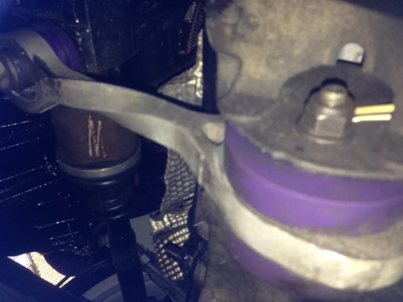

Up to date photo, driveshaft seal replaced still leaked :/ over tightened bolt and it sheered so for to tap that out now so close it's frustrating!!! Wheels dropped off to be powder coated as I wasn't happy with the finish before

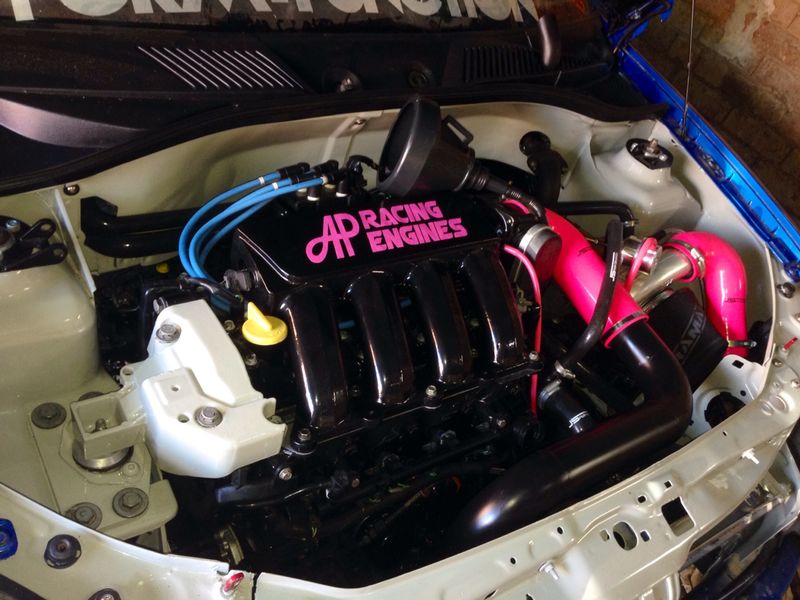

NorthloopCup

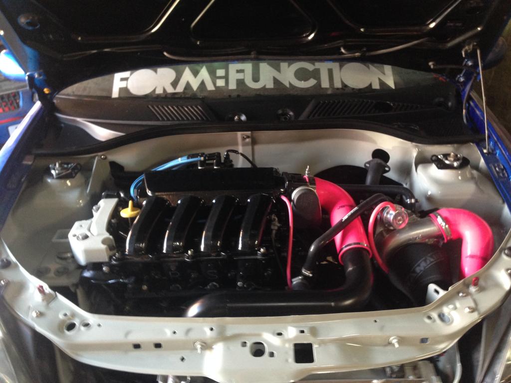

Looks good mate! Not thought about rubbing back the paint to expose the Renaultsport writing on the inlet? It would just break up the black a bit. You could always paint it pink to match boost hoses?
batesey
  172 Cup Turbo
The inlet is actually smoothed off, got a decal to put on it from the engine builder when it goes for bedding in :)

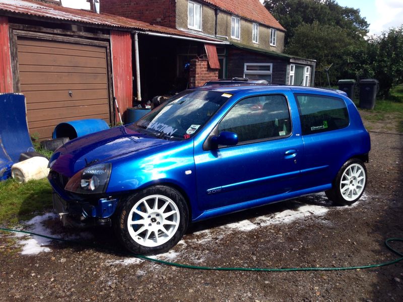

They see me rollin'... :D

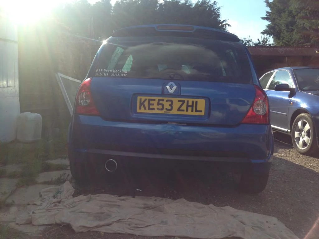

Bought a 2nd had mondiial bumper which had an oval exhaust cut out, so fitted the 182 surround but was left with a gap either side, didnt want to paint it straight away so got some fiberglass and filler and satin black and got creative with my mate :)
Realigned the exhaust too so sits perfect! well happy will save having the £30 bumper i bought from being painted for a bit (old one was cracked)

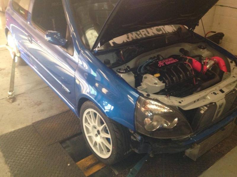

Ordered the wrong size r888 so got rubbing issues on full lock :( ordered some new tyres so the r888 are for sale now
Hopefully get new tyres on Wednesday then get her on the dyno in next week or two once the engine builders done the first start up :)

Quick update!! Engine builders had her started, his words are. "She's a monster" that's at 0.4 bar lol boost comes in at around 3k which is awesome for a gt30, that's down to the exhaust housing from a gt28 [emoji12] so excited to get her back
  340i
Can't wait to see what numbers it makes!
The engine builder you are using aren't far from me, just seen your FB post :)

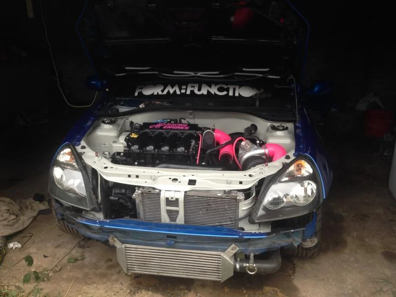

Got the car back from the engine builders after some running in...

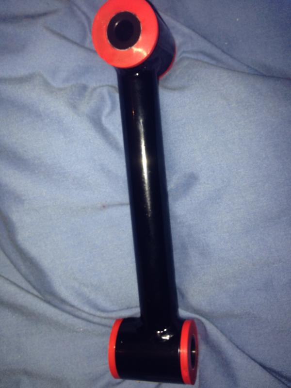

Gear linkage need some aligning, the dogbone has fallen to bits so I've ordered a evol engineering one,
Also there's no power to the engine so something is wrong there but he got around it with some jump leads

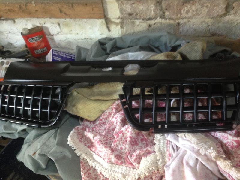

Painted the front grills satin black
Hopefully the new dogbone will arrive Friday, I'm guna try fix the other issues tomorrow, fingers crossed mot next week and expo show top 25 a week on Sunday [emoji1] some hard work coming up to be ready along with a house move the same weekend [emoji16]looking to have her mapped in December
batesey
  172 Cup Turbo
Think that's probs why it fell apart, must have lost it when it was apart, bush was tired anyway so needed a new one

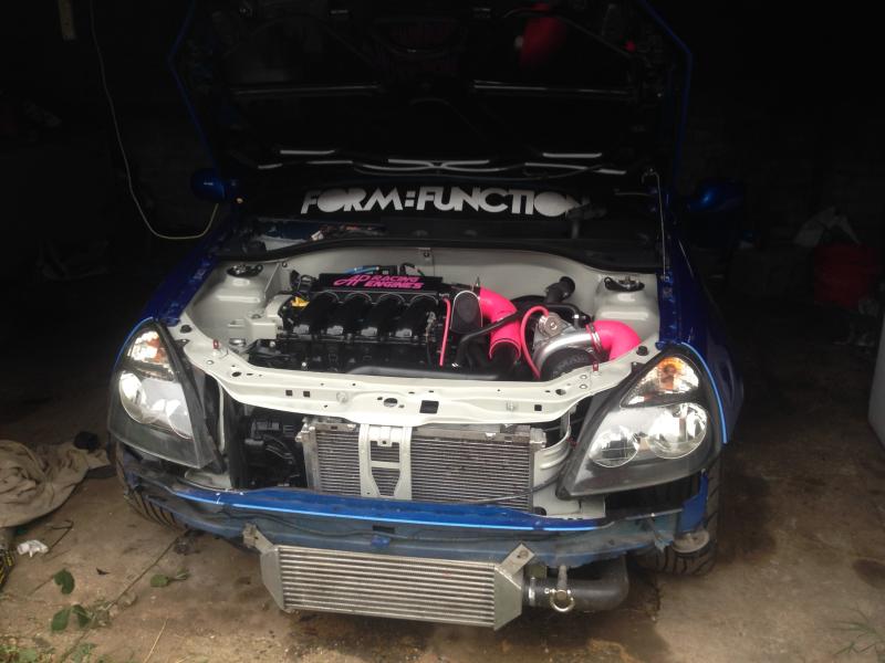

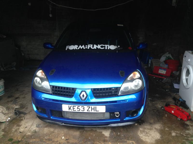

All back together!! Picked the bumper up from bodyshop today , fitted new dogbone and sorted the wiring fault [emoji1]
Also got a new buffer pad for my mates polisher which I've borrowed to get her ready for expo at the weekend [emoji16]
