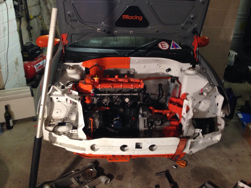

Sorry not been much of interest happening on the thread but things are still developing with the car. At the moment i’m just trying to learn as much as possible about the engine and how much of a task its going to achieve the figures i’m looking for.
Other than the engine the other work planned consists of:
  • PMS shifter
  • Lightweight flywheel and 7 1/4 AP clutch
  • Rebuilt AST's
  • New front discs and slight modification to the mounting bracket
  • Brake servo removal and replaced with bias adjustable pedal box (Will be selling these in a few months once its all finally made and tested, its a very simple bolt on solution)
  • PMS adjustable top mounts to be fitted (When its completed)
  • PMS rear stub axle and larger bearing kit (When its completed)
  • Refitting the Gripper straight cut dog box as they have redesigned the crown wheel and pinion to eliminate any future issues
  • Strain relieved gear stick for full throttle gearshift's
  • CMComposites fibreglass bonnet
Jobs for the course of the year:
  • Further development of the suspension with modified ARB’s F+R
  • Gearbox cooler
  • Increase the sensor package to allow more data (Brake pressure, steering angle etc)
The timescale for the engine is about 12 months so its a slow burner project but will be worth it in the end :)

Just got a phone call from Gripper the dog box is fixed and ready to go :) I’m heading back up North tomorrow and collecting it and then putting the car back together on Thursday. I can’t wait to drive the car again it feels ages and also been very odd not been within 200 miles of the car to tinker with it! I think i’m going to be doing Bedford on the 15th Feb so not too long to wait until I can drive it again
