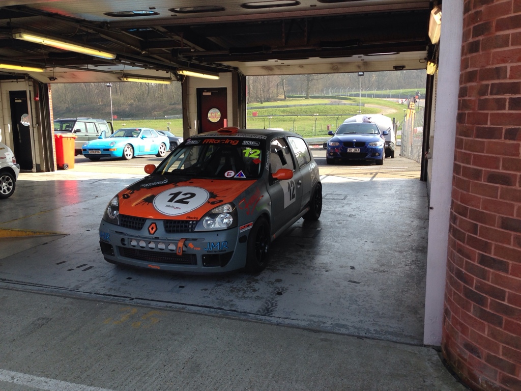

I think its safe to say I also have the CS race car curse that is going around at the moment......

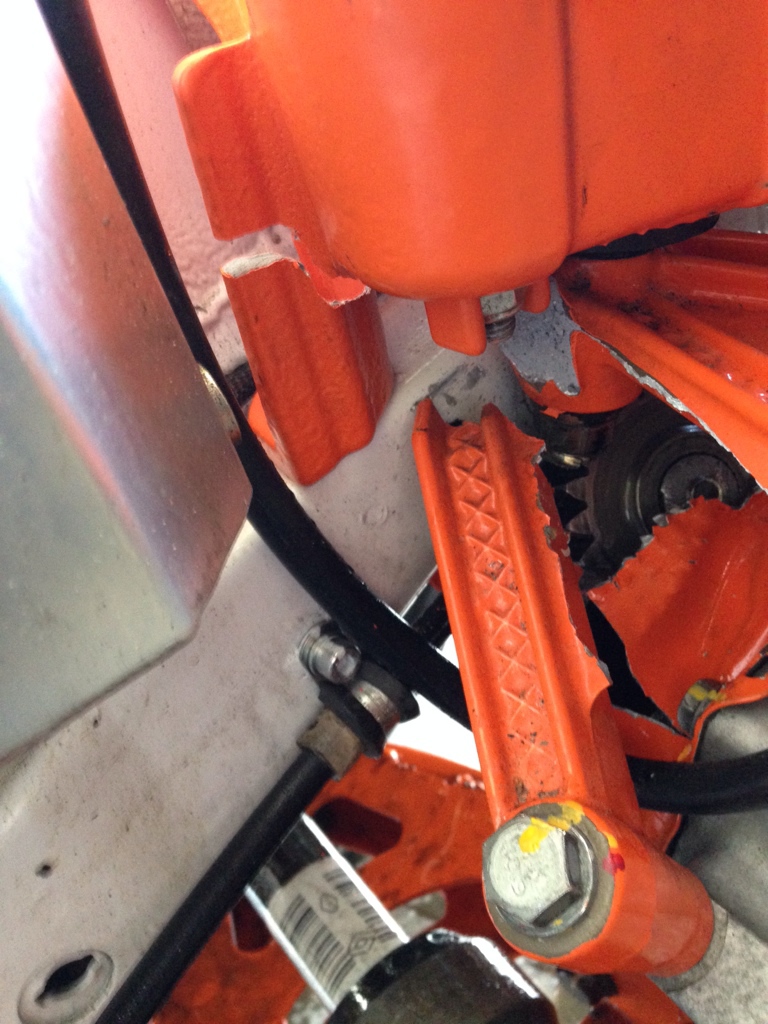

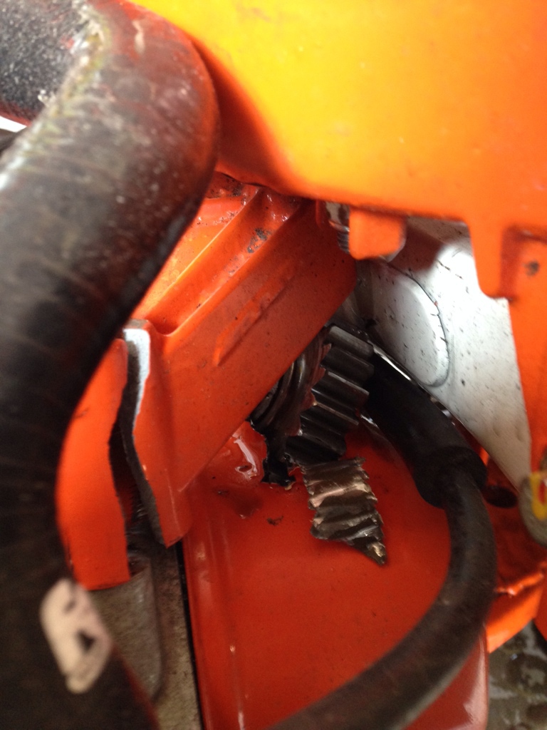

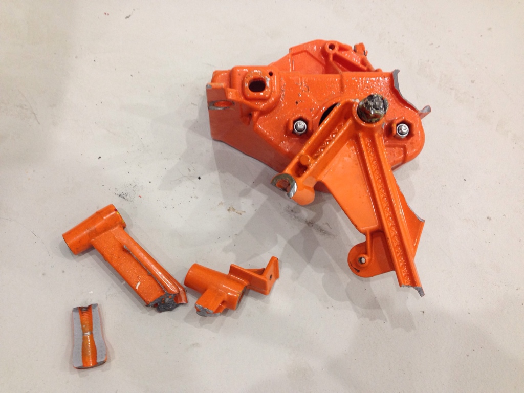

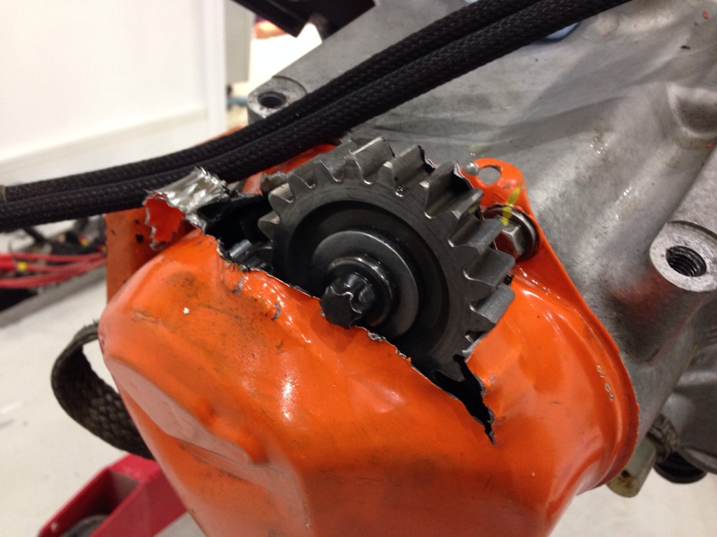

Half a lap in went to put it in fifth and the gears have ejected themselves from the box and sheared the metal gearbox mount the lot! For the half lap before I went for 5th the car felt epic! Lol
Doh

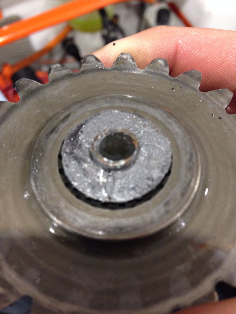

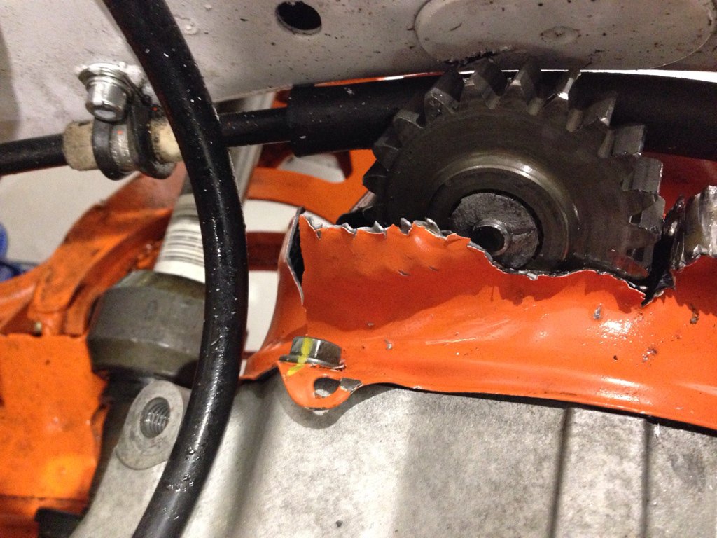

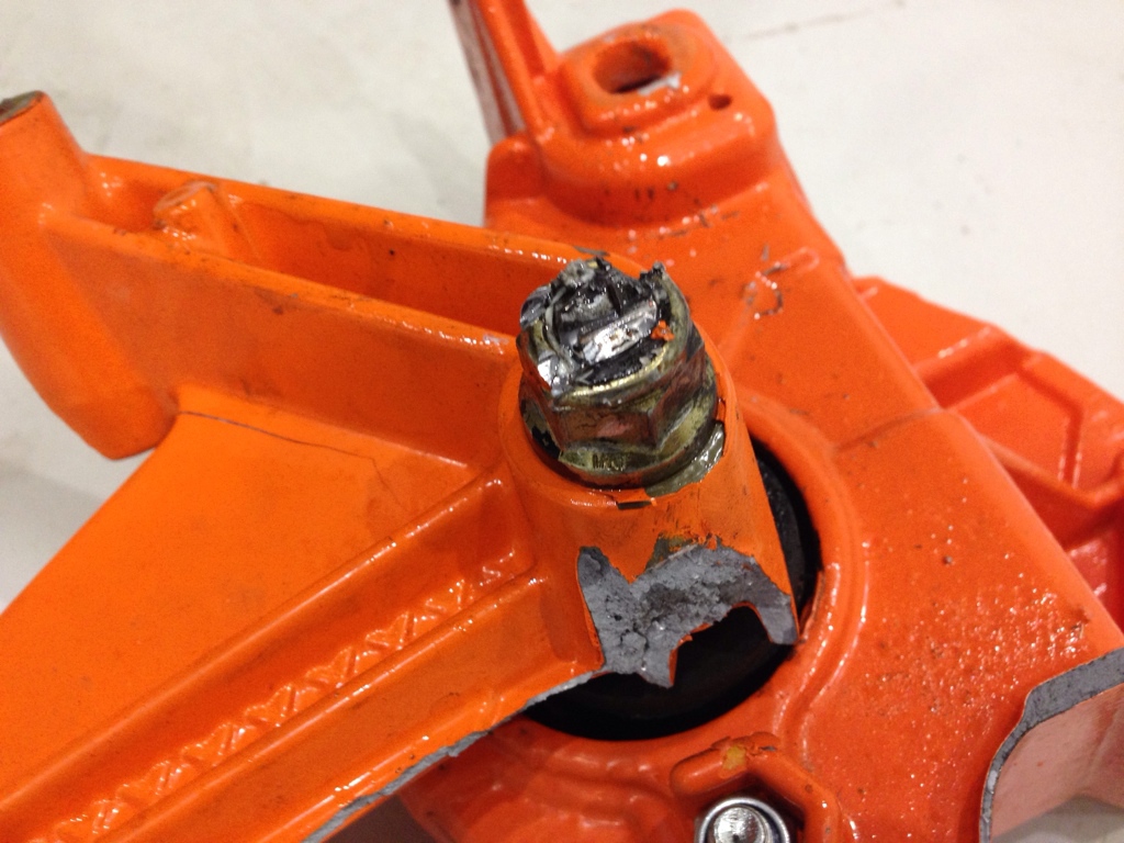

Thanks guys :) Well got the car back to base and done some stripping down and now have found the cause of the problem, It seems the new pinion shaft that was made over winter to replace the old one that was missing a tooth had a flaw in the material as the bit 5th gear bolts onto has just sheared clean off. I’ve watched the video and the second I take my foot of the clutch you hear a bang and lose drive. That was the first time 5th gear had been engaged on that shaft.

Yes i’m glad it didn’t hit my brake lines or it would have flown through them, the damage that one gear has done to the gearbox mounts, bolts and even dented the chassis leg... Mental!

No mate it's a torq headed bolt for the gear on one shaft and a 27mm nut on the other.
So it is, I can picture it now. The nuts over a hollow shaft iirc. I have only had the covers off once.
Same sentiment stands though, I was hoping it was the securing device that had let go but it transpires its the whole shaft that's let go :(

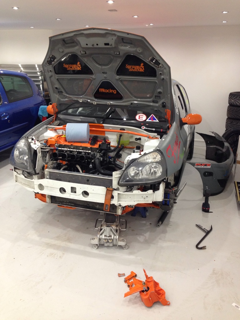

Haha no just a very nice garage one of my friends has kindly let me use now my house with garages has sold.

Unless there was a major defect, its been caused by something else locking first and putting an abnormal load on it.
I guess you will just have to wait and see what Gripper say.
I’m still 100% its an issue with the shaft the rest of the box was and still is mint and its just 5th

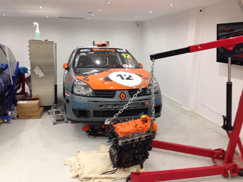

Have been lacking motivation to pull the car apart again for the gearbox out but I'm heading up near Coventry this weekend so made sense to get the box out and take it upto gripper.
Getting really quick at taking it out now I think with a second pair of hands 30 mins is achievable!
Not sure what the plans are now really, the car is going down to Puremotorsport at some point soon for them to fit their new adjustable top mounts. After that I'm not sure as the gearbox will take at least 2 months to be fixed I think so probably will put a std gearbox in for a while along with another engine with the 421's in.
I'm getting a head done and going for a set of 423's for my current engine so that will go back in once the gearbox is done and after the road trip to Le Mans.
Just want to drive it really pretty fed up of looking at it every day and not using it.
