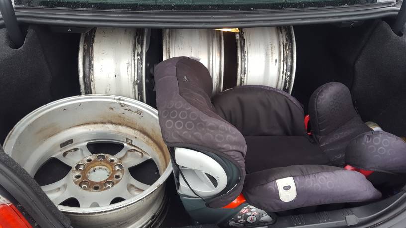

picked 5 of these up today for me winters, boot swallowed them up!
