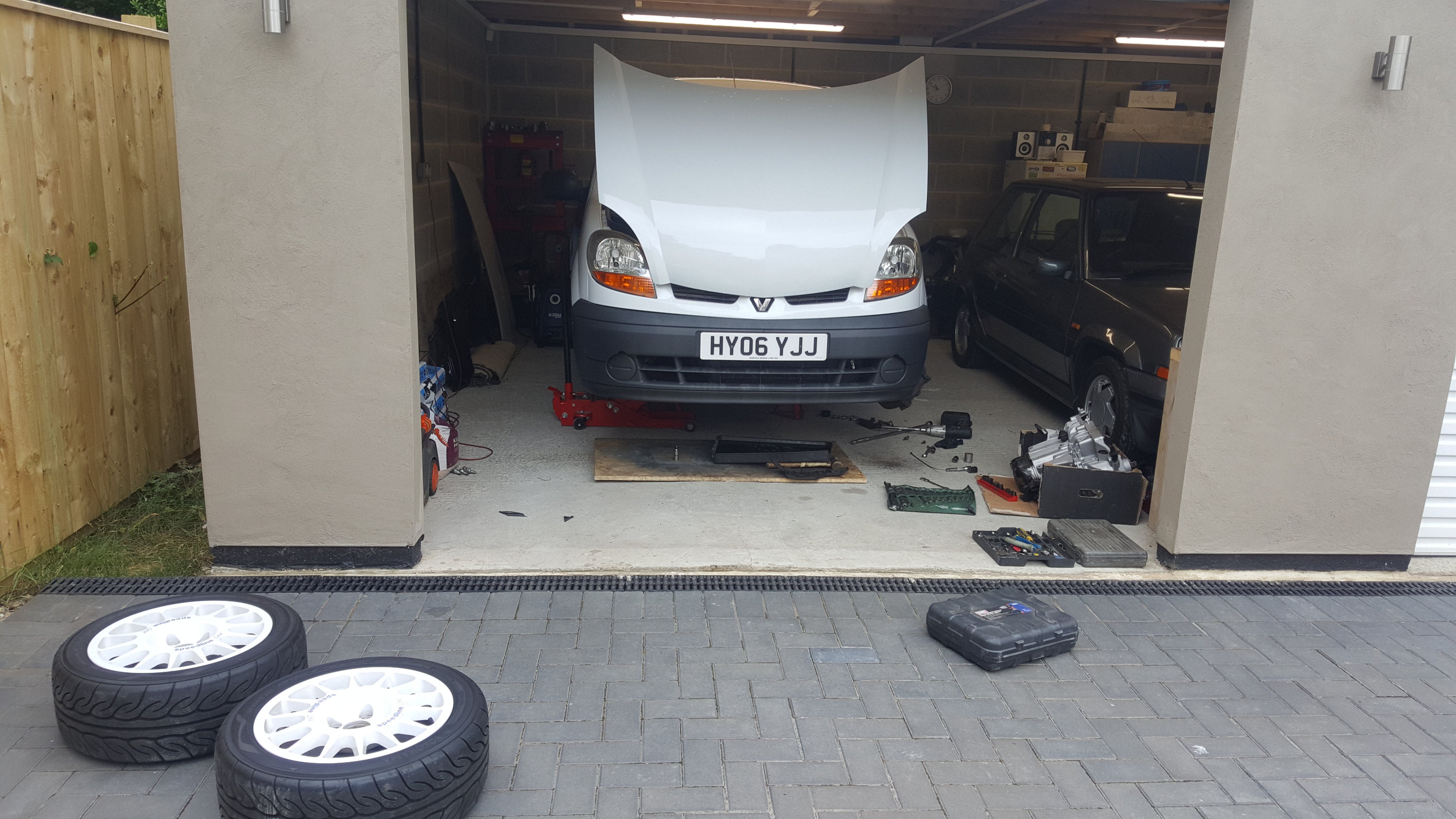

Box swap day. Steady 45mins and subframe is ready to drop, quick bit of dinner and scan a meg250 with clip then back on with it. Hopefully be running and driving with new gearbox, new clutch & pms shifter in tomorrow ?
Brigsy
  T.Turbo
Box swap took a bit longer than anticipated ?
Got box out fast enough, subframe off. Left steering rack in situ as all the hpas pipes looked like hassle to remove

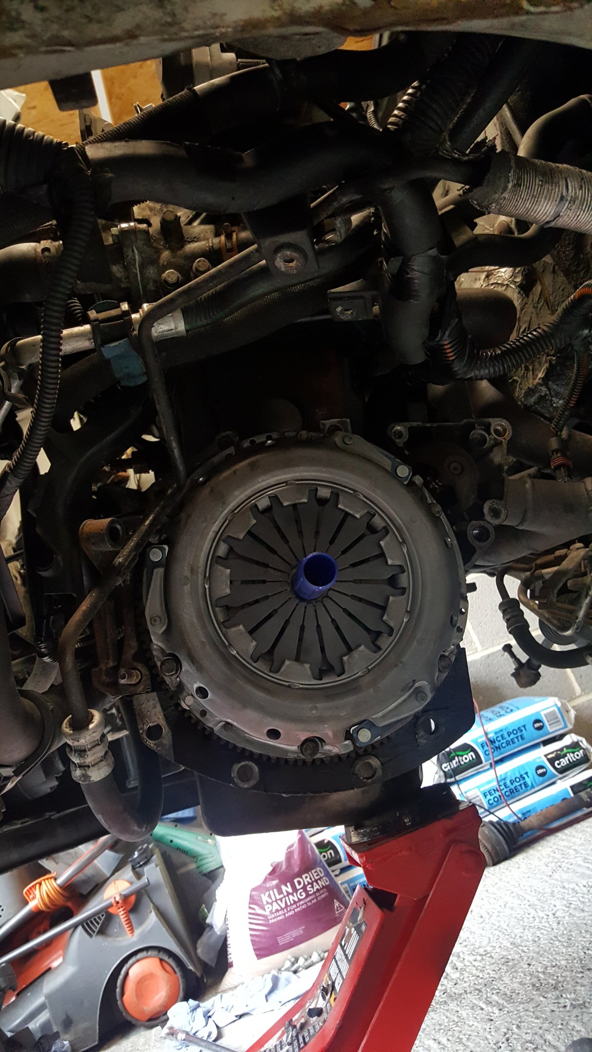

New valeo clutch in - old one was Luk and well worn nearly to the rivets

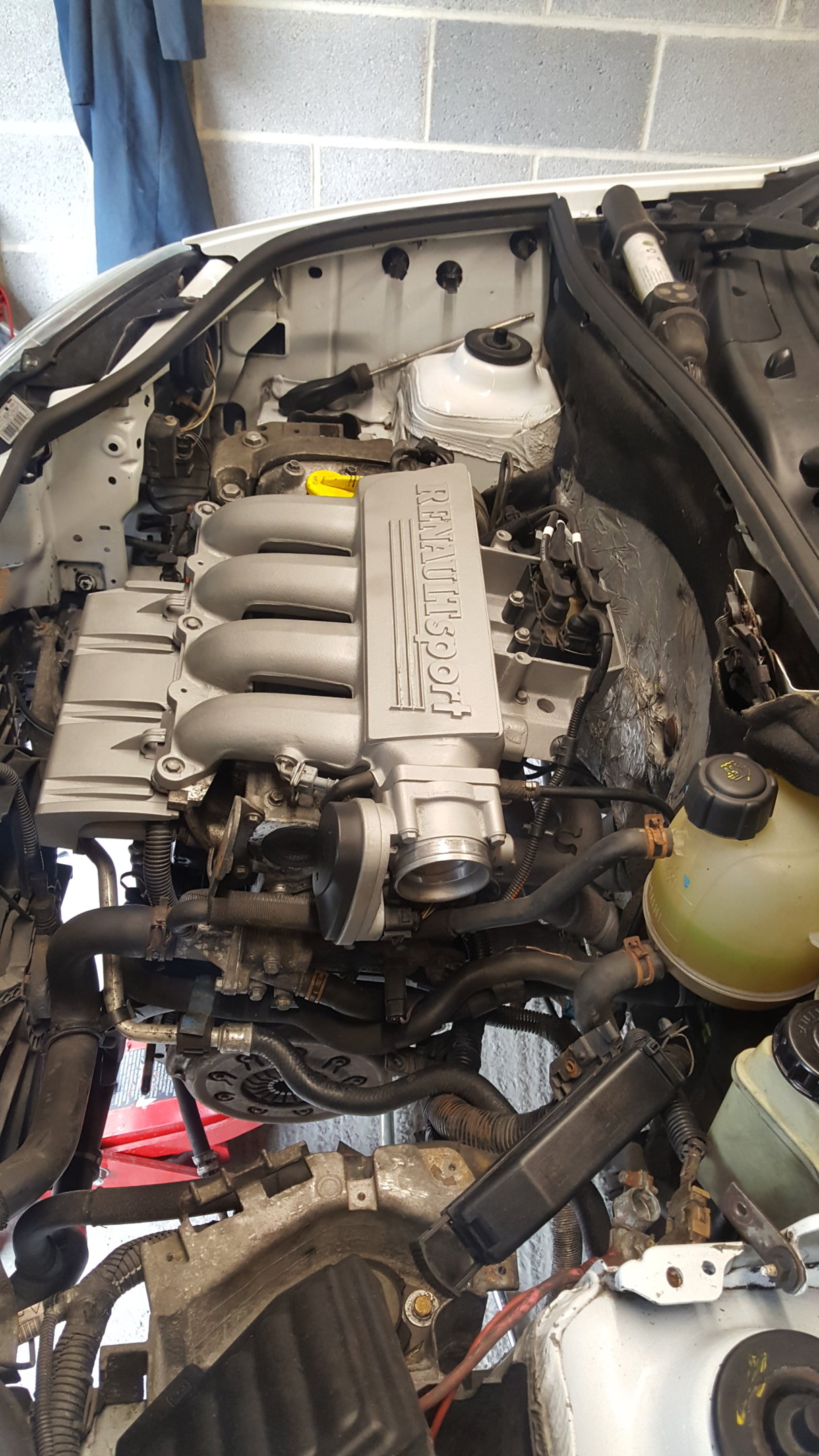

Box back on Jc - 129 fitted to replace the knackered Jc 089 ph1 box. Filled up with oem Elf gear oil

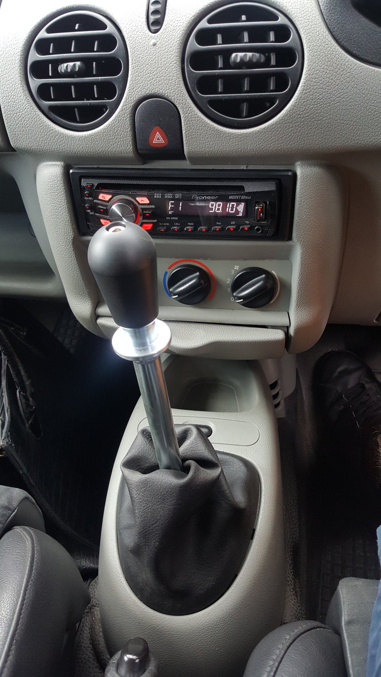

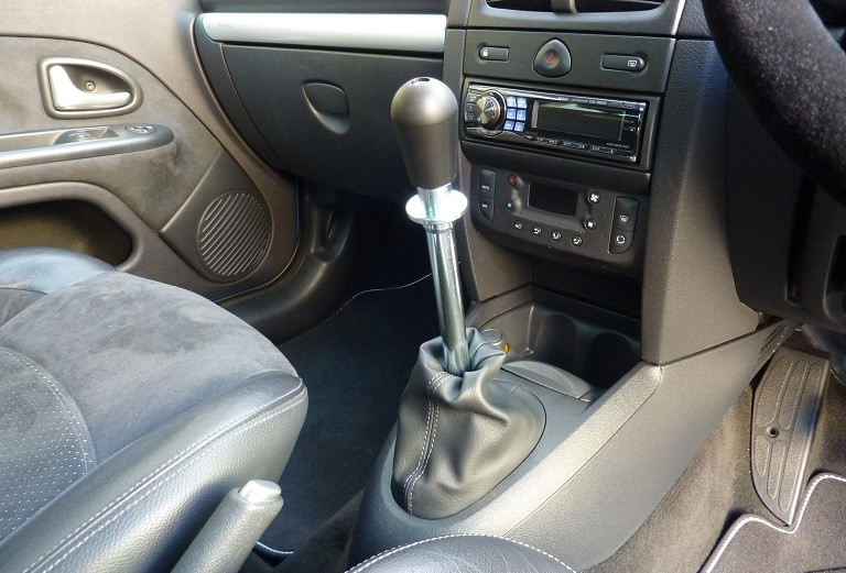

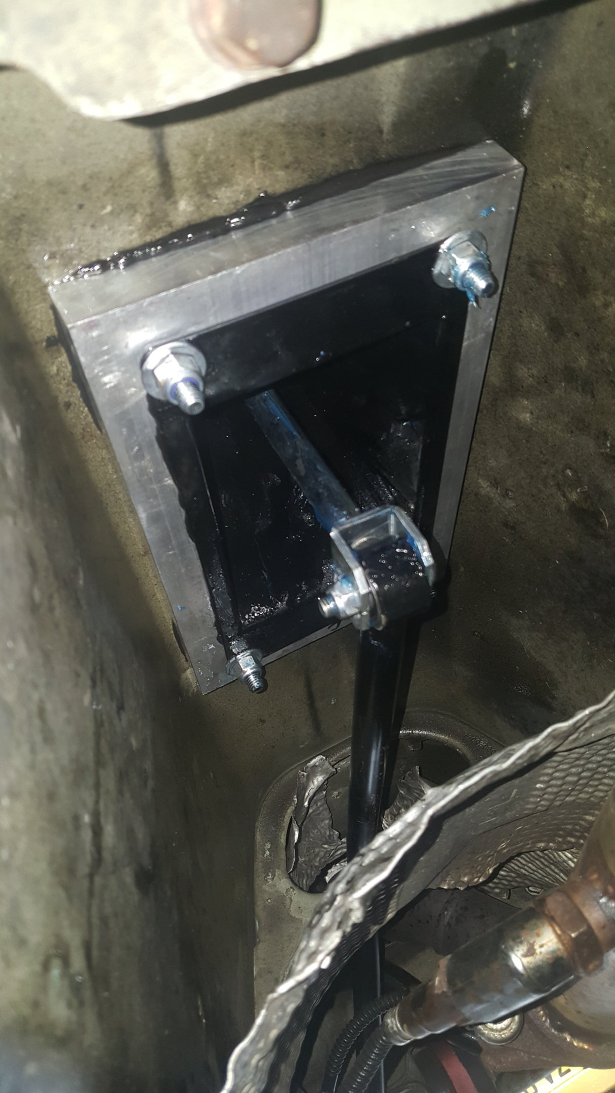

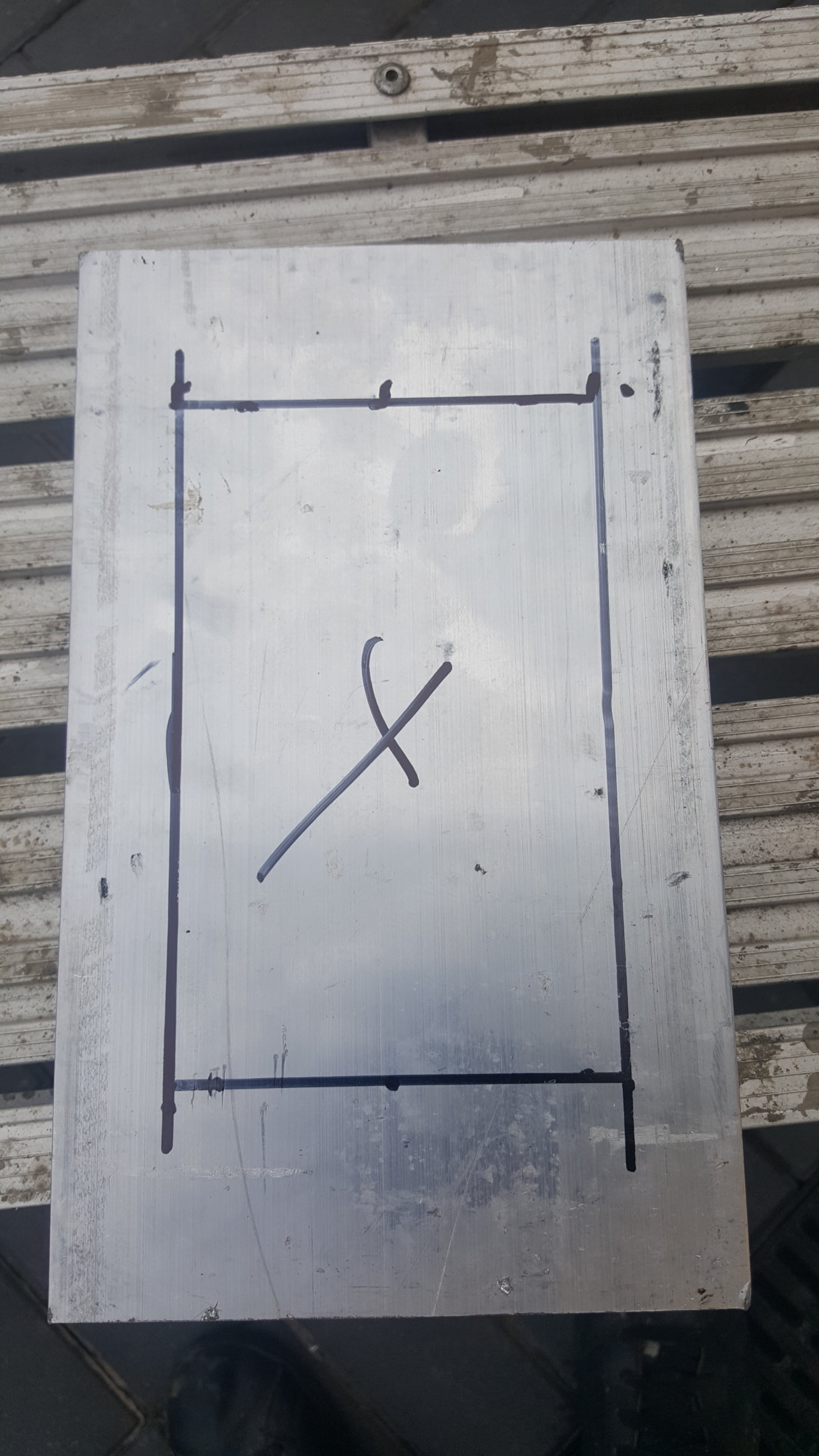

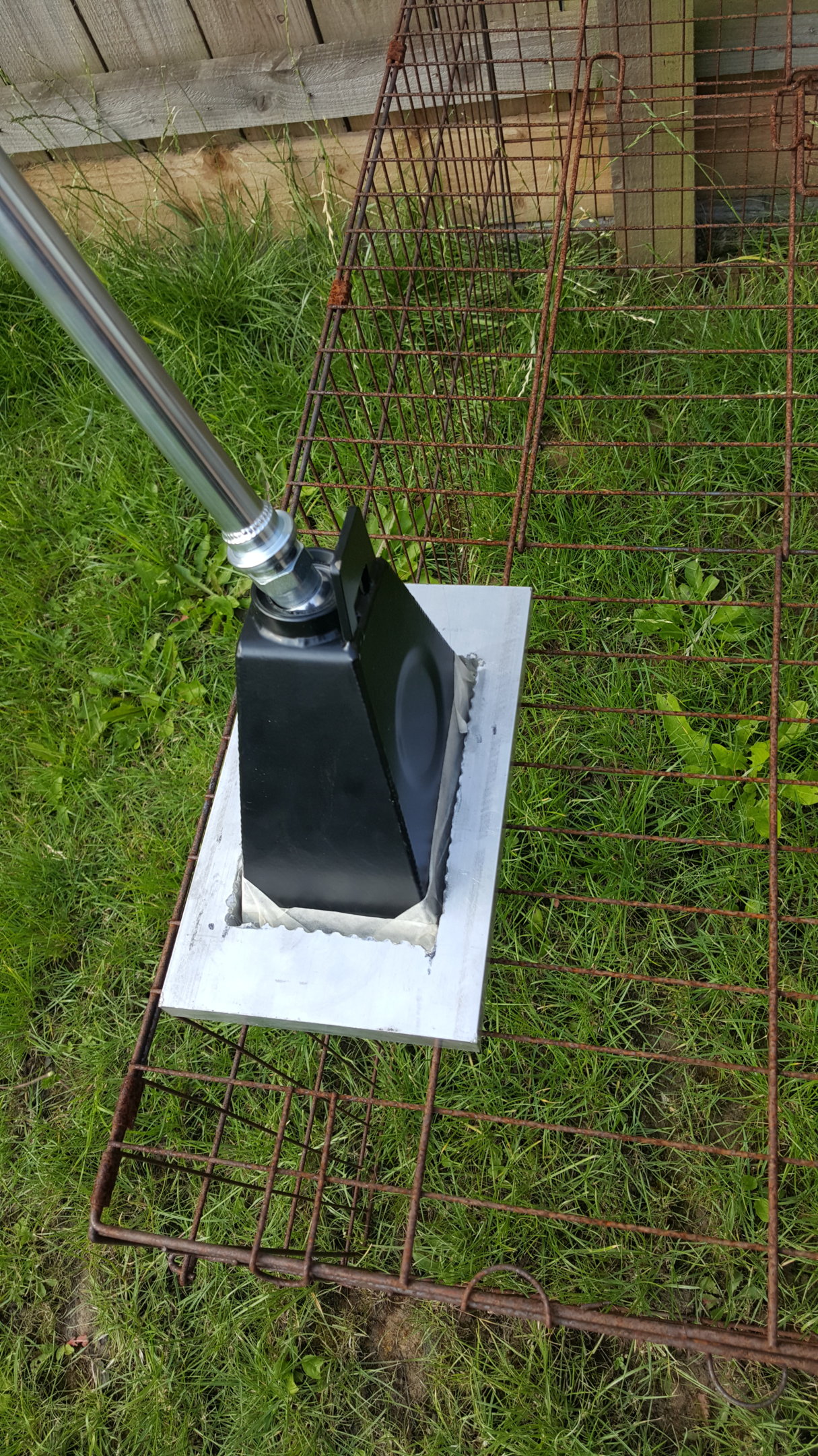

Trial fit of Pms shifter to see what the score was. @H2MRK had advised me it needed to be dropped 20mm as Kangoo tunnel is higher than clio making selector rod hit the subframe when trying to select reverse
That was that for last weekend as ran out of time & needed a piece of 20mm alloy sheet to make a collar. Ordered a bit off ebay on Sunday with the aim of receiving it through the week.
Brigsy
  T.Turbo
Tuesday arrives and alloy plate arrives

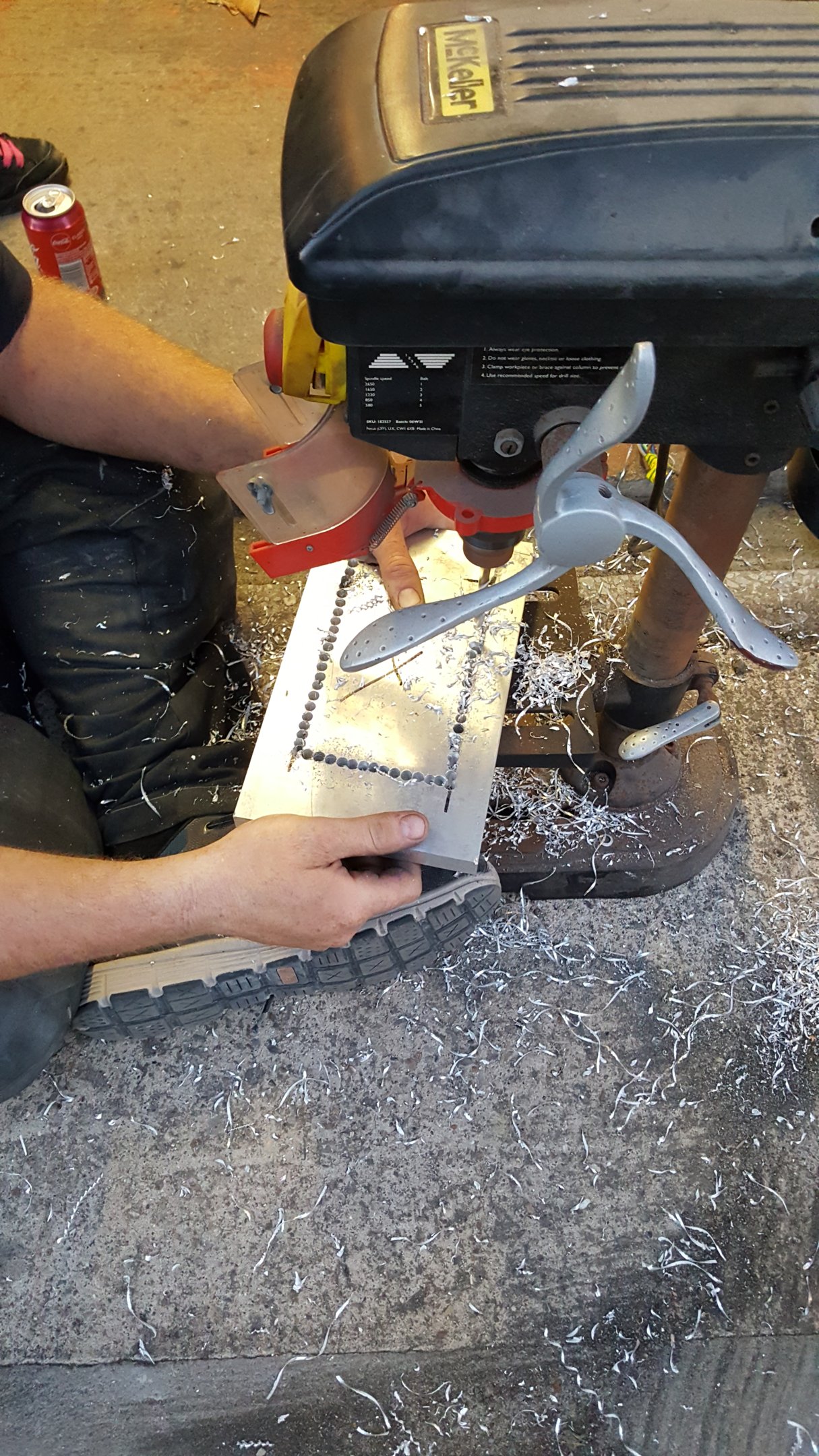

X marks the spot that needs to be cut
Cutting this was not as easy as planned - 20mm is quite thick and grinder was not really touching it so got my mate to chain drill it out. We call his garage BAMS (back alley machine shop) anything goes lol. I would have usually got a machine shop to do this but costs were spiralling out of control
Quick tidy up with flapper wheel - function over form and not to be seen when fitted
Fitted - all gears select fine. Feels great too. Everything coated underneath with acf50 and corrosion block grease to keep it fresh

Clubsport look with gear gaitor fitted

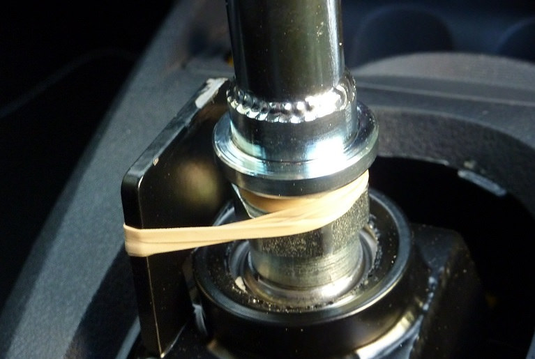

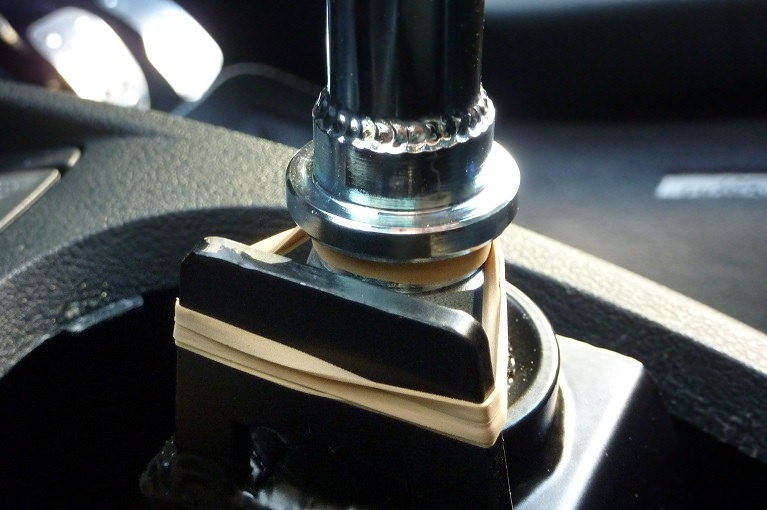

Pms shifter was rattling like feck the other day. Fitted dampener onto it and its 75% improved. The weight makes the shifter feel different not sure if i preferred it before or now? Linkage needs slight adjustment to make reverse easier to get.
Brakes not as sharp as they used to be, didnt really notice the other day - i dont think i was using them much ? so fresh fluid and adjust rear shoes. Might see if funds will allow a set of ds1:11 pads for the front. Will see.
I have the PMS shifter and vibration dampener on my 182 - i never drove the car without the dampener as it all went on at the same time so can't comment there but with regards to the rattling, I went round the block when first fitted and sure enough, rattle rattle rattle. My OCD and need for everything to be neat and just was not happy about this (lol) so I thought of a very simple solution which might be worth a try in the van maybe?

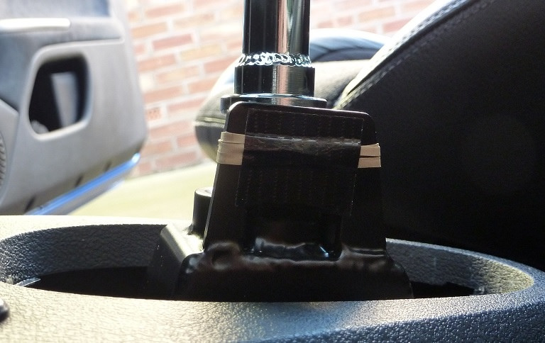

I got an elastic band and did this;
proxy.php?image=http%3A%2F%2Ffarm5.staticflickr.com%2F4661%2F40271135642_256b37d5b9_b.jpg
proxy.php?image=http%3A%2F%2Ffarm5.staticflickr.com%2F4716%2F40316497161_048c4bdefb_b.jpg
I then fired up the car again, let it idle, no rattle....... was gently revving it, no rattle........ the band has enough 'give' to allow the movement for the gear changes (this is where a solid cable tie would be no good) and doesn't cause any issue, but is tight enough to stop it vibrating. To stop the band slipping off, I've just neatly held it down with some tape;
proxy.php?image=http%3A%2F%2Ffarm5.staticflickr.com%2F4741%2F39418971285_80cfba24ca_b.jpg
It's a bit basic I know, but all back together with the brand new gaiter that was fitted at the same time and you would never know

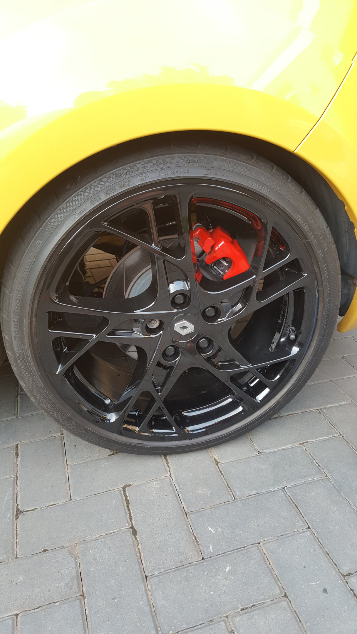

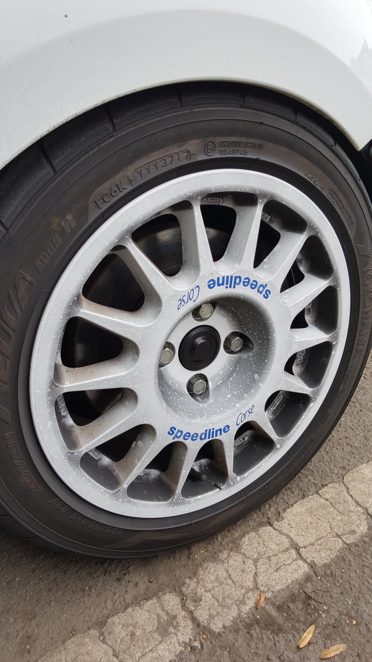

Whilst in the air give the wheels a decontamination inside and out, sealed in preperation for mega brake dust at csf festival.
Still love these when clean. Half hour job previous poorboys wheel sealant has done the job well

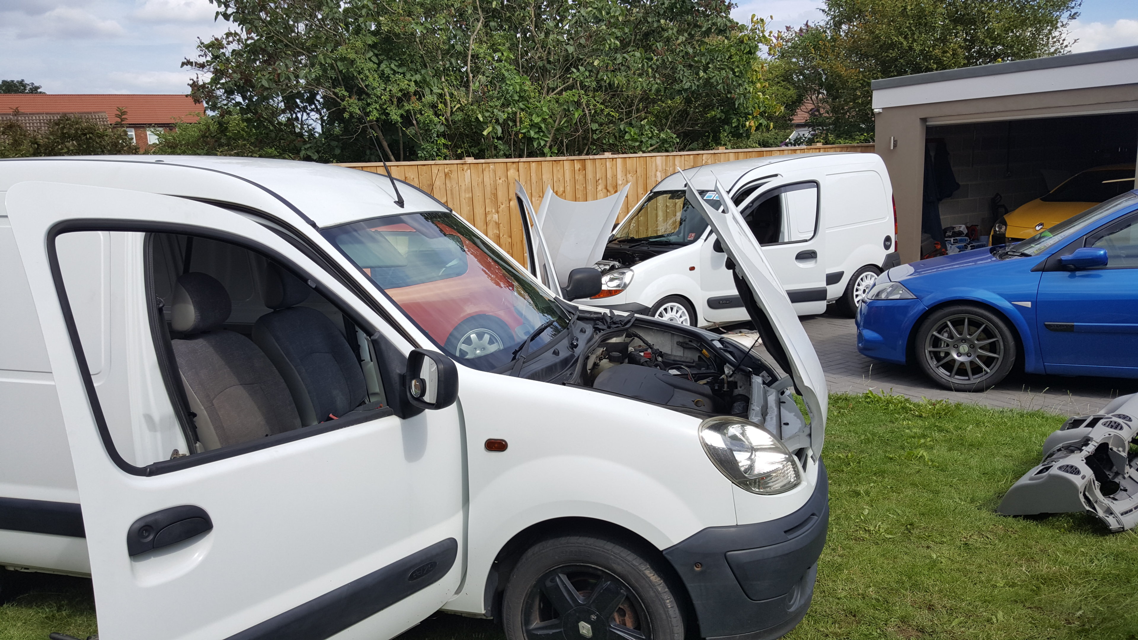

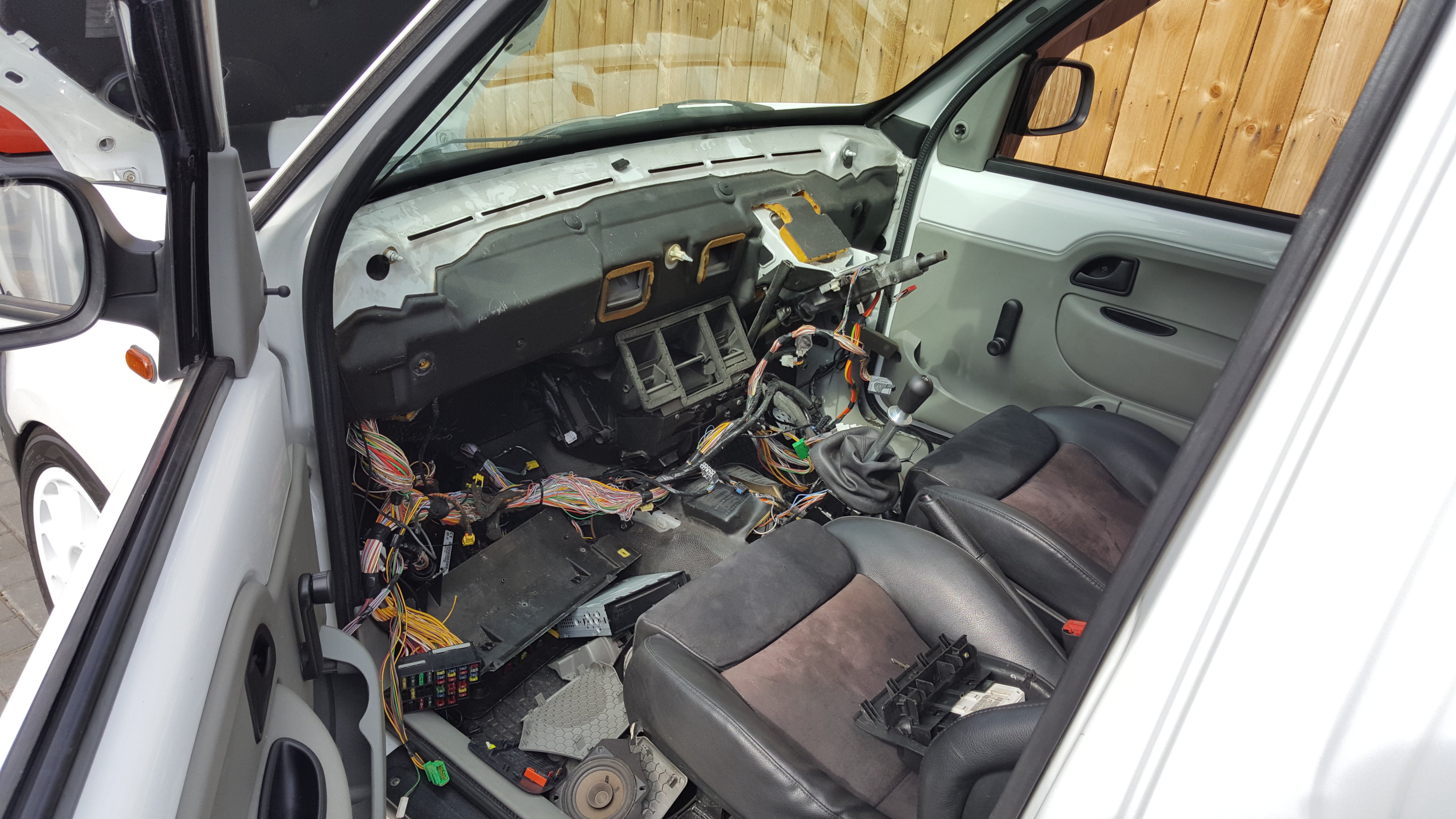

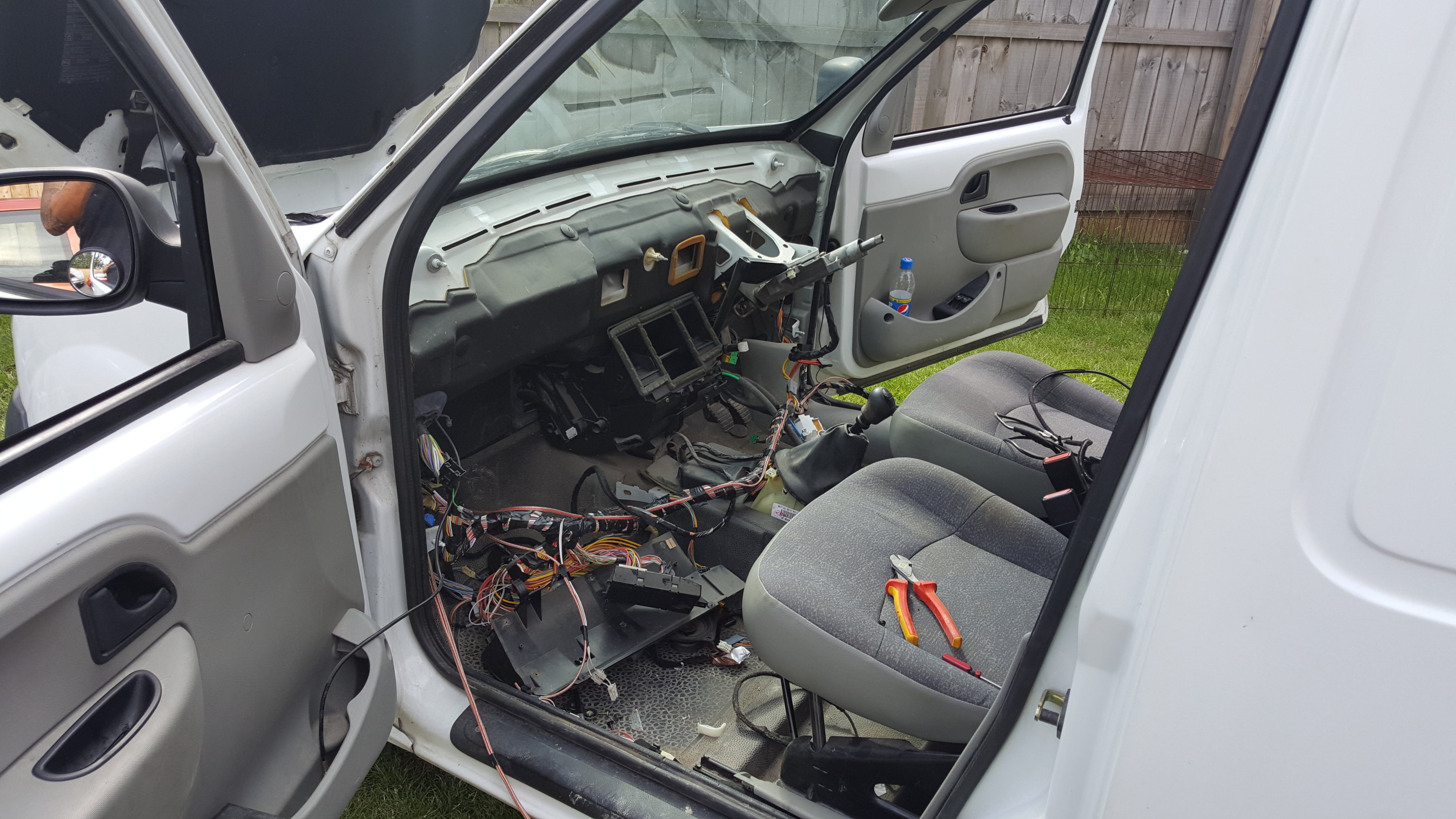

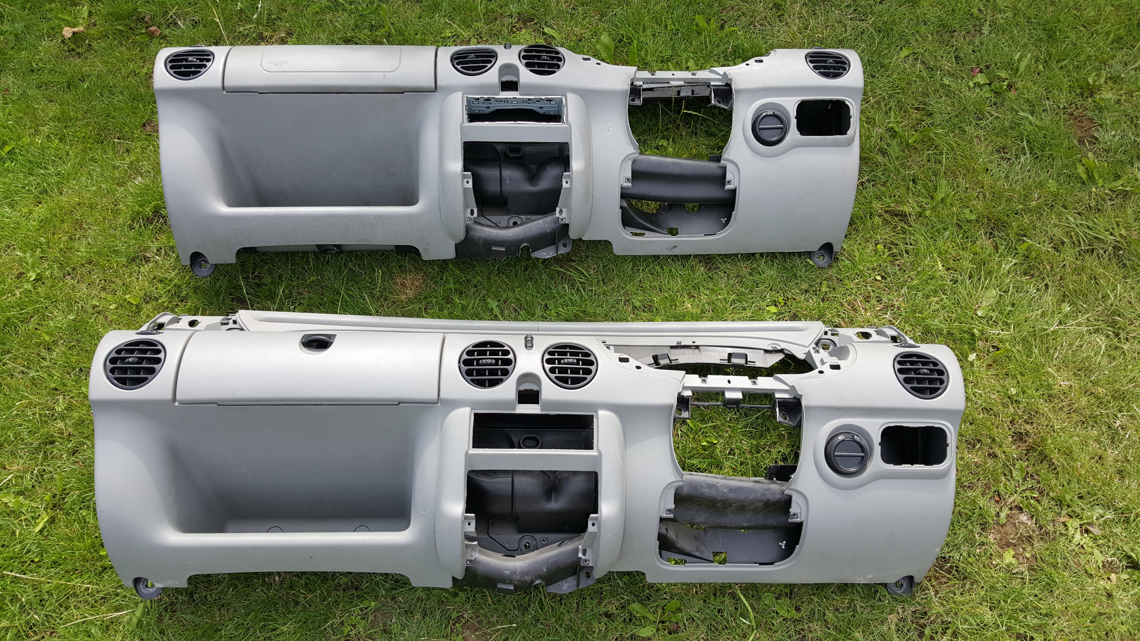

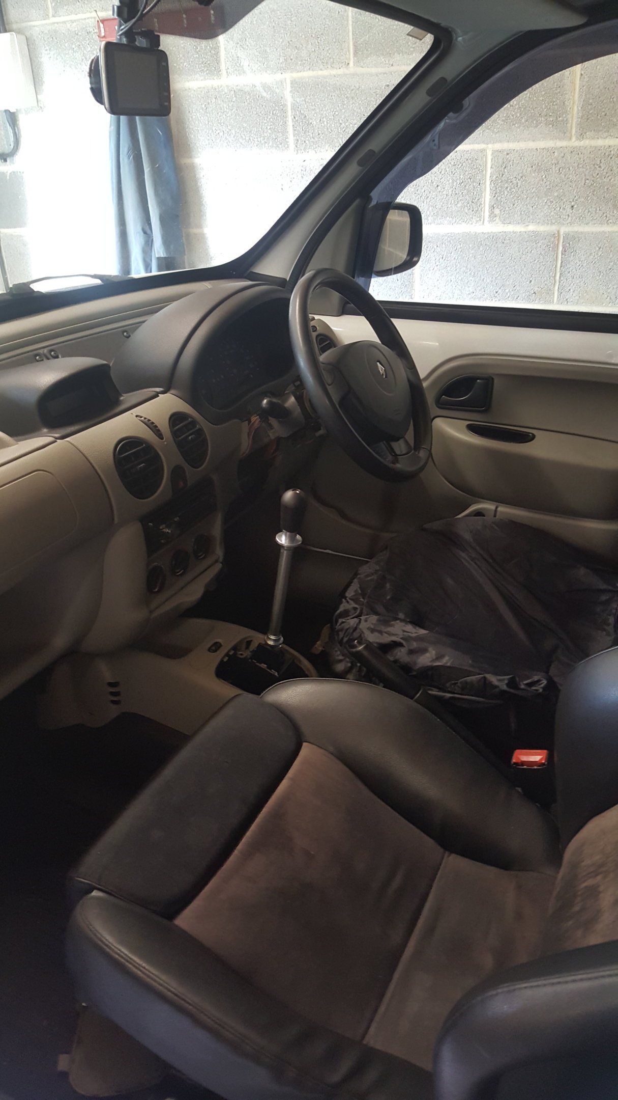

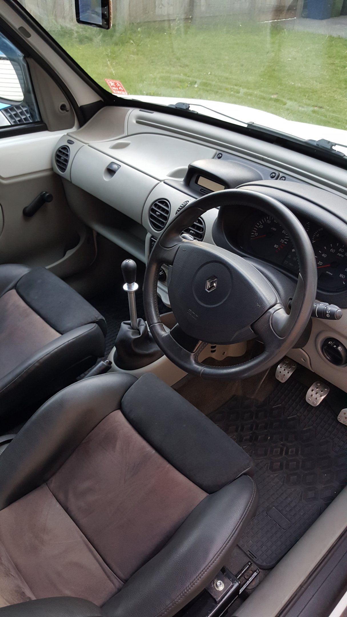

A good mate of mine picked up a mega cheap Kubistar. Had a look round it and the dash was mint with no airbag and he was planning on selling the van so asked if a cheeky swap could be done..he eventually give in and said take what i want as long as it will still sell?
He rings me up mid day Sunday giving a small window to do the swap. Started the job 2:30pm cars and vans everywhere
Kubistar dash out
Kangoo dash out
My airbag dash vs glovebox dash. Feels lighter should have weighed it really
Brigsy
  T.Turbo
7:30pm job done and absolutely knackered due to heat and lack of food. Looks ok though and free

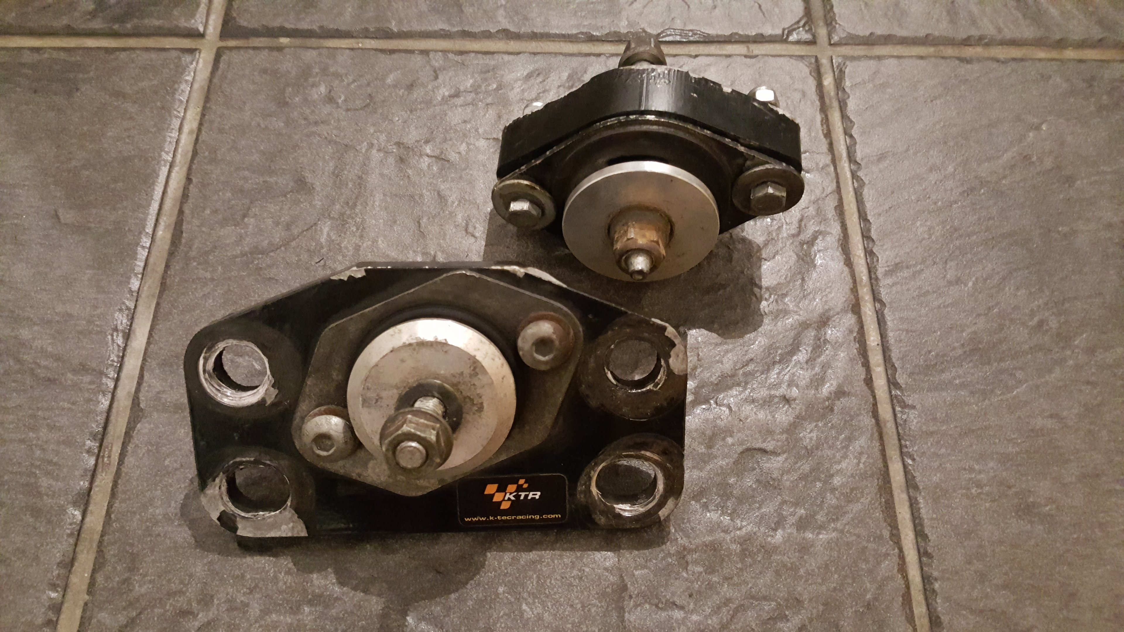

I had planned to collect a pair of ktec/vibratechnics mounts in Darlington so straight in the clio to get them after fitting dash ended up getting food at 10pm lol. My engine has a bit of a rock now you can change gear with new box so should sort it out.

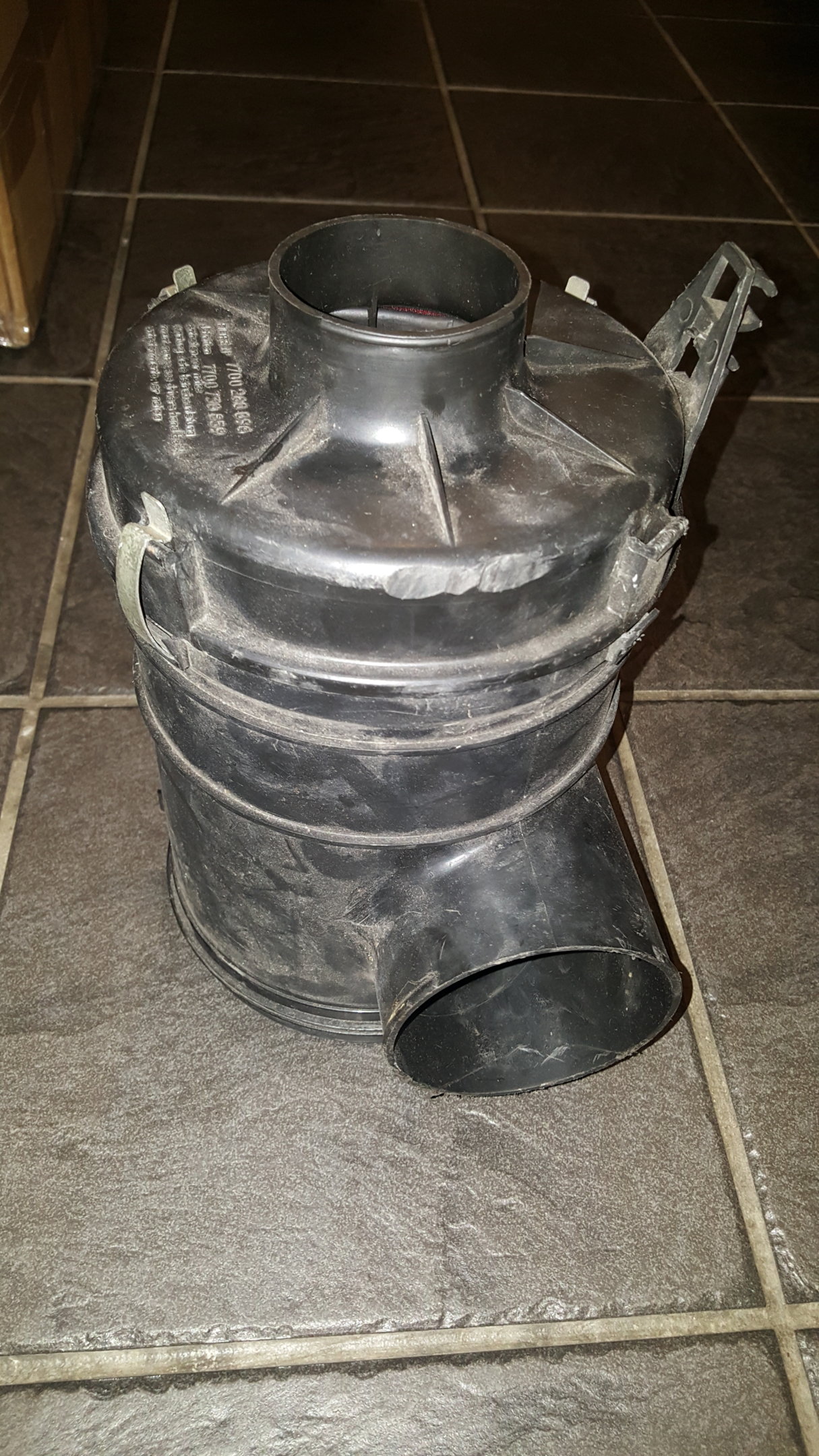

I have also acquired an espace v6 airbox to fit. I really want to put this on however i had the kangoo noise tested last week and its 102db at 4700rpm so cant really add any more noise ! Ill prob bosh it on though and hope for the best.

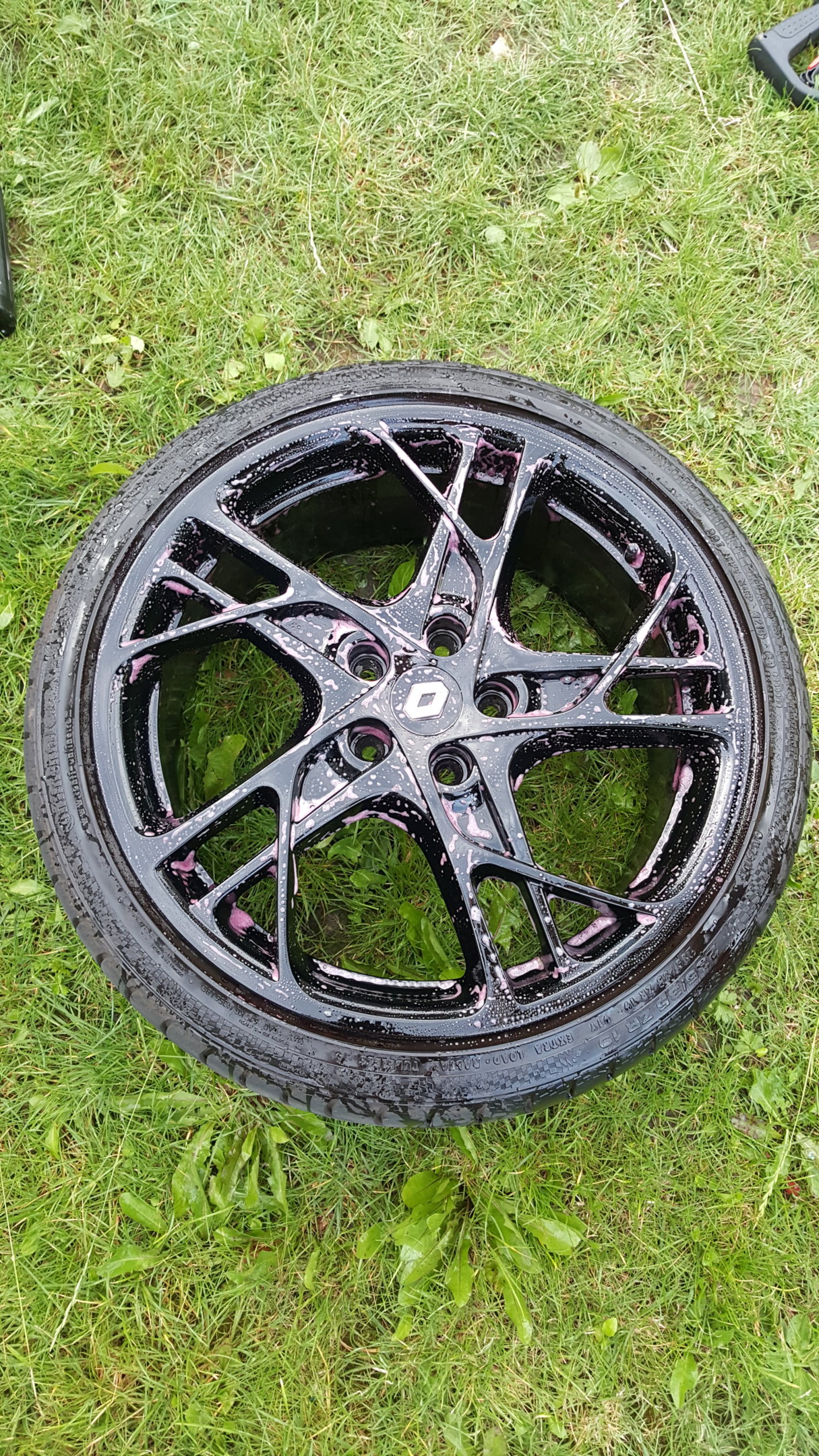

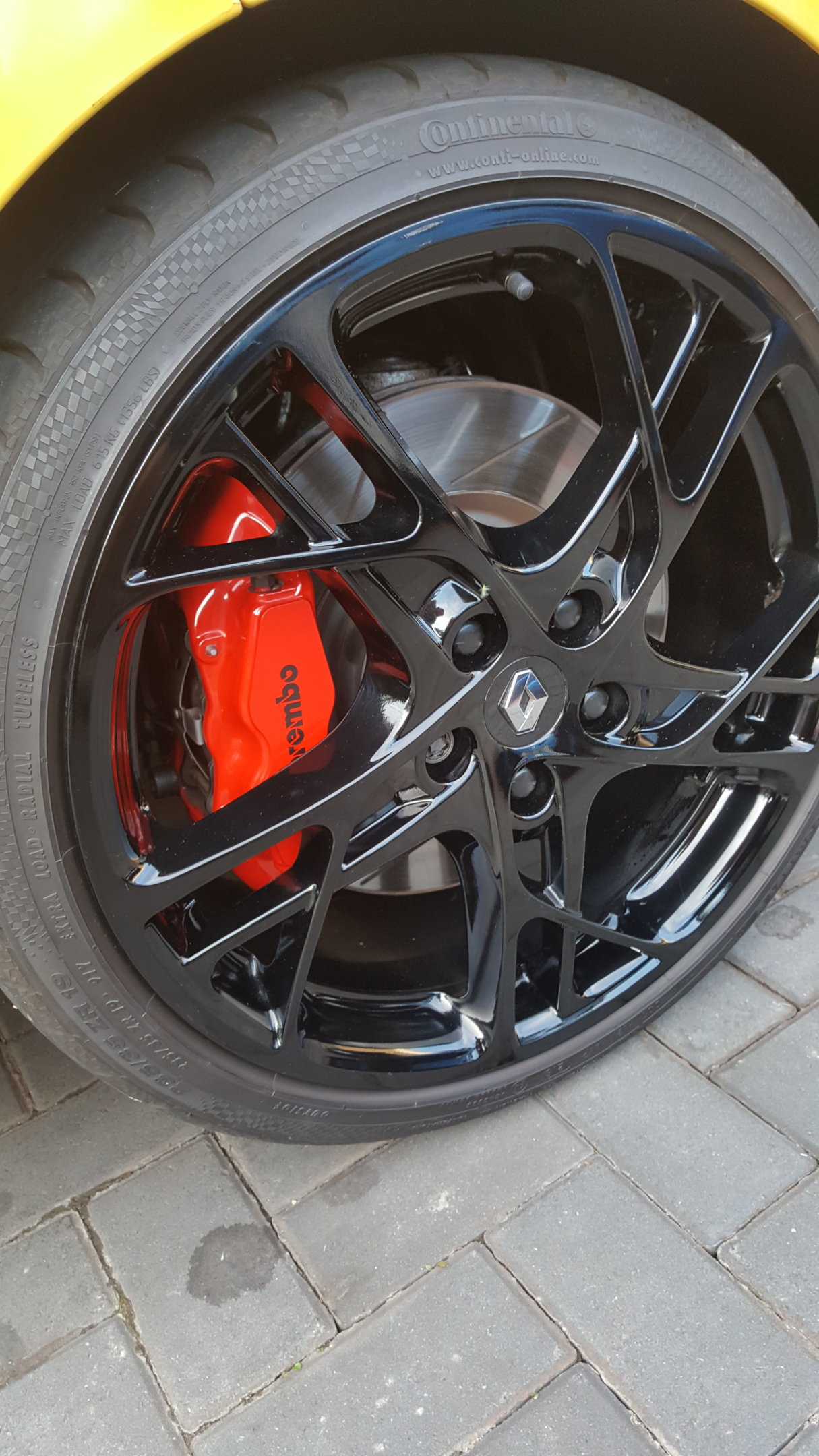

In other news i fitted the Bc coilovers to the mrs meg 250 cup. Had a mare doing it as somebody had been there on the passenger side and fecked up a couple of bits. All sorted now looks and drives great, really impressed with the bc's for the cash. Lowered 40mm front 30mm rear from stock.
Wheels had mega fallout on them due to previous owner so decontaminated them and sealed on Sat. Had the mrs on the job its her car so get hands mucky haha. 3 hours on Sat to do them with bbc radio 1 ibiza weekend on the radio.
Done
Worth the effort i reckon, should have got before pics as really bad rust particles. Also renewed glovebox and dash trim below the Renaultsport plaque for new oem as a few scratches.

3. Fit V6 airbox - all parts ready to fit

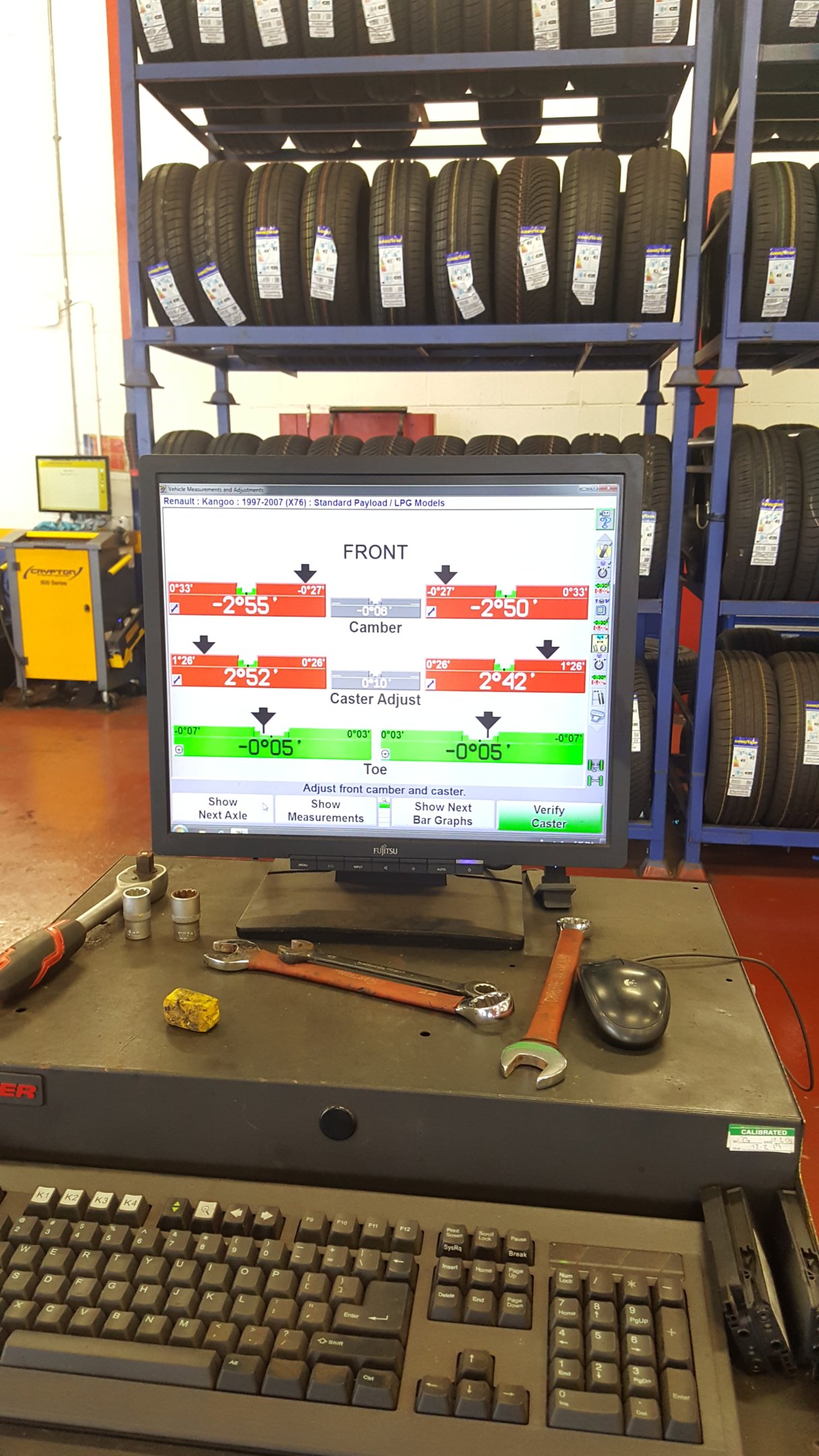

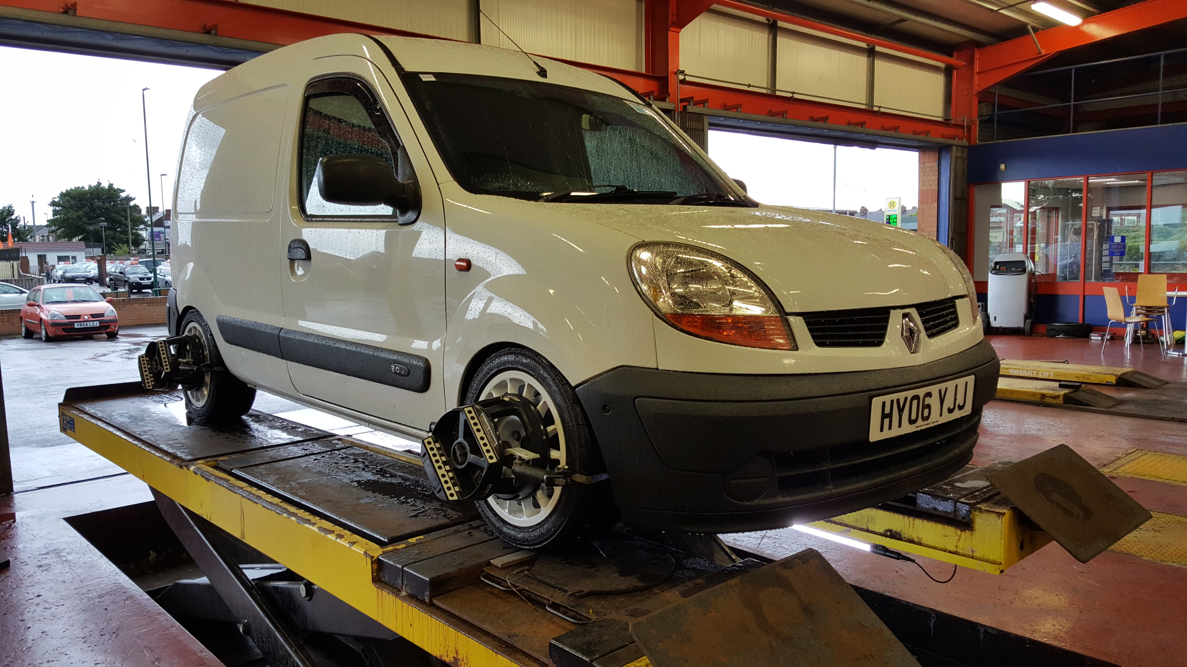

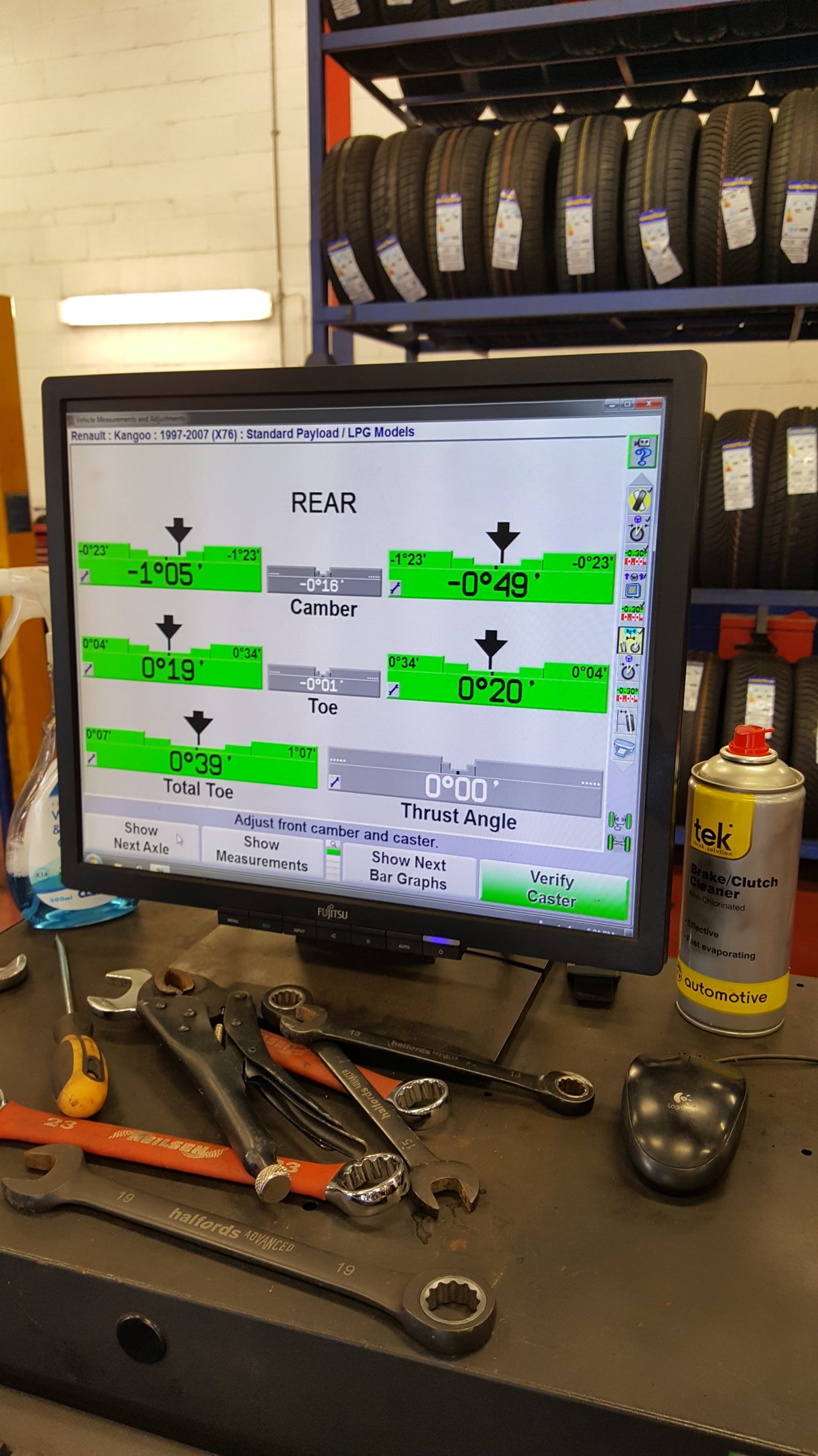

Had it on the local hunter anlignment to check the geo and it was out as expected. Camber was out on passenger side so took home to make adjustments and back in on Friday. Should still be on target for ready to roll this weekend

As in previous post i had issues with the camber up front. I set it myself last year by elongating the top strut holes on the shocker with a carbide burr (oldskool way same as the gt turbo cup racers done it).
When i set it last year i done some maths and worked out how much the holes needed to be elongated by to give -2.5deg negative and used a template to suit. When the bolts were fully back in the slot the drivers side was -2.5deg and passenger side was -2.2 deg which was deemed close enough as im no race driver.
So had the strut to hub bolts undone when changing gearbox and passenger side was not fully home in the slot when refitting which made the camber miles out -1.3deg on passenger side and -2.5deg. One of my good mates can whack it on the hunter anlignment to set the toe but i have to set camber first as its just a quick blast.
So last night i undone strut bolts and the strut moved back to the mark on passenger side which would have given me -2.2deg again but i thought it was the ideal time to sort it to match drivers side.

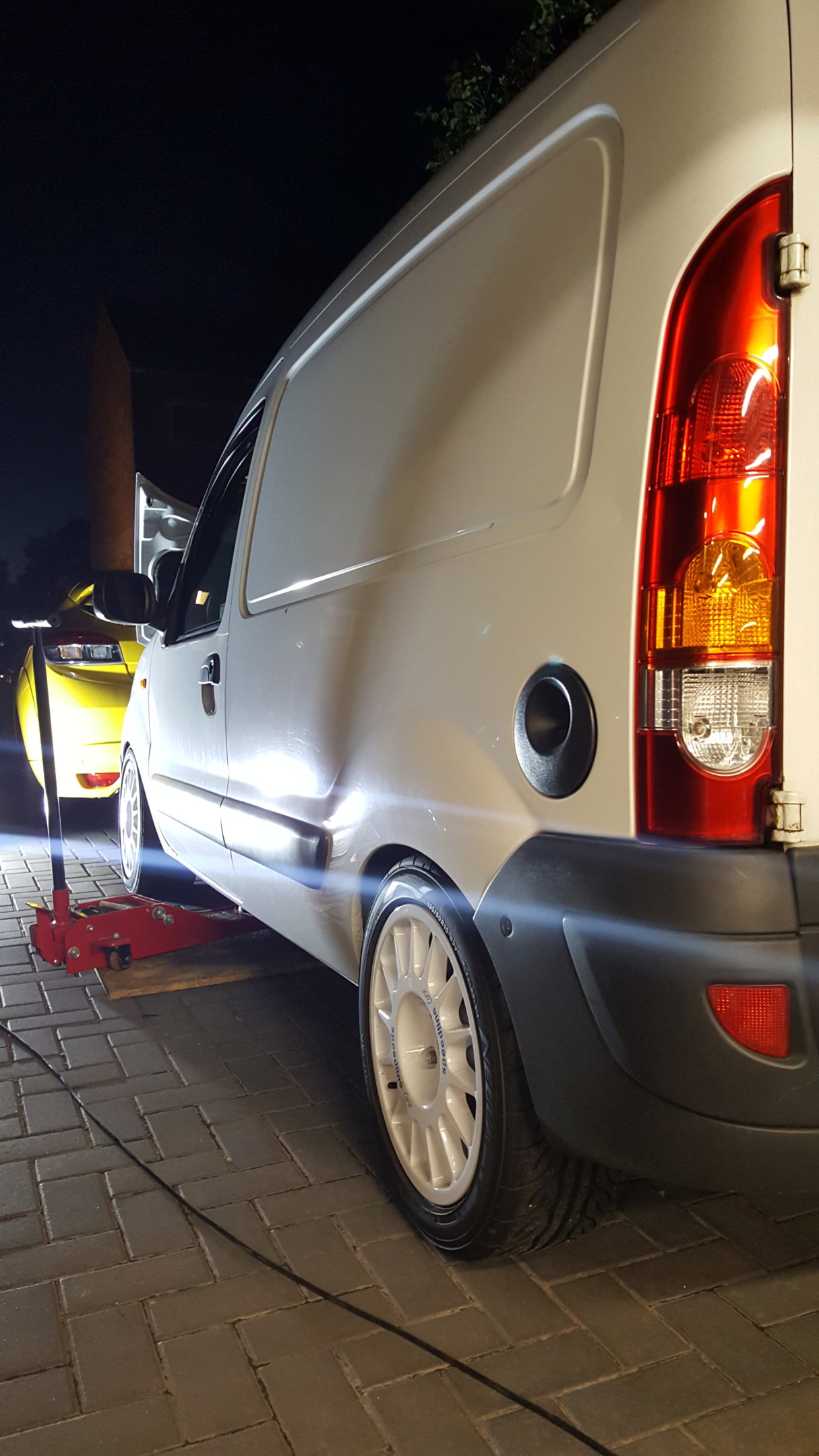

Late night working under my led floodlight, 10pm after gym - 30 mins job done and checked with level/steel rule
Back on the hunter today. Taped spokes on wheels to save any marks. A bit anal maybe but want to keep then in decent nick. Looked mad when driving apparantly lol
Camber pretty much knacker each side now so pleased with that. 10 mins of toe out overall, works great for fast road/occasional track use.
Rear looks half decent too, camber a bit out but non adjustable so nothing can be done unless the stubs are chopped off and changed to clio setup. Drives absolutely bang on now best its ever been since ive owned it.

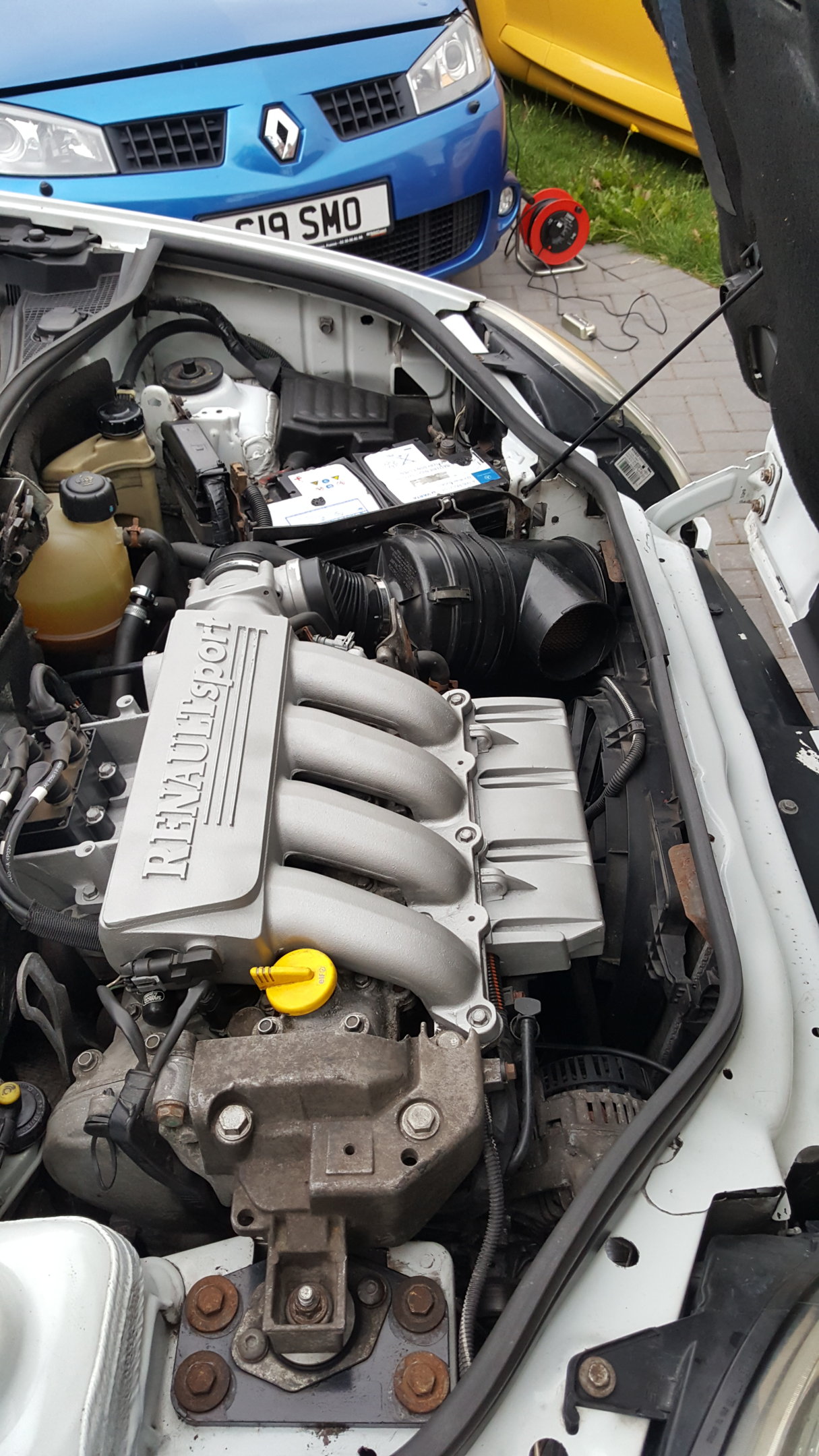

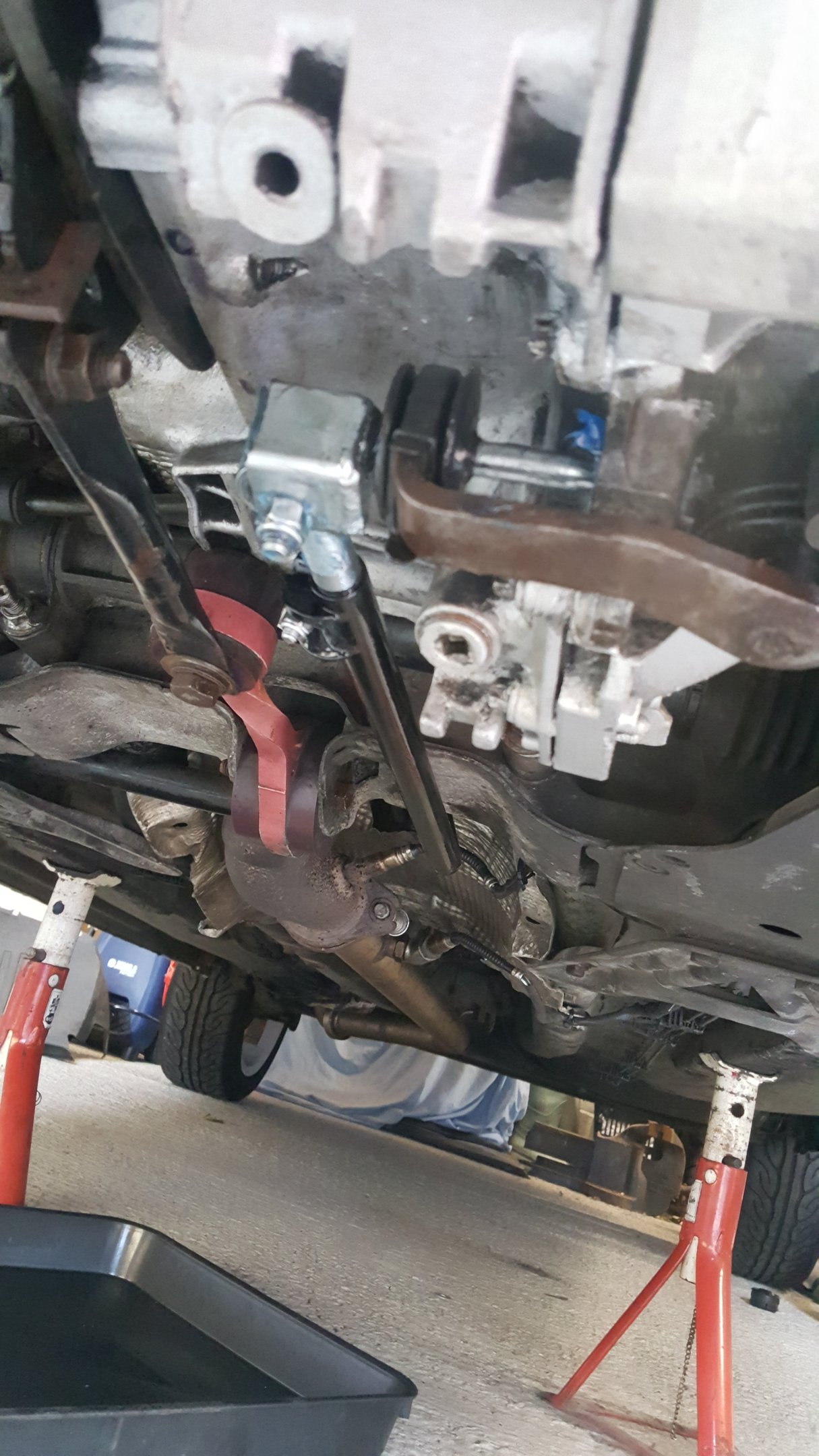

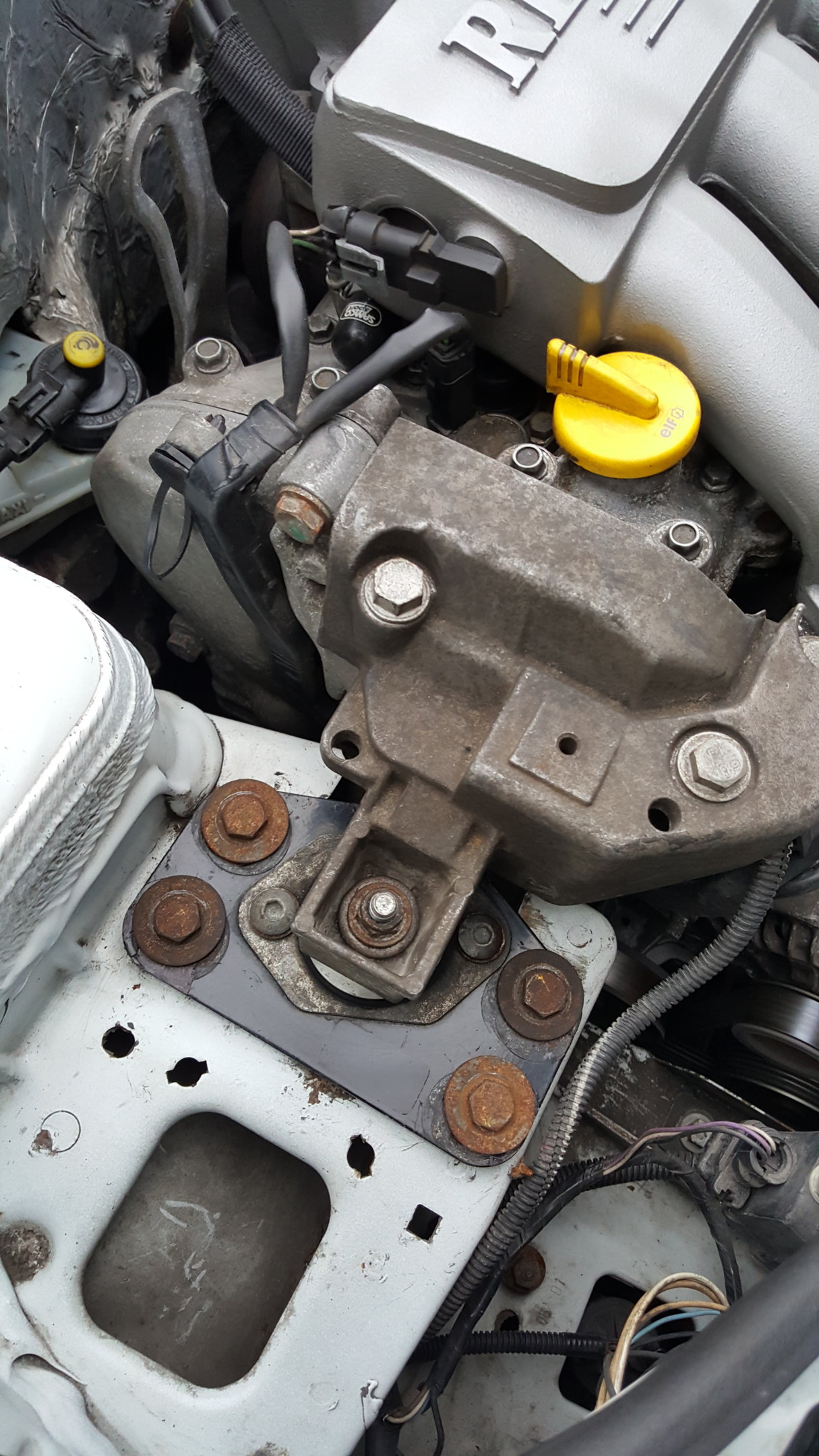

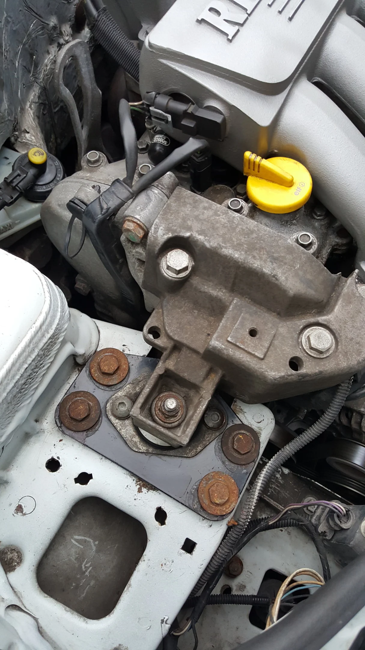

Vibratechnics engine and gearbox mounts on, excuse the rusty bolts did not have time to tart up

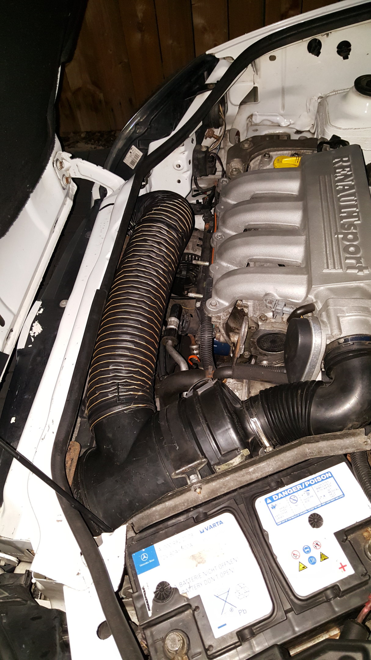

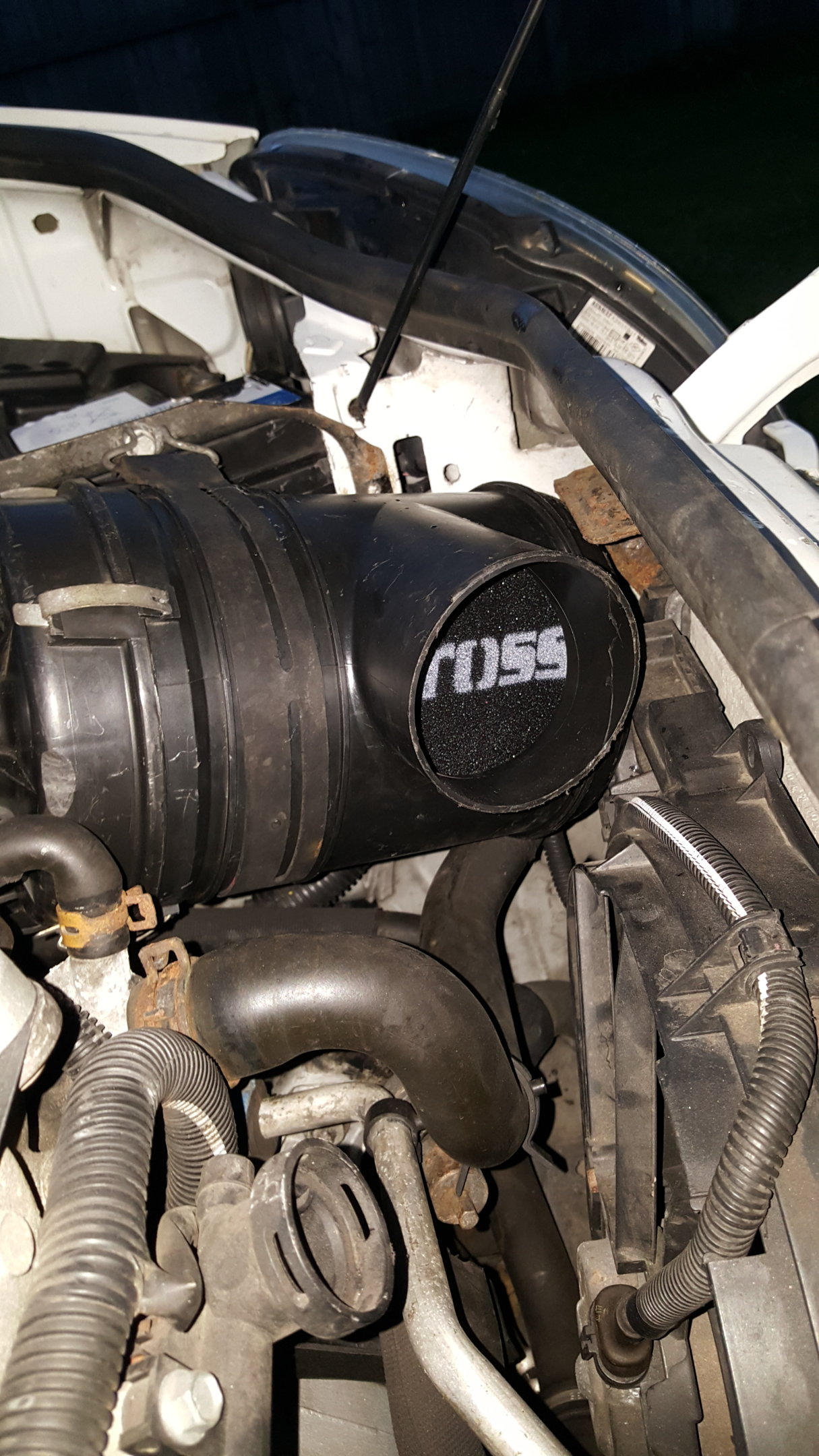

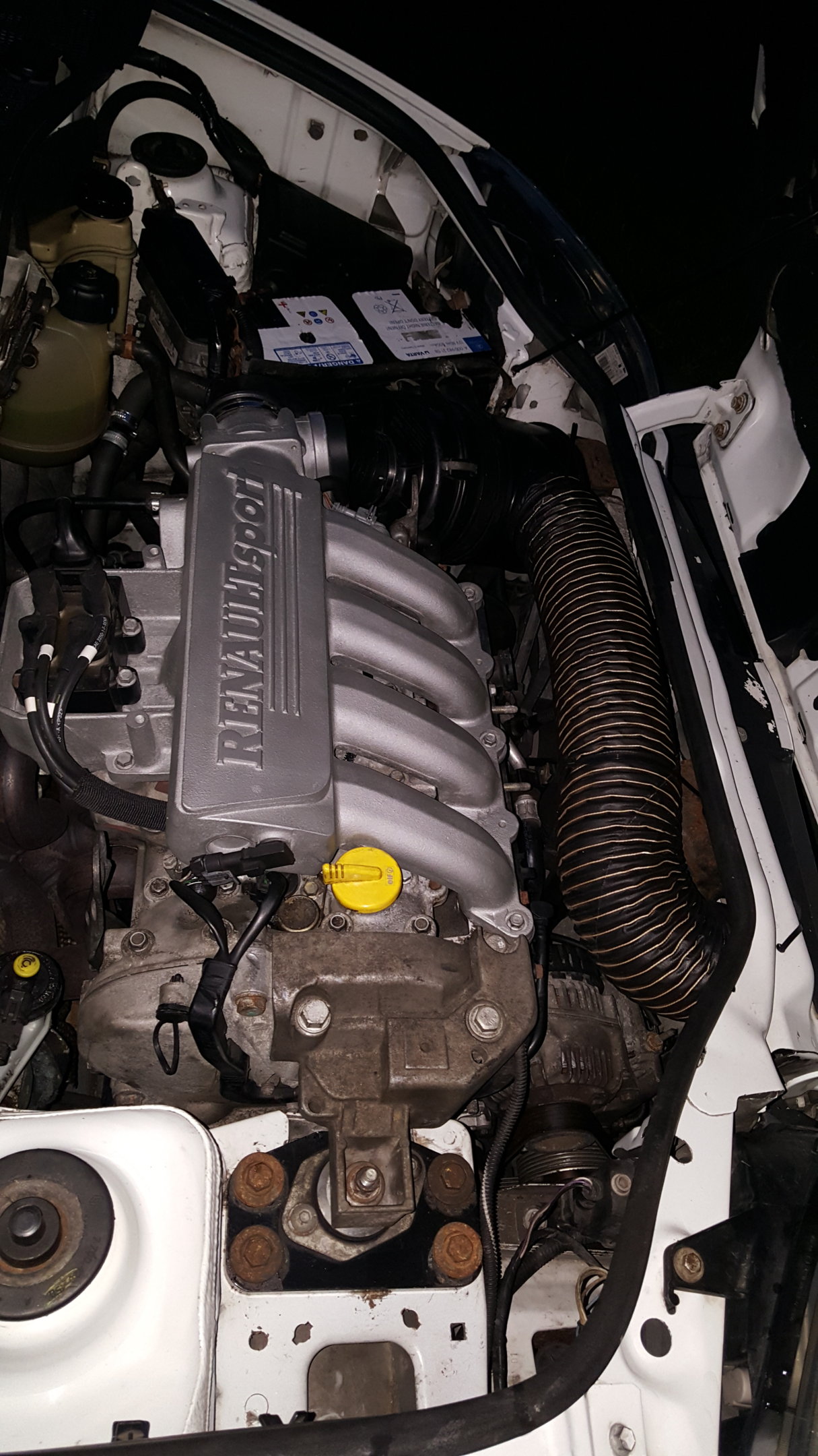

Espace V6 airbox on. Tight as feck to get in even with ph1 airbox pipe ! Just need to connect a cold air feed to it - @Ricardos has kindly sent me some over so job to do this week. Would have had the inlet facing the passenger side but due to the massive battery fitted no chance ! Will run caf in front of inlet to drivers side grill.

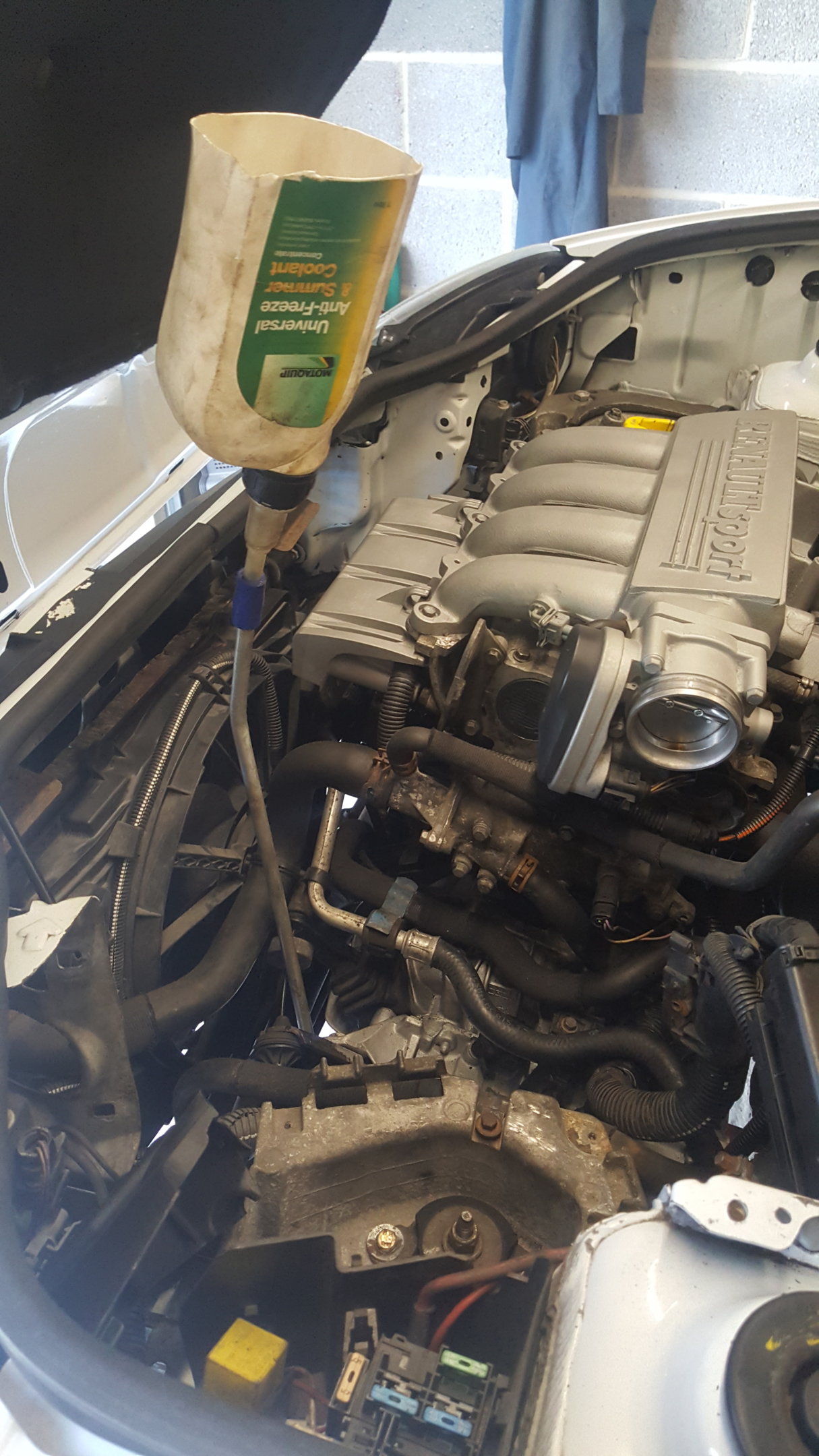

New kunifer brake pipe and more Motul rbf600 fluid and we are back up and running. Test drive lastnight on shopping run brakes feel great.

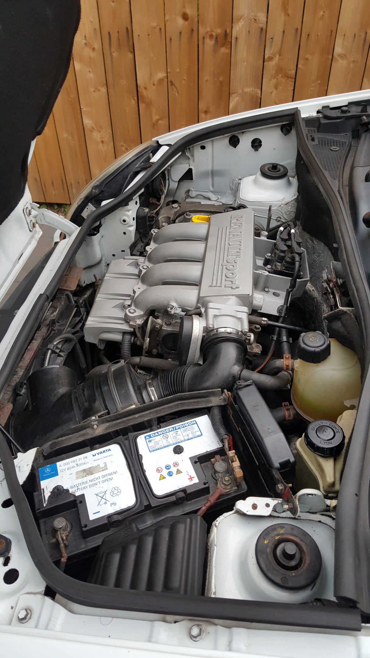

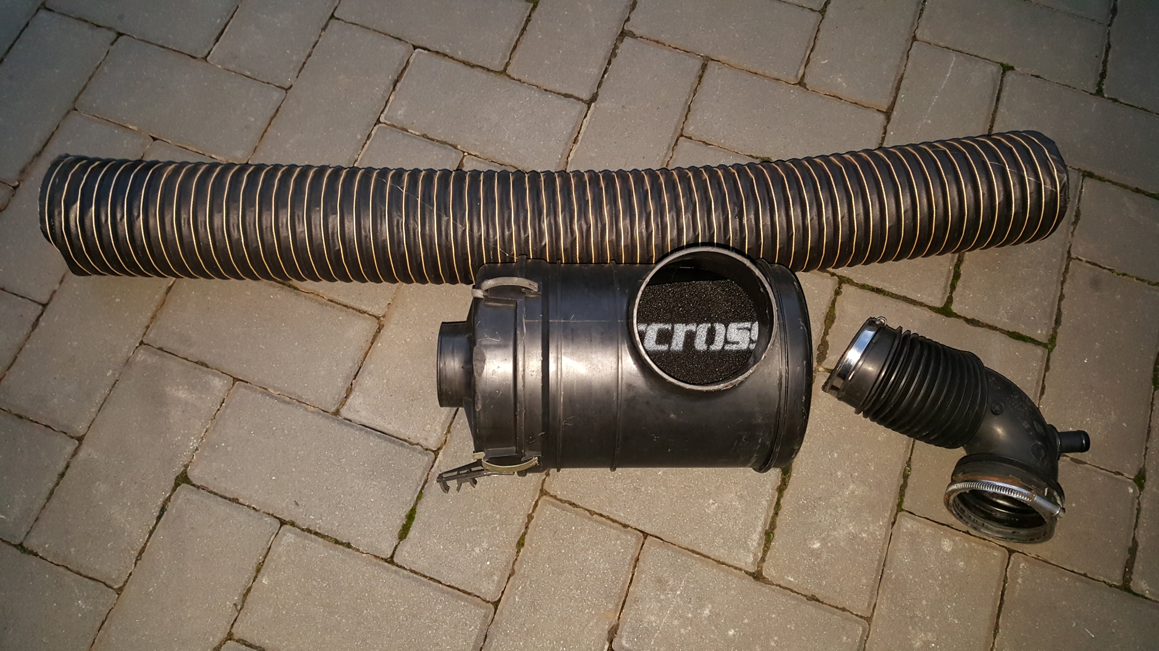

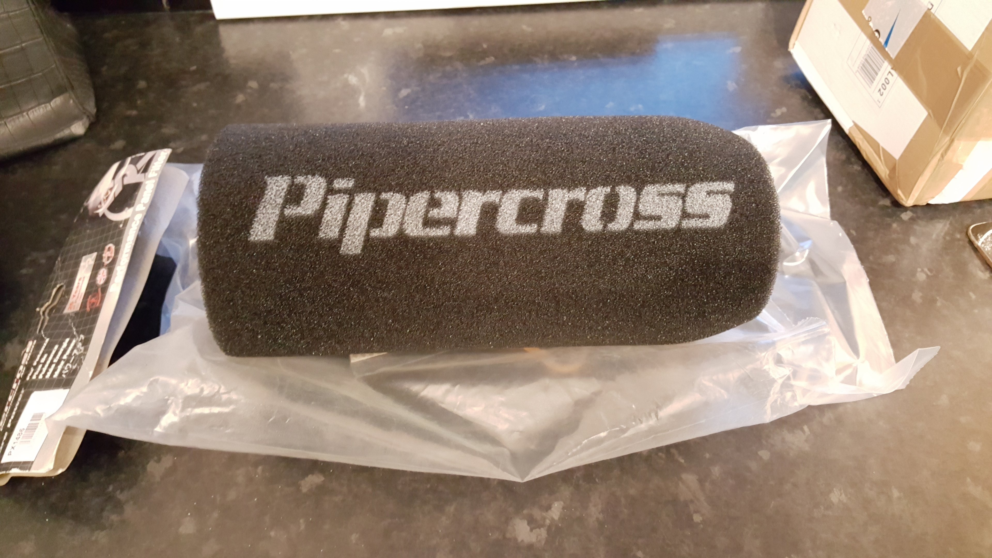

Bought a bargain pipercross panel filter for £18 new off ebay and fitted the cold air feed to the airbox tonight. I would have routed feed behind battery but have this daft big merc diesel battery on which is fine so refuse to replace it until its fecked. Cant see the cold air feed length making much difference as its 105mm and no restrictions. Quick wash and its ready to go roll on Sat !

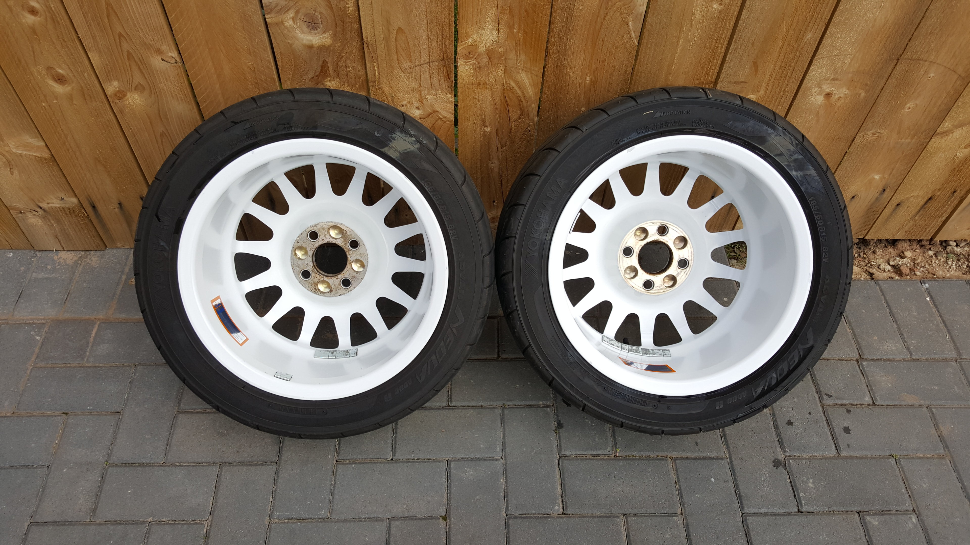

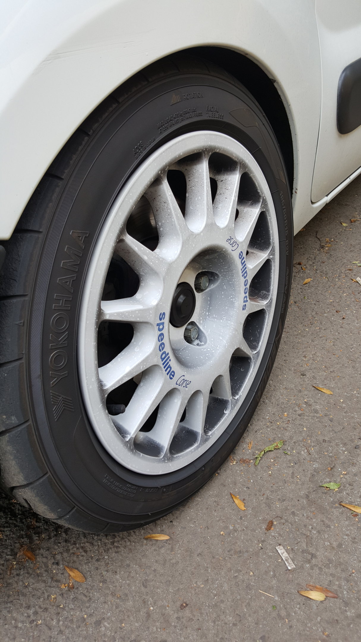

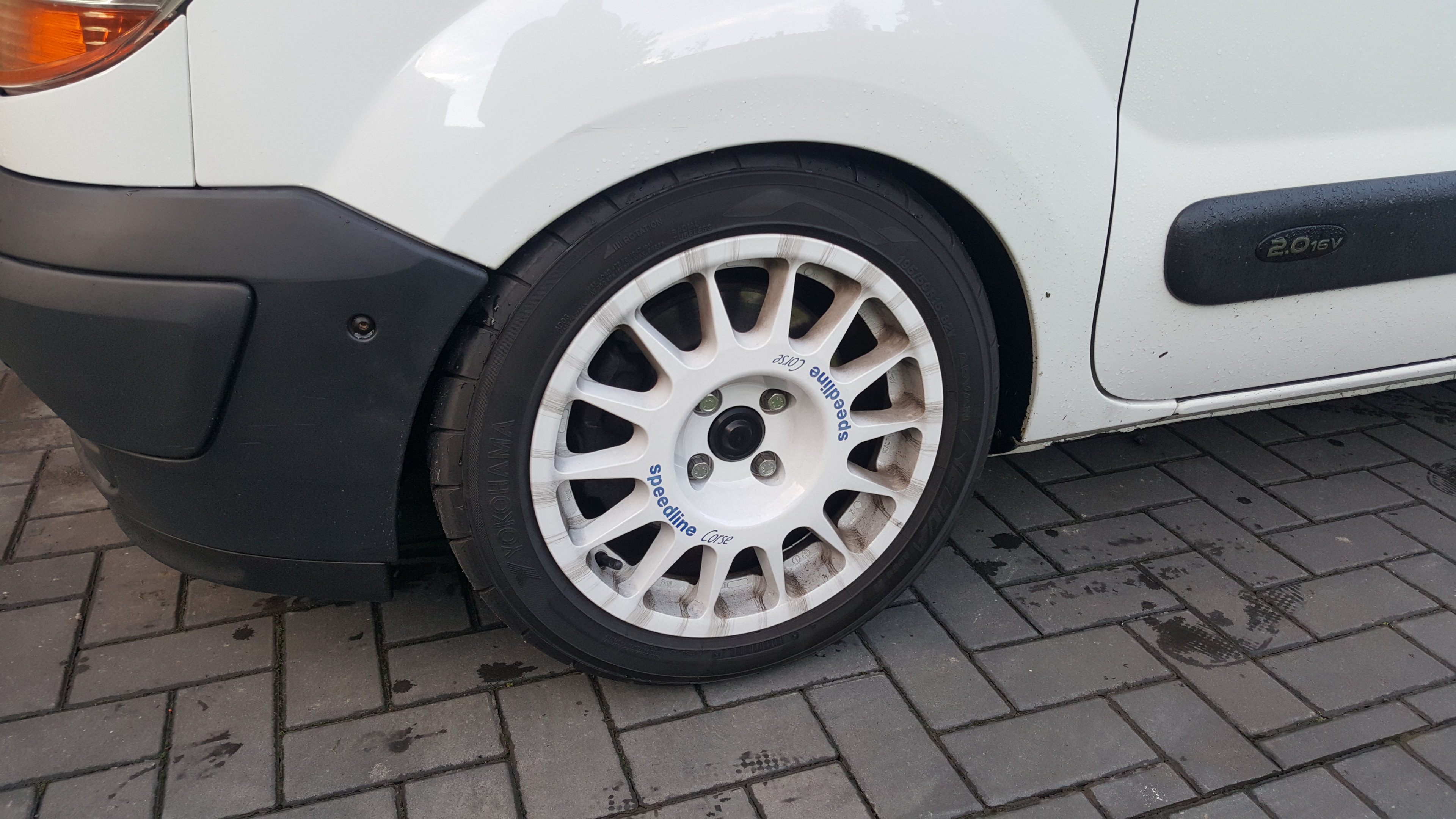

Front wheels

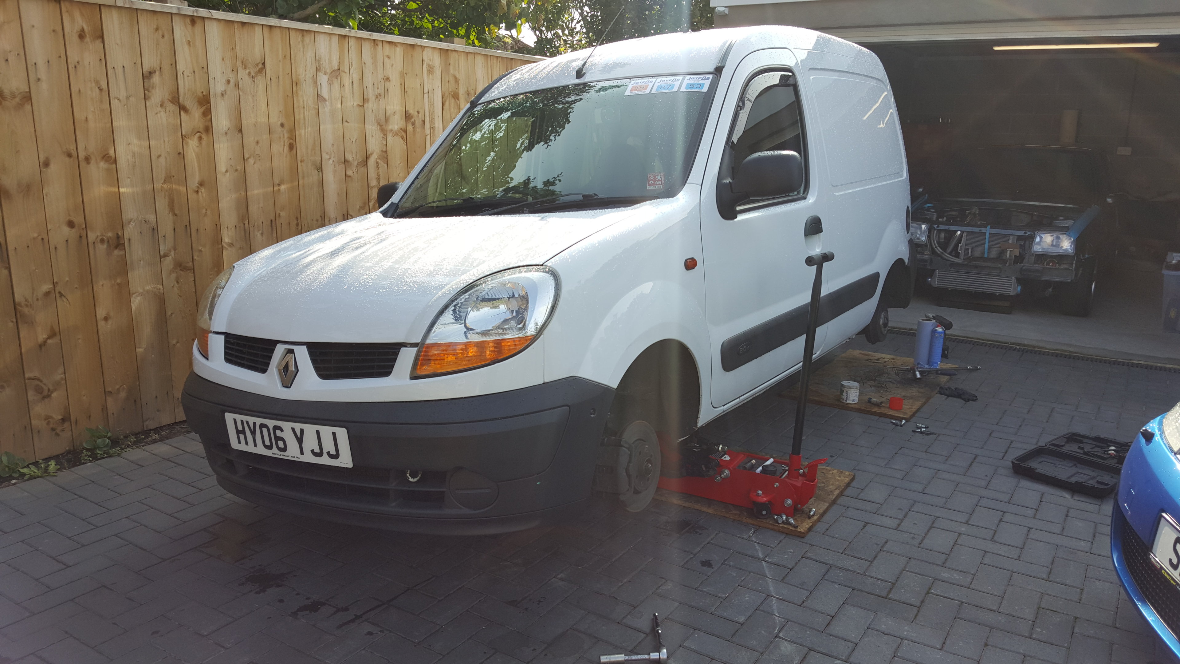

Brake pedal had a lot of travel and handbrake had a lot of clicks so whipped drums off and reset the crappy self adjusters and checked shoes. Quite a bit of meat has worn off the shoes so adjusted the bar on the rear compensator. Not really touched the compensator bar as i could never get the rear wheels to lock up under braking but still far too much bias to the rear as compensator was always pulled closed giving full power to the rear drums.
The nut was right to the end of the adjuster due to the amount of lowering so had to chop the spring in half which give me the relevant adjustment. I was tempted to take the bar off fully cup style as i rarely carry load in the back and its always light or fix the compensator position with threaded bar. Im going to pop it on the brake rollers soon and check out what the braking force is like now its adjusted. Still it will be upgraded to rear discs as soon as money allows.

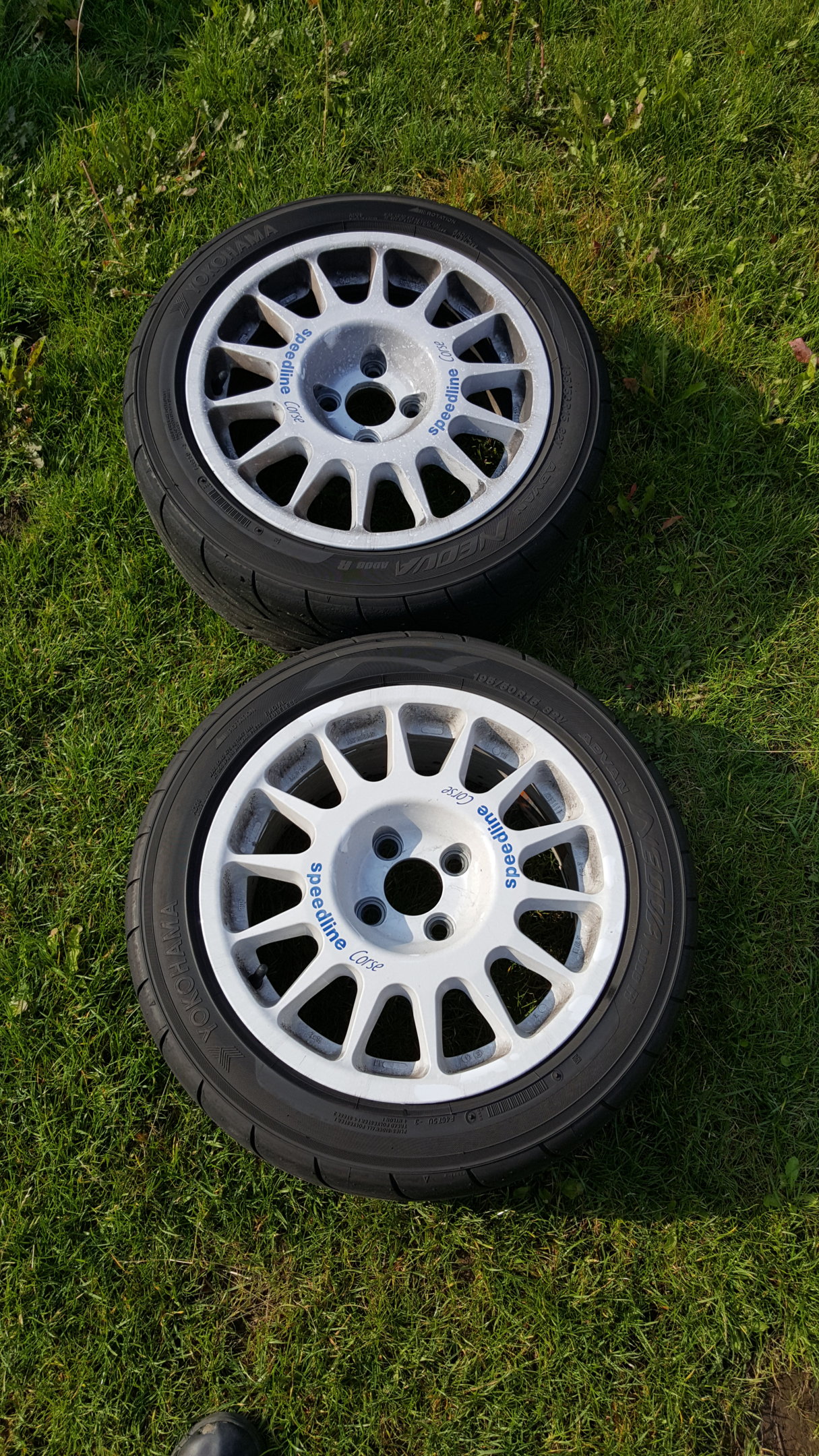

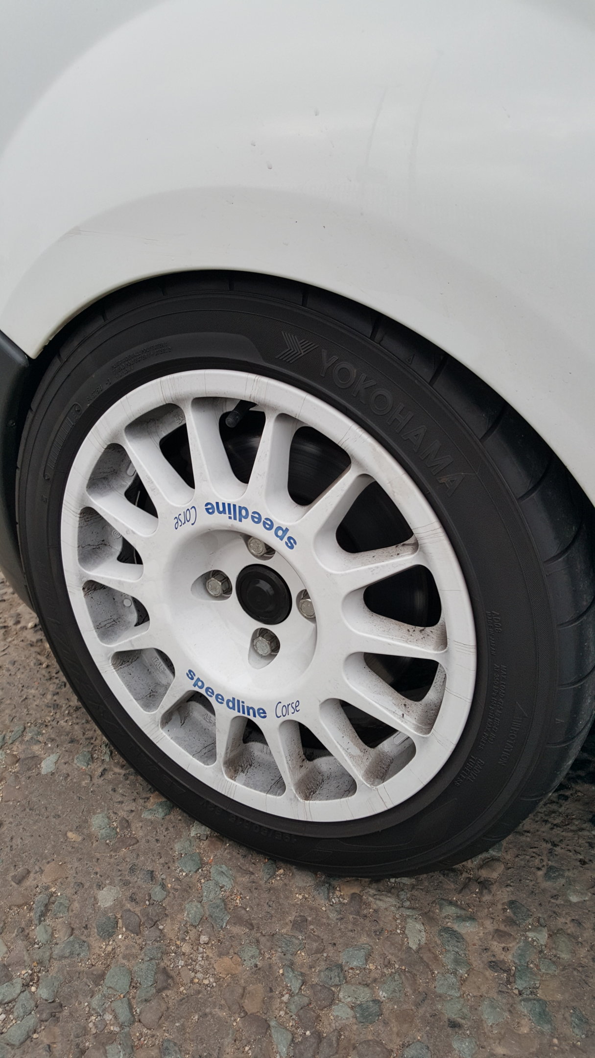

Rear wheels (lower in the pic ) had quite a bit of dust on too which indicated the drums were probably working a bit more than they should

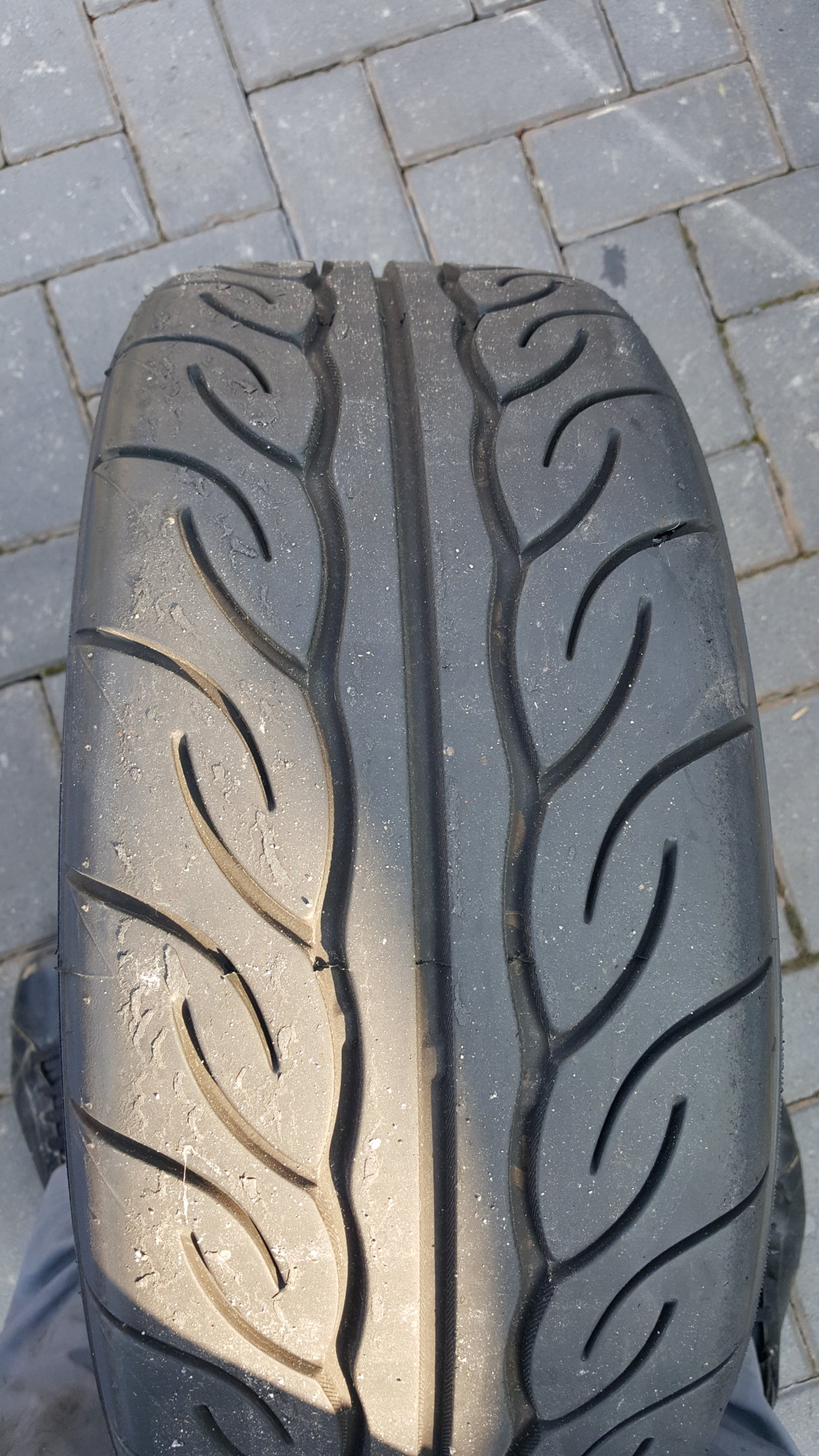

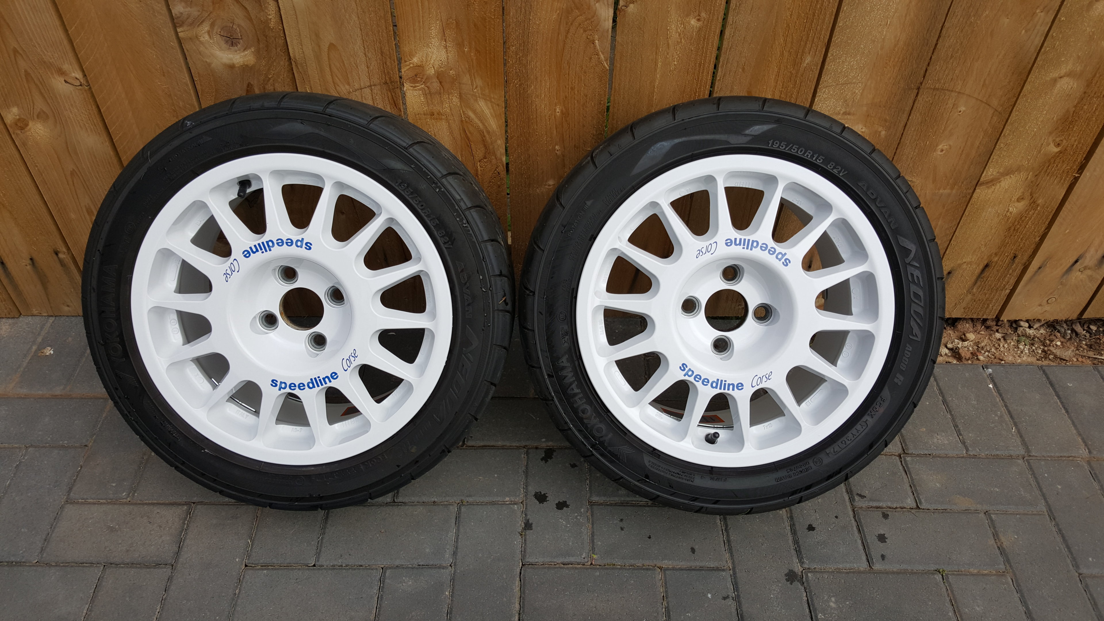

Hardly any wear to the Ad08r's. They had a lot of pickup on after a few runs out on track which worn off on the way home, great for the money
Not impressed with the pbs pads however they still have s**t loads of meat left on them and i fancy doing Croft in October so will give them a 2nd chance. Need to get some road miles on and see if the vibration has gone up front - felt like pad deposits so will see if i can clean that off with a deglaze. Also will add some brake cooling via the front fog blanks and see how it goes ! Thanks for reading
