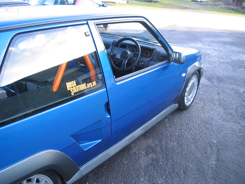

Looks different now I done the following to the rear wheel drive 5 (Sorry for slight Hijack)
I bought it allegedly running but it was incomplete when I picked it up so unable to check so I trusted the seller:(, when I finally got it all together first turn over the 1.7 volvo engine was fecked oil pissing out of the manifold. So I couldn't be arsed to fix the crappy Volvo engine and ditched it and luckily I had a friend whom had a modified golf that was for sale so I bought it and used it as the donor, the engine was a mix of AGU head from the golf and a BAM bottom end from an audi s3 but with a ko3s turbo which was off a mk1 TT, I was also using Adaptronic e420c standalone

Sold it unfinished to get it running it needed some one better at electrics to get it to spark. I sold it 90% done at a massive loss need the space for the new toy :-) sorry its non Renault this time
sorry to post a question here about other car than the Forged Clio, but looking at the door panel of the R5GT, I was wondering what kind of work was done there... it's original like that, or you made some changes James5_GTT?
thanks!
No problem with the off topic post mate. My Clio isn't really worth posting about at the moment. It's just been dumped in one of the garages since we moved and I've not had time to touch it.
Artorius looks like a standard 5gtt door card but re covered with the speaker grille removed. The top part looks recovered also as I think that was bare plastic and the lower pocket removed
