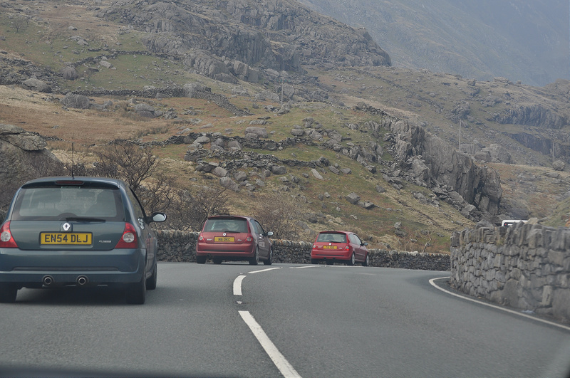

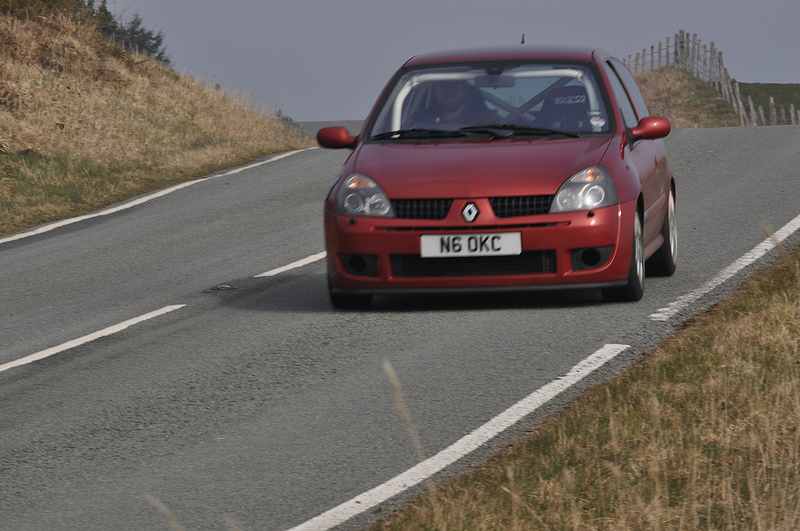

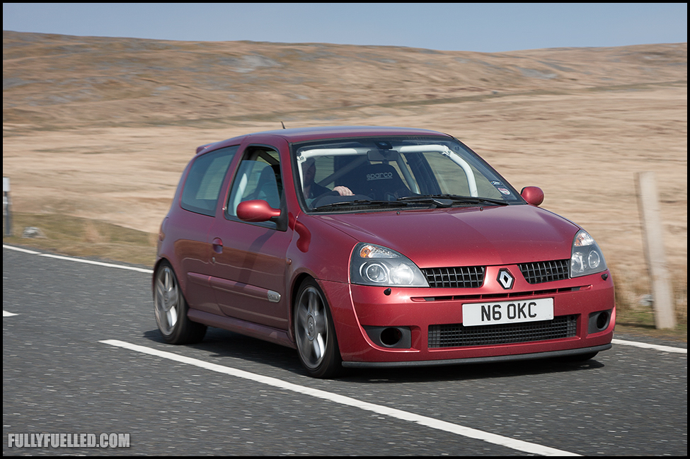

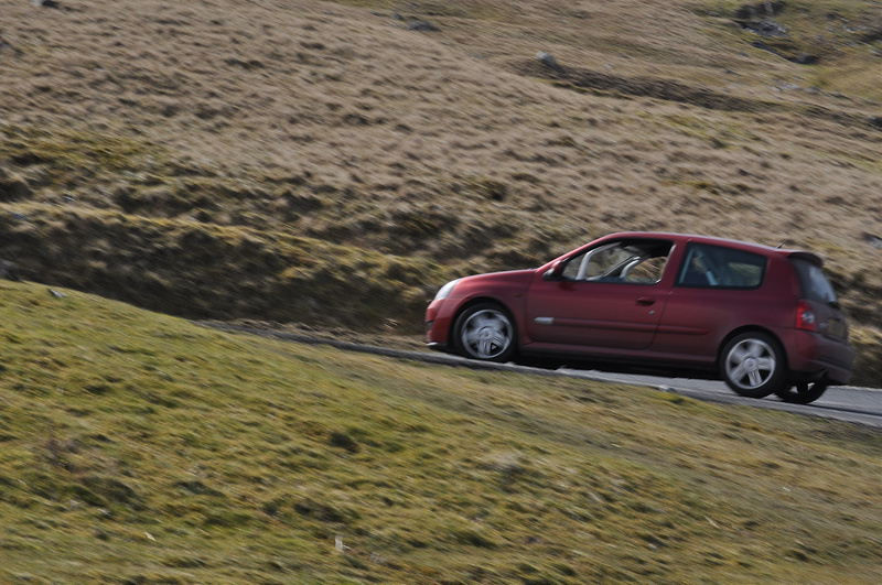

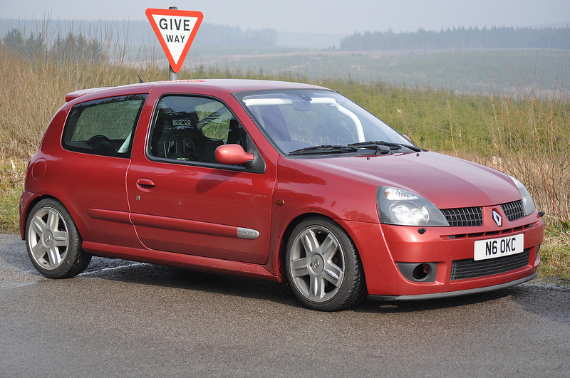

So, the flamer had its 'shake down' test this weekend just gone. 748 miles along some of the best roads the UK (Wales) has to offer. Was a great weekend, with great company and I am pleased to say the car performed perfectly. Made me realise how much I missed it, and why it is worth the pain of engine swaps ;)
Thread is here http://www.cliosport.net/forum/show...eat-engine-and-a-Vee-do-Wales-(Very-pic-heavy) but some photos I have stolen below.
On the return leg on the M4, my bearings started to worsen. Both front ones were advisories on my MOT for play, so they will need sorting. As will the brake imbalance from a sticky rear caliper, and I am changing the DS3000s. They were great when warm, but when cold they didn't inspire confidence and at low speeds this weekend the squealing nearly made me cry like a baby.
A few jobs to do, but nothing major. :)
