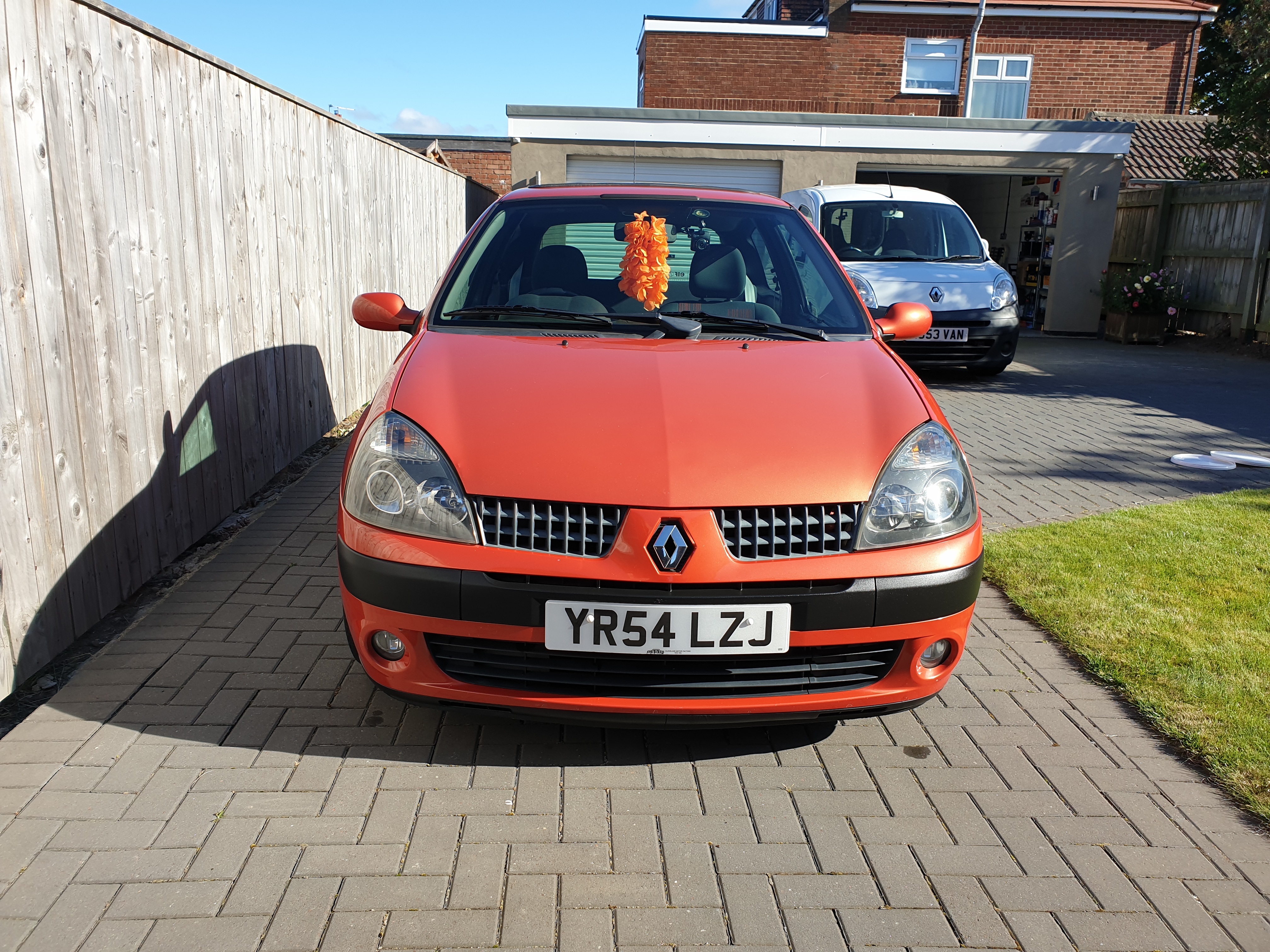

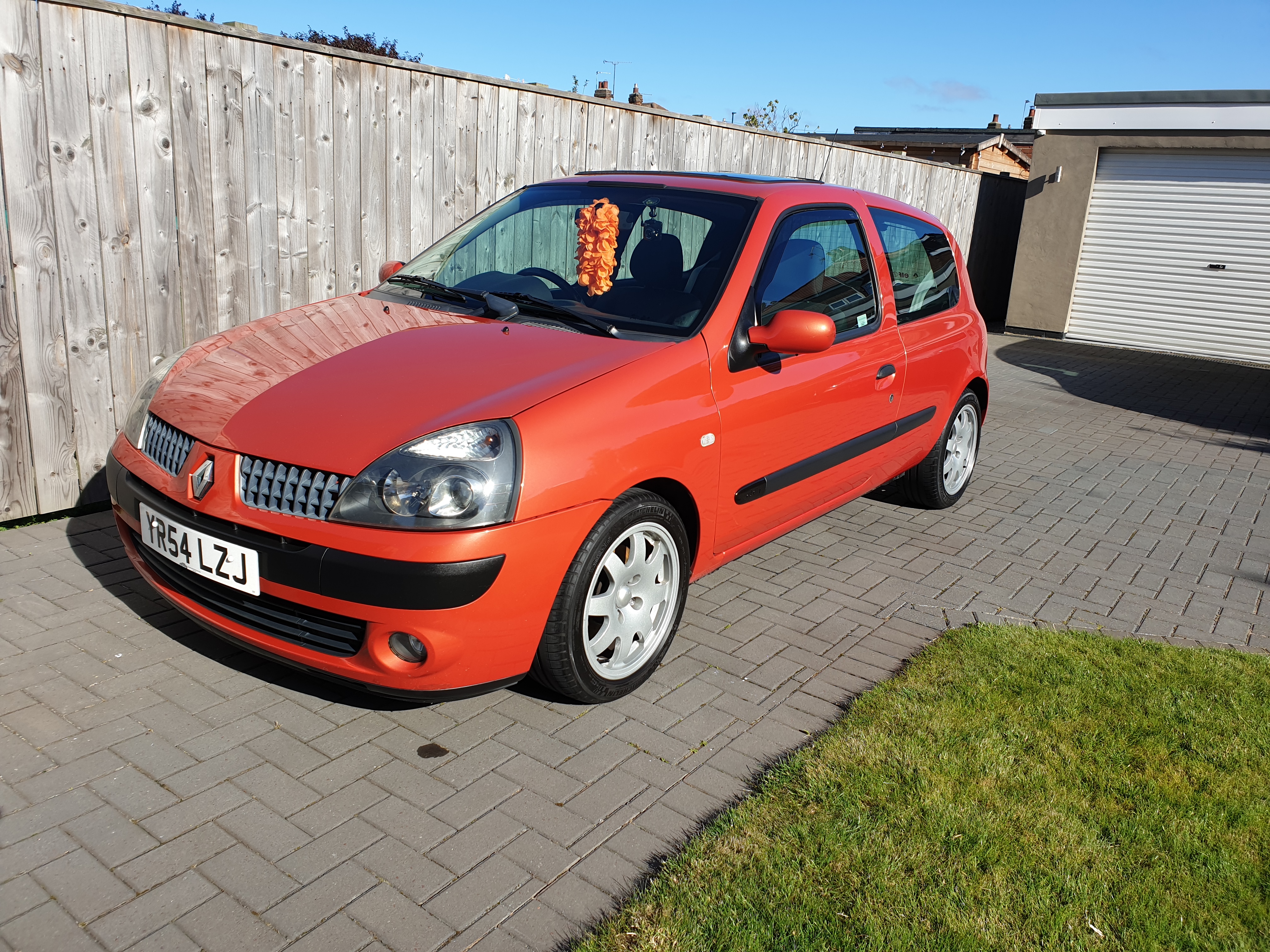

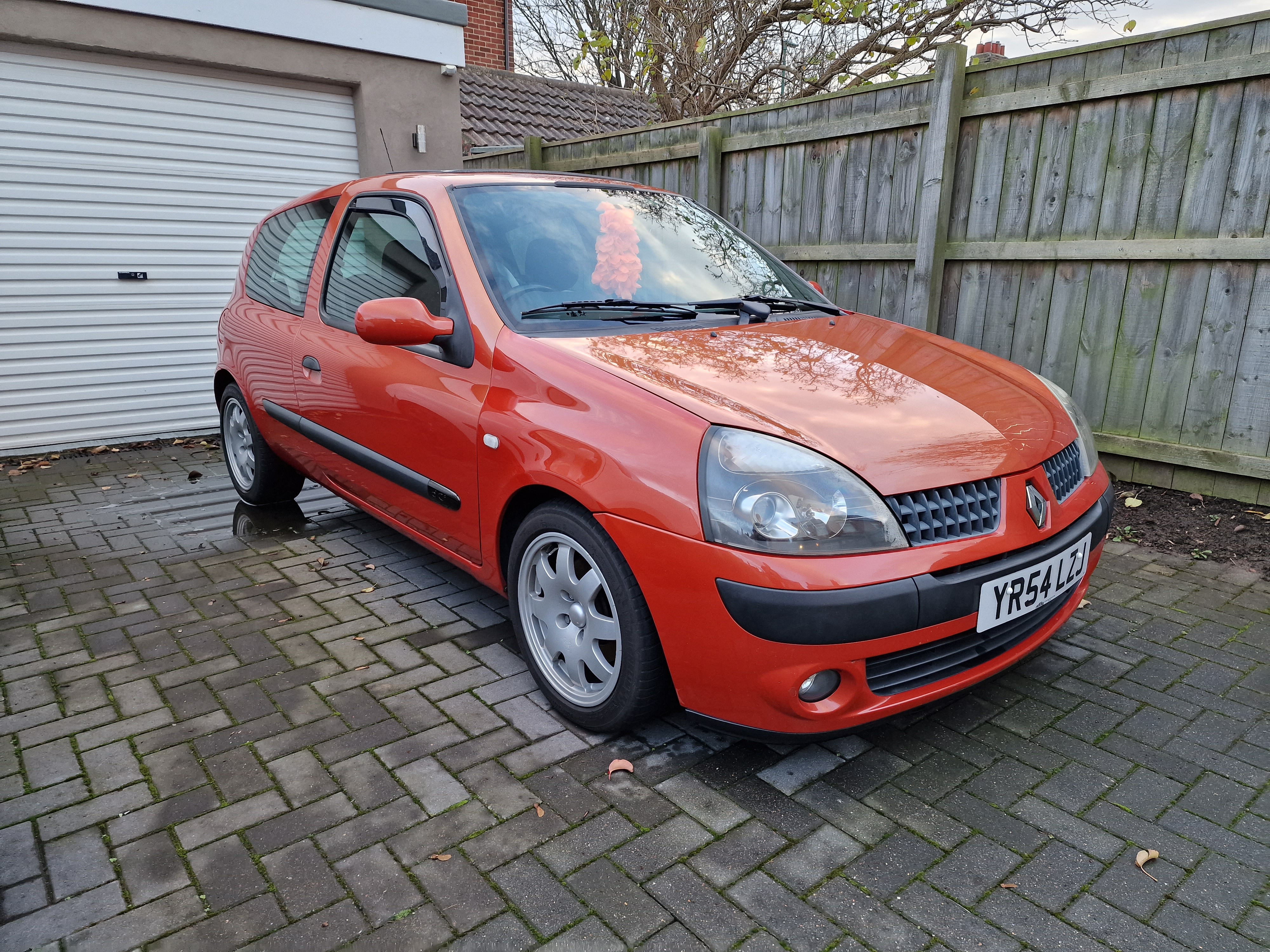

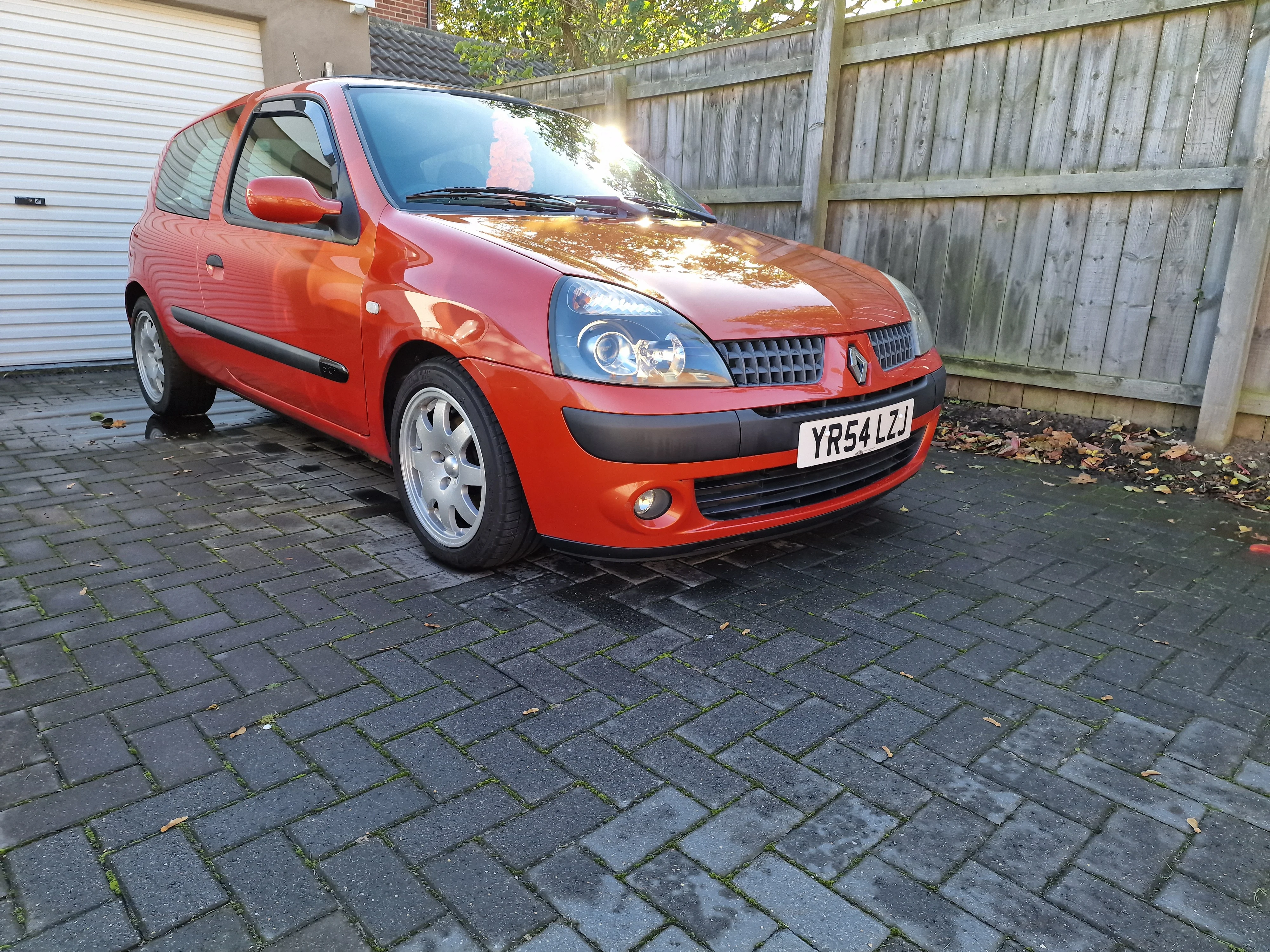

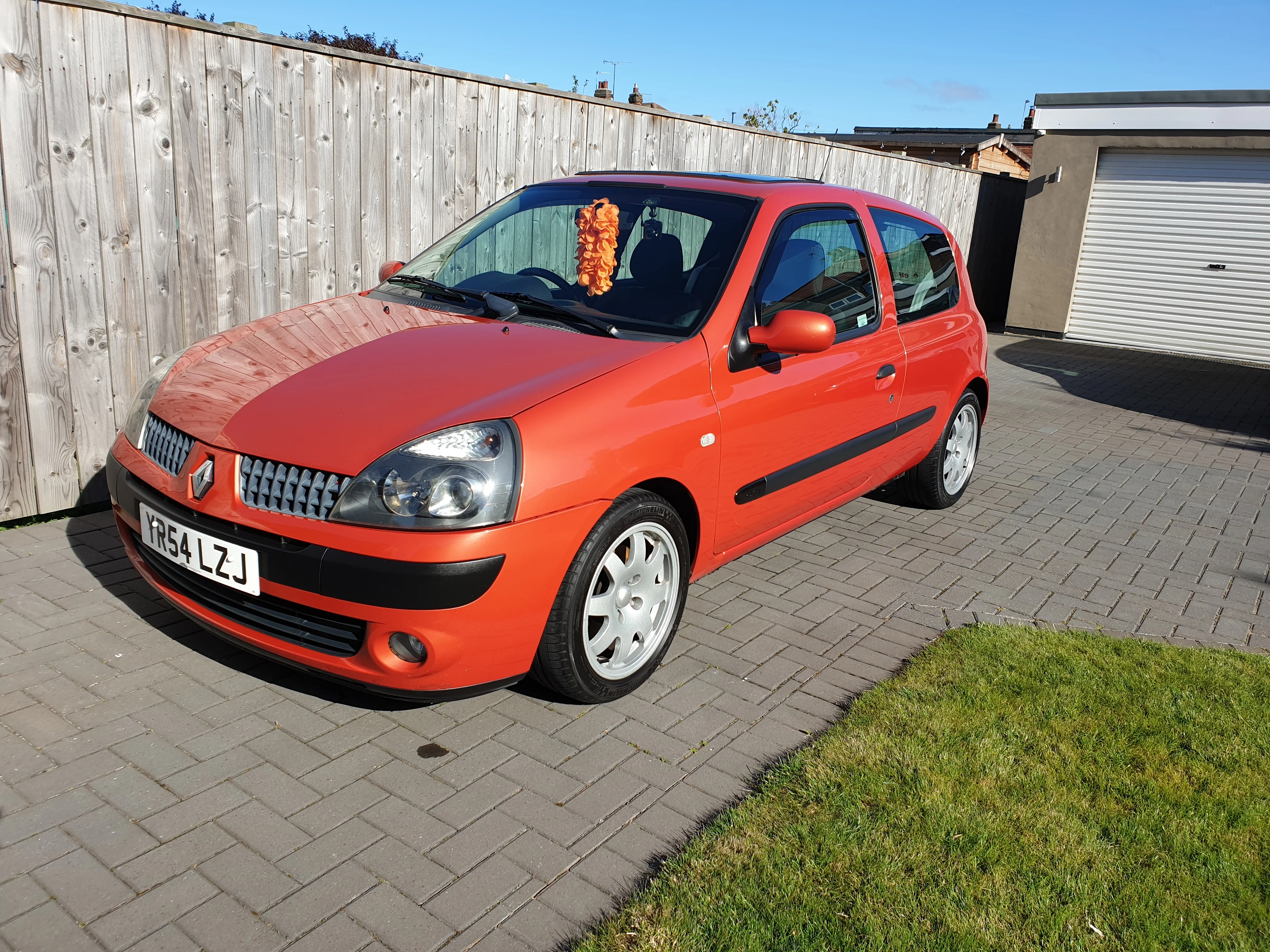

Give the orange dci a good clean up. Its been neglected a bit in the cleaning department recently, been used for tip runs and allsorts so was looking a bit sad.
Headlamps needed a polish as had went yellow, good 2 bucket wash, coat of oldskool collinite 476s wax, AG trim gel and cleaned the glass.
Still looks mega when cleaned up, especially for 157'000 miles and £80 purchase price several years ago. Brilliant little runabout.

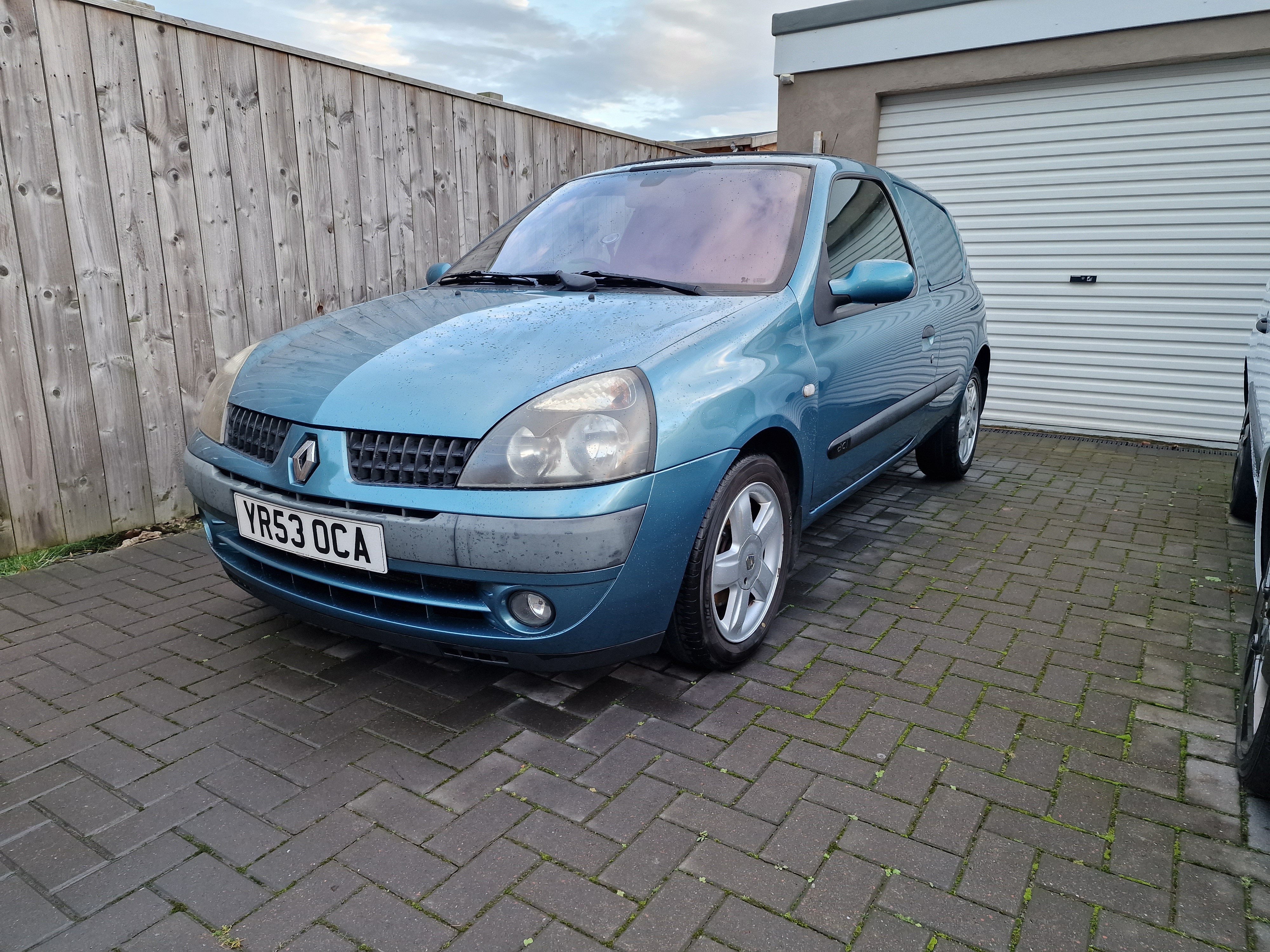

Blue dci due mot this week. Ive given it a pre mot check over and apart from a pinhole in passenger side cv boot it all looks decent and should pass without too much drama.
Done a few long ish runs in it and the mpg is even better on the £25 map. Went to gainsborough to pick up a bottom end for my Kangoo yesterday and trip reported 70.1mpg at 70mph even rising up to 70.3mpg in places as lower speeds in traffic. To get 68+mpg on the stock map had to sit at 55-60mph before. I never reset the mpg so this is average over my local journeys recently too, so cant moan at all!

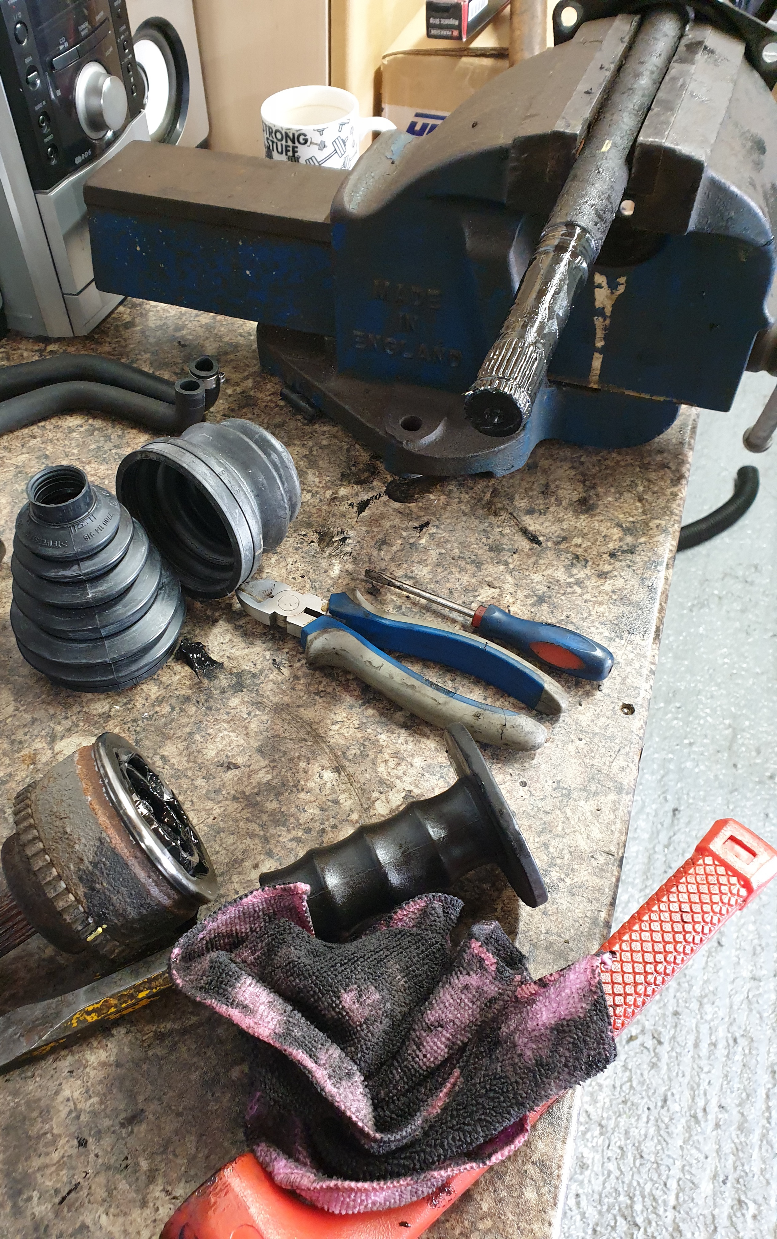

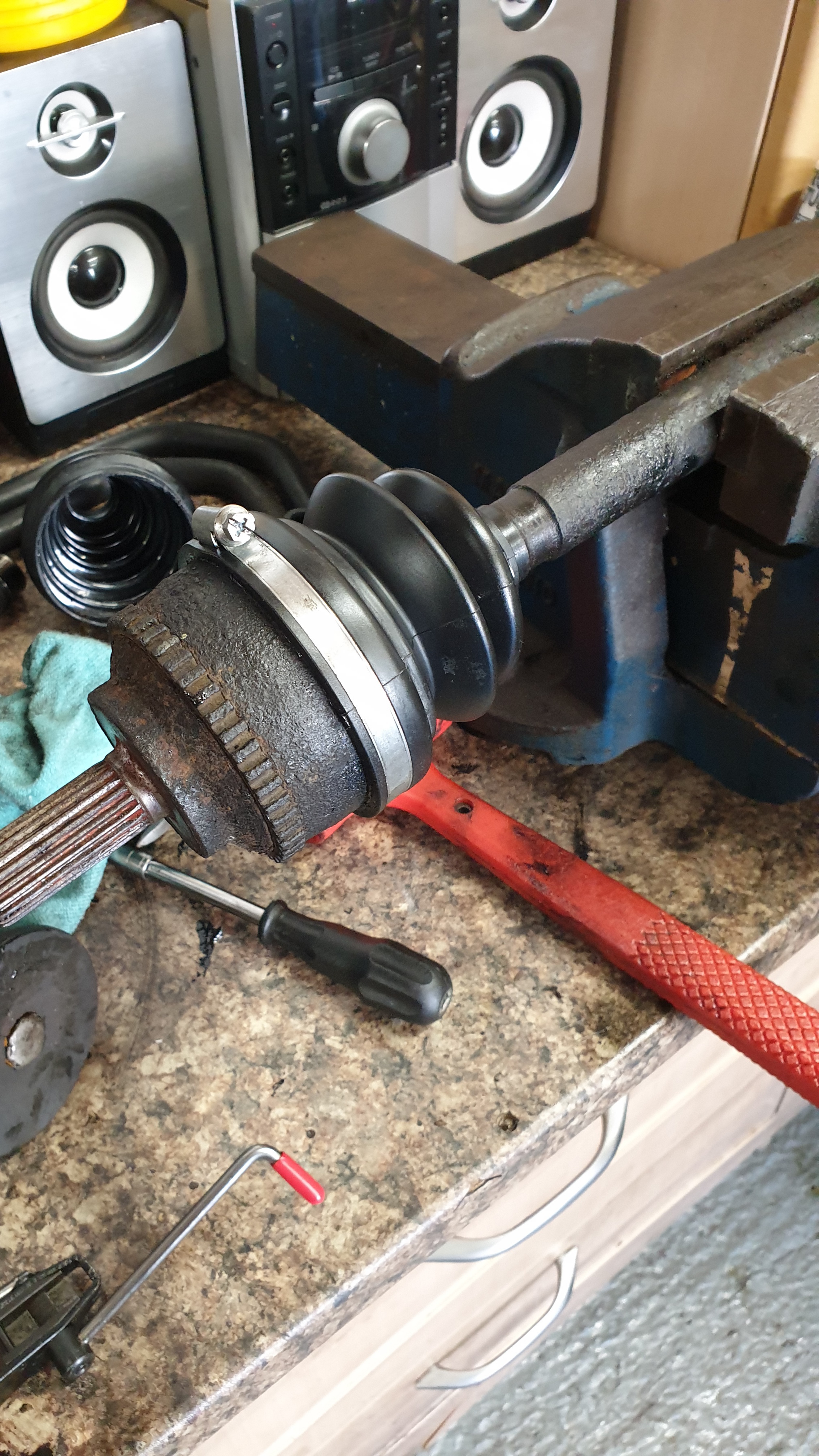

Cv boot done, hour of mess yesterday. Shaft out, good few choice blows to cv with large hammer and cv popped off. Note genuine renault cv boot in the background.
Typically would not fit as aftermarket shaft and slightly bigger outer cv. So had to scrouge round and found a suitable boot in the random shite cupboard which fitted fine. It might be an inner now ive thought about it, but is flexible enough to move ok on full lock and clamped up ok so better than a split one. Its the o/s shaft sand bearing is wet on the inner so ill bang a shaft in soon.

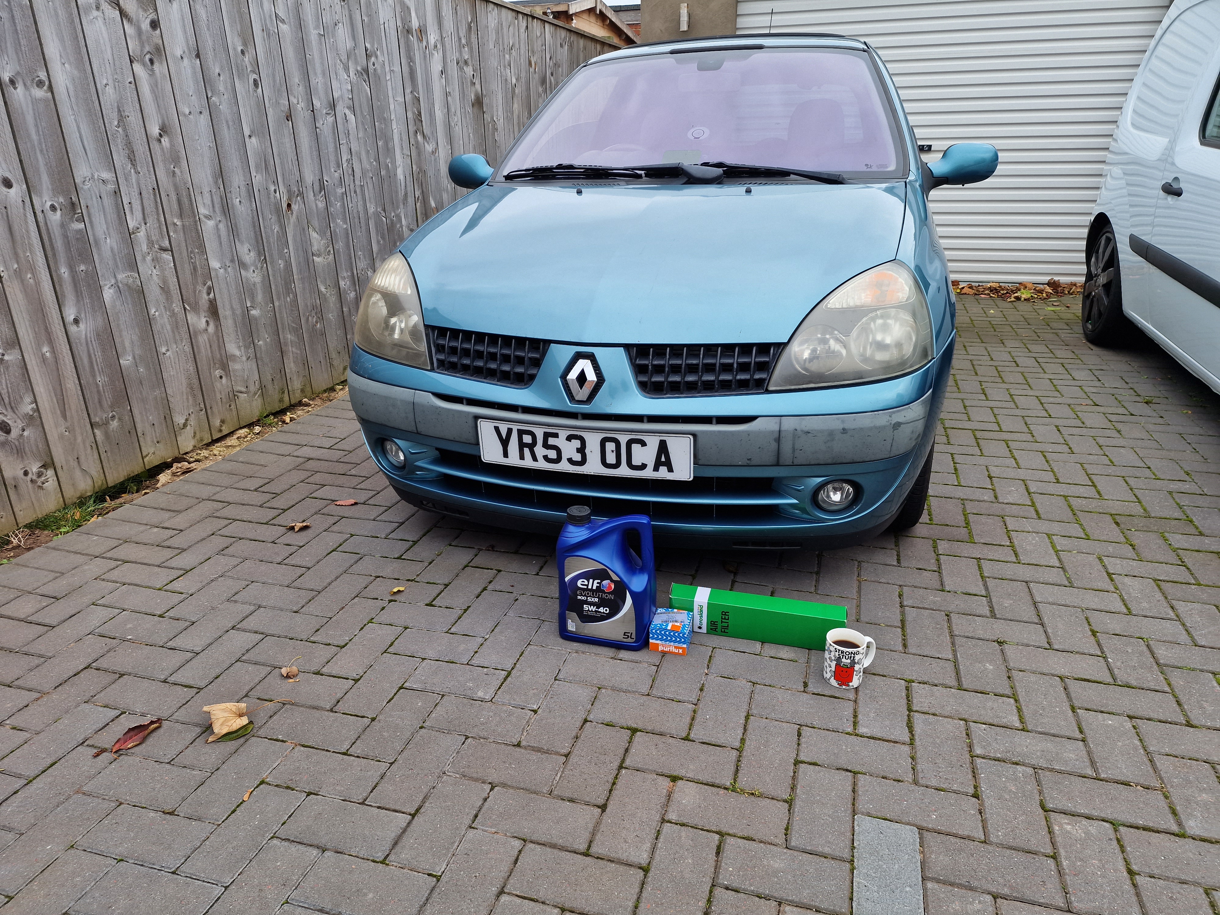

Serviced it. Its covered over 11k since its in situ re ring and still running great. The semi synth oil had been in for 8k and its hardly used any. Changed it over to Elf fully synth 5/40 this time round, new oil and air filter done at 153k.
So easy to service. Its a one cup of coffee job/20 mins max. That should do it until spring/160k.

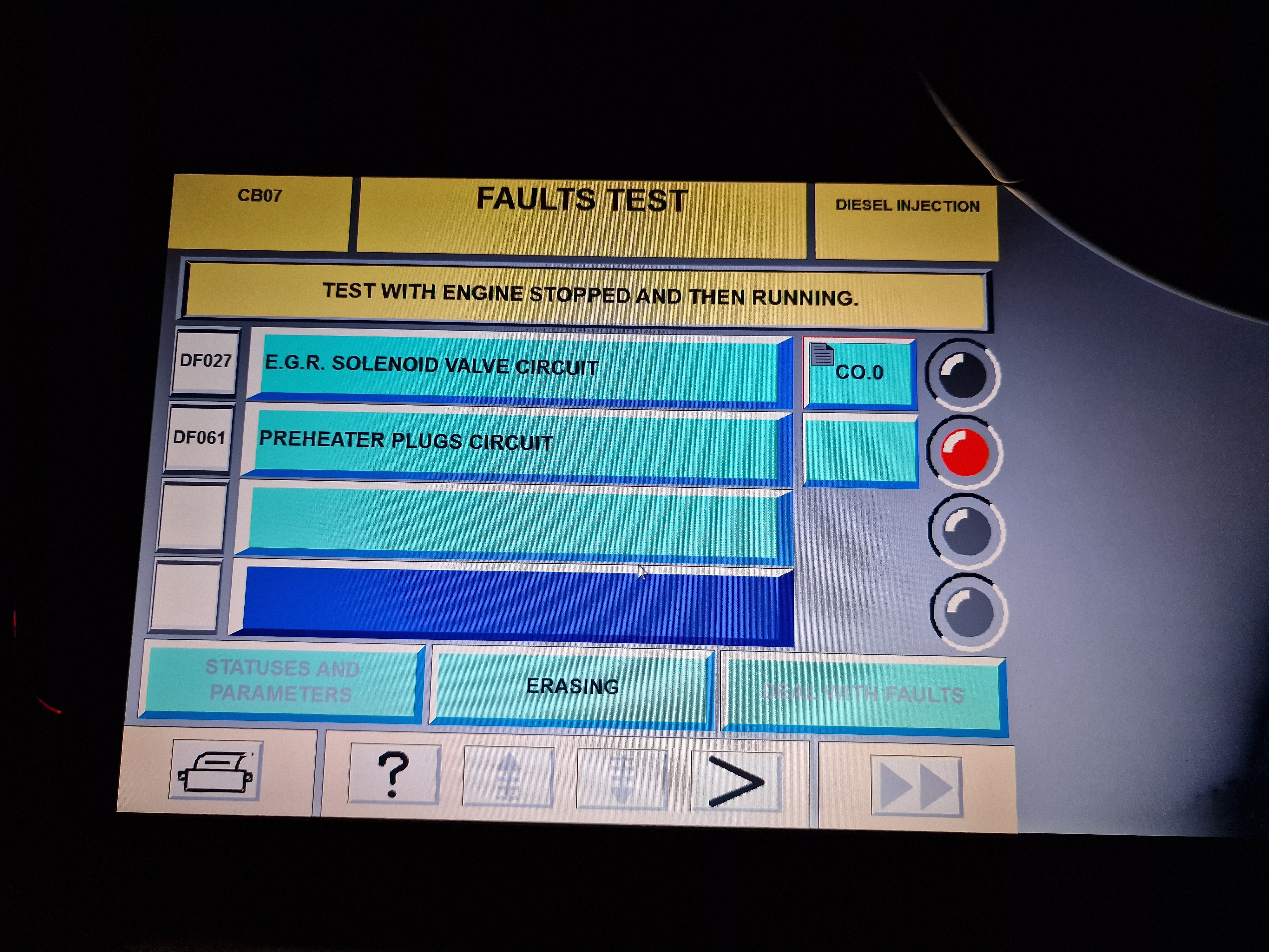

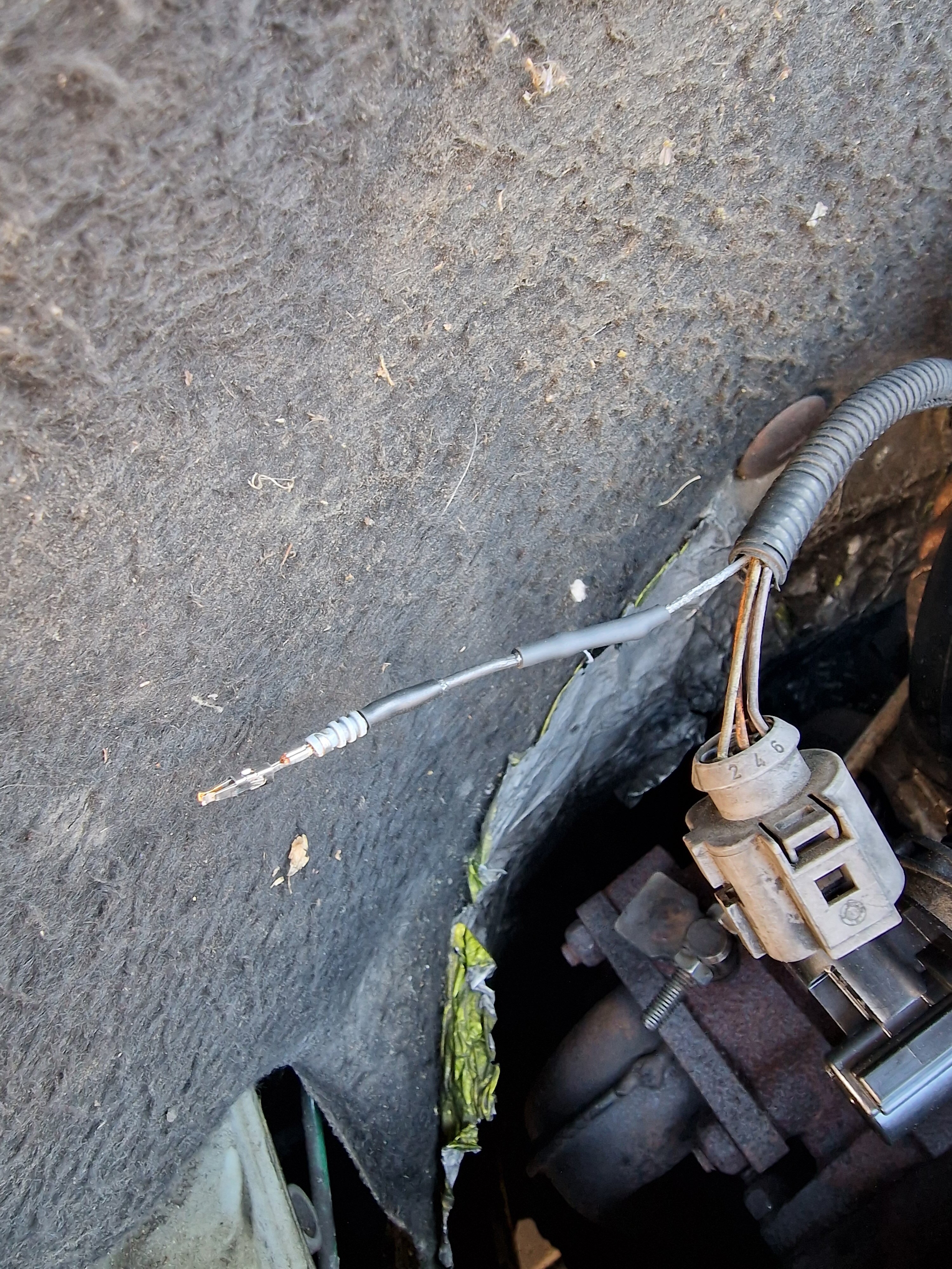

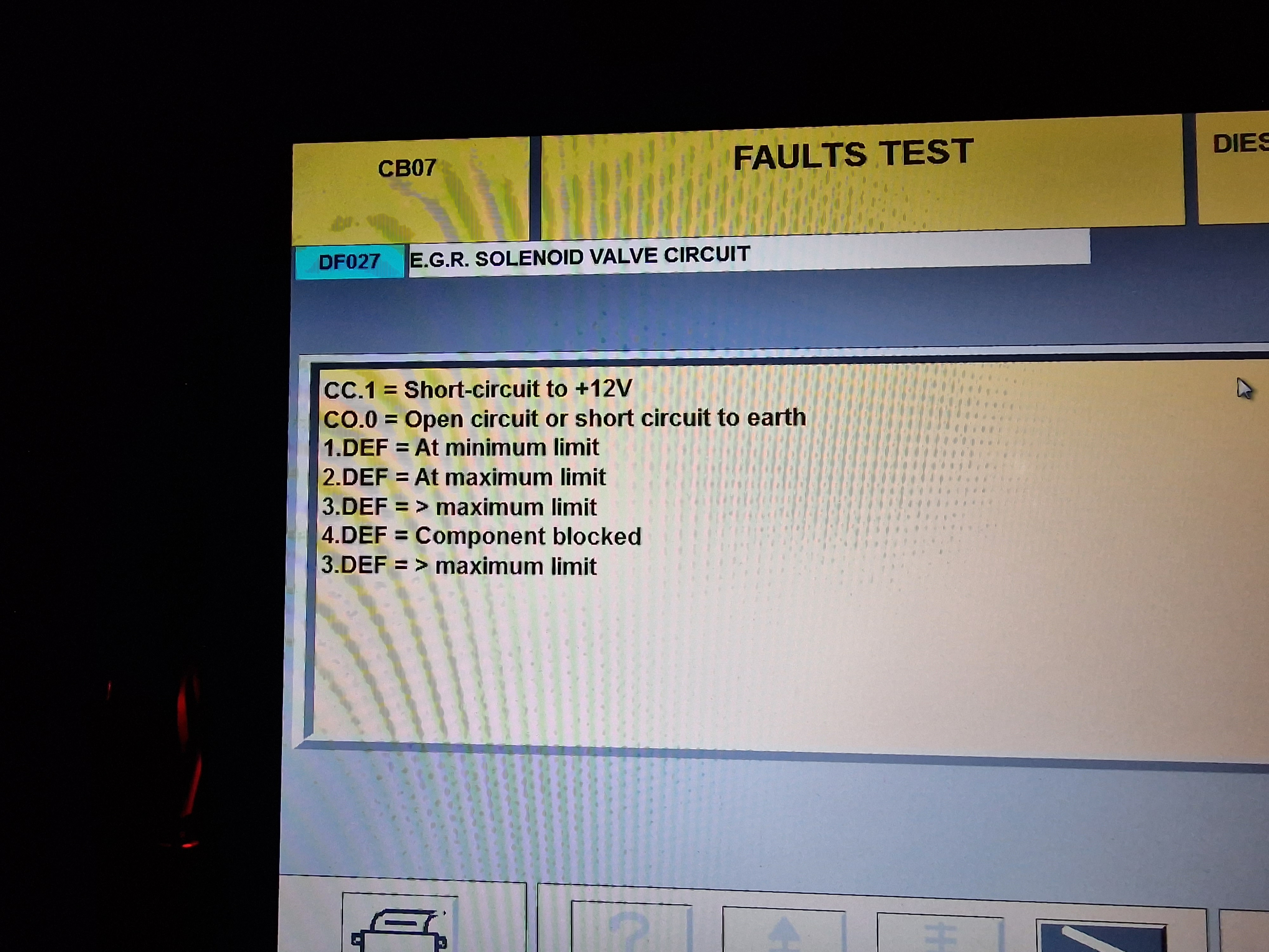

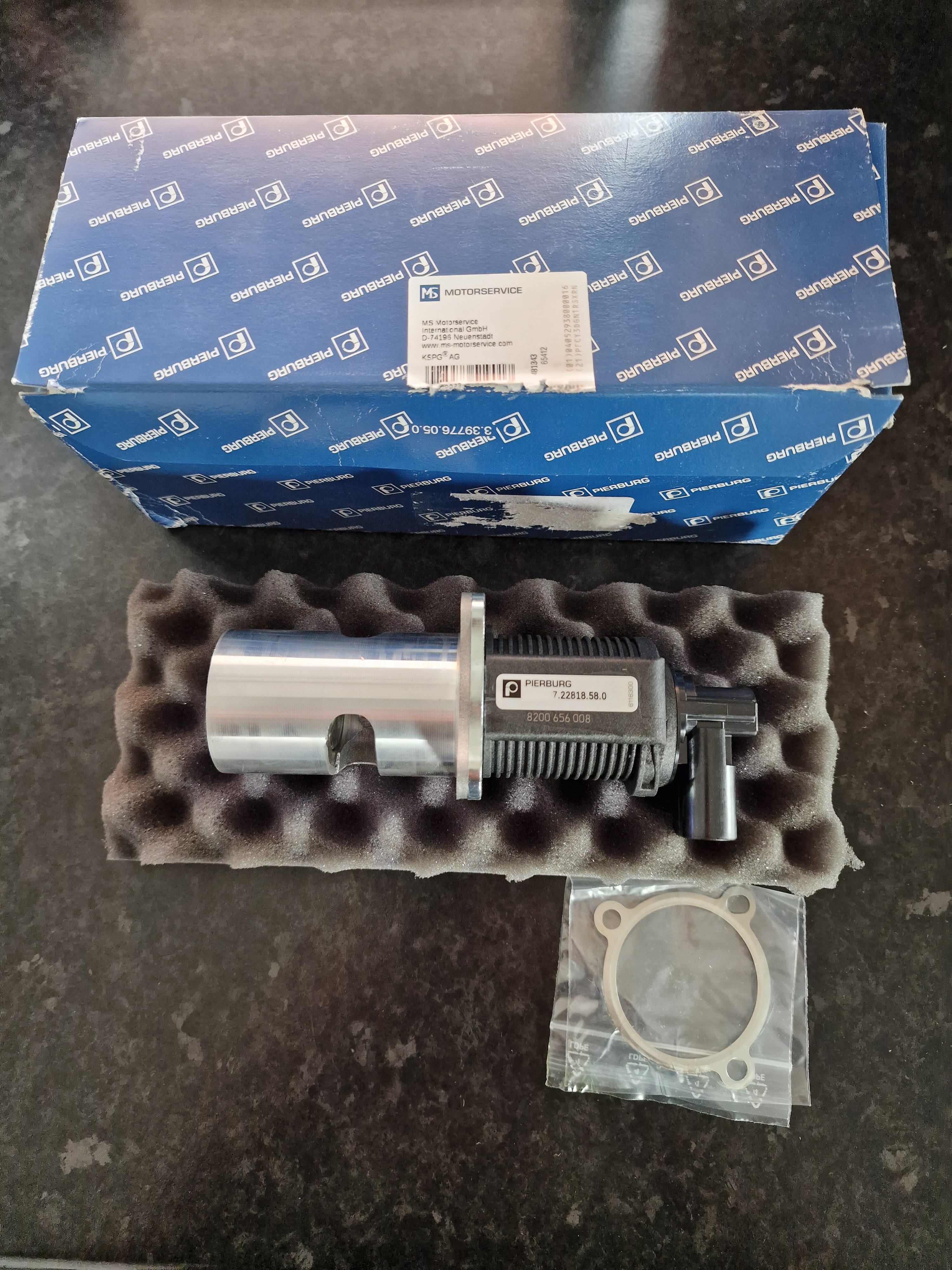

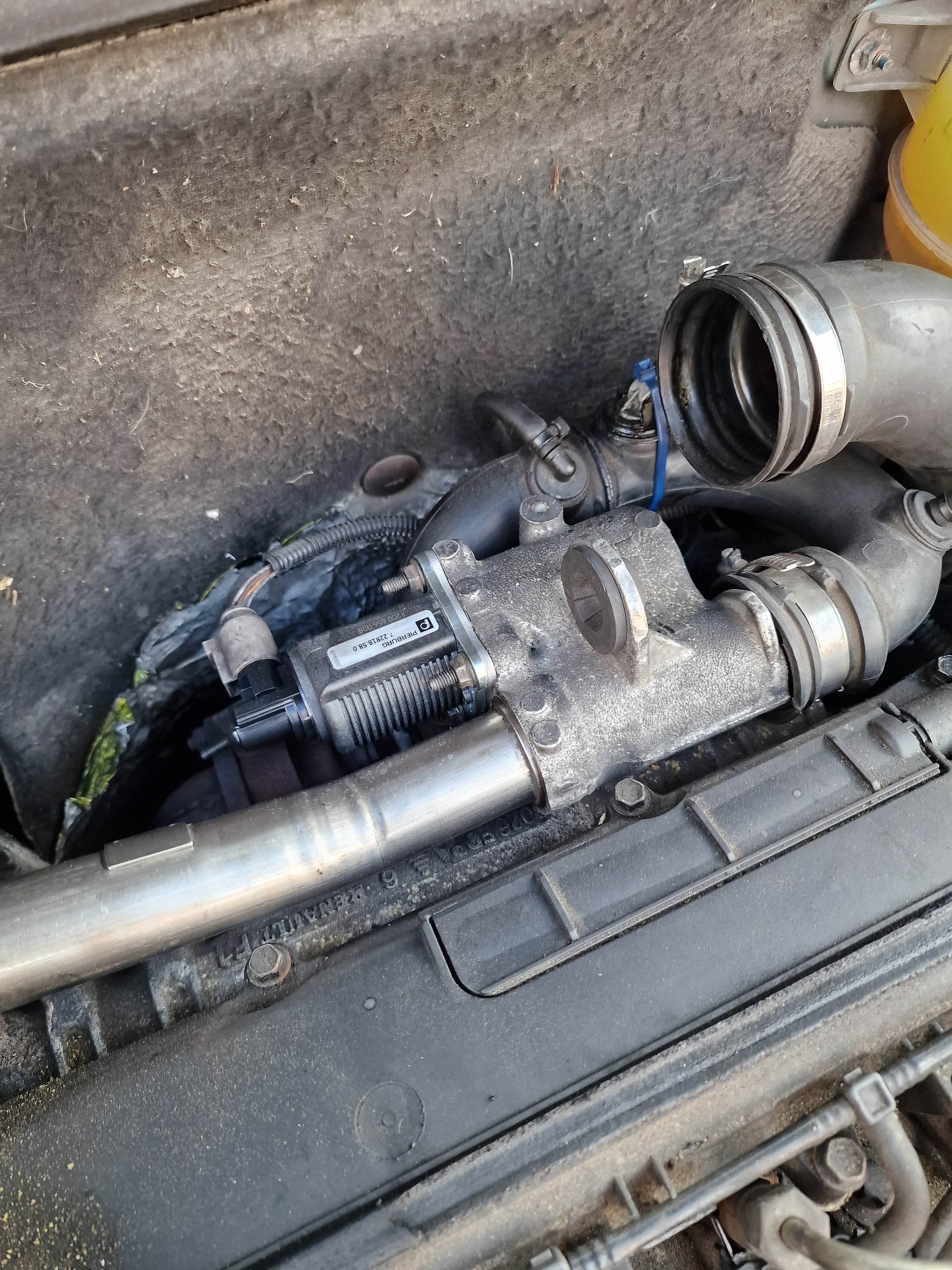

Blue dci pinged the eml up a few times recently. Scanned with clip and egr fault logged
With CO.0 stored and it was also chucking up 1.Def and 2.Def, i assumed the solenoid had s**t itself and performance was a bit flat. Id had issues with this egr before so treated it to a new pierburg oem for £50.
Fitted in ten mins

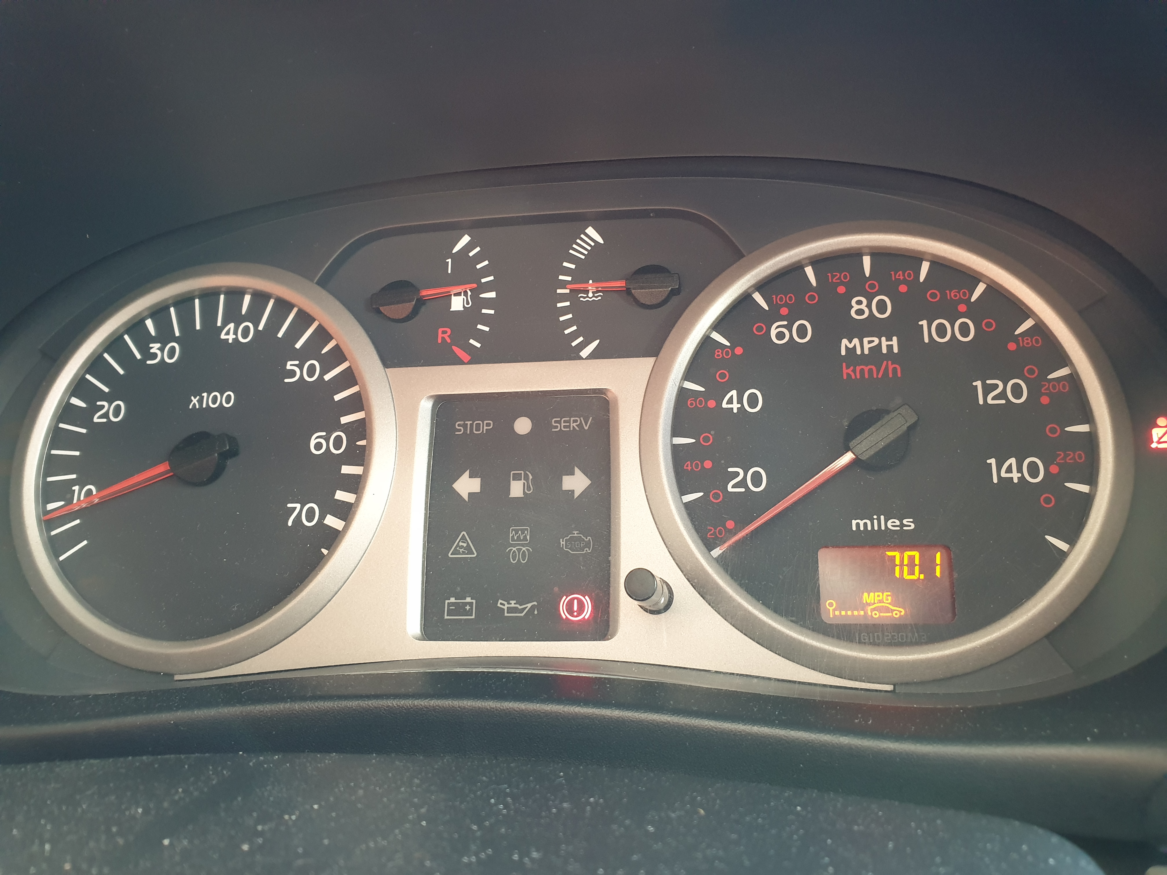

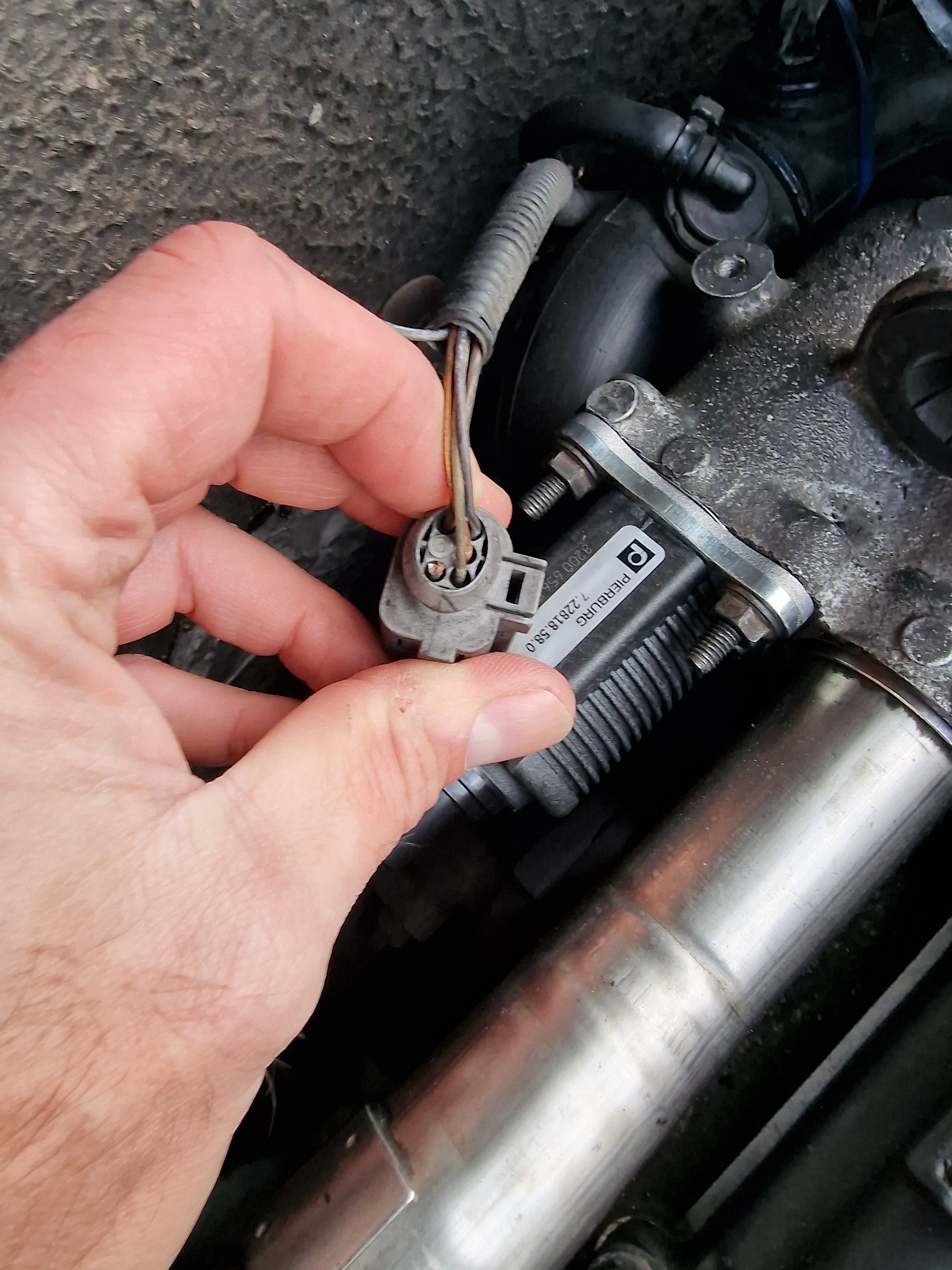

Stuck clip on , cleared fault codes and egr adaptives. Started engine, and to my discust eml was permanently lit with the same fault.
Back apart and the black earth wire has snapped at the egr connector.
De pinned, soldered a short length of wire onto the stub, crimped to existing wiring and covered with dual wall heatshrink.
Fixed. Probably would have been a free fix, but anyway its got a nice shiney egr and performance is back to intended.

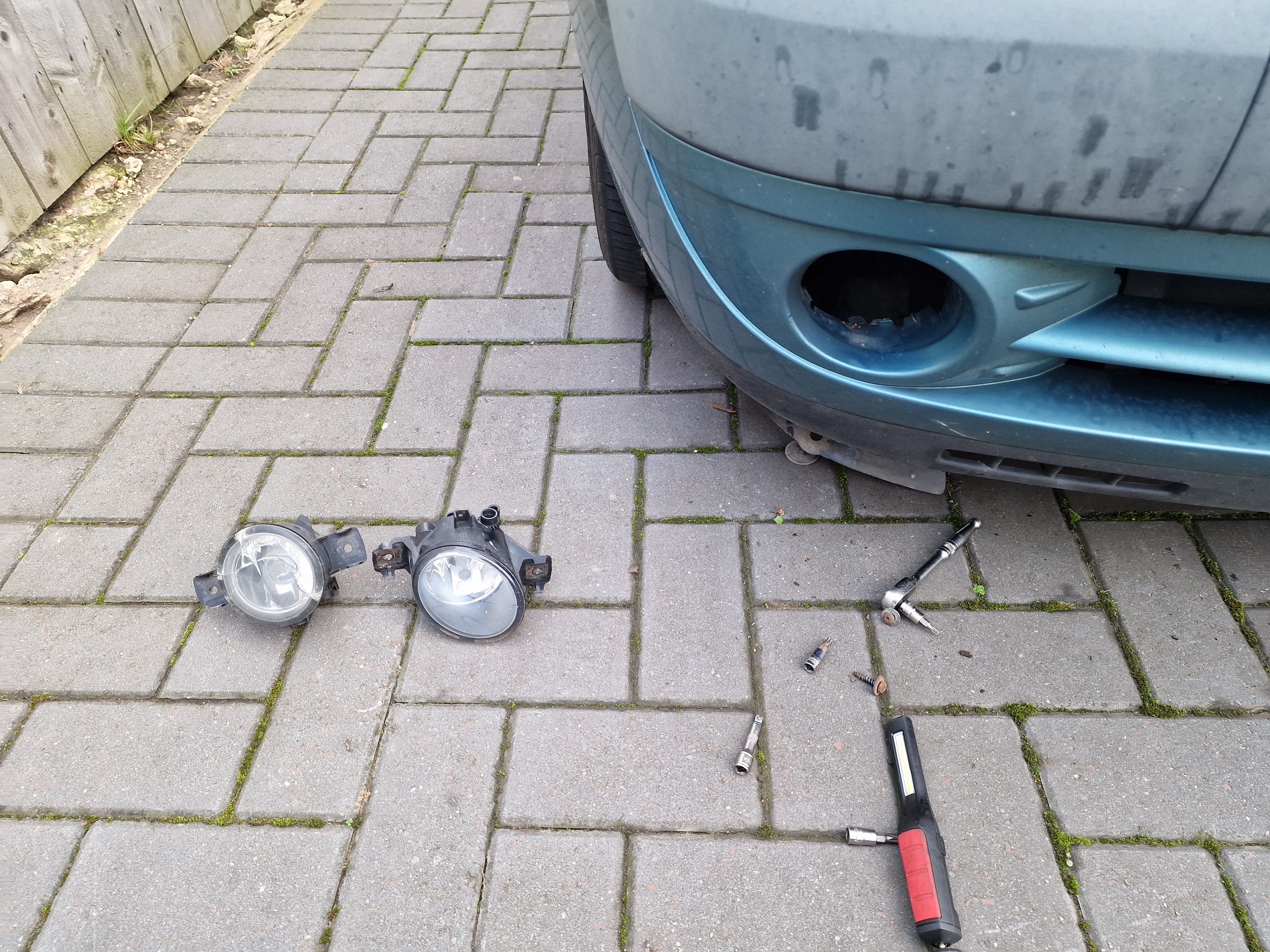

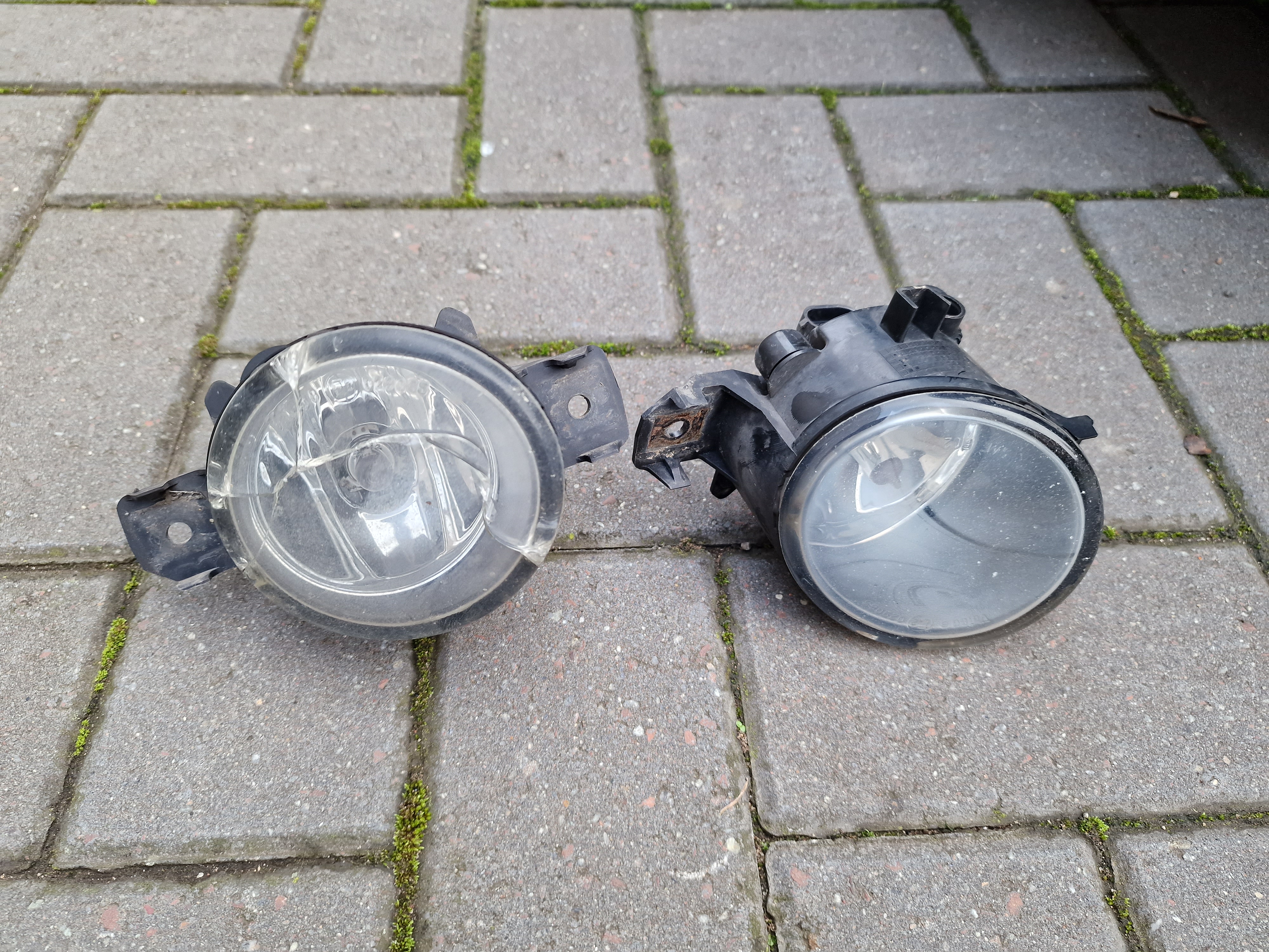

Noticed drivers side front fog light was cracked on the blue dci, assume a stone done it on the motorway. Had the old ones off the trophy which are the same so ten min swap/free fix.

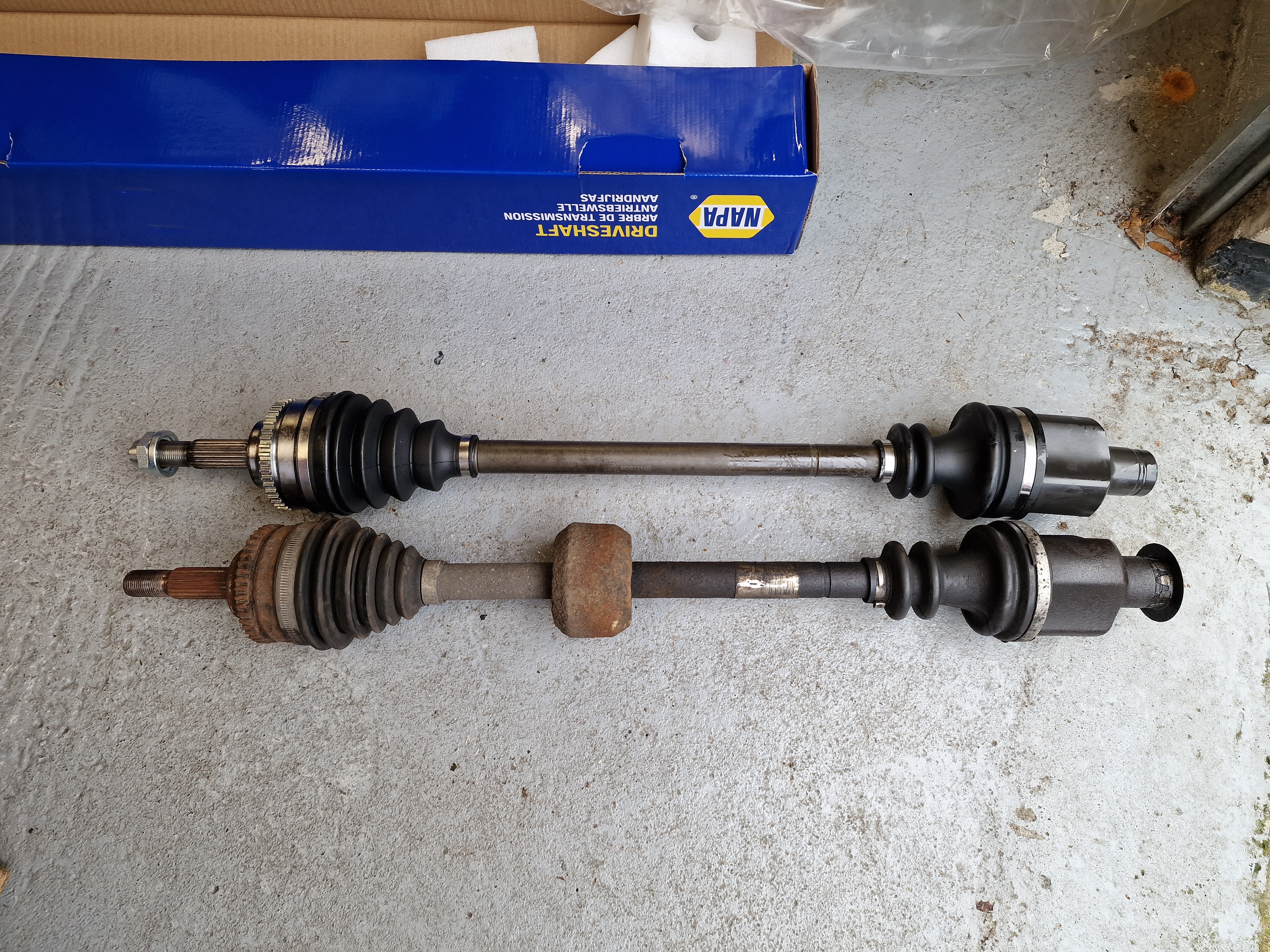

Drivers side outer cv on blue dci started clicking when turning approx 1000 miles ago. From previous experience they usually click forever on lock so was planning on ignoring it until it developed furthur.
Anyway done 280miles on Wednesday (Goole, Rotherham, Scunthorpe and return) and on the return leg of the journey near home, it started clicking on acceleration/slight lock. Cant moan as original shaft at 156k.
Rang up local motor factors to get a price on a shaft, and they had one in stock for £50, cheapo napa brand but im sure itll handle the diesel power.
Original shaft had at least 4mm of slack on the outer joint when checked so well worn.
Fitted on Thursday dinner time in 36mins and took the rear brake shoes up which took another ten mins, and good to go for next week which will be 500miles or so.

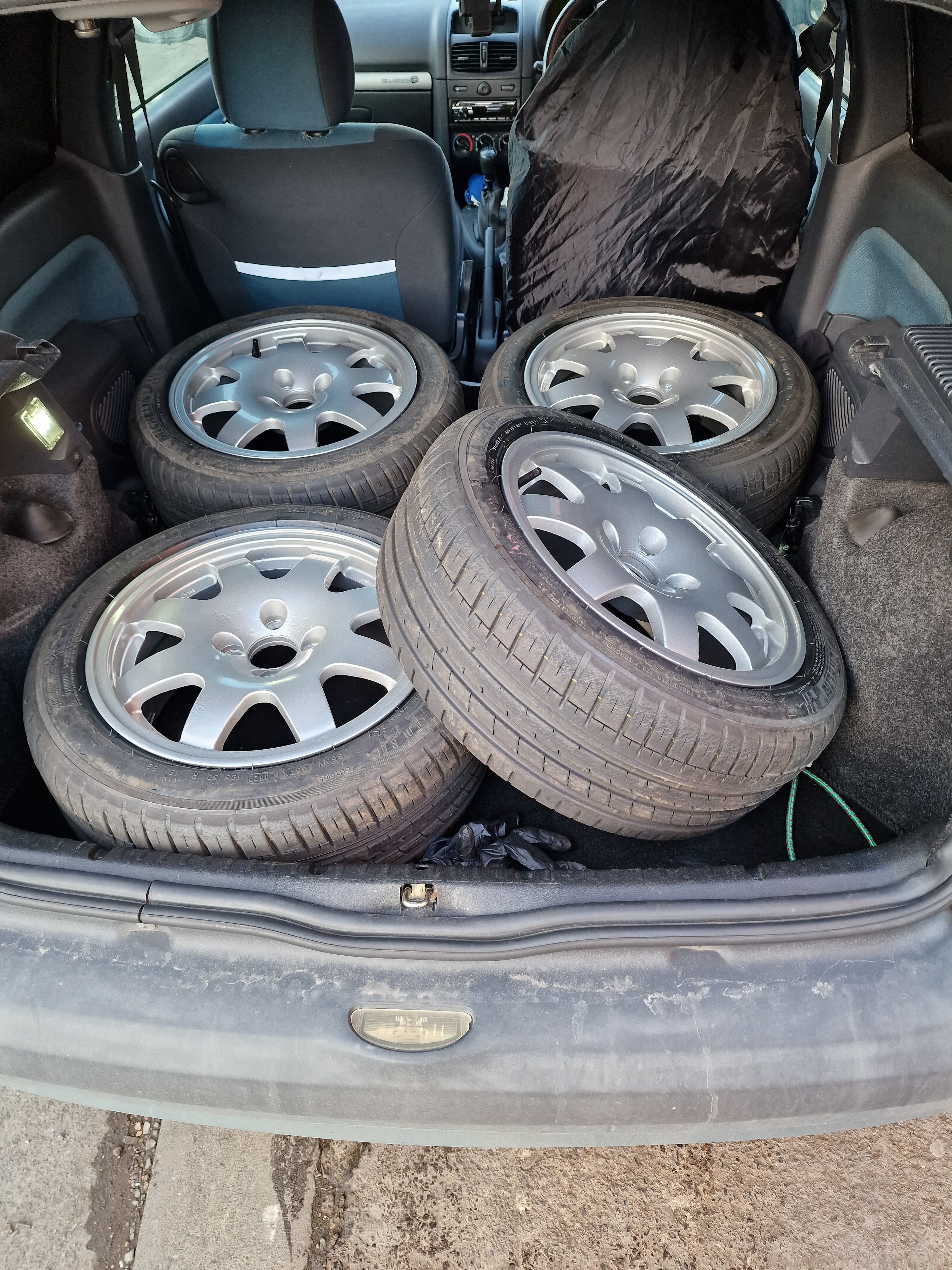

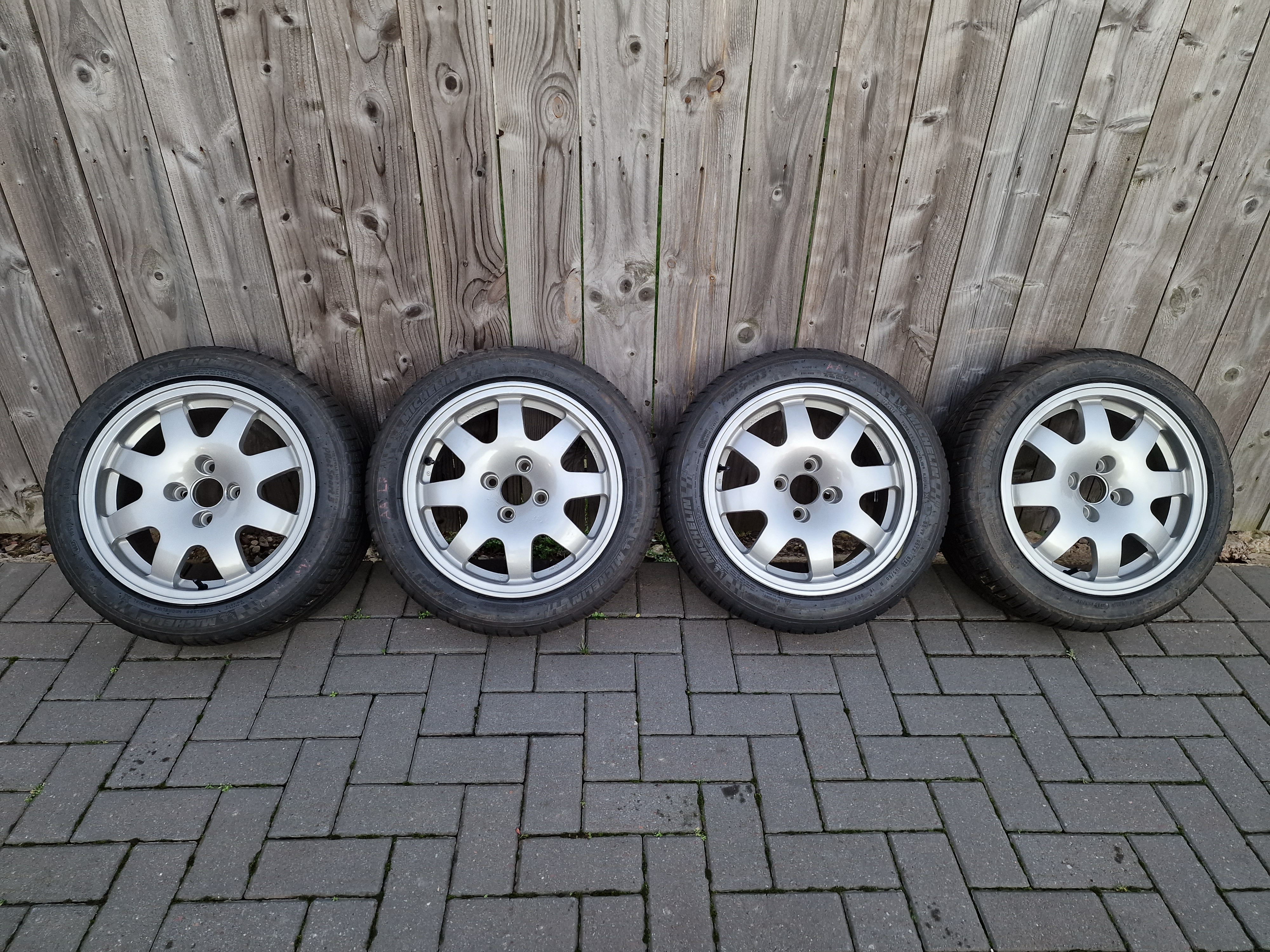

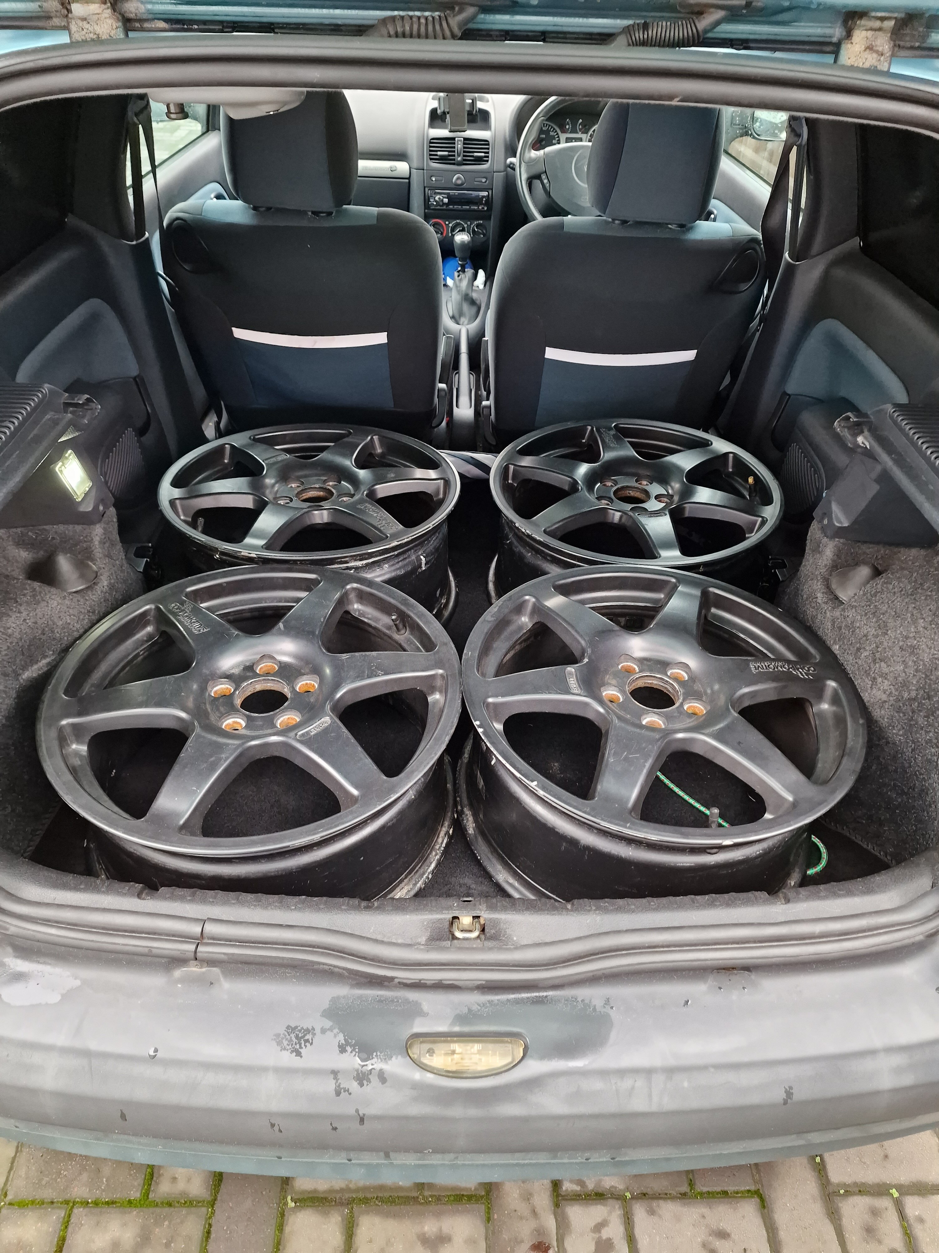

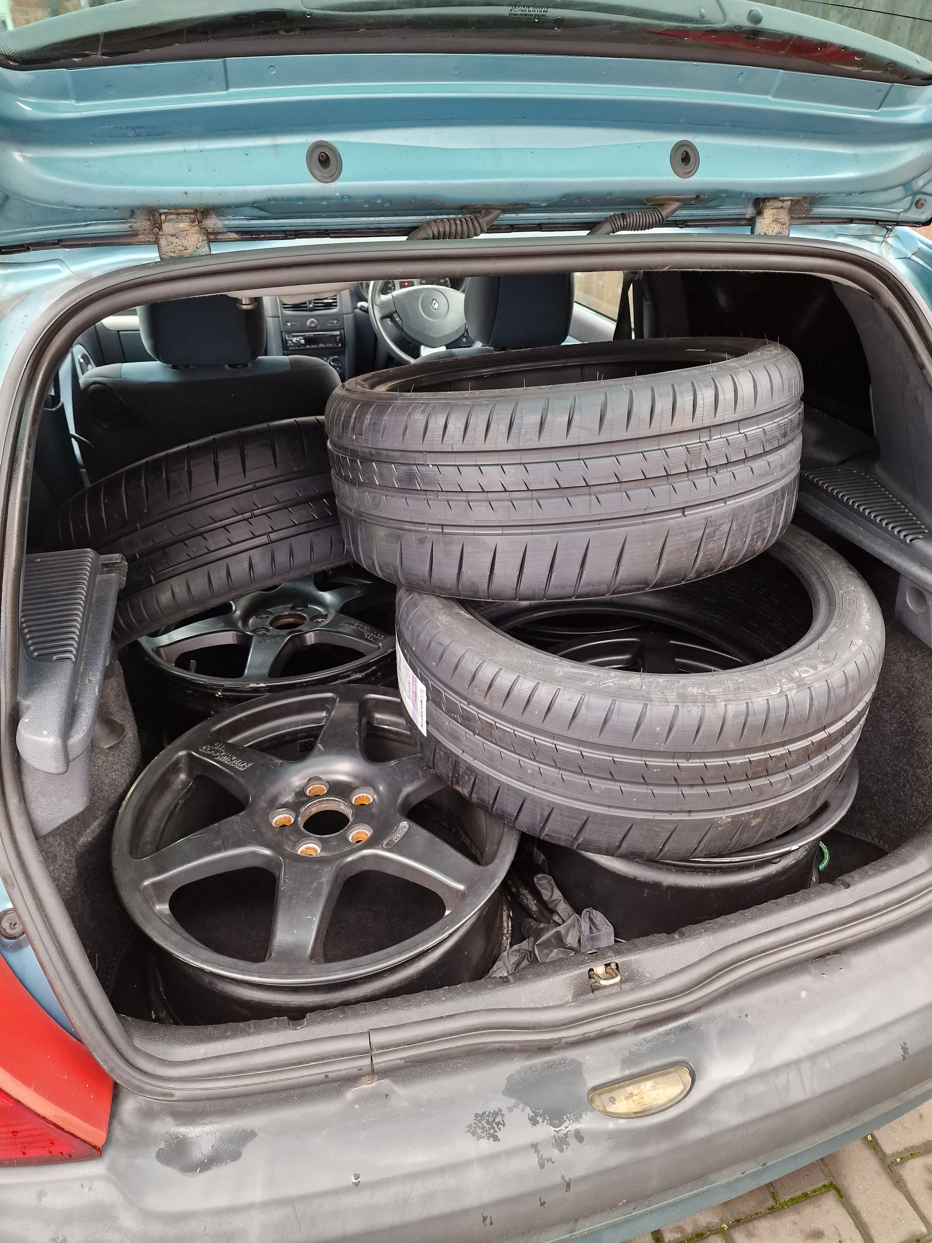

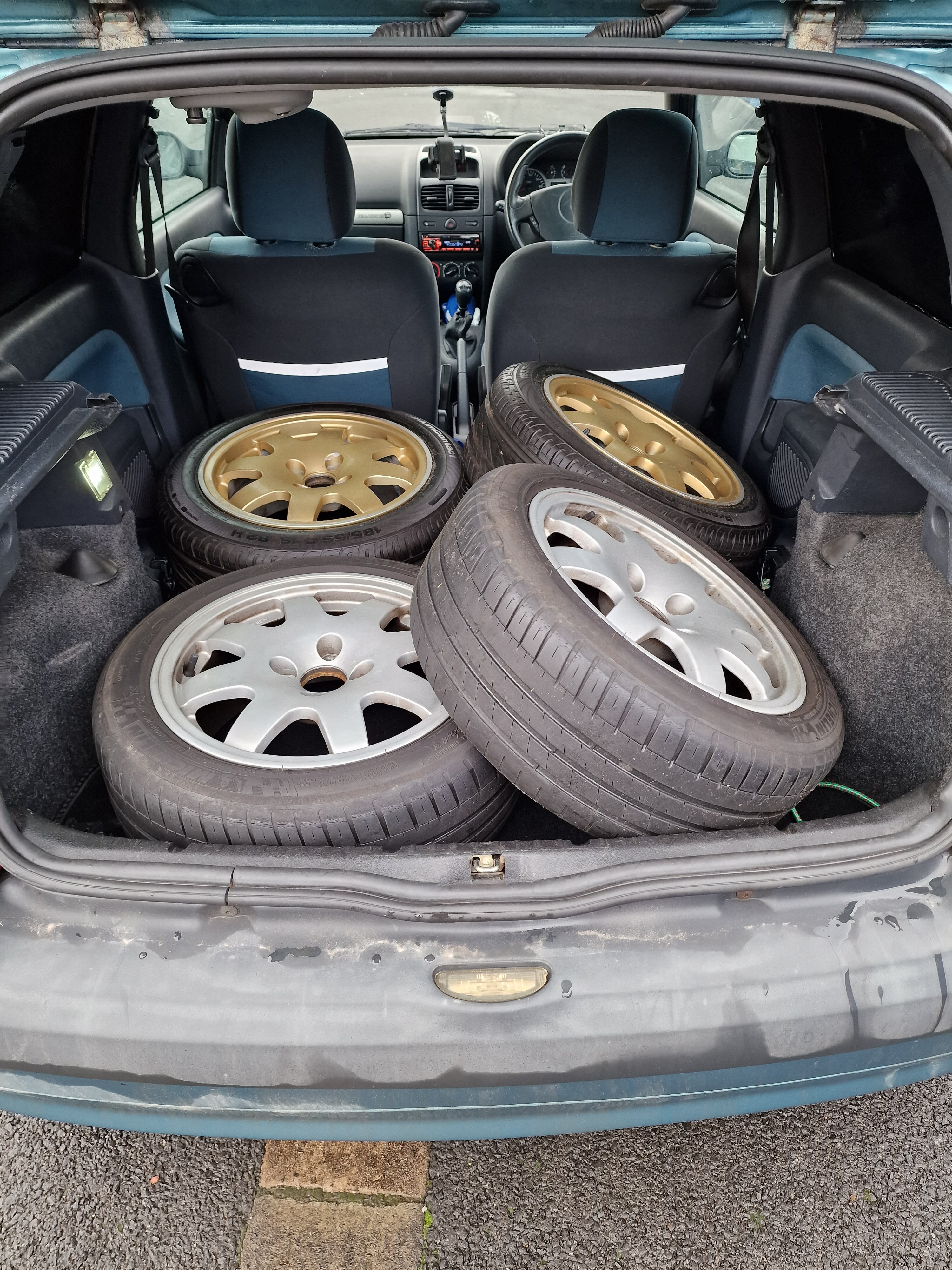

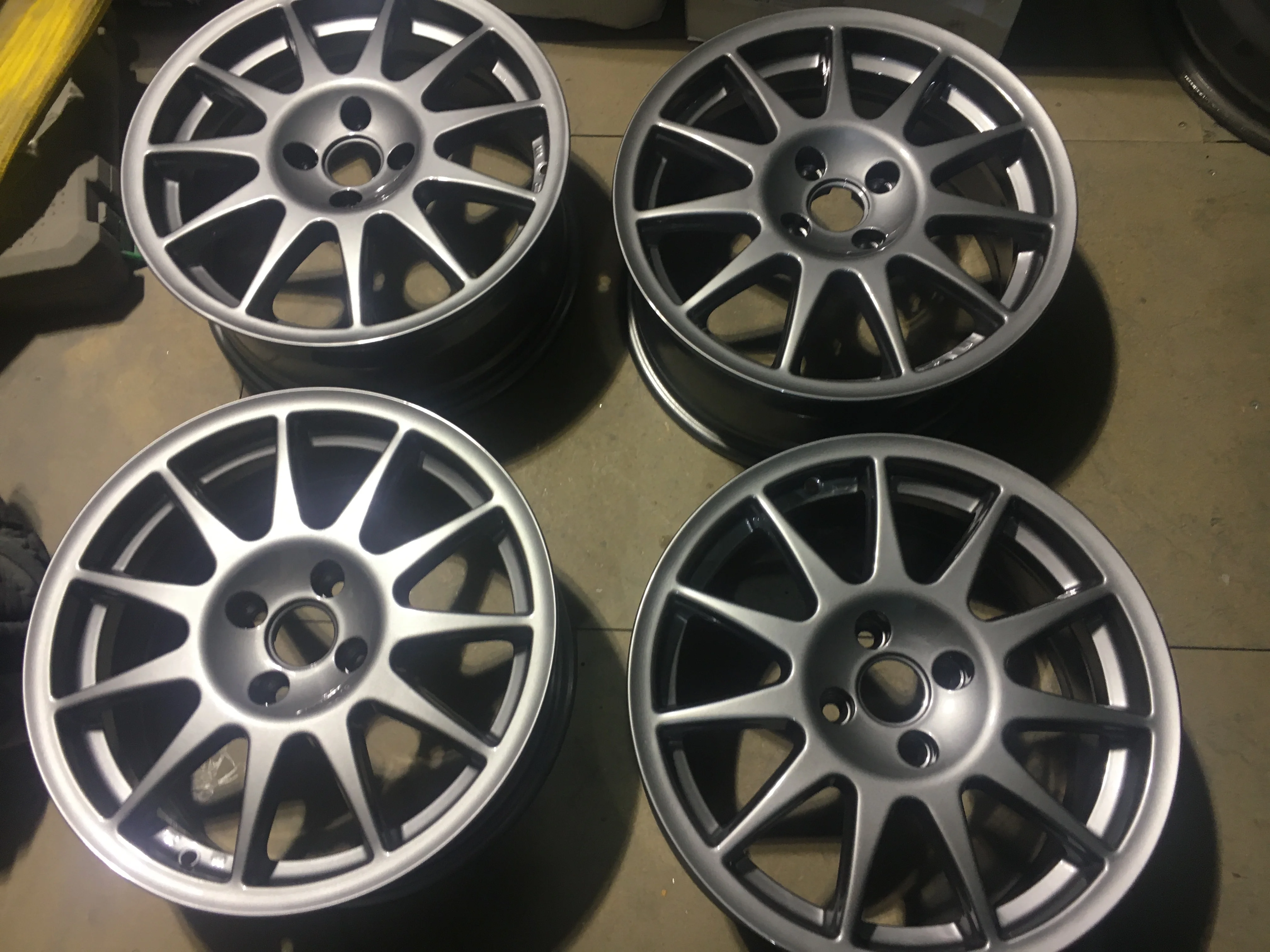

Orange dci is due its mot in a few days. Tyres were getting right down and one of the williams wheels on the back was like a 50 pence piece causing a wub wub noise on certain road surfaces. Id prepared in advance by buying another pair of wheels to refurb a couple of years ago so decided now is the time to get them done.

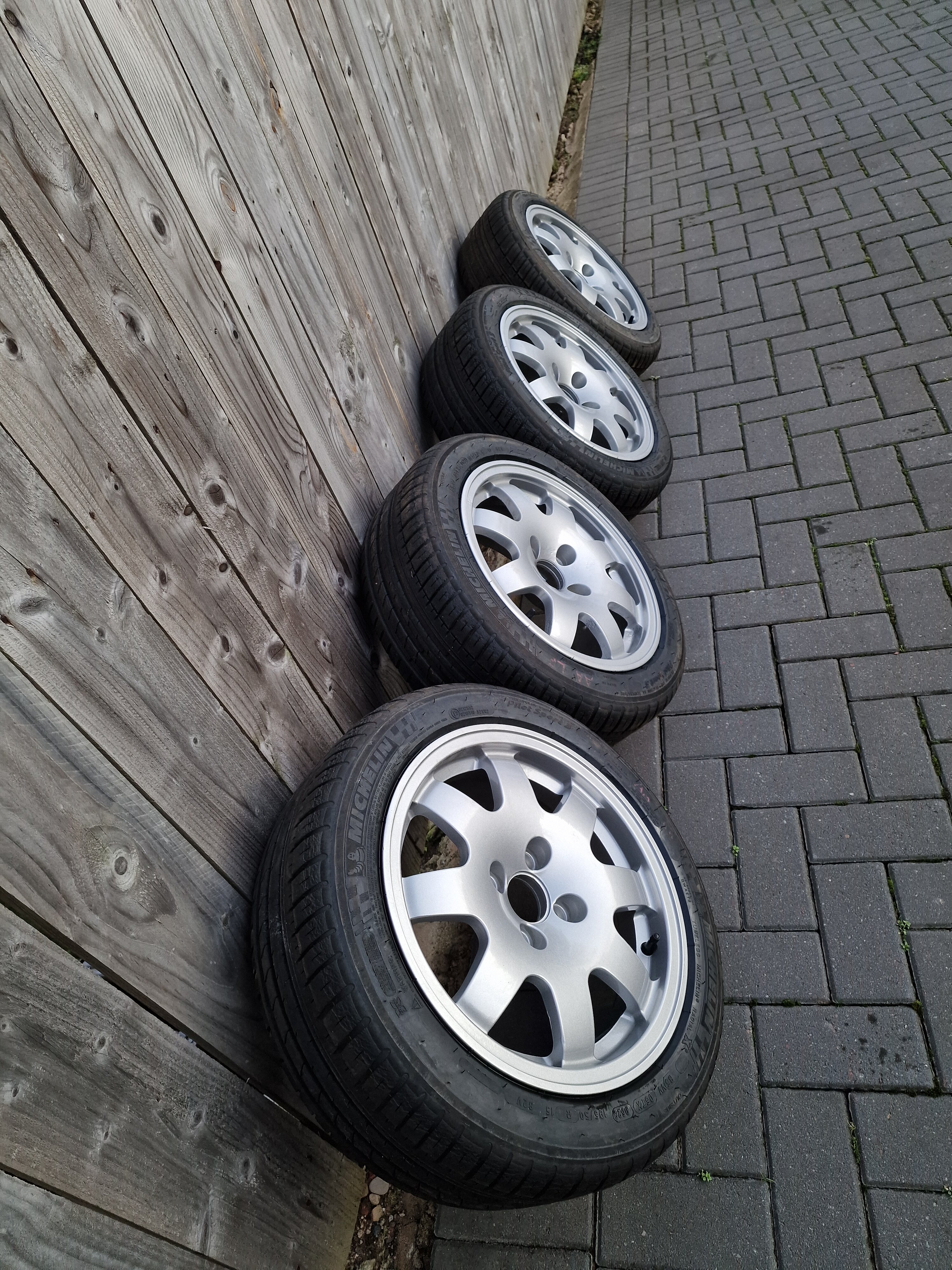

Checked all the wheels to see if true, and the front pair are straight, one rear has a slight buckle, and the o/s rear is pretty bad so decided to use the new pair as straight, which makes a good set of 4.
Loaded up in the blue clio

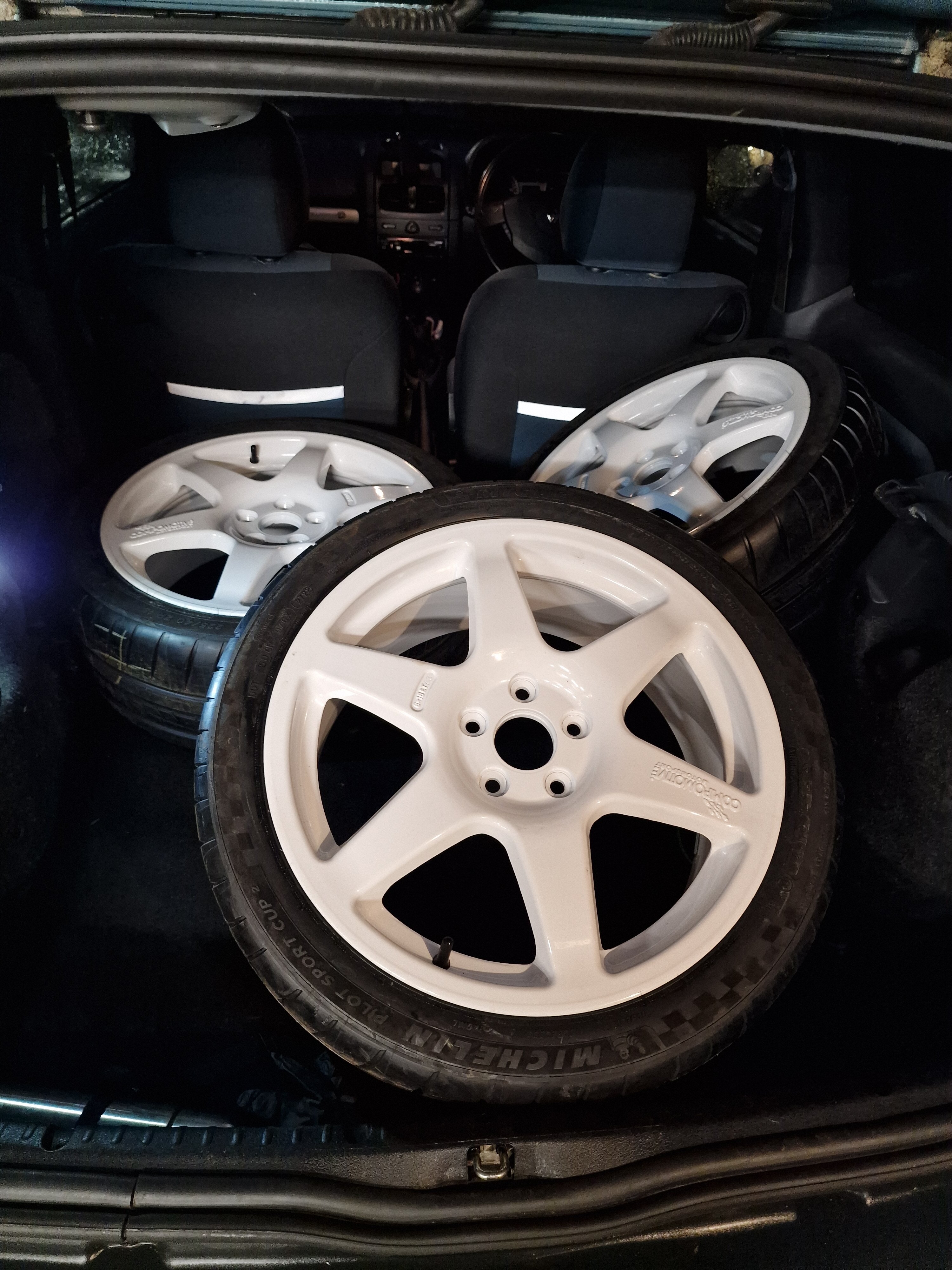

Collected, the place i use was quiet on the run up to xmas so got them turned round fast. Fitted with a set of ex ginetta pilotspoet 3's with loads of tread.
Give them a clean up and seal with collinite before fitting.

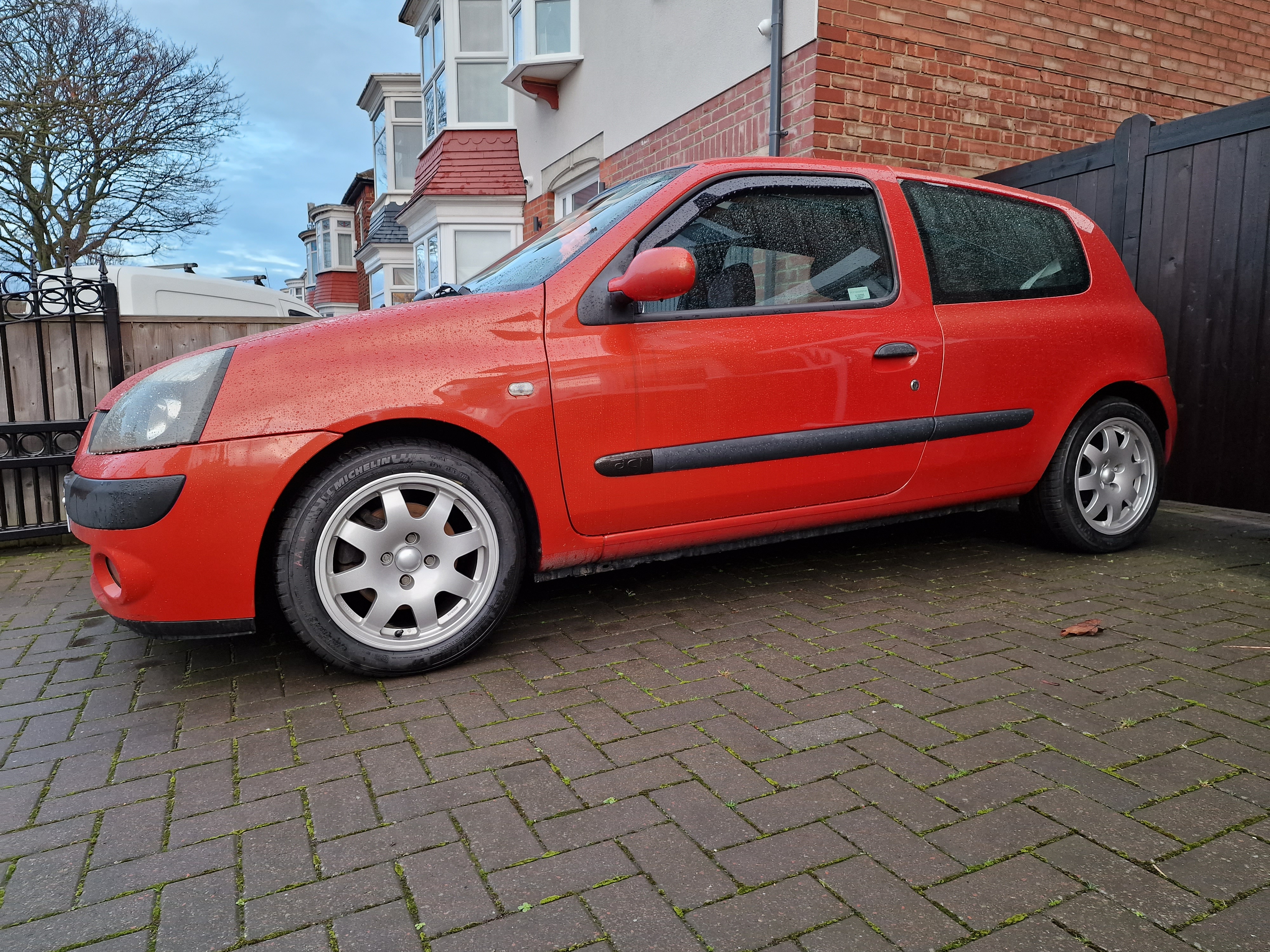

Fitted. Look a bit fresher, and the silver is brighter than the old finish so a bit of an improvement. Drives lovely, no more noise from the rear.

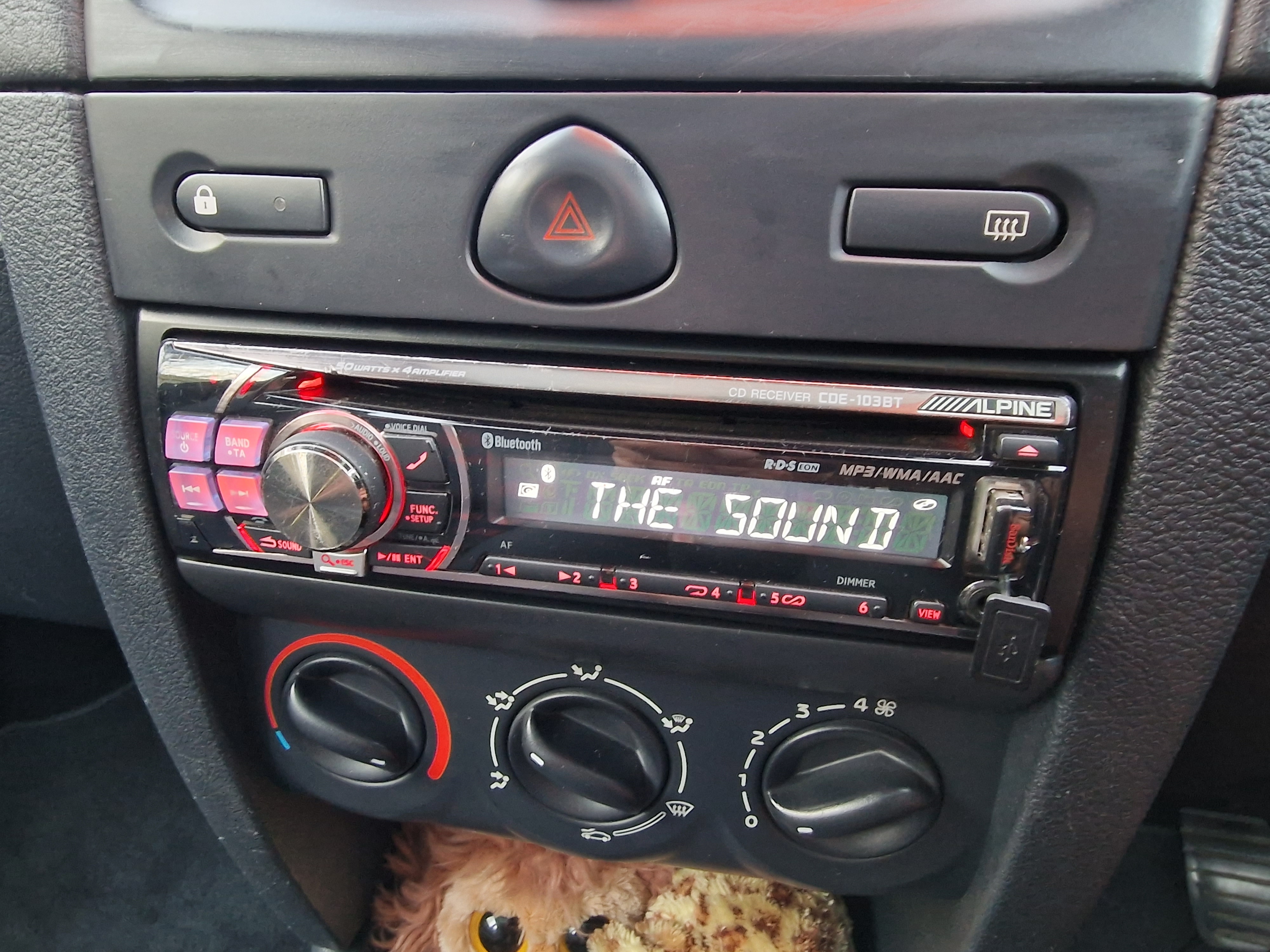

Also fitted another alpine stereo. The old alpine had broken somehow, it actually packed in for a bit and then just started working again but the sound quality had gone a bit on the piss.
Got this alpine for £15, its basically the same as the old one but has bluetooth so slight upgrade. Cheap and cheerful and sounds 100x better than old one.

Orange dci went straight through its mot today. Mot testers comments, clean for an old car. Had tracking done whilst there as it had gone out a bit on drivers side. Not sure if anybody else has the same.issues but feel like im forever getting the tracking done on the clios!
Another year of cheap motoring ahead.

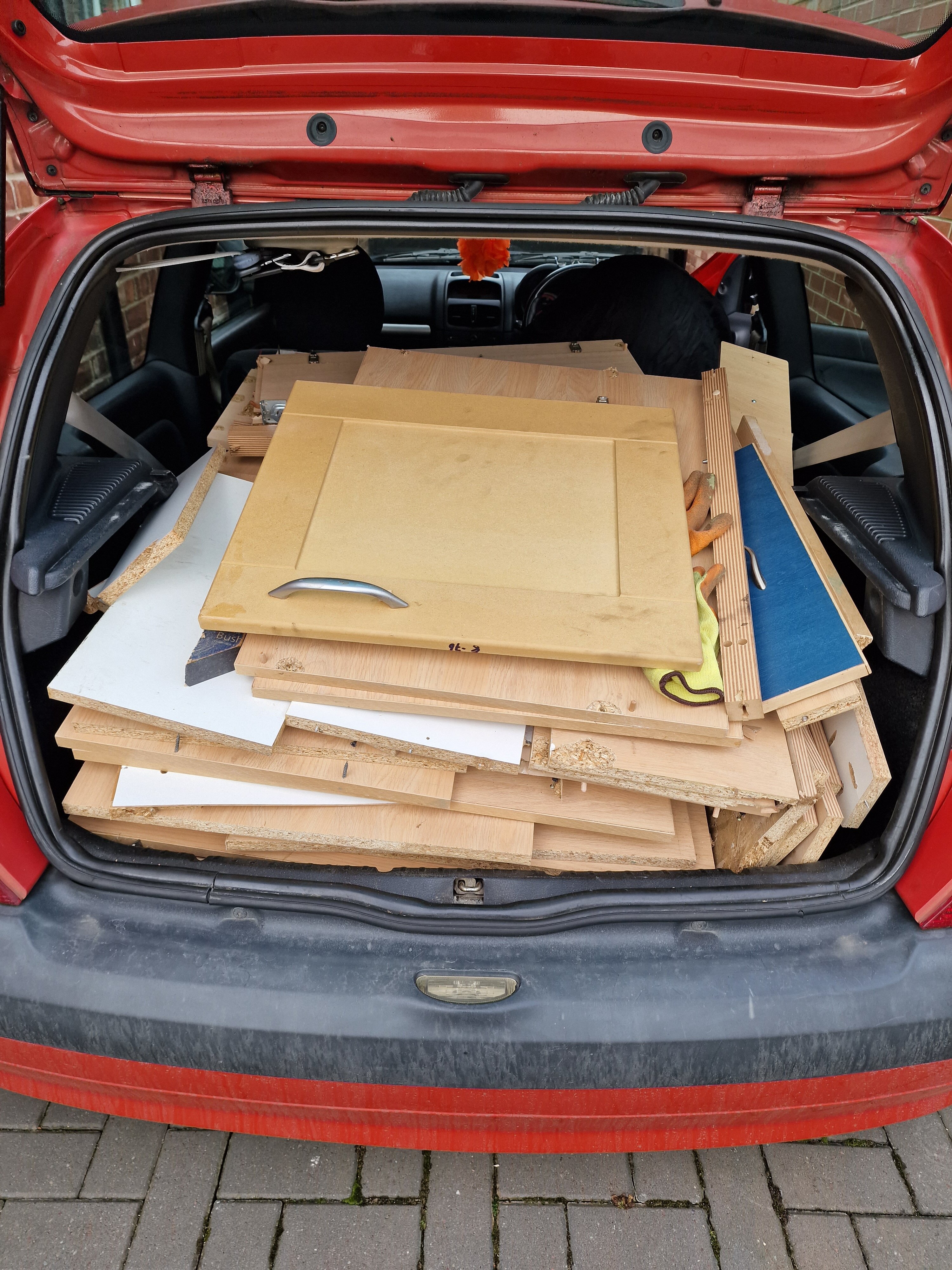

Small update. Got a few free kitchen units to fit in my garage. Infact a few too many as 2 van loads turned up! So had a few runs to the tip in the orange dci today.
On its arse!
