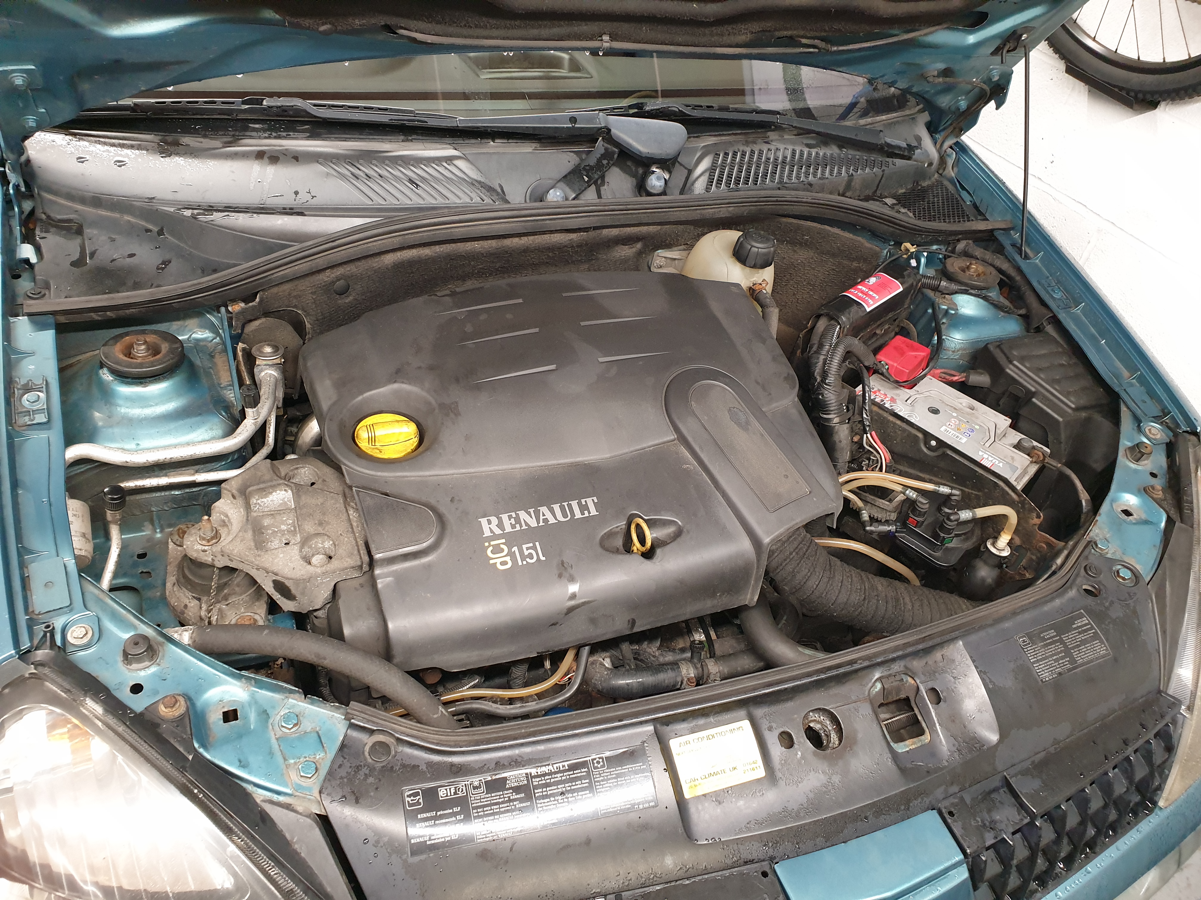

Mpg seems to be awesome on the blue dci @Mazz it does do a fair bit of dual carriageway driving though. The orange one does around 62mpg with a mixture of street and short dual carriageway runs, so yours sounds about right.
Id leave cat off and egr blanked. The blue one is smoking bad from cold now and assume oil control rings are stuck due to oily crap building up, these engines are dirty and the egr chokes them up. Ive got the parts in stock to give it a freshen up very soon, im thinking about spinning the egr 180deg when its back together aka cheap delete.

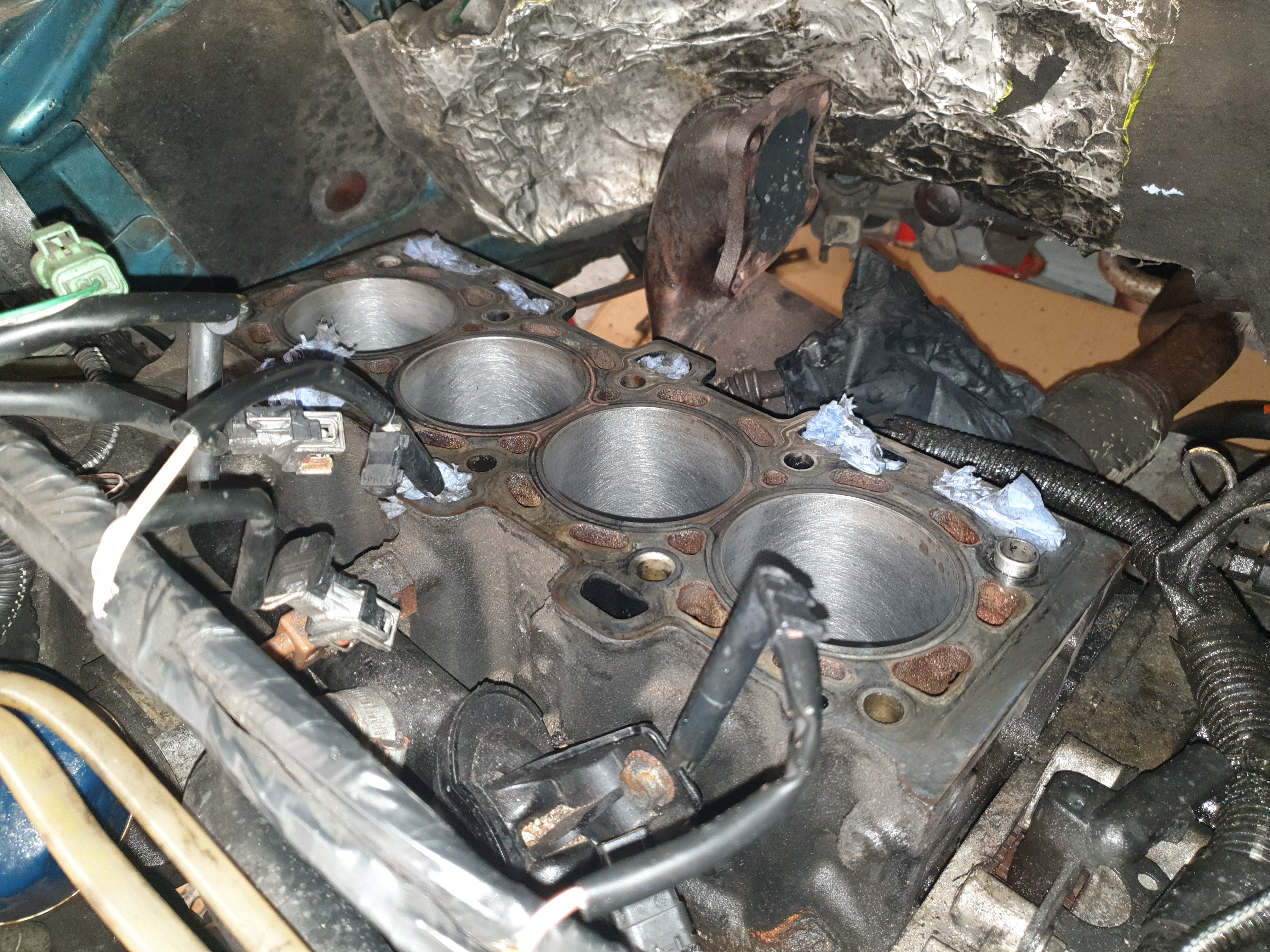

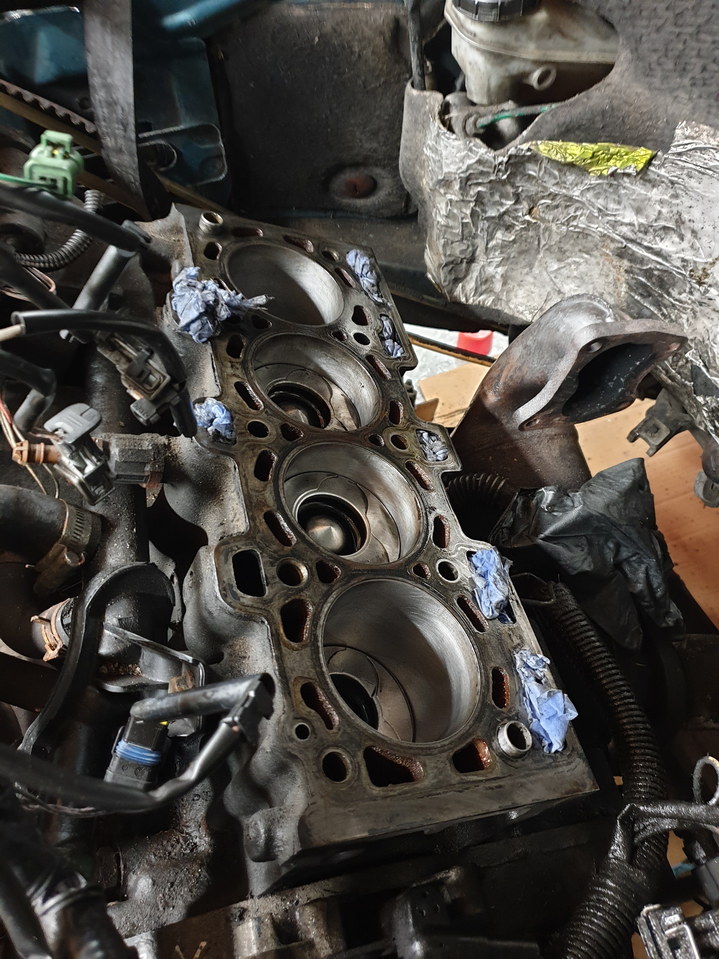

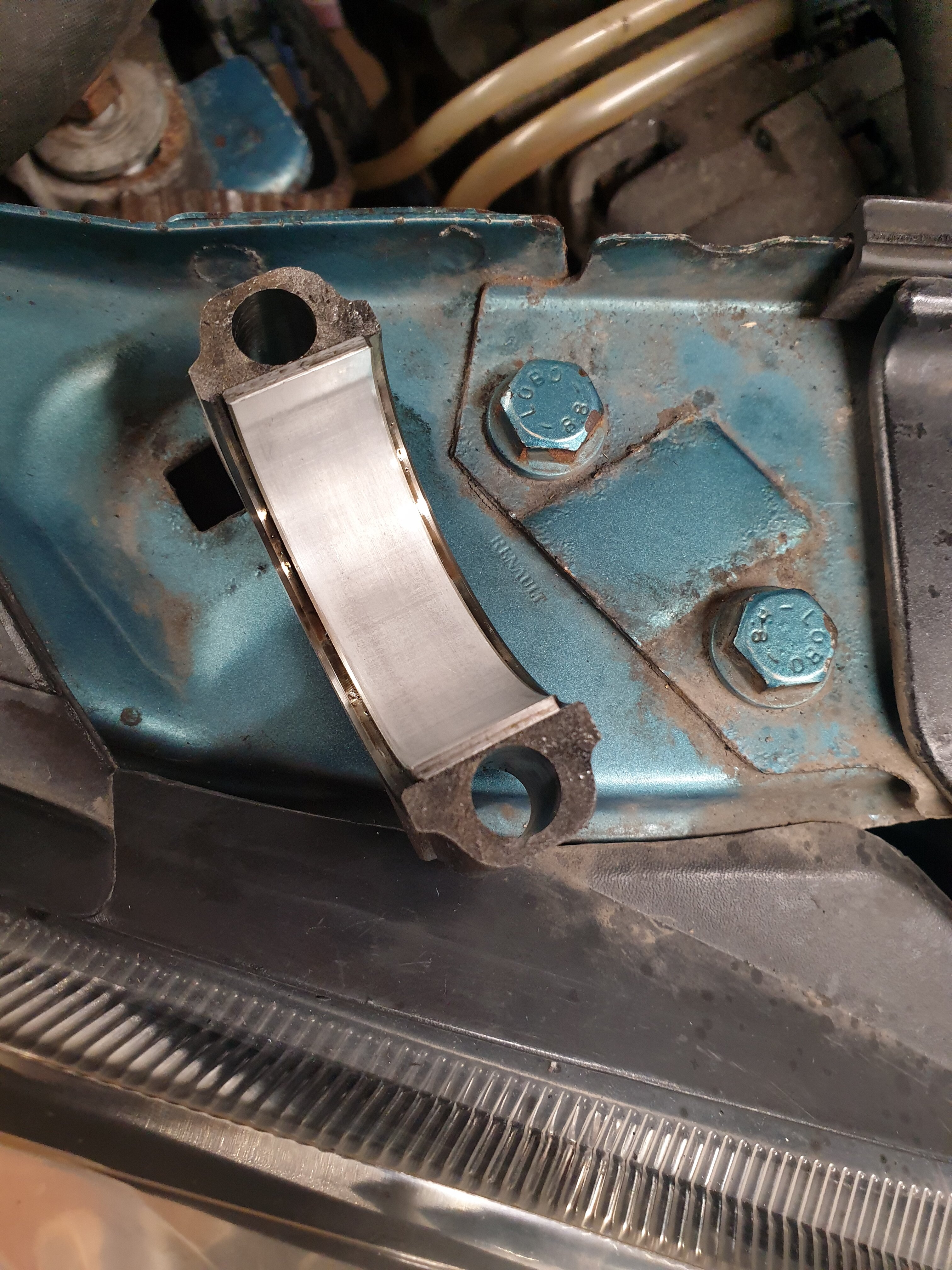

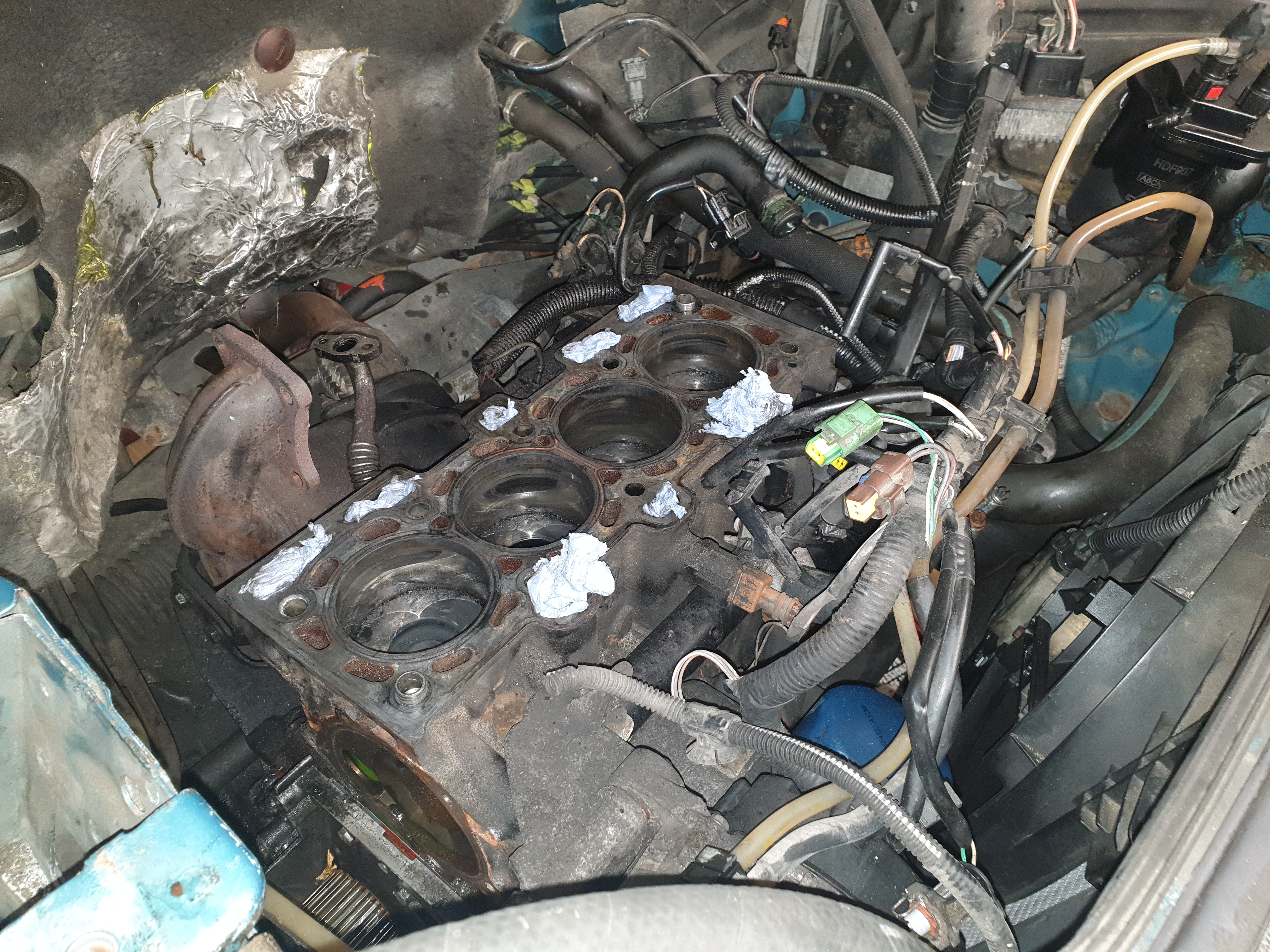

Xmas repairs to the blue dci.

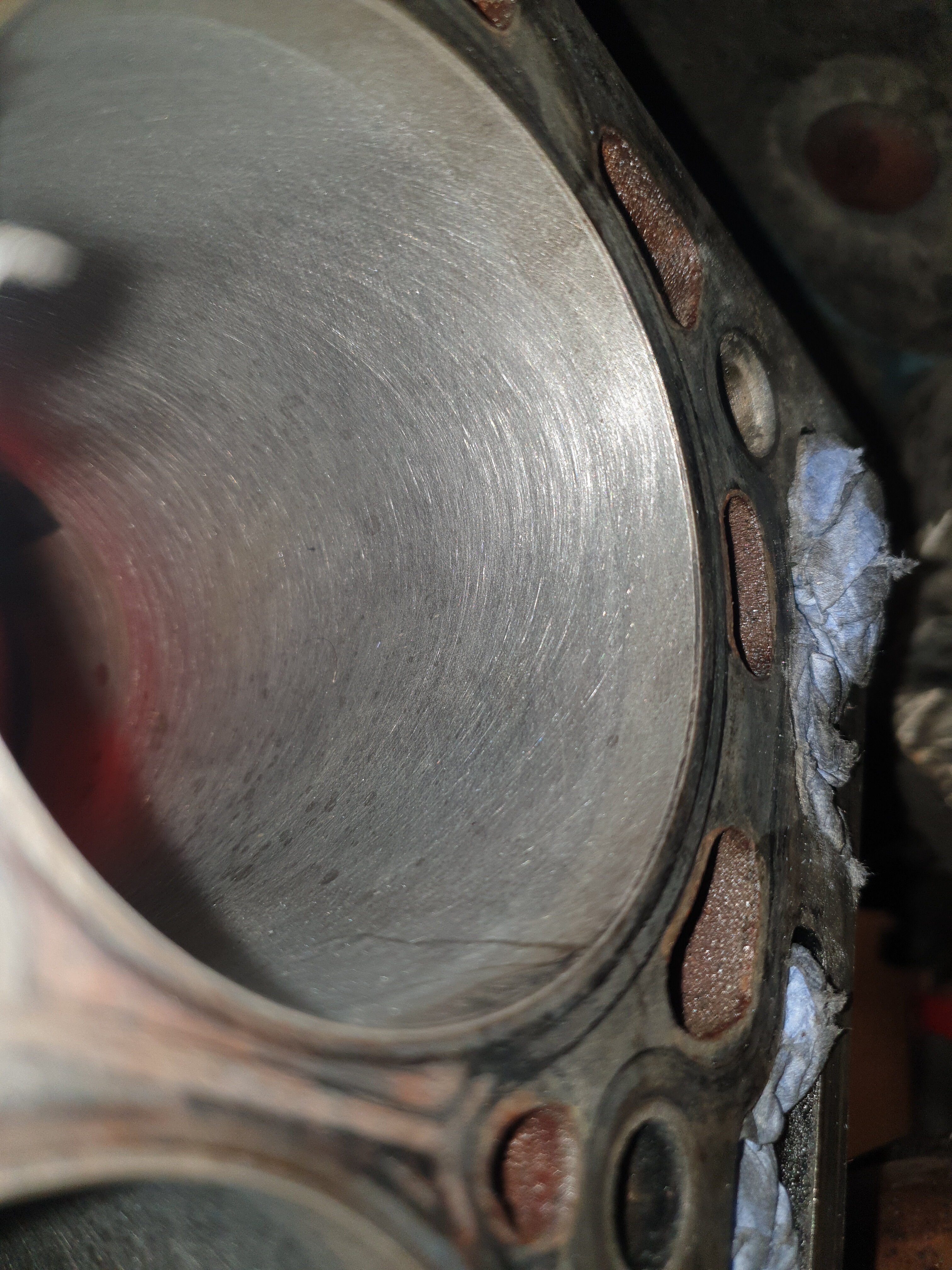

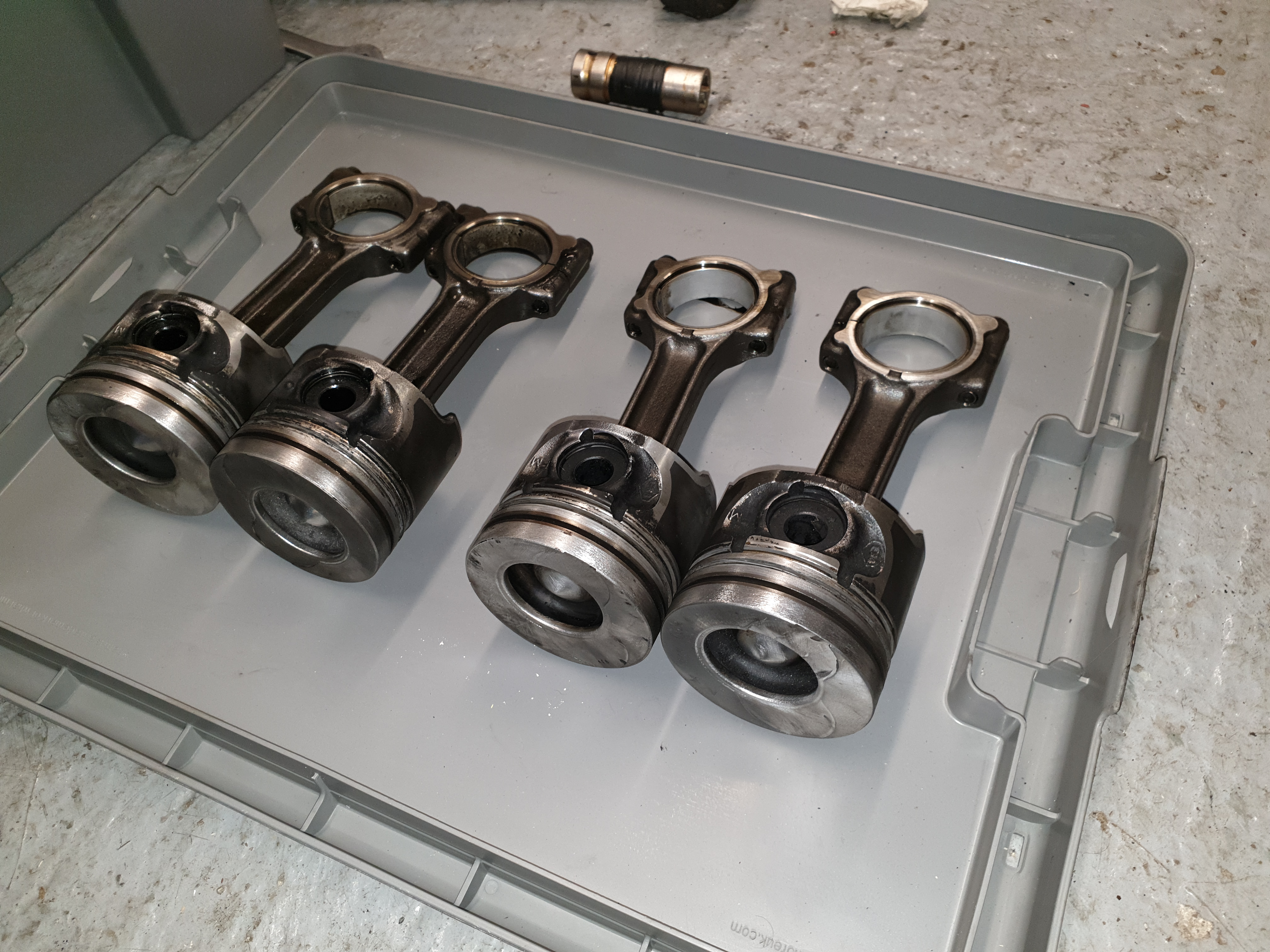

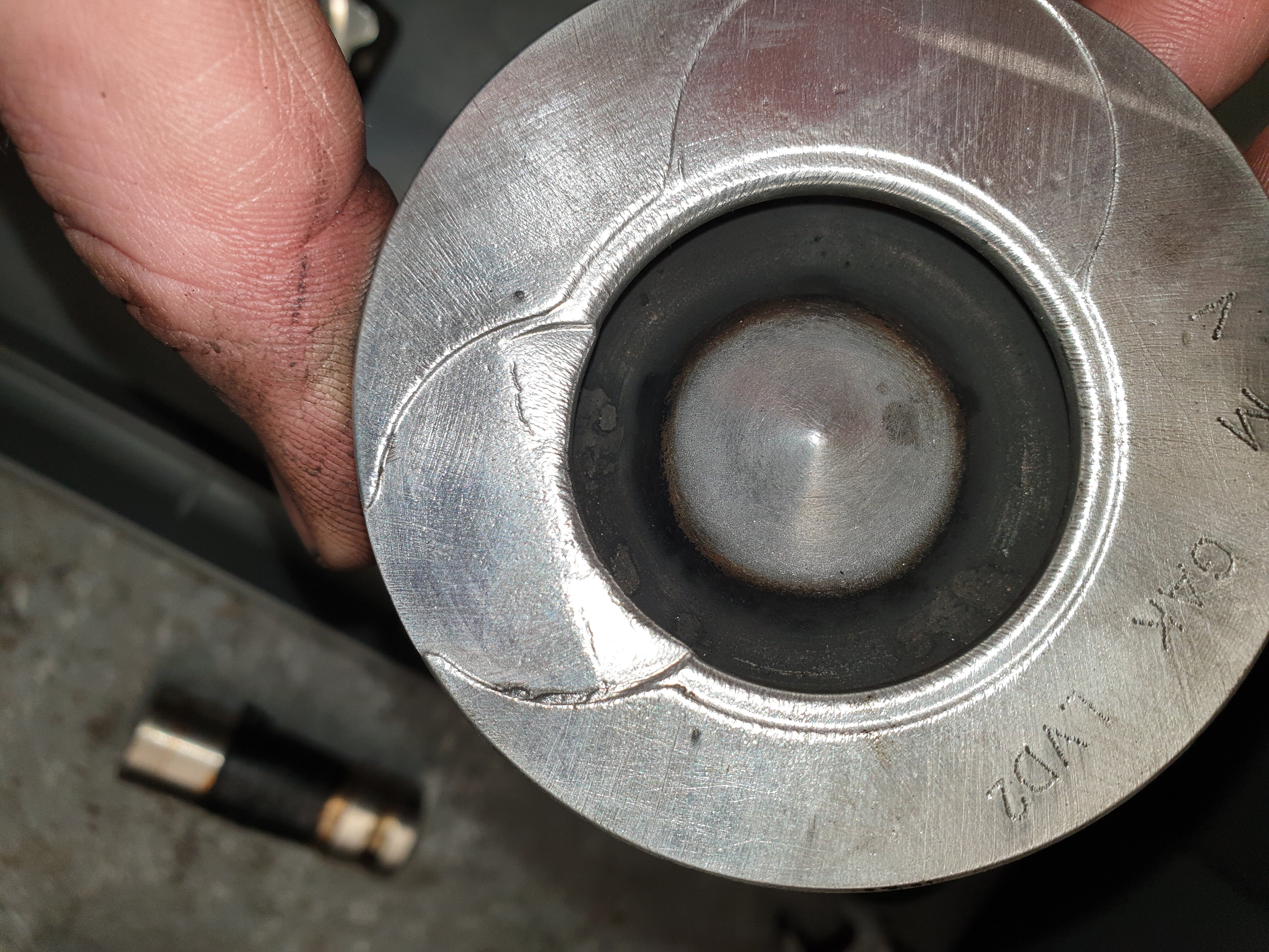

Epic amounts of blue smoke/misfire from cold now. Ready to pull pistons out tomorrow, bores are nice and shiney, i guess that explains the epic oil usage. Evidence of previous inlet valve to piston clatter on cylinder 1&4, i had a feeling it had a head job previously.
Pikey flex hone in situ tomorrow.

Blue clio back together.
Fired up first turn, did not need any sniff to get it going which was good. No blue smoke from cold so looks promising, engine sounds great even quieter than before.
Took it for a ten mile drive on some local b roads with hills using peak torque/boost to get some load on the new rings to break them in. Will run it on mineral oil for a thousand miles or so before going back to synthetic.

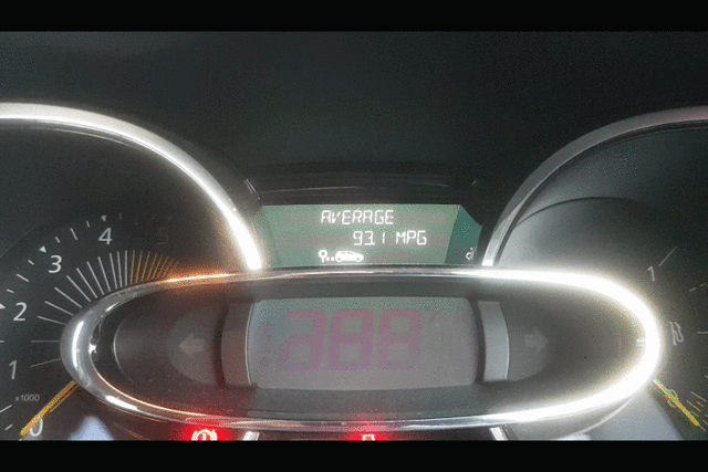

@Brigsy - I used this for a looooong road trip last week. Did nearly 70mpg! (Think it was 68.8??)
