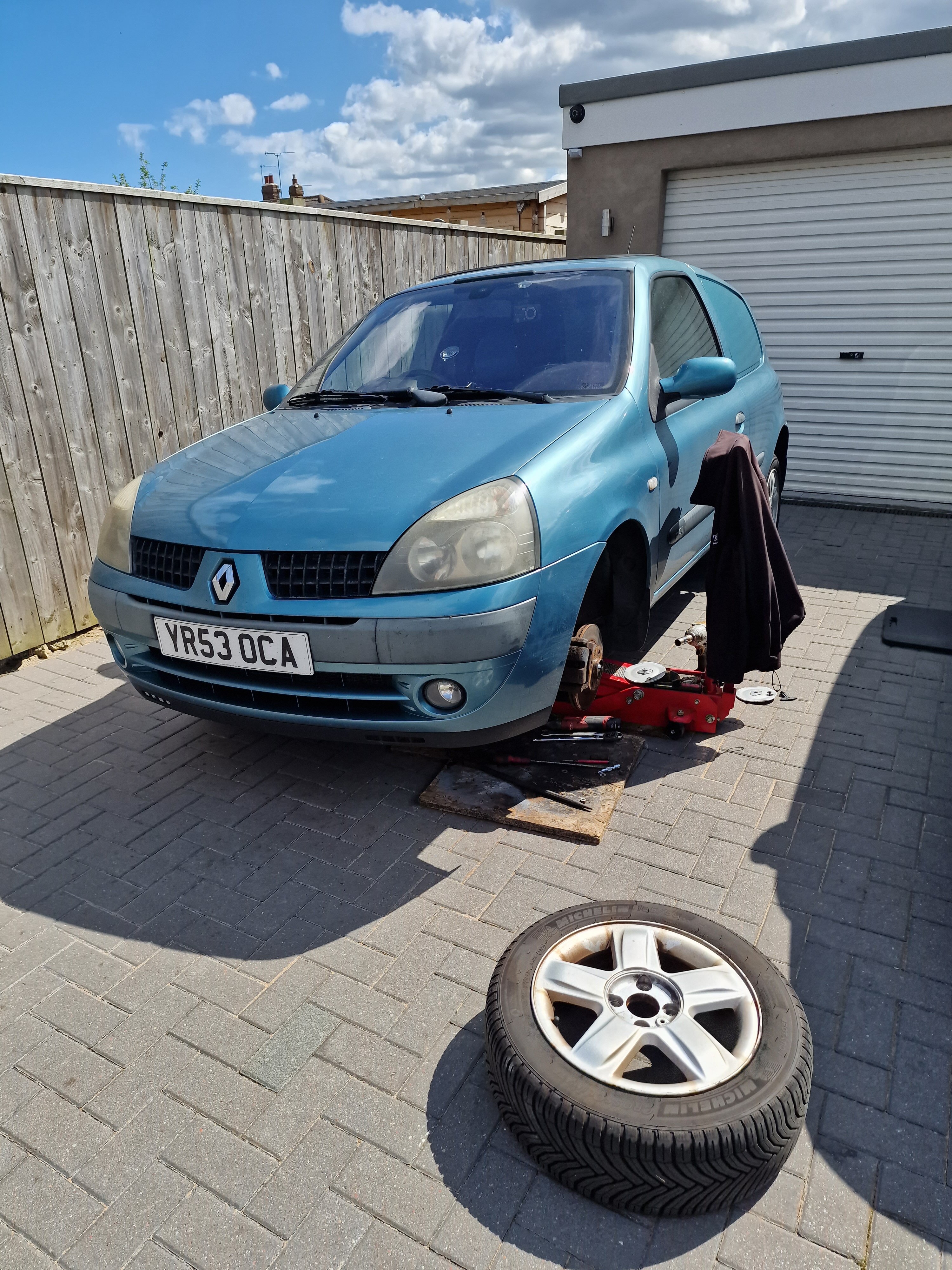

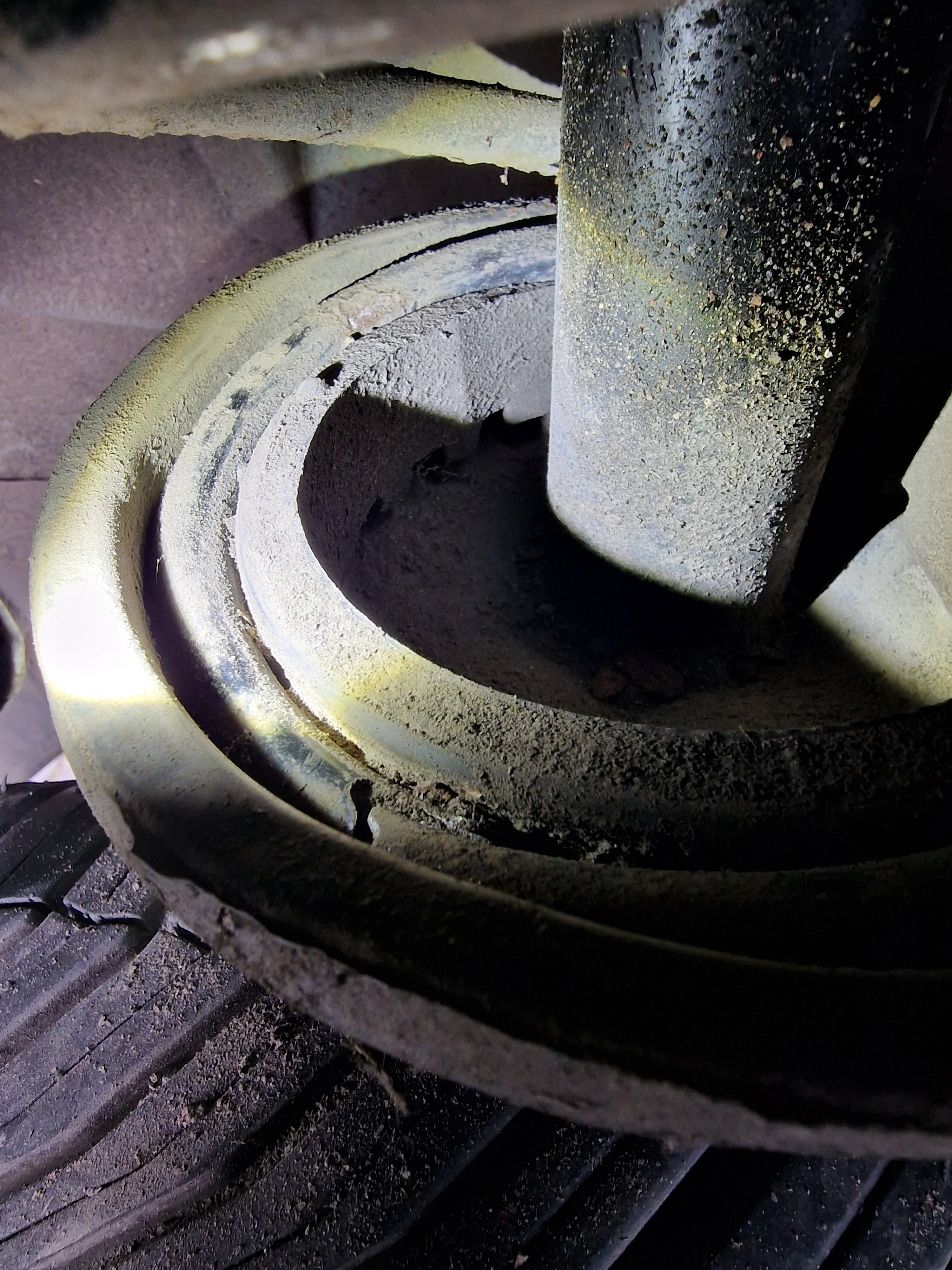

Small problem with the blue dci today!
Heard a twang when driving half way down the drive. Jacked up and passenger side spring has snapped half a coil from the bottom.
Original springs as far as i know at 162k so cant moan. Ordered a pair from local motorfactors so thats tomorrows job, also both front wheel bearings as its getting a bit noisy up front. Its no rolls royce but standards are defo slipping so will make some improvements to noise.
oh thats unlucky! gladly its not a so bad job to do (in theese days I need to sort out a little leak on water pump gasket..I'd love to do springs and bearings instead heheh).
if you manage to find also oem spring silencers would be even more silent!

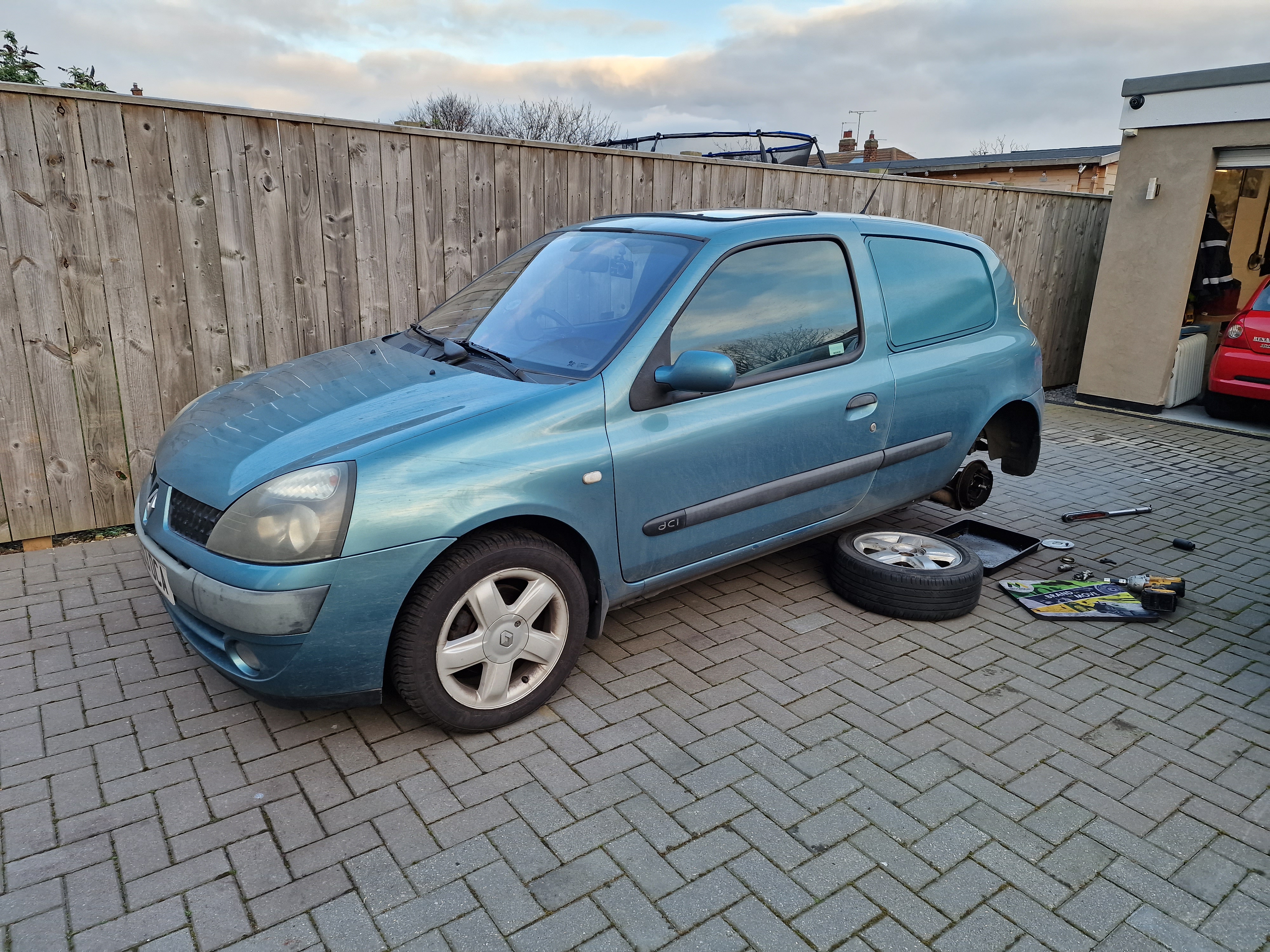

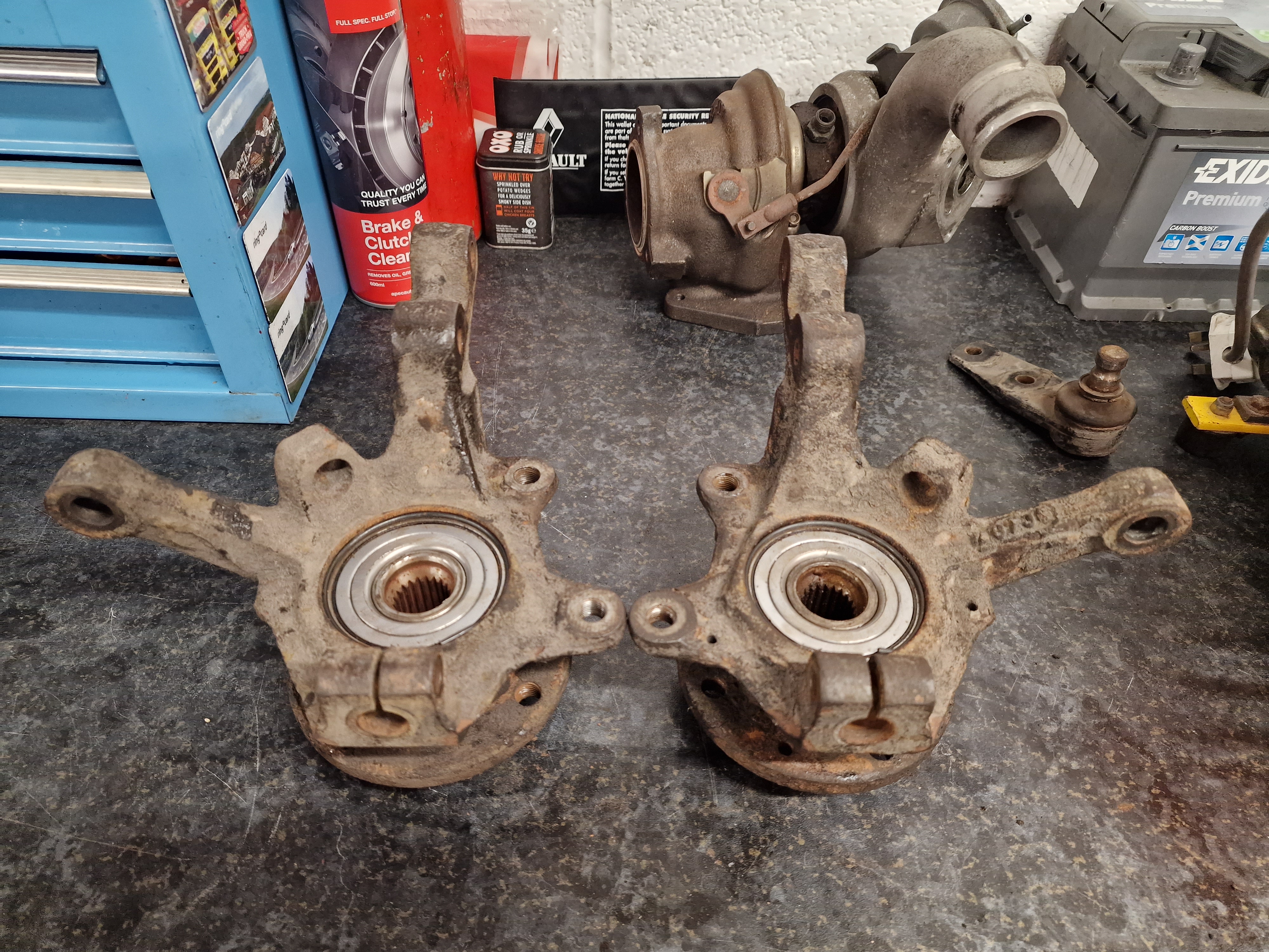

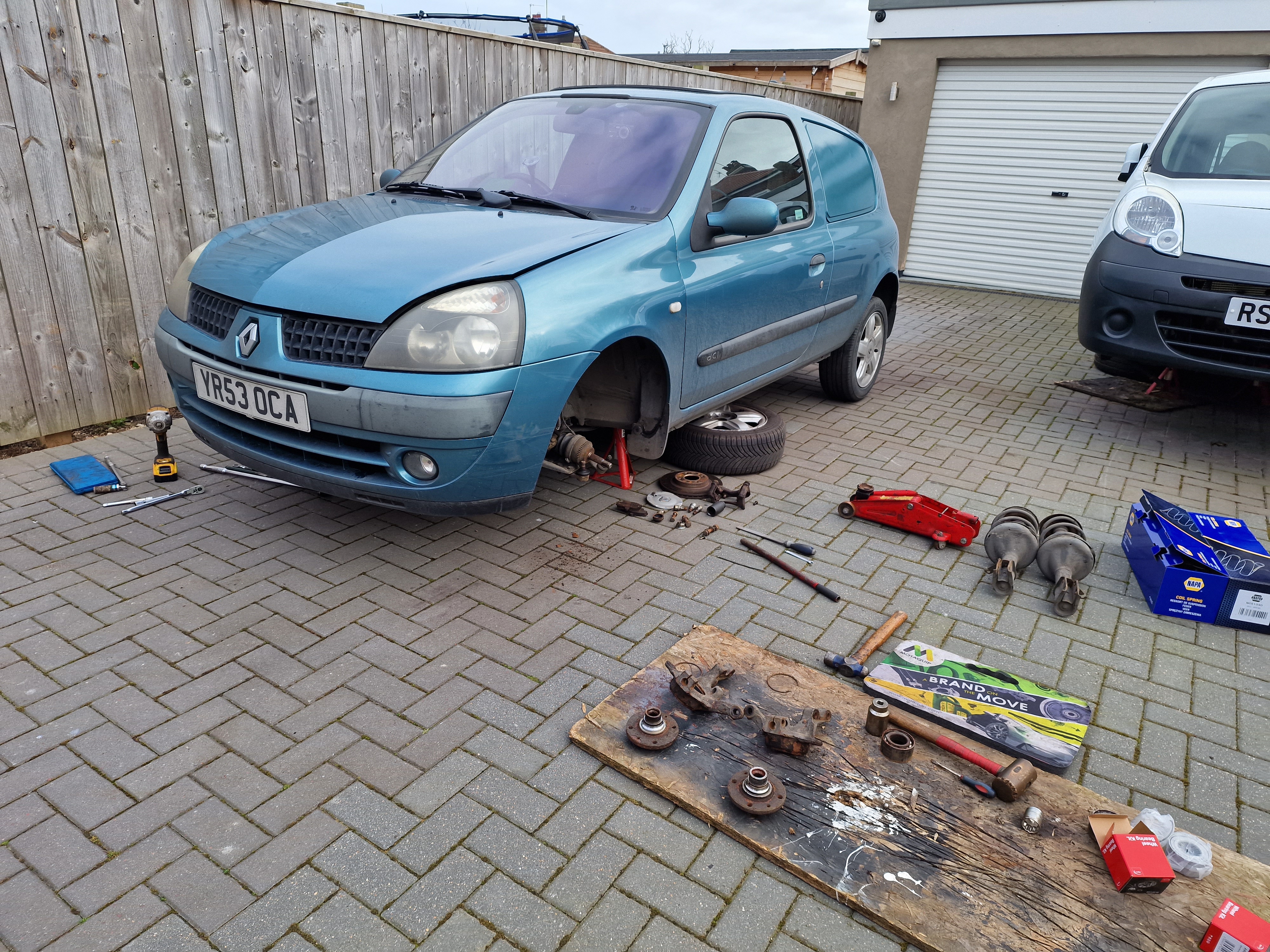

Made a start on the blue dci today.

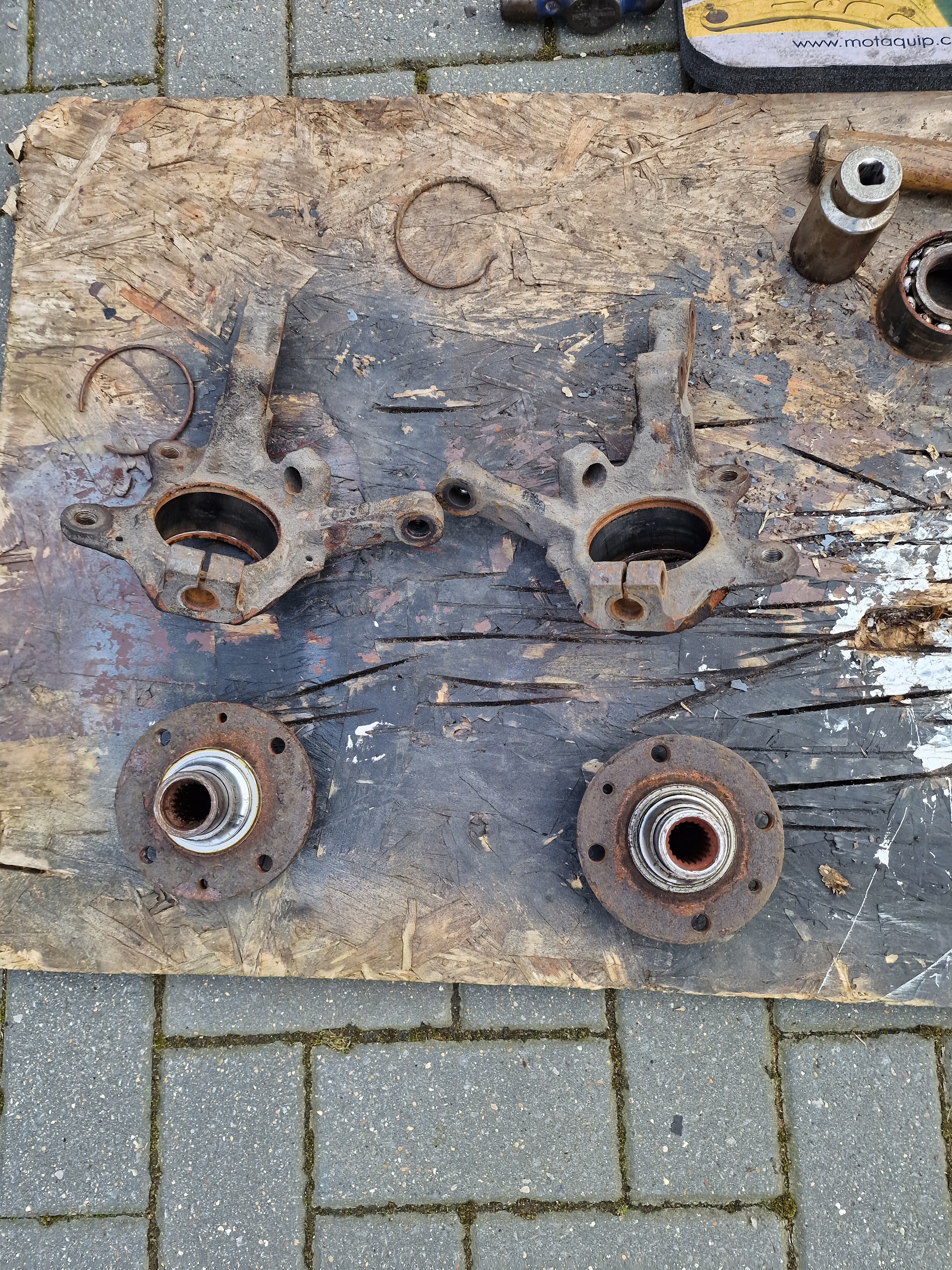

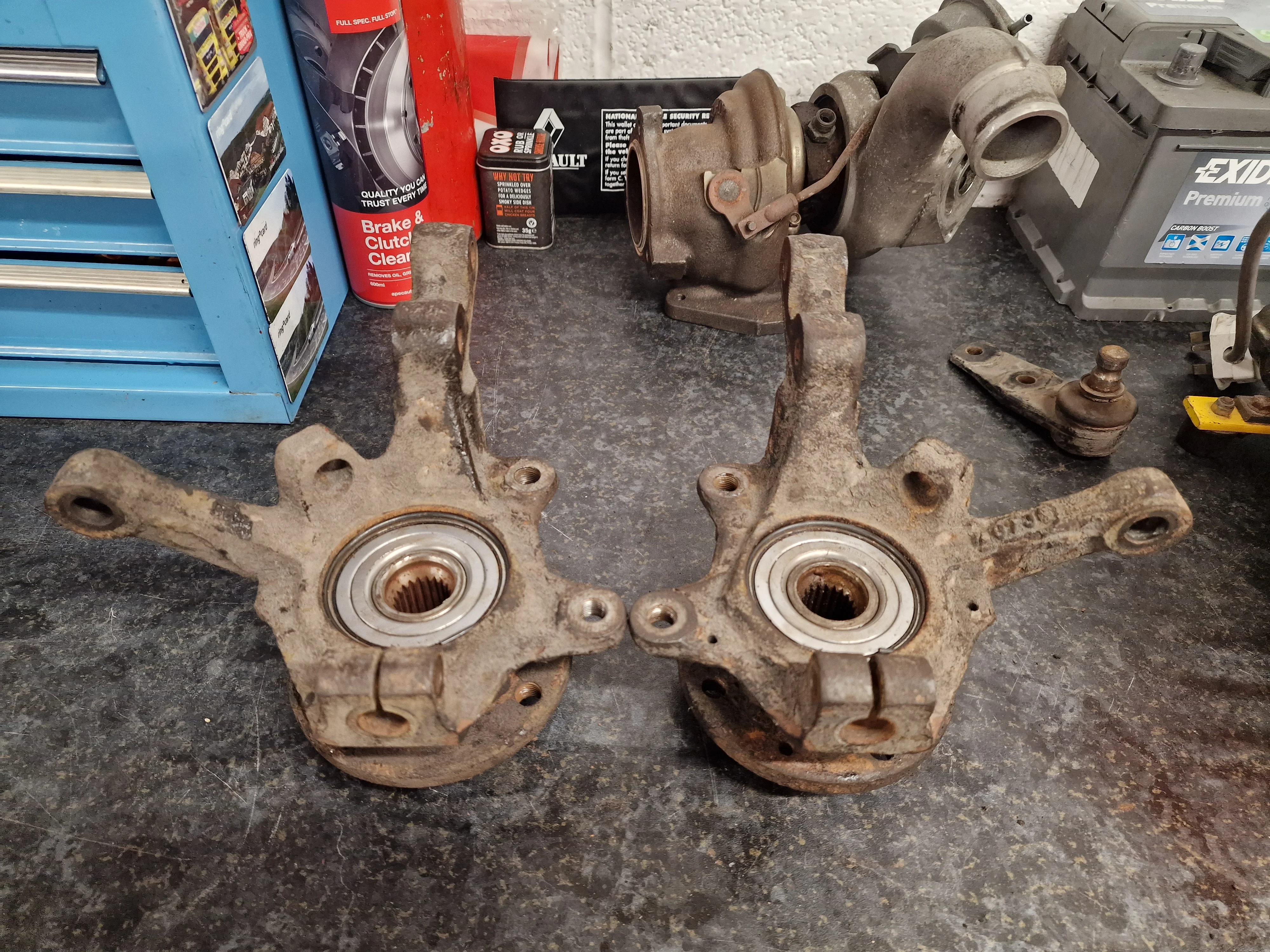

Picked parts up at 130pm, Stripped and ready in an hr. Noted o/s balljoint sloppy/play so rang local motorfactors and they had a new one in stock.
Shot down and picked it up. Pressed new wheel bearings in. Go to fit new balljoint and its an m12 one where i need m10. Back to the factors to swap that. Look for my spring compressors and realise id binned them last time as threads were looking sketchy at best.
Starts hailstoning and its 5pm at this point. Shoot down my mates unit to use his hydraulic spring compressor to fit new springs. More running about than actualy working!
Get it back together in the light tomorrow.

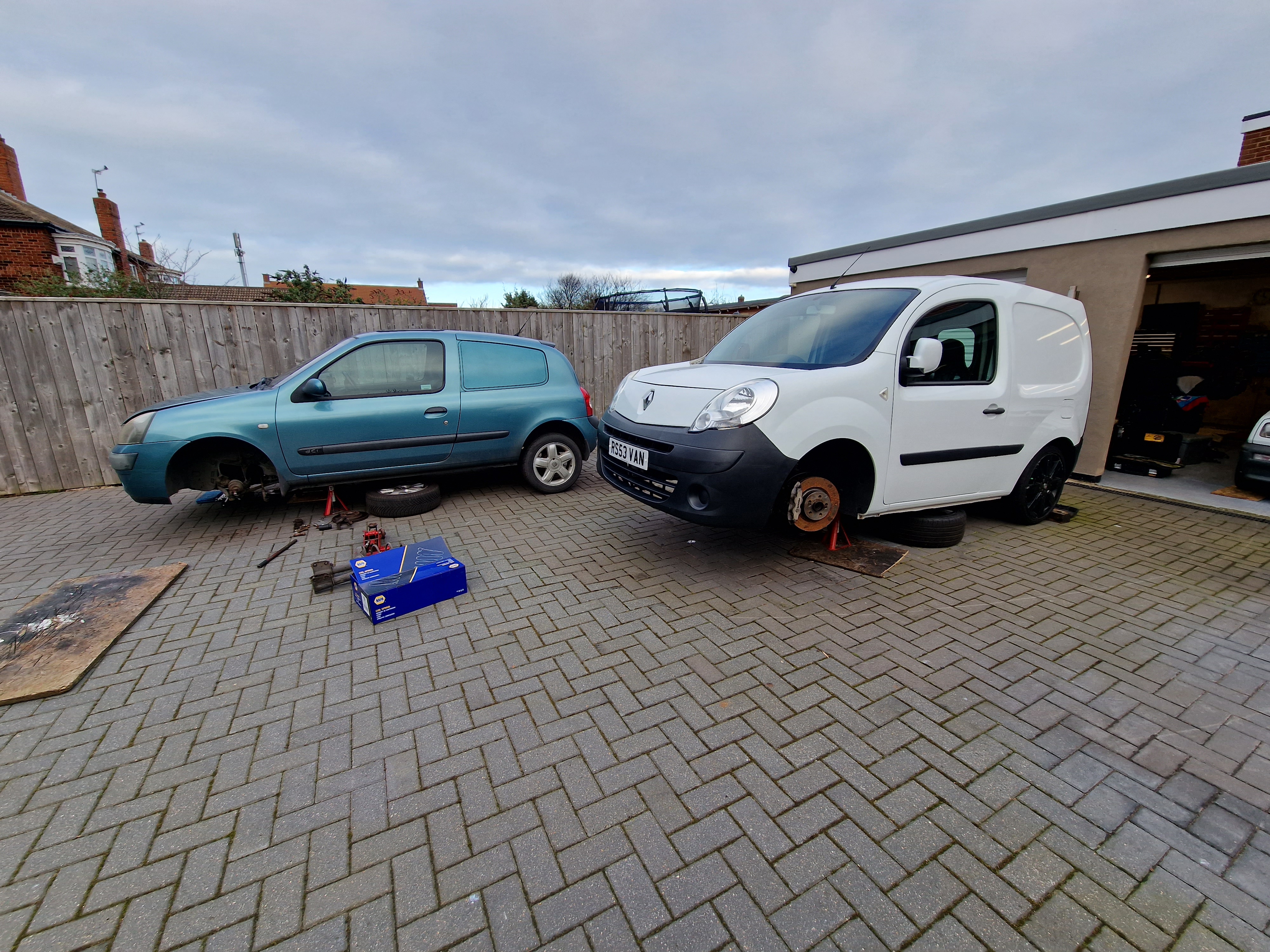

Renault life, all on axle stands

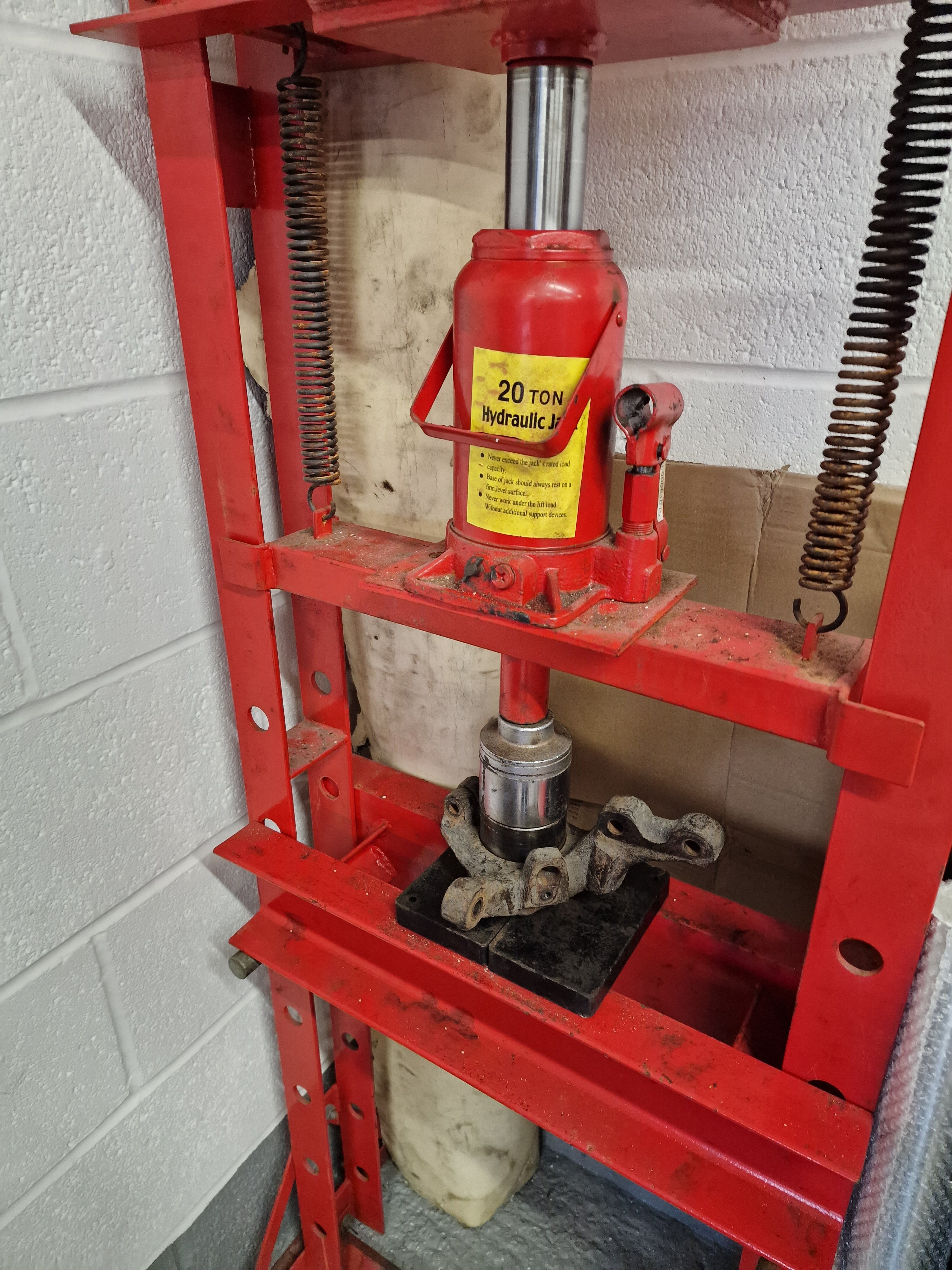

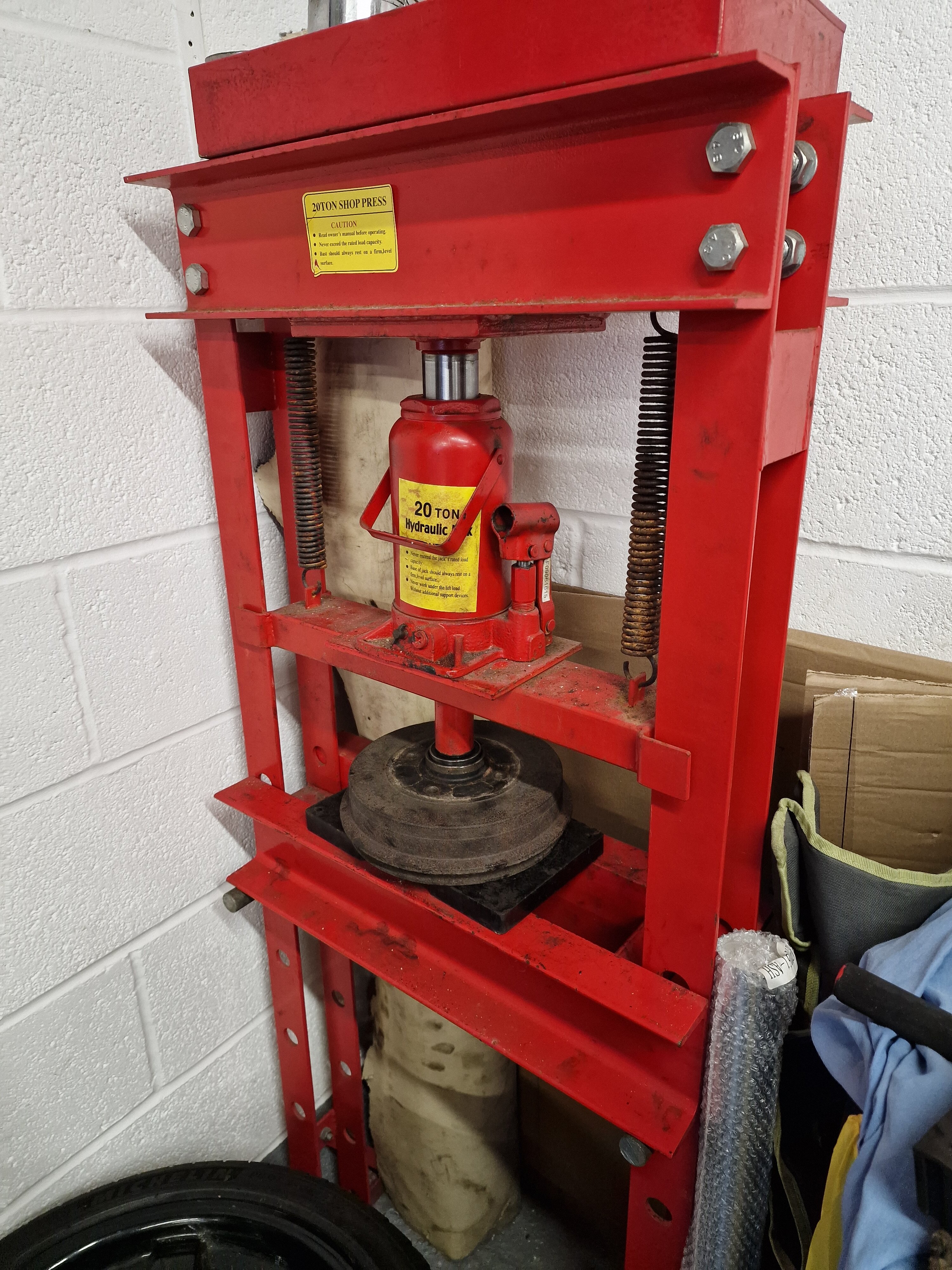

Big copper hammer gets the hubs and old bearing races out in a few blows. Grinder to cut the old bearing race on the hub until almost through and split the remainder with a chisel. Bearings were gritty so well past their best.
Cheap 20 ton press in action. Bought this in 2008 and its done a load of bearings and bushes over the years and absolutely paid for itself. Old race and large socket as mandrels.
New bearings in. Hopefully be loads quieter as the stereo had had to be turned up loud to drown out the noise recently :LOL:
On the home straight now. Would have been nice to box it off today but it is what it is.
Thanks for reading!!
Everything refitted and torqued to spec in an hr this morning before the crap weather set in.
Improvements all round, wheel bearing noise gone, steering is sharper, ride is better. Brakes are improved as serviced them whilst apart and freed off the sliders as passenger one was seized.
Done 20 miles and all good. Ill get the geo done tomorrow if all goes well, as it looks to be 20mm or so higher than before and cant be arsed running the new tyres off.

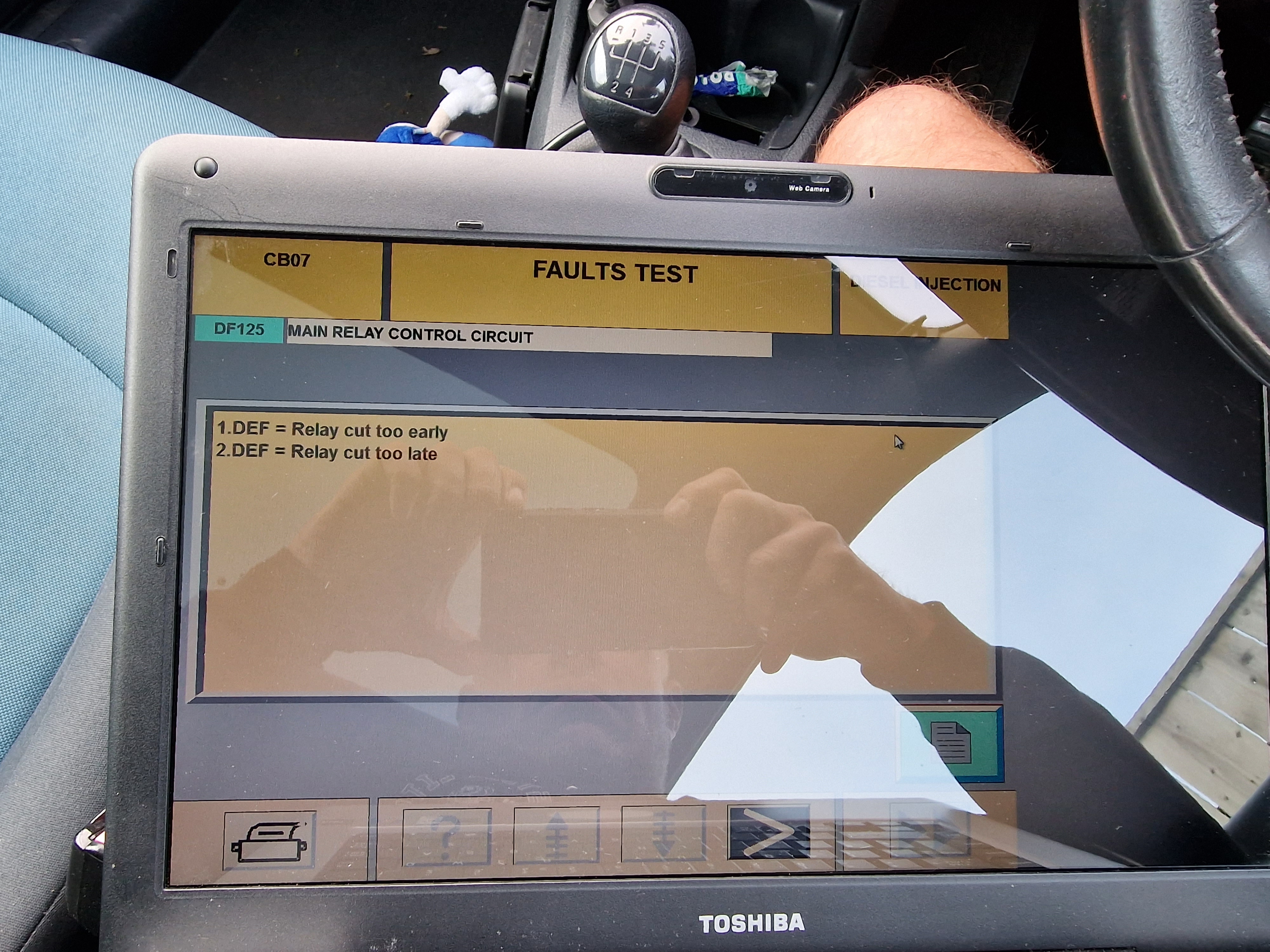

Monday update

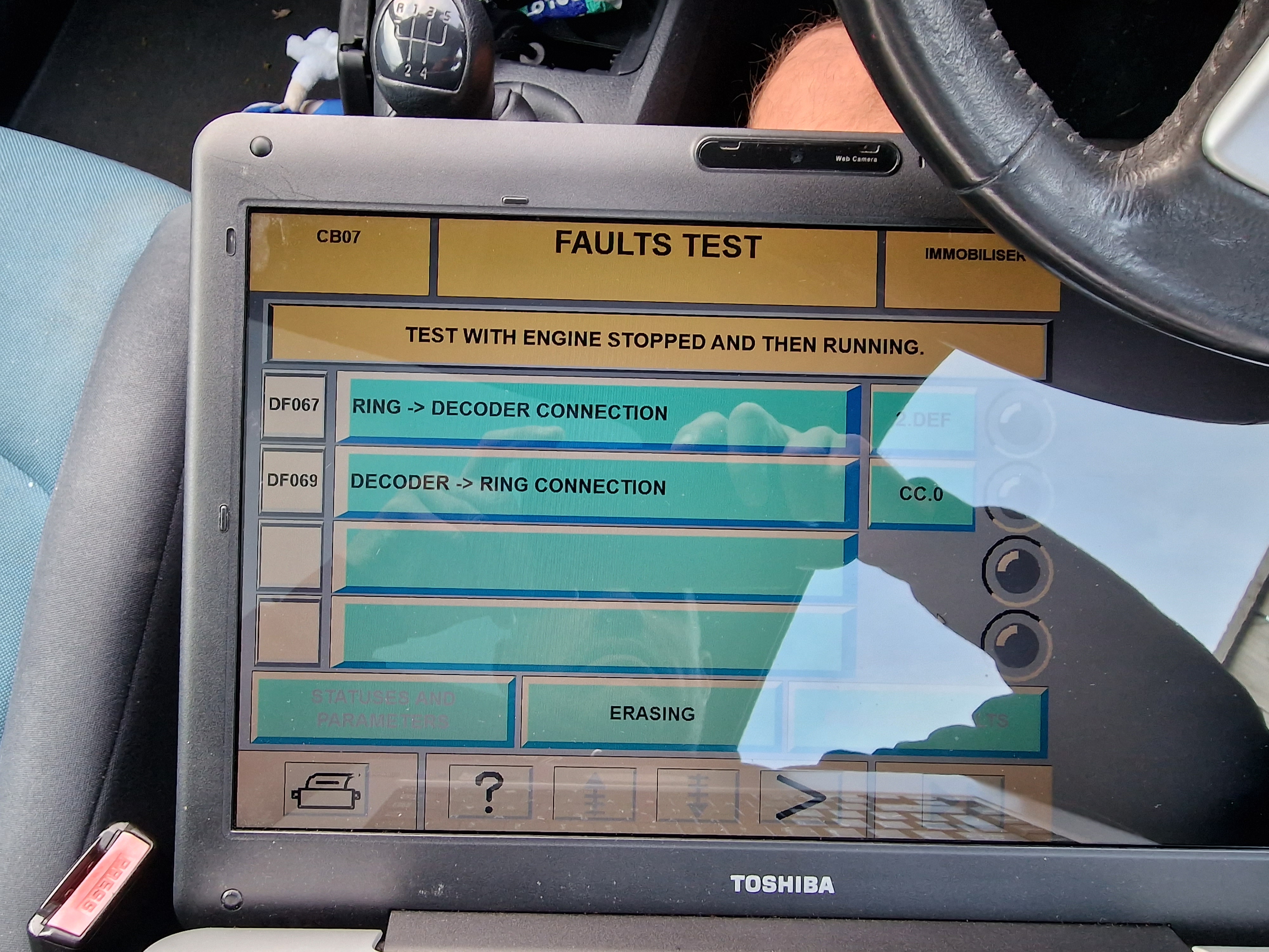

Another day another small issue. Go out on a site visit to Cramlington approx an hr away/100 mile round trip. Make it there no fuss and on way back stop at local garage to get toe set.
Pull up and turn engine off no issues. My mate shouts me to bring it in, go to start and red immob light of doom/no start. Repeat 5 mins of ign on and off and it eventually starts. Fires up and cuts straight out, and repeat a couple of times, eml is flashing. I catch it on the throttle and with a bit of diesel knock it stays running.
Get toe set, then same carry on again to get it started up and stay running. Only a mile away from the house and luckily make it back.
I thought an injector was on its last legs so get clip on to see what the f**k is going on.

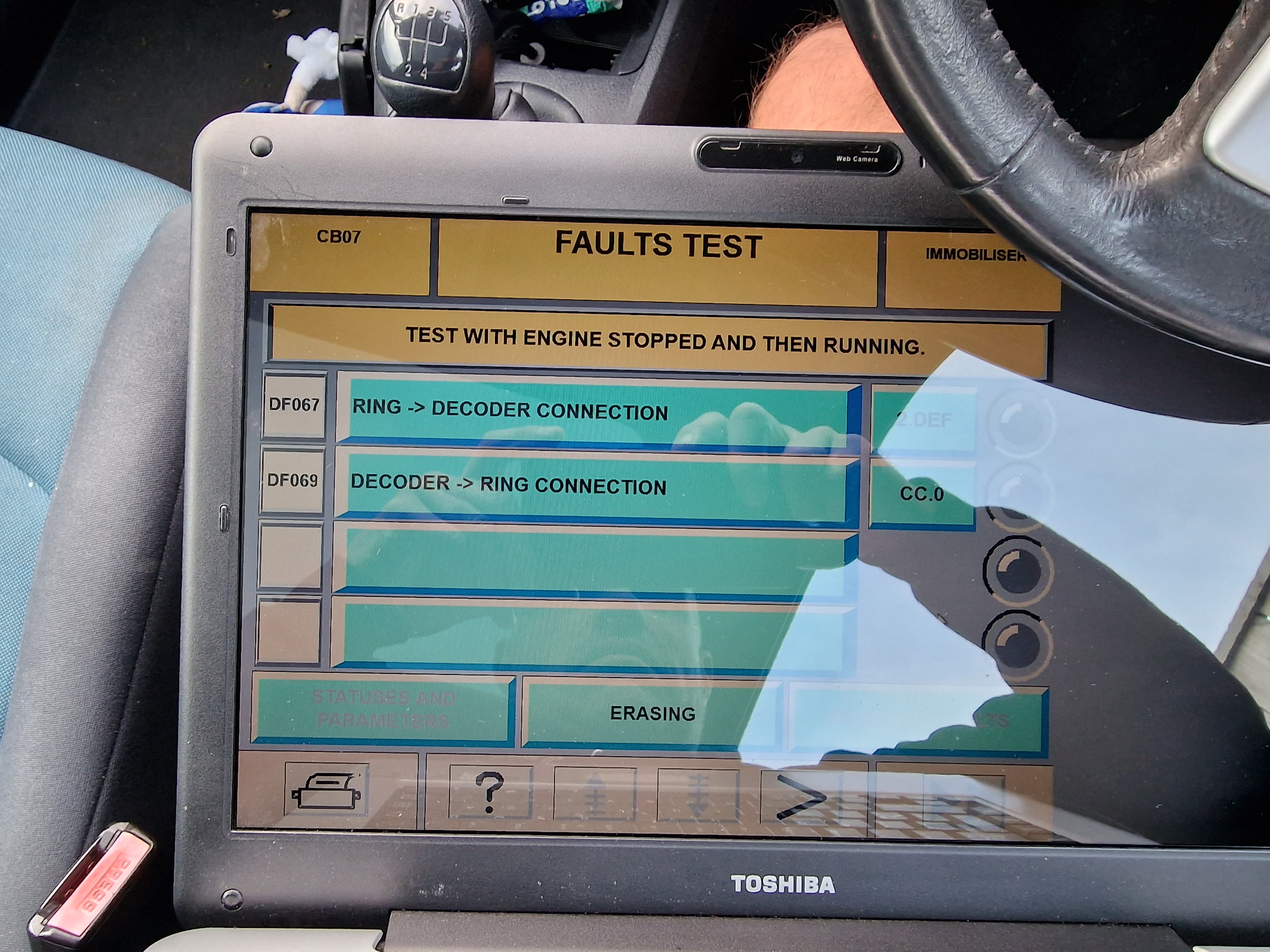

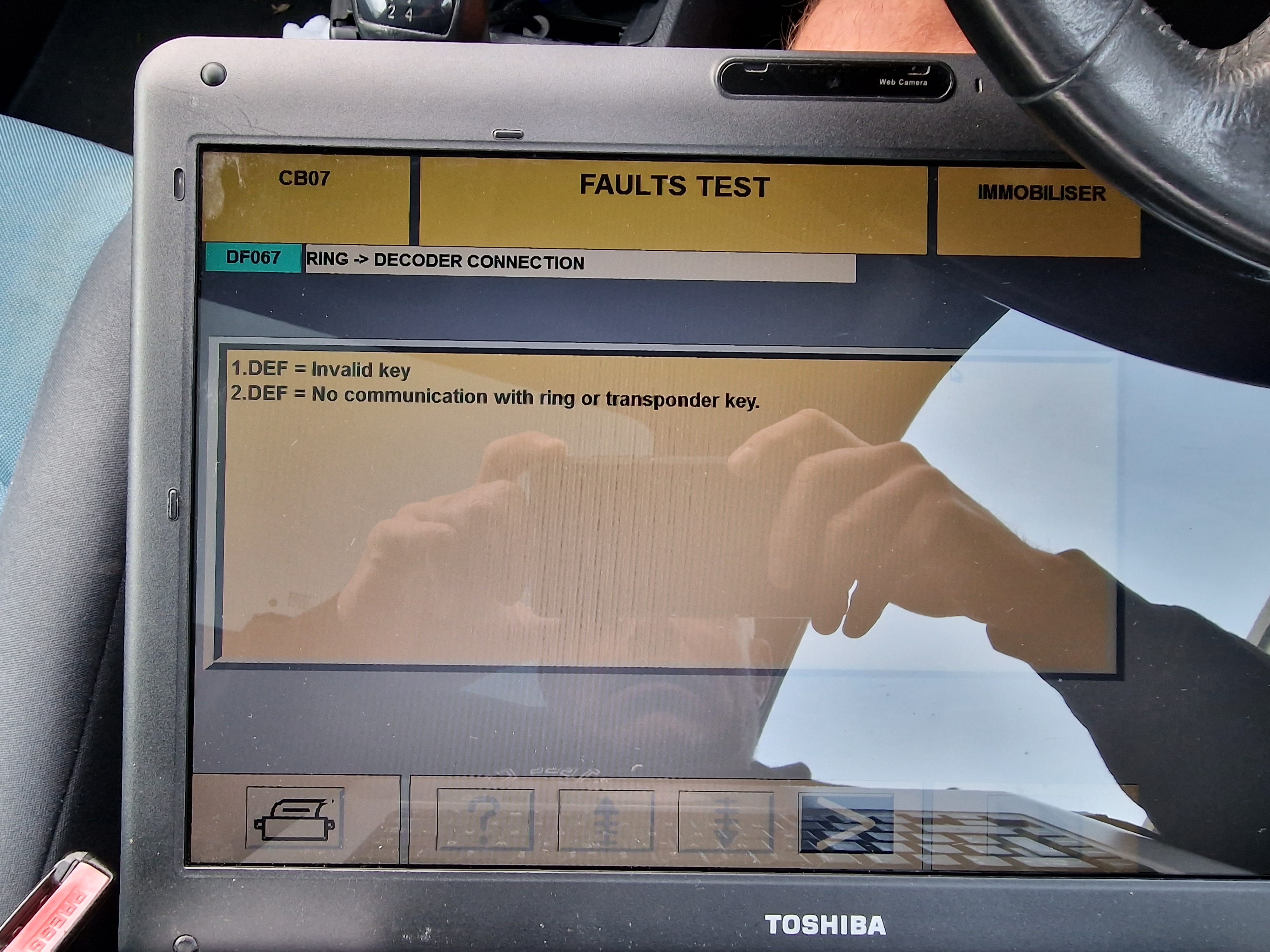

Scan immobiliser and codes stored
No communication, Strange. Clear faults and does not appear again when cycling ign as immob light is off but still conking out.

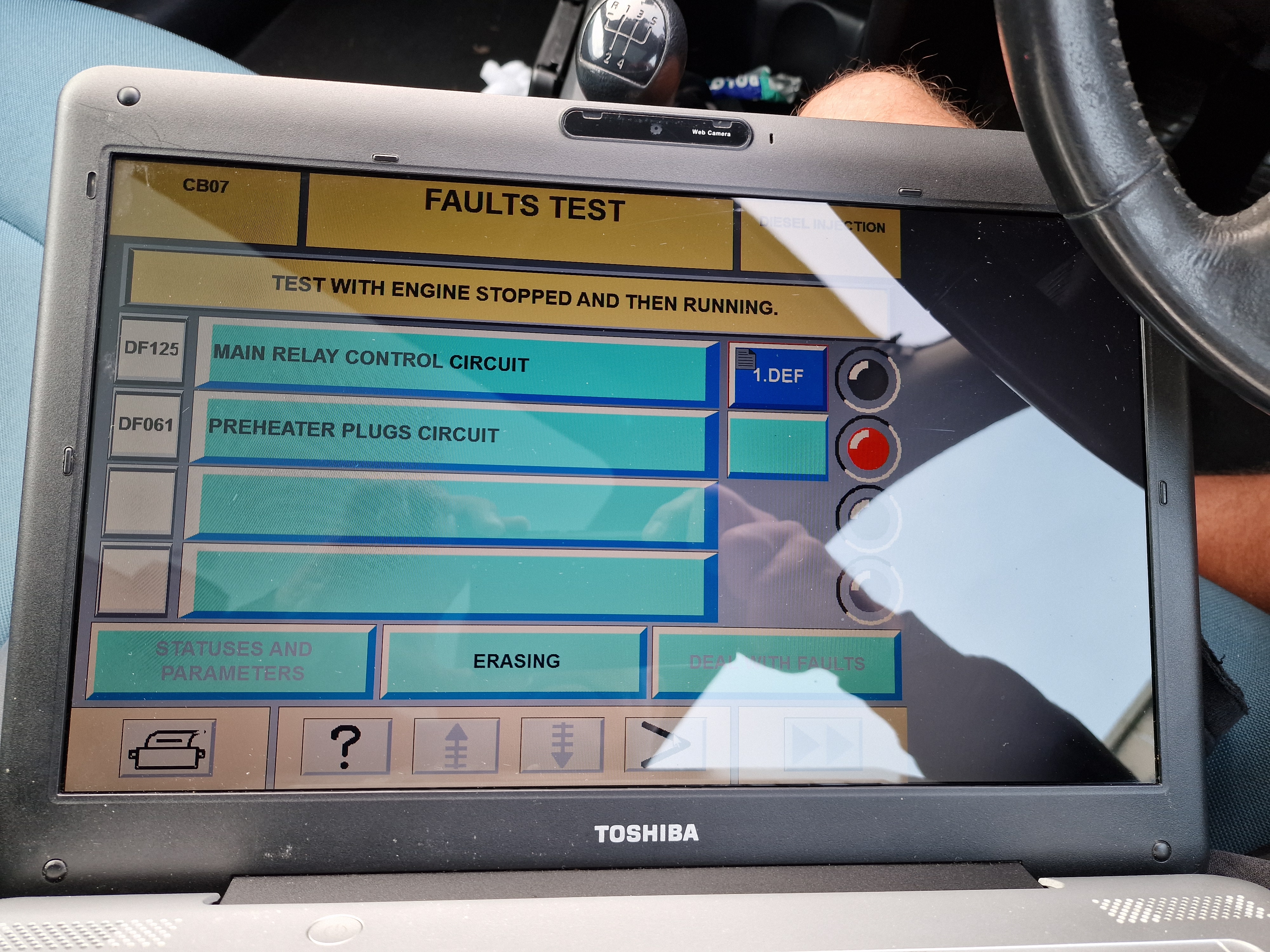

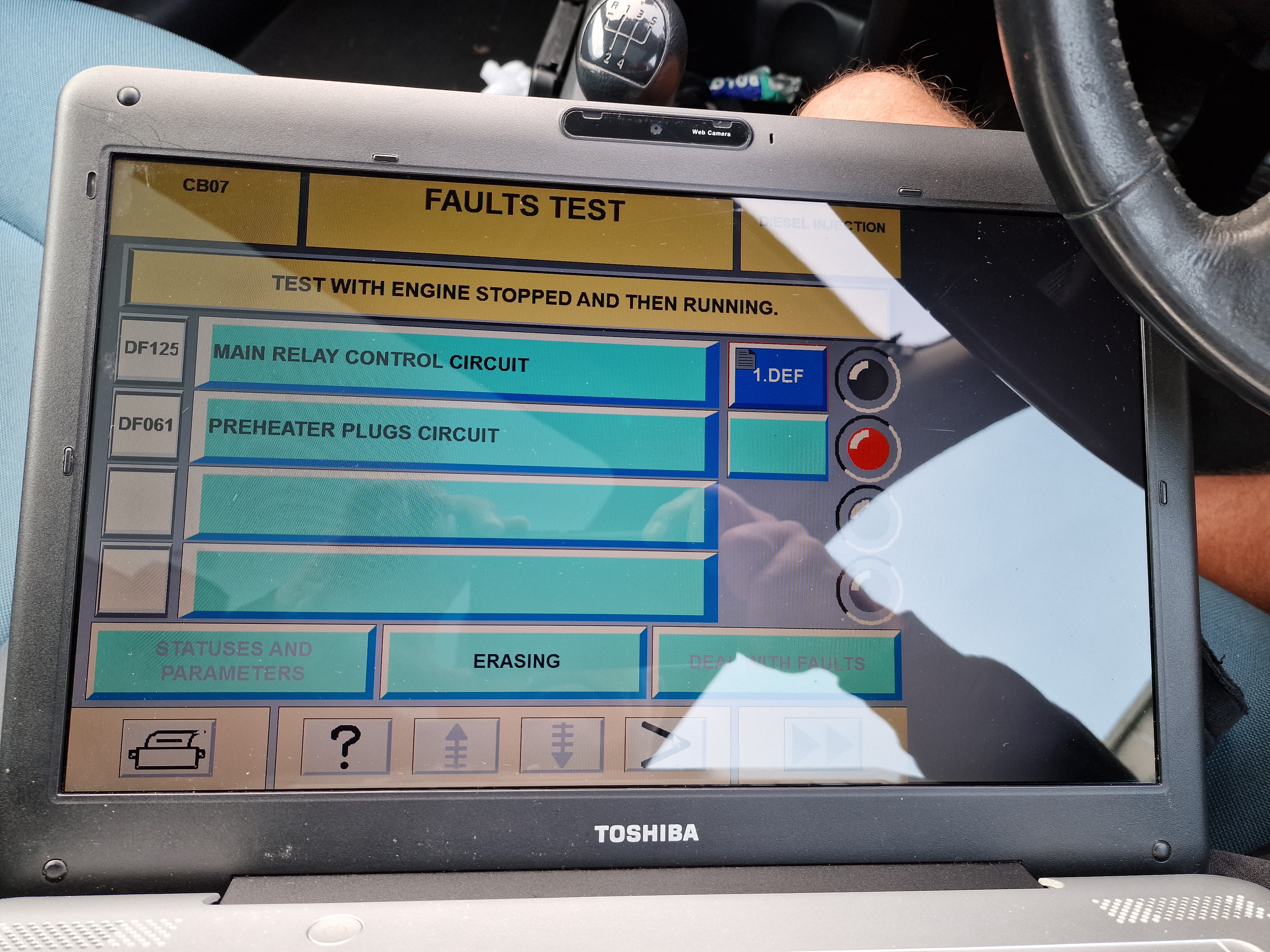

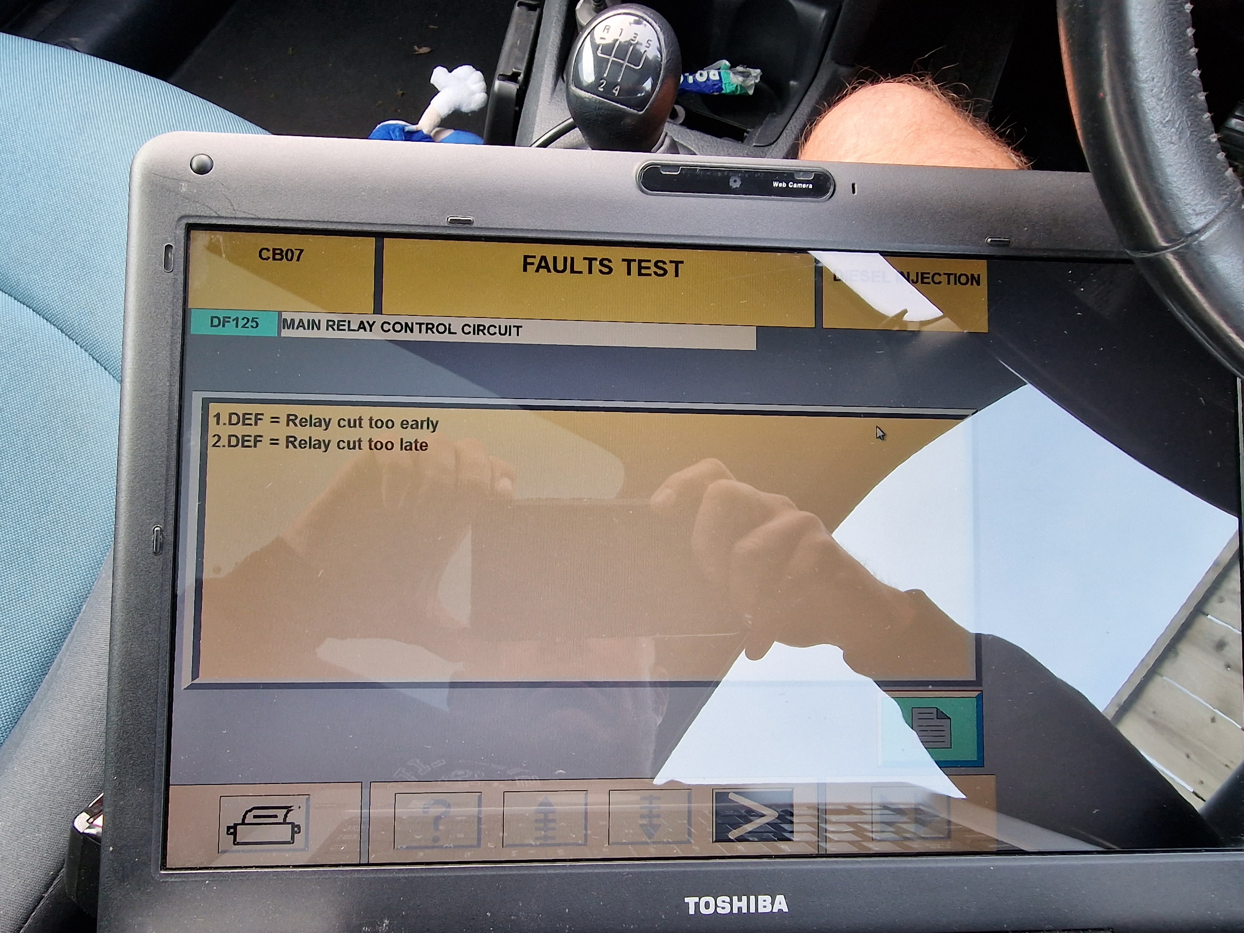

Scan engine ecu and DF125 is stored (ignore heater plugs as its been on forever)

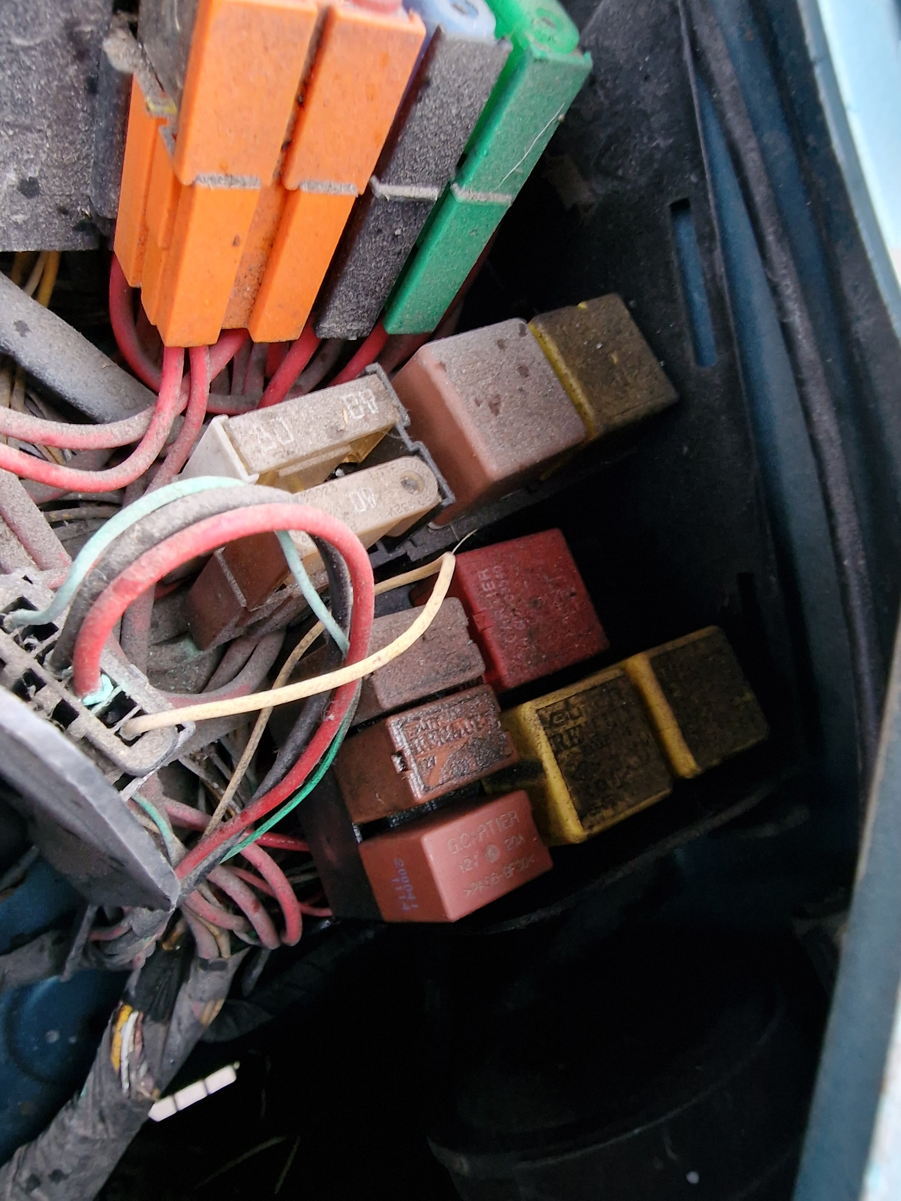

So its wiring or relay. Fire up my other laptop to find ecu/immob relay. Take it out and no corrosion suprisingly so bosh a spare relay in
Note clean relay thats replaced the old one. Fires straight up no issues and fault gone, repeat it a couple of times to confirm. 20 min fix.
Done 20mile round trip to gym and all good again.
In situations like this you would be knackered without clip or similar good diagnostics! Id bet 90% of people would say injector in this instance.

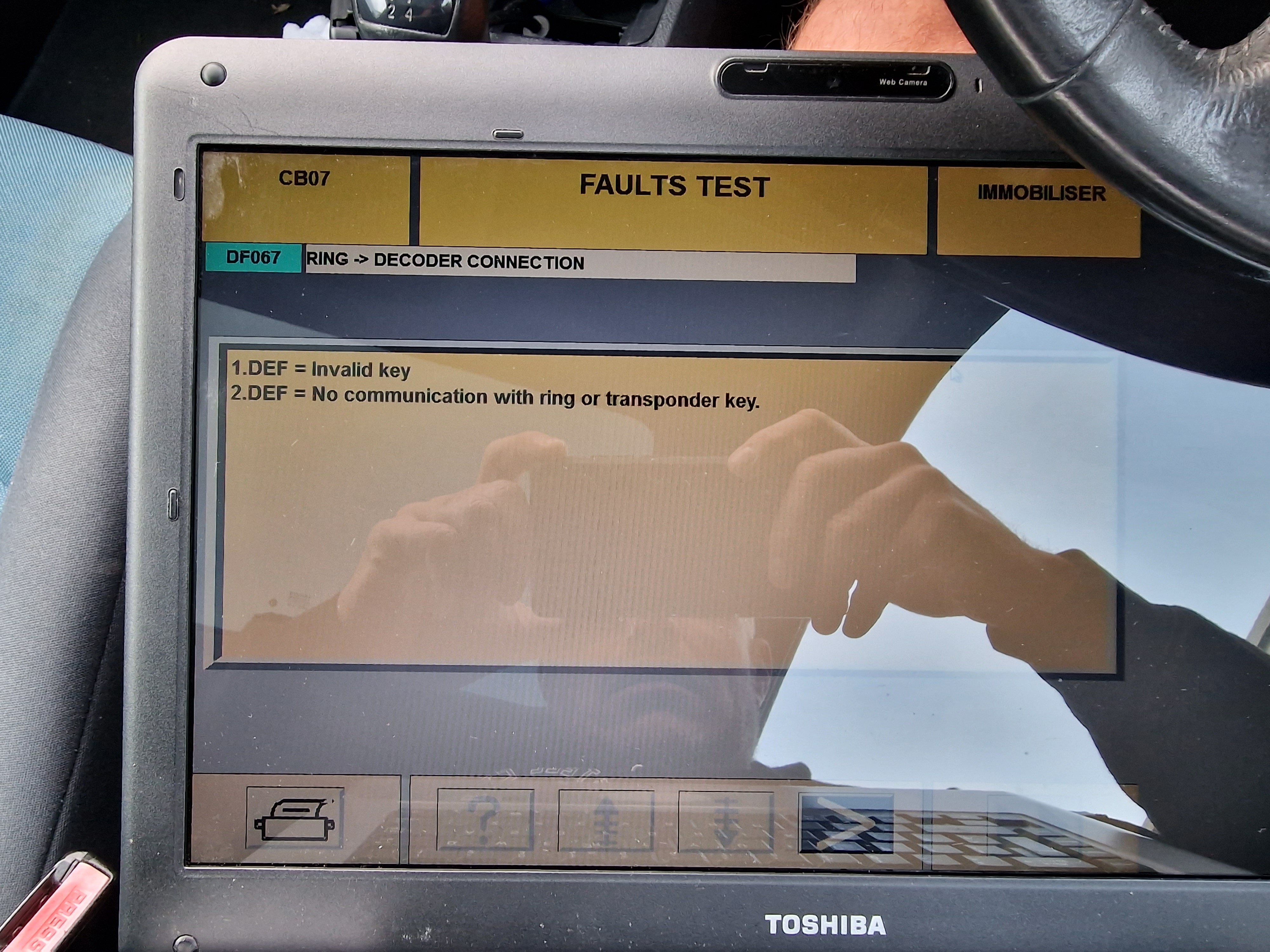

Monday update
Scan immobiliser and codes storedView attachment 1633449View attachment 1633450
Scan engine ecu and DF125 is stored (ignore heater plugs as its been on forever)View attachment 1633451
So its wiring or relay. Fire up my other laptop to find ecu/immob relay. Take it out and no corrosion suprisingly so bosh a spare relay inView attachment 1633453
Manchester and back tomorrow lets keep fingers crossed nothing else breaks.

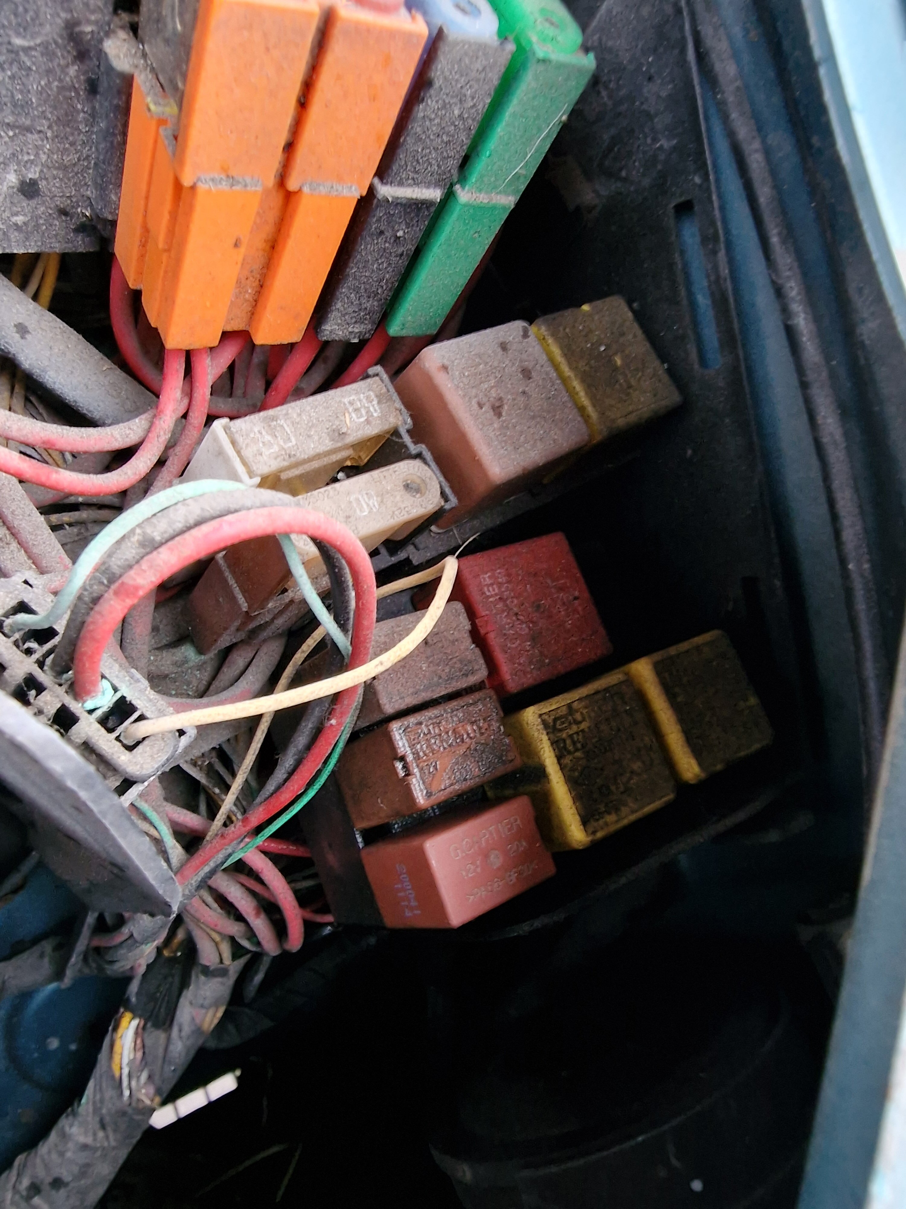

I feel like that post should be made a sticky somewhere. The amount of people who spend forever pissing in the wind when that red light comes on is phenomenal. Top work 👍
Ive fixed a few immob red light of doom and its always related to the underbonnet fusebox area. Nice easy one this one luckily.
Interestingly i tried the obd scanner on clip today. No faults present apparently, id already went into the ecus and found the info logged so knew faults were stored. Wonder if obd scanner on clip is the same as generic?
Probably similar to a generic scanner yeah, obd2 is just the basic protocol which won't look at all the parameters Clip can.

I’m well jealous of the press in the garage. I’d love that
When i first bought it i was unsure whether it was worth it for a one off job, but over the years its absolutely earned its money. Must have done at least 10 sets of bearings and loads of bushes and other random jobs. Still s**t myself every time i use it if a bearing case moves with a bang like it did on one today :LOL:

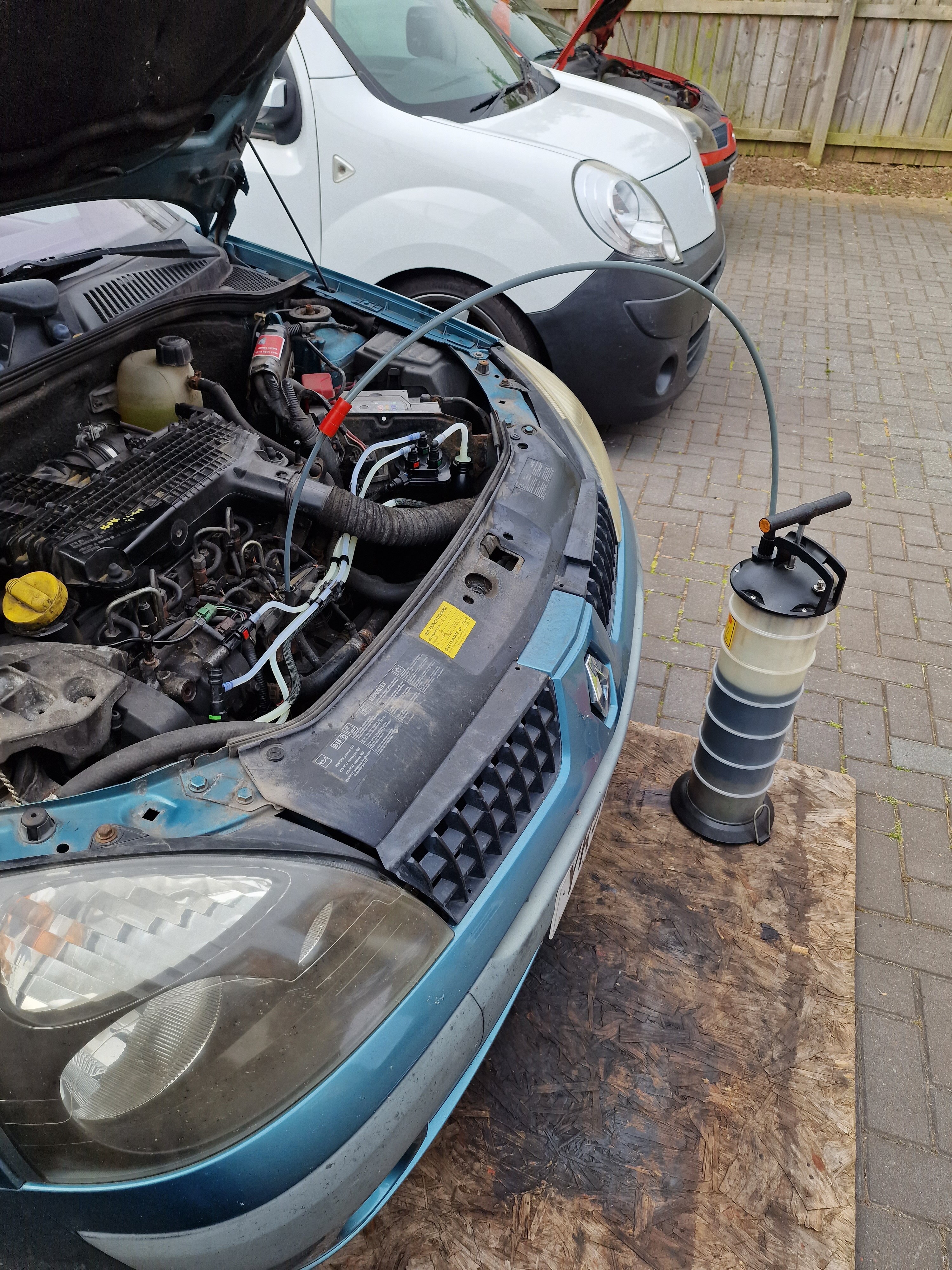

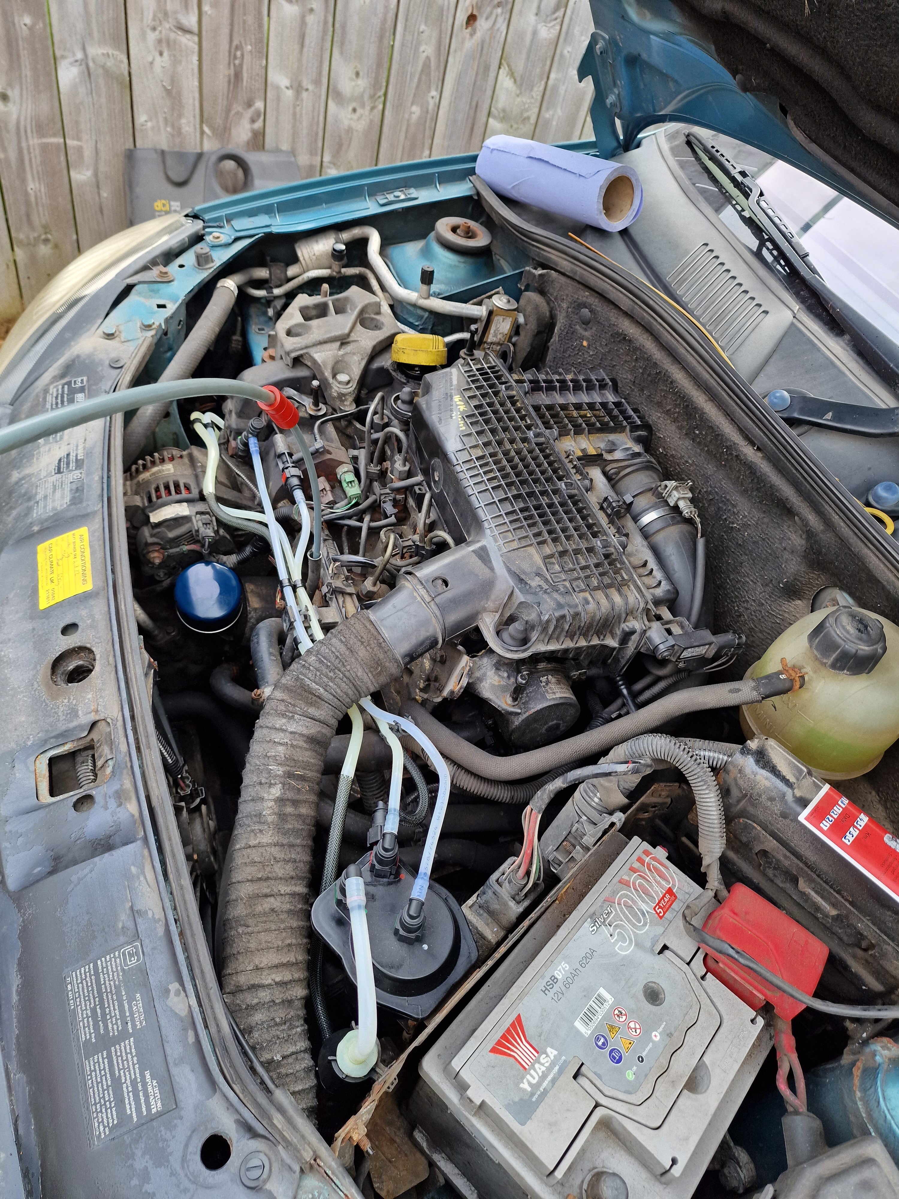

Ive also had a small issue with it. Basically every day it will start straight away from cold. But - if you start it up, and turn off after a minute or so and leave it 30 mins or more, it will take a long crank to fire it. If you drive it for a few miles after first start its good as gold though.
Its had this issue on and off since i bought it, and have always suspected an airleak at one of the push fittings on the diesel filter. Loads of air in the diesel pipes.
Bought all the diesel pipes for under the bonnet from autodoc, gates brand. Quality seems OK. Fitted this morning with new delphi filter, and noticeably less air in the clear pipes, starts even faster. Id read that the diesel primer also has a non return valve in which can fail, no idea if true or not but its changed anyway.
Will see where its at after a week or so, if not an injector may be getting there. Again ill keep driving until it becomes an issue, got a can of easi start in the back just incase :LOL:
Also changed oil and filter whilst at it. Oil consumption half a ltr over 10k which is spot on. Apart from getting diesel all over my arms the pipes were straightforward enough to fit.

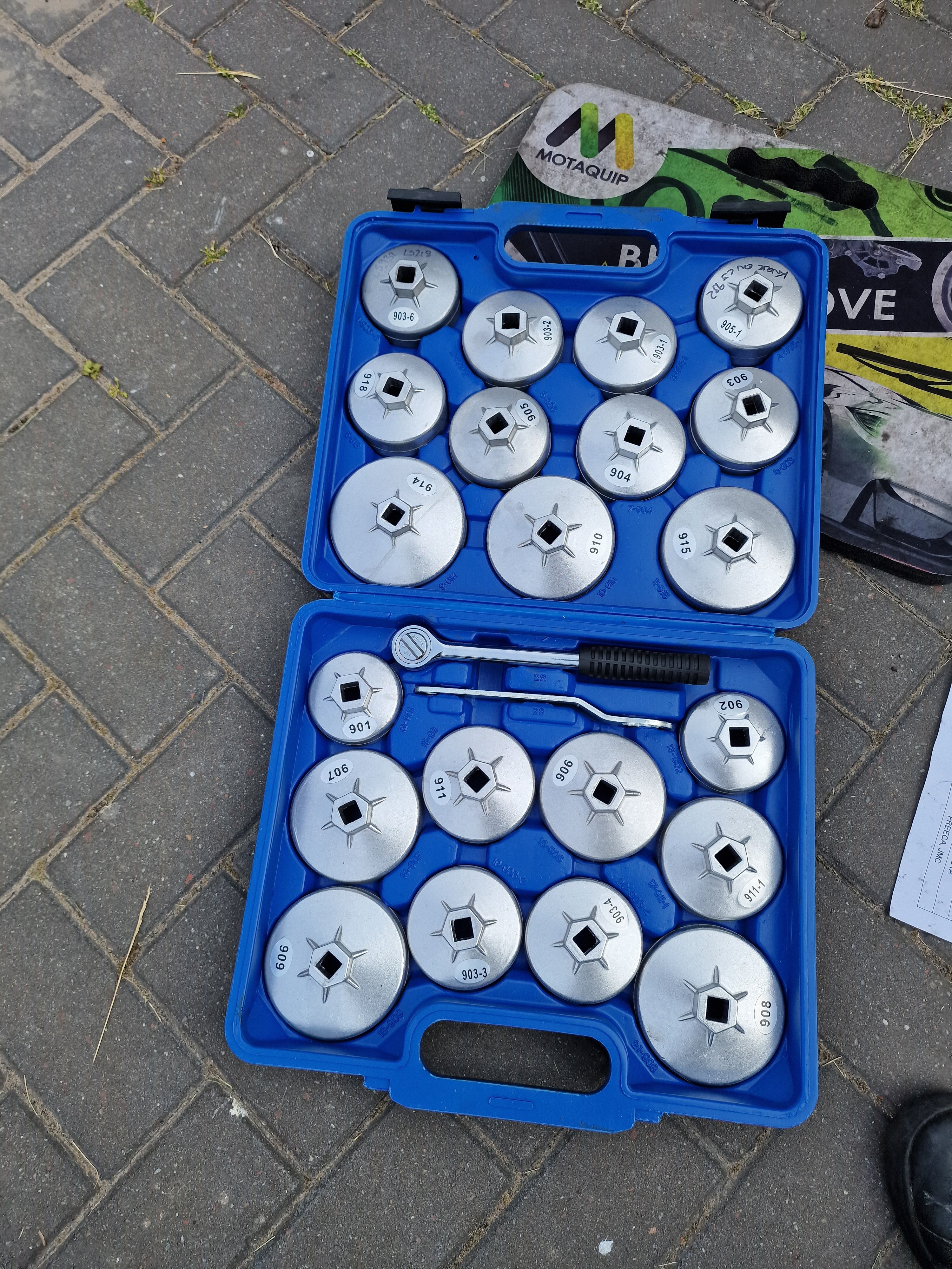

These are also spot on for dci filter removal, as the filters go tight as feck for some reason. Cheap too.

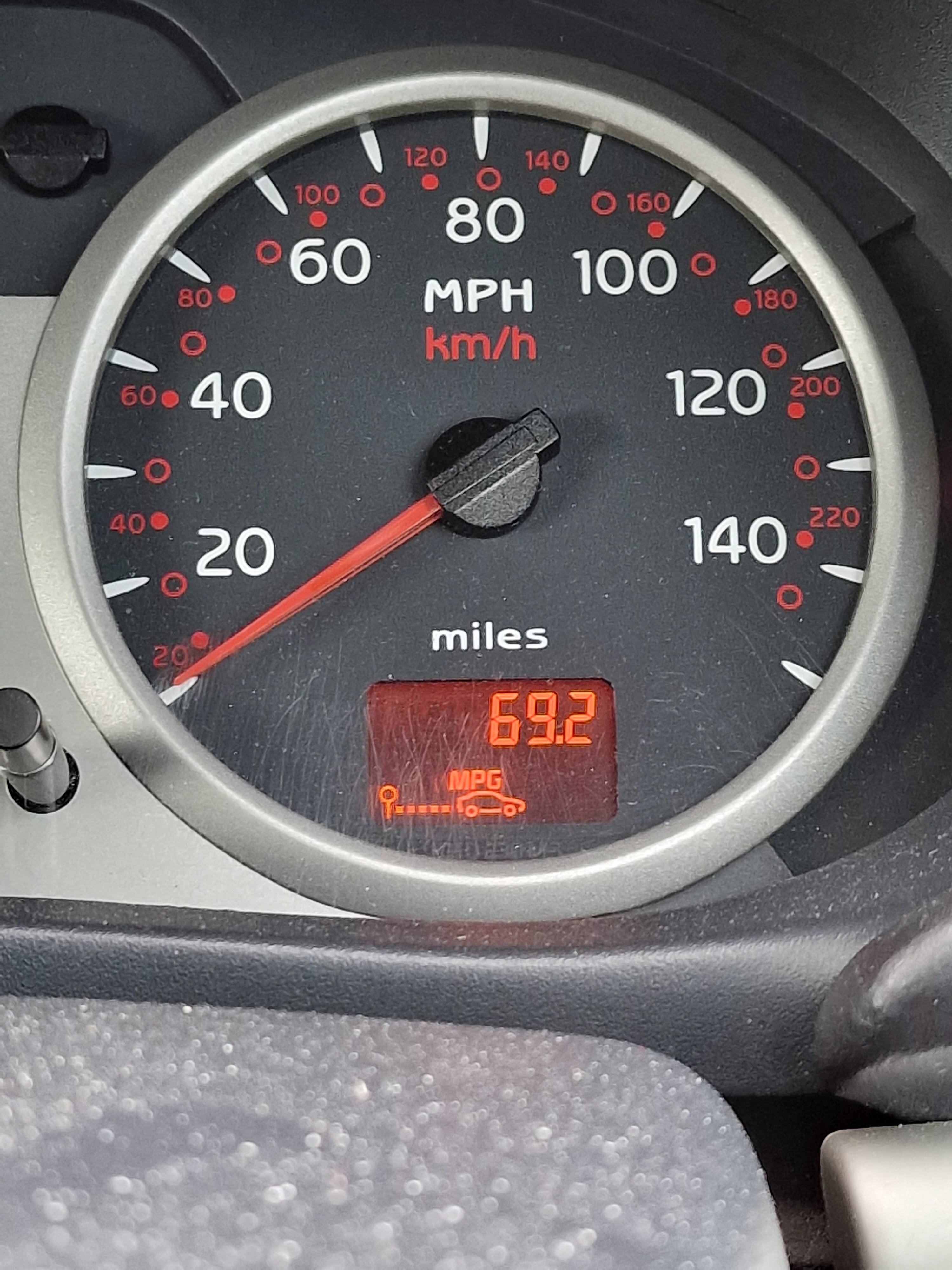

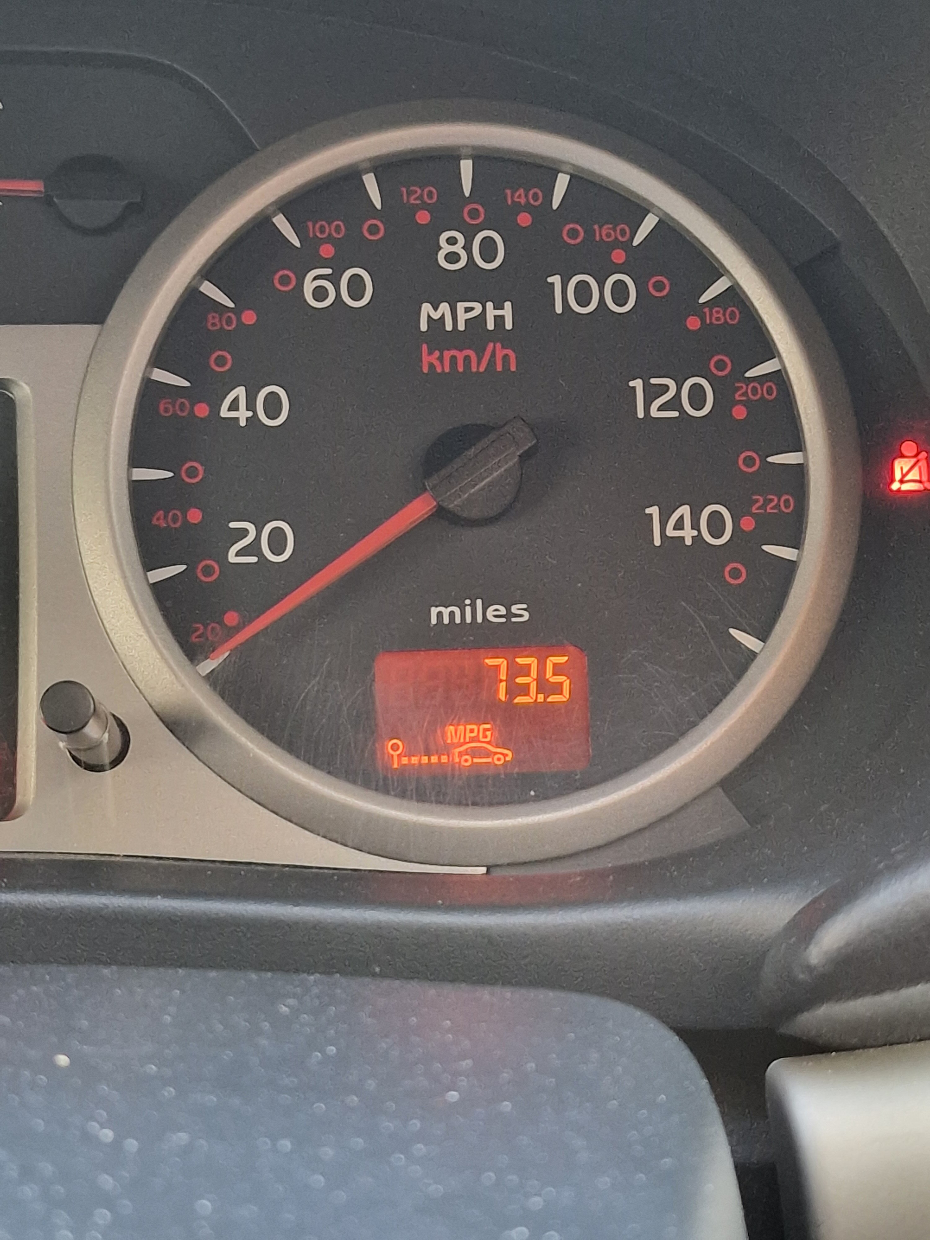

Also blue dci average mpg over 10k miled is 69.2, awesome for an old diesel. Thats mixed normal driving however been sticking to 60mph on motorway in work time, why rush.

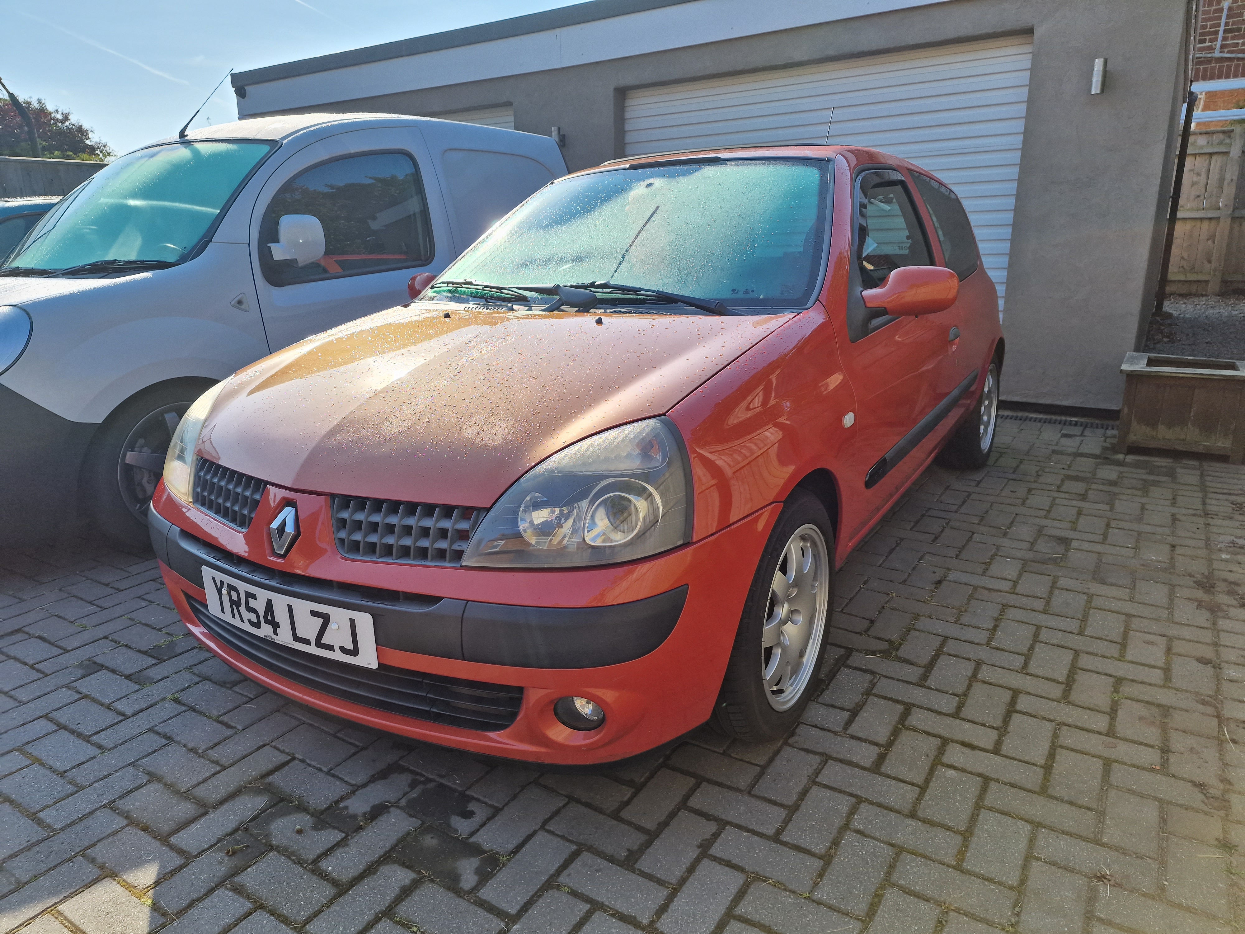

Orange dci plowing on as usual. Still not done belts yet must get on it as soon as i get back from hols.

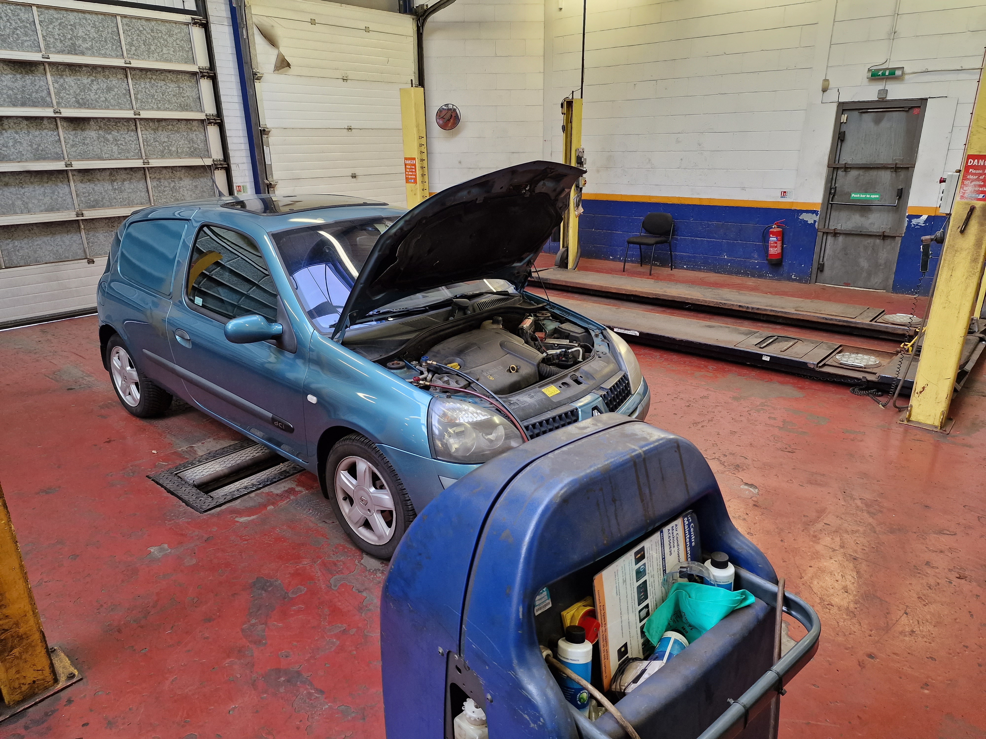

Aircon was still nice and cold but felt like it sometimes took a little longer to cool. Its been 3 years since recomissioning the ac system and it had only leaked a little bit of gas hardly nothing and still showing 4.5bar pressure iirc. Anyway had it topped off again and its ice cold straight away now.

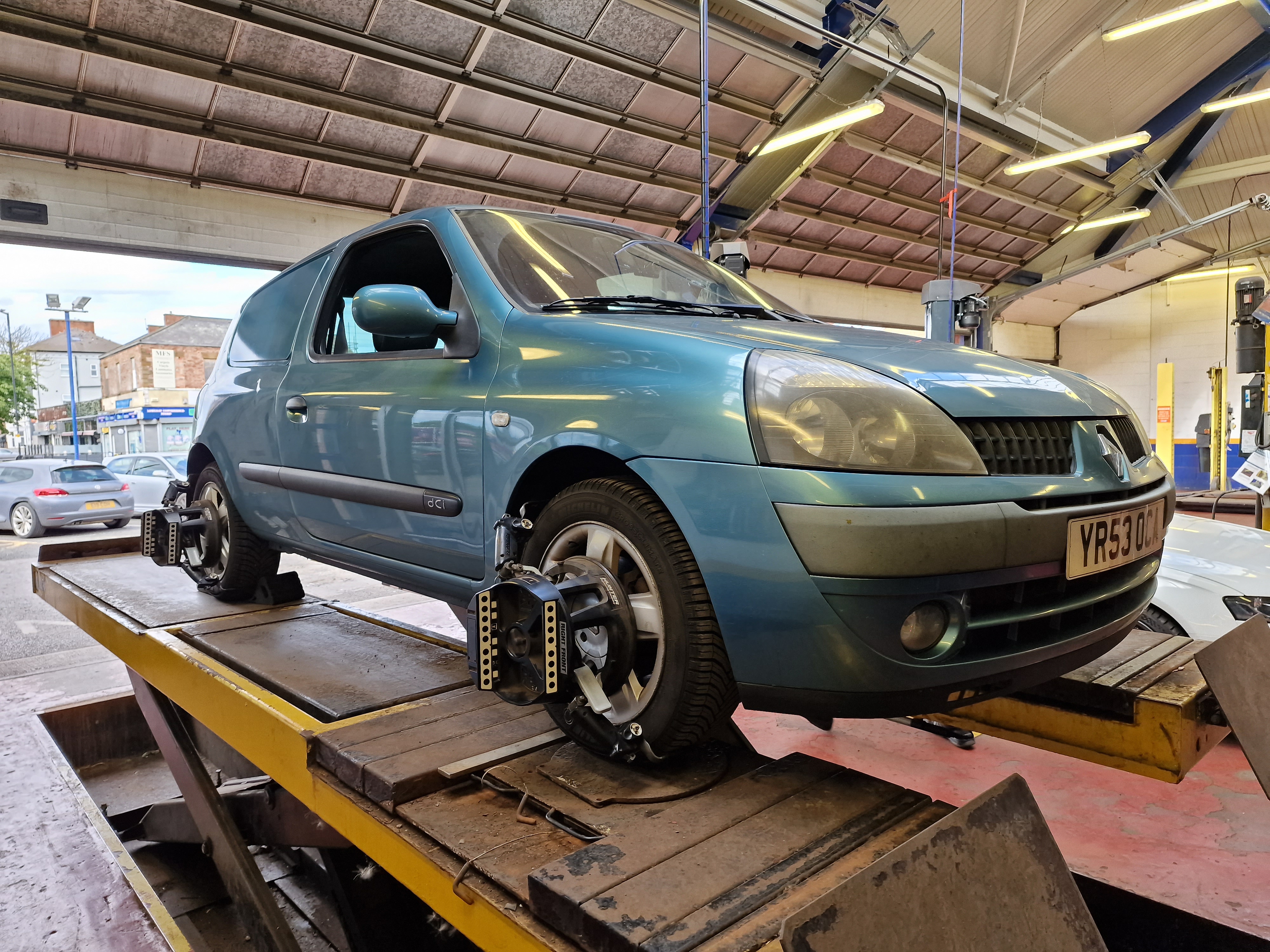

Straight down for geo as steering wheel was off. Steering wheel is arrow straight now and drives spot on again.

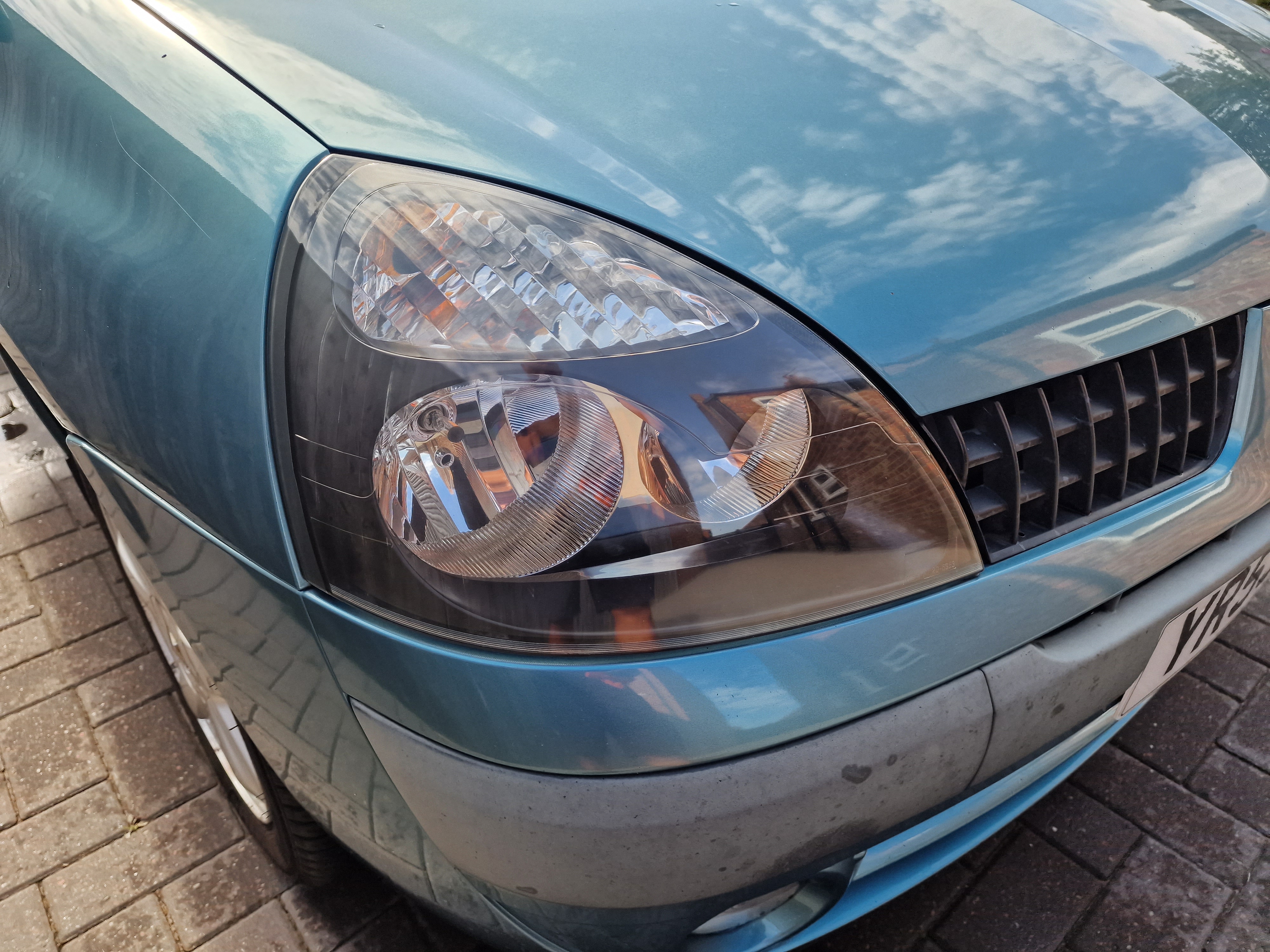

Updates.
Blue dci up to 174'500 miles so done 3k in 7 ish weeks. Been all over with work, it just cruises along with no complaints..ac working beaut in the heat, 69-70mpg all the time normal driving.

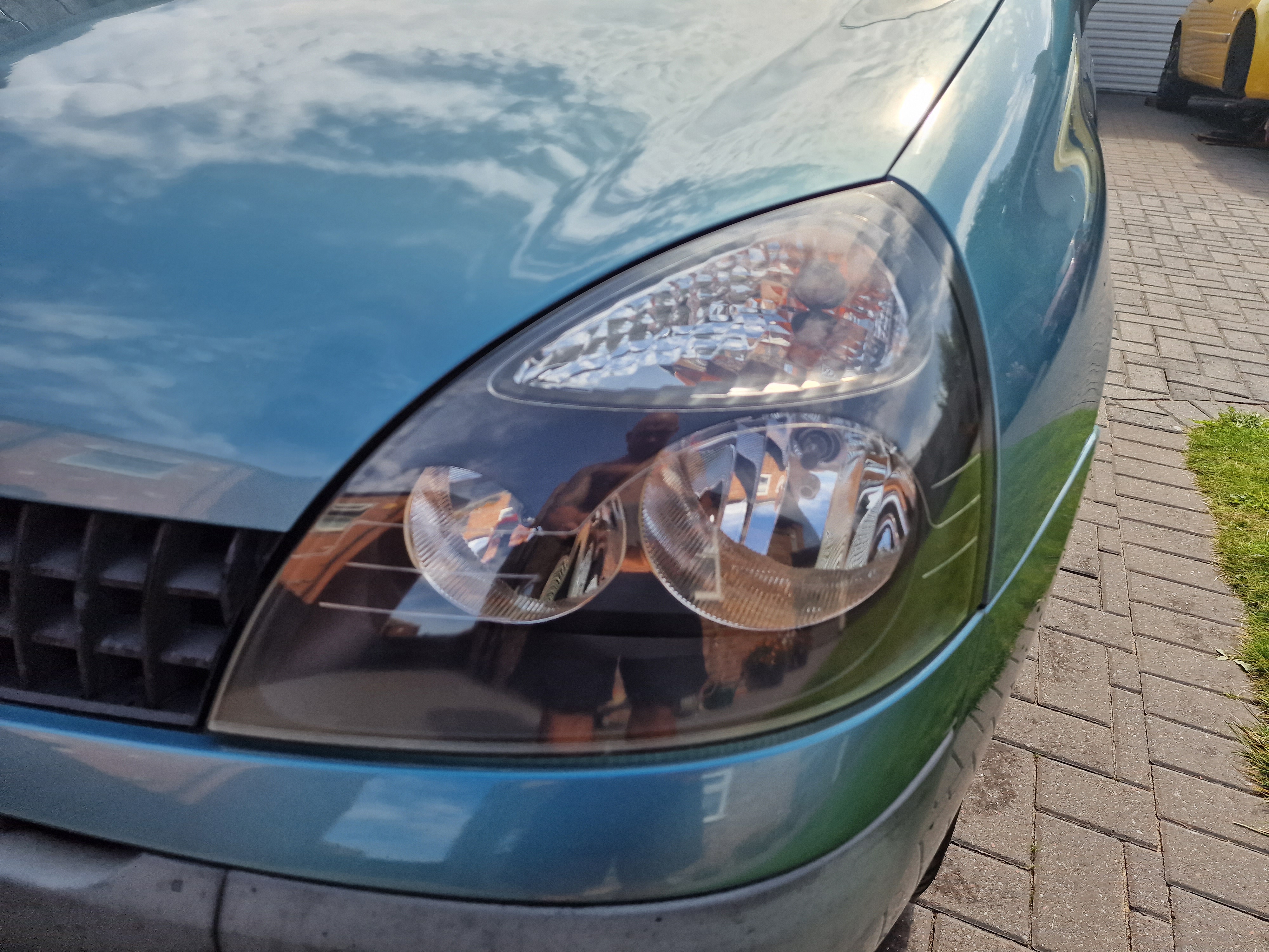

Its looking well used/mucky and headlamps faded so yearly polish time, its dark season coming up so be nice if the headlamps work a little bit better with clear lenses.
Before - piss yellow headlamps.
Started by wet sanding first with 1500 wet and dry, followed by 2000 wet and dry. Followed by da polish, cutting compound on medium cut pad then final pass with finishing compound and finishing pad. Took about 20 mins overall to do both and decent result. Sealed with left over gtechniq wheel armour ceramic coating, see how long it lasts.
Done.
Also washed it as not been cleaned since June and front wheels were black with brake dust.
Still passes the 10 foot test. Mot next Friday, should be good to go.
