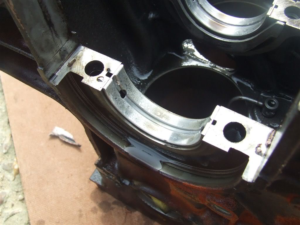

think I found the problem though... cylinder number 2.... has no shell bearings!!

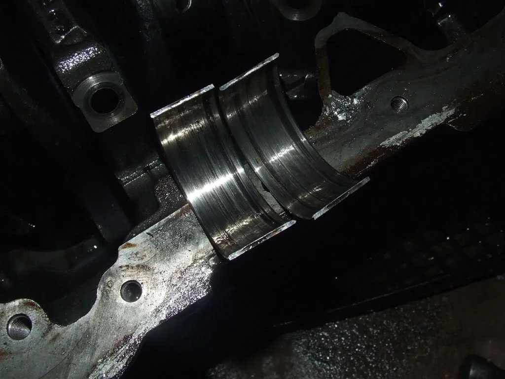

  '92 172, Lotus Elise

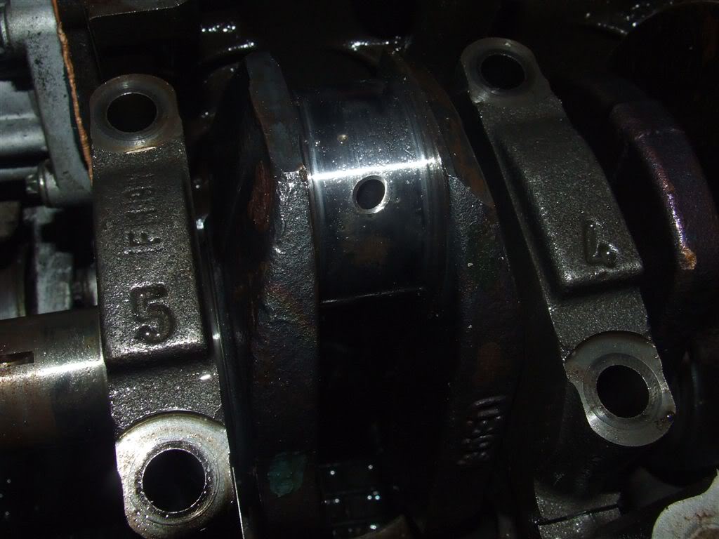

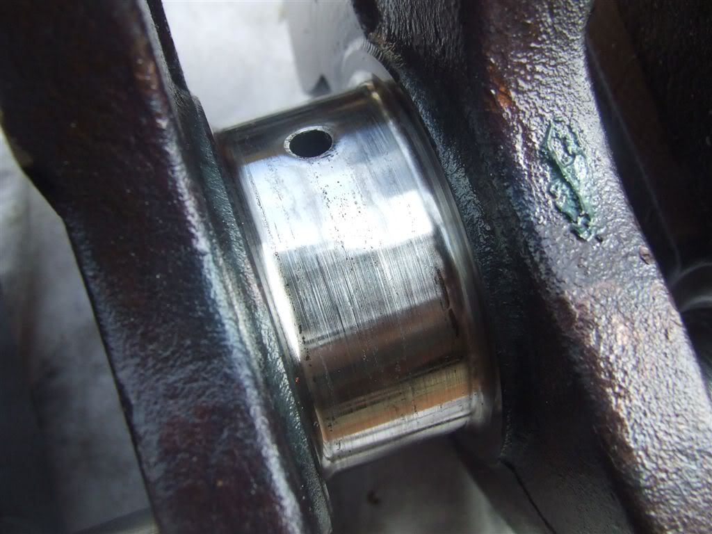

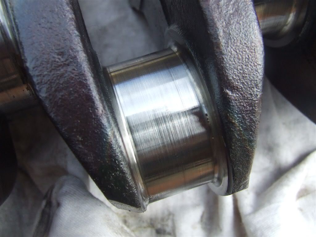

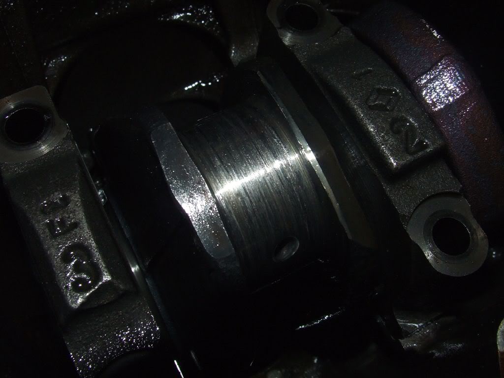

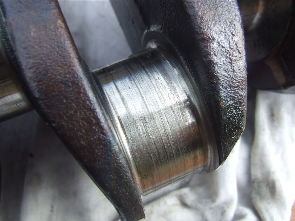

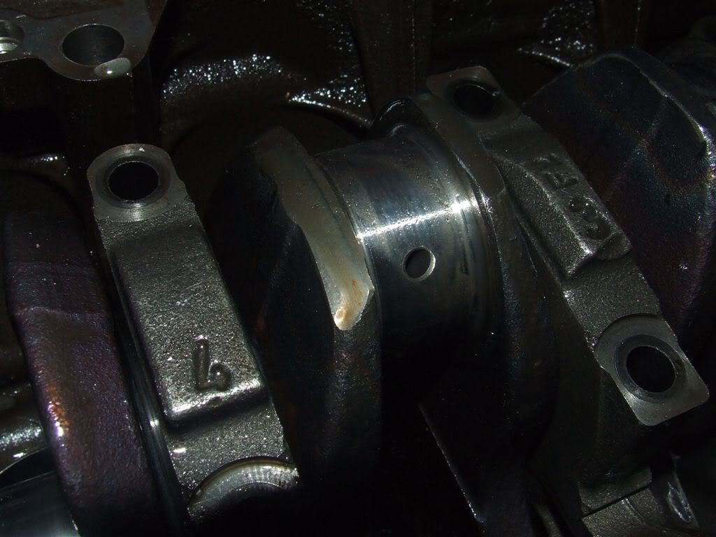

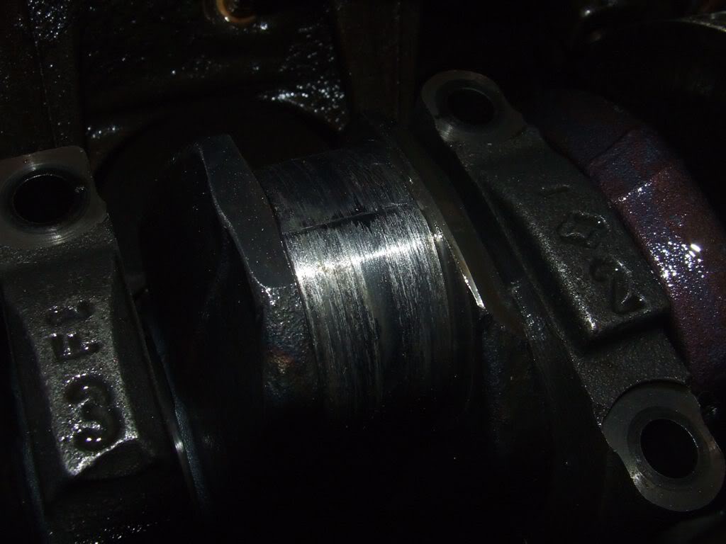

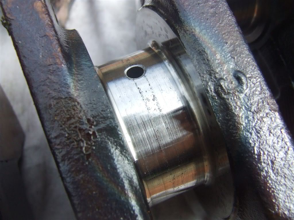

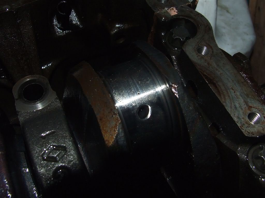

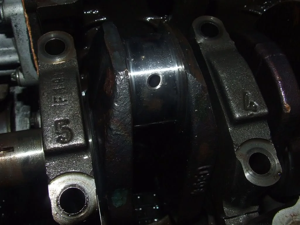

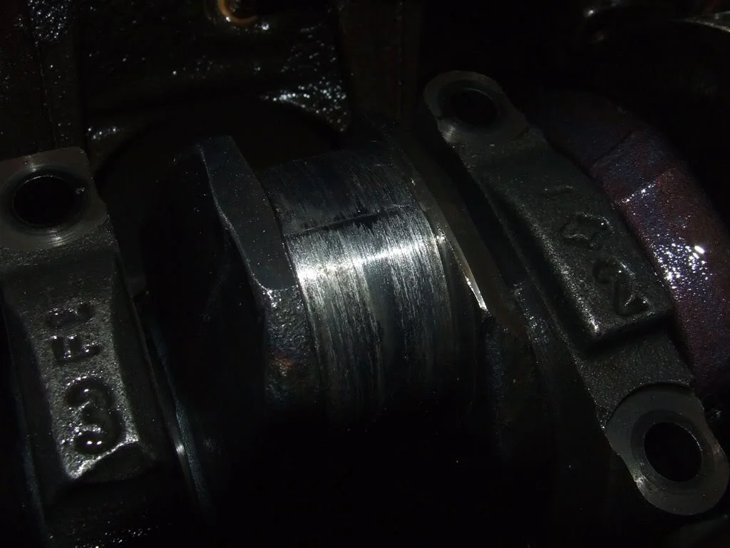

#1 conrod
#2 conrod
#1 crank
#2

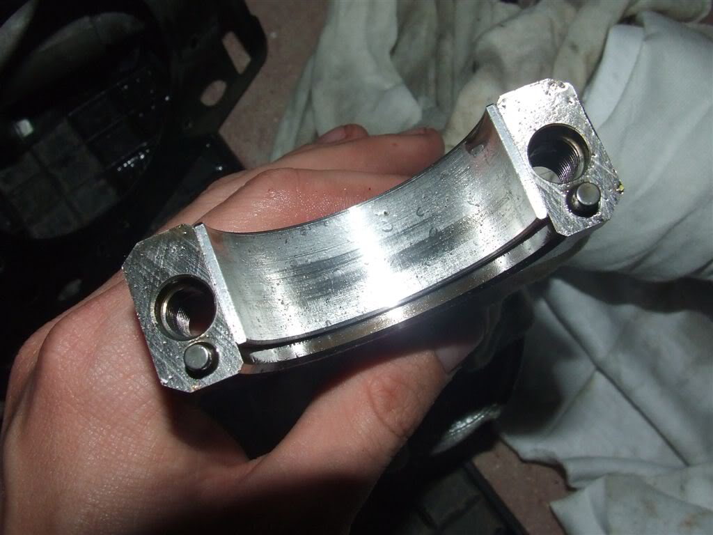

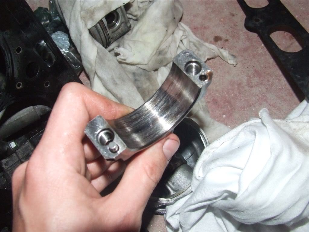

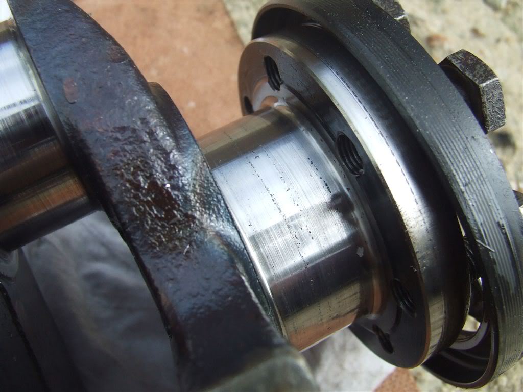

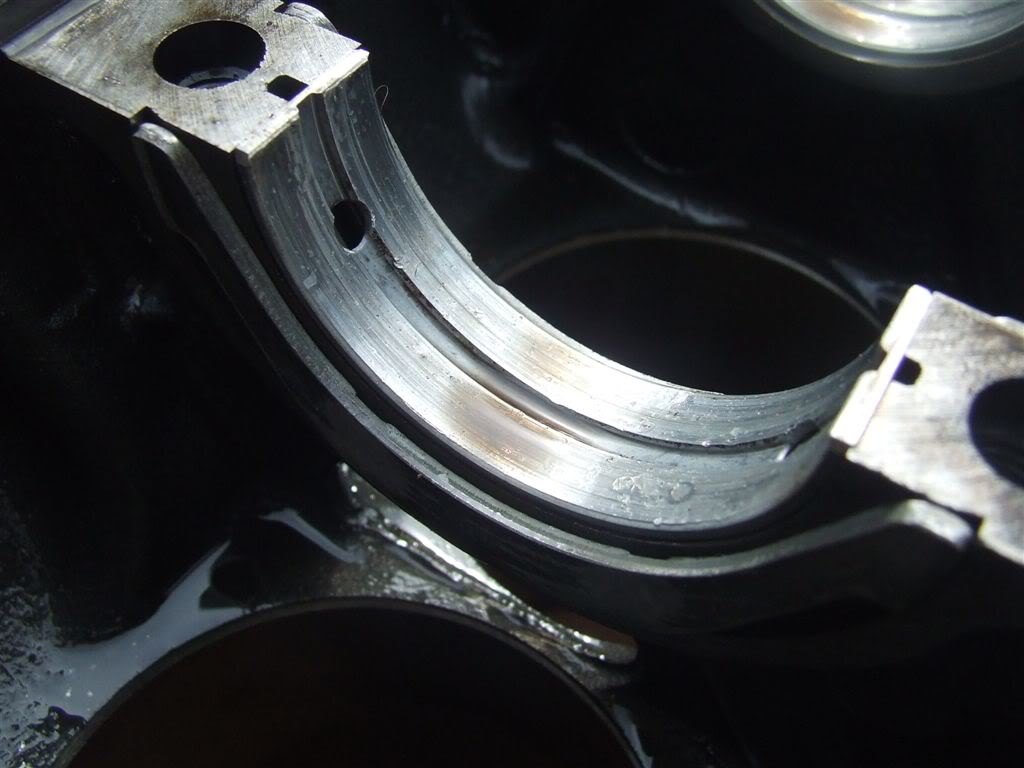

my mistake, the bearing is on there, it's clearly just spun
#2 shell bearings
#2 crank
apologies for rubbish pics, its 2am and quite dark :D

That journal is tatored, lol. At lest you're learning stuff eh ;)

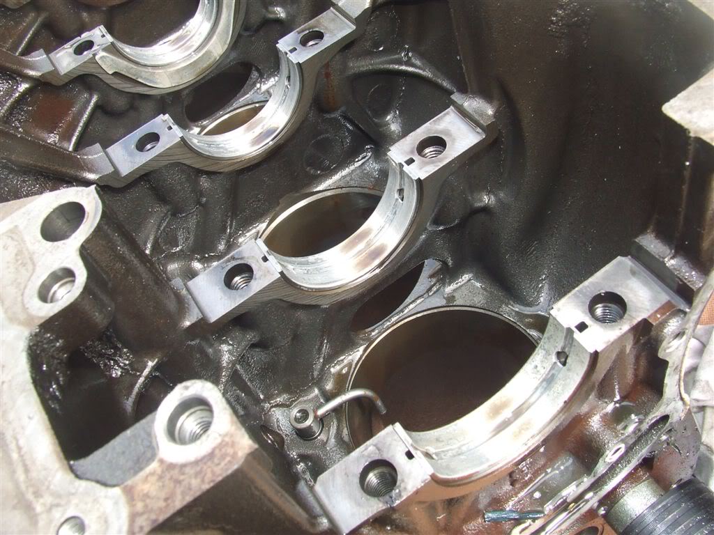

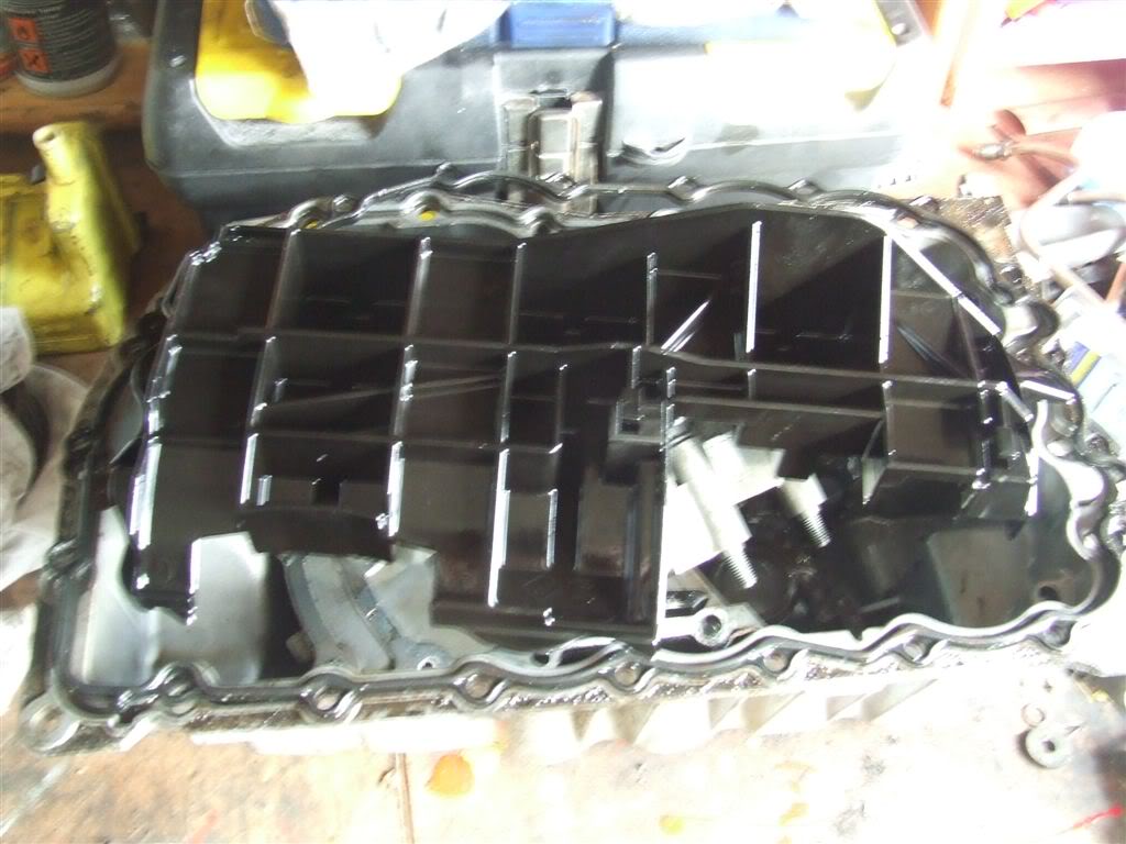

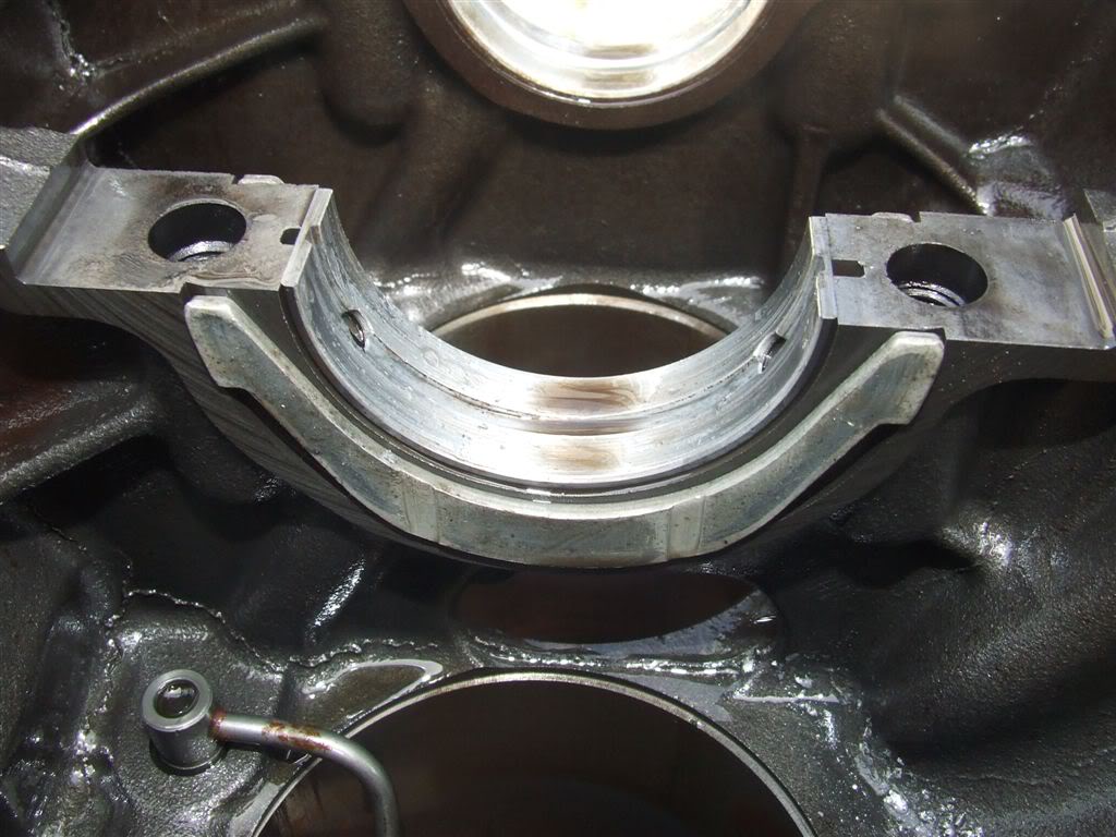

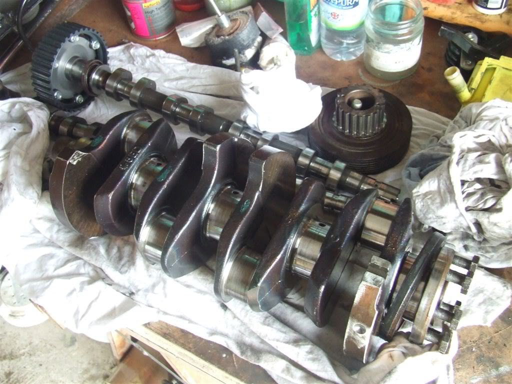

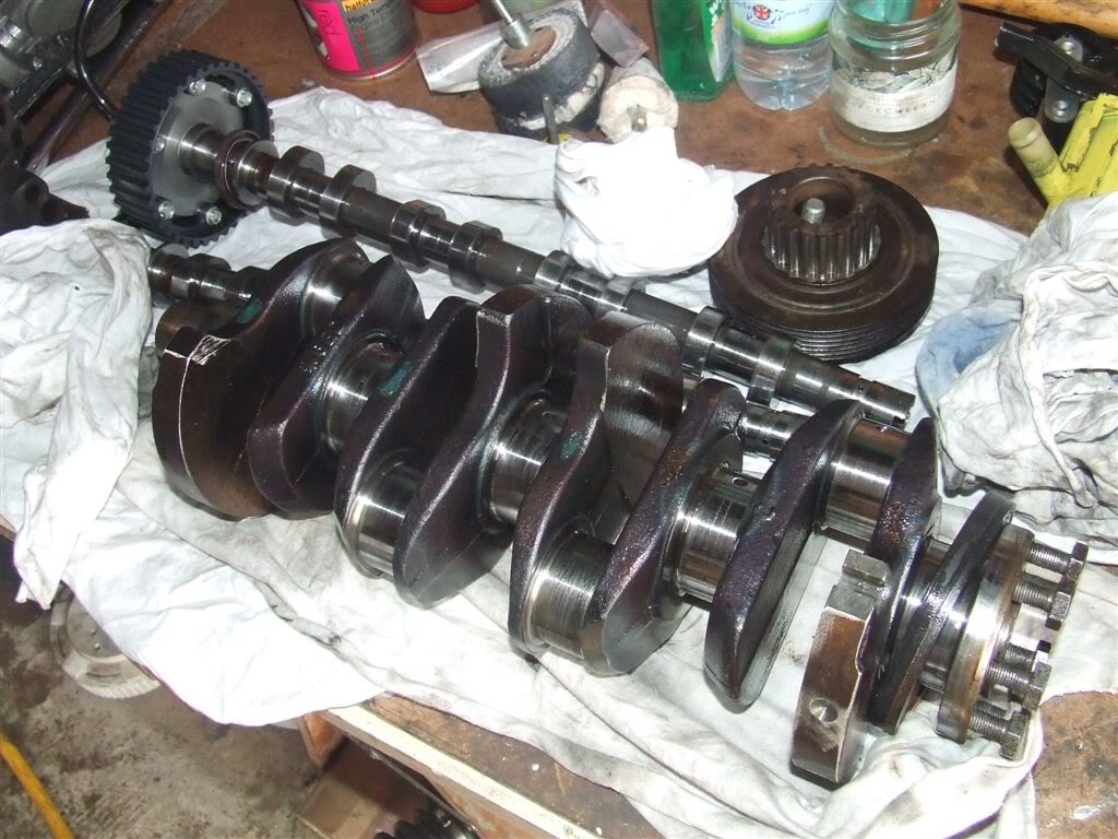

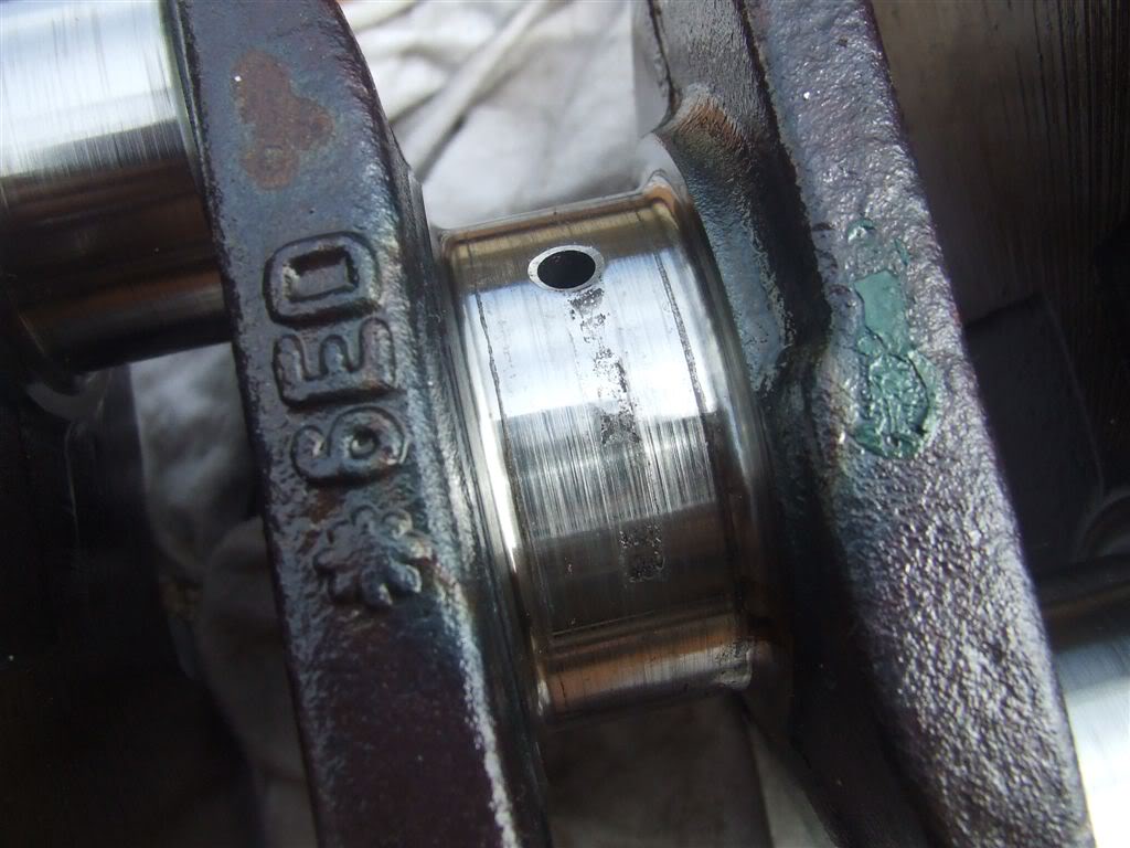

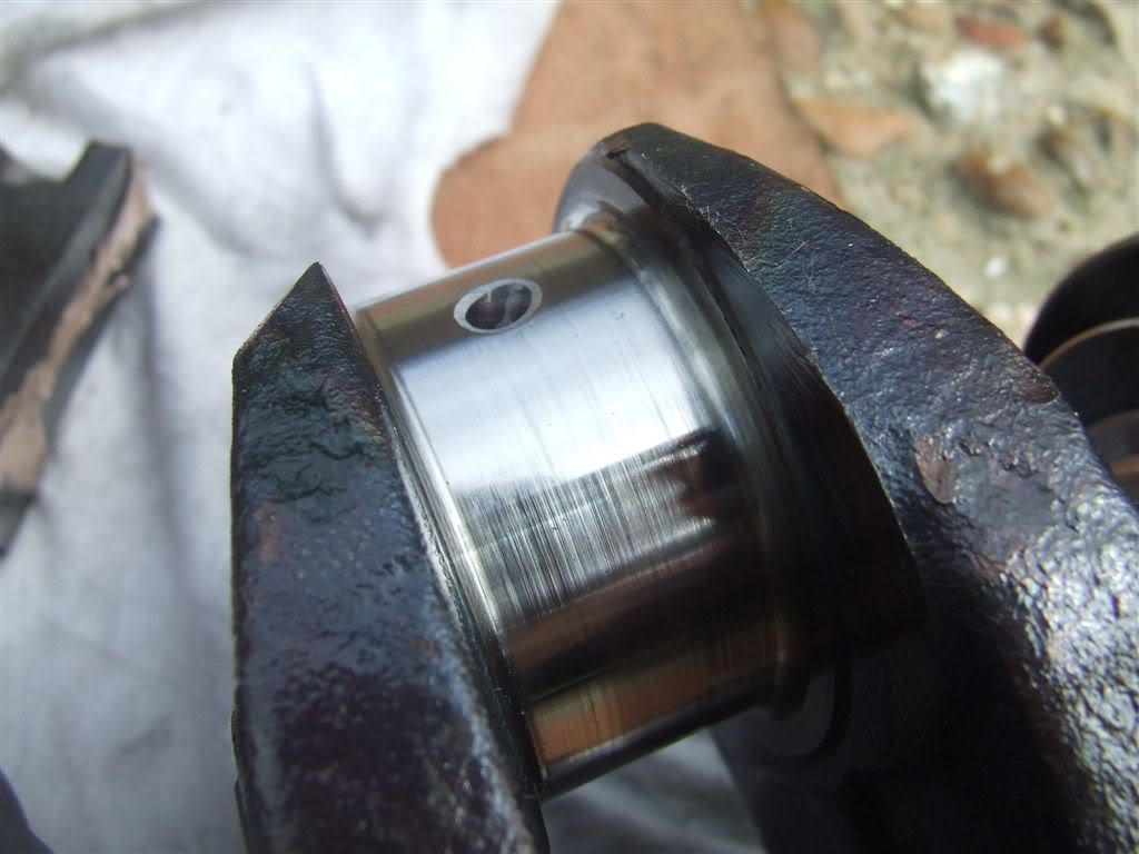

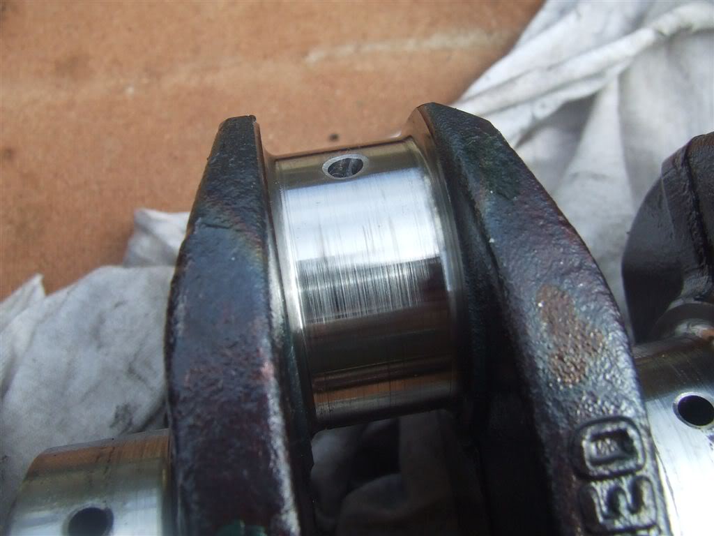

took it all apart this morning... here are some pics
what are these removable things? :? (on #2)
from the pulley end going to the flywheel end:
fun!

The crank is shagged fella. If you're adament about rebuilding this engine you'll need the crank ground and oversize shells. Contact BenR to see where you can get them!
it might be, the fell off and i placed them back in for the purpose of the picture :eek:

crank is going to be sent off to be ground (properly this time) with new bearings etc...
I figure its the best way, as once its all back together, I'll know exactly what the engine is like, rather than getting another one and risking it
  E92 M3 Monte Carlo
as said mate your better off getting a mint crank its already been done once,the chances are it'll f*ck up again,and there thrust washers which reduce side to side play in the crank
that's if it has actually been done... I don't think it has.
what would be the problem if its properly ground to within tolerances and rebuilt up? surely it would be no worse than a standard one and I'd also know the condition of the engine, rather than risk getting another
