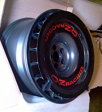

Yes wheels will affect cooling but unless you fit something like this the difference will be negligible. Mintex 1144's aren't any better than a Brembo standard pad IME. Yellow stuff are infinitely better than ds2500 too and a fraction of the cost.
