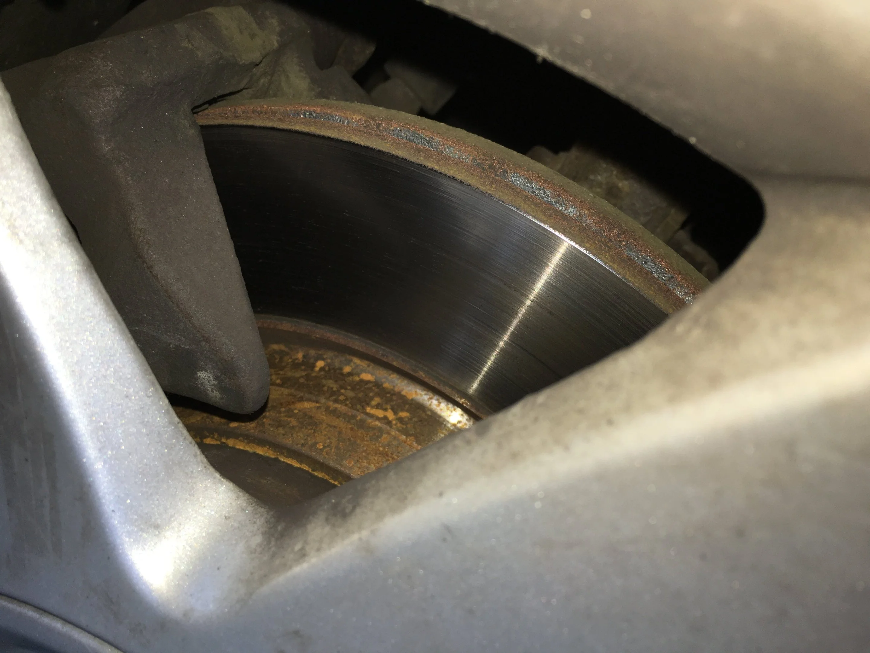

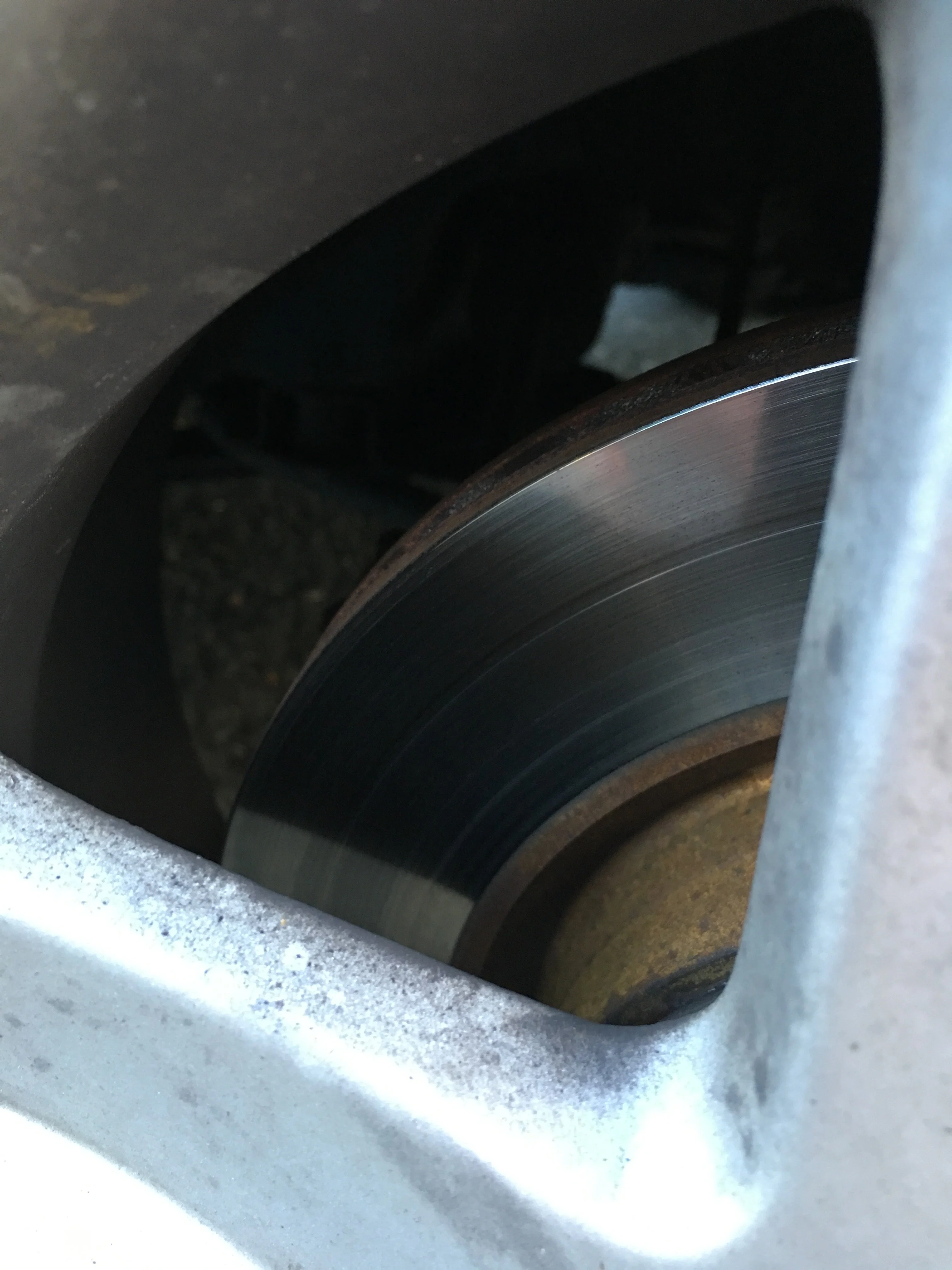

Wishing to get into DIY, I replaced my pads and discs just under a month ago. The pedal feels fine and the brakes stop the car quickly enough, however there is a ring of corrosion on the inside edge of the disc (near the hub), which is where the pads aren't touching the disc.
Is it normal for there to be an area of the disc face that is corroded, especially that inside edge? Also, one disc has a smaller corroded area than the other so is this normal wear or have I put everything back together wrong? Pictures attached.

Ta for the replies guys. What about the difference in size of the corroded bit between each disc? Is that anything to worry about?

Not particularly mate, the main thing to watch out for with the discs is scoring.
Looks fine. Great way of learning is doing jobs like that. Do an oil change, air filter and oil filter change next. Gives you great satisfaction knowing you have done it yourself. Also worth getting any tools you might need before, nothing worse than having to put it all back together to be able to run to Halfords. Even if the tool is expensive it will be worth it in the long run as you will use it time and again.

If you really wanted to, you could take the discs off again, clean up some of that corrosion, then use something like hammerite on those bits, then when you go for a drive, the pads will rub off any excess paint. That usually does a nice enough job.
Mercedes Benz do that from factory on replacement discs.

Only reason I asked about the different sized corrosion areas (ie difference in swept area) is that shouldn't the two sets of pads cover the same area as they've been fitted the same way? Plus, I looked at another Clio that had the same sort of corrosion on the inner part of the disc, but was smaller and identical on both sides. Am I just worrying too much?
