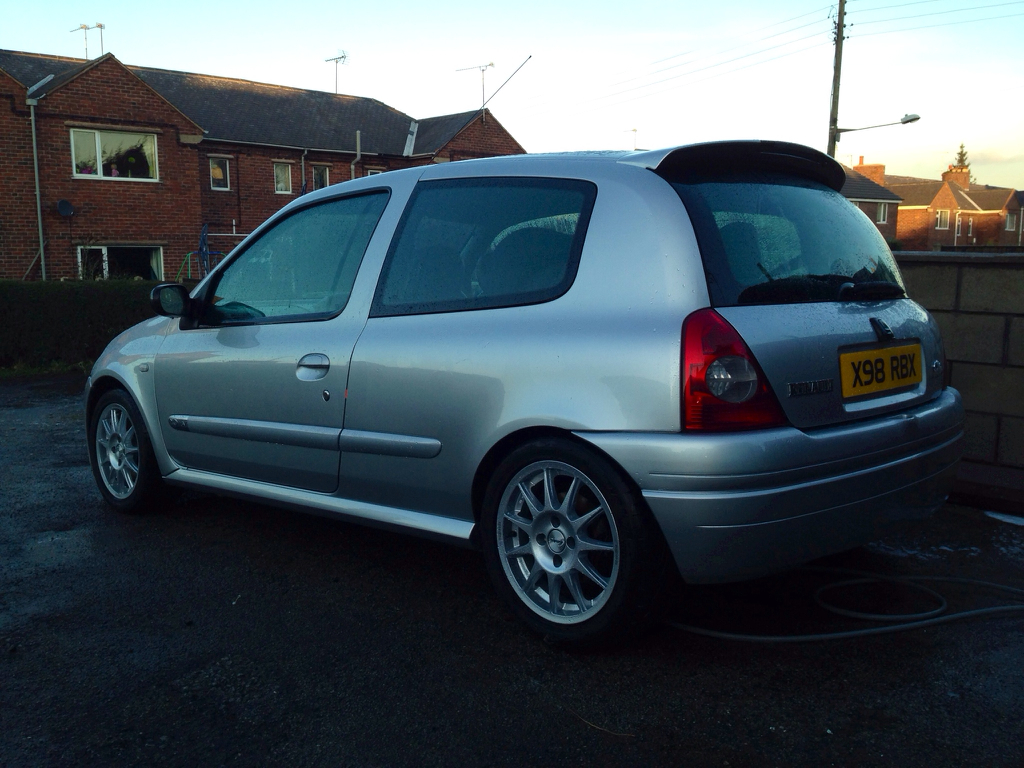

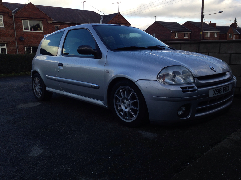

Door handles fitted and gave a good wash.
The door handles seem a little darker, could be the fact I need to machine polish my car to get some gloss back, if not il have them sprayed again.

Might be because they are a different grade of plastic, so it's not a perfect match? - looks alot cleaner on side profile now. Do like.
Did you manage to fit the handles ok?
  Inferno 225 cup
Yeah fitted then pretty easily and quickly, just the screw Clip on the interior door handle dropped down do now struggle opening from the inside :(
Yeah you could be right tbh, does look a little fresher.

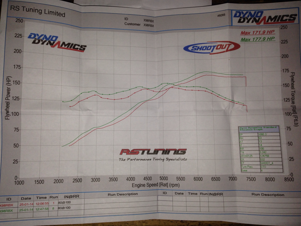

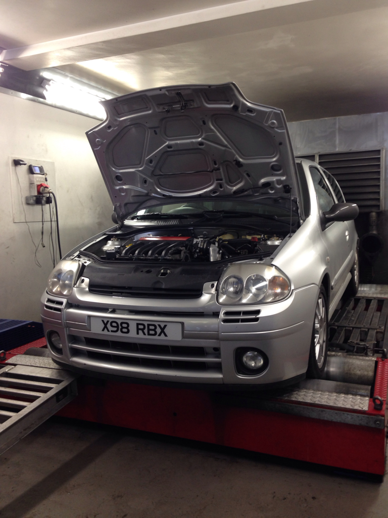

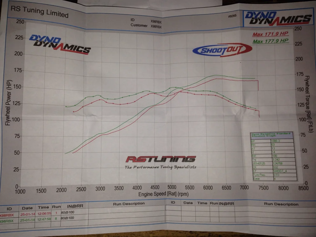

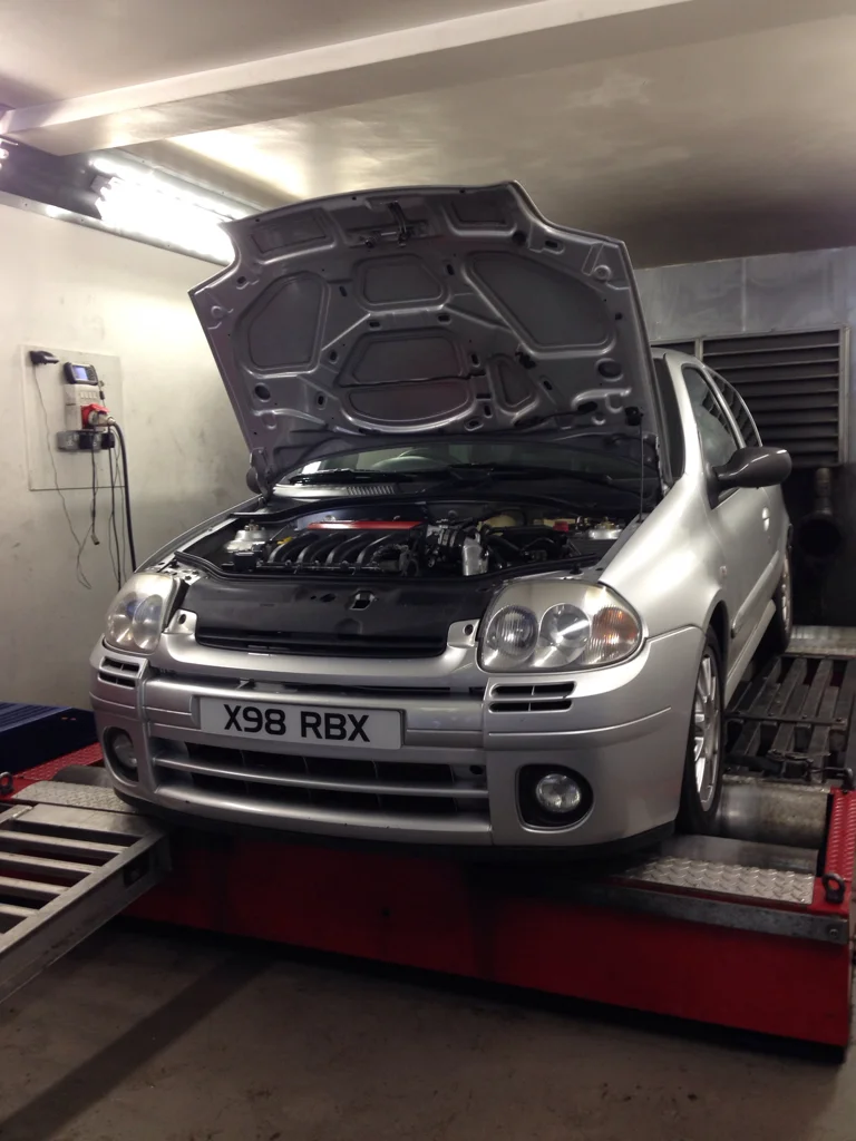

The car went up to Paul yesterday for the mapping, unfortunately I didn't see above the 180 mark, but with a new lambda sensor as it is knackered and a Decat Paul said I should.
He also said the alloy induction pipe looks to be restricting air as the diameter is pretty small.
I'm chuffed it Made that power to be honest ( I know of a lot that don't ) and it drives and picks up speed pretty quickly and the cams sounds So nice.
Here's a pic and a graph.
Where to go from here power wise I don't know, that's down to cub and the price he can sort later in the year.

At least you know the car is running right and at the correct power, would have been nice to see its true power run before the cams.

Worth mentioning the car had an RStuner map on it already, so the gains don't look as good compared to an untouched engine :)
Once that gearbox is sorted it will be ALOT better. I didn't think we'd make it home with all the knocking and banging from the 'box lol!!
