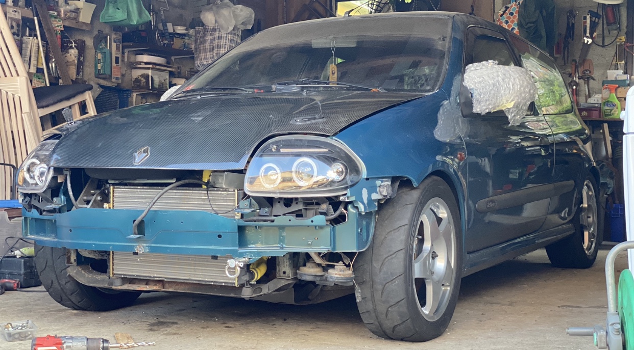

Yesterday I managed to visit the car to do some works
Fitted a sticker (boring)

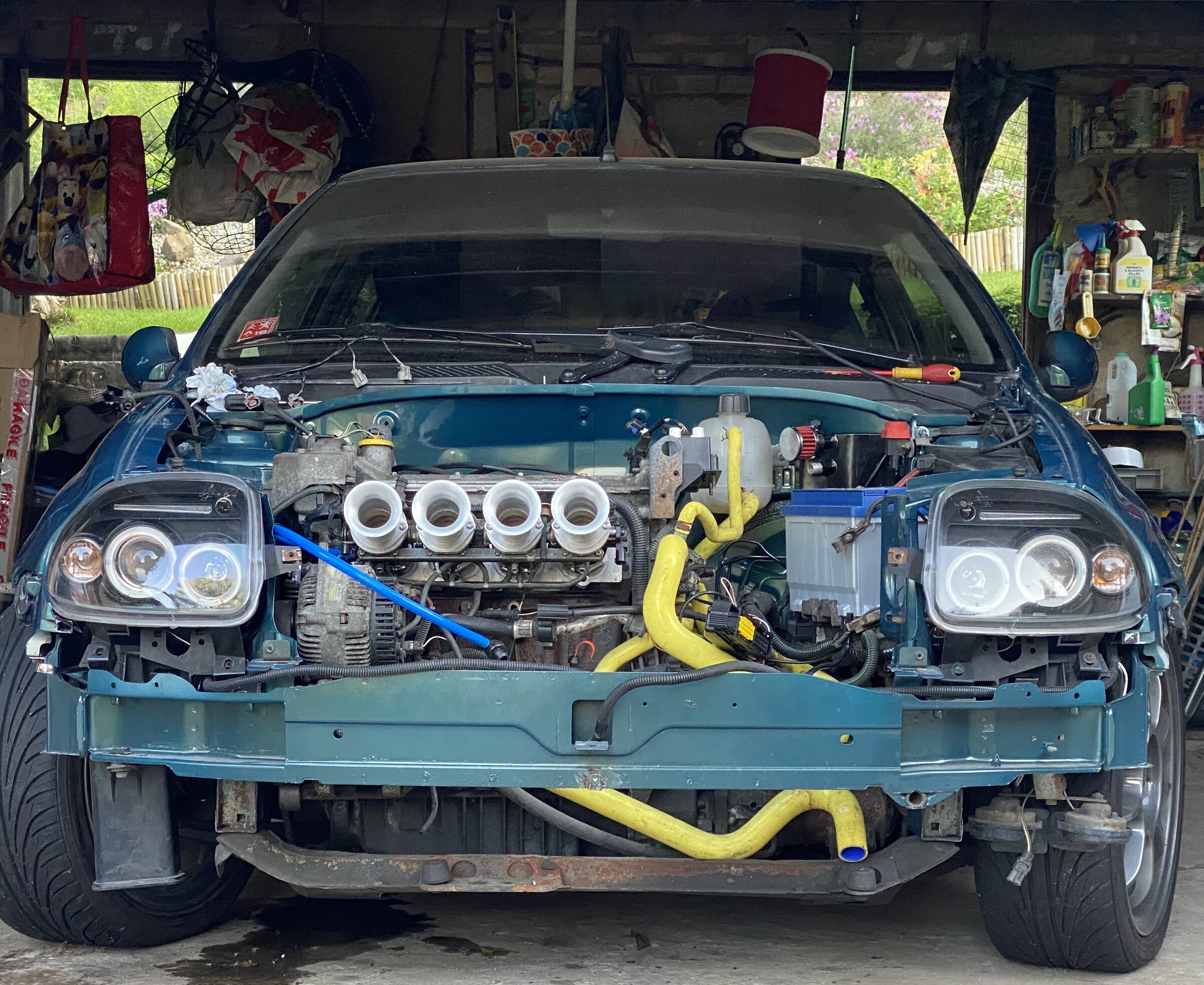

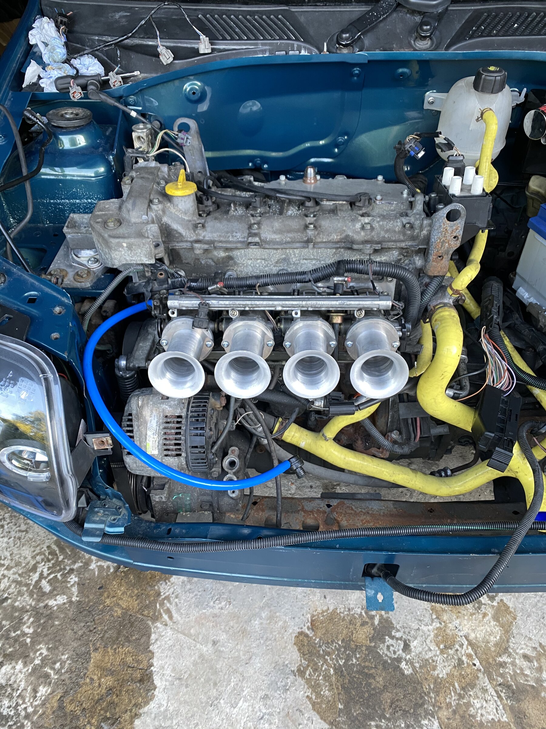

Had the bodies fitted whilst I faffed about with the loom plug for the ME221. I think they look great

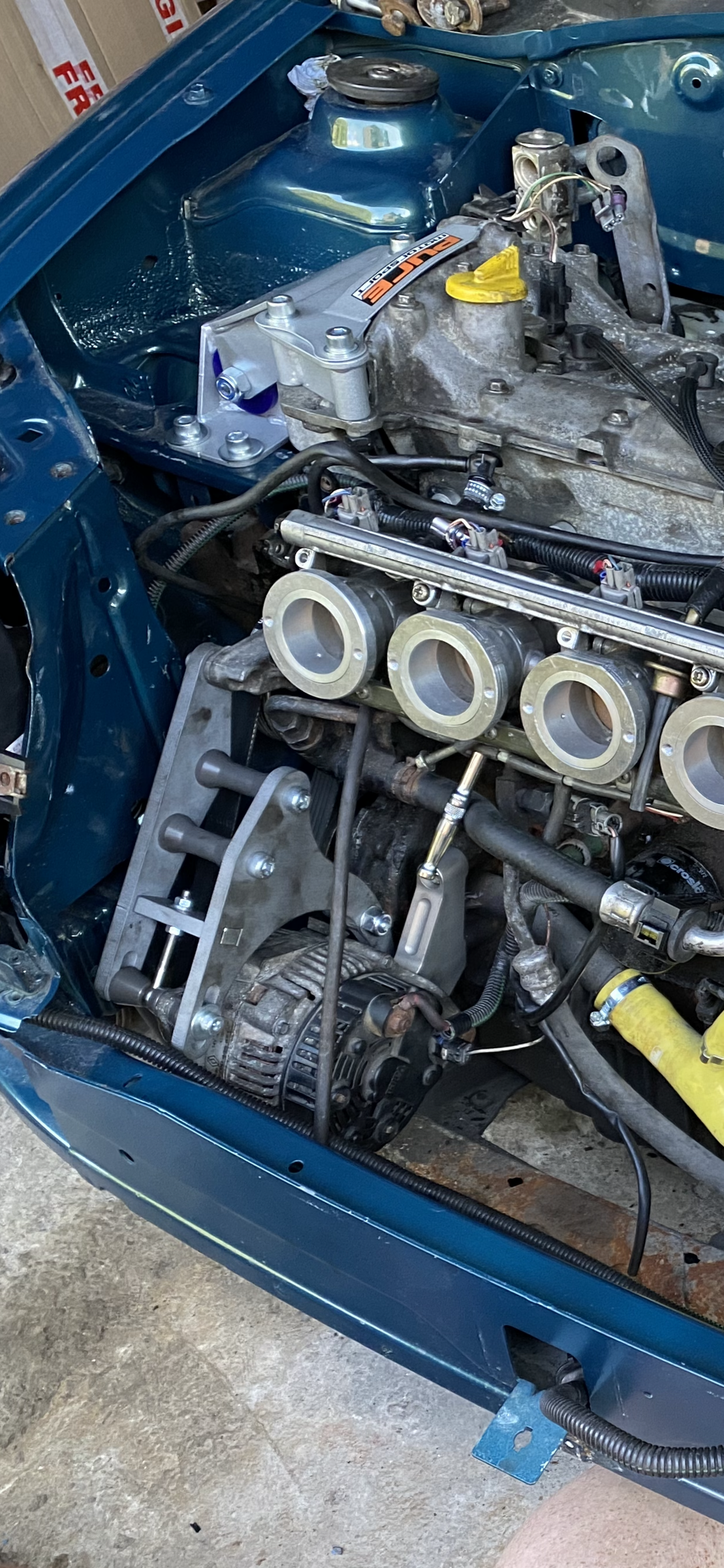

Couldn't fit the backing plate for the filter due to the OE position of the alternator (as seen in pics) so will be ordering the PMS a/c delete kit to solve this
More attention required at the fuel rail as the kit came with part of a custom loom which doesn't seem to fit my car or the 197 injectors I planned to run so back to the drawing board there
Now on the immediate shopping list is a tuning lead for the ME221 so I can load a base map on to try & start the car
Obvs the a/c delete from PMS & will be changing the Vibratechnics upper engine mount for a PMS one as there is one bolt redundant from the lower inlet & I feel it would be safer to get the PMS design

Started the electronic install for the ITBs with the ME221 PnP, pin swapping to work with the ph1 as per guide provided by ME - no interesting pics for this
Decided to buy the Air Con delete/Alternator relocation backetry new from PMS & treated myself to an upper engine mount too - fitted with the help of the other half & a friend
Changed the connectors on the loom to the ZX12r ones (330cc) as I have a billet rail to fit them

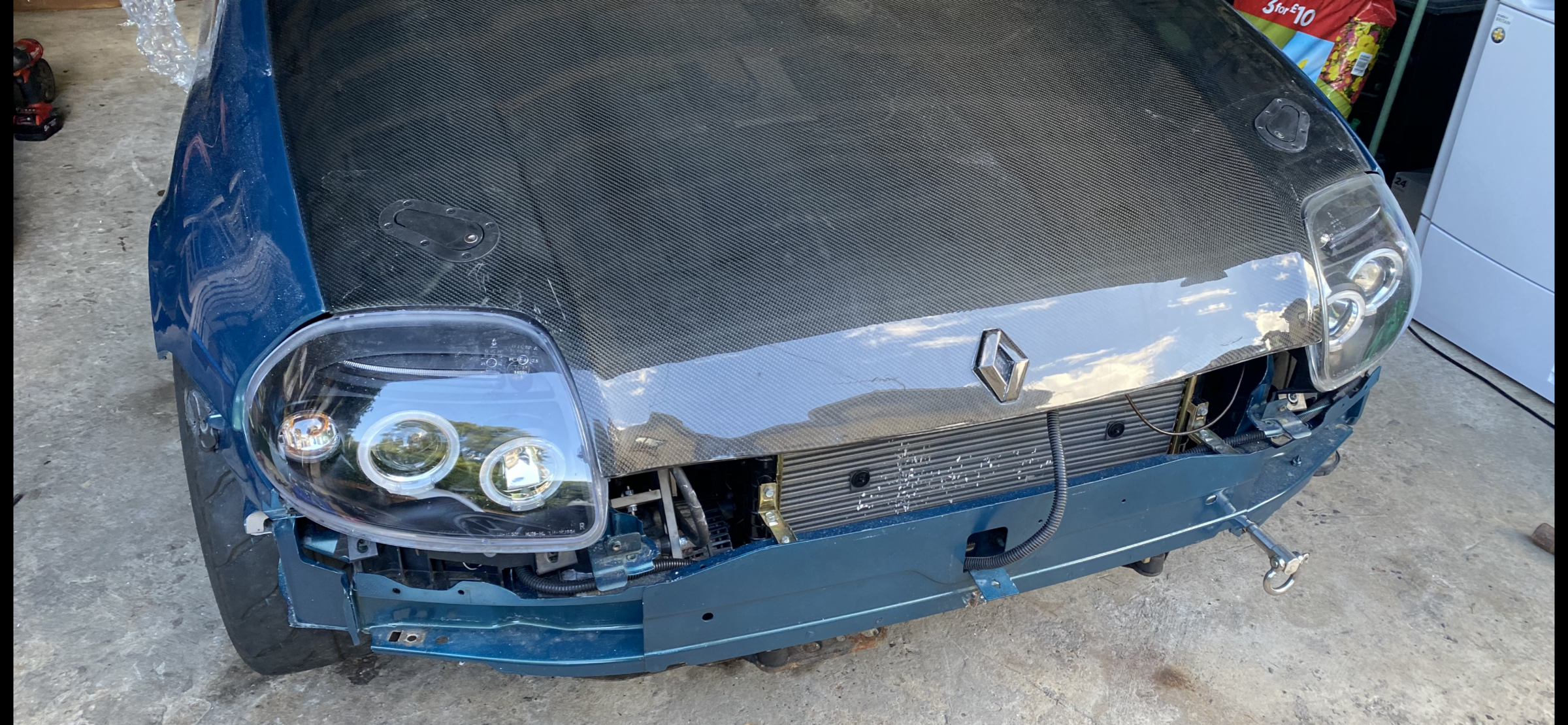

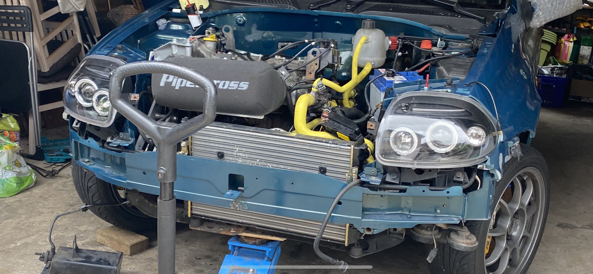

Secured all the ITB bits aswell as fitting the slimline caddy rad & fitted the Pipercross filter - had to chop some of my bonnet out for it to fit

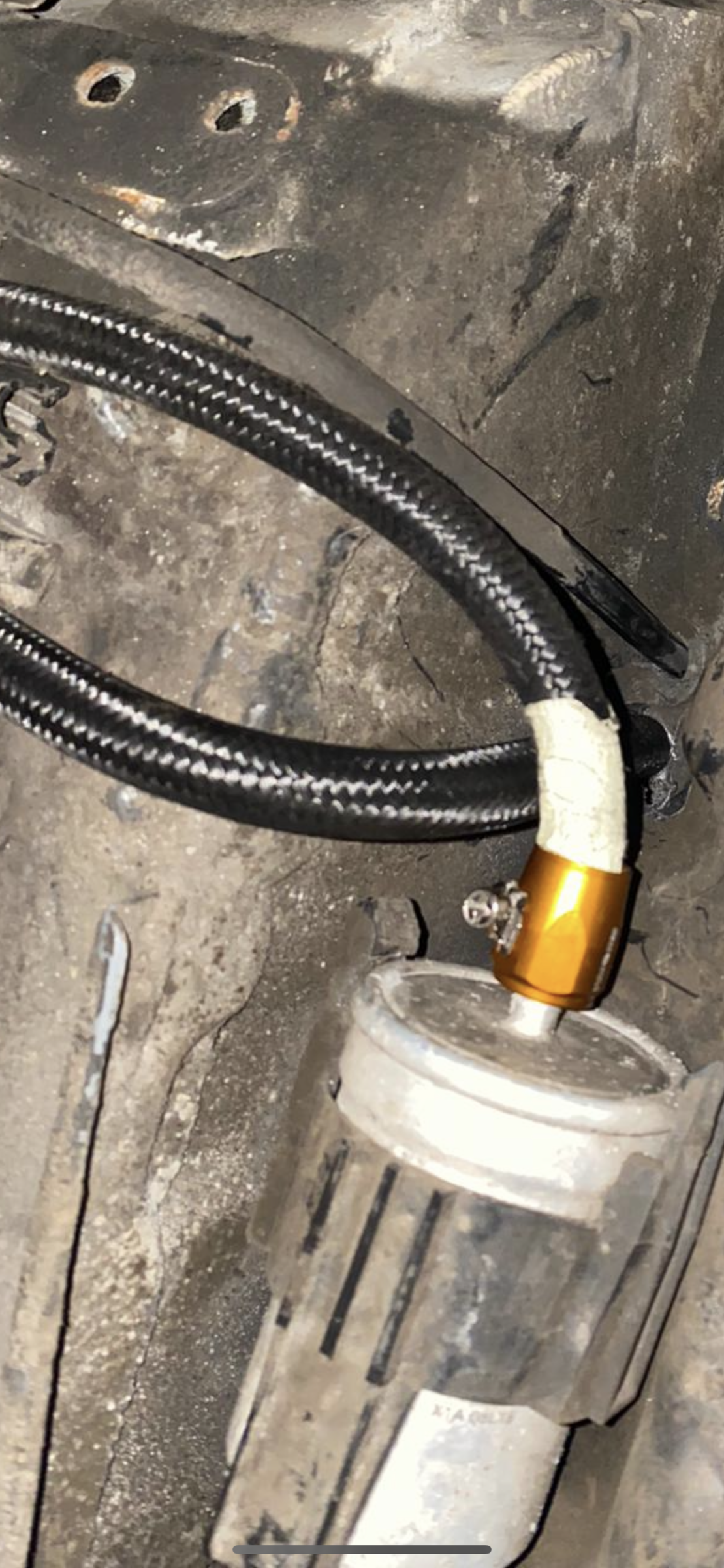

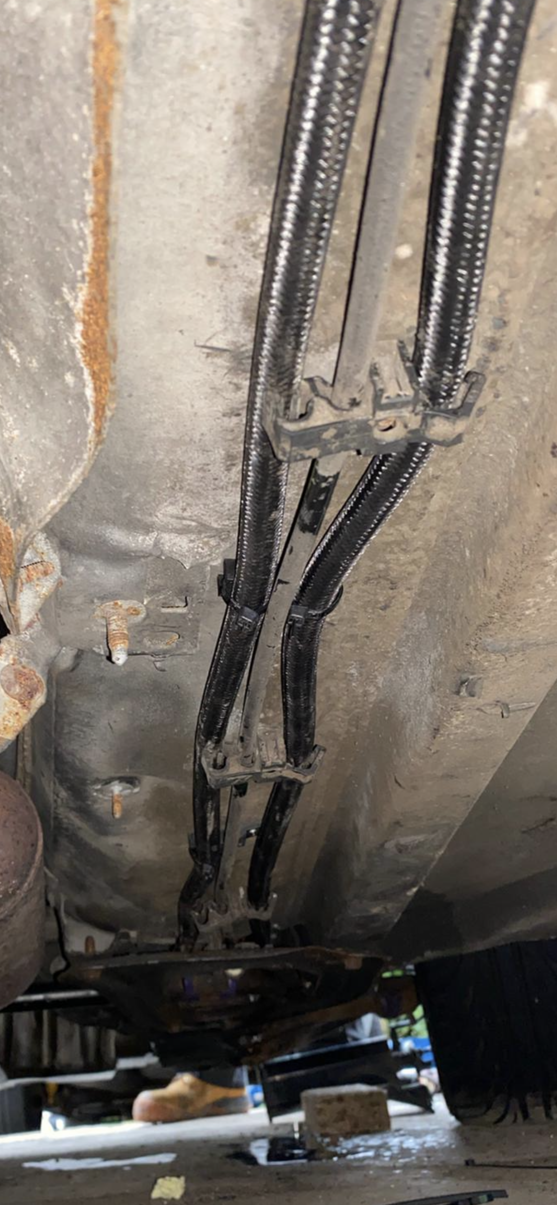

FItted aeroquip & braided hose for the oil breather & feed and return brake lines (run under the car)

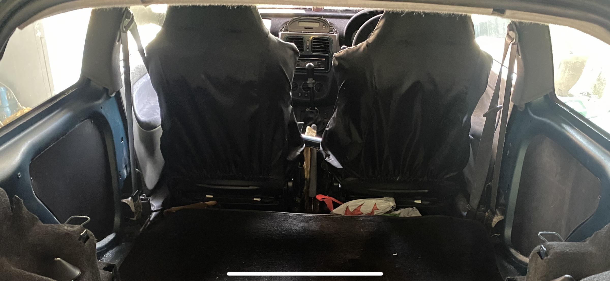

In the meantime fitted CM Composites rear door card panels which I'm happy with

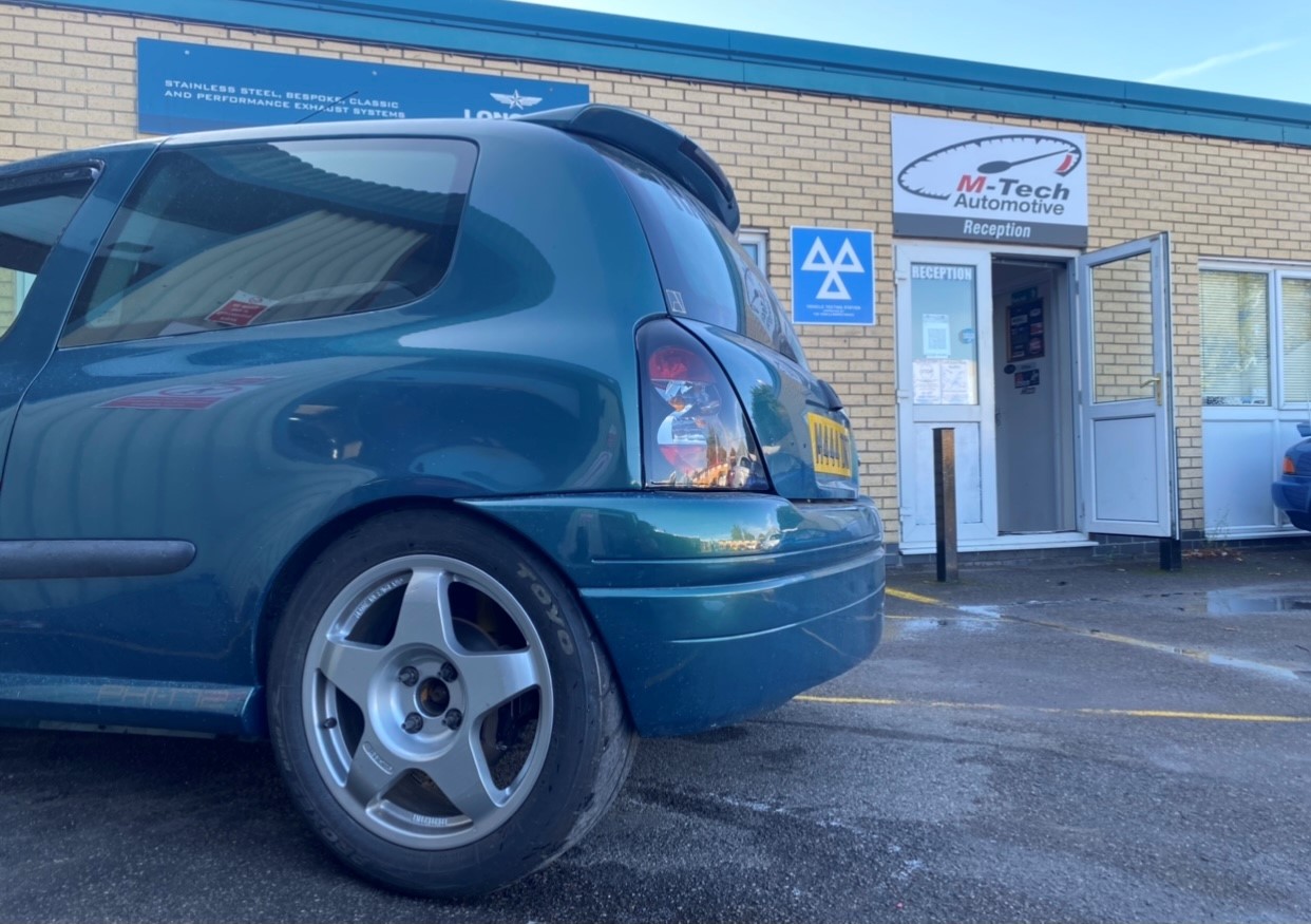

Thanks, it's at https://mtechautomotive.co.uk/
The ME221 wasn't an issue as such, it was my illiterate auto electronics knowledge lol they had the car running yesterday :) now all it needs is the fan wiring up, a new throttle cable & it's ready to be mapped. Then they're looking into an earth problem in my rear light & then fitting the ePAS

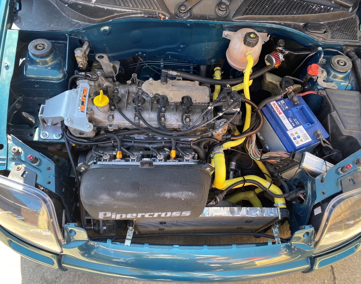

Yep so they removed the bodies, cleaned them up & replaced the gasket and that made it run a lot happier. They had to add some springs to the bodies to get them to return & the throttle cable had to be changed as there wasn't much movement in the pedal.
ePAS wasn't fitted as the budget was eaten up with the issues but the garage managed to reposition the reservoir & secure it safely using a custom bracket.
Brake servo/master cylinder relieved itself on the morning I went to pick it up. Temp fix using cable ties but will be looking into this to make sure there isn't an issue in the future. The garage recommended I fit a heat shield.

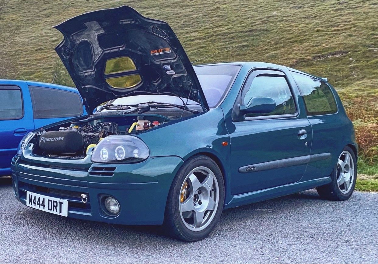

Sadly the few shows I had lined up have been cancelled or unable to attend due to local lockdowns, feels like a greater power isn't letting me show this car off haha so a few pics will have to suffice

Yeah I'm happy with mine, sounds great and drives well. My build is more casual than solely track focused though. They just need some additional springs to return, mine wasn't the only kit I know of that needed these. If you know what you're doing with the sensors etc & are not working to a timescale then they're worth it imo
I haven't experienced other kits so in terms of installation/performance I can't really comment
Around a 30-35hp gain (made 5hp less with the pipercross filter on) with 6 month old fuel + the 197 cams. The dyno there is very critical so I won't embarrass myself by sharing the numbers cos it's pub chat. The owner of Motorsport Electronics himself mapped it & he was very happy and said it's a very strong engine :)
