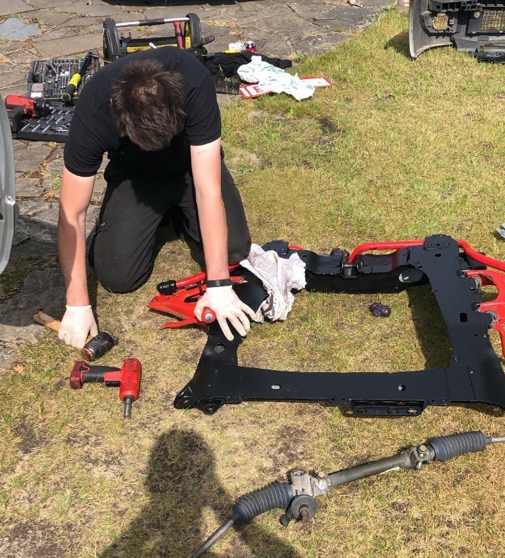

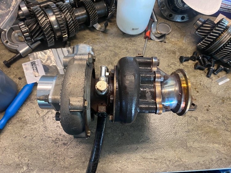

Part of the track day prep on my car included checking the breakaway torque on the Gripper LSD. Once I had confirmed it needed a service, Graham gave me a huge hand in getting the box out very urgently for it to be sent up to Mark Mayfield. Mark dropped the diff to Gripper for their service, and whilst it was there, he gave my gearbox some love. Thankfully, it was in really good shape and did not need much at all (miss daisy driver over here). The turnaround was decent but being in lock down meant the car which is kept at my parents’ house was left on stands for almost 3 months.
For those interested, the gripper had been on my track car for pretty much 5 years exactly and it was second hand when I got it. So, it lasted very well and absorbed a lot of track miles.
When lock down eased and businesses started to re-open. Alex White from AWMotorworks very kindly came down to re-fit the gearbox for me and get the car up and running again. A few hours later he was done, and he drove the car back to his unit for me in anticipation for some other maintenance. Once he is done with it, I'm hoping to get a few track days in this Summer!
Whilst he was down at mine, he also supplied and fitted new Powerflex black ARB bushes to match the wishbones. As well as putting new track rod boots on my new solid mounted DCI steering rack. Courtesy of Graham's garage.

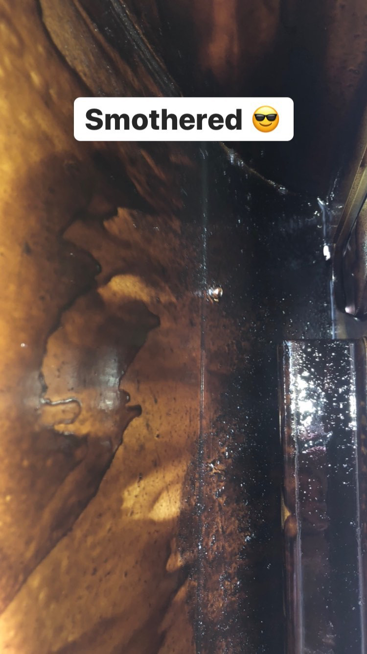

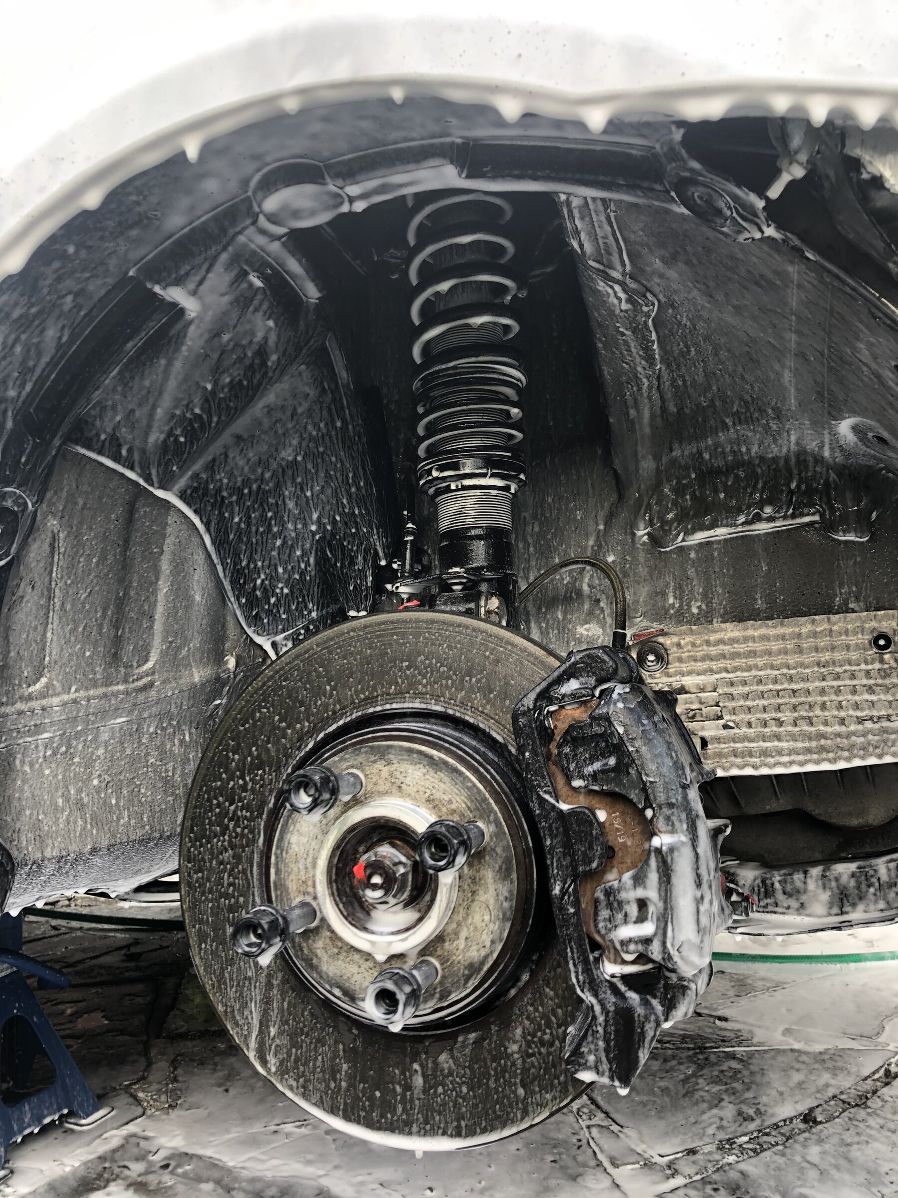

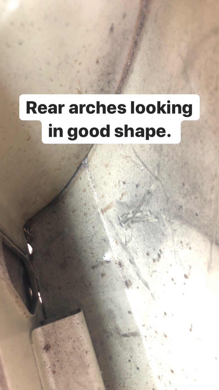

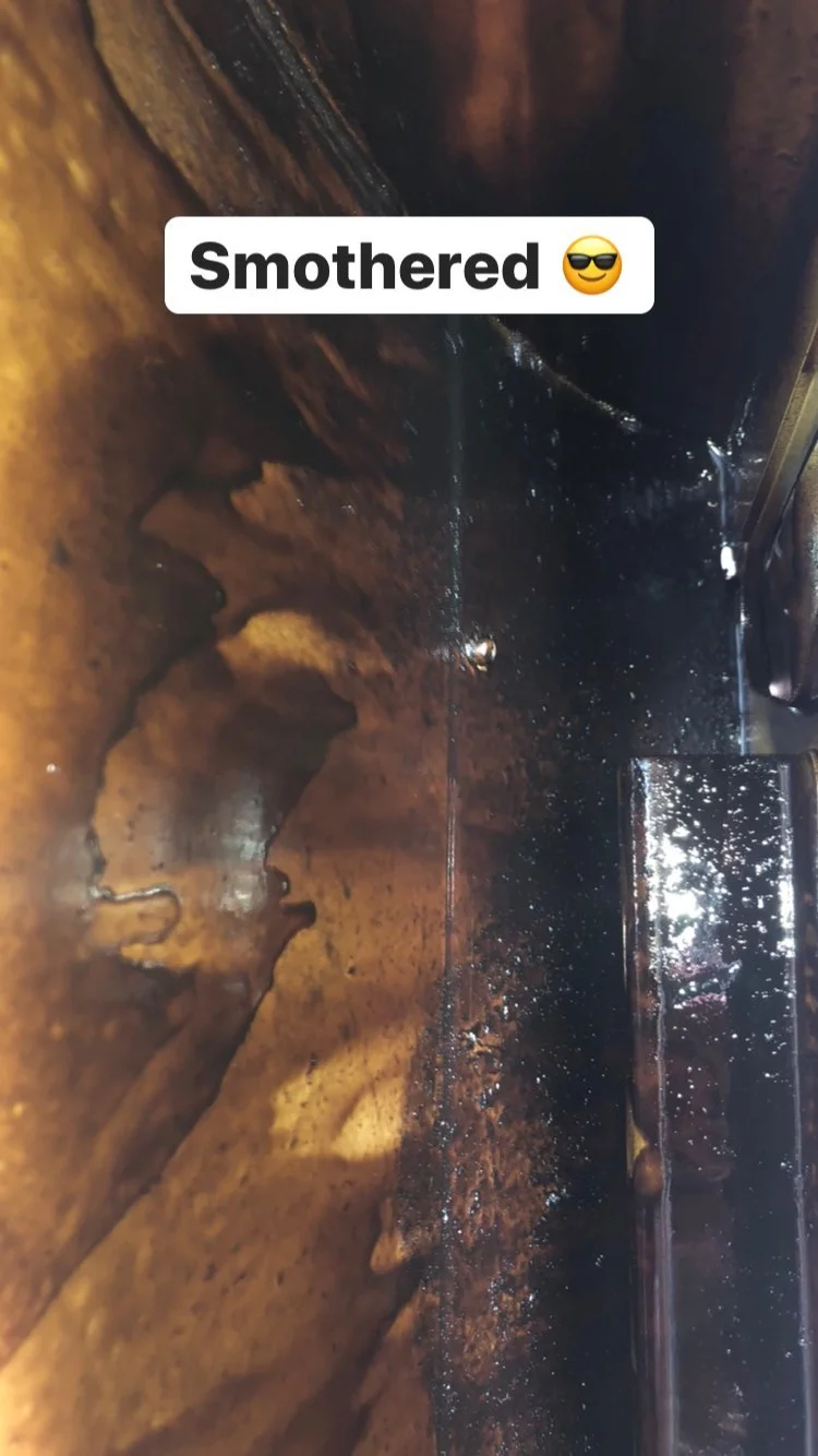

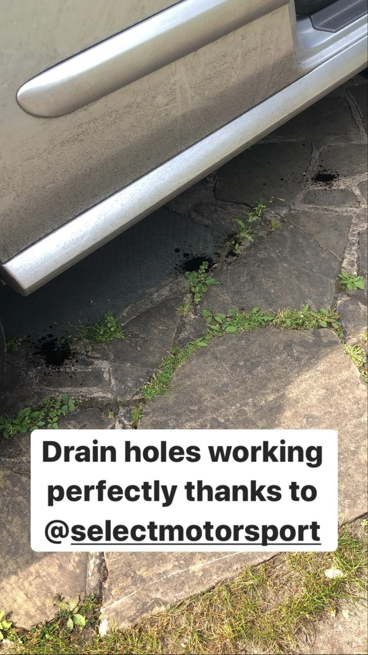

Back in February I did also actually get the car over to @Mash. at Select Motorsport to have some work done on the sills. They were pretty crushed but are now reinforced and properly protected. I can also confirm the drain holes work perfectly again so hopefully no inner rot which seems to plague a lot of Clios. One more job ticked off the list which I had been meaning to get sorted for ages! So cheers to Matt for that.

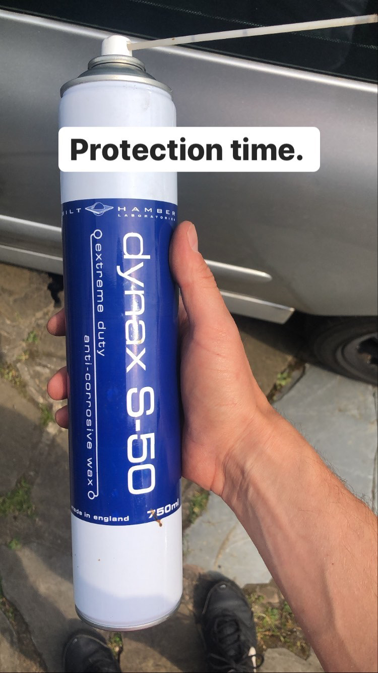

Once the car was home I smothered the inner arches with Bilt Hamber Dynax S-50 which is an anti corrosion cavity wax.

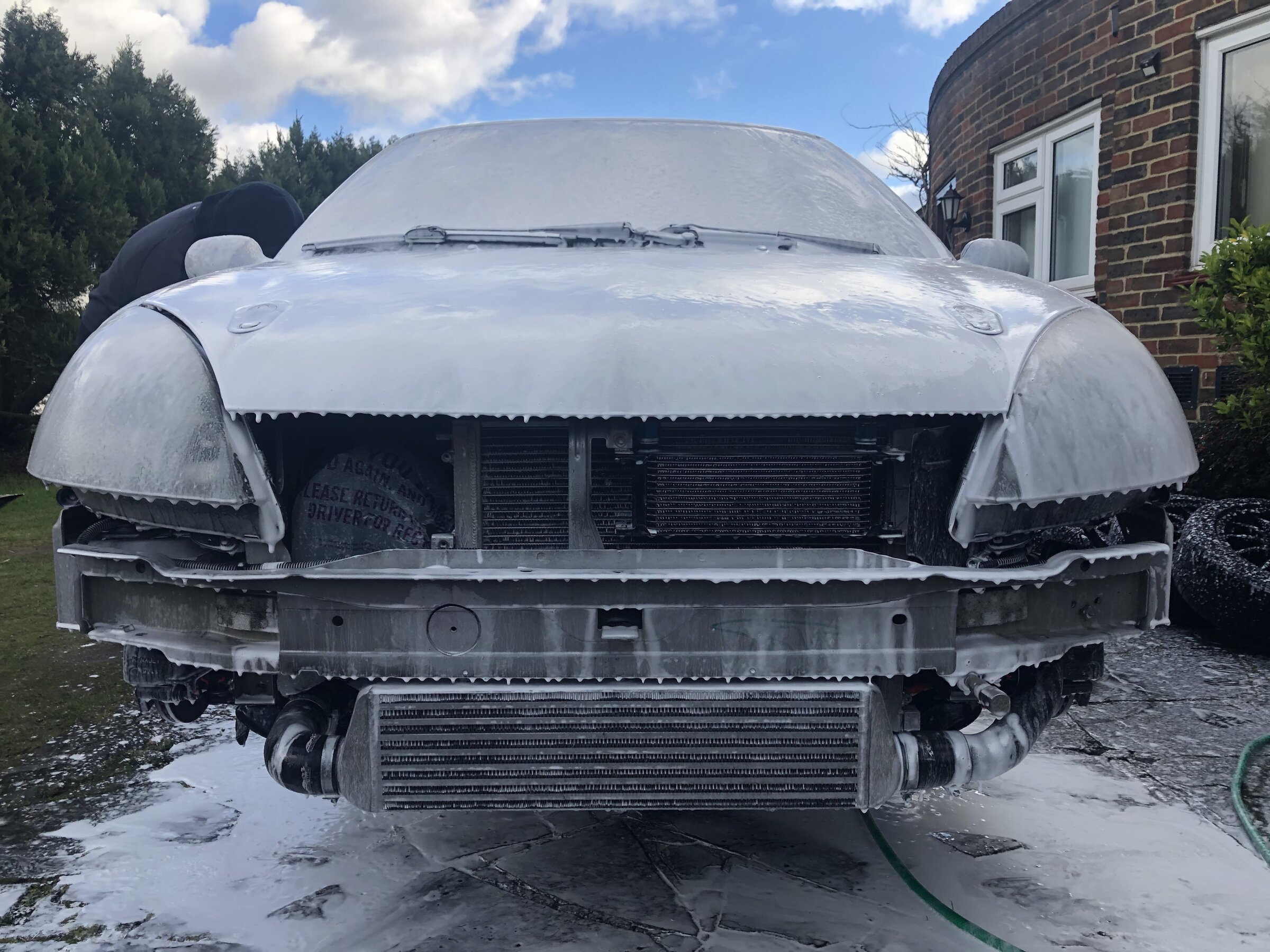

Pictures taken from my Instagram story:

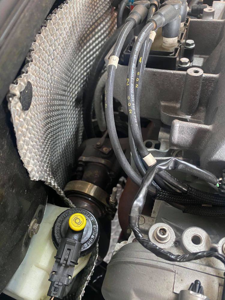

Quick observation on the last image, you don't run the small tube supports between the subframe and vehicle body.
Any reason?
Yeah I do, it's just perfectly hidden behind the caliper there.
You can just about see the top of it in red behind my nimbus deflector plates.

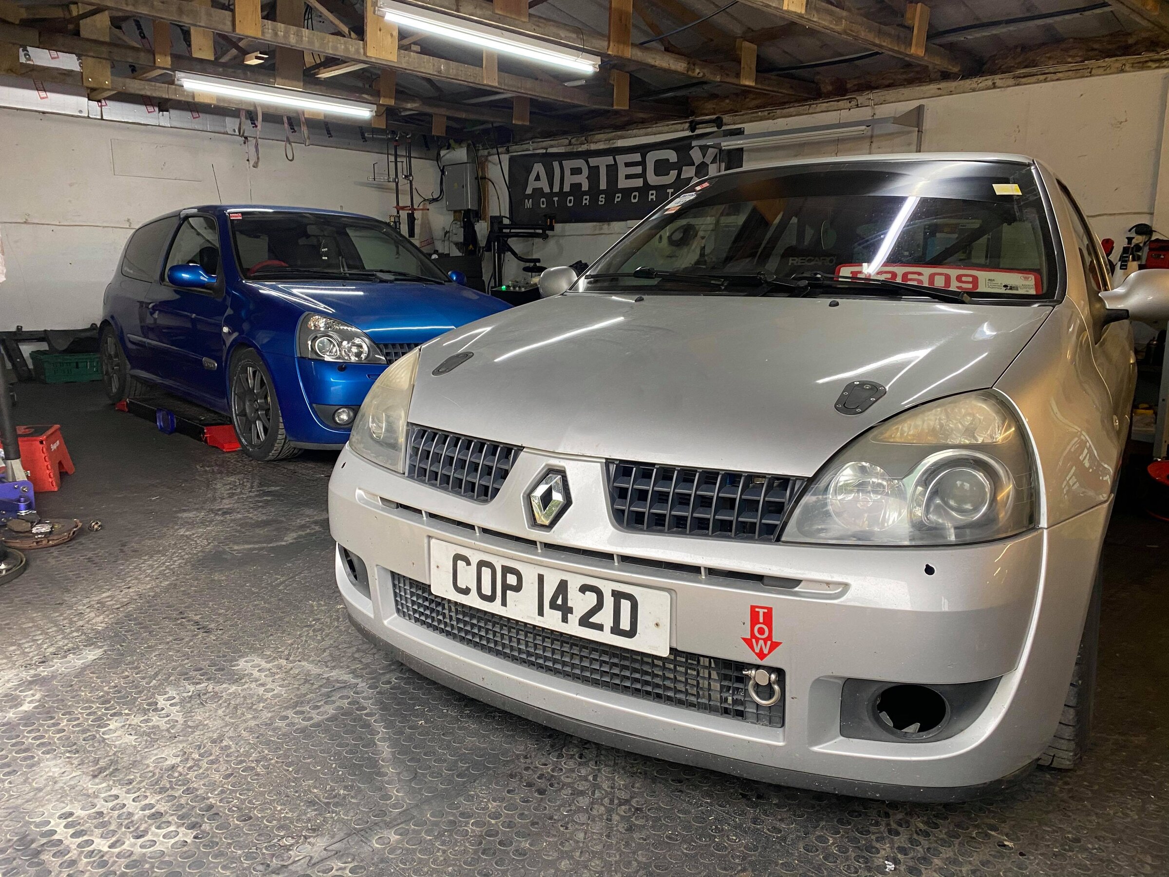

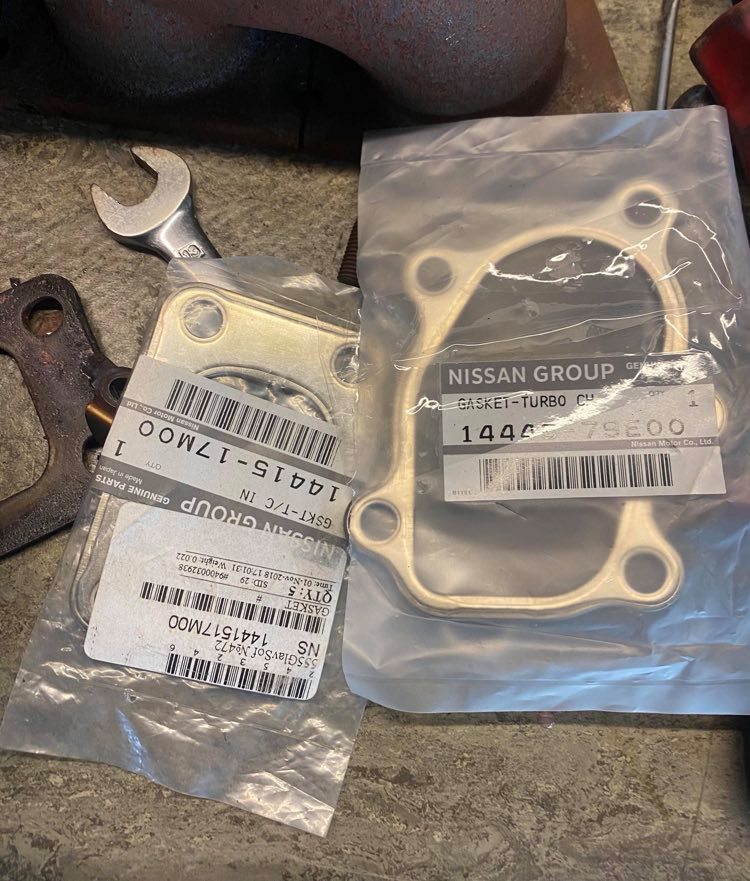

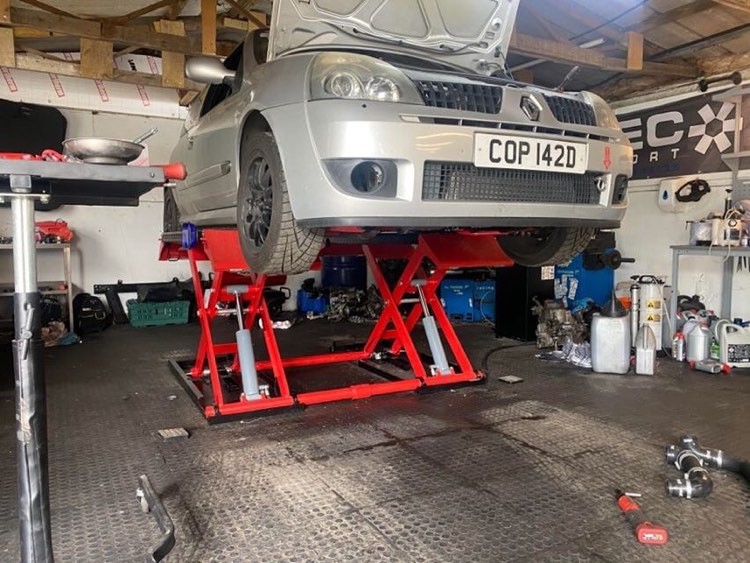

I collected the car this weekend from AWMotorworks.

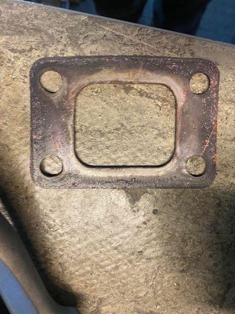

Alex spent some time sorting the following bits for me:
- Replaced the Slide Motorsport copper turbo gaskets with genuine Nissan items and new locking nuts.
- Re-sealed the turbo oil drain, as there was a slight oil weep.
- Modified the intercooler mounting so that it sits more flush with the rad rather than a huge gap in between.

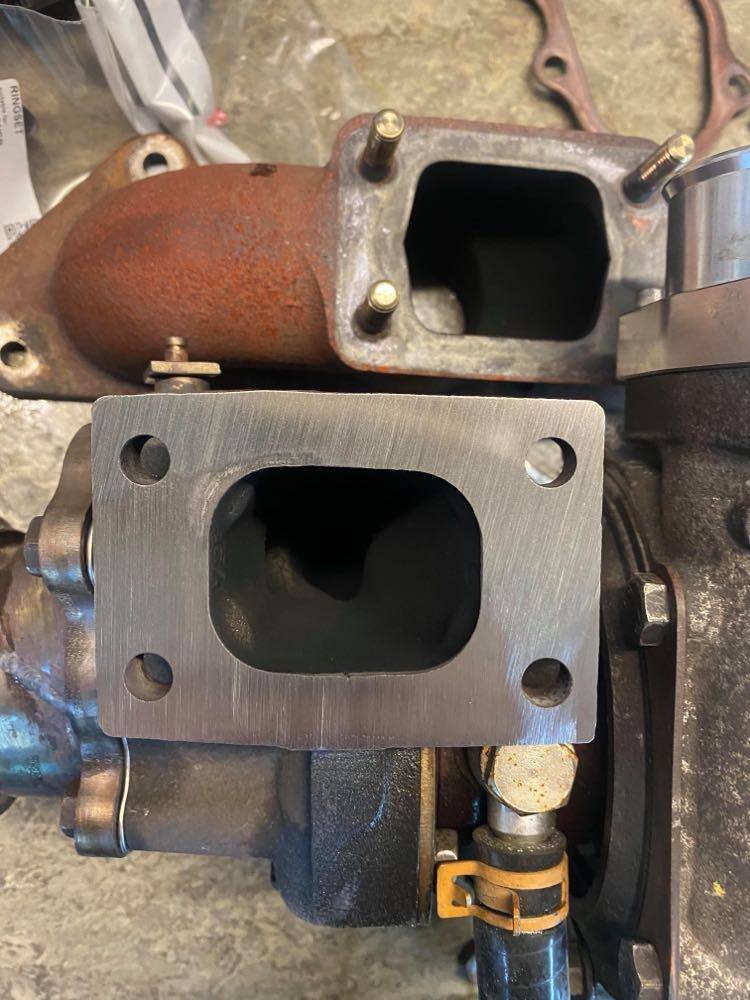

Slide Motorsport copper gasket which failed on Graham's cup:
New Nissan parts:

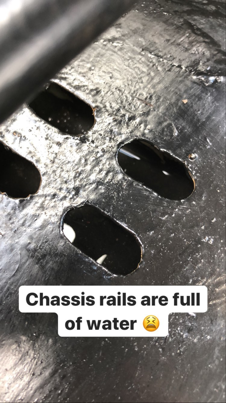

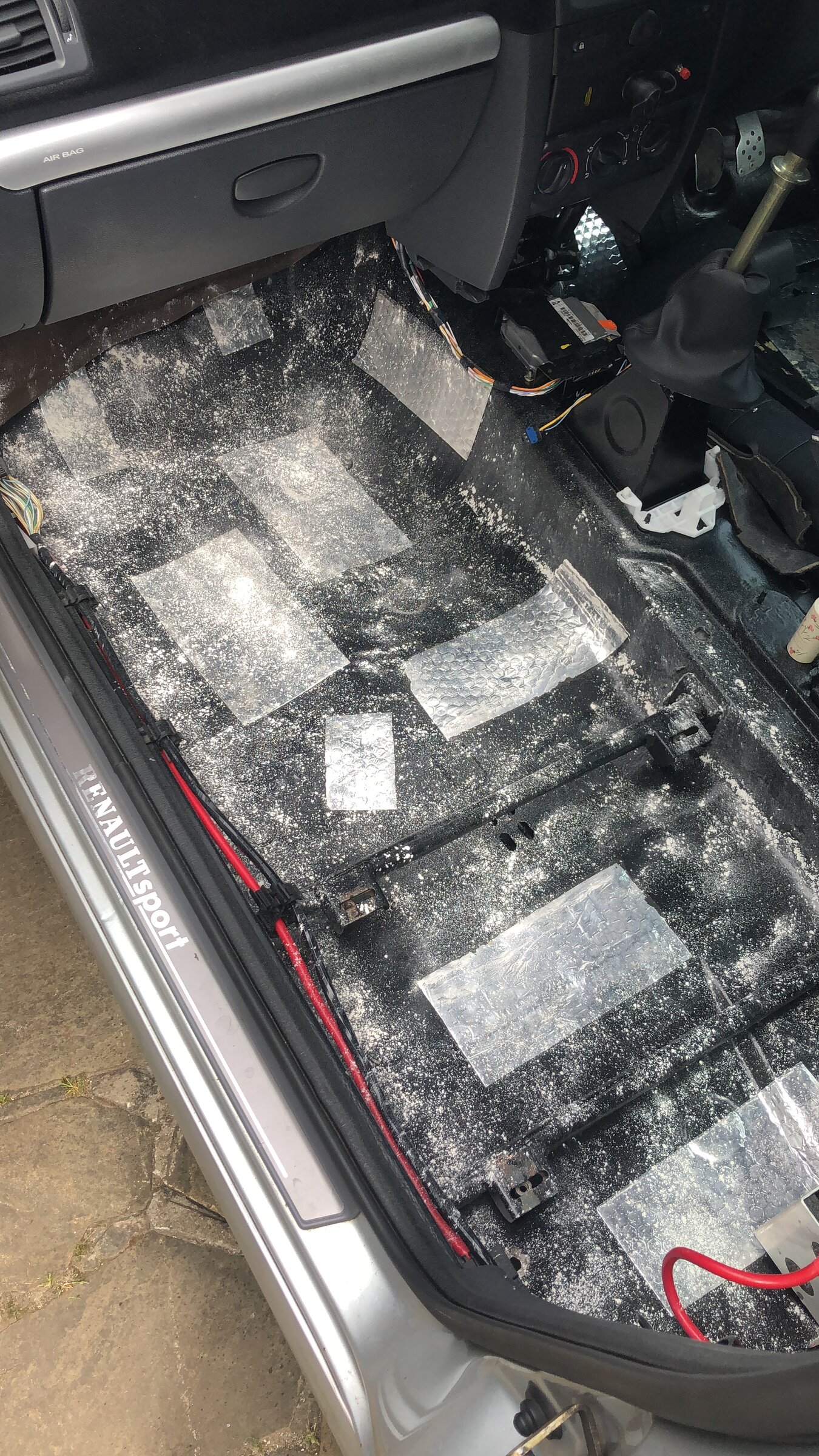

After Alex reminded me to tax it, I drove the car home and it was not enjoyable at all!! The front carpets and underlay are all out at the moment as I'm trying to source a water leak! I originally thought it was up from the chassis rails, from when the car was at a huge angle on axle stands. Although since the car has been back on all four there has been another small collection of water on the floor, so I need to figure out where it's coming from! :mad:
Talc powder to try and source the drips:
Having the sound deadening, underlay and carpets makes such a huge difference to the NVH. I had forgotten how loud and rattly the car was before we fitted all of these back in last Summer! No idea how I lasted five or so years in the stripped out state!
So once I have found the leak I will jump at the opportunity to get the interior back together again! Combined with awful tracking the car was pretty tiring to drive all the way home and I was thankful when I pulled up onto the driveway!
