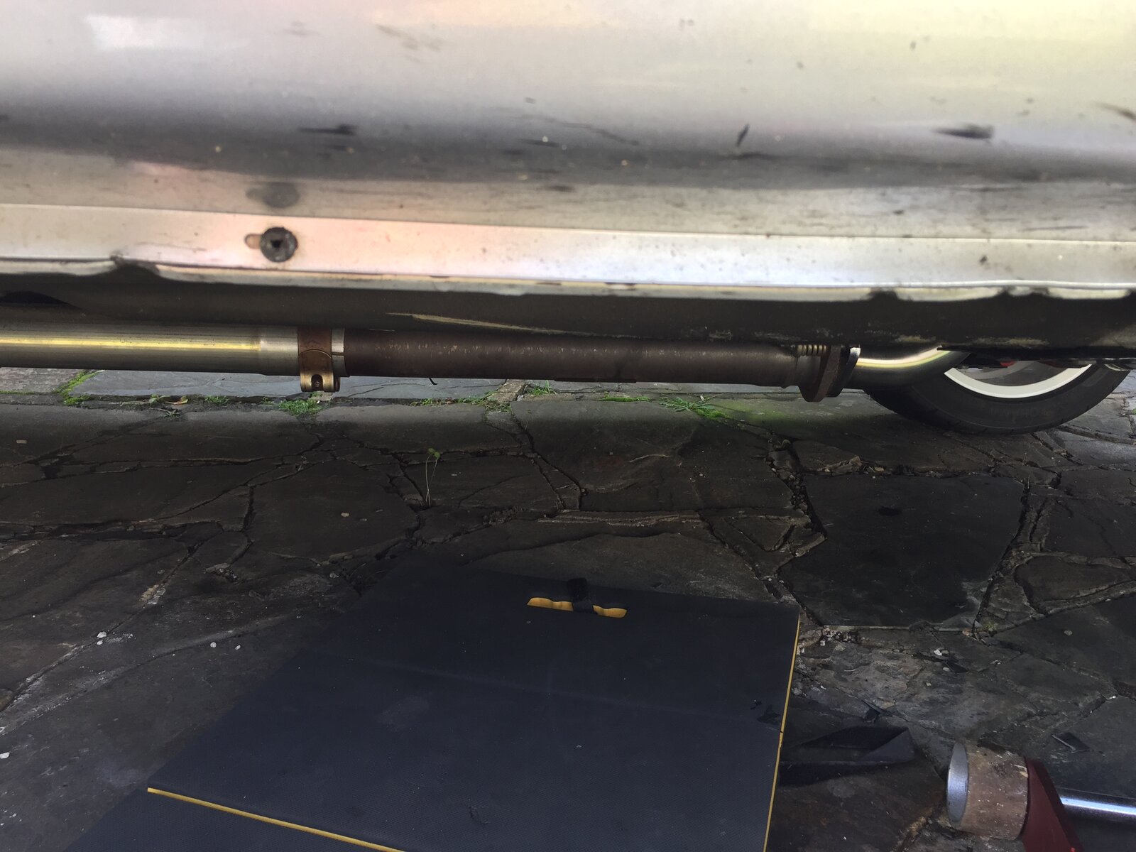

It's possibly a bit lower than normal. Doesn't seem to be as bad as yours sounds though. I'll have a better look and get a pic at the weekend.
It does seem to be a lot of weight freely hanging between the downpipe and the centre section hanger though!

To confirm, the entire exhaust does sit completely parallel to the ground. no lower than the original system. I forgot to take pictures though sorry.

Thanks for the picture, mines site alot lower are the downpipe to cat join the starts to slope back upwards.

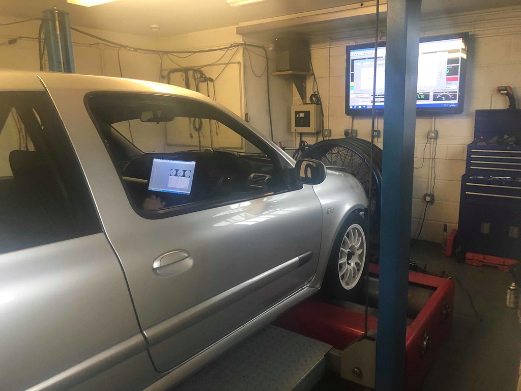

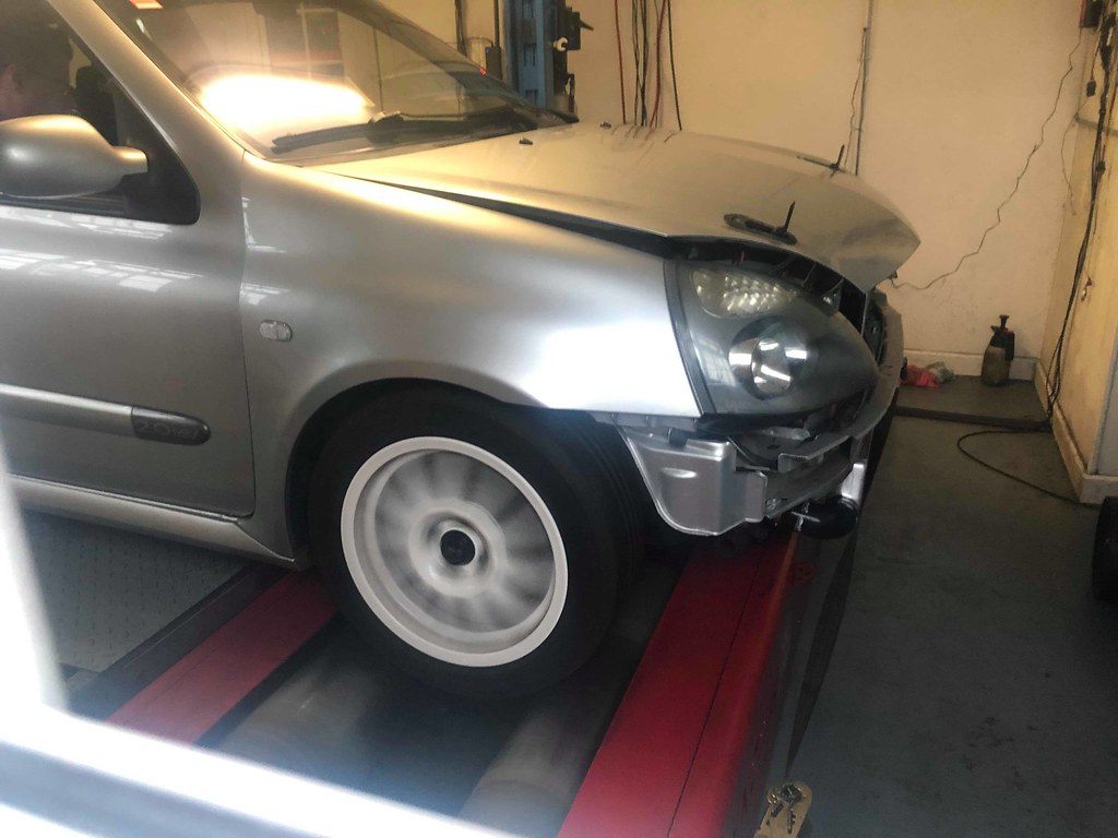

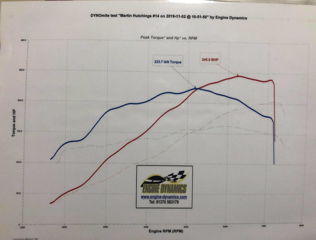

02 November 2019 - Mapping
Graham joined me for a very early start on Saturday to take the car up to Engine Dynamics for running in and mapping. I loaded the car on to the trailer the night before so all we had to do on Saturday morning was sling the tools/spares into the back of the truck and get the trailer off the drive. We set off at 6am and arrived on time at 07:30 :)
When we got there Andy plugged the car in to give it a check over and found that one of the Lambdas wasn't working. Luckily we'd planned ahead and brought a spare so this was quickly changed over and the car went onto the dyno to start the running in and mapping.
Around lunchtime the car was done and Andy was very pleased with the end result. He mentioned that the boost controller had allowed him to hold onto the power a little more at the top end without bumping up the mid range with stupid amounts of torque. Boost steadily increases from a very low 0.45 Bar to a pretty low 0.52 BAR haha. So it should be pretty safe but still feel progressive right up to the rev limit, which was left at the standard 7200.
I wasn't interested in the pub talk numbers, but nonetheless they are pretty impressive:
245 bhp with 223 ft lbs at 6250 rpm.
It's been a long time in the making for us so it was lovely to see great success. We're going to spend another hour or two on the car to do and oil change and get it MOT ready, then we will properly start the next project to see us through winter... The exact same OCD turbo conversion on Grahams new BG182.
Cheers for reading :cool:
This graph is overlaid agaisnt my previous ITB and 421 cam setup to show the insane differences!
I didn't get any decent pictures as it was pissing down and we weren't allowed in the dyno room whilst the car was properly running. A couple of pics from through the window though.
Until next time...

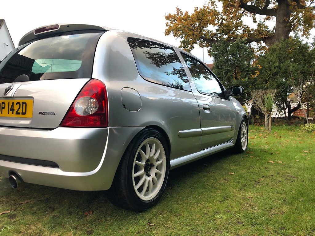

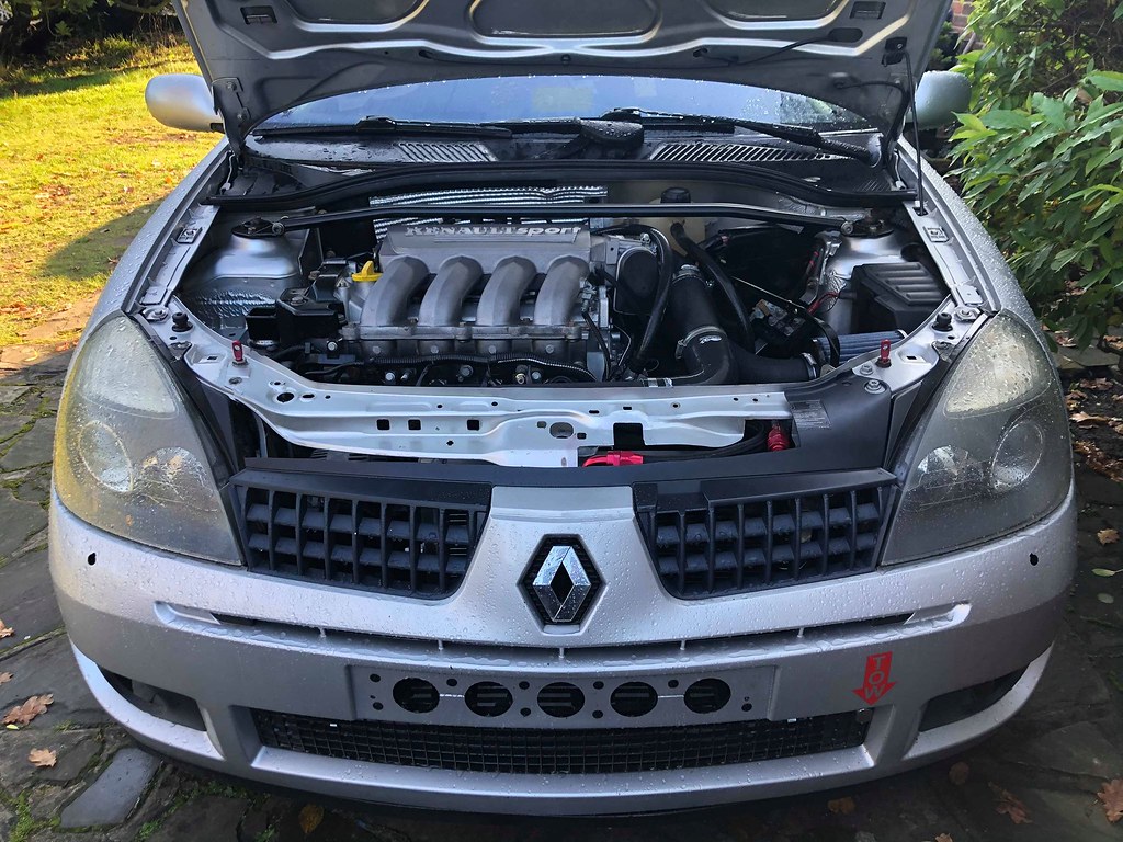

We've spent a few hours prepping the car for an MOT over the last week.
I also finally got a chance to give it a quick clean for some insurance photos. It still needs an good polish/wax though and the wheels are actually pretty grim up close so they'll come off when I next get a chance.

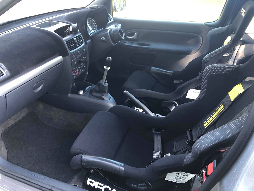

Gents, where did you get your bolster protectors from?
I have a genuine Recaro one for the Clio but im after one for the Cayman, and the Recaro ones do not fit the Porsche bucket seats.
I've got some lovely ones in my R, made from the original seat material too :p
I got them off eBay, but unfortunately I think they company stopped making them for some reason. My friend was looking a while back and we couldn't find the seller anywhere!
The ones in the Clio are just cheap universal ones. Velcro goes under the seat cushion and then an adhesive strip sticks to the side of the bucket seat.
I remember seeing them that were made for the GT2/R seats but as you say, seller went AWOL.
Perhaps i'll have to tray and source some Alcantara and get some made. If possible, would you be able to take some pics of the ones in the R and even a few measurements so that i may get some made?
Big ask i know, but would be appreciated if i could even just see how they attach in there :)
I've got a template somewhere as I was going to look into getting them reproduced for other R owners. Finding the material was the hard part.
Do you have me on insta? I can send you some direct pics on there if so...
