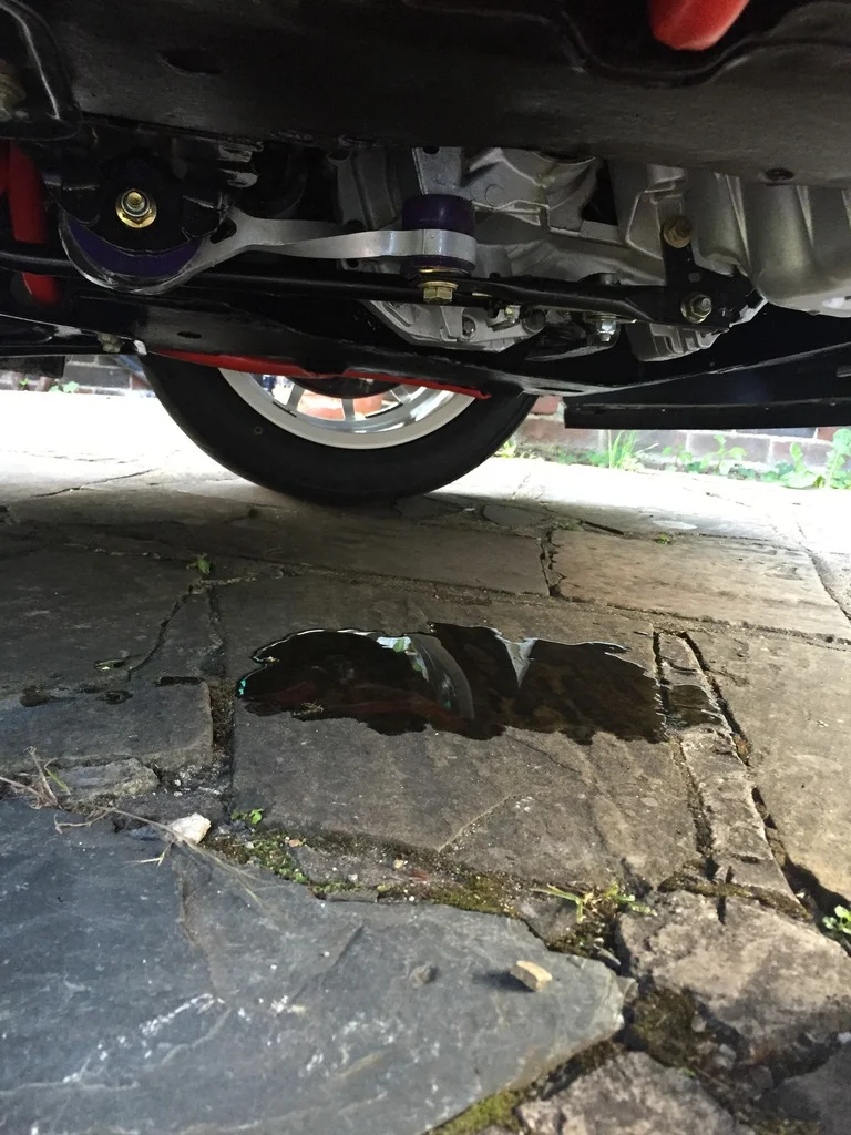

So on Saturday I bolted everything back up and put the box oil back in. One litre at a time, extensively checking for leaks in between. All looked good. I even ran the car on the axle stands to get a good look whilst it was all spinning. Still looking good I put the wheels on and proceeded to take the car onto the road.

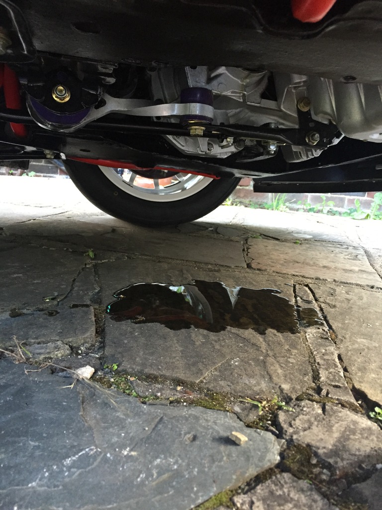

The juddering on the corners has gone now (or I wasn't pushing hard enough to notice it) so that hopefully means the shorter Ph1 shaft has stopped the bottoming out issue, which is great. I stopped up the road to have a look underneath and I could see drops of oil so I jumped back in and headed home.
When I pulled back on the drive, I looked underneath again and the oil was streaming out. I quickly jacked the car back up to try and save the remaining oil and got back under to have a look. It all looked the same as before, so I have no idea why it was leaking so bad. The sleeve was still solid and spinning with the output splines.
By this point I was feeling very frustrated so I left the car as it was and didn't touch it for the rest of the weekend.
Anyway, on a brighter note, I've just spoken to John at Gripper. He was extremely pleasant and very helpful.
He explained the old and new design of diff to me. The new design solves this sleeve leak issue. He then offered to send me out a new longer and smaller sleeve and gave me some advice on how to fit it if I wanted to try it on my drive. He said if not I could bring the gearbox to them and they would sort it for me, all free of charge. The turn around is 3 days and they would then TNT it back down to me.
I did consider having another attempt on my drive, although I've now been swayed to just send it back up to them. This will no doubt be more reliable and eliminates any errors on my behalf.
So this weekend I'll take the Gripper'd box back out and get it back up to them. Can anyone recommend a decent courier for a gearbox? Or does anyone I know happen to be heading up that way in the next week lol.

Another little update....
A very productive weekend for me. This is how I left the car on the last update (August 5th)
That weekend (August 8th) @GrahamS very kindly came over to help me get the gearbox back out again. This time, as above, it was going back up to Gripper.

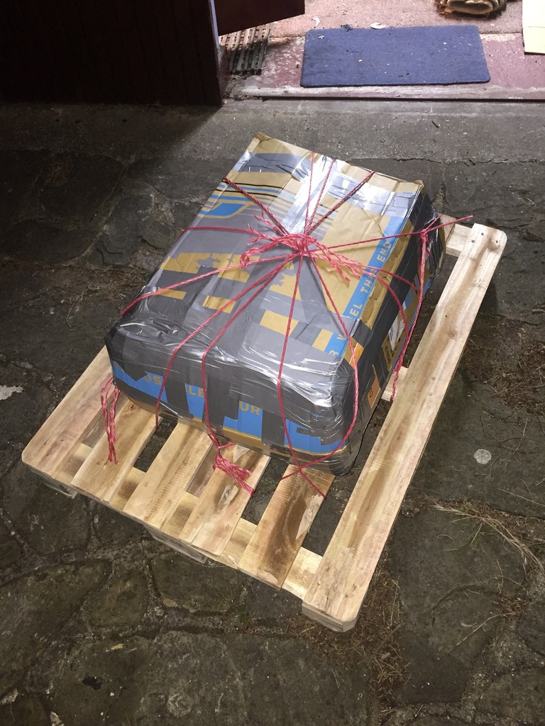

So as instructed by John at Gripper, I boxed the entire gearbox up and stuck it on a pallet.
To my surprise John then arranged for TNT to collect the box from me. This was a very welcome gesture.
They received it next day and it was stripped down on the side of other jobs. It was only 7 working days from collection day to re-delivery!

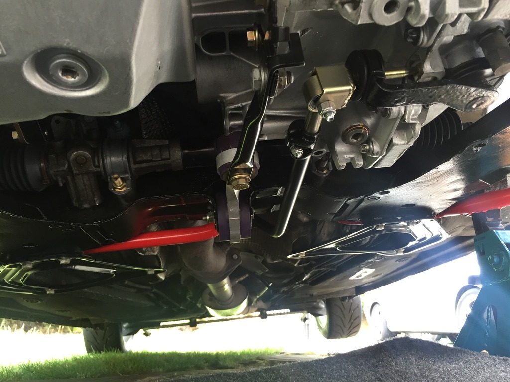

So this weekend (August 27th) I thought I'd give it a go and get the repaired gearbox back in myself. With an extra pair of hands from the old man. Graham also swung by again, just as we were about to put the subframe back on. So he helped us maneuver this into place as it's not the easiest job when the car is on stands. Everything else was bolted back on, the gearbox was filled with 3.1L of oil, and the car was put down on the ground and tested.
Finally there are no oil leaks (yet anyway) and it's nice and clean underneath again..

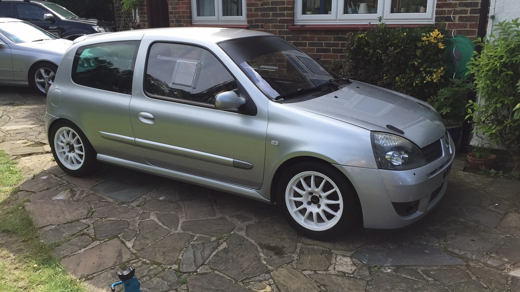

I took the car for a blast on the road and everything feels sweet. I'll be looking at Brands Hatch track days today and hopefully getting something booked.
I'm glad I cracked on with the gearbox job myself. It did take me about 8 hours all in 😂 but now I know it's something I can do in the future rather than having to make others do it for me.
Big thanks to @GrahamS for once again offering a helping hand. Hopefully he can get his cup on track with me.
I'd also like to give a big mention to Gripper. They have been absolutely awesome. John was extremely friendly over the phone and they have gone well and beyond their warranty responsibilities. The picked the box up from me, repaired it and sent it back down to me without charging me a penny. So I'd recommend them to anyone now and I wouldn't hesitate in giving them my business in the future.
