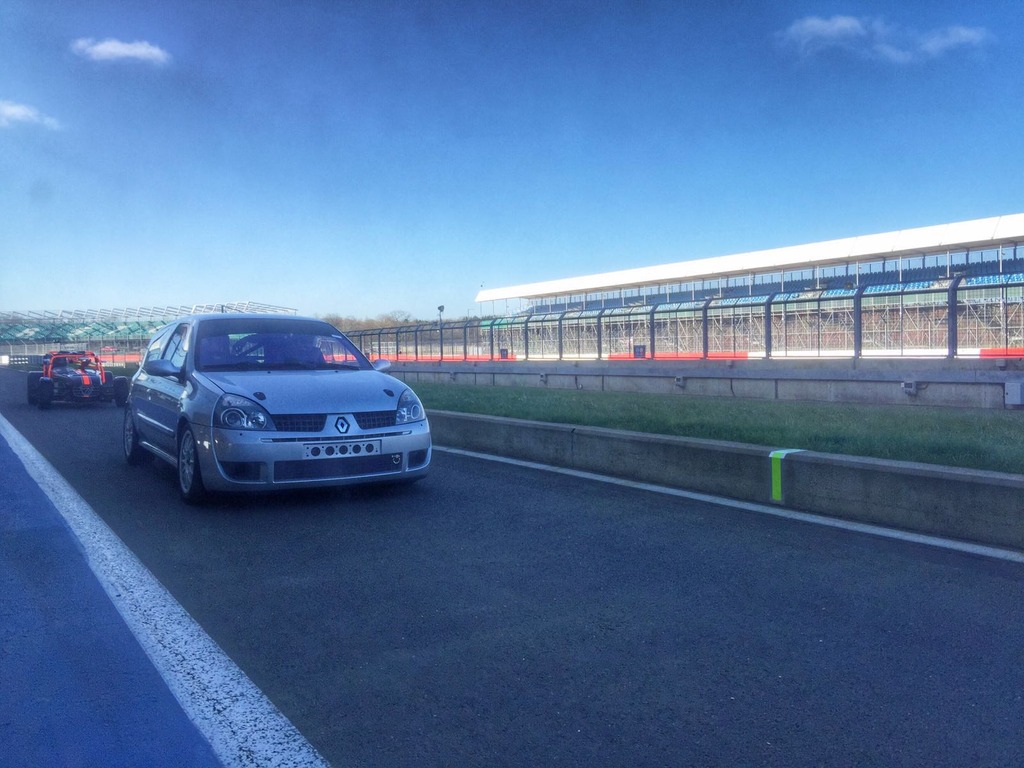

Had an awesome day with the Clio at Silverstone yesterday. It was my first time there and it was on the very fast GP circuit so I was a bit nervous at first, not knowing what corner was coming next. My dad was a lot more cautious, but I was able to encourage him to be a bit braver towards the end of the day. What a great circuit it is though, would definitely like to return at some point.
It was a freezing cold day but the sun was shining, so it was perfect Motorsport weather.

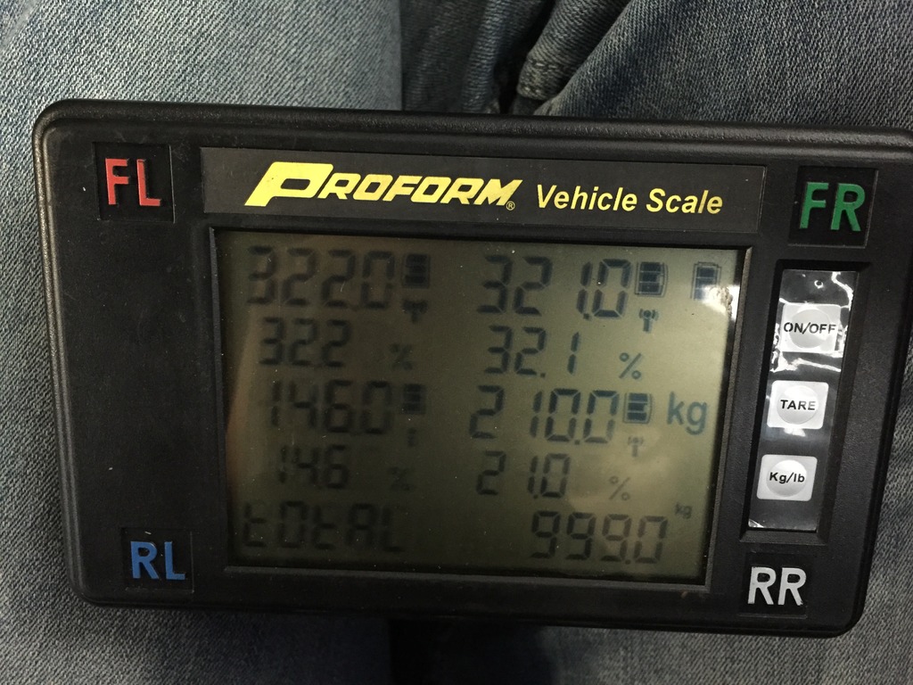

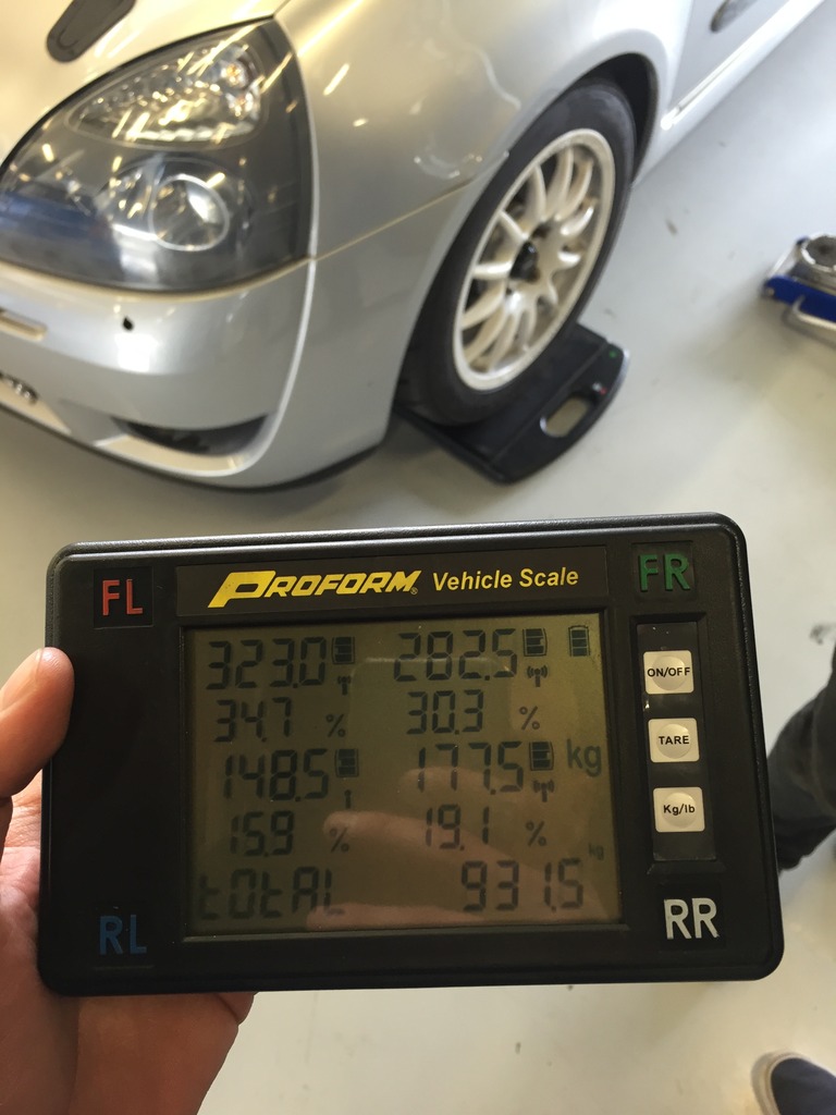

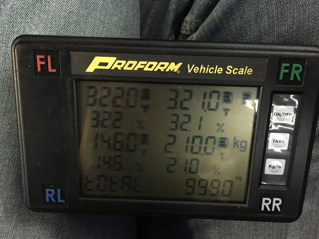

My car felt great all day. Especially after a quick lunch time tweak to the corner heights by my good pal Ant. It felt amazing after this! Thanks to Andrew for hiring out his scales. I was also pleasantly surprised with the weight of the Clio. Considering I still have ABS, three rear glass windows, all steel panels and a passenger seat in.

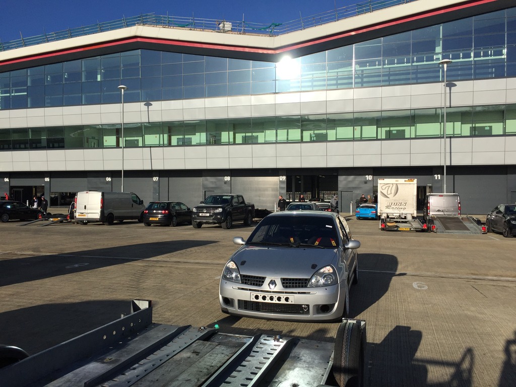

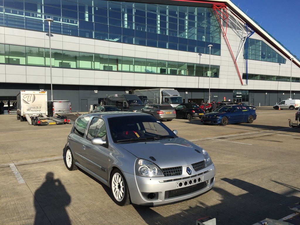

Getting the car and tools ready on Sunday afternoon.
We have arrived.
Starting weight.
After, and with me in it.
Last session of the day for my old man.
is that 931kg total? Thats light! No cage I assume? And no fuel either? :tongueout:
No front section (yet) but a SD rear section with double cross and harness bar.
Just over 1/4 tank fuel. Forgot to mention that. So would be about 10kg extra to get it up to half a tank. (Assuming the Clio tanks are 50L)

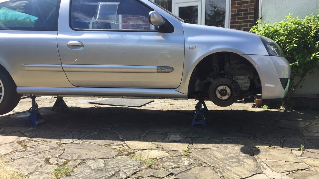

@AlexW came down this weekend to help me sort out the recent issues.
Whilst I was faffing around getting the old seal out, he did also change my nearside drive shaft over to a shorter Ph1 one. Which I can confirm was about 10mm shorter. Thanks @Mini182 for confirming this issue. It did look as though the shaft was bottoming out in the diff, you could see some small marks. Hopefully now it'll be sweet and not too short though.
