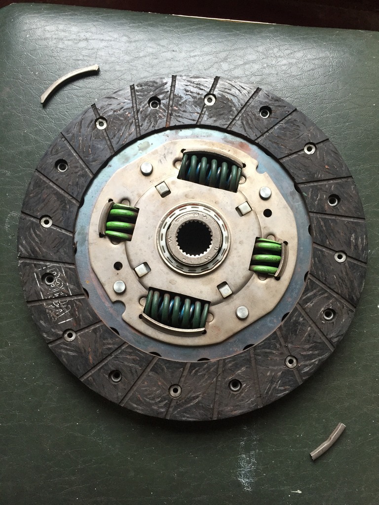

After investigating some other potential issues they both decided it had to be the clutch, assuming that this gearbox was OK. A quick text to James confirmed it was most likely the clutch and that the box had barely been used. He had experienced a similar noise before also.

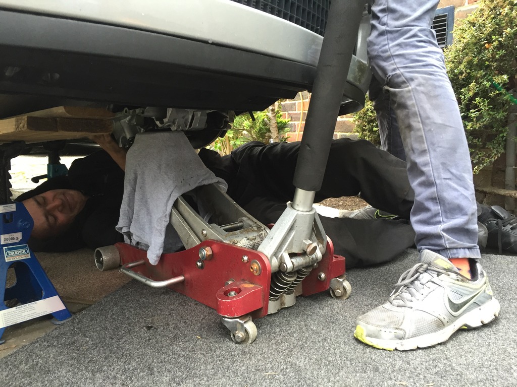

So within the hour, Graham and Alex had taken the wheels, shafts, subframe, gearbox and clutch off. To find this:
It was a clutch failure all along and not a dead gearbox as everyone at Bedford had suspected. But because I was so quick to source another gearbox we literally straight swapped it over without even touching the clutch. As you can see the clutch was basically brand new anyway, so no one expected it to be the culprit.
After a quick laugh (tears from me) over how I'd spent all that money on a new box for no reason, we hatched a plan. We called it a day and the guys made their way home.

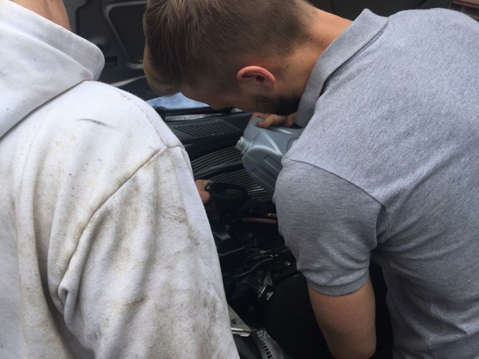

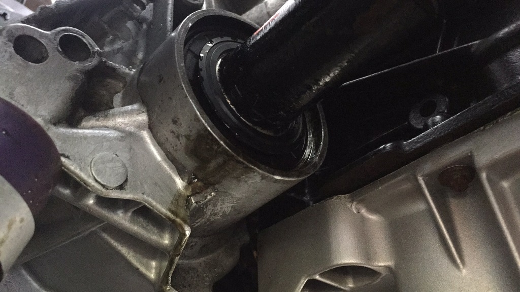

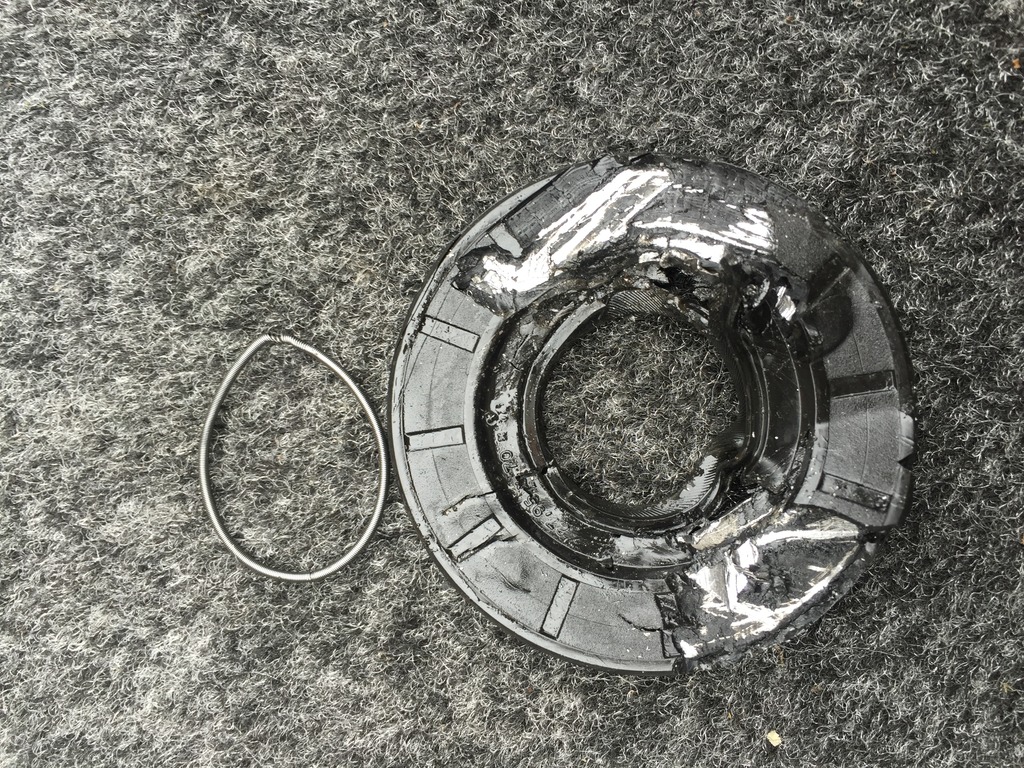

Fitted a new seal to the box where the O/S drive shaft connects, was a b**ch of a job getting the old seal out but got there in the end. I put 2.3L of oil back into the gearbox as that's all it had left in it when I drained it. Was 3 fresh litres a couple of weeks back, so I've lost 700cl from the leak.
I'll top it up when the new stuff arrives, hopefully today. Then start the car again and give it a test drive around the block. There's no leaks yet so I'm hoping there will be nothing when it's full and has been driven again.

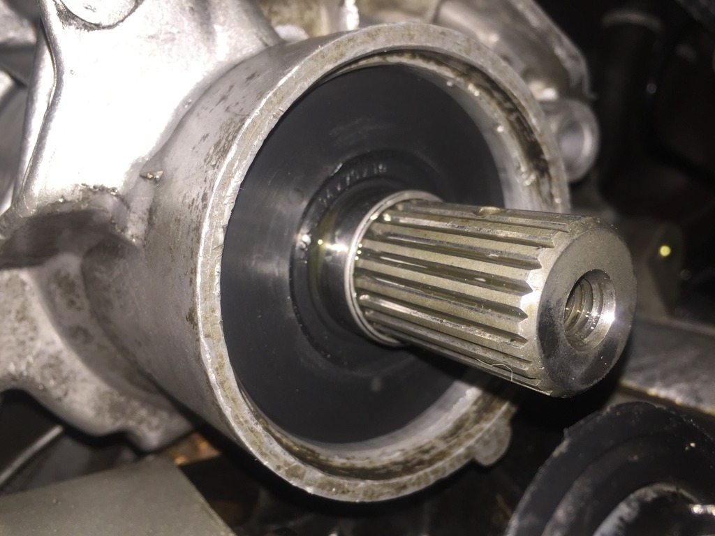

Doesn't sound too good! What is the oil seal collar, the silver sleeve in my picture?
I'm not entirely sure how old it is to be honest. It was Porkies old box. I'm told it had done about 3 track days since it was rebuilt though.

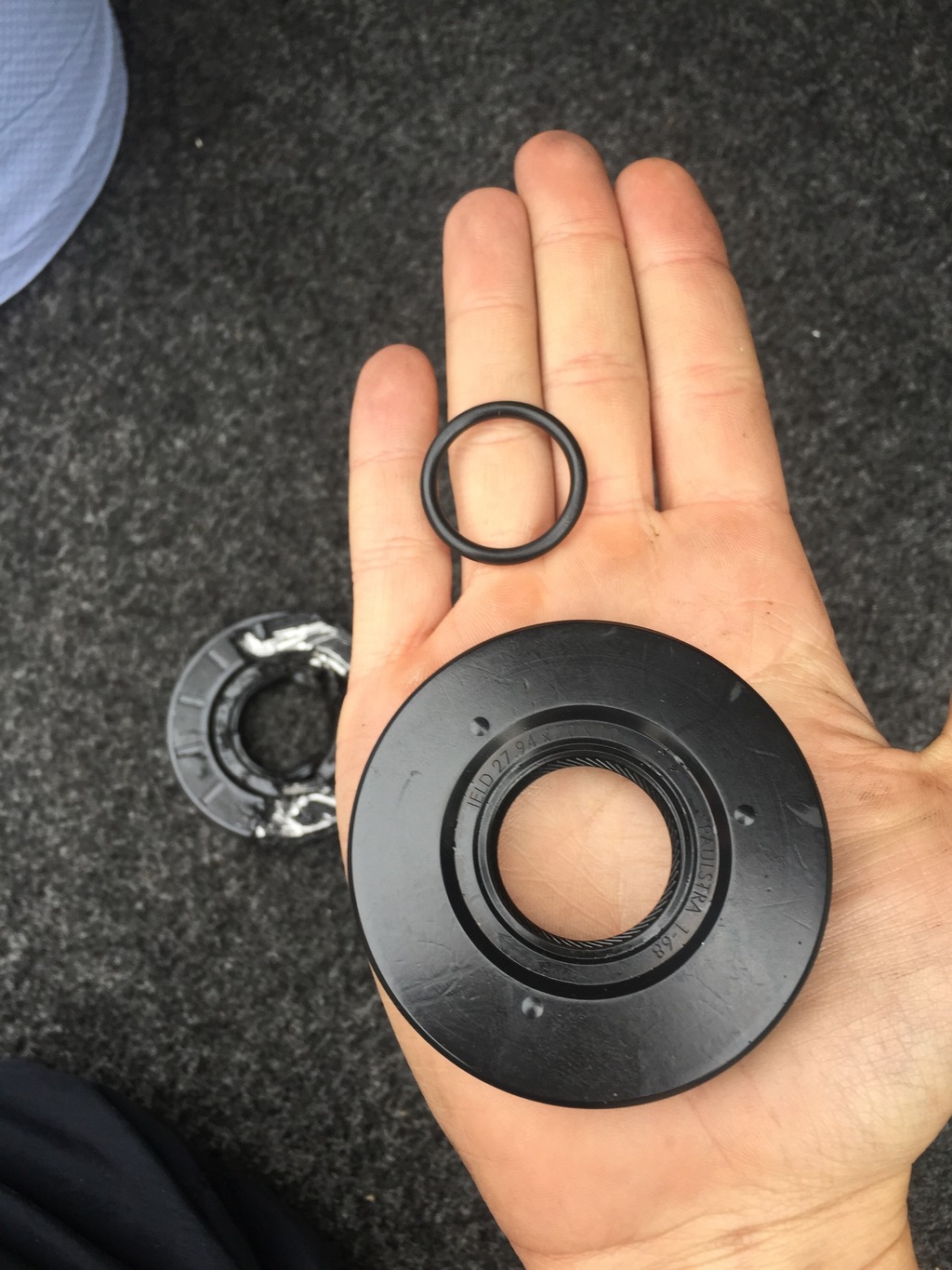

Old seal
New item
Fitted in place. I used electrical tape and a mallet to push it in as square as possible.
Then fitted the rubber o-ring right down over the metal sleeve. No pics of this.

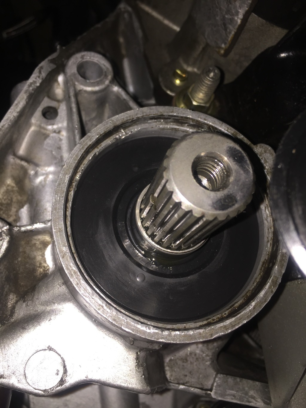

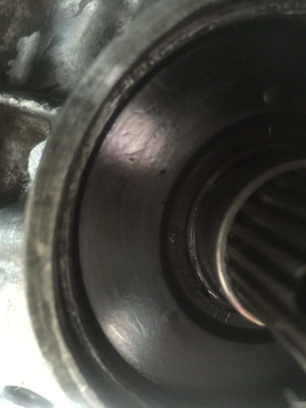

The oil seal collar is that silver sleeve that sits over the splines. On the older diffs this is just glued on to the shaft, and over time the glue breaks down and the oil tracks along the splines making you think the gearbox oil seal is at fault.
If you look at this pic you have taken the splines appear to be full of oil, if it was just leaking from the gearbox oil seal itself these splines should be dry, so I reckon there is a possibility that might be your problem.

Although I think I might have just poured oil over the splines before taking that photo. Can't remember for sure now.
