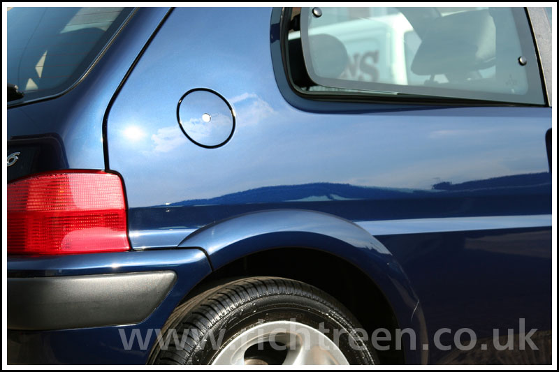

Normal IP PO91L tends to dry out before it does it's job on a warm day, I am thinking you are not getting longer enough work times with it. Worth looking into PO85RD 3.02. Worked for me last weekend even on a warm day that I would noramlly have decided against doing any polishing on but had to take advantage of. Also on a Blue car.
PO85RD 3.02. and Menzerna Final Finish (PO 85RD)
Still use the lights in Sunlight to inspect, as it allows you to alter the range of the light on the panel and avoid missing anything that is going to annoy you next time you see it under the sun or under the petrol station lights.
I am not a fan of Powergloss by PC a little bit to harsh for it, can only get it to work here by 4 inch spot pads.
^ Looks great rich! I found that with the older Menz, needed a good spritzing mid polish! I'm tryin a new polish next weekend that the body shop gave me (3M)
Cheer Ali.
Yeah the PO91L tends to need some QD to get the required work times out of it on warm days for sure.
