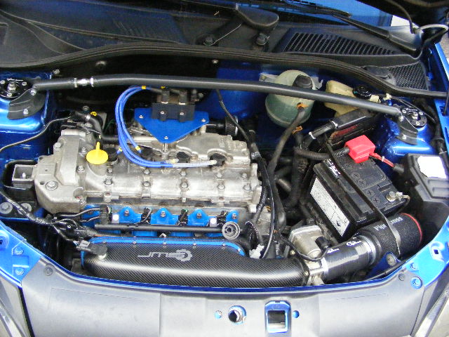

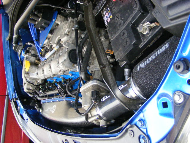

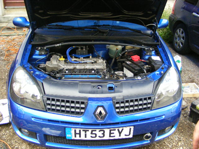

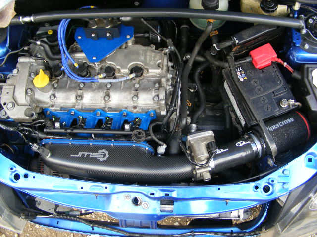

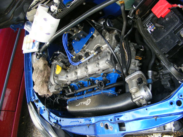

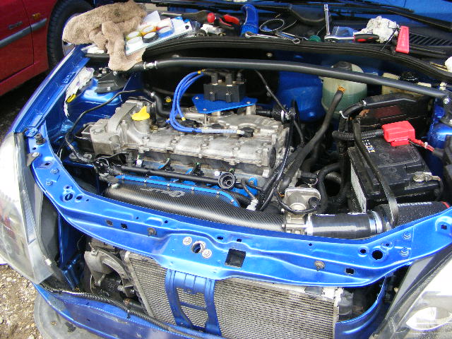

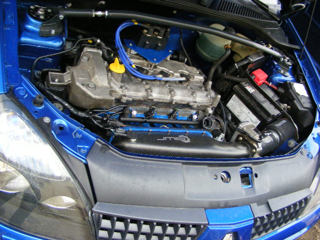

Firstly some picture with the JMS RS2 fitted. Man! What a bit of kit! It’s pretty, and it performs! We even manage to pull extra horse out of it with our Semi GR/n cam tool and other head to manifold adjustment. Result is outstanding 204 Horse power ,199.6hp (din corrected) with standard cam and standard engine internal as well as standard rev limiter.
It was not like that at first test on chassis dyno with result as low as 161 hp at 6900 rpm to were we are right now, a lot of work as been done in development as well as choosing the right associated part to make the engine acoustic perfect. We can say now that we know pretty much how to tune that awesome piece of a kit from Stone Automotive.

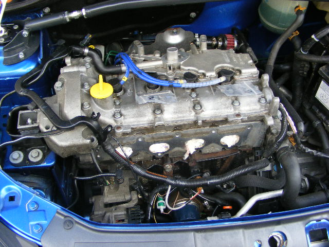

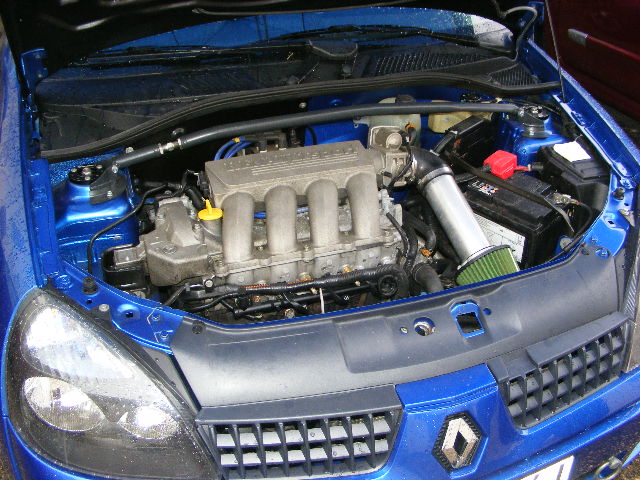

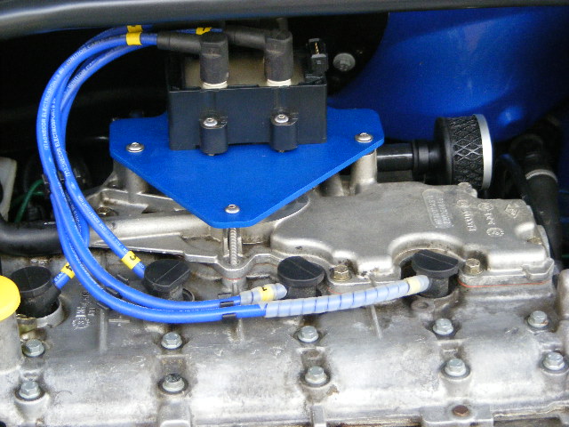

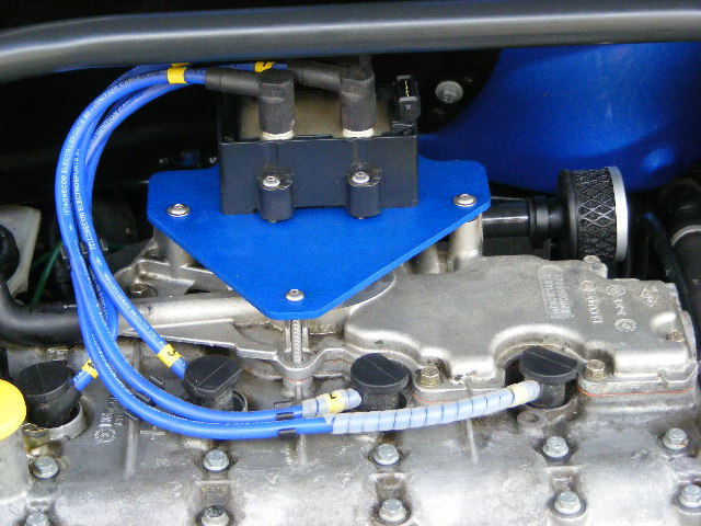

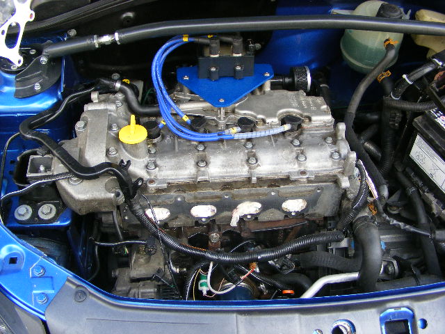

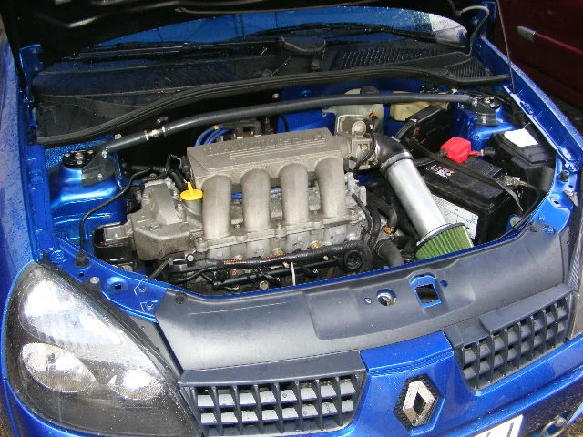

Old manifold out…
Coil pack fitted.

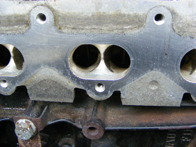

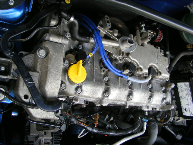

A look at the head inlets, wich are not too bad for a 172 head.
http://nsm05.casimages.com/img/2
011/09/12//110912104337421648735505.jpg
Kit is almost in place.

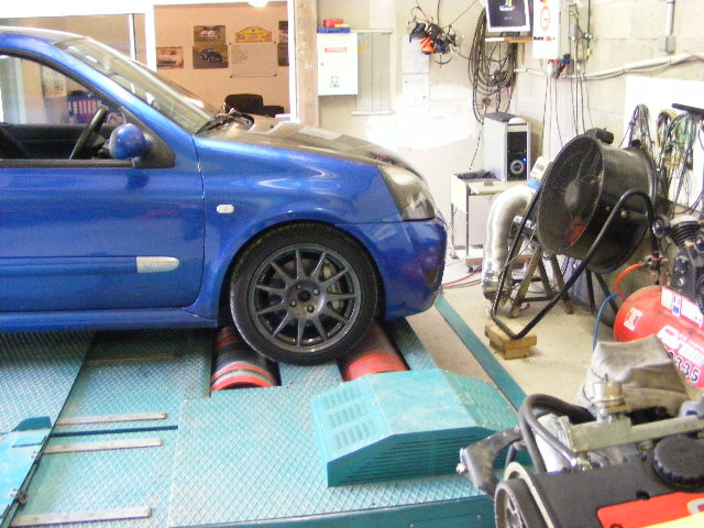

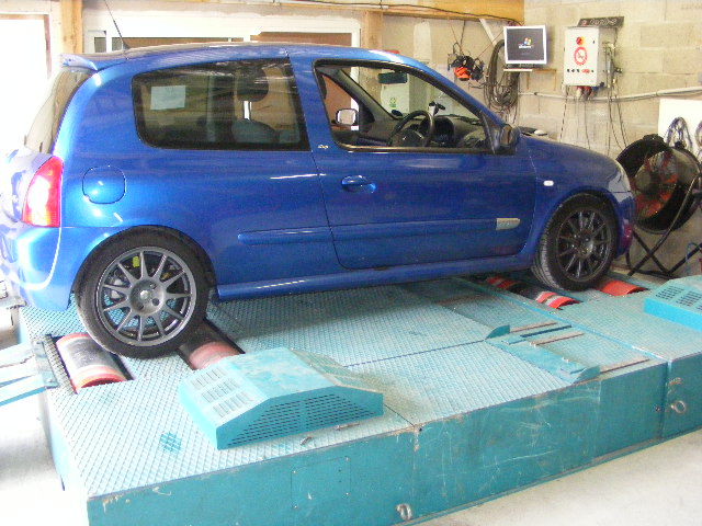

The car on one of the dyno ECU/engine tuning.

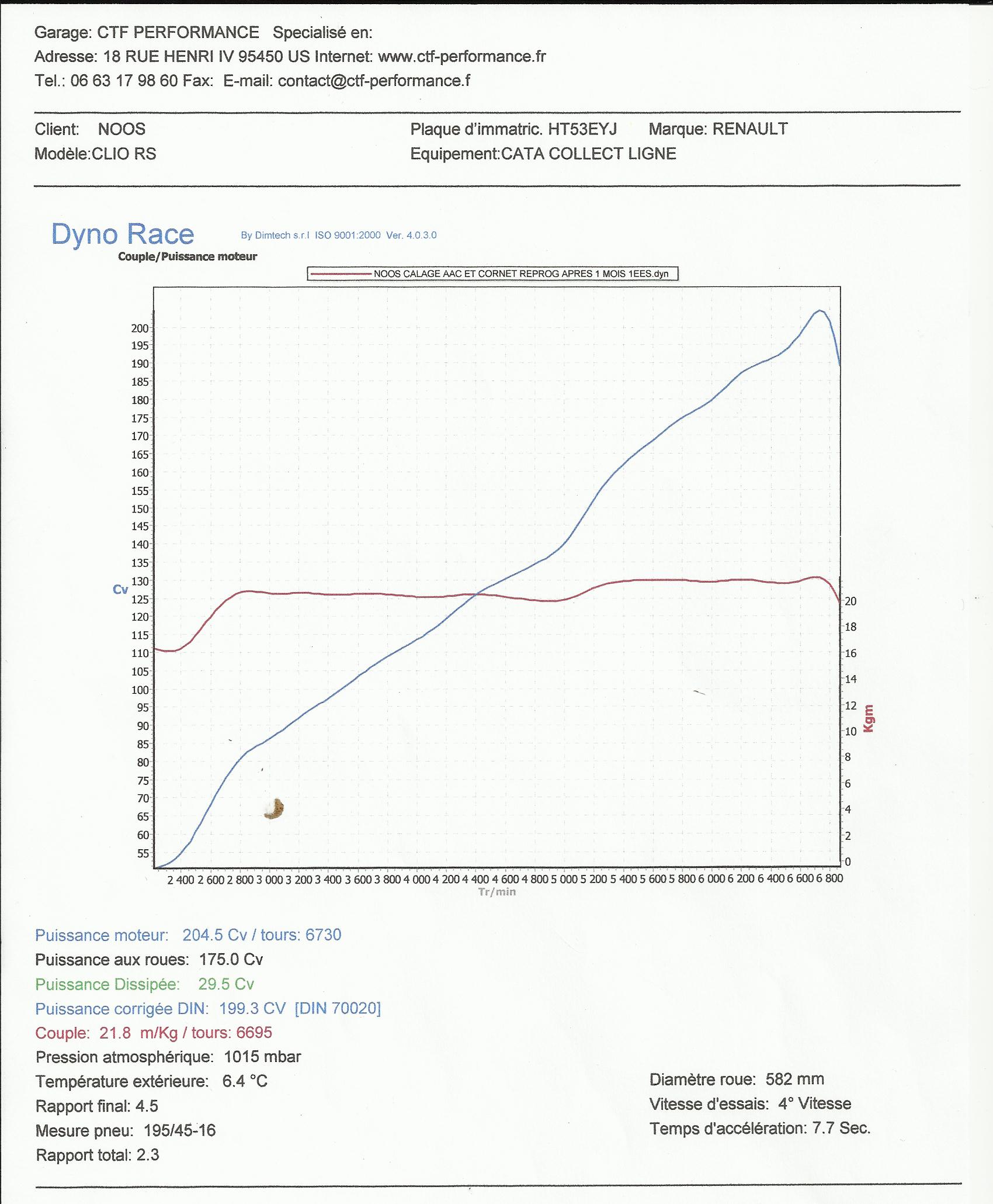

And the final result. (as for now!!! as we still have cards up our sleeve for improvement.)
More update to come…………..
looking good mate. Is the red line torque? If so it's really low for a modded 1*2. Standards tend to peak at about 150 ish.
Yes!
204HP (199.6 hp din corrected) at 6900RPM
175 HP to the wheel
157.6 foot/pound force of torque flat from 2700 RPM to 6900 RPM
it is impressive ! 100hp per liter.

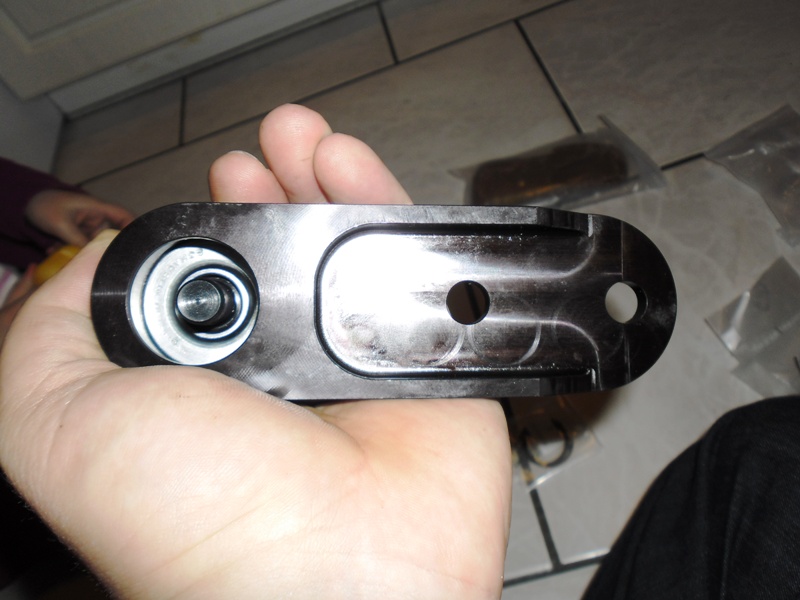

Well... there are 2 pieces brake disc off my trader section :rasp: (285mmx26) but I did not take the time to take picture but it will ultimately come...
But on the other hand I have track data.....
I was breaking better that all megane 3 and 2 RS as well or better than Porsches or lotus ect... with very low working temperature.
After 40 minutes of track on slick tires (so hard use) disc were at 250 Celsius and caliper at 100 Celsius.
I was using CL RC6 that day but the working temperature of my system demonstrate that i could probably get away with road or fast road break pad and be just as fast.... I'll be testing another product of my trader section which is Black diamond fast road pad rated up to 500+ Celsius.

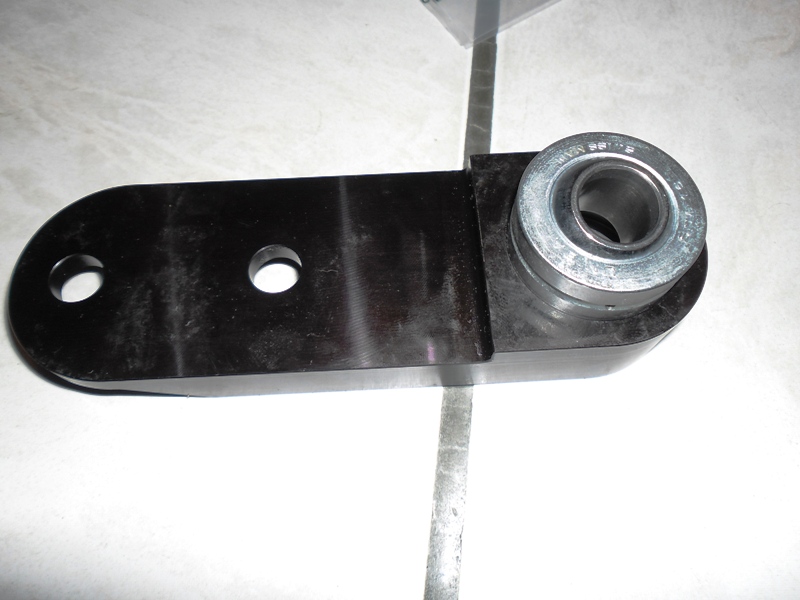

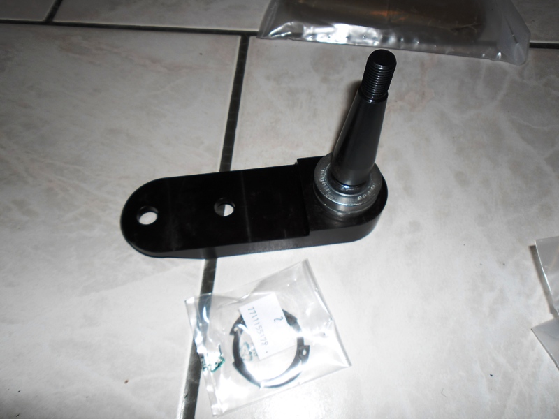

I've also fitted B14 coil over my "Via rouge circuit" because the car is lighter and lighter and as you can imagine high adjustment became necessary, but in the process the handling and the balance that i had with my via rouge went to SXXt and i have to take the car to a wheel to wheel weight adjustment to restore that neutral balance that fit my driving style. that too I did not take picture. :S

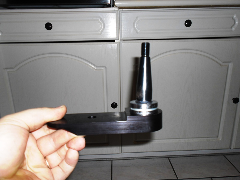

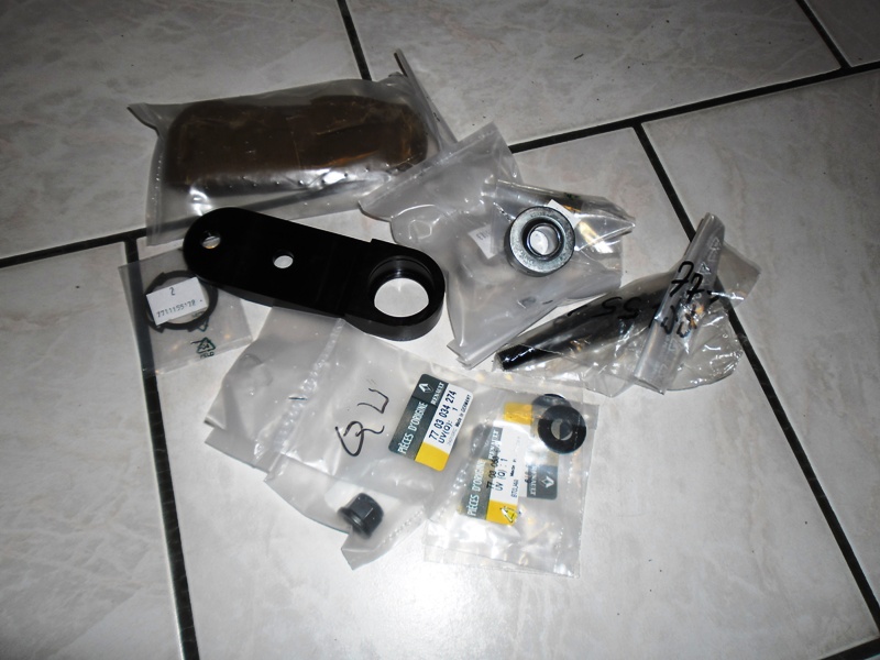

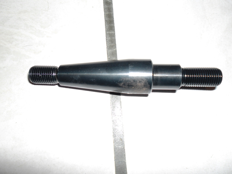

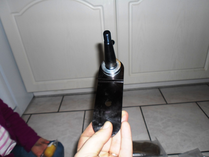

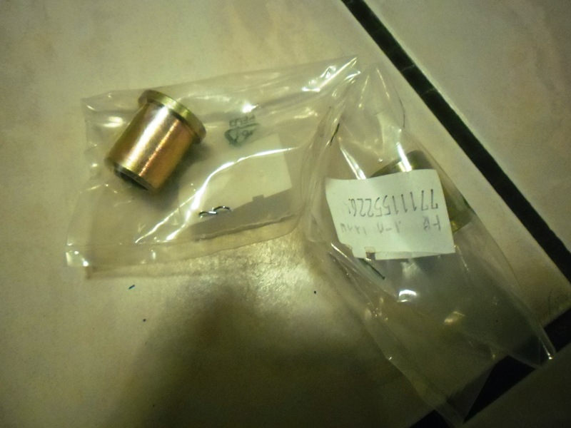

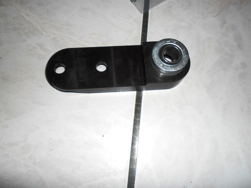

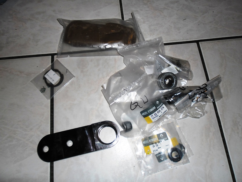

What next..... is a wider front and rear end gr/a style... with some parts off the Renault Cup racer, and some parts of other Renault model (specific drive shaft, specific hub to be modified, ect... ) car should be wider in the front by 2 to 3 cm (1") without using spacer. and everything should be plug and play. :evil:
Find below pics of parts necessary from the Clio cup racer.
I'll be posting more about it when it get done but I will also assemble similar kit if people are interested.

I've spotted Drive shaft compatible to install my Cup racer front end. just need to go get them....

I have replaced my front A frame with brand new one originally made for clio V6.
And as you expect my cup racer set is is on and working.
After all I’m using Renault safrane upright, hub and bearing from a laguna 1, bottom mount of the Billstein cup racer shock to match the upright…. Very specific driveshaft….
Right side drive shaft from a laguna 1 mk2 2.0l(f4r)
Left side drive shaft from a laguna 1 mk1 2.2D
Any other set up won’t work… and I have tried many…..
