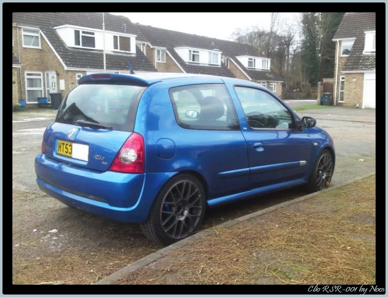

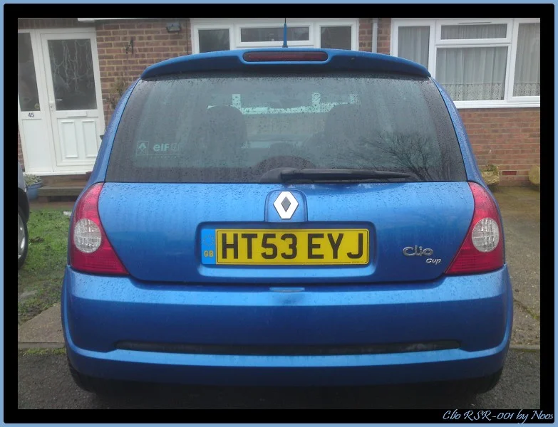

This how I bought the Car:

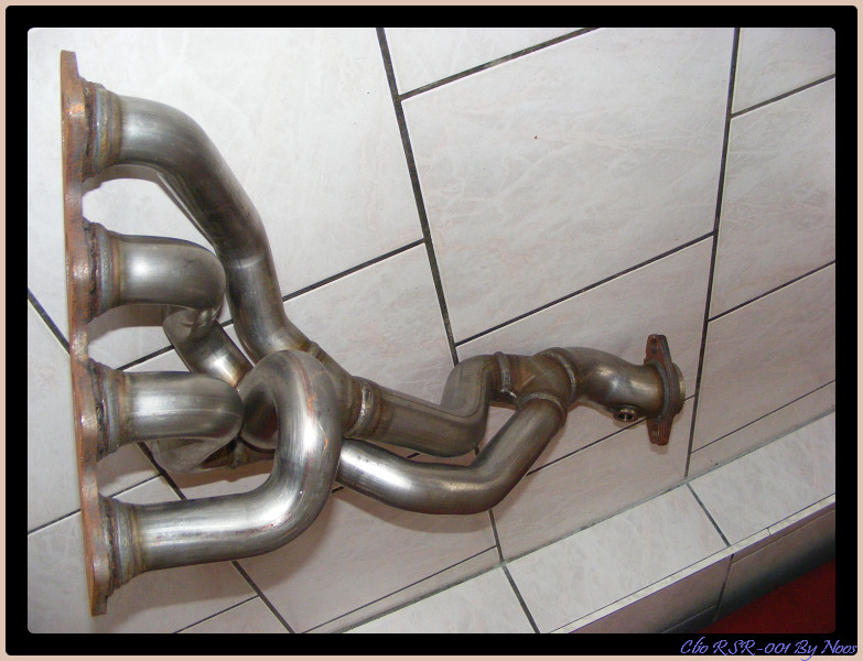

- 4/2/1 Clio racing cup stainless steel manifold ( similar to a 182 but better)

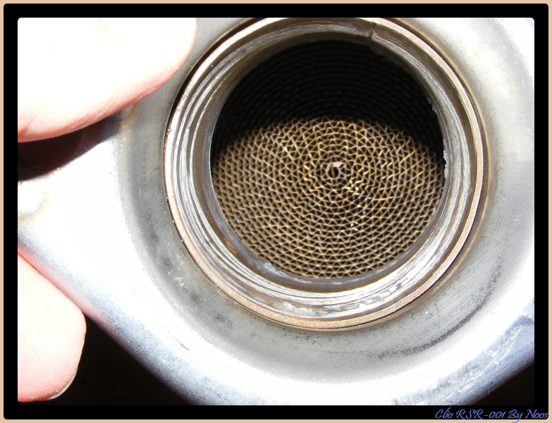

- 200cell sport cat

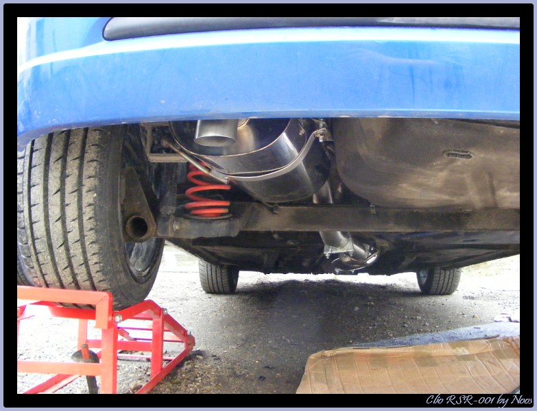

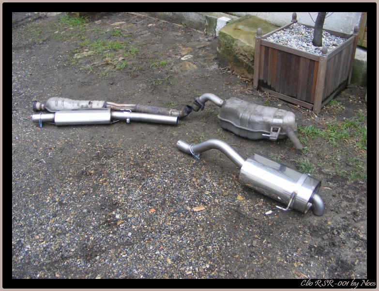

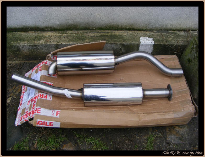

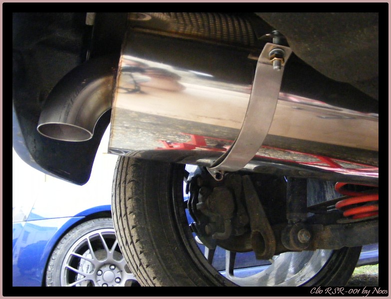

- k-tec 65mm stainless exhaust
- Fast road Via-rouge Track shocks with - 40mm Apex (awesome s**t !)

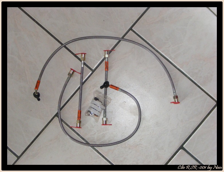

- braided hose front and rear.

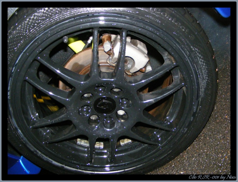

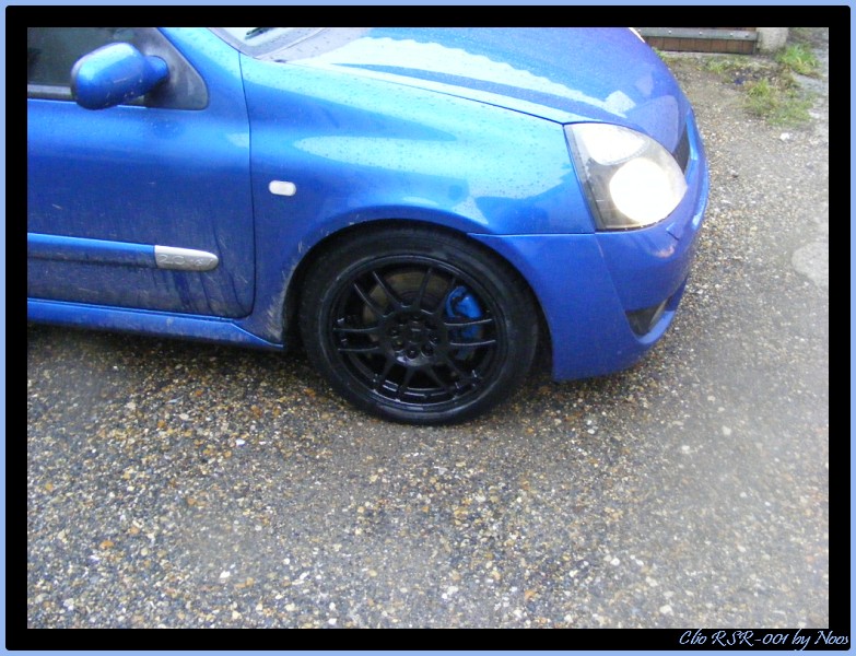

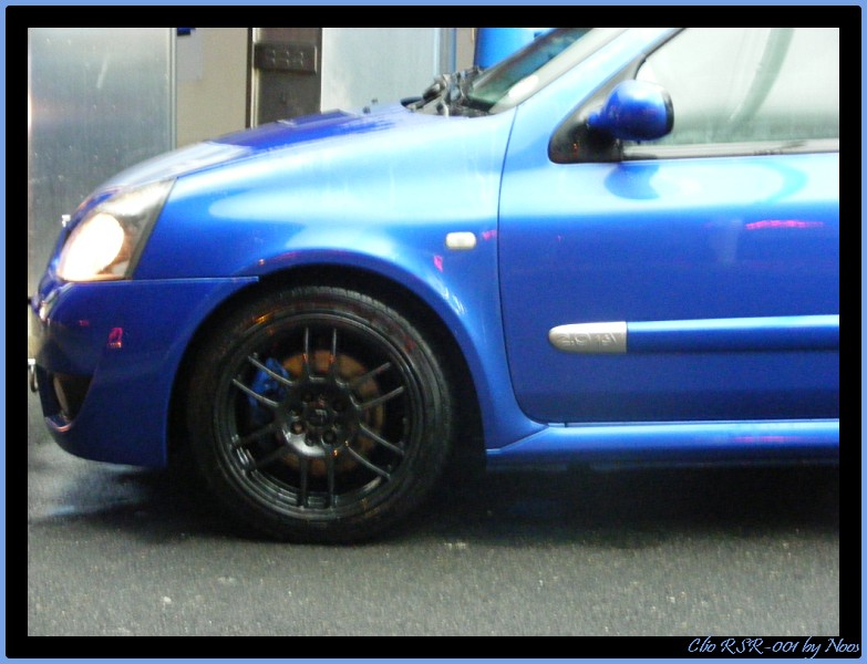

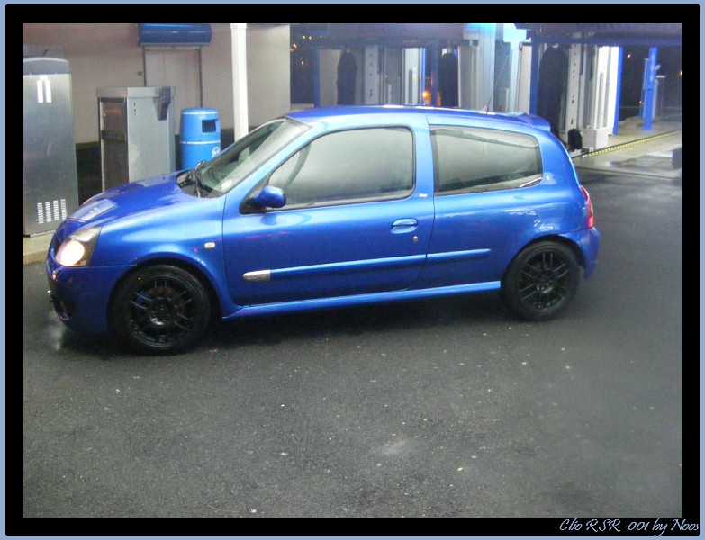

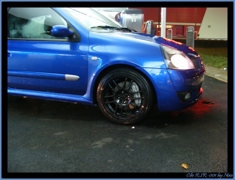

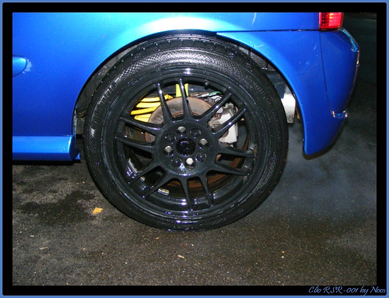

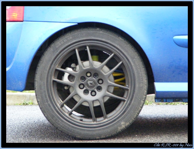

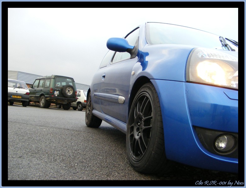

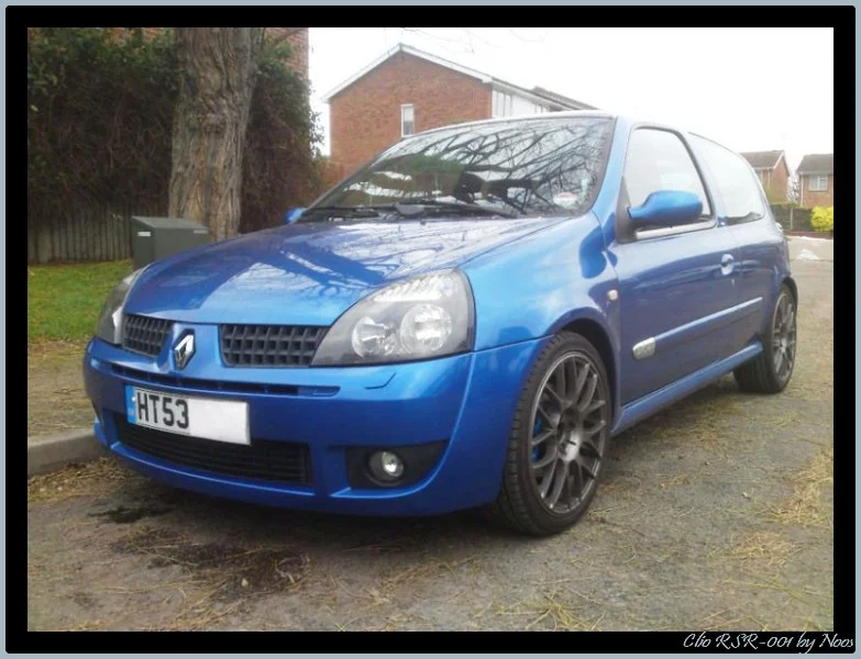

So the first thing I did was to trade those ugly 17 inch rims for a set of OZ F1 Black series with new Continental sport contact3 tyre... that would be my, road gear to use when I'm not on the track....
Somebody for some more ??? ;)

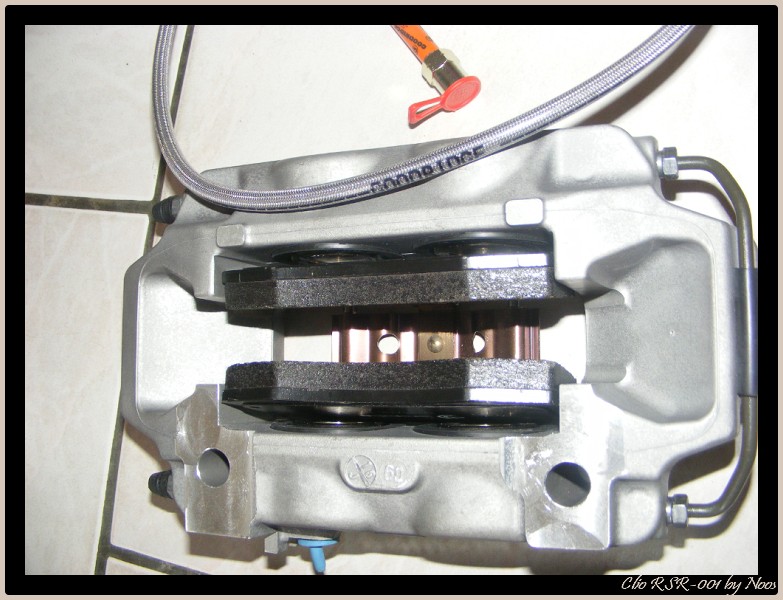

1/2 of what I need for my Plug and play brake set up.

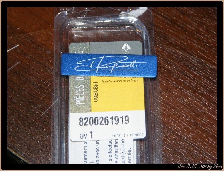

specific Renault RAGNOTTI badge that you normally find on the french version of the Cup

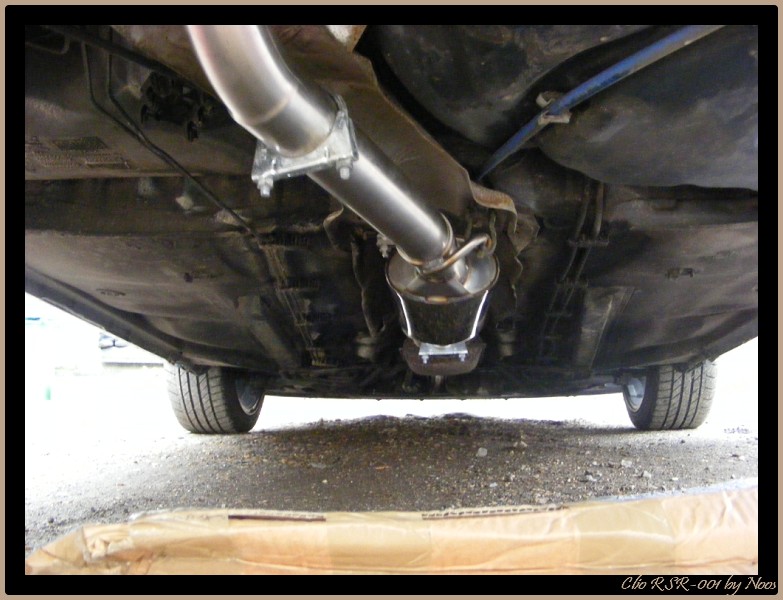

K-tec Big boy !
and the set up on the car...

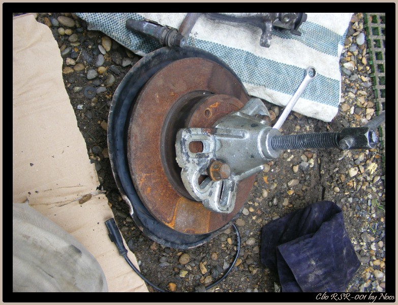

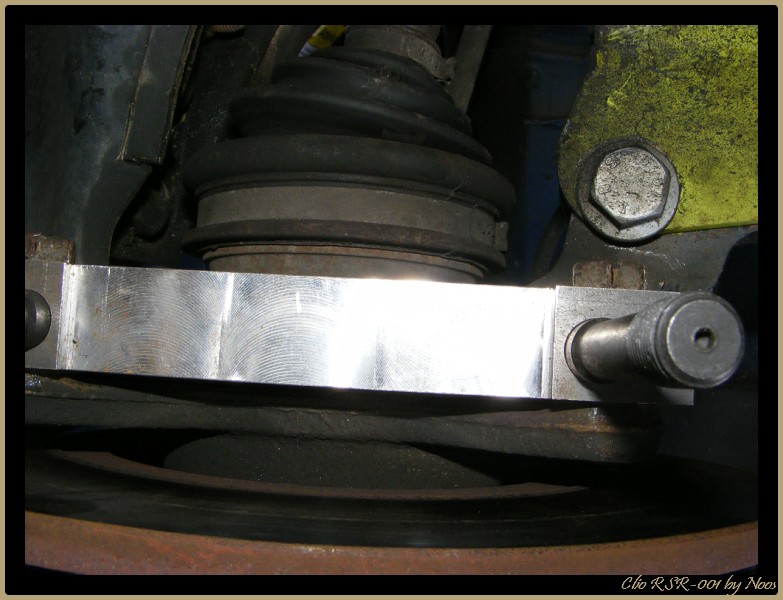

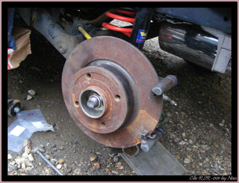

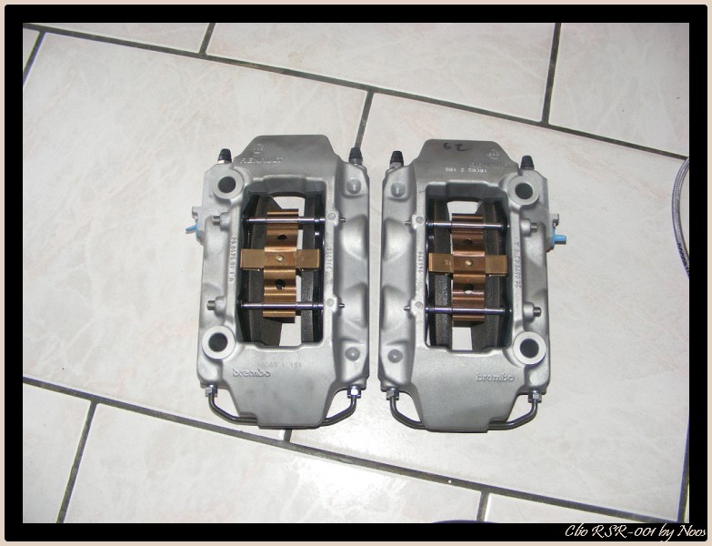

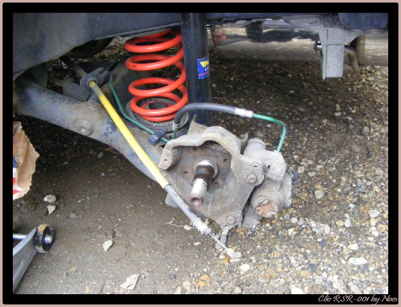

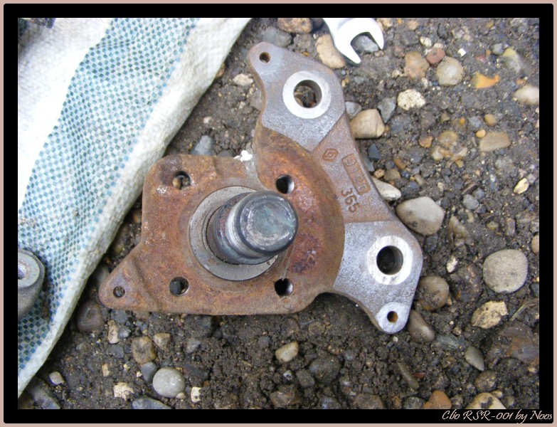

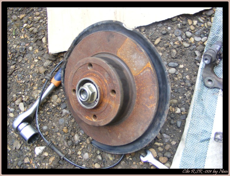

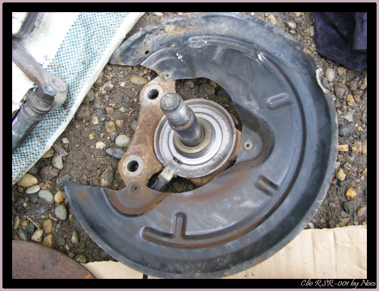

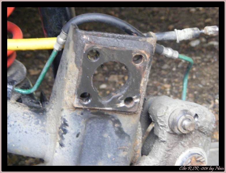

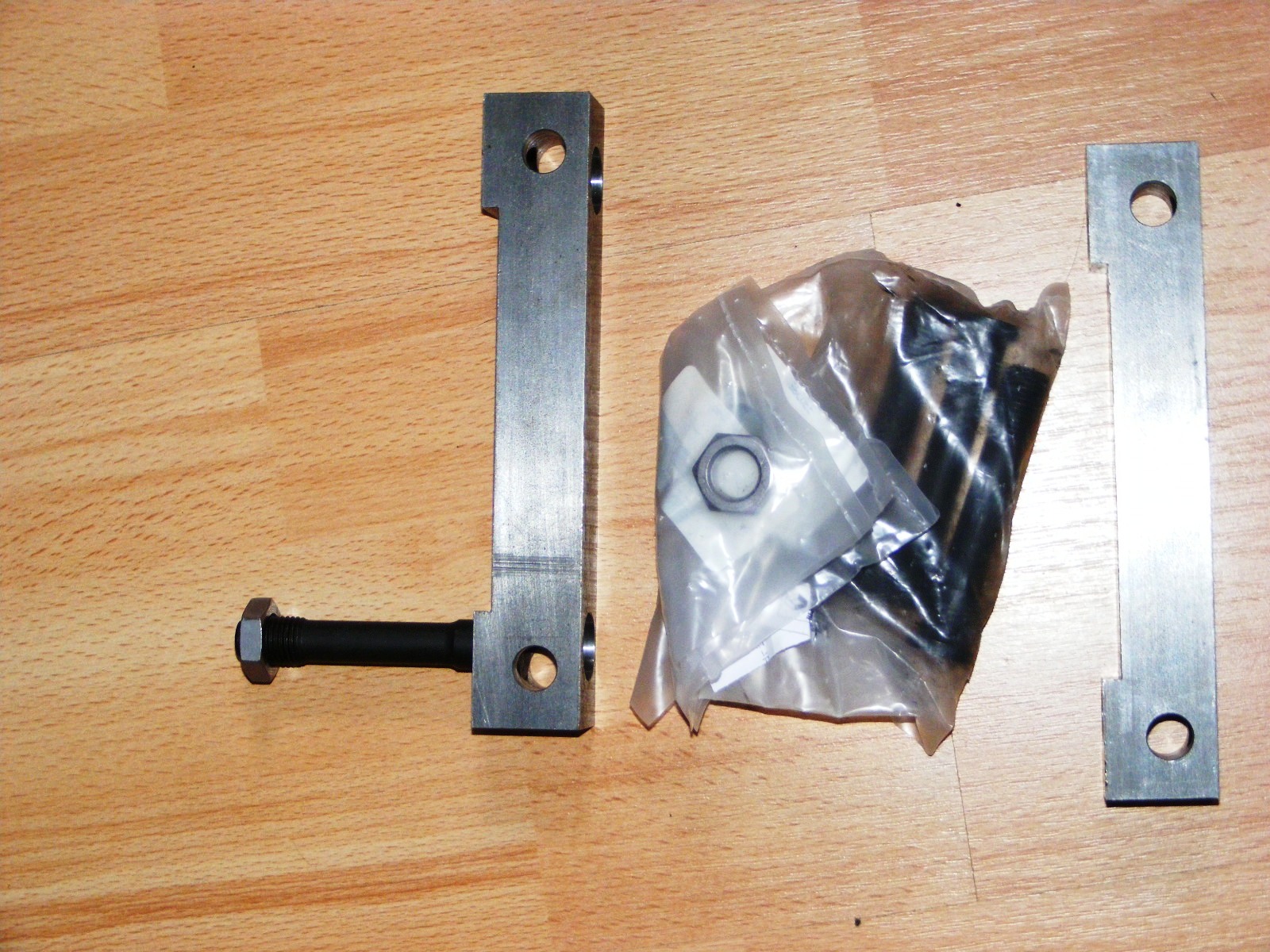

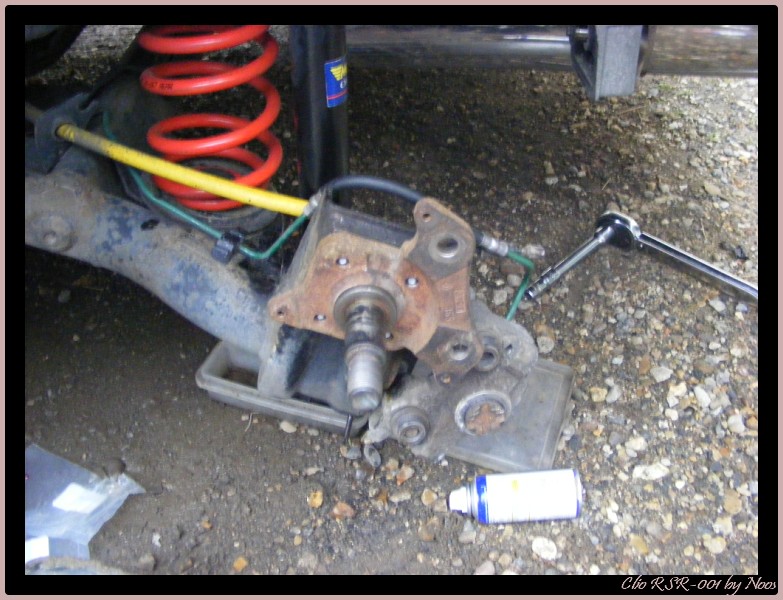

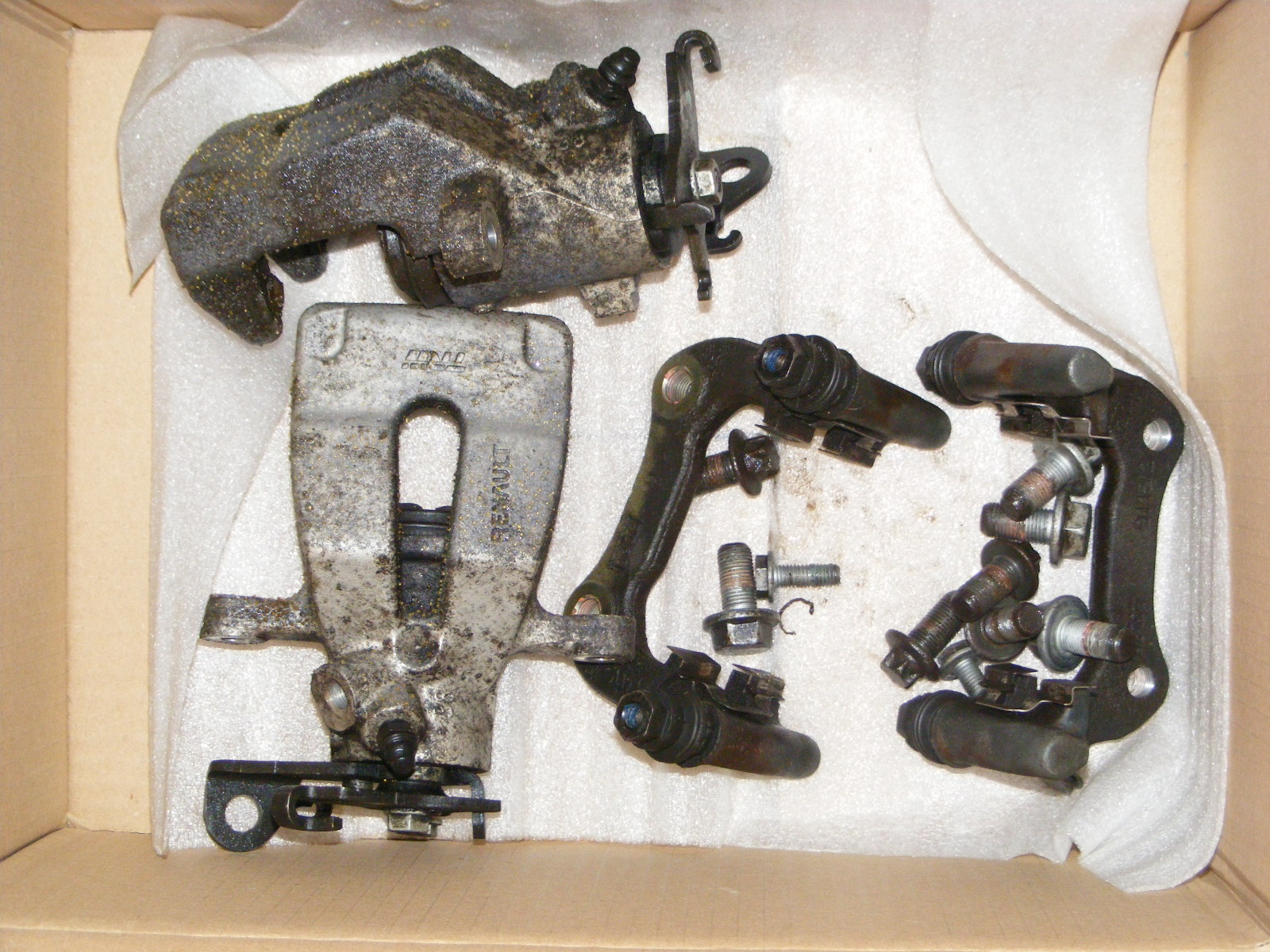

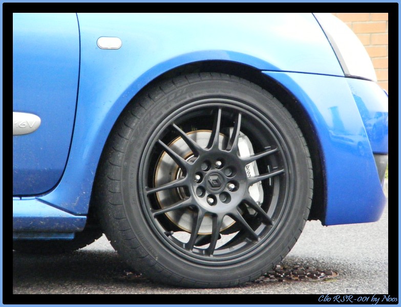

The other half of what I needed for my uprated rear big brake: bigger bearing, slitly bigger disk, bigger caliper, an a very good +9mm offset on each side....

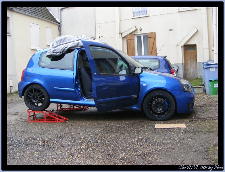

Getting the s**t ready.;)
It 's time to remove the old stuff.
Hop! on the car!

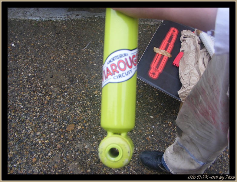

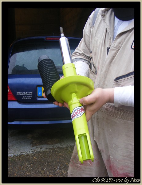

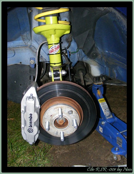

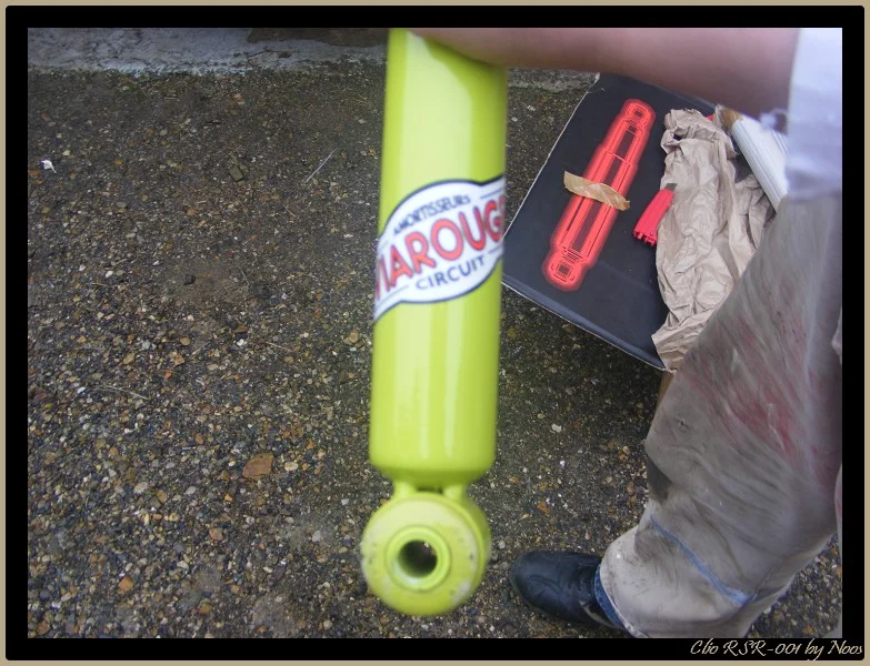

In between I fitted a set of those, I don't know if you guys knows that brand, it is French, it use Bilstein b14 cartridge re-set to they own spec with there own bottom end.... they are absolutely awesome to my purpose!!! the performance is realy like B14, just you can keep you standard spring if you want or just go lower, making them lot cheaper than a set of B14. After trying couple of brand, I'm happy with a set of -40mm apex spring. wich are realy only a -25mm with the weight i removed of the car... :S

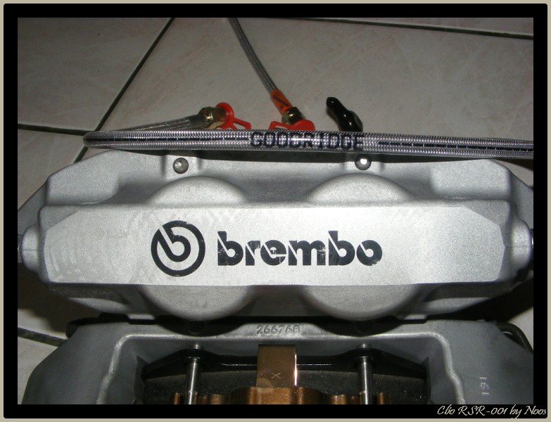

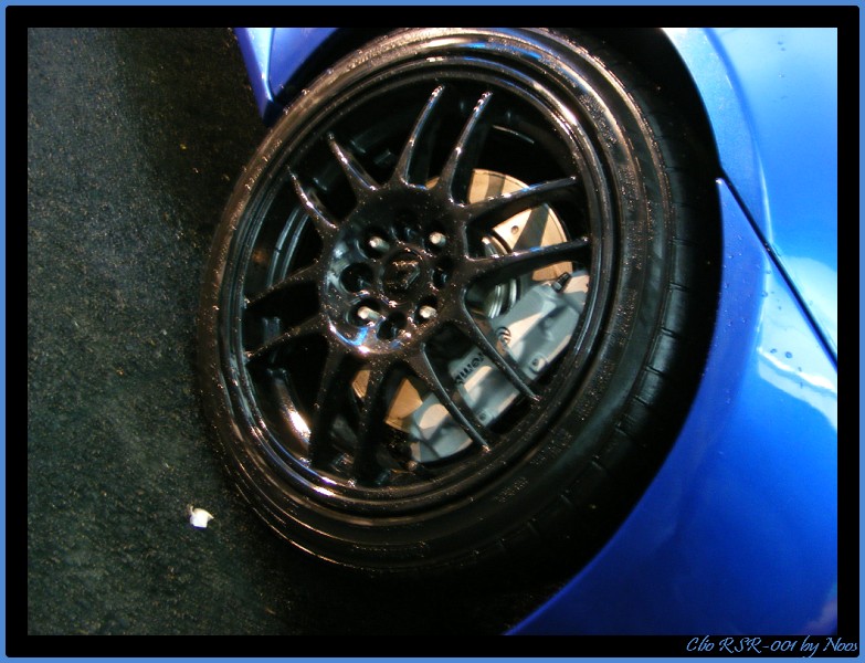

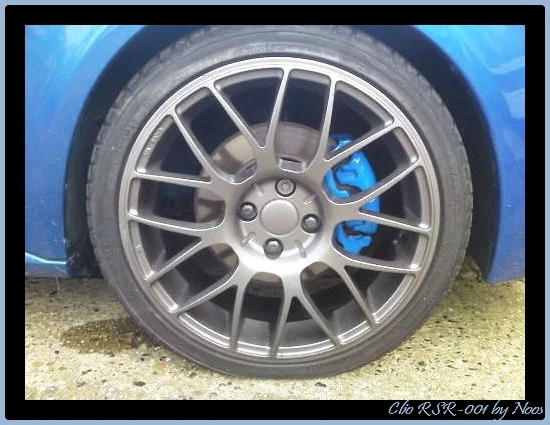

Time for some Brembos!!!
the result !!

where did you get the brembo adapters?
Ragnotti rules
I do not know if it is the appropriate place for that but I and a friend are making and selling them as a kit ... :eek:

will you be selling the kit on here? sooo want brembos. id just need the adapters tho, will source my own brakes

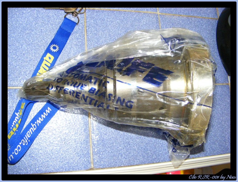

Quaife :evil:

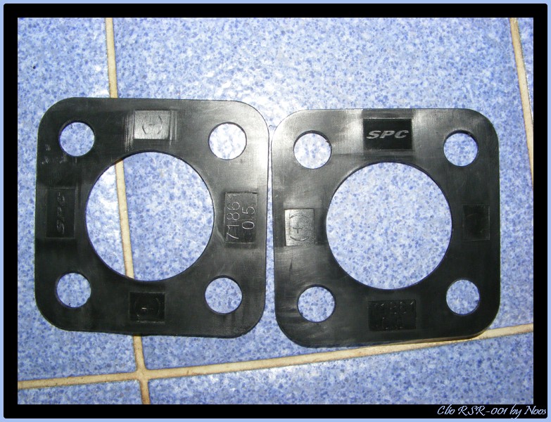

shims... I've set up the car to a total of 2 degrees negative camber at the rear...

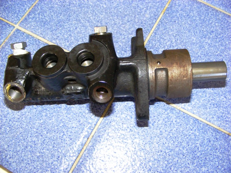

Uprated Master cylinder 23.8mm compare to 22mm (standards)

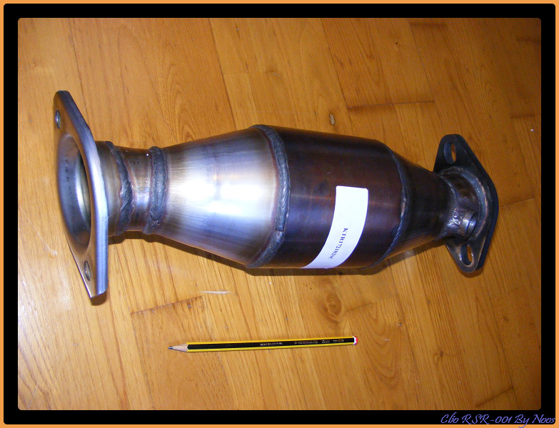

Sportt cat

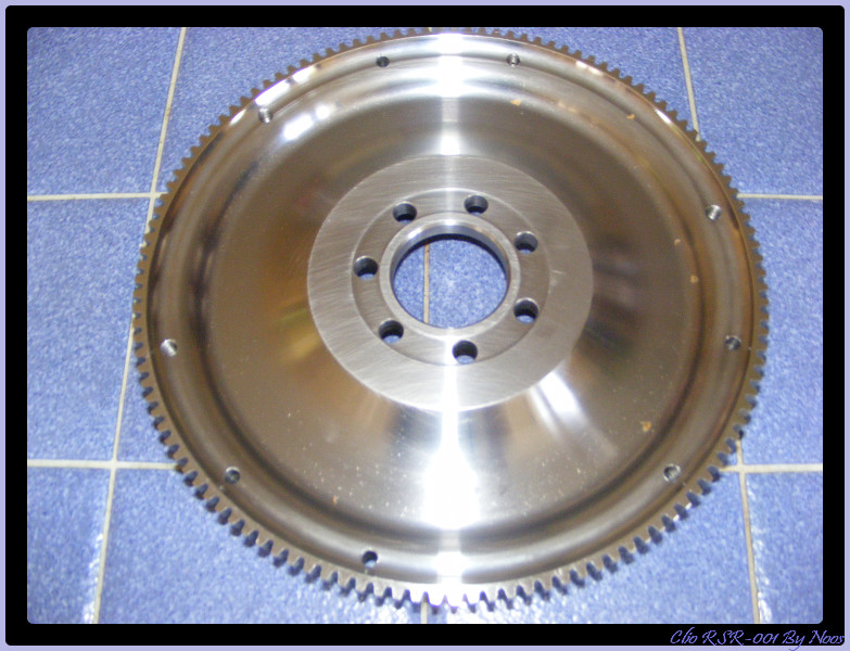

Lighten flywheel ... thanks to k-tec

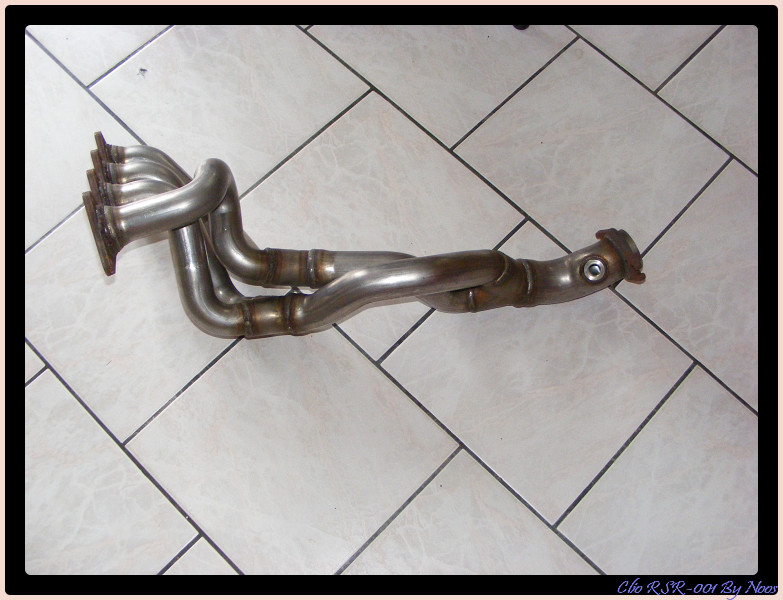

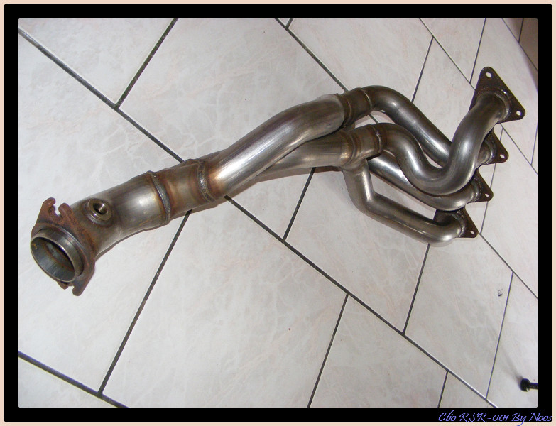

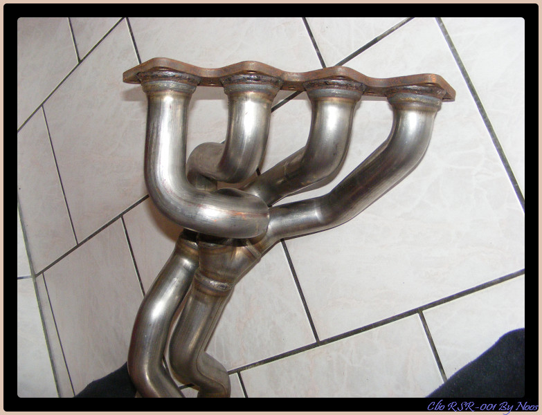

Racing cup manifold....

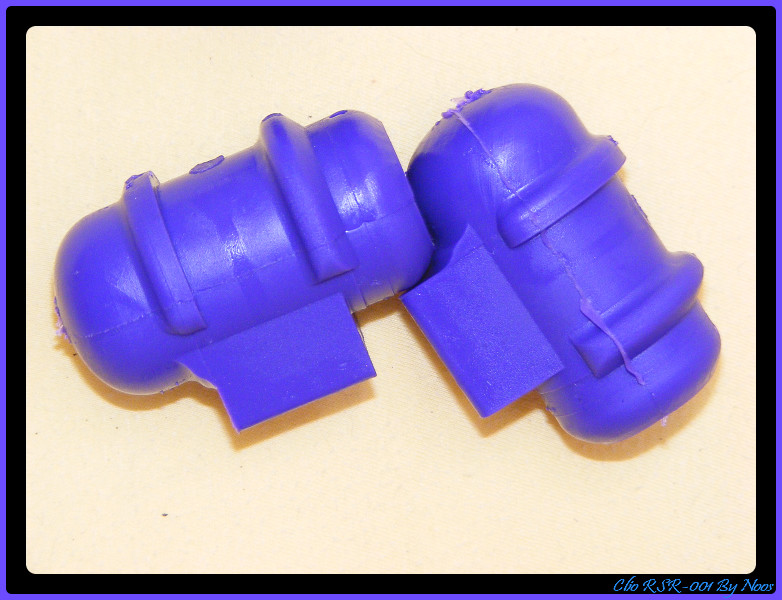

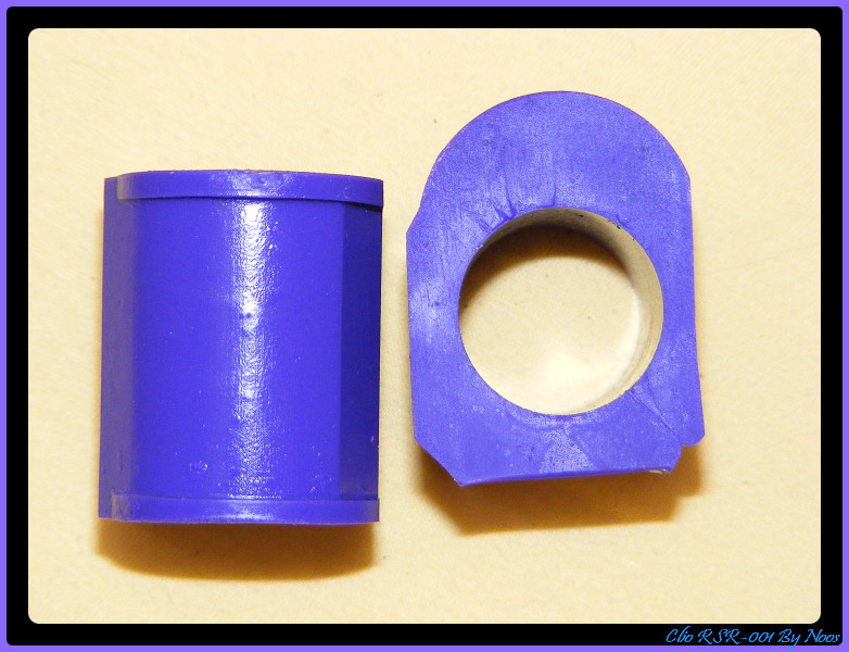

Powerflex anti-roll bar stuff

very nice mate. where did you get the mani from? looks like a 182 one to me :S
Indeed ! it look like a 182 but it is not... the 182 got a flat spot on one of the tubular to improve clearance with subframe, this one has not, also the racing cup is about 2 to 3 cm longer... and for instance I had to modified the k-tek exhaust to be able to fit it properly.

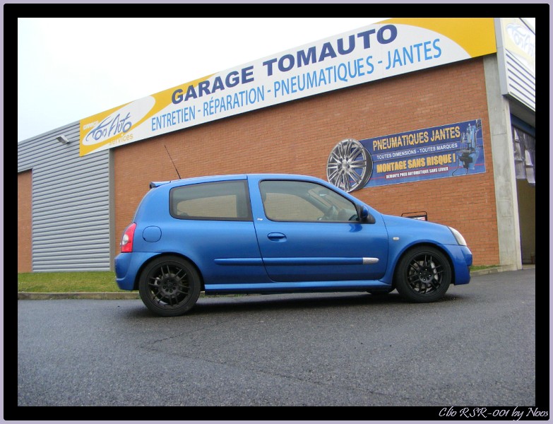

mehhh that garage.... well that deserve an explanation... it is the only garage I trust! to make it simple.... The owner, a friend, chief mechanic trained with Citroen and Peujot in the national rally championship, even though I'm starting my own structure and performing 95 % of the worked inhouse I ' frequently rely on him when i'm too much busy or just lazy ;)
On the top floor you have, an other friend Marc, specialize in after-market rims... He is the one to thanks for those OZ back special edition, repaired and repainted as they would have come from OZ ... He also the one who found 15 inch rims that would fit on top of my big break set up...
I recommend they if one day you pop in France ...

Quaif is the first modification any Clio 172/182 owners should do first ! it literally transform the car into a corner monster !

hi mate does the cup manifold make any difference when fitted?
  Golf GTD Mk7
Ah I see. what car is it off? or is it a custom job?

It is of a Renault cup but the racing version... and it is custom lol, it is renault custom ! lol

For the Brembos I'm selling those kit ;)
And for the suspensions set up here is the link: http://www.amortisseurs-viarouge.com/
I guess few horse, otherwise why bother , I mean what could be the reason why Renault fit it on the Racing clio ?
