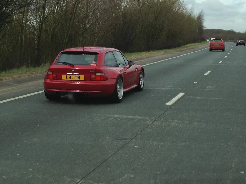

Looked good this morning Tom!
(Crap pic alert)
Haha it looked immense! I was in the blue VW van giving you the thumbs up. My mate was like wtf is that?! That is a cliosport member was my reply lol

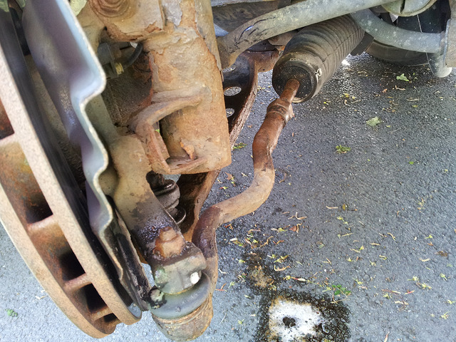

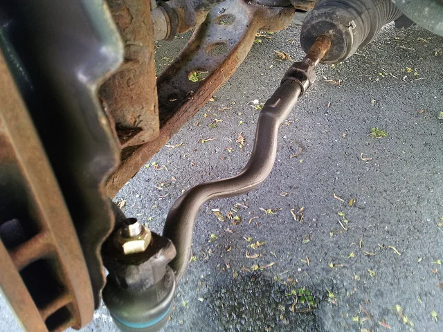

Changed the tie rod ends yesterday, however I did forget how many turns it took to remove one of them and the tracking is now completely on the piss. I am a moron. Its booked in for an oil service Friday anyway so i'll have it aligned then.

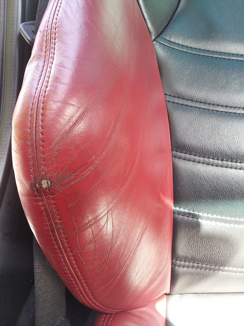

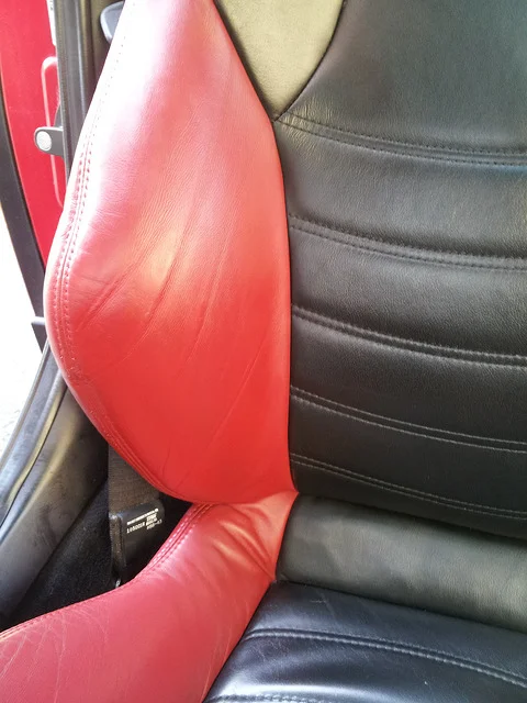

Before:
After:
  330i. E30 Touring.
That looks awesome.
I need to get one of these kits for my E30. How easy was it to do?
That looks awesome.
Its surprisingly simple to do.
I applied the dye neat to the worst areas then wiped off the excess from the good leather so that the scratches and cracks were filled, then diluted the mix very slightly and gave the whole bolster a few passes.
Having said that, on trying the lower leg bolster I just couldn't get the finish right, It either looked streaky from the sponge application, or I would apply too hard and end up wiping away some lower layers of die leaving a big hole in the finish. Gave up in the end. The nice thing about it being water based, is if you mess up, it just comes off with a damp cloth.
f**k me that's a good repair! Proper wicked work.
Get on that strut with a wirebrush and some spray hammerite man!
I'll tidy up the underside sometime soon, the paintwork on the drivers side is my next priority though. Some surface bubbling coming through that I want to get stopped before it goes further.

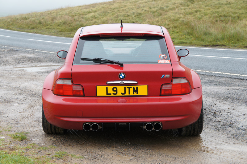

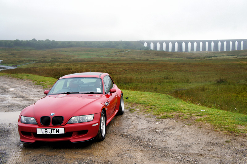

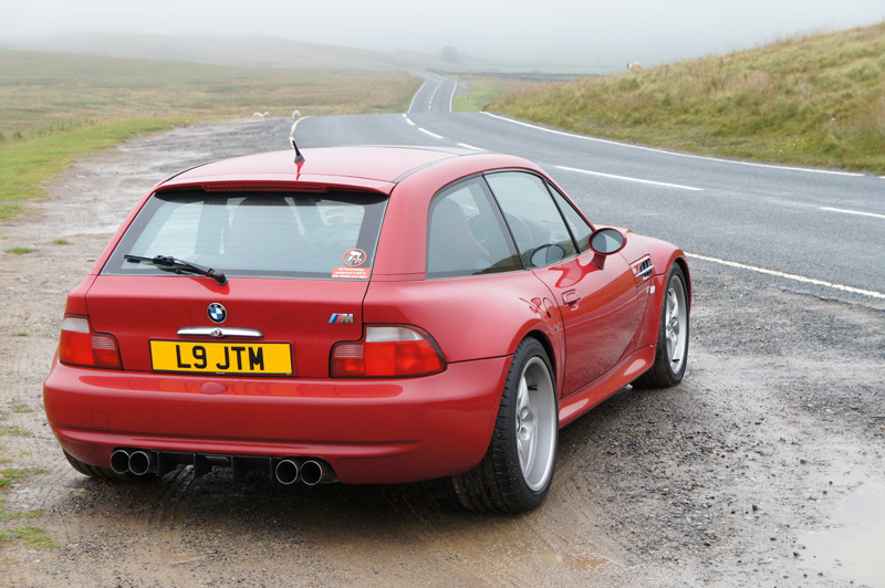

Anyway, the weatherman said today was going to be blue sky up in the dales so I thought I'd take the opportunity for a spin out on the last day of my holidays, before its back to the boring work commute.
Of course it was perma-drizzle for the entire trip.

I do love these things- I even like it's red, I've been pining over another red car recently!
  Italian 3.2 V6
Dat ting has a wide ass!!

Really lovely cars these, I'm starting to think I prefer the Z3 to Z4 now too in coupe form.
I actually passed one that looks very similar to yours on my way to Leeds Saturday and looking at your profile I'm wondering was it you?
Nickw88
  BMW F82 M4
Thanks man.
I work in Leeds so there's every chance it was me. There aren't any other red M Coupes locally that i'm aware of.
No problem, it's a lovely car.
I was sat behind it in the 50 zone having a good old look. The guy driving had grey hair (and I have no idea what you look like). If it wasn't you there's another mint one around
