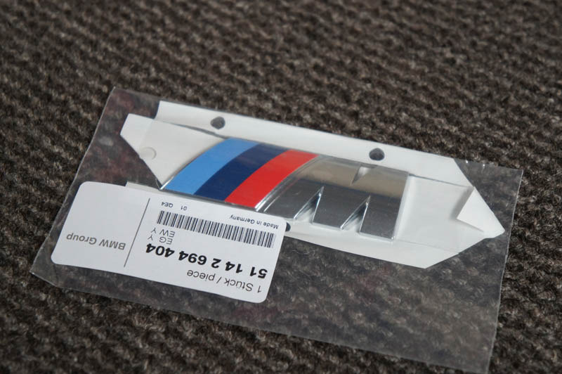

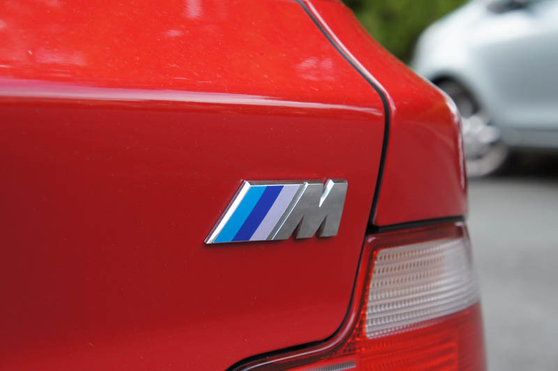

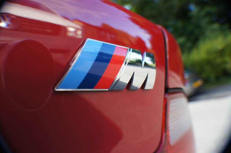

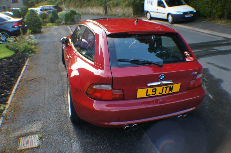

Ordered a new genuine S54 rear M badge as mine had faded massively.
Before:
After:

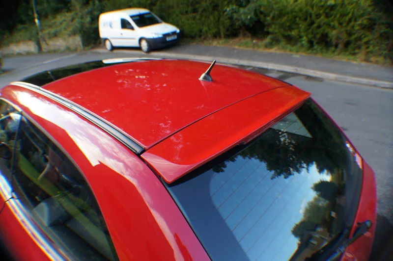

Another reasonably large job was colour coding my rear spoiler. It had always been on my to do list, and with the recent nice spell of weather i got the heat gun and aerosols out. Pretty pleased with the finish considering its a rattle can job and the Halfords lacquer I used is terrible (that's coming from someone who sells it every day).
Before:
After:

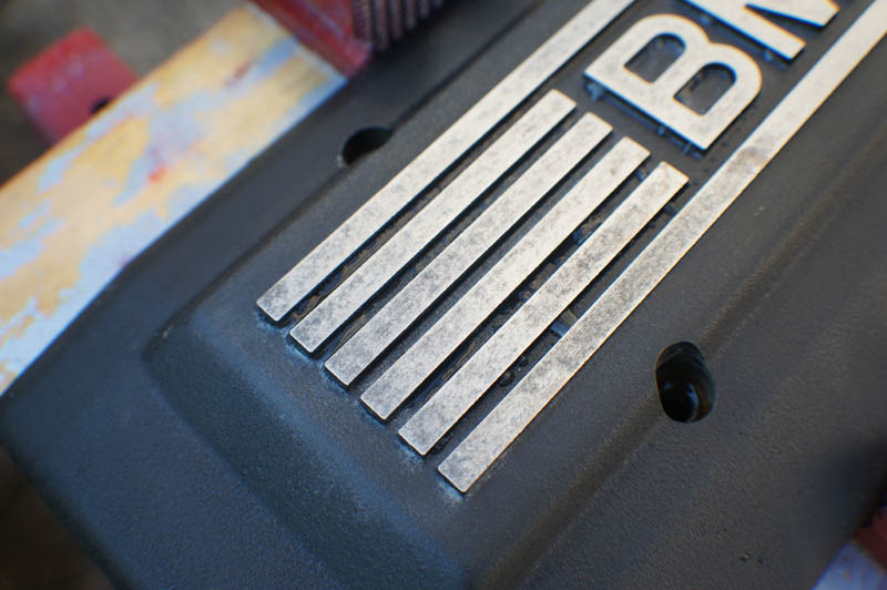

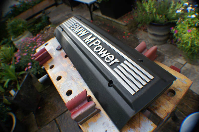

A couple of today's smaller jobs were tarting up the pitted ignition cover. The after picture doesn't do it justice, its worlds better than before;
Before:
After:

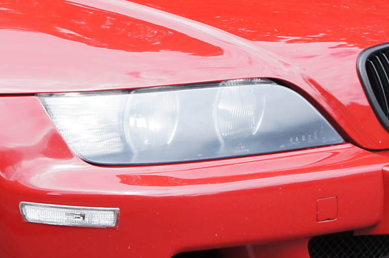

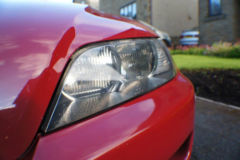

And finally, I borrowed a neighbours rotary polisher and had a go at cutting back the scratched and hazy headlamps;
Before:
After:

I need to do the same on my headlights, never done this before.
Going to buys rotary polisher off the bay, but wondered what type of head you used, and if you needed any chemicals or liquids specifically designed for job?
Thank you,
Hello mate, thanks for the kind words.
I used a regular waffle/foam polishing pad that came with the rotary machine, a few sheets of 1200/1500/2000 grit sand paper and my preferred cutting polish of choice (which is G3 scratch remover paste)
Meguiars have since brought out an excellent little kit which has everything you need to do the job including a mop attachment for a regular rotary drill. A friend has used this on his UV-damaged Clio headlights with some excellent results. I highly recommend it:

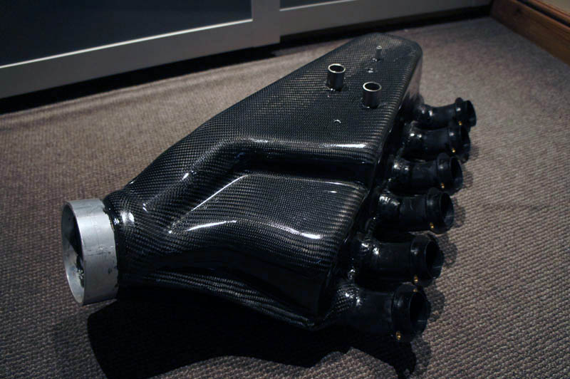

Yeh....so this arrived today:
Hoping to trial fit it over the weekend, order a filter for it after some measuring and then look into getting an Alpha-N map sorted.
Cannot wait to hear the noise this is going to make.

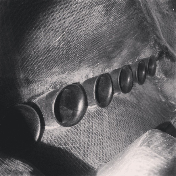

Lol at the difference! The inside looks beyond shocking would it really be the hard to sand them before binding both layers together.

The airbox came from these people:
http://www.verbundfasertechnik-opit...on-ansaugsystem-für-bmw-porsche-mercedes-amg/
Really pleased with the quality of it, its certainly not on a par with the MAC boxes, but its obviously a professional job.

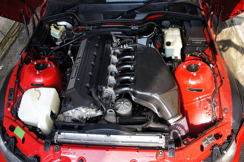

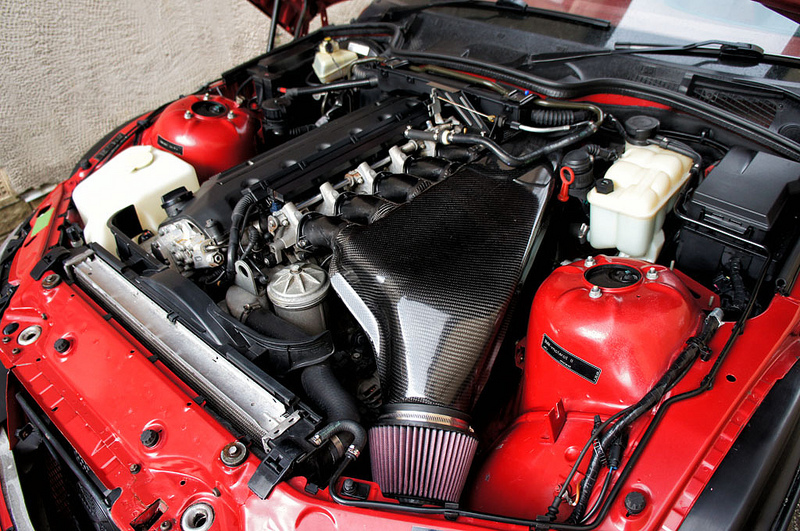

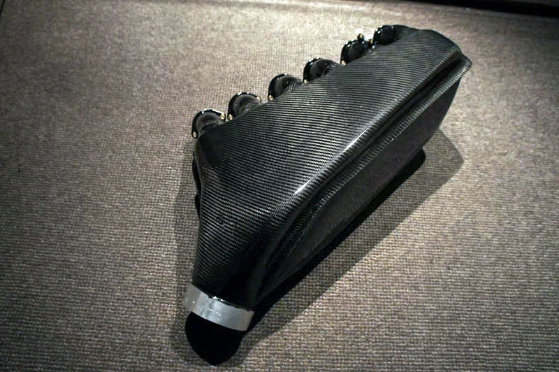

Got some final fitted pictures after spending the morning tidying the install up.
Replaced the vac hoses for the box with more expensive and sturdier silicone heater hose as I wasn't happy with some of the kinks and bends.
Fitted new airbox mounts underneath as the old ones split trying to remove them.

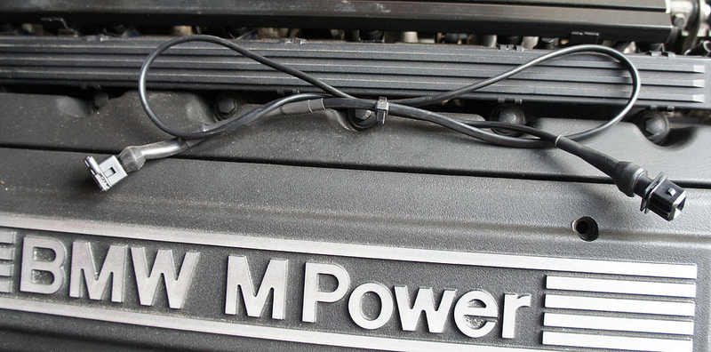

Perhaps the biggest modification was extending the wiring for the air temp sensor. On the original manifold this sits much near the block, yet on the carbon box it's right at the mouth so the original loom isn't long enough to reach. I really didn't want to cur the original loom up so did some head scratching.
​After a lot of googling I worked out the connector plug is a bosch EV1 type, most commonly used on fuel injectors, so I ordered a breeding pair and along with some twin core wire, made up an extension piece:
DSC00452web by topgeartom
Room for the air filter is VERY tight, so after lots of measuring ordered a K&N cone that met my dimensions, unfortunately when ordering, there weren't any in the country, so as a stop gap I removed the metal base from an old ITG JC65 cone and used it as a sock filter which actually fit and worked remarkably well.
The K&N finally arrived a few days ago and is obviously a bit sturdier so whilst the box was off I fit that and crossed my fingers everything would fit back in the limited space in the bay.
With everything connected and bolted up the fit is literally perfect, the end of the filter cone just about touches the rim of the cold air duct on the back of the headlamp - very pleased with that.
On a side note, since running the box I have used a full tank during my regular commute and potter to the shops, and after doing the maths it appears to be returning exactly the same mpg as before. Bonus.
