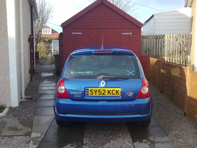

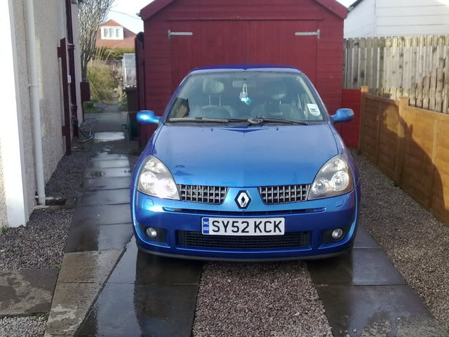

The photos I promised ages ago.
Before when it looked like a tractor.
After with no rubbing 49 threads front 8mm raised back. excuse the pics taken on my phone and sorry but the wife took the first photos hence hoggin the lime light with her jap scrap.
