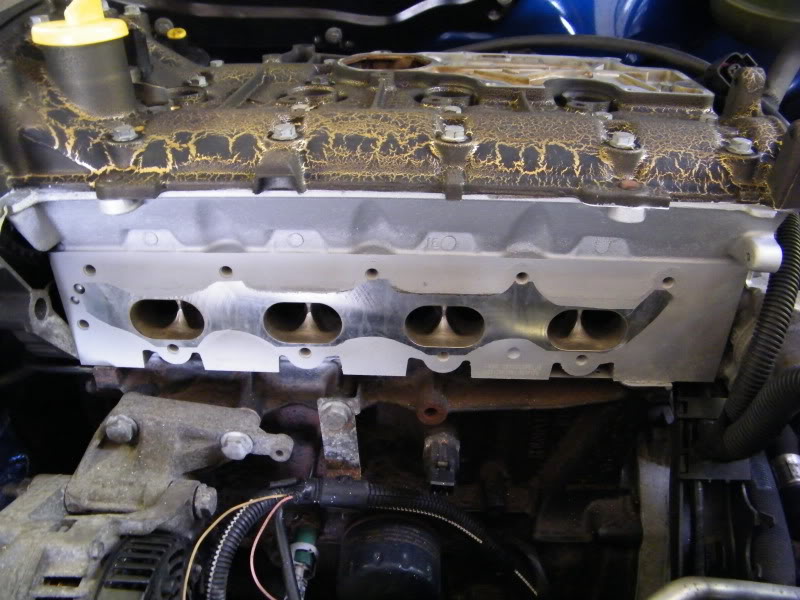

Firstly, got a bit of VHT paint on the head face, before anyone says it yes it was all masked off etc before painting, nothing worse than paint in your holes!!

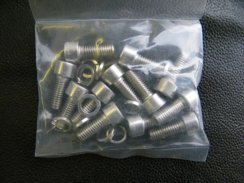

Shiny stainless steel fixings arrived, courtesy of Jason @ Paul Chetwyn Supplies, Many thanks :)

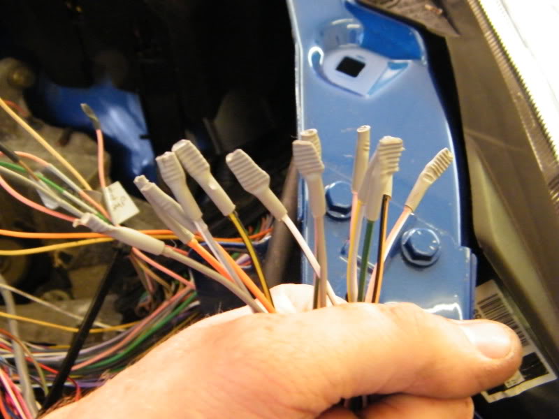

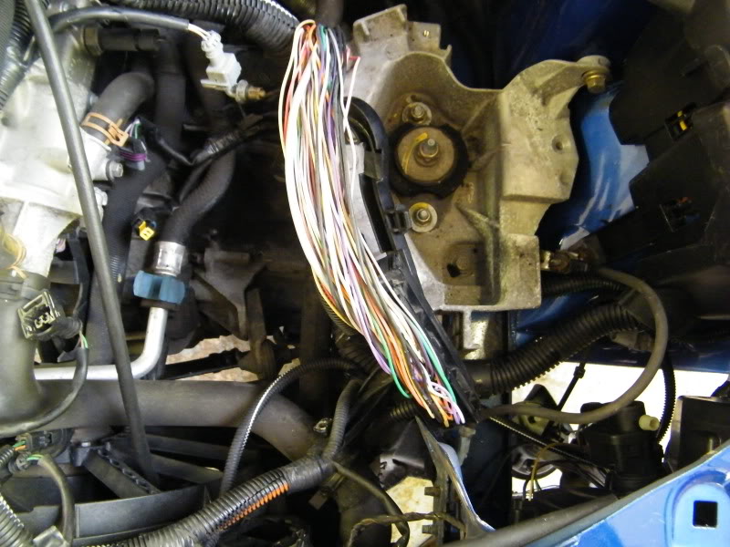

Then gaz got more involved with the wiring, not a fan of this to be honest....
eeeeeeeek :

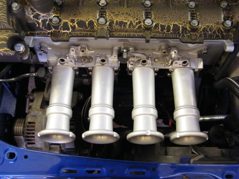

Bodies actually fully bolted up!

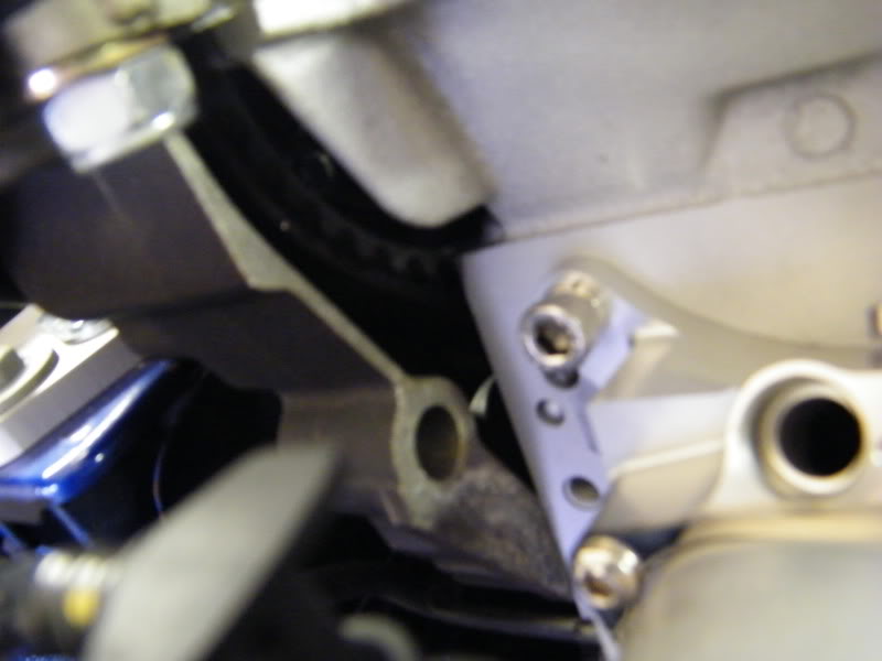

Andy always goes mad at this little hole left in the cambelt cover....
So, he made this little cover, that i painted and bolted on :

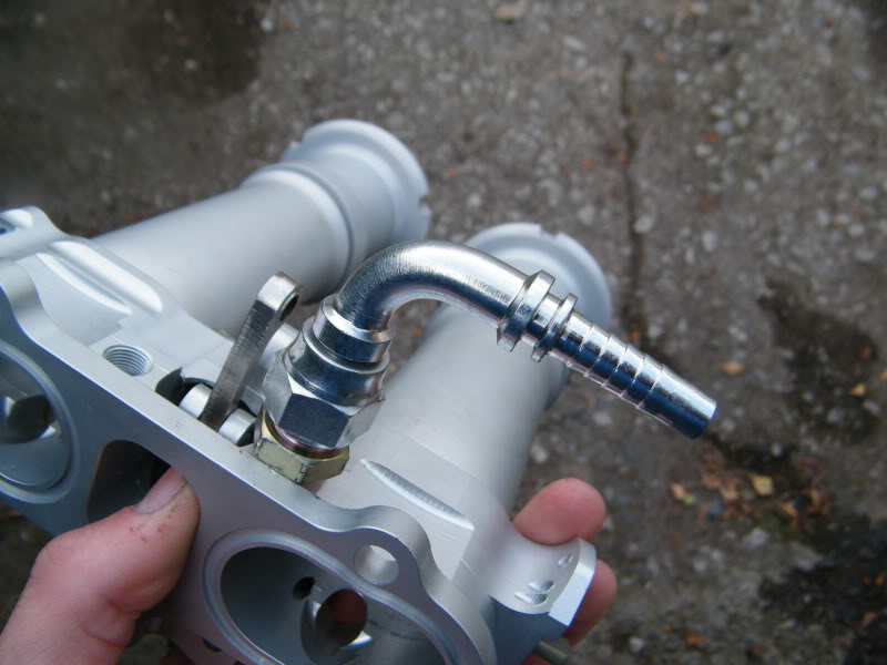

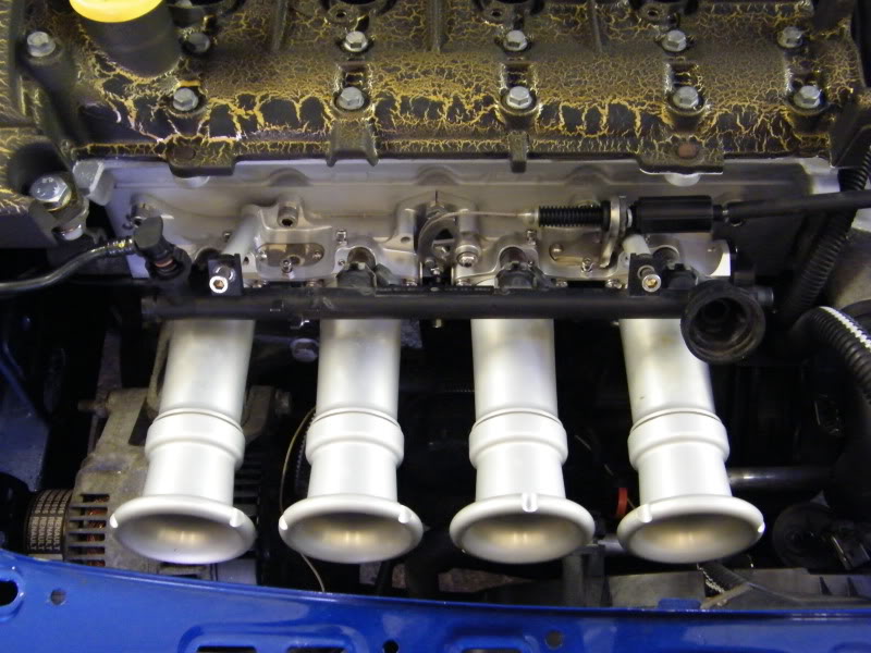

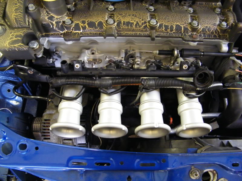

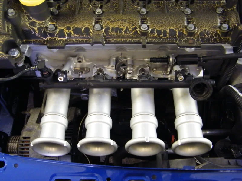

Fuel rail all on and tight, it had a new injector because i broke one being heavy handed :(

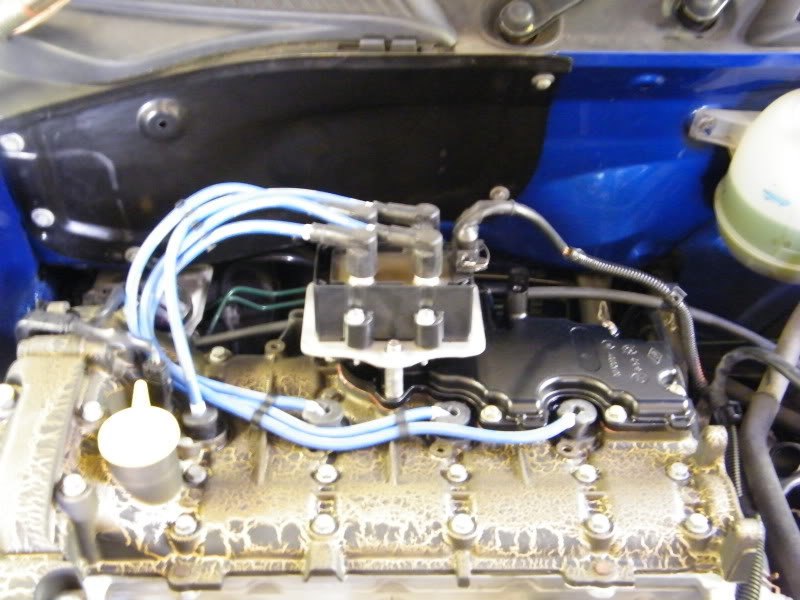

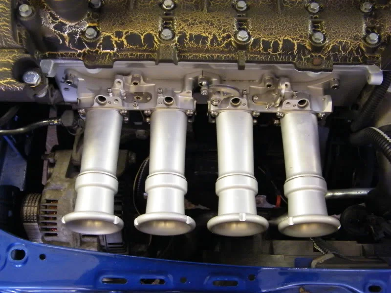

Coil pack and HT leads / breather plate fitted :

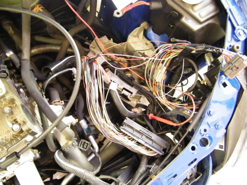

Wiring loom into injector's, fue pipe connected etc :
Slowly getting there...................
So after many hours wiring and scratching of heads, it ACTUALLY runs, ecu and wiring is just resting and very untidy at the minute, we had truble with the crank sensor, but once sorted it fired up easy, runs and idles.
Thought we had a TPS fault, but it seemed to improve once warm so think it may just need maping properly.
Still loads to do, firstly tape the looms up and mount the ECU's etc, but it's a milestone! :)

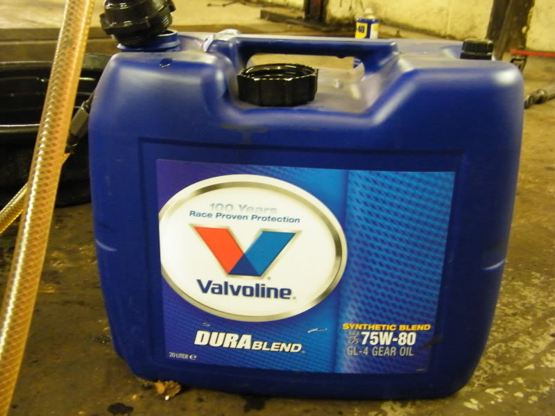

Gearbox oil change, using valvoline gear oil.

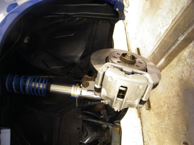

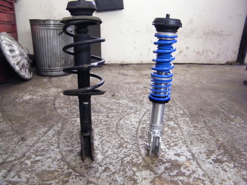

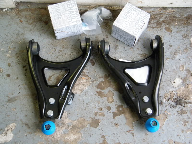

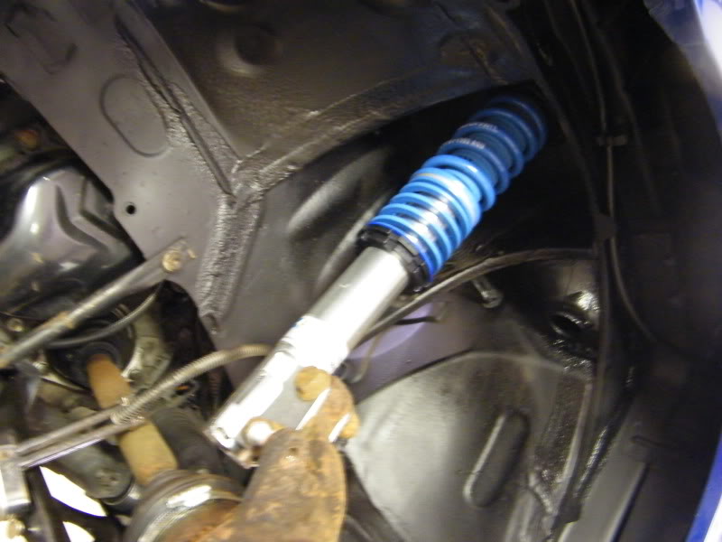

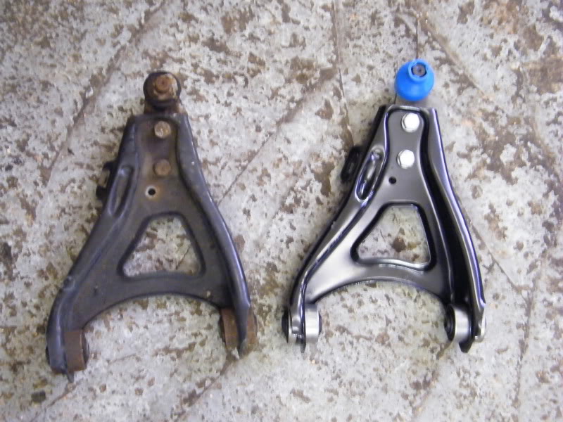

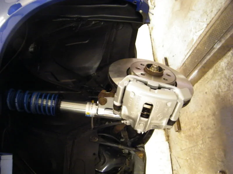

Fit my N/S front coilover unit, track rod end, bottom arm, poly bush, caliper, pads, dosc and flexi hose.
Also replaced my PAS pressure switch as that was weeping :( More bloody expense!
Anyway, will let the pics do the talking, couple more good nights and i hope we will be gettitng there outside, then down to TDF eventually for mapping.
enjoy, or i hope! :)

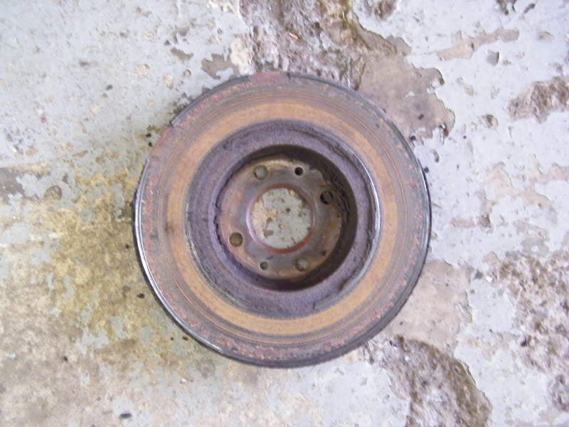

Old disc off, skanky :

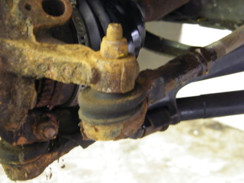

Old track rod end, replaced this, but failed to take a pic of the new one cos im a goon:

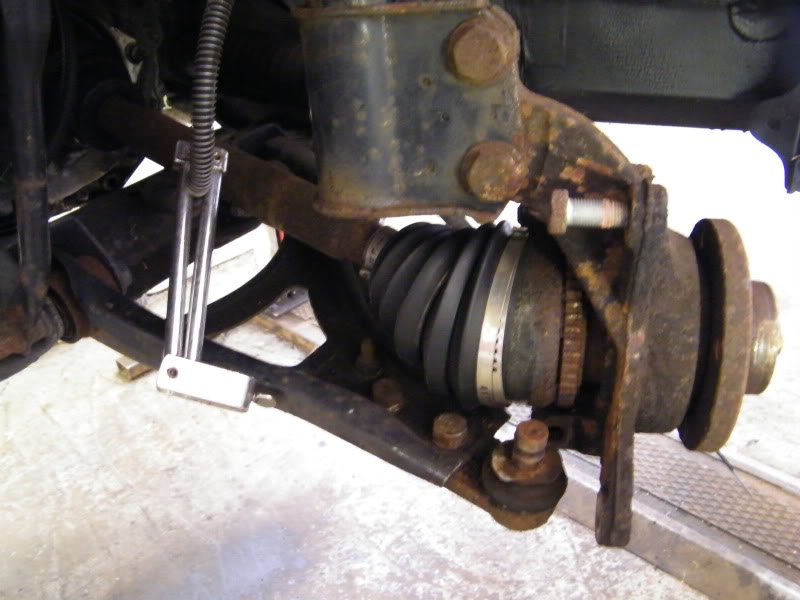

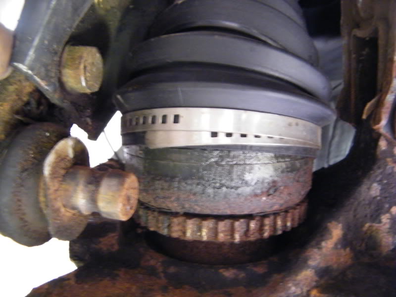

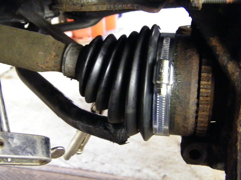

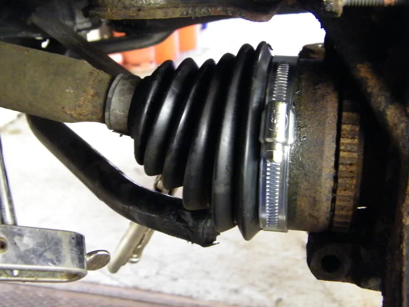

Somebody's idea of a well secured CV boot..........

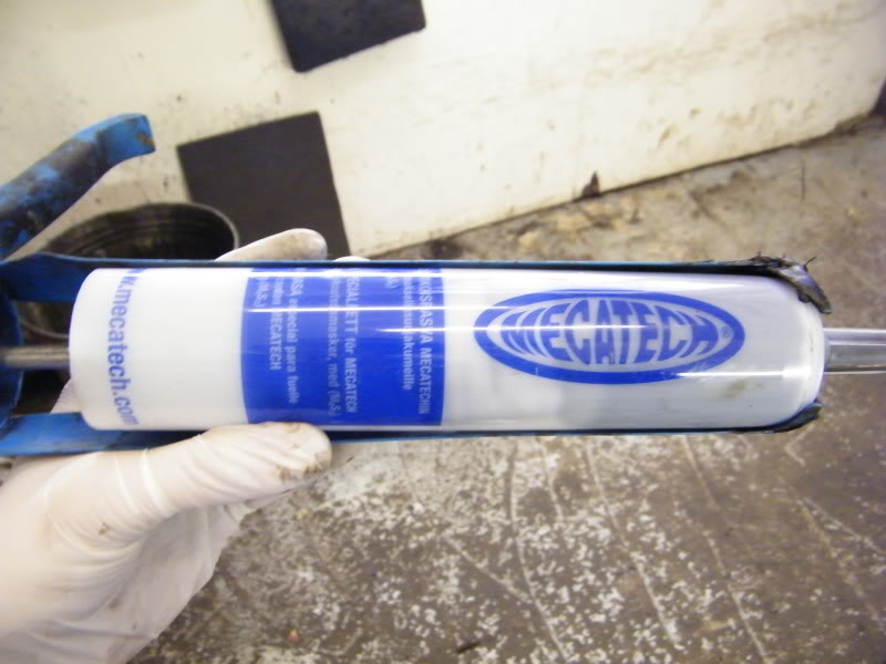

CV boot grease :
Proper job :

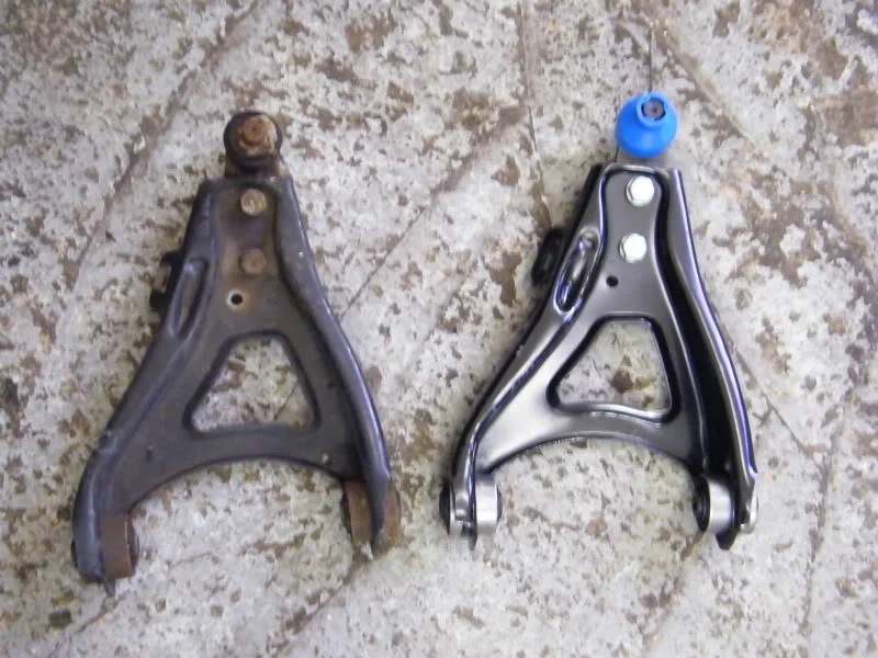

Old and new together :

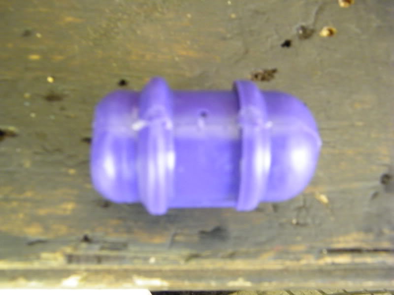

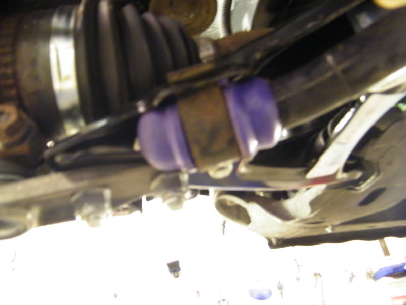

Anti roll bar bush, poly.
And fitted :

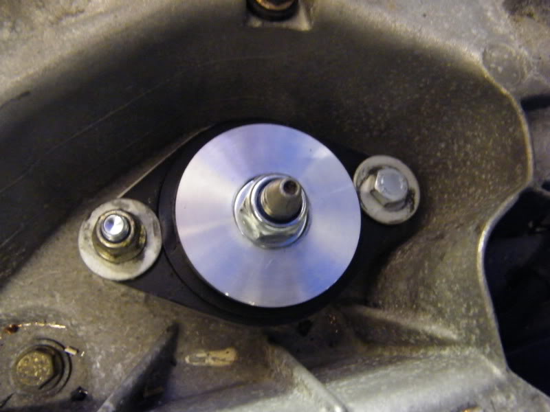

in, with new strut top mountings:

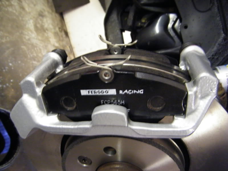

New disc, carrier on and DS2500 pads in :
Caliper on, and braided hose :
Said valvoline gear oil:

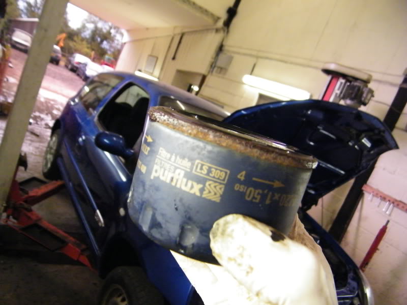

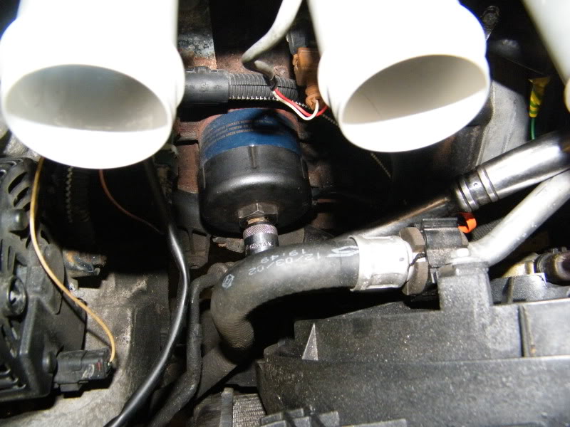

With the ends unscrewed, you can actually get at the filter off pretty easily :
Doesnt look like this has been changed for a while :

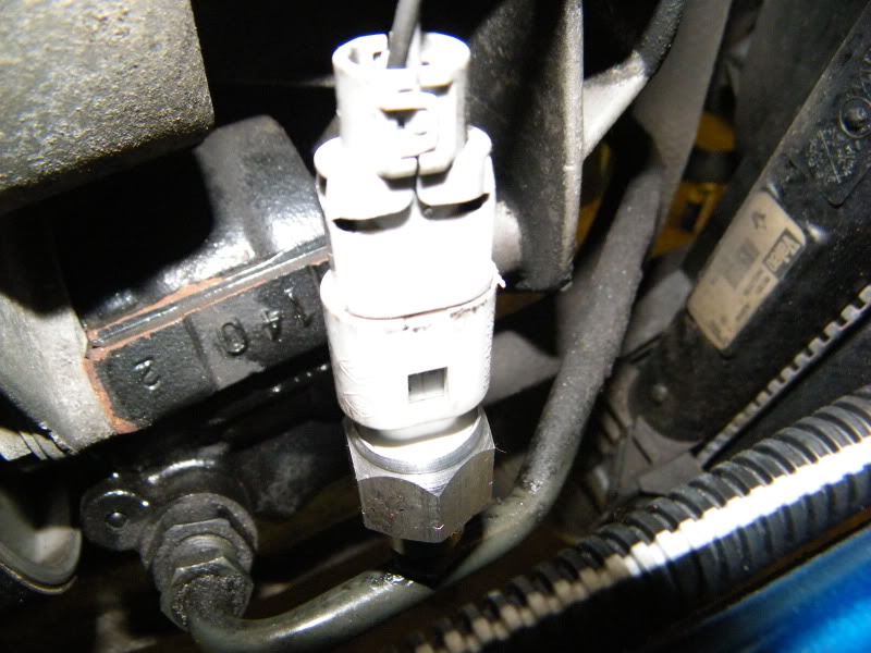

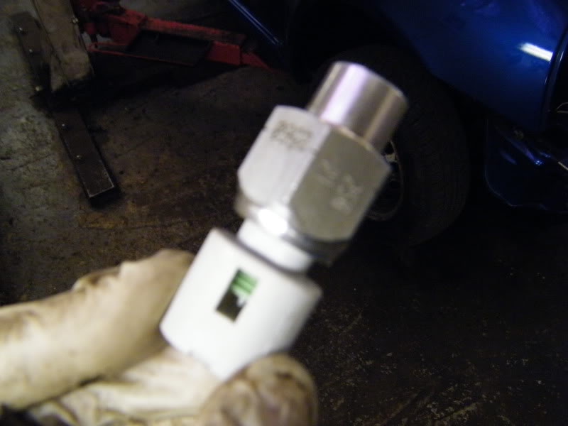

New PAS pressure switch :
and fitted :

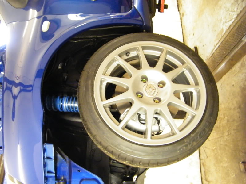

Front wheel on, first time in a long while.....:

Don't have any pics with me, but friday afternoon put the rear coilies on, rear braided lines, fit all the o/s front bushes , lower arm, track rod and coilover unit, bled all the brakes up, finally got a brake pedal, lol!! :) been driving around for months with no calipers on back and to from the workshop.

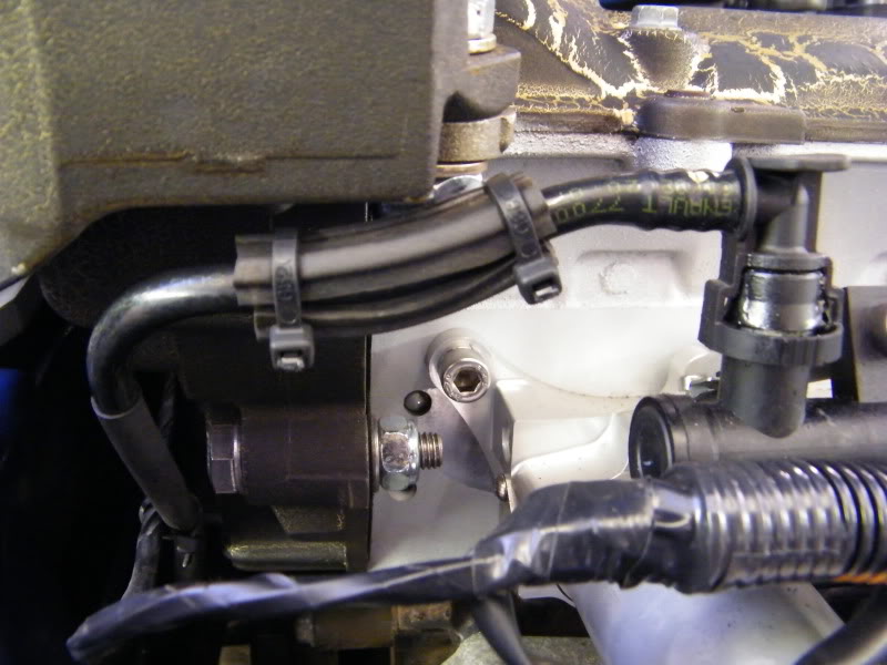

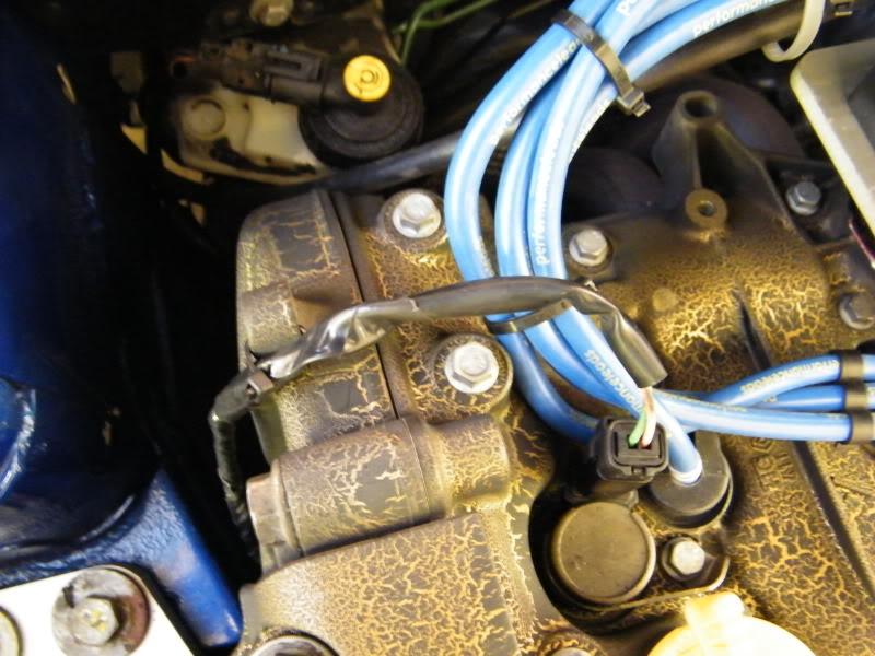

Rmoved the MAP sensor plug and capped the wires, tidied the end of the loom up a bit.
Wasn't touching, but put piece of rubber over the fuel pipe just in case..... better to be safe than sorry, tolerances were close!

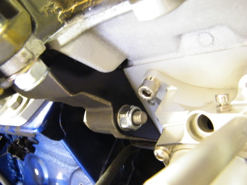

Fitted the uprated gearbox mount while the battery was out.

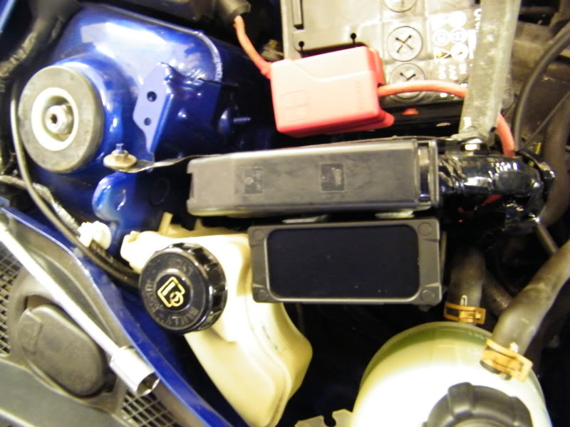

ECU mounted, not going to put all the cover's etc on, only going to be a summer car / fun vehicle.
Just a quick pic of the capped wires that are not used, using Wurth heatshrink with resin, warm and squeeze. tidies it up no end, and no moisture can get in! :)

Thursday night, did a bit more, fitted the inner arb bushes, dogbone bushes and heatshield behind the mani! :)
