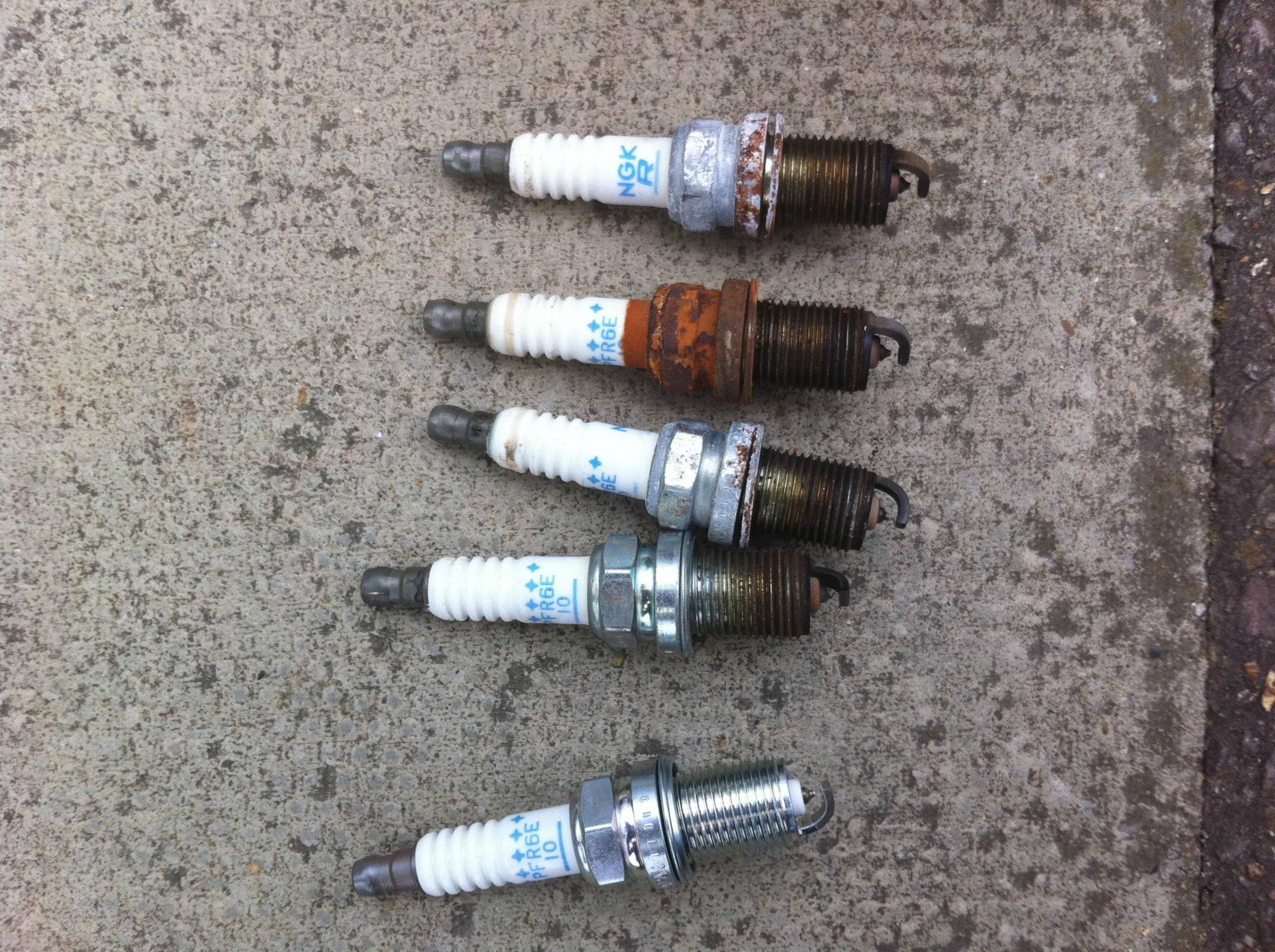

Mine were VERY shot. 3rd one especially! That one had quite a bit of surface rust on it. All the tips seemed covered in soot too. Worst I had seen, although I havn't seen that many.

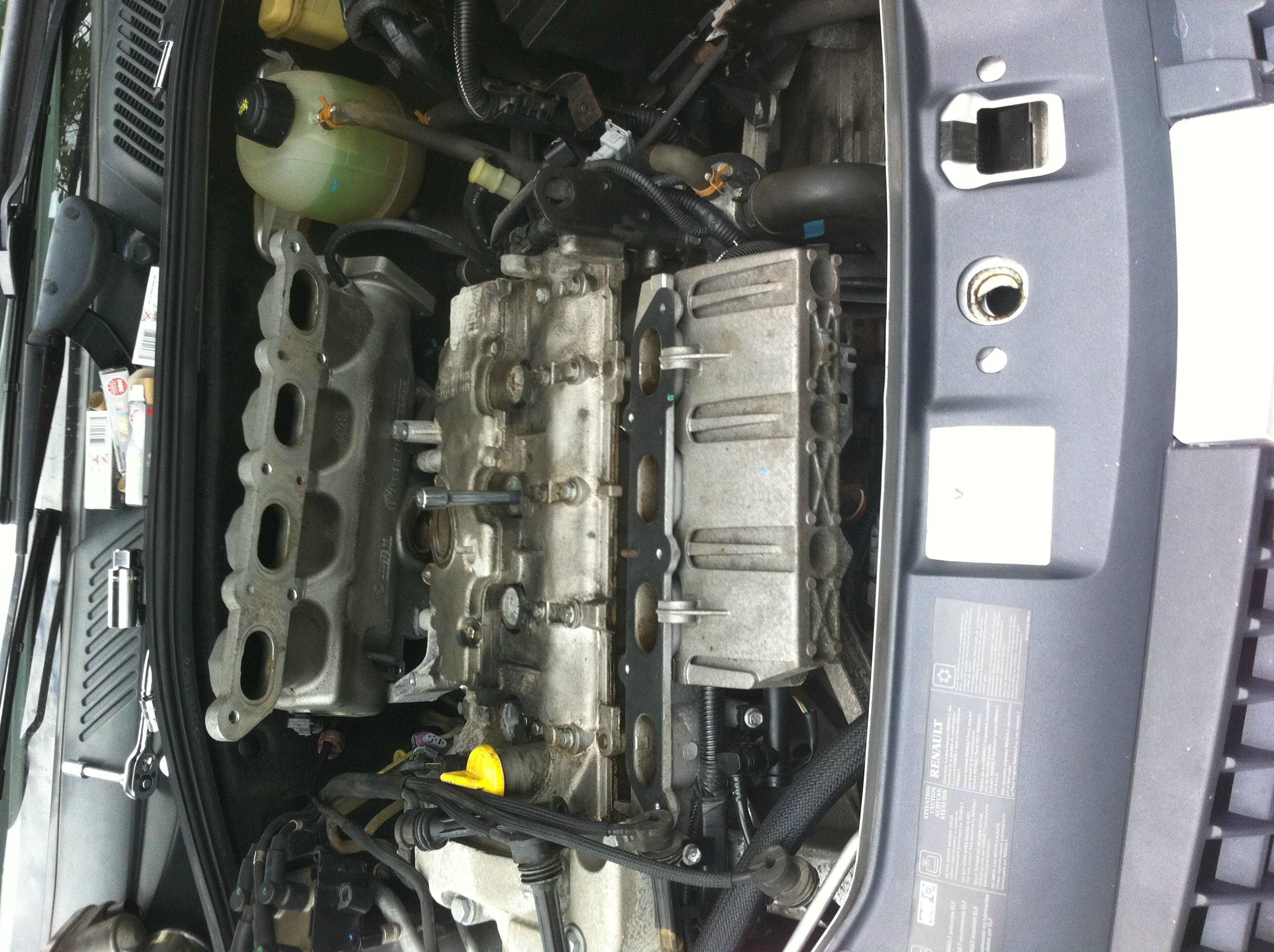

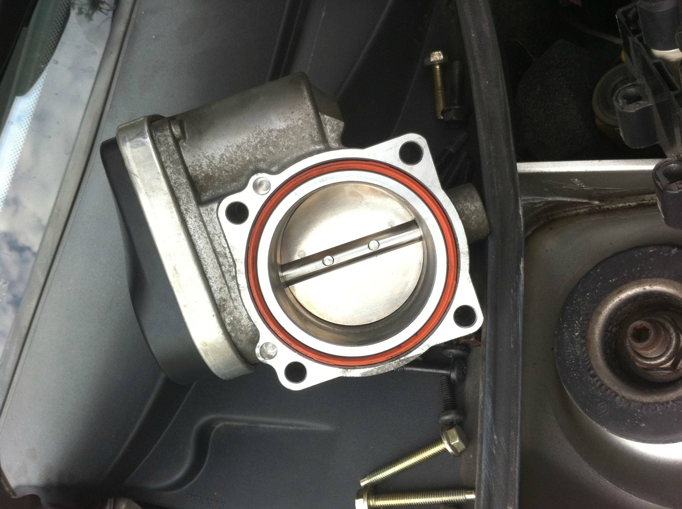

Old plugs are absolutely f**ked, thread had started to rust somehow and the built in washer was completely brown with rust, aswell as the tips of the plug being completely black. So in went the new plugs, took around an hour 1/2, having to take half the inlet manifold off, also cleaned up the throttle body while I was there as that had a few layers of gunk on it too. Carb cleaner FTW!
Nice shiney throttle body, om nomnomn nom

They also say the spark plugs are good for 75k. Look at the f**king state of yours. Renault are basing the life time b****cks on 100,000 and the average time a person could possibly (pissing in the wind) keep the car for.
The additives they put in don't last forever and degrade
