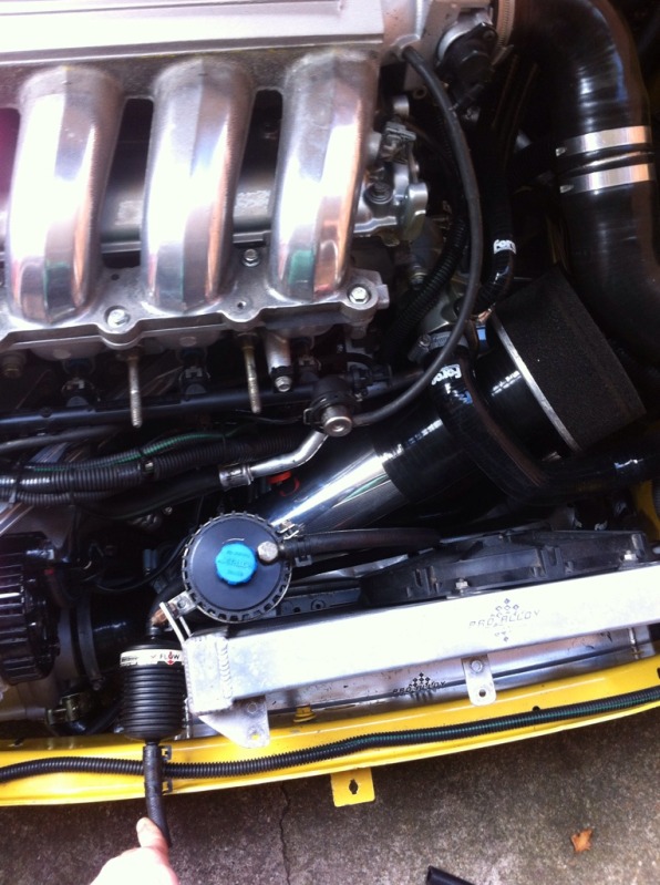

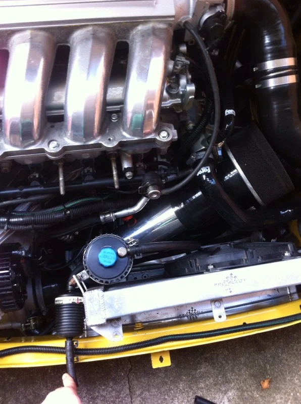

Dom Ive made my own filter relocation set up here's a picture.

Looks cracking as always. Have you kept the cold air feed in place? On my phone so can't quite see
Looks good that mate, nice and simple. What sort of air filter is that.

Thanks Paul, the only cold feed I had was when I ran a V6 airbox in n/a form. What boosted route do you want to take?
Its an ITG filter it's what you get in the original rstuning kit, so it can sit in the gap between the charger & radiator.[/FONT]
Have you had any boost drop from that? I moved mine somewhere similar and lost 1-2 PSI
Not that I've noticed but it was mapped with it on at stage 2 I havnt swapped it after mapping & stage 1 the filter was directly on the charger.

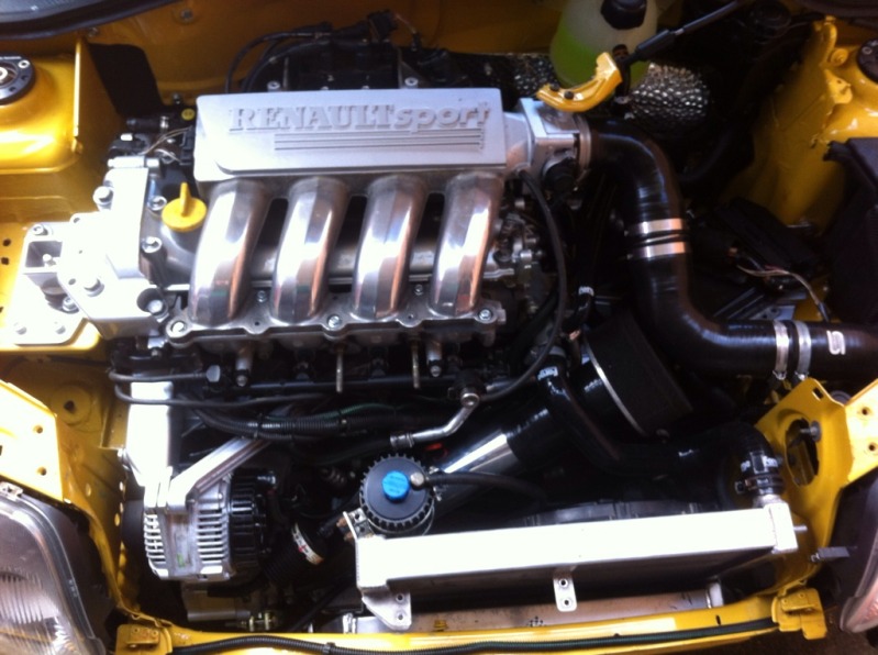

I said I'd do Dom a list of engine mods that I've done as he's doing a forged engine too, but I thought I might as well do an upto date list on here as the cars about finished now in terms of any more mods being done.
Engine
2.0 16v F4R
Fully rebuilt
New thrust washers
New big end bearings
New main bearings
New OEM oil pump
Supertech Inconel One piece valves
Cat Cam valve springs
Cat Cam 438 cams
Cat Cam rods
Custom CP pistons - 83mm
ARP rod bolts
Cometic head gasket
Rotrex C30 94 supercharger (Brand new)
Custom pro alloy inter cooler
Custom pro alloy slim radiator
Custom slim fan
Mocal oil cooler for charger
630cc injectors
Megane sport spark plugs
Megane sport crank pully
Helix organic clutch
Ported out Ph1 cylinder head
Matched inlet manifolds
ITG air filter & custom pipe work
K&N breather filter
Black silicone boost pipes
Samco black coolant pipes
182 exhaust manifold
K-tec 2.5" decat/link pipe
K-tec 2.5" supersport stealth cat back
Vibratechnics engine mount
Vibratechnics gearbox mount
Powerflex dogbone mount
Iceberg silver engine cover
Polished inlet manifold
Using Millers Nanodrive CFS 5w40 engine oil
All engine brackets/mountings & gearbox mount powder coated

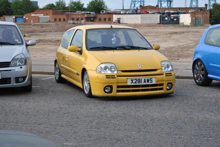

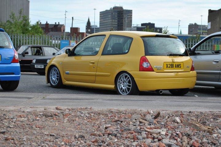

lol at the last couple of pics! way too low and look how the wheels looked being non-spacered.
I thought i'd posted in this thread but obvs not.
It it one epic car! Got to be the best ph1 one here. Epic spec list aswell craig :) Just awesome.
Haha I kno far too low, that was when I first fitted the coilovers wasn't like that for long though, the wheels look lost in the arches too :dead: Spacers are a must on them IMO.
Not sure about the best ph1 but I really appreciate your comments mate :) it's come along way & I love the little yellow thing lol.
