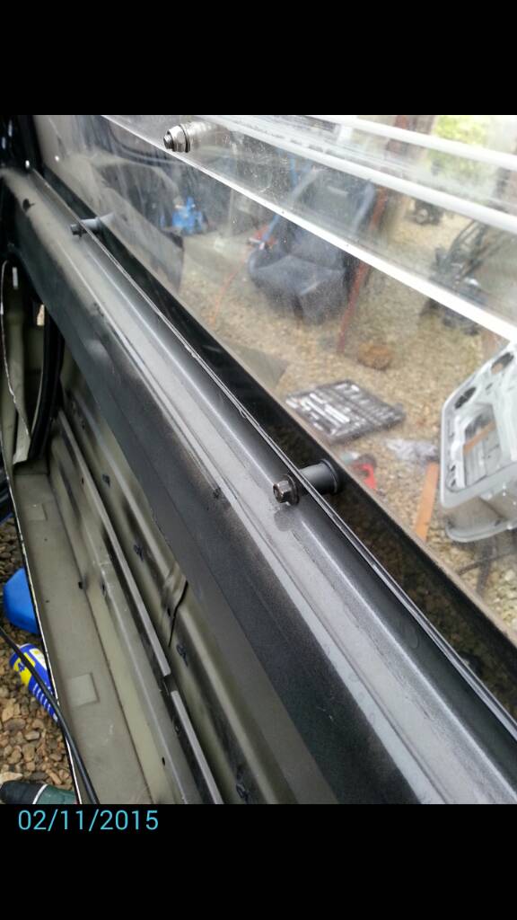

Sorted how I am going to bolt my front windows in just debating cutting all the material out covering it up! My uncle work a window fitting company so he is going to do a decent job of the sealant on the backs!
Im not on the Bedford one its to far for me after the Oulton park trip
Here we go bud, works very well outer rubber trim covers the bolts looks very tidy and secure..

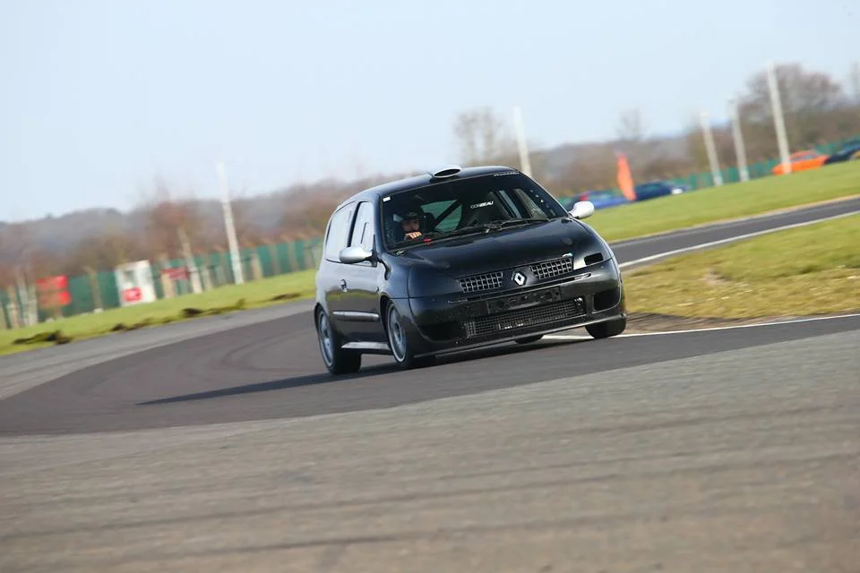

Well its first outing was proper good like!
Traveled up Friday night to split the driving up and back in one day as well as a full day on track would of killed me.
The day was very successful, the car ran faultlessly all day, apart from the adjuster on the bottom of my ASTs falling off somewhere round the GT circuit, and my CV boot making a mess of the inside of the arch and everything near that, despite not having a spare it managed to survive without any grease in it.
In terms of set up, I spent most of the morning facing the wrong way, either from not warming the tyres enough or just not gauging the car well enough. Despite this I felt very confident and comfortable in the car which is great news.
Im pretty inexperienced in terms of track days/cars in general really (Think its my 5th trackday) so spent most of the day practising to really dial in trail braking and perfecting my heel toe beforehand - I found trail braking really effective on the hairpins after the long straights as those corners at Bedford really just seem to feel dead slow and really bog the car down if you don't get them right. But yep was a great day most importantly meeting more of the crew and having good battles out on track. Another thing i need to consider is noise levels, spent most of the day trying to get as far away as possible to the DB meter while getting noise boarded early on in the morning.

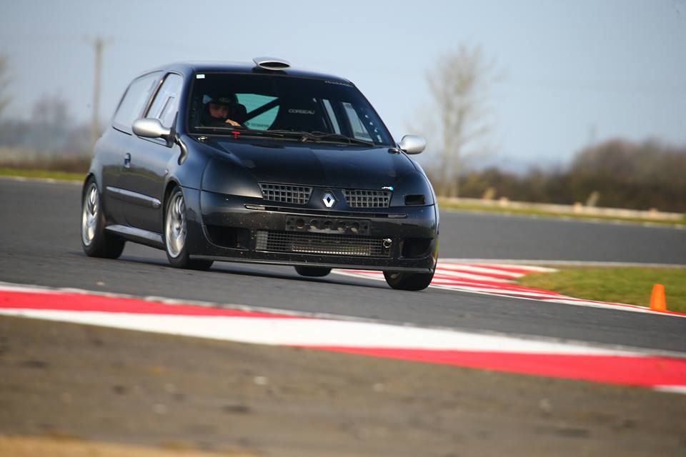

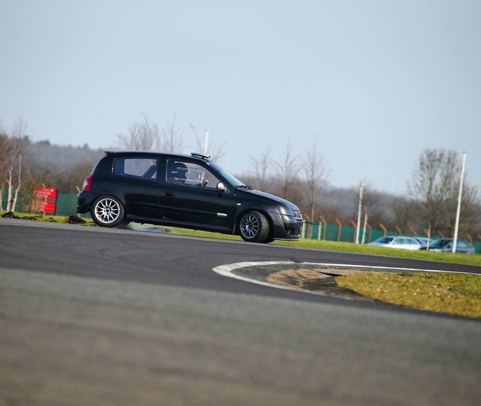

Few photos that were taken at Bedford, knew the camera man had caught a few spins on there.. as when I would straighten up I would always see him crouching on the exit of the corner looking down in his lens in disgust haha...
Photos below, forgotten how to upload haha..
That went well...

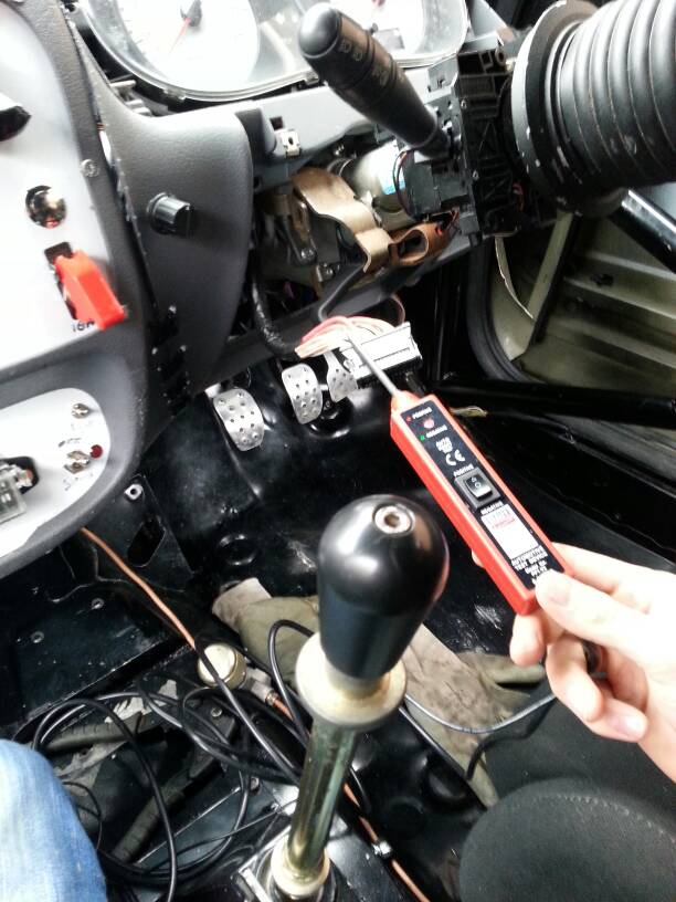

Started on jotting down what wire does what etc so I can get rid of the stalks and put them on switches on the dashboard, I'm tempted to make a separate loom for that day when I buy a standalone ecu that can run the engine while my own loom runs all the interior s**t.

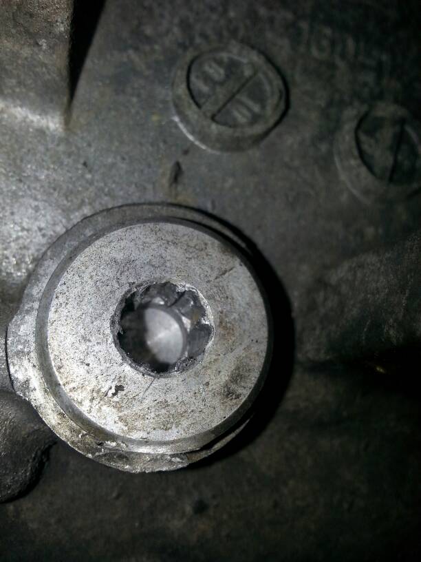

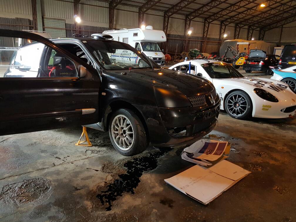

and spend the day faffing changing the gearbox oil on the 330, was greated with this...
The good and bad thing about it was it was very easy to remove with molegrips which suggest a person who previously owned this was to lazy to find a spare plug for the filler. Lucky it's the same size as the lamda blanks on my ktec exhaust, so a little swap and all sorted.

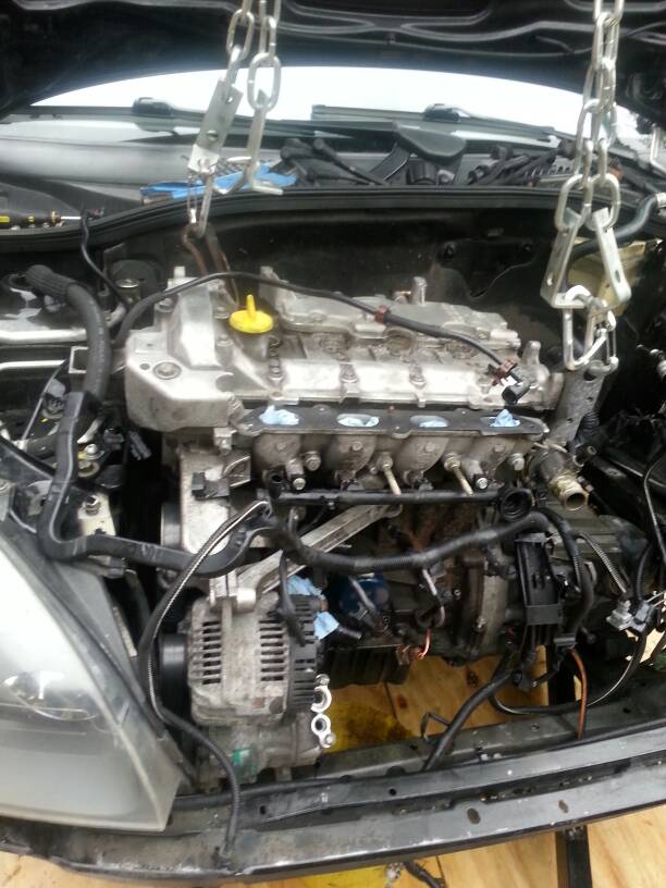

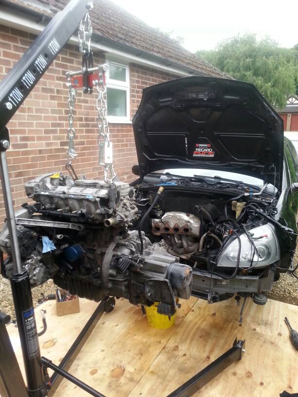

So recent events have forced me to part with my 182 (which can be seen below) lots of money has been poured into it as you can all understand, and is currently up for sale.

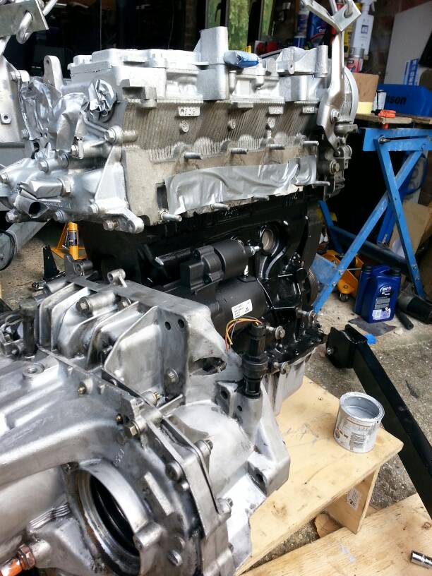

It recently underwent a bit of surgery due to a crunching 3rd gear and a dodgy starter motor, so I decided to remove the engine as a hole, as before the sale it would give me a good oportunity to clean it up - my thought process behind this was last time i removed a 182 box it was by dropping the subframe on my back on a gravel drive - it was unpleasant!

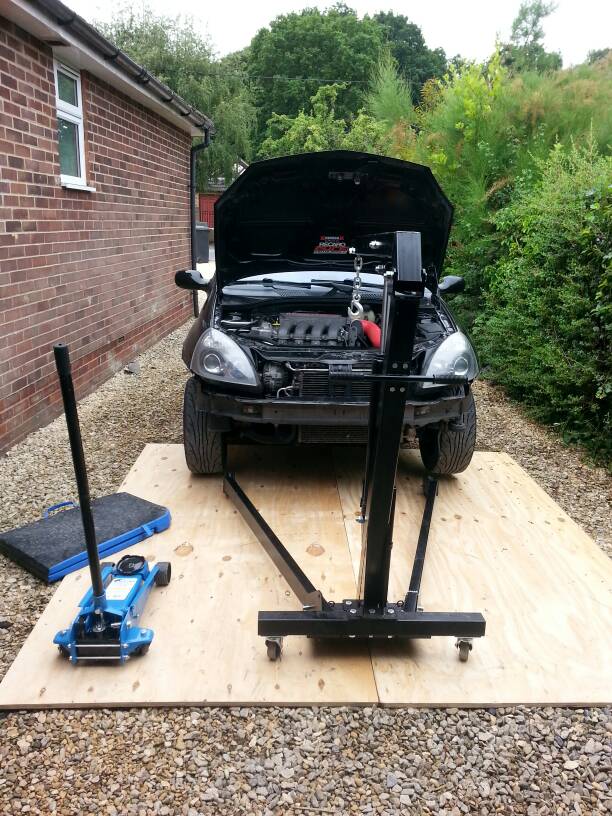

So I began sourcing stuff I needed, I borrowed an engine crane from a @CUB off here, who was very helpful providing that, and when I say stuff that was all I needed really.. haha but yep top man he is!
Here's how she started.
A during showing state off engine etc
So it was a big learning curve and it was the first time I removed an engine, but it came out without any issues which I was pleased about.
and there she is back in and all cleaned up with no issues, apart from the live wire of the starter motor was touching the trigger wire... when I connected the battery I thought I had managed to hotwire my car as it started turning over...

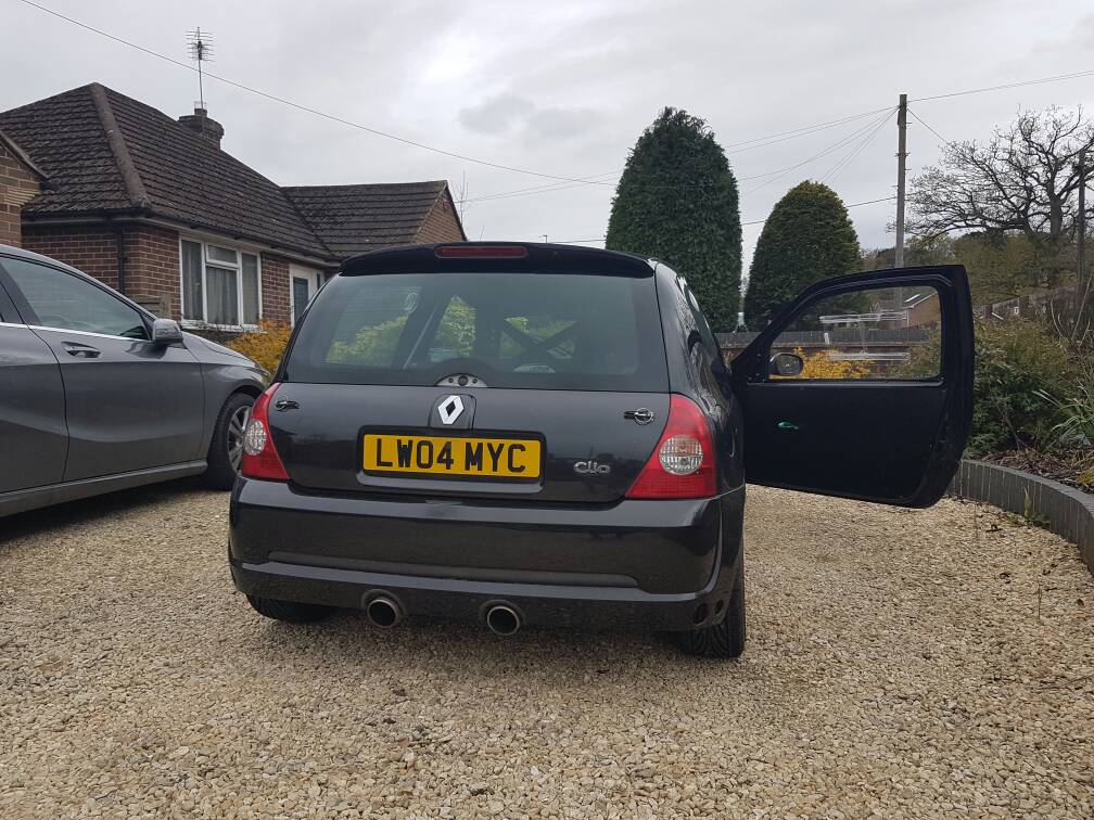

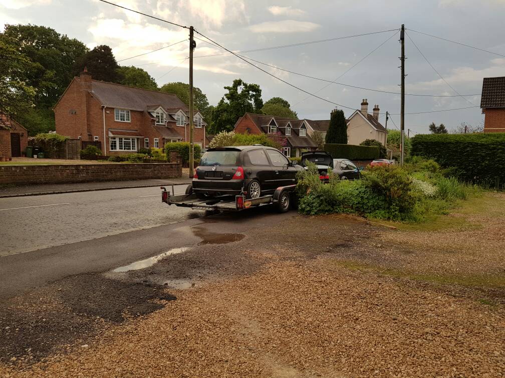

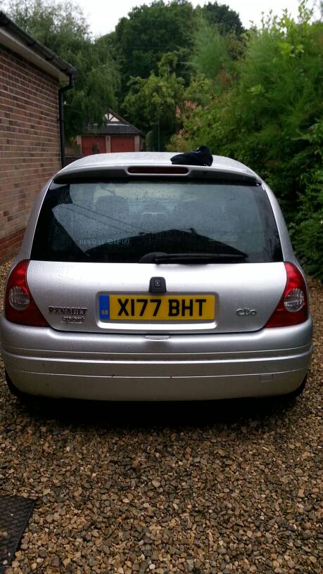

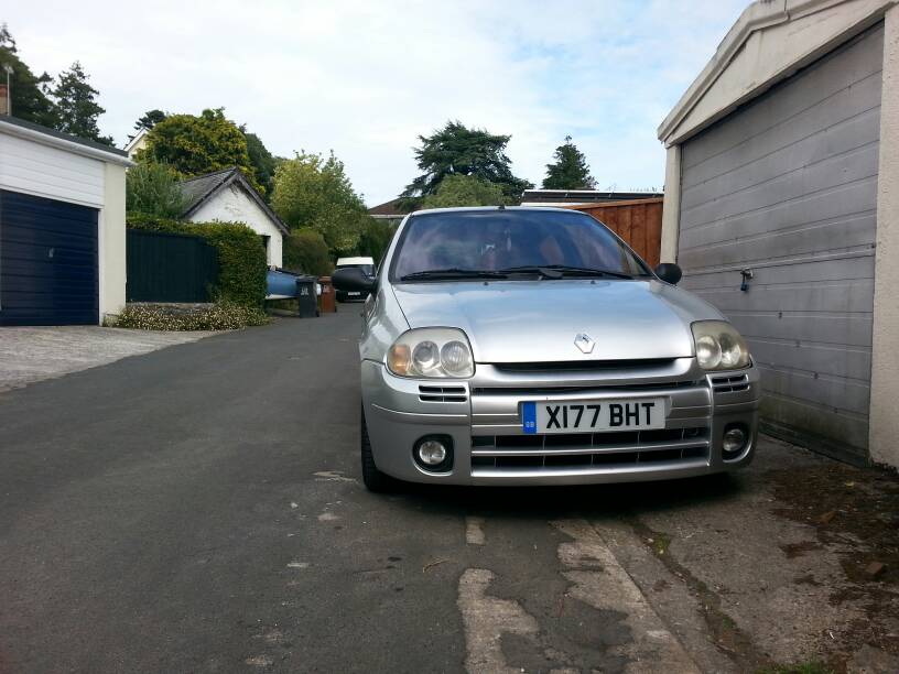

In addition to this I have bought myself a run in 132k phase 1 - I've always wanted one and now is probably the right time to, the title suggests this will be tracked, and further down the line when a daily is sourced - it certainly will be.

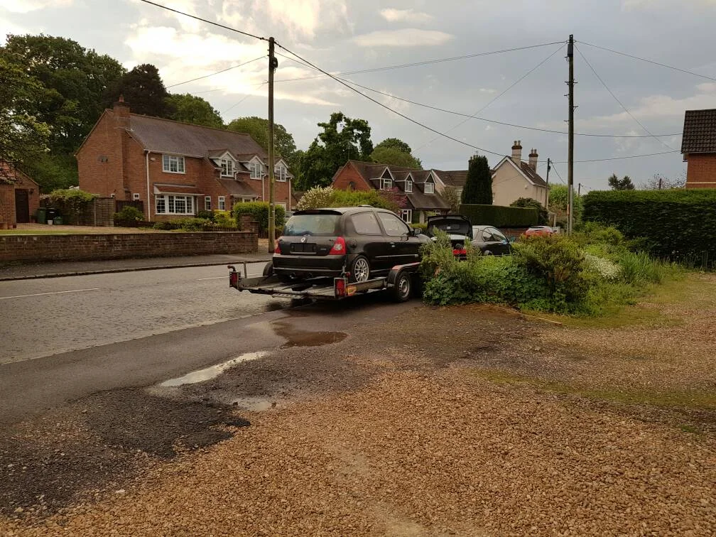

I bought it very much standard, it hasn't been looked the roof looks like someone's had a dance on it, but hey its cheap and the front end is cool af.
Picked her up from Devon
First thing I did was change the rear lights to ph2, but not I'm very much regretting it since I picked up a cup spoiler... 😧 (for £25 bargaaaaain)
following that, i restored the headlights using the usual method
It was raining, and garage space is minimal...
2nd update was to replace the drivers side door, which the guy had supplied - turns out a Ph2 door will fit in a 197
also put some ph2 bump strips along with colour coded door handles... which is a Ph2 mod I do stand by! haha

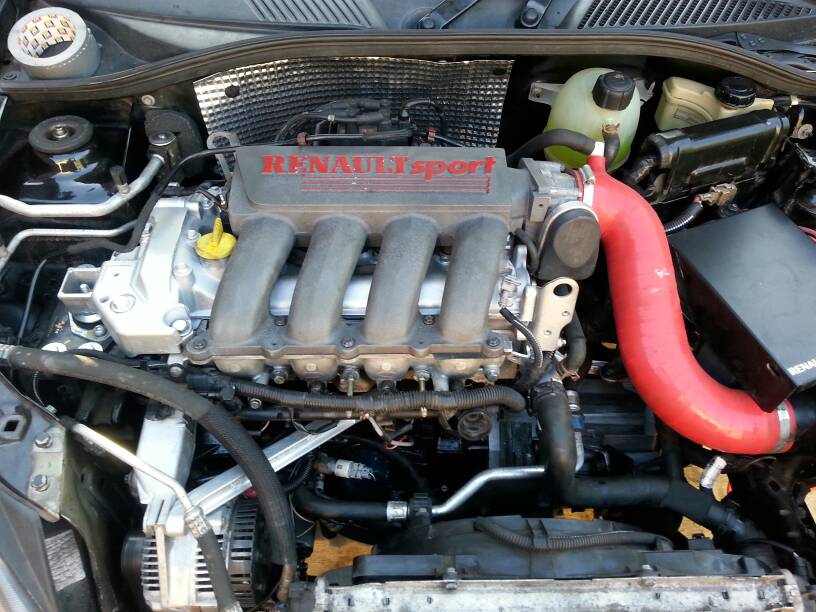

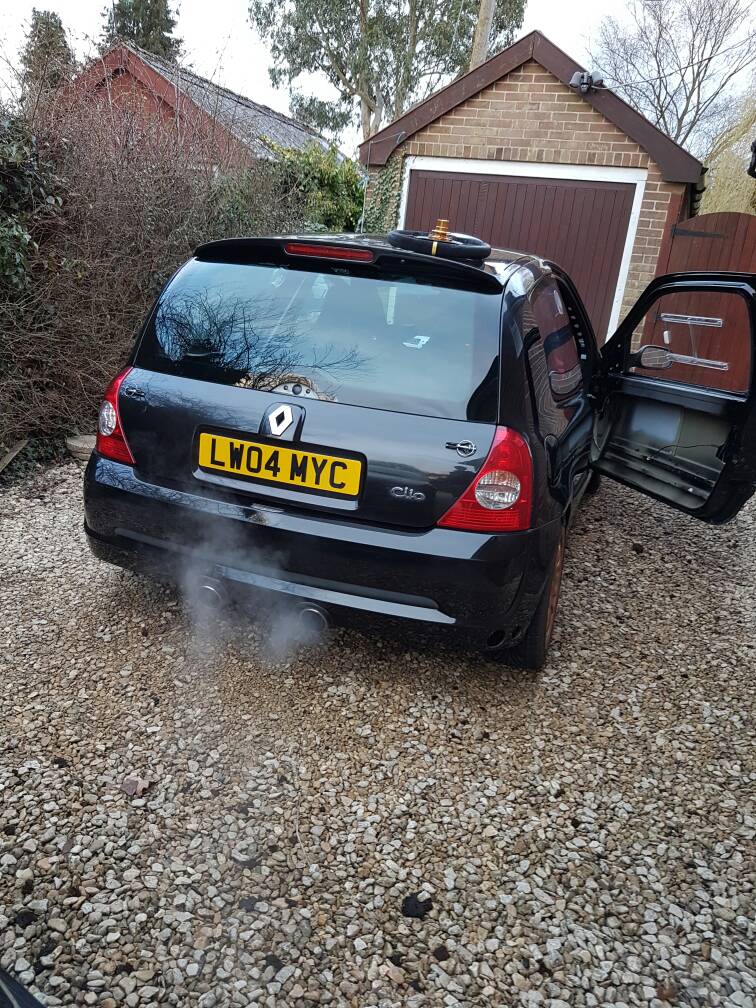

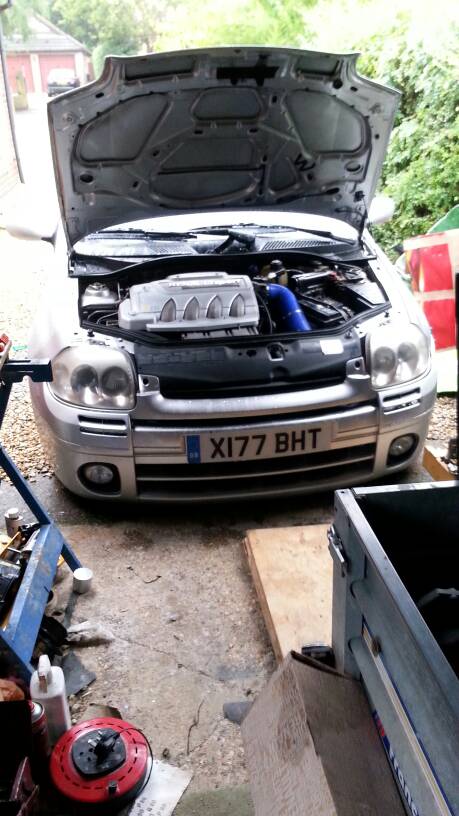

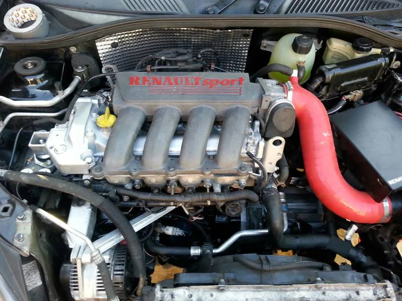

So going from getting back from bedford with a horrendous misfire, I replaced the injectors which seemed to cure the main misfire but there was still a misfire on idle that I could not diagnose.
I remembered when i originally bought the ph1 he supplied a new fuel filter with it. So i chucked that on today loving life with the ph1 external fuel filter set up so it was just a case of plug and play, and that has seemed to have done to trick...
Im not sure if the misfire was caused by using bedford fuel, but it seemed to be quite consistant with other members. Anyway im pretty sure everythings all good now, it doesnt start first time generally when it hasnt been used if i dont use the throttle but i think thats another issue (icv or summin)
Also managed to get hold of a replacement adjuster to replace the one thats fallen off, which i thought was gonna be a massive ballache but kevin @ kamracing sorted me out. Win.

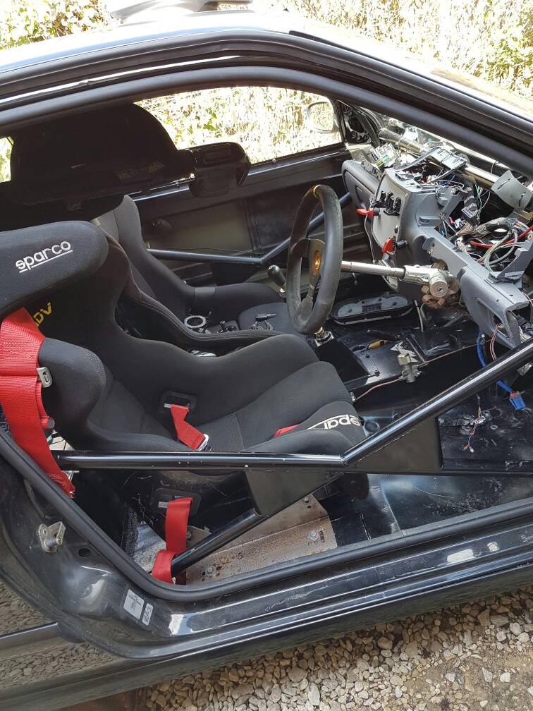

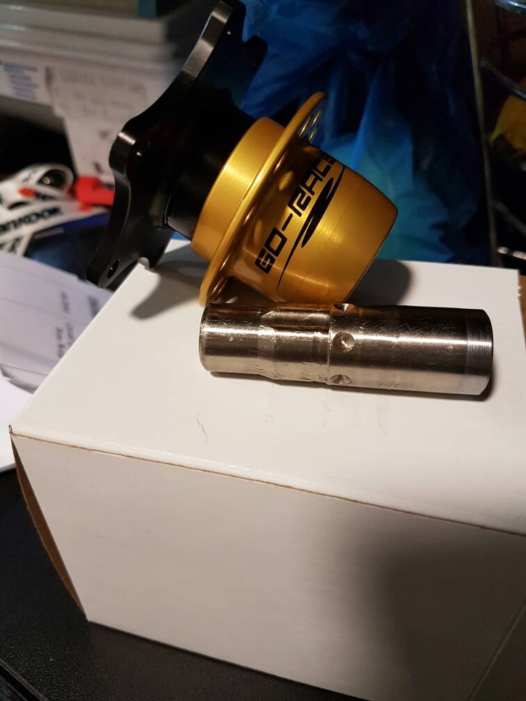

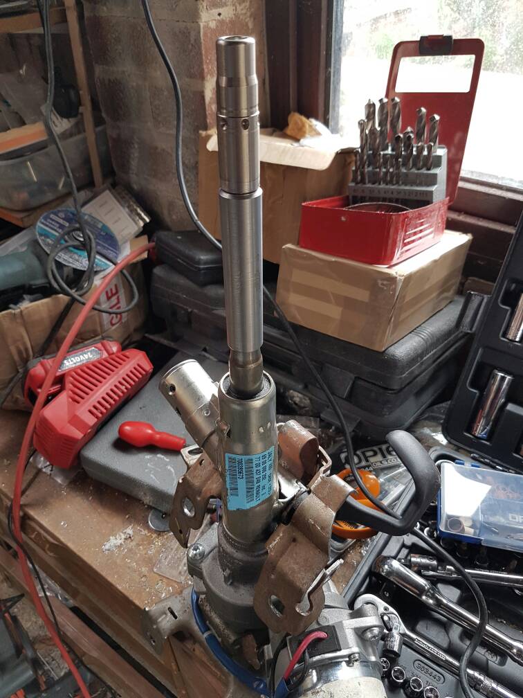

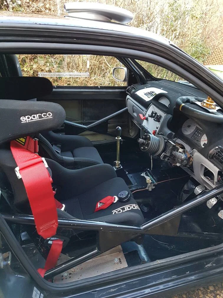

The spare cash from this meant I could buy a new QR, I went for a self aligning GoRace, not cheap but fantastic quality

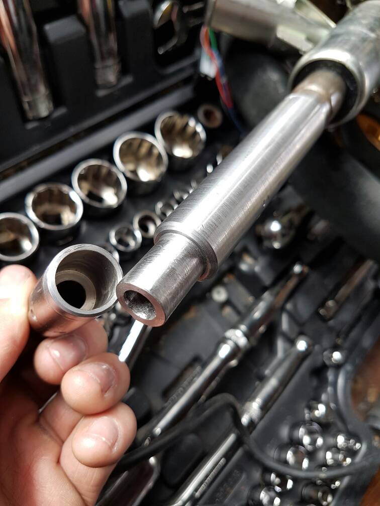

So I set about planning on how to fit it to keep my steering position the same (which is pretty far back)
So I had this machined so it can sleeve the steering column and the QR slug together.
This has now been welded either end and is obviously now very secure.
These pictures are from the test fit earlier. The plan is to remove the casing that holds the ignition barrel and make up a few brackets that go from the dash roll cage bar to the steering column.
Also there is obviously quite a lot of leverage on the bearing of the steering column so maybe an addition bearing being fitted to the shaft that was milled above will help keep the longevity of that.

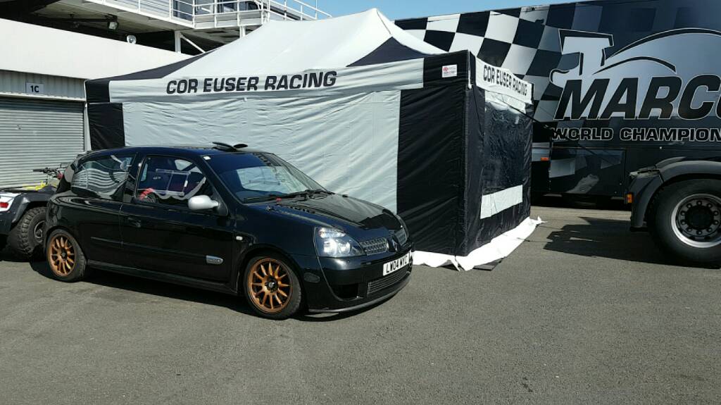

In other news I managed to get the opportunity to help out Cor Euser team in the pits for the silverstone 24hour. This was a great experience and will hopefully be doing more in the future.
So yeah all round brilliant weekend there.

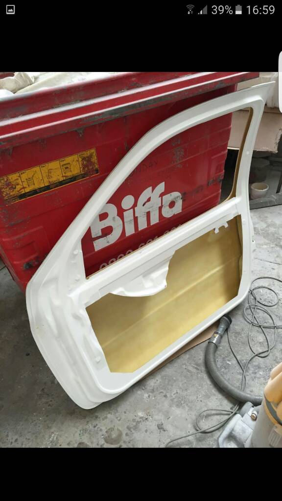

Anyway next plans for the car are to sort out the fiberglass doors.
Need to source some mk1 kangoo hinges to get them fitted and I'll wrap them black to save some money on paint.

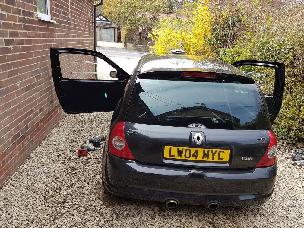

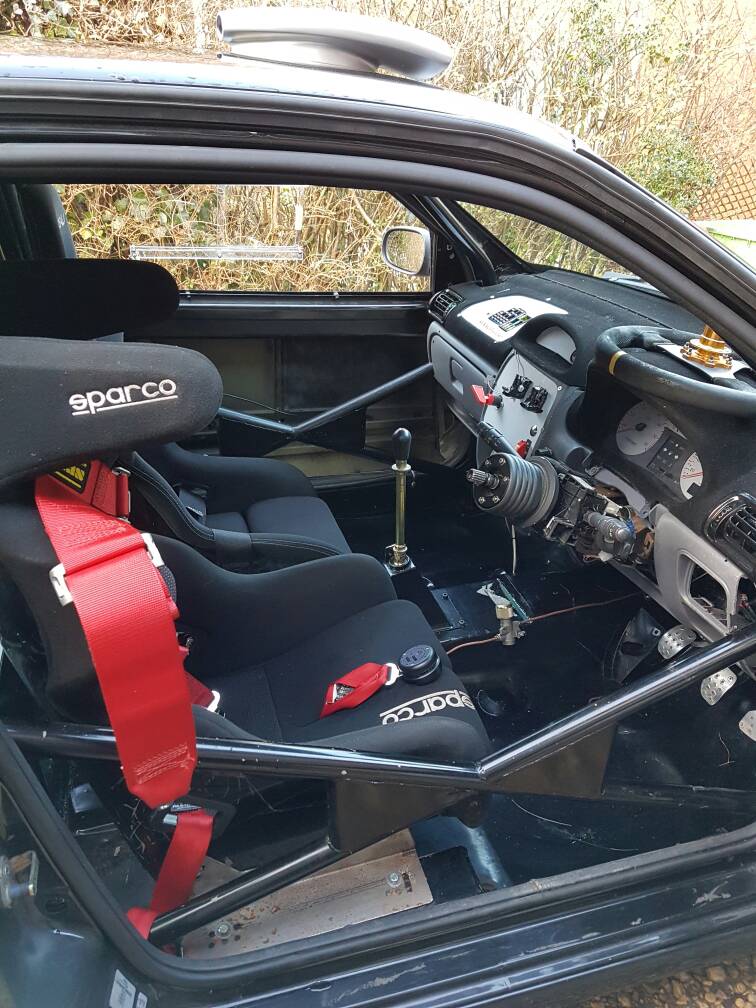

Just about had time to do a few things today.
Firstly got round to fitting the door cards i kept putting off.
Smartens everything up for sure.

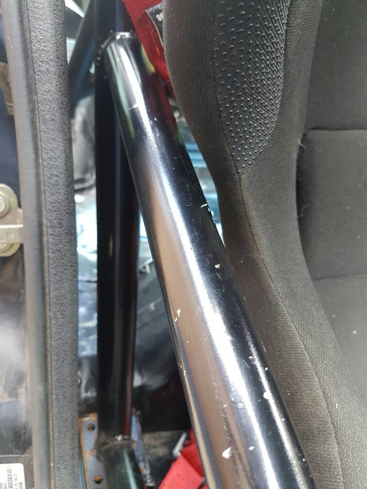

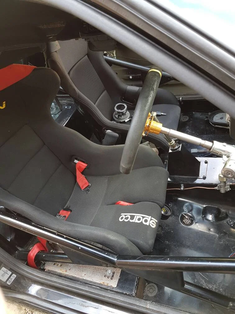

Secondly i wasnt happy with my seating position (to high)
So I set about doing that, very fiddly wrestling with the weight of the seat and trying to find a good position.
In the end i flipped the mount upside down and shortened them so the seats would practically be on the floor, well just above the crotch eyelets, this was perfect untill I realised that the seat hits the door bar.
Balls, so had to rethink that in the end i settled with the height below. Really havent got that much room to play with.

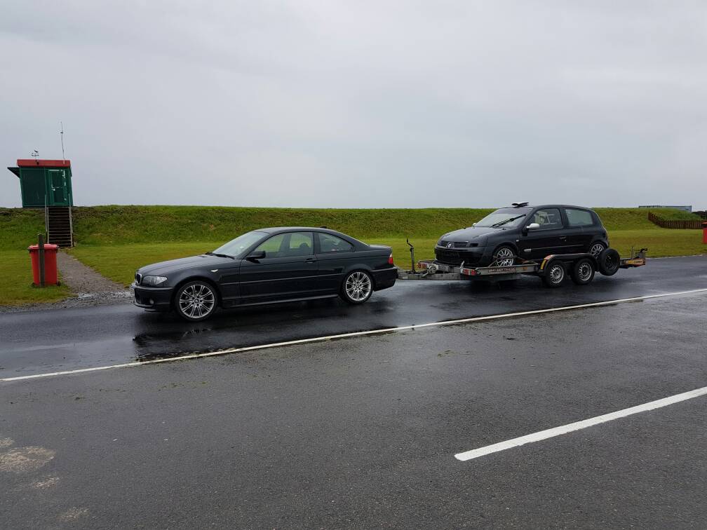

The 182 saw Blyton yesterday for a test day, that I managed to get on, only 4 cars on the day so lots of time to sort the car out, and enjoy it.
First time Id been to blyton, and despite the weather was a great track.
The morning saw puddles everywhere on track, and was proper greasy due to the warm weather beforehand/rubber on track.
Annoyingly i hadnt got round to sorting some proper wets yet, so my road tyres (toyo proxes tr1s) had to do, absolutely shocking tyres to say the lease.
Further along the day the track was starting to dry out in patches, which meant some unusual line choices while blasting down to a dry patch on the inside, braking as hard you could then swerving back into the racing line and trying to make the corner. This was great the first time id been on track in the rain and it was great!
The last session before lunch saw the track pretty much dry, which mean the track had to be re-learnt all over again, this is when the pace started to pick up and smiles starting to get bigger, what a fast track! Loved it!
So yeah went off to the pub for lunch, and came back to this...
Ooops, turns out the curb I smashed into at 'the wiggler' cracked my sump, pretty gutted about this, but considering the day was free and all I had to pay for was fuel I couldnt complain to much! New sump time!
This was also a first for the daily 320cd to tow the clio, it towed excellent all day for the 3.5 hour drive there and 3 hour drive back, and averaged around 45mpg too.
Also colour co-ordination game is strong here...
So yeah will get some footage up later, and i have some video of me going over the curb that caused the sump issue.
But yeah all back home, will remove sump this week, weather dependant and get that sorted ready for Castle coombe in June.

Just replaced my sump gasket, what a pain in the ass of a job lol. Made harder by my exhaust manifold tbf tho.
Car looks awesome
Car looks awesome
Yep started on it today, just gonna drop subframe as a hole I think, although cant get a track rod end out the hub after a lot of smashing it with a hammer!
Cheers dude, so does yours!!
Sent from my SM-G935F using Tapatalk
