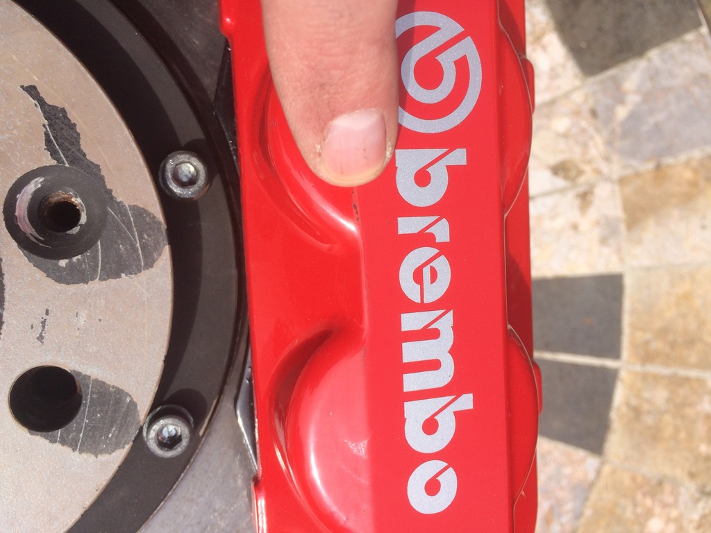

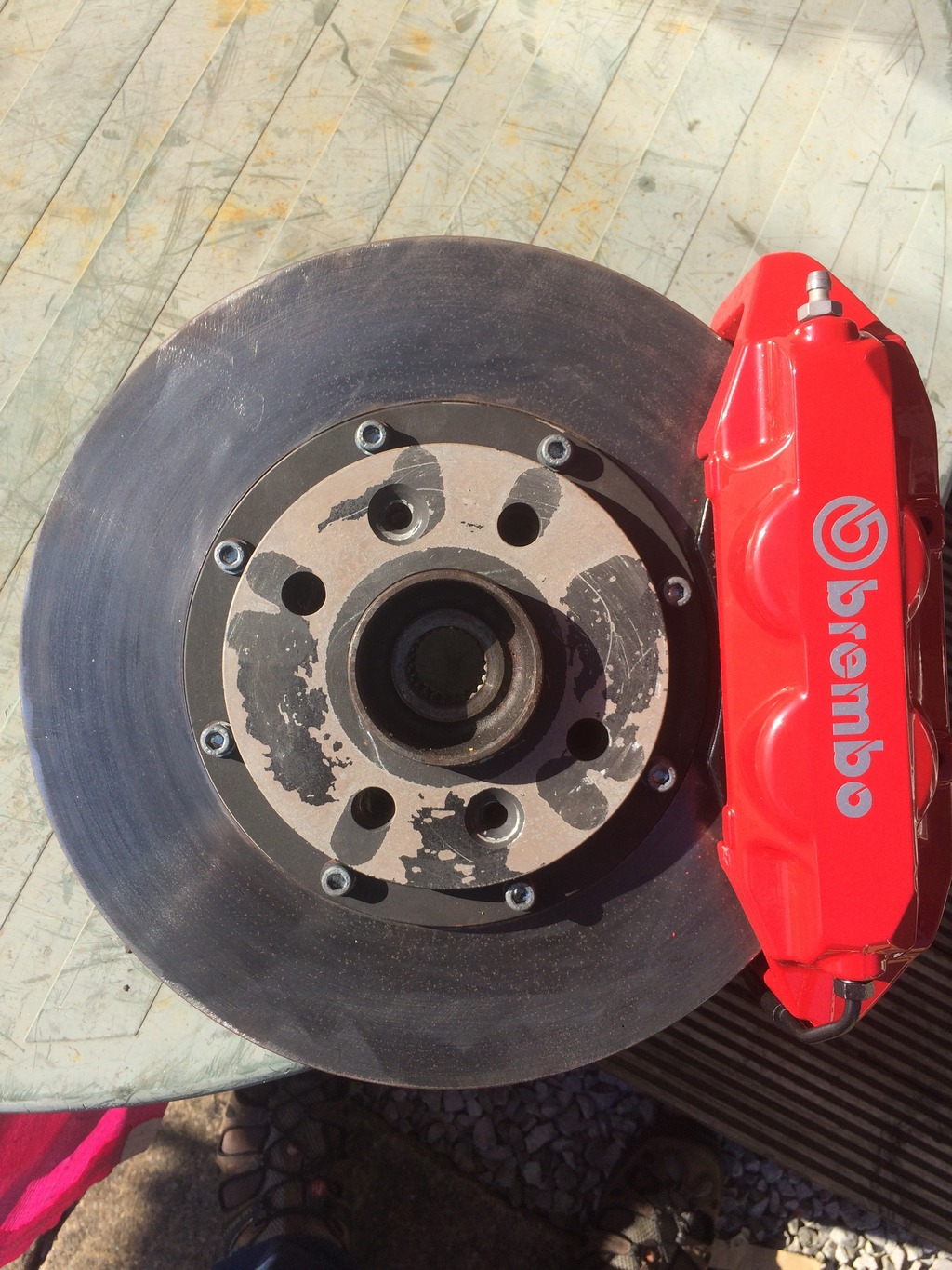

Finally found a bit of time to get the brembos milled down to @chris powell 280mm spec.
Using 283mm bells and rotas and currently M1144 pads.
Inital mock up on spare hubs looks good with no fouling.
Next is to look at exactly what size spacer is needed for Trophy et45 16" speedlines. Too many different opinions online on spacers plus I'm not using standard discs so best just to have a look on the spare hubs.
Like the bell and rotar setup as well as the Brembo's :up: How much in mm have you taken off the Brembo's to fit the 280 brackets as I've gone for a 283mm rotar as well ?
HIi @green. i took the standard 5mm. rather than worring about the 1.5mm less it technically is. Also i figured at a push it would then still run 280mm standard discs if need be. I havent fully torqued everything up but its not looking like it will catching on the bell and currently has a nice bit of disc lip at the top. you could probaly only take 3.5mm off and be fine.

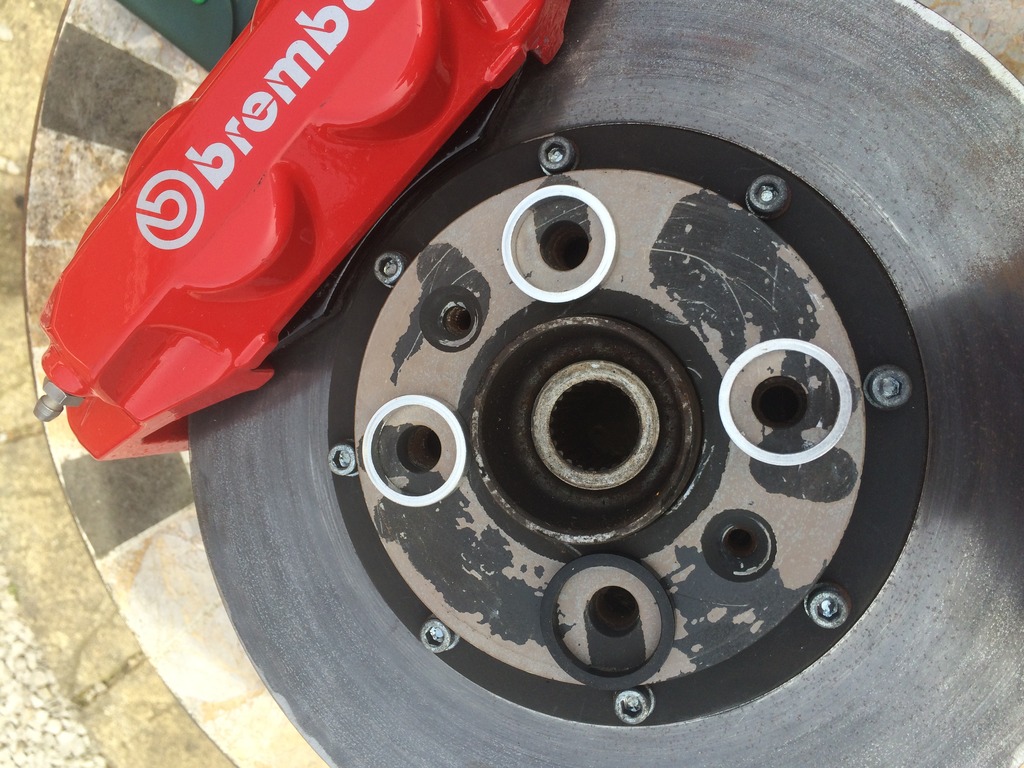

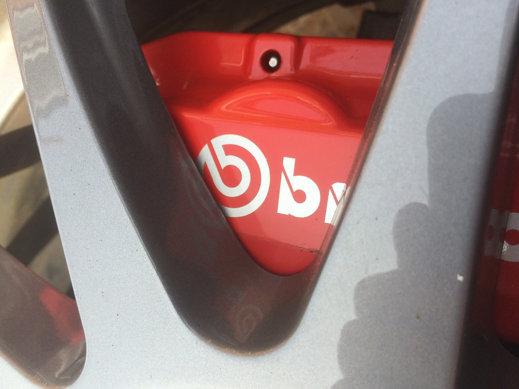

Nicked a wheel of the car. These are genuine renault trophy ET45's.

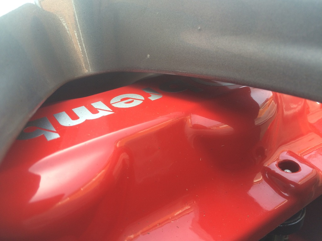

First test face down. On my 280mm setup on this wheel the weights cleared with no issues. I can see on 300mm kits this might become more of a problem.

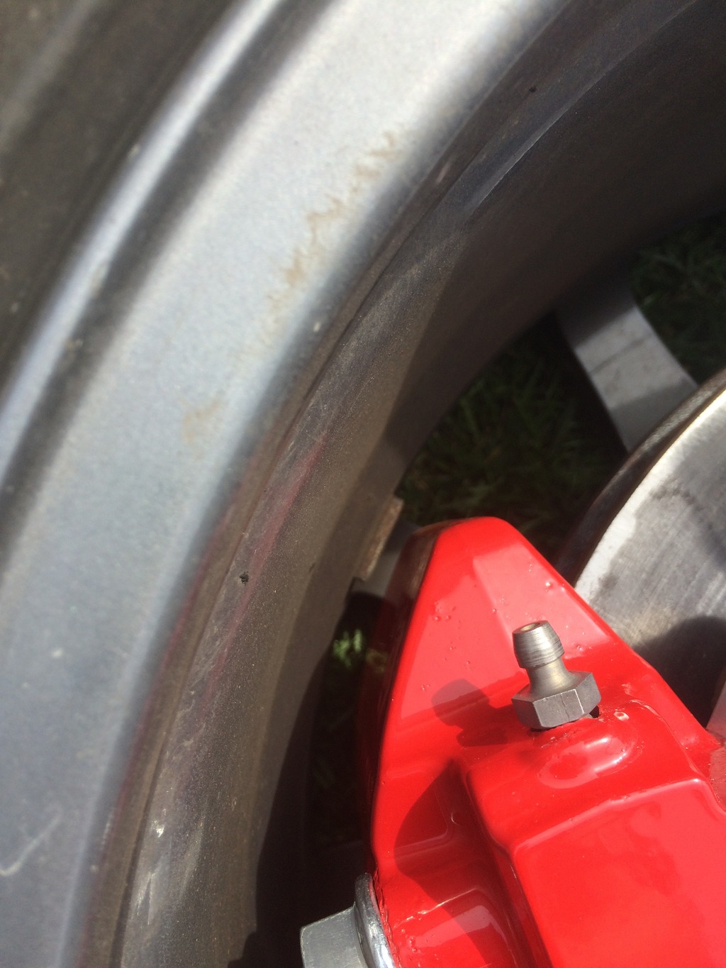

It was however obvious that the assembly was sitting on the blades of wheel rather than floating above it. This was confrimed when i moved everything to the bench with the slightest of dirt marks on the brembos. and further confirmed with the wheel on. i could see dailight between the wheel and the bell on the insde but couldnt get it in focus on the camera.

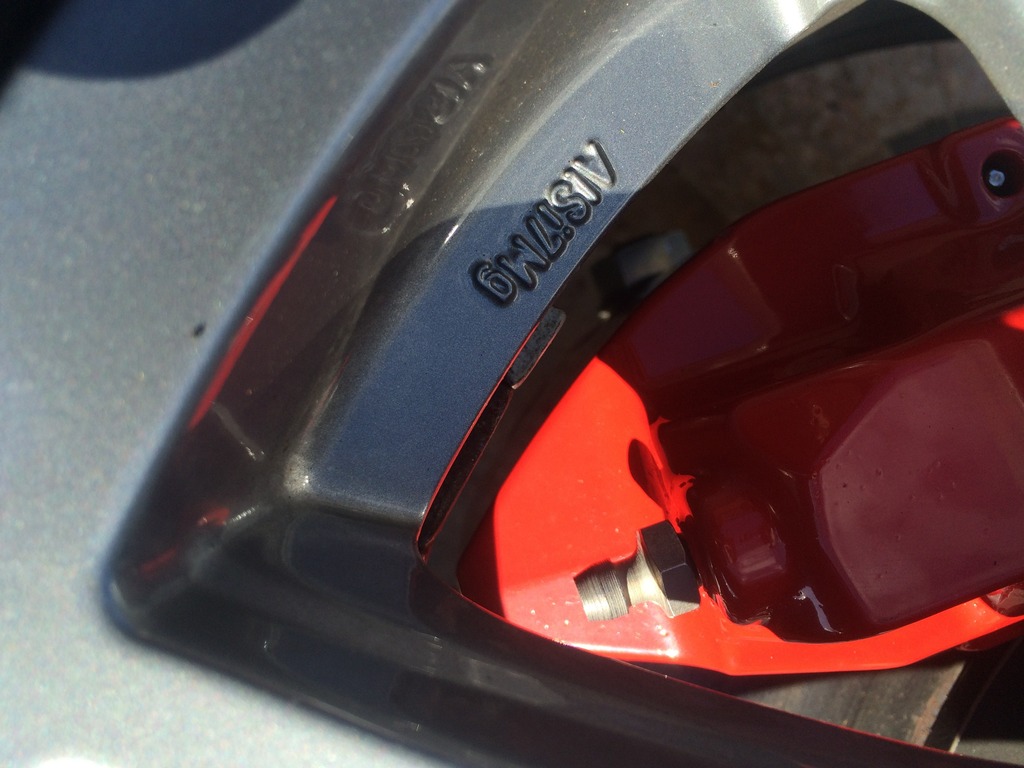

So first stop was trying some 5mm ish spacers. Not the most perfect things but some MTBs headset spacers are cheap and simple.
Once again it looked like the wheel was touching the brmebos and the slightest attempt to spin the wheels wouldnt have it.
Moved onto 10mm spacers and bingo... space. I would judge this to be about 4mm. however with a massive pinch of salt as nothing is tightened up and i doubt the mtbs spacers are the most perfectly made items.

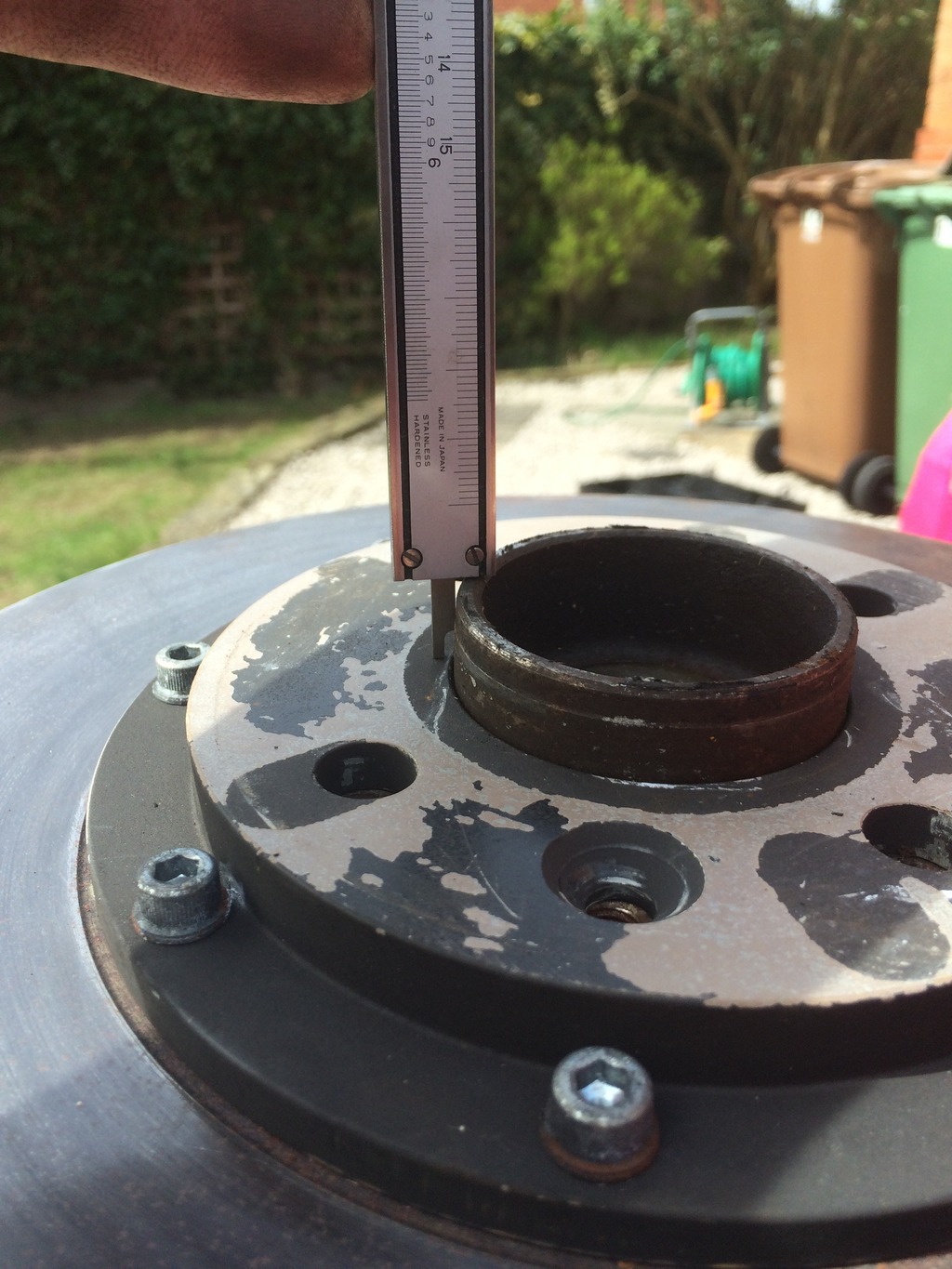

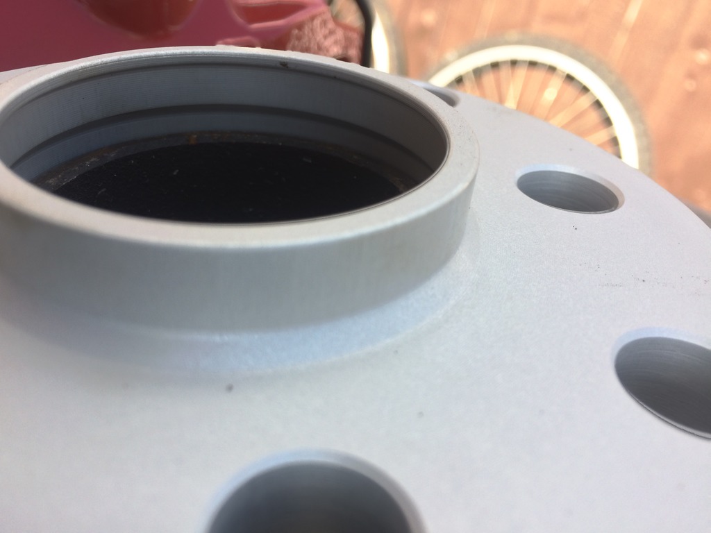

The hub left over above the bell is around 13.5mm. so a 10mm spacer only leaves 3.5mm of lip to help you get your wheel on. I've not made my mind up about studs so i think my only option is to go for either a set of resparyed cup turinis and some 5mm (11.5mm effective difference) spacers or 15mm hub centrics with longer bolts.
decisions..

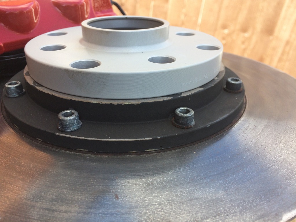

So freash from Germany so Eibach 15mm hubcentrics. The Eibach ones left plenty of space on the hub flange so sit flat.
I would guess you could have them shaved down to be 13mm if I really wanted before the lip of the flange fouled the inside of the spacer.

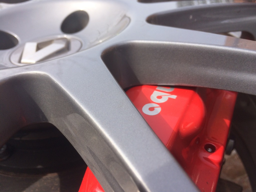

Some longer bolts and the wheel is on the test rig. Again you can see why 300mm kit must get close to the wheel weights.
I would guess with my setup/280mm brackets with 5mm shaved off the brembos. That there is 10mm space between the wheel spokes. Which would tie up with the 5mm spacers touching. and the 10mm spacers having around 5-6mm of clearance.
