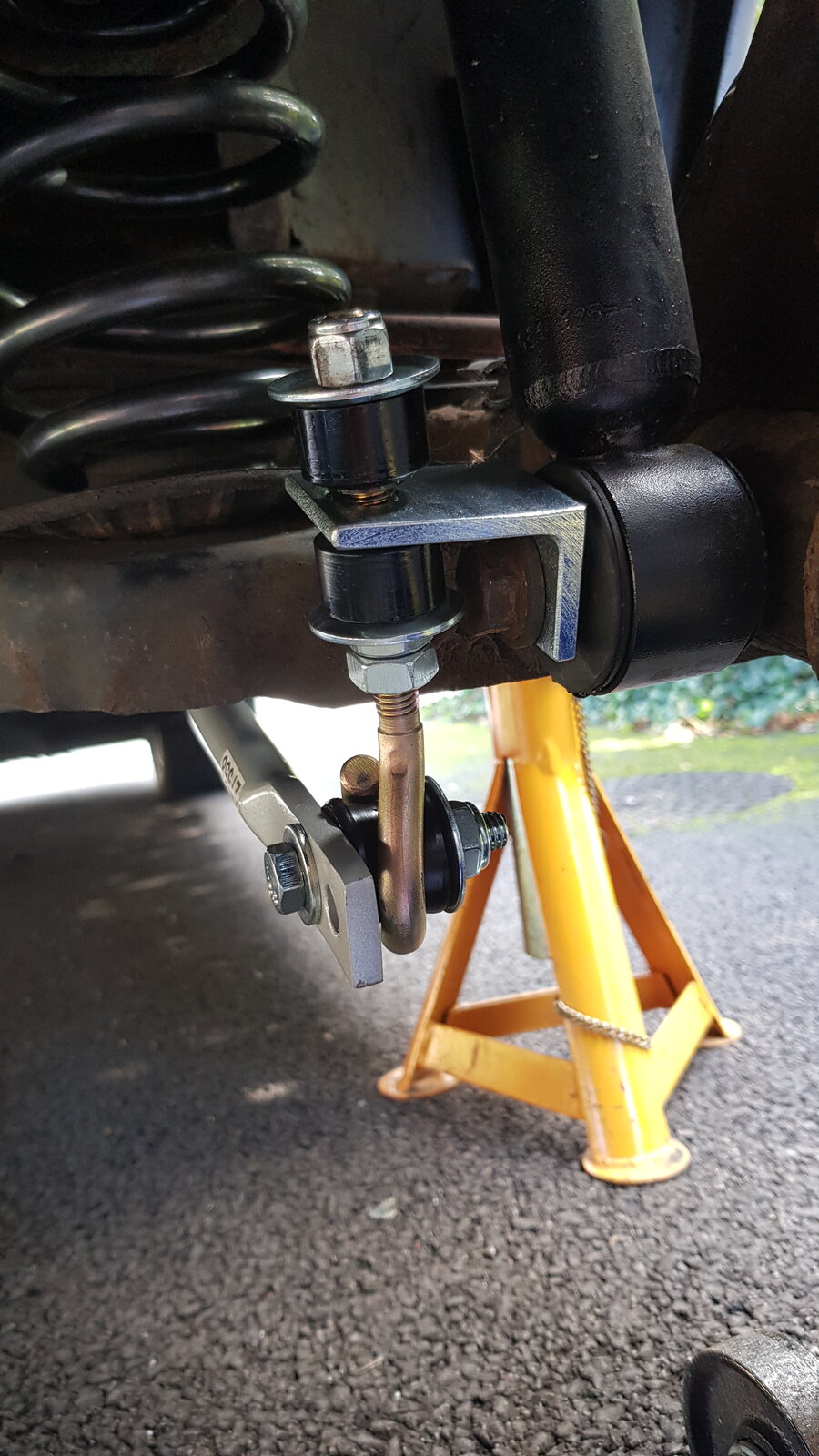

Currently trying to fit a new rear ARB and I have a slight probelm 😬
Doing up the nylock nuts on the links is stupidly difficult. Im having to use a breaker bar to get the nut to turn. In the process the link has been bent out of shape! See pic..
Should they be this bloody tight and if so any tips on not bending the f ing links in the process?
Thanks
They shouldn’t be that tight.
Mine was second hand and I’ve never had a problem with those nuts.
Sounds like the nut has cross threaded as it’s gone on.
Ah jeez I hope it hasn't but you could be right! I think ill undo it and see if there is any damage.

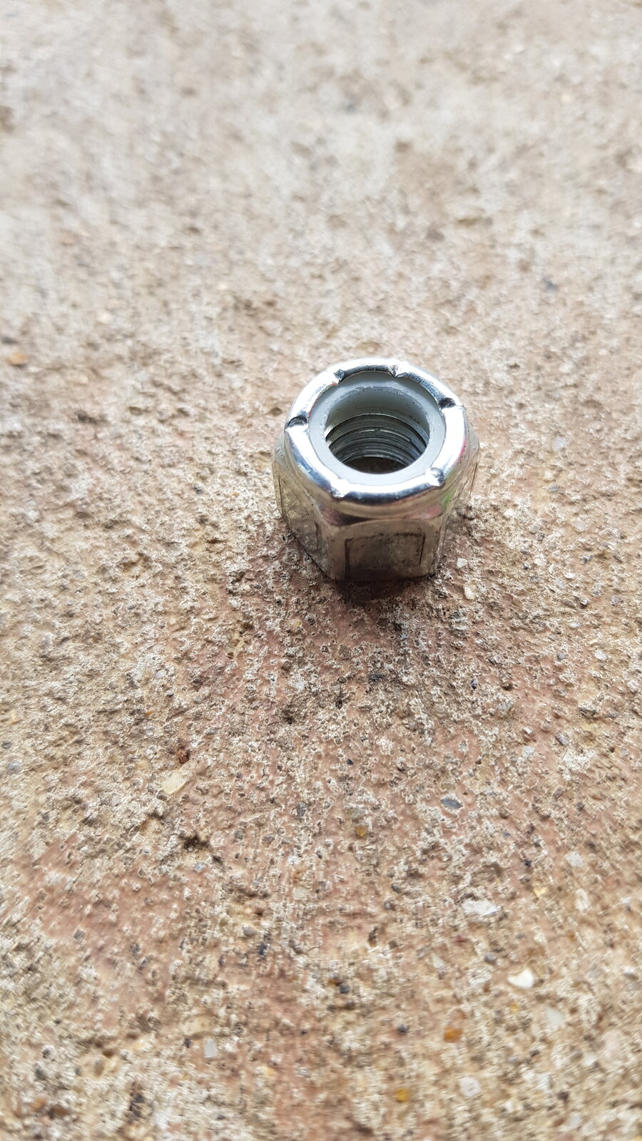

This is the same nut (for the other side). Only had it on 2 turns and the threads look slightly stripped :/

Are you sure you're using the correct nuts? They're imperial on the u bolts but not sure on the rose joints.
Definitely cutting into the nyloc thread and you dont want to be forcing them on.
Ive just read an old thread about this ARB and I think I might have used the wrong nuts so yeah I think you are right. s**t lol. Ok ill see if I can sort this. Thanks :ROFLMAO:
Yeah the embarrassing thing is ive been following those instructions! I think ive got lucky though as the link has bent back into shape from removing the nut and the threads are fine.
Thanks for your help!
