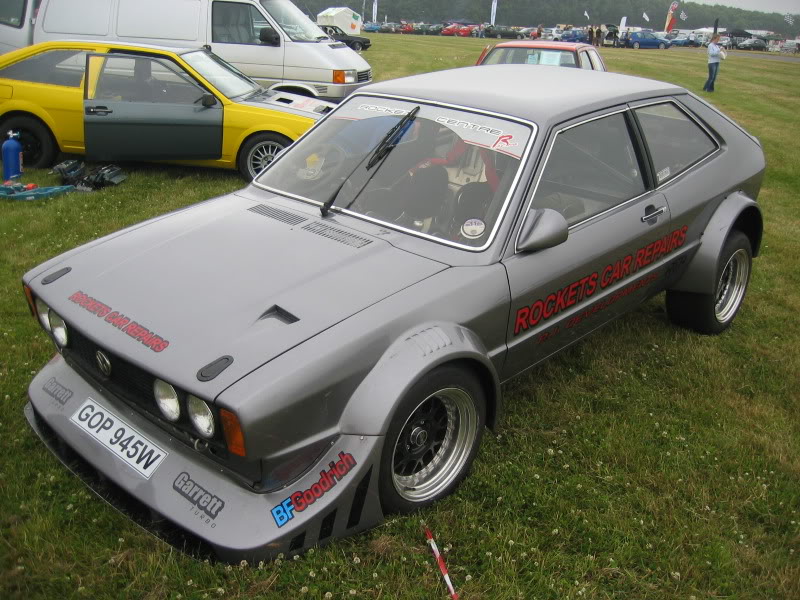

No they wont - the original Clio TT i built in 2004 was running over 400 bhp in a 750 kg car.......
I used to pull up at GTI international and nail most golfs and audi's running the same block.
My pal jordy is running nearly 700 bhp in his car now and his quickest time to date is a 10.07 @ 141 mph.
Thats my uncles mates ginger jordy !
knows his stuff !
