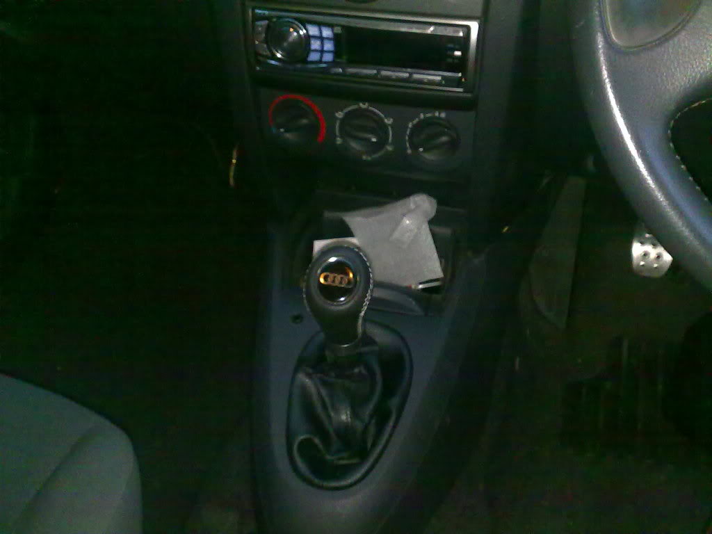

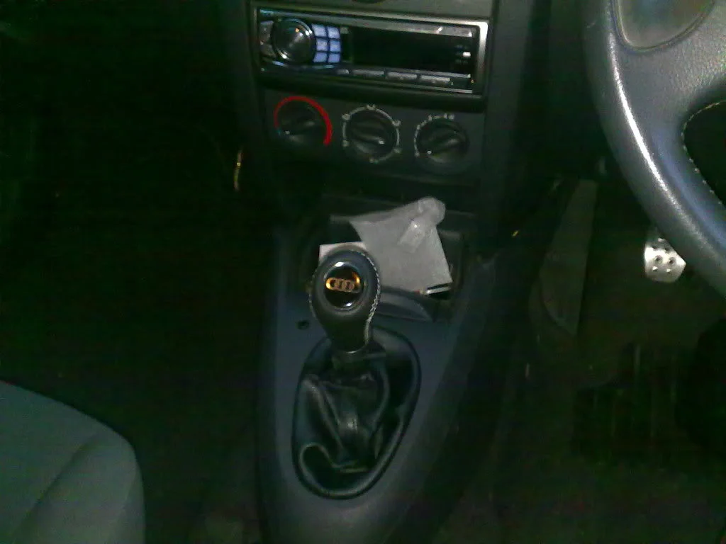

- Installed 182 rear seats

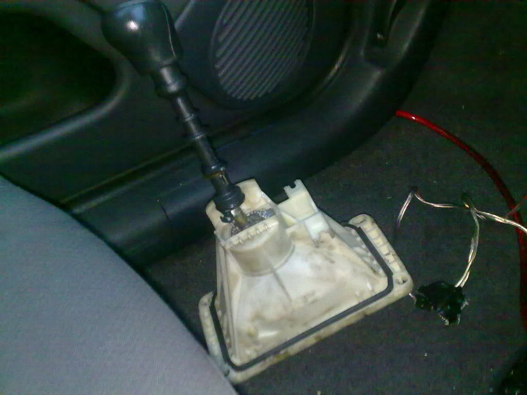

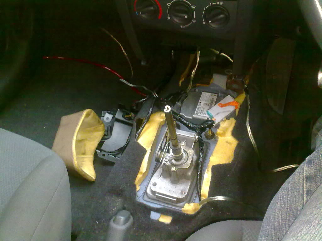

- Refitted the Lower-half of the dash plus gear stick / knob assembly
BEFORE:
DURING - Had to mod the old renault gearstick surround chunk of plastic thing as it restricted movement of the audi gearstick quite badly.
AFTER - Kinda back to factory (Yep i need car mats :))

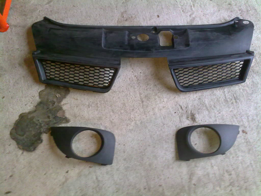

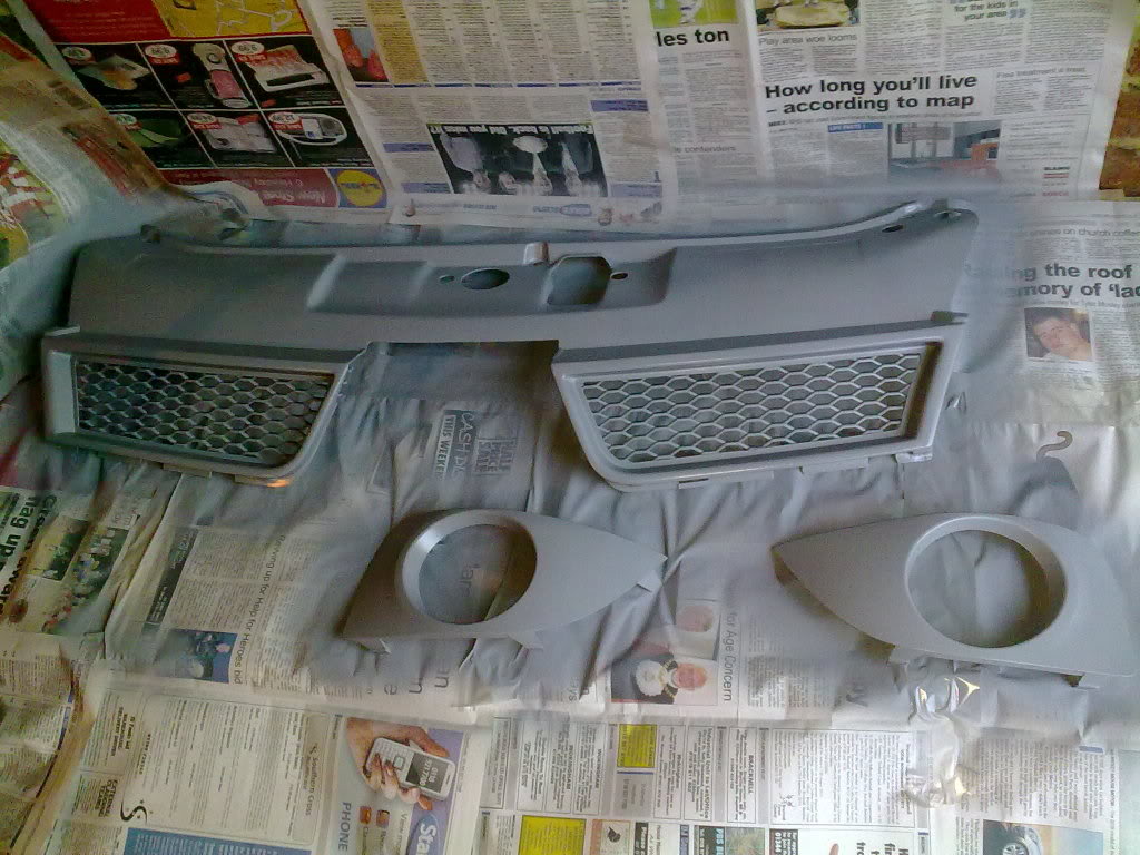

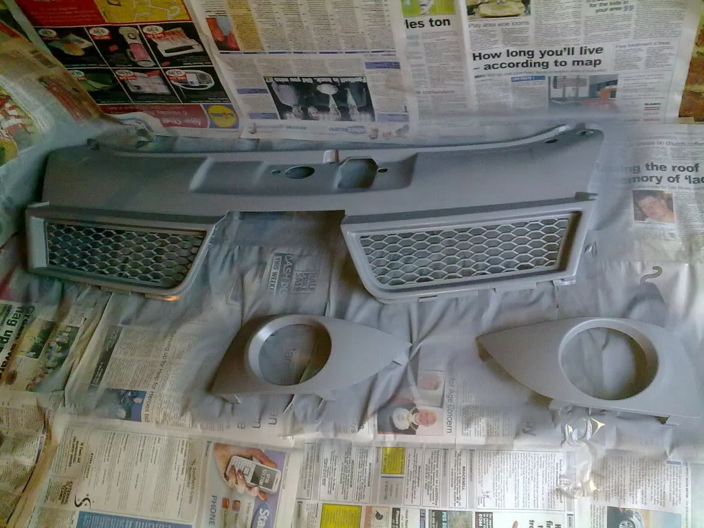

- Then wanted to give the Black plastics on the front end a spruce up...
BEFORE: FOGS + UPPER GRILLE TAKEN OFF
PRIMED:
FITTED BACK ON CAR:

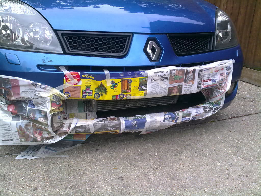

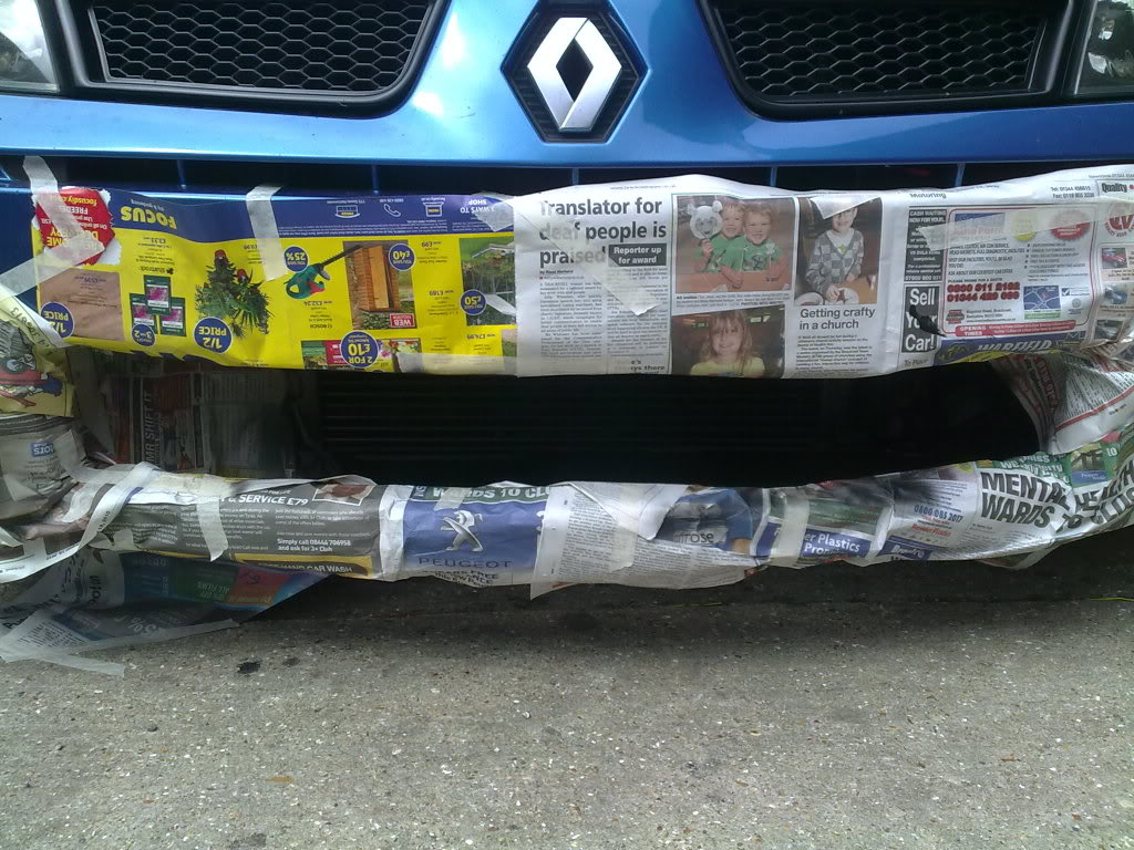

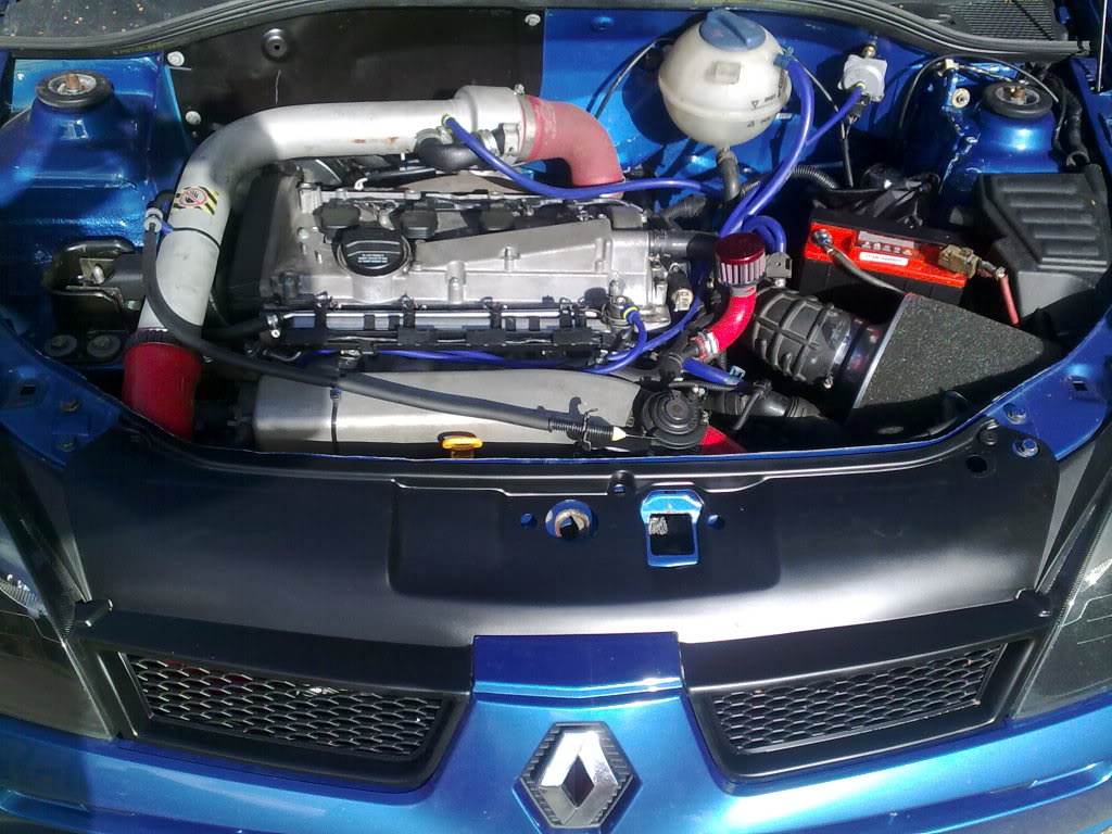

- Then i wanted to spray the intercooler black so it made the clio look as standard as possible
BEFORE
MASKED
MADE BLACK

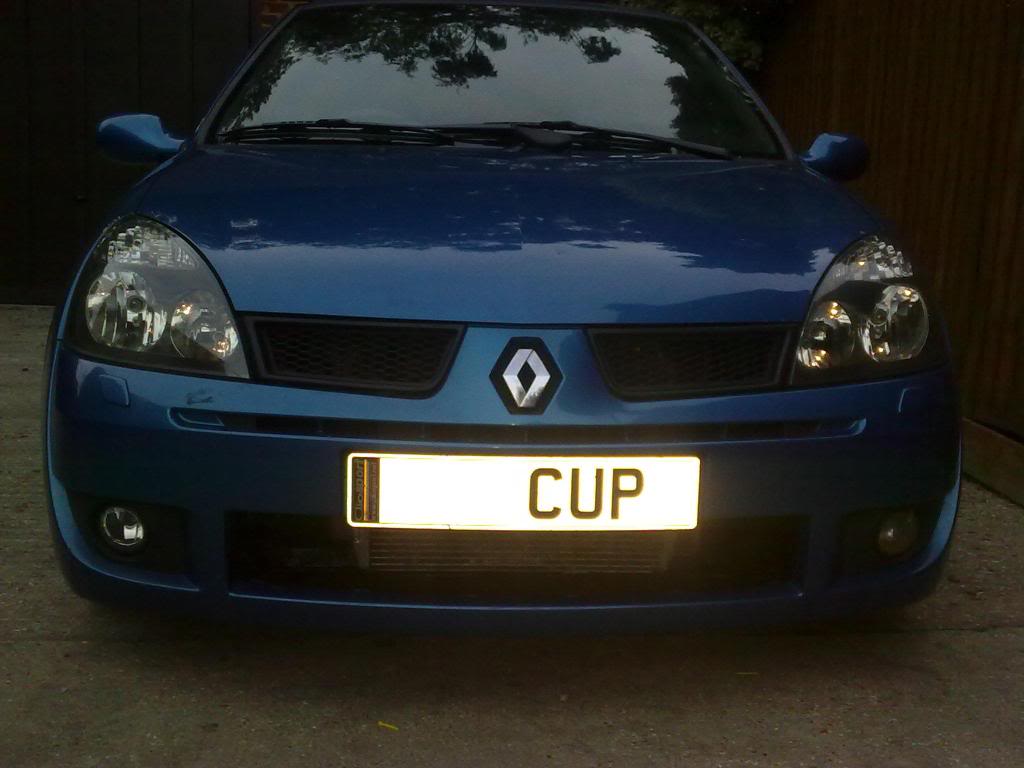

- Then finally needed a new lower grille as its always had a very tired looking bit of mesh over it.. So thanks to Clio172Pete who managed to get me a brand new sport lower grille the front end is now ALMOST complete, and stealthy
YES i realise i need 1 new fog and a splitter (bear in mind the car hasnt had a wash YET-when its cosmetically all done then it will get a right going over :))

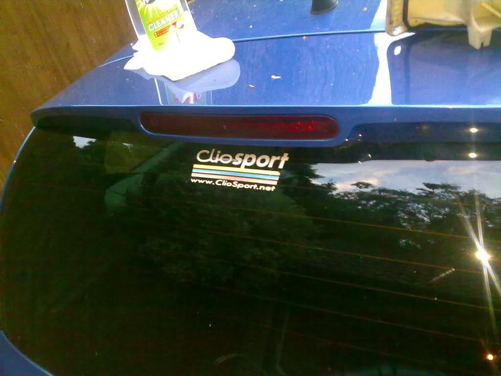

- Replaced the old yellowing CS sticker on rear window with new style fresh one

I was hoping you might swap the grille over for a proper sport jobby!
  172 cup TT
Re: Clio TT (172 cup)
yeh i know what you mean.. years ago there was a huge want for this MS design grille, but am kinda 50/50 on it now... still like it but not as much as i did. Not sure, your helping me sway toward changing it tbh...

I quite like that grill tbh! Car looks great, and is gonna go like you know what.
  172 cup TT
Cheers Jase - yeh somedays i likeit somedays i dont.. Never mind.. Apparently exhaust is all done, ready to be picked up tomorrow morning for its first proper drive to its MOT station

I remember that type of grill from when Middo had one in like 2006 (I think its MS Designs or something) when I had my Mk2, they are rare as f*ck. Looks good, keep it on!
  172 cup TT
yeh thats right Foxy, its MS designs, cheers yeh ill keep it on... ah well, time to hit the sack for a few hours before going to pick up the car and put her on the road - feel like a kid on christmas eve!... touch wood its all good and then goes through its MOT without too much a problem

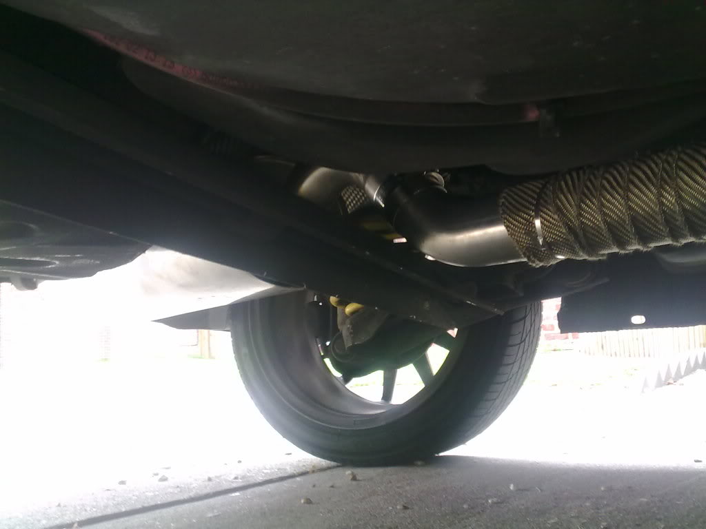

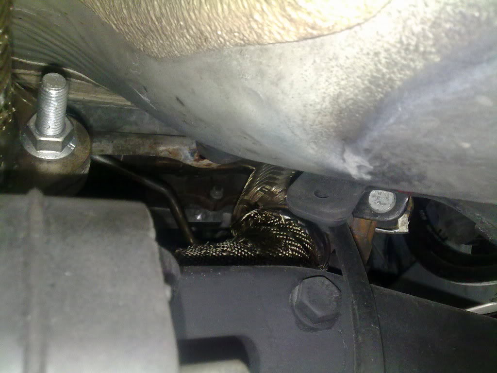

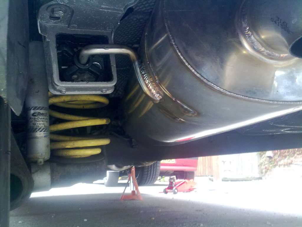

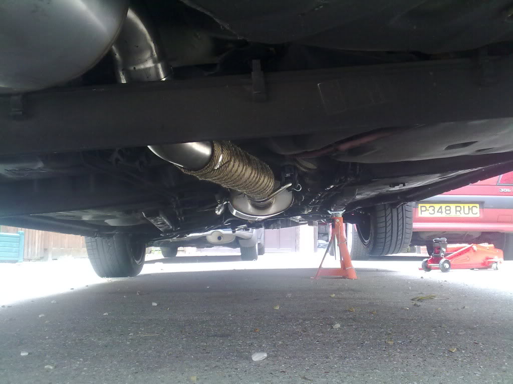

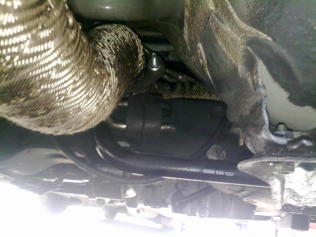

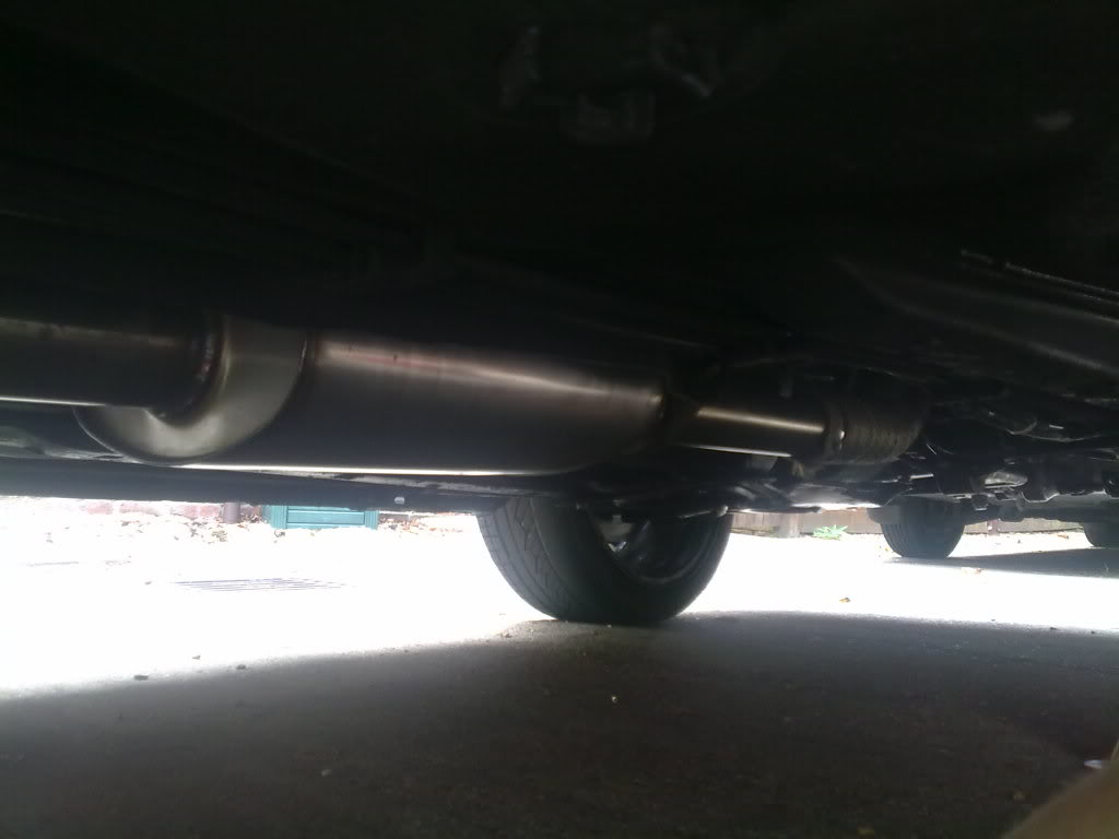

Jacked her up and took a few pics of the exhaust, im so chuffed with it. Had the downpipe wrapped which protects the brake lines and gear shifters a bit more, and also the part which runs close to the fuel tank just to be on the safe side...
Added an extra mount for the down pipe plus a flange so if i have problems in the future its easily detachable
this is where the downpipe joins the flexy pipe right after the turbo..

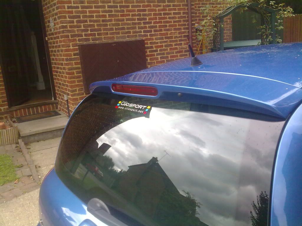

Old CS Sticker
New CS Sticker + stubby ariel

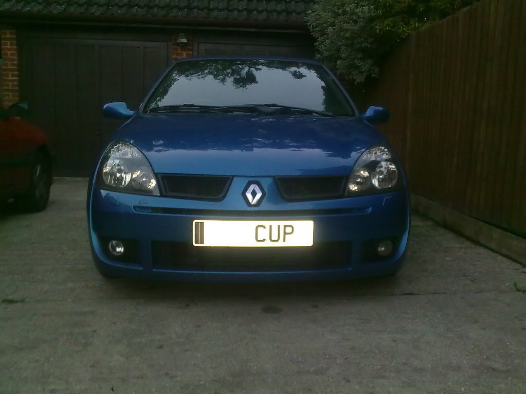

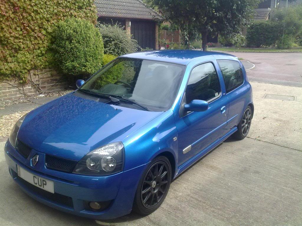

How she looks now, i need to put on the new fog light i have and splitter on but its getting there.. - Off to Norwich at 5am on tuesday morning from Reading. If it survives and doesnt dump her oil all over the rollers then the drive back on tuesday afternoon is going to be nutts!
