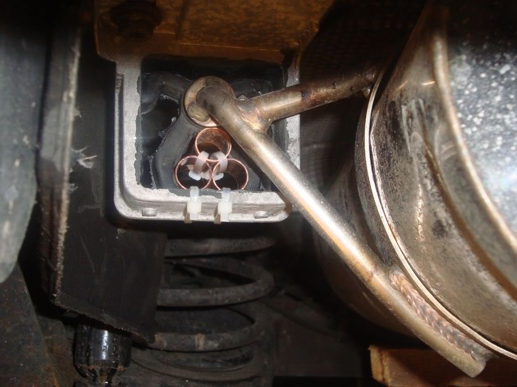

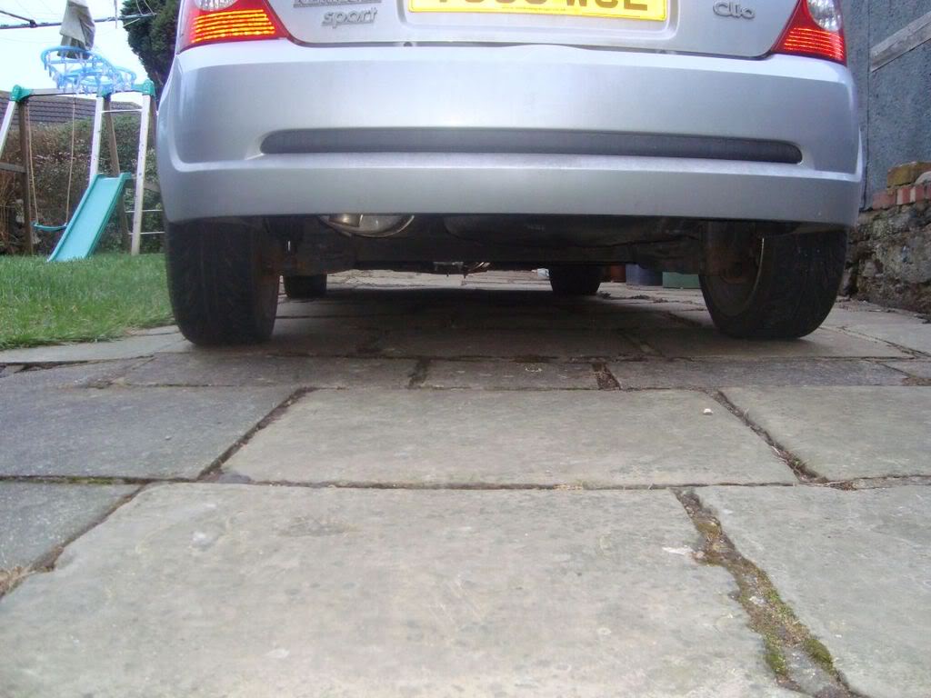

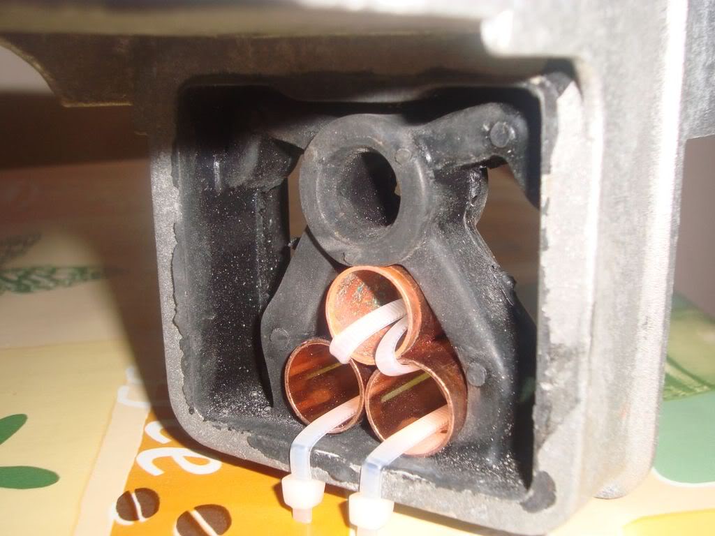

Just thought I'd post up this afternoon's handywork...... Like most, my K-tec Stealth wasn't particularly stealthy once fitted, despite having a new rear mount installed.
I'd seen people on here pack the mount with old sockets, but since I still need all my sockets(!) I bought a pack of 4 copper pipe connectors from B&Q, about 75p and cable-tied them in. Job's a good 'un.
The exhaust isn't quite sitting perfectly yet because the rear box needs twisting round slightly in its clamp but since they used paste between it and the centre section, this isn't a five minute job. Anyway:
Mount off, three bits of copper tied in:
Back in situ:
Stealthier stealth:
I appreciate the idea and it sits a lot better, but surely the mount is made of rubber for a reason? Isn't effectively removing all elasticity going to cause problems?

Lol, okay cheese. But, generally, exhausts must be made from a flexible material for a reason?
Not saying it'll affect it in a few months, but further down the line? Vibrations with no damping affecting the structure of the exhaust and, therefore, manifold, etc?
I agree there must be a reason why the mount is designed this way to allow movement. Preventing this may cause problems.
There is still some movement, particularly sideways. In any case, before I replaced the exhaust the old rear mount was completely shagged as they all usually are after about 10 mins of being on the car, and then the exhaust just sits on the metal bracket with no suspension on it at all.
I think the main problem with the mounts is that there is too much movement built in to them, so lots of bouncing around quickly destroys the rubber part since the back box (even the standard one) is quite heavy. We'll see.
@ dinneh - I haven't got a sound clip and I'm not sure you'd gain much from one. It has a nice deep burble at idle, and then is slightly noisier than standard when you give it the beans. Nice edge to it but still civilised. Same on the motorway.
