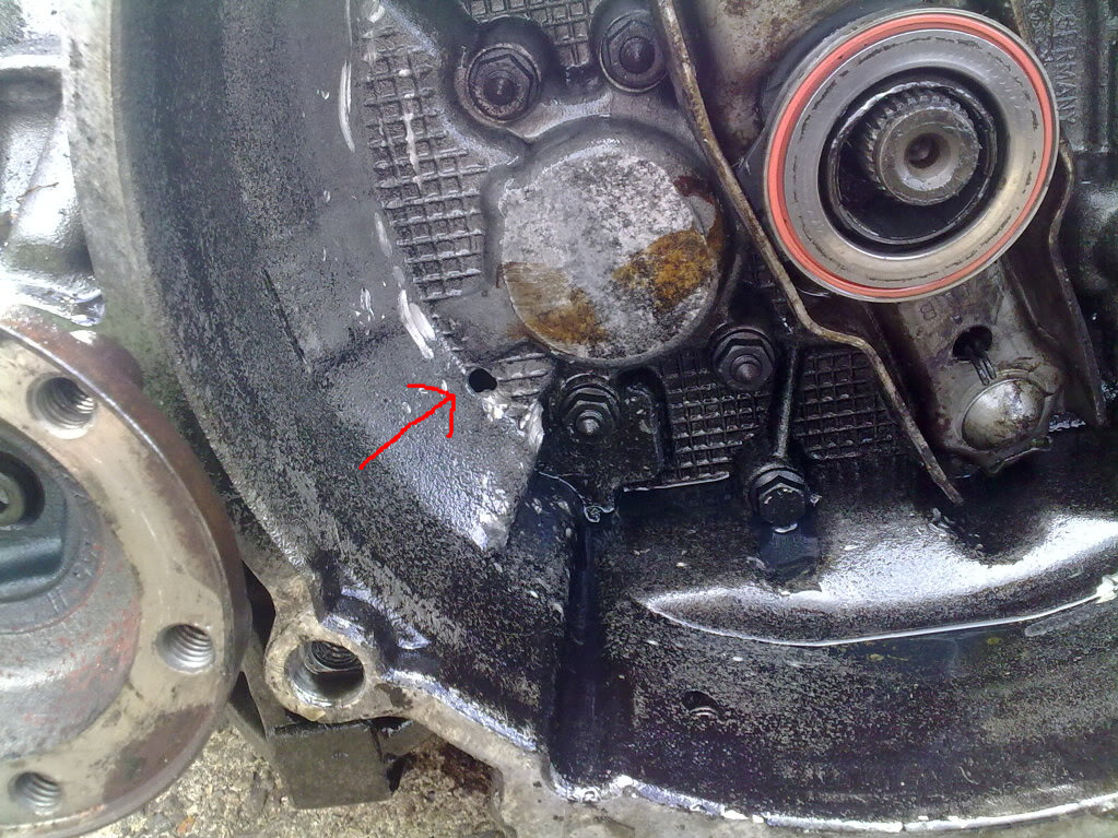

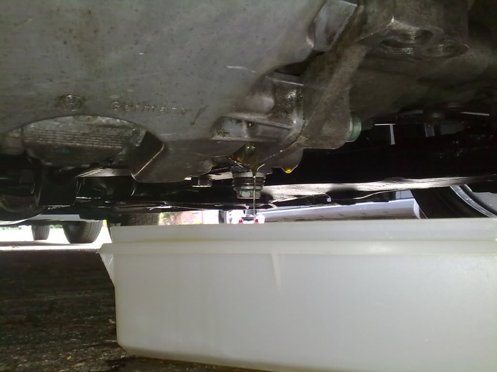

Realised from the rolling road sesh that i had 2 oil leaks.... 1 seemed fine and a case of the dipstick being mullered and oil being spat out of it.. sorted this by buying a new plastic dipstick housing and installing that... I thought the 2nd leak was todo with the gearbox.. For the last few miles of the last time i drove her it would jump out of 5th every so often, and then start to be difficult to put into gear.. typical examples of gearbox dying.... Combine this to the slight oil leak when being mapped i think ive a big problem with the gearbox..
Wanted to source the leak AND see how much (if any) oil is left in the box so bought 2 litres of good gearbox oil jacked her up, undid the filler, then undid the dump and suprise suprise only about a cup full of oil came out, probably just over half a litre!.. realise that i defo have a leak, and that its not an engine problem which i suppose is the better of 2 evils..
Filled her up with a litre to source where the leak is coming from, and it seems to be where the gearbox mates to the engine...i think - so took a piccy, would someone just confirm?.. possibly a gasket or something gone?.. but it was pouring and not dripping.. took a few mins for the oil to come out.

I am pretty sure there shouldn't be any oil coming out from/anywhere near where the engine and gearbox join! :S
  172 cup TT
Re: Clio TT (172 cup)
hehe you dont say! :)...
im thinking its the seal on the input shaft(but would it leak THAT bad if its that?), or worse the final drive rivets failed or rollpin... either way its gearbox off jobbie... FLAN!!!!, that spare o2j you were talking about? :)
Flan: After a whole day of research im pretty clued up on the damn things now mate - but was told this from people on the VAG forums dude plus the following :
"You should be able to work out where the oil is coming from fairly easily, the clutch should be ok... i had a hole in my gearbox casing recently which dumped oil all over the clutch, i cleaned it down with some solvent cleaner (or brake cleaner) and altho it slipped for the first 100ish miles it's been fine ever since, i've also been told washing up liquid and water mixed is good for cleaning oil from clutches.
Unfortunately there is a couple of common faults with the Diff on O2J box's that often cause punctured casings, first is the final drive gear rivets failing (these can be replaced with ARP bolts), and the other is the roll pin which holds the Cross Shaft which the spider gears run on in place shears, causing the cross shaft to be able to move... puncturing the box... (spider gears and cross shafts can also fail, but not that common on the variant of the o2j fitted to most 1.8T engines, which have better quality diff gears and a thicker cross shaft).
Best thing is to get the box off and investigate."

sod it if the casing is blown just drive it to mine... the box is fooked anyways.. lol
but check where its coming from first...allthough either way its engine out n box off (what a fookin mission)
you need to get the propper vw gearbox oil when we fill it back up! and you could do with a new pair of renault wheel hub nuts (your ment to replace them when u remove them)
there is n inspection plate near the flywheel.... see if you can find where the "fail" is.

Ha - do you think the casing is definately gone then mate? - The oil is coming exactly from that bit in the pic, cant see any holes in the casing anywhere if that helps.
tbh i dont think it would get to yours, 65mile away and it would probably chuck that oil out in tops of 25 mins... hmm

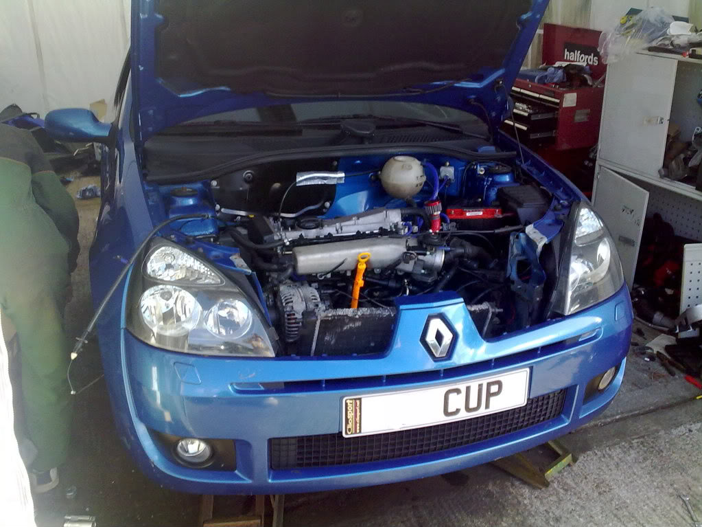

Managed to get the car to Flans with a dead gearbox, stopping a few times on the M25 filling up the box as we go.. just about got there when something went just yards from his.. ! lucky.
Started at about 9am and after a little while she was ready to take the engine and box out (looking in a sorry state!) :
After the box was taken off the engine the problem soon became obvious.... A bolt had sheared and punctured a hole :
Replaced with a new 02j box and got everything back in by 6ish.. bloody good going, Flan dont mess around, legend :)

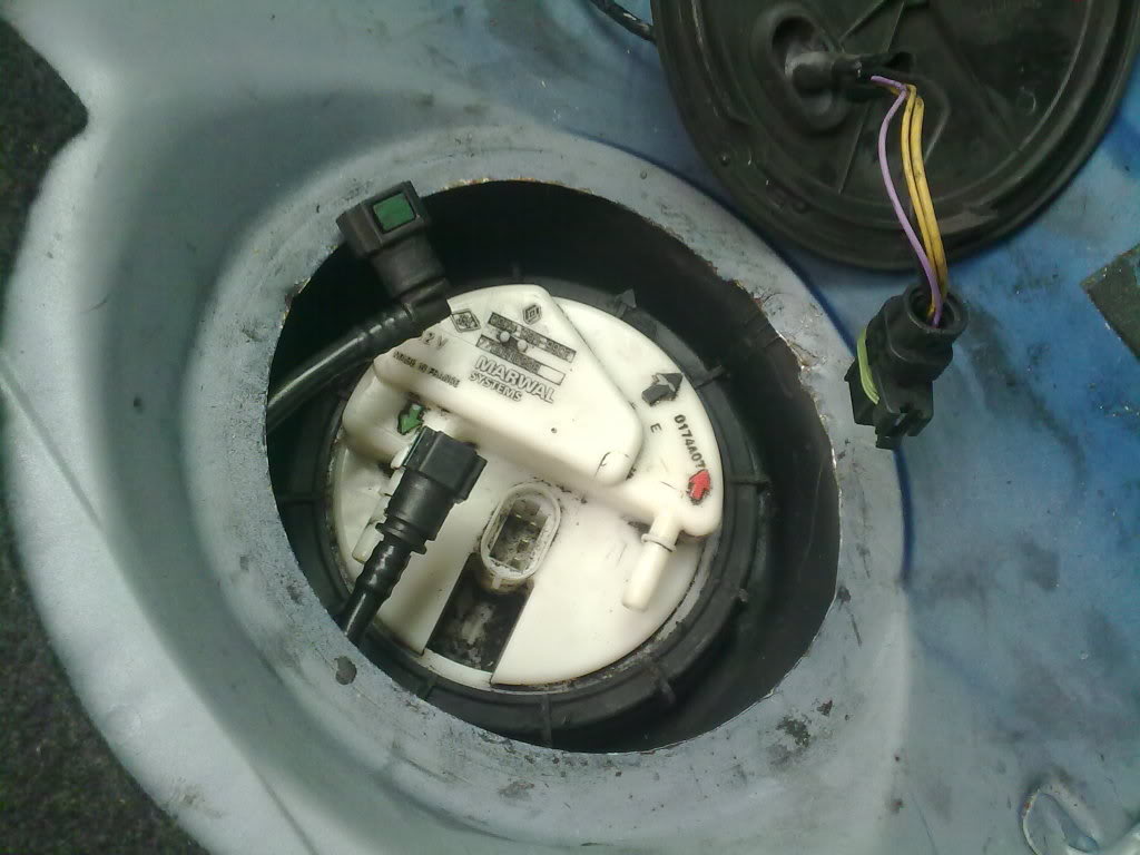

Then it was time to work on the juddering problem that i had which couldve been many things.. but after advice from many people on here (thanks!) we started work on replacing the "weak" clio 172 fuel pump and installing the new Walbro fuel pump which is apparently good for over 400 brake so thats me future proofed i guess :
Fired her up, and perfect!!... no problems at all!! no juddering... the fuel pump WAS the problem.....what a drive home!.. amazing (even though it was only low boost and 240 brake).

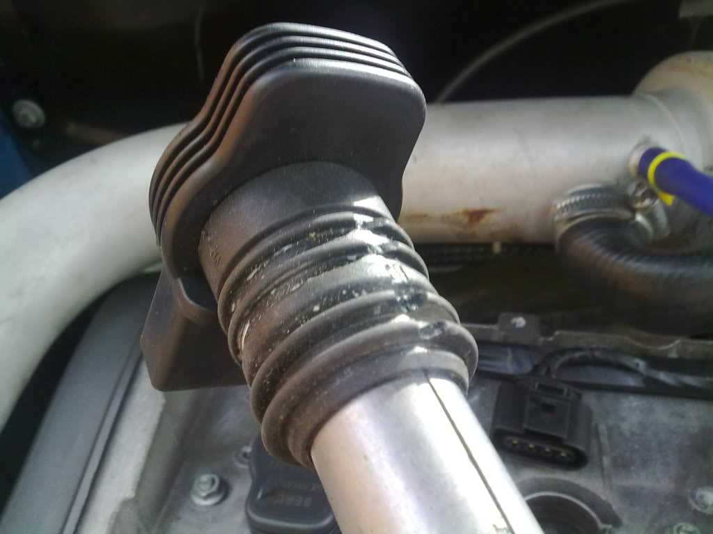

After driving for a few minutes though would hear just a single "pop" from the engine bay... Looked under the bonnet and coil pack 2 kept popping up!... wierd. Seems to be a common problem, and due to a build up of gasses/pressure/what ever... After talking to Bill @ Badger 5 he suggested the way to fix it was to cut notches all the way up the coil pack to allow the gas to release - which i did, and hey presto it worked fine :

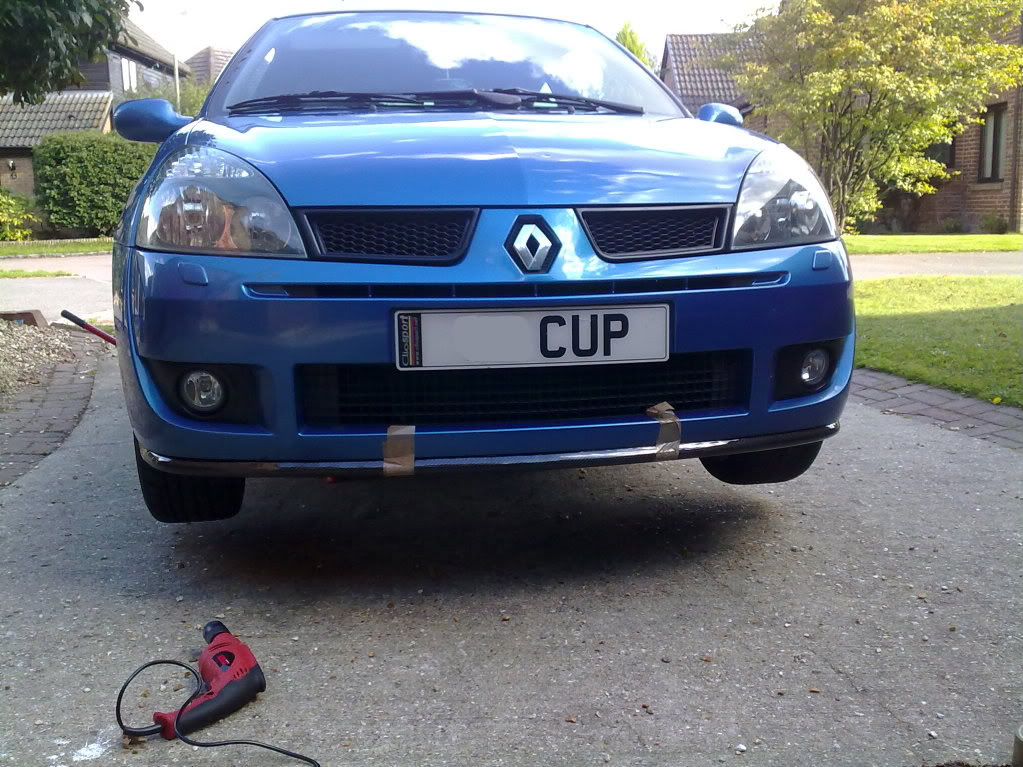

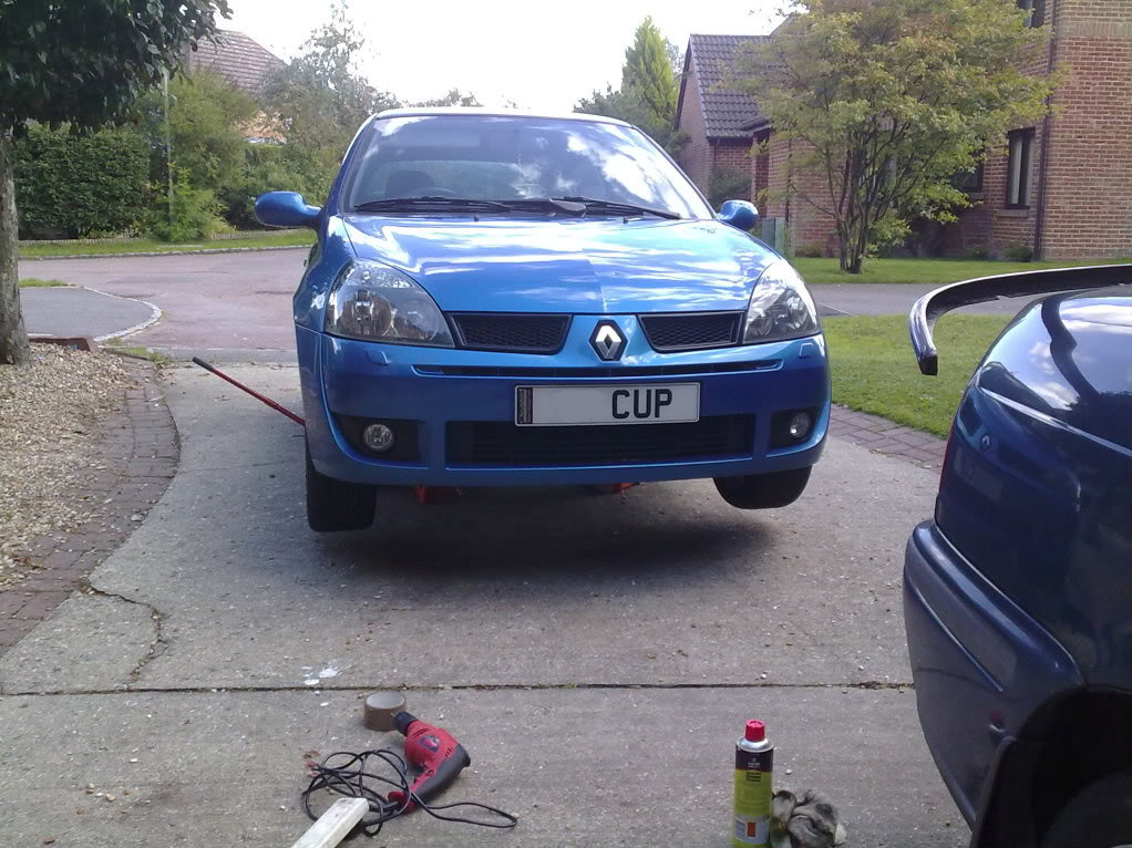

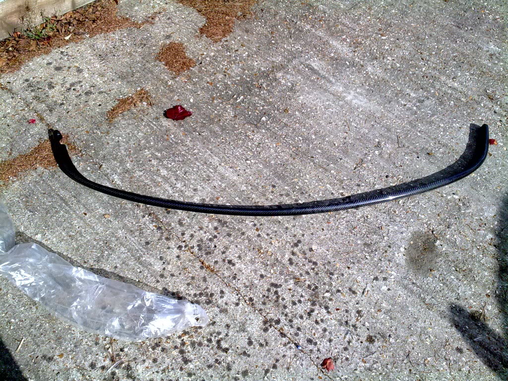

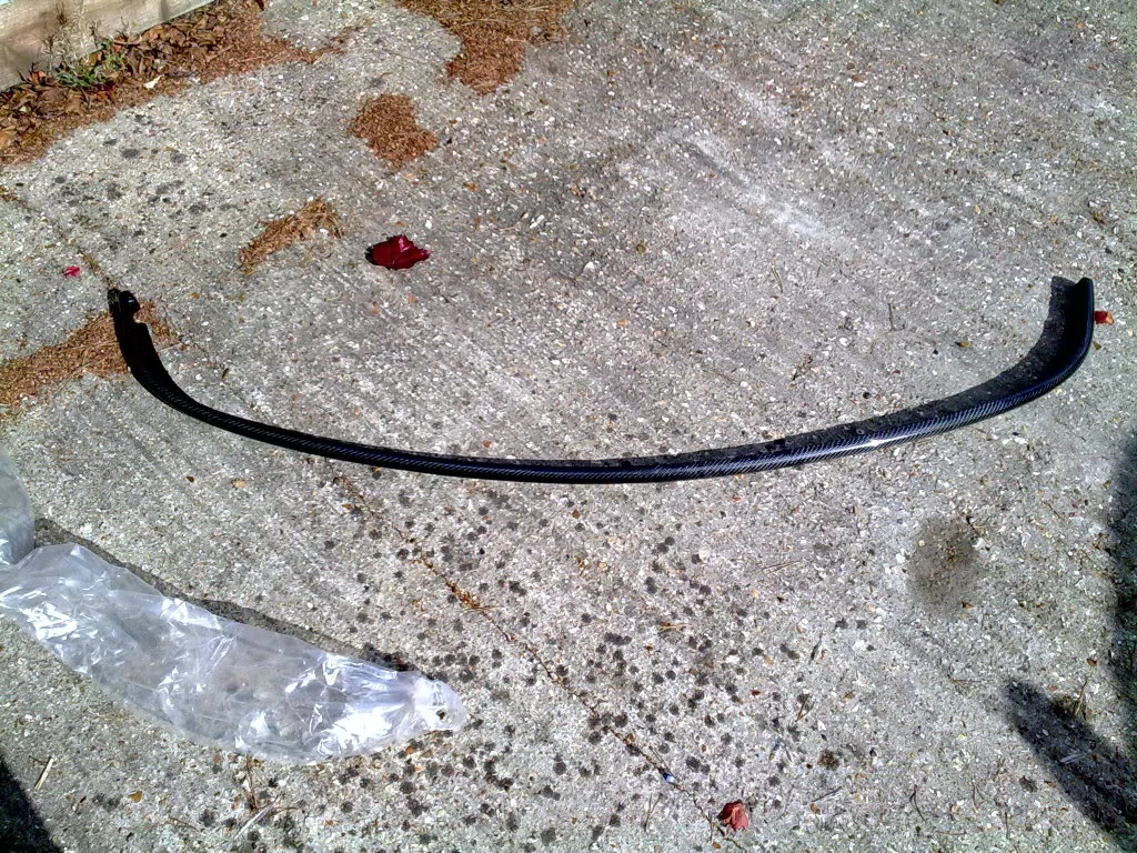

After this it was time to FINALLY fit the carbon splitter that i bought years ago!!..
And finally an almost finished picture - still a few bits to do but its ALMOST there!!.... FINALLY!
