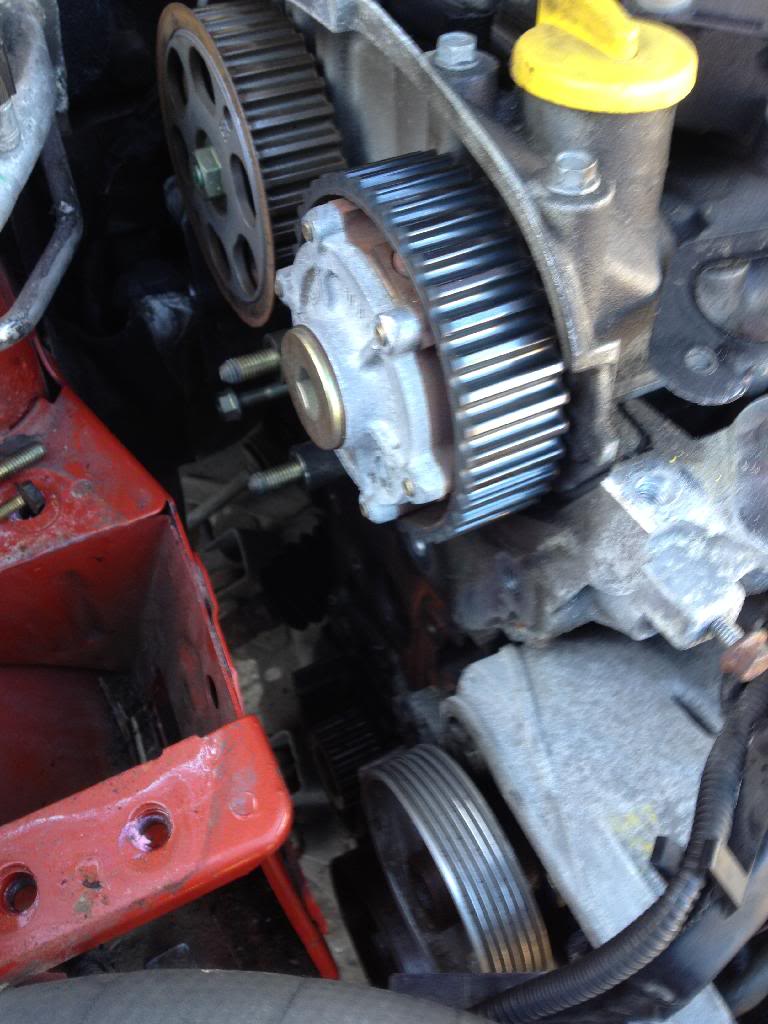

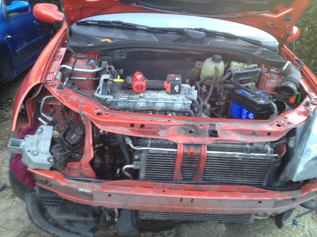

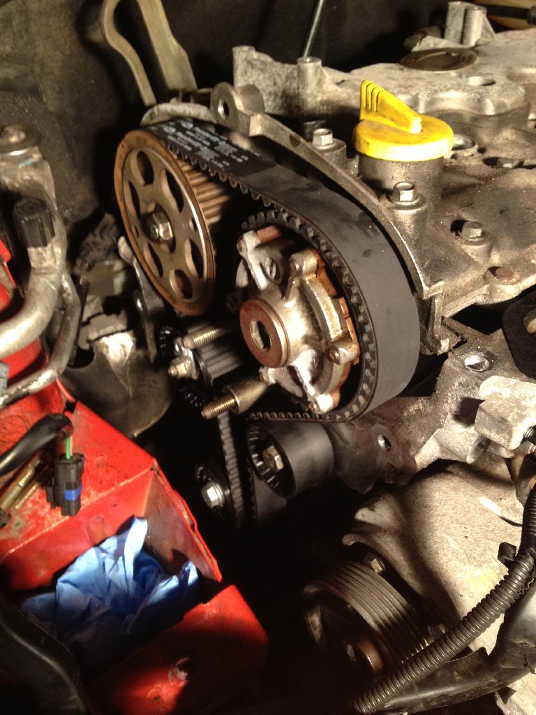

About two weeks ago, I stripped the front end of the inferno to do the PAS pump, Alternator, Aux belt kit and Cambelt kit. I ran out of time that day to finish the job, but I then had no time/decent weather to carry on, so first pics are a couple of weeks old.
Got all the front end stripped.

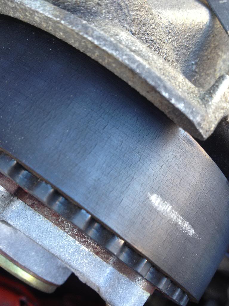

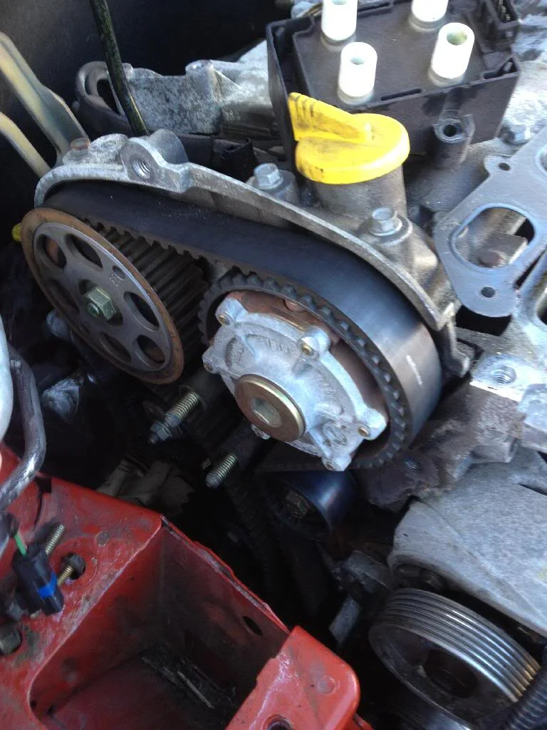

Old belt
Belt etc off

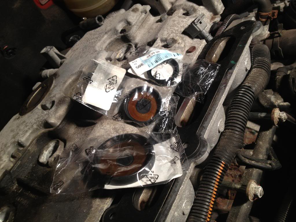

New cam caps, new dephaser seal (just slighty weeping, but while I'm there etc!)

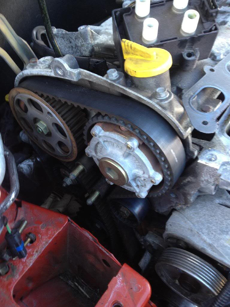

New belt kit on, timed up with the proper renault tools etc.

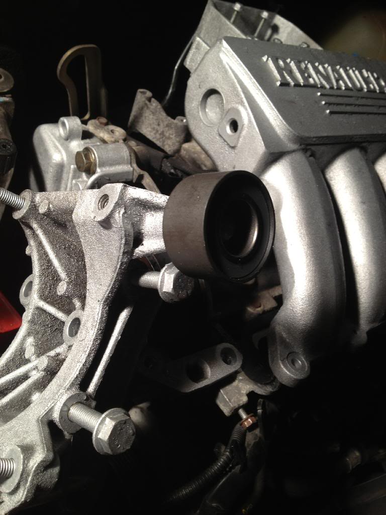

And just before I called it a night (at 7pm) I fitted a new ilder for the aux belt, love how easy it is with the bracket off.

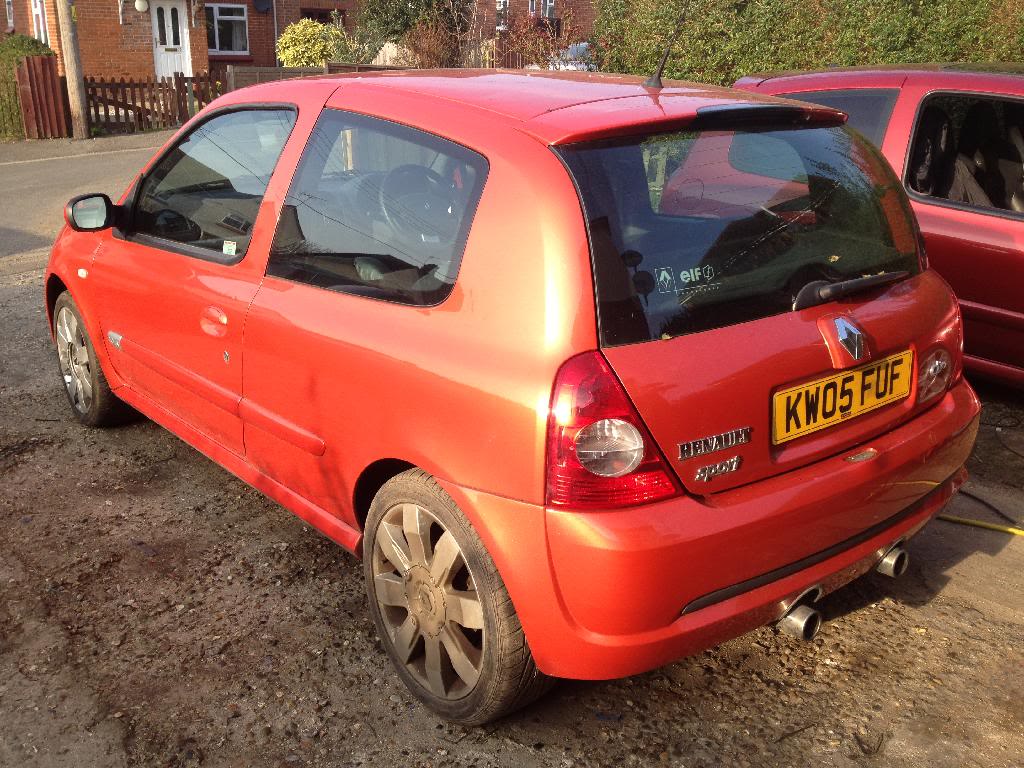

But this morning, I added another one to the fleet lol.

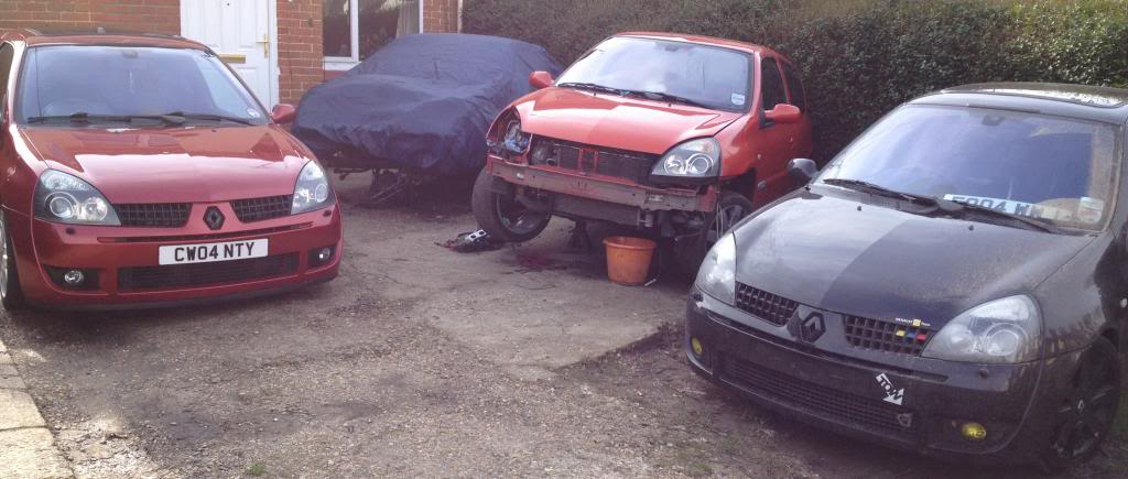

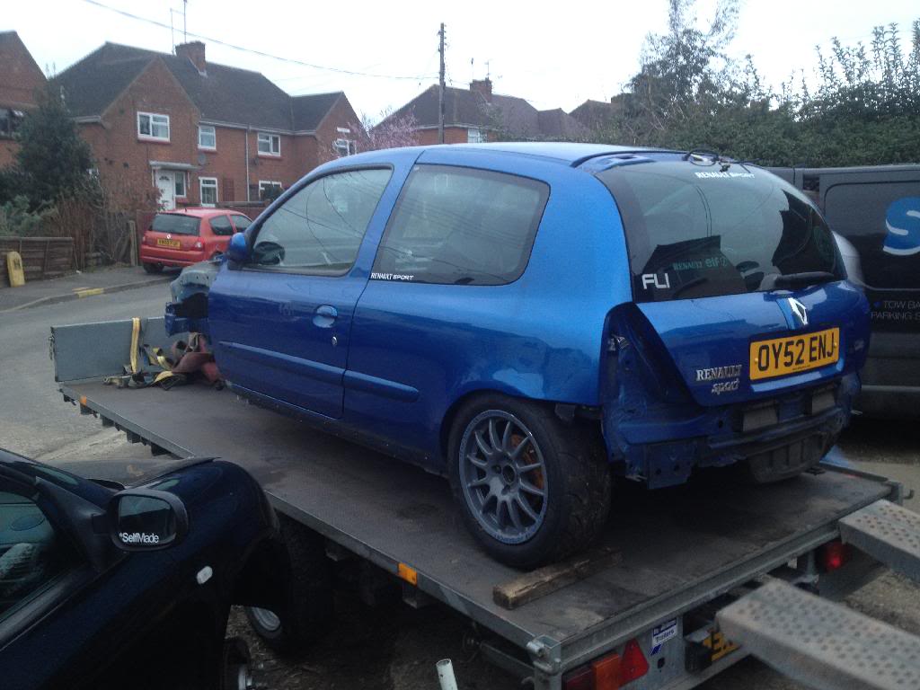

meekings14's old DCi. Its most likely requiring a new engine, as its flood damaged, but we'll see, already compression tested it, completely nothing lol.
It got a bit dirty on the way home....
Not the worst driveway in the world.
Plenty to do this weekend!

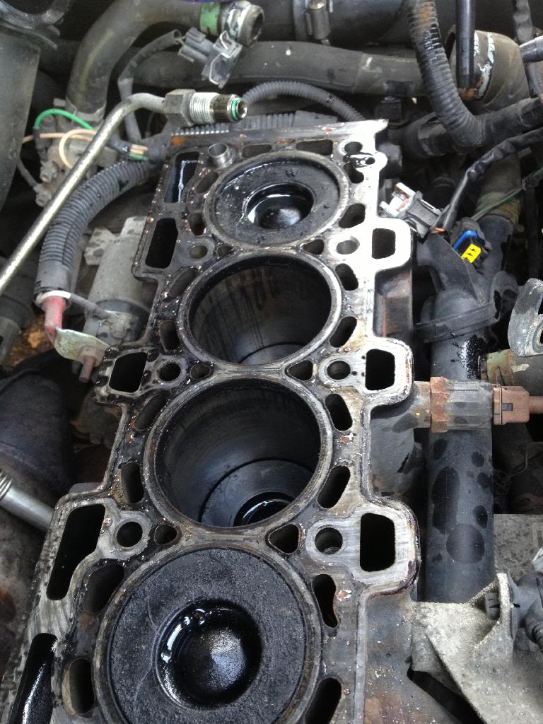

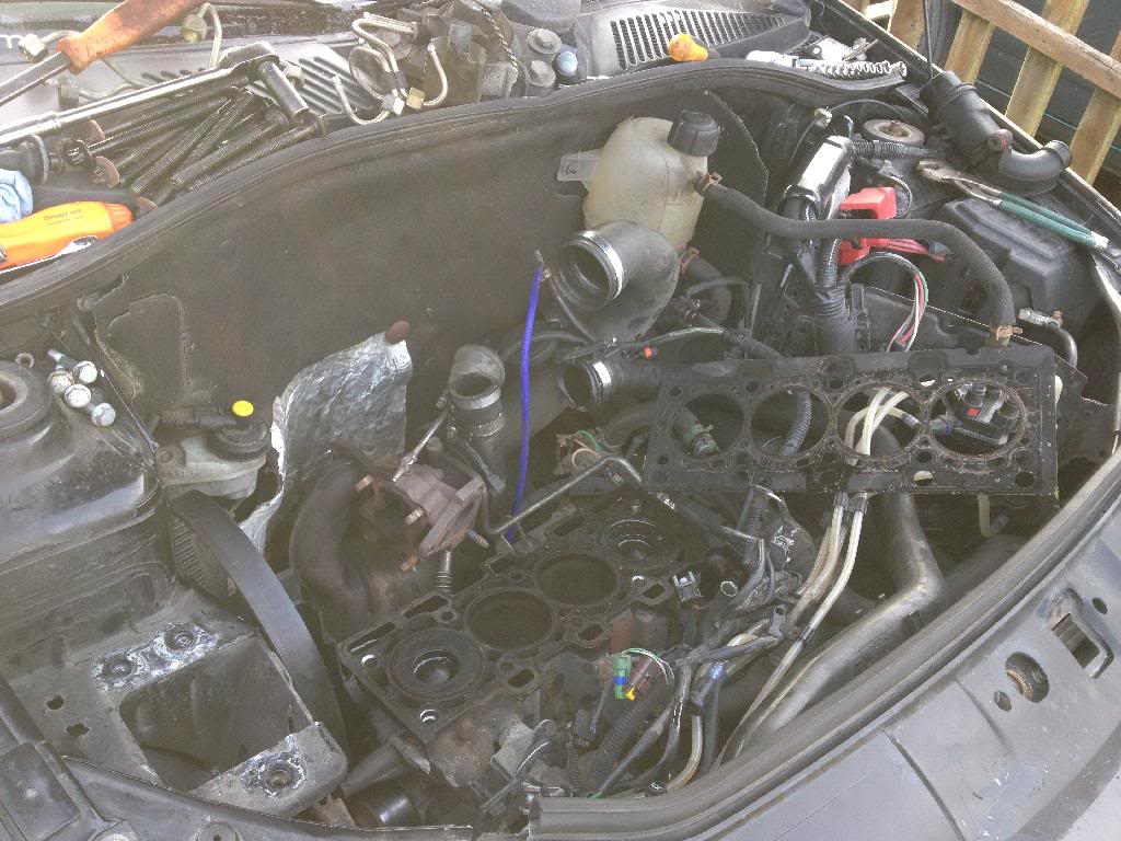

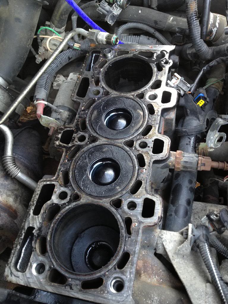

But, half way through stripping it I found the timing to be about 120degrees out, suggesting the crank pulley has slipped, or the belt itself, impossible to know though.
Eventually got the head off, no damaged valves at all (lucky!).....
2 & 3 pistons are fine...
However, 1 & 4... Number 1 has a bent conrod, causing the piston to sit lower. If it hadn't been for the timing, it would have probs kept running, although poorly.
Can just about see the far piston is slightly lower.

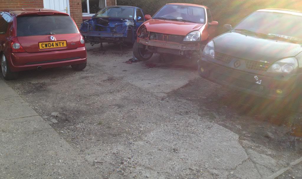

Another car in bits on my drive!
Will price up my options and figure it out, either rebuild, replacement bottom end, or replacement full engine.
Til next time.

That dci looks good reminds me to much of mine ;) if the rest of the engine is ok , and the water has not screwed the injectors , I would go with putting one rod in it ,May even have some kicking about at work if needed lol
Got some old 80 rods if you need any Alex
dont think they're bent, still in my old bottom end so will check the piston reaches the top and no bearing damage
Yeah I need to get it stripped further, injectors appear okay so thats a start. Will hopefully get it sorted ASAP.
Will check this lot out first, just need to check it hasn't damaged the crank at all, will pull the engine out when I get chance.

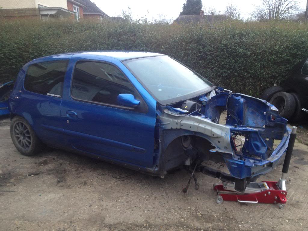

Waved goodbye to the cup Today..

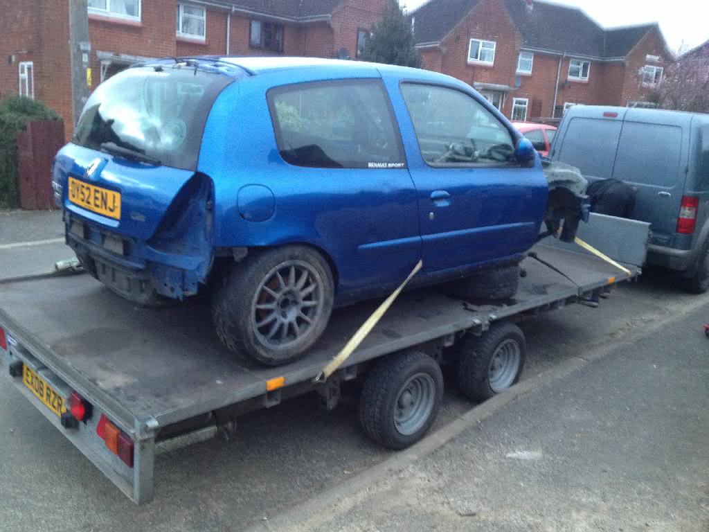

And as some of you may have noticed, I got the Inferno running, right before the lads turned up to collect the shell, won't be the last CS sees of the little Cup either.

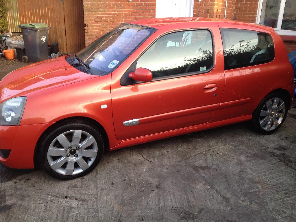

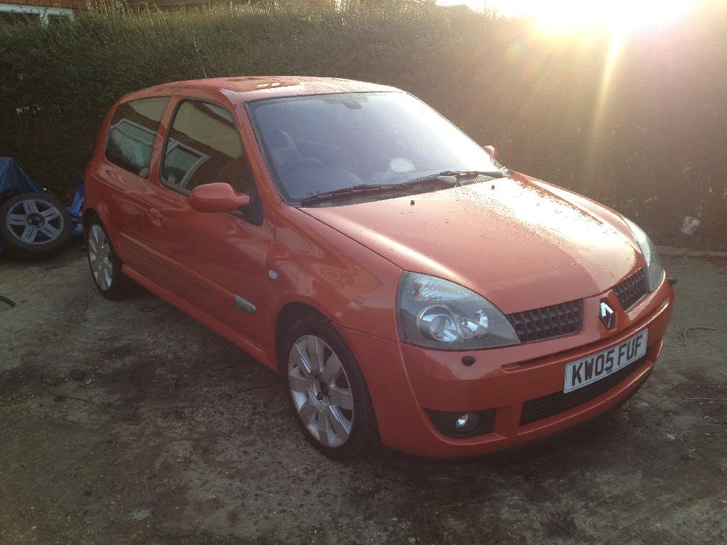

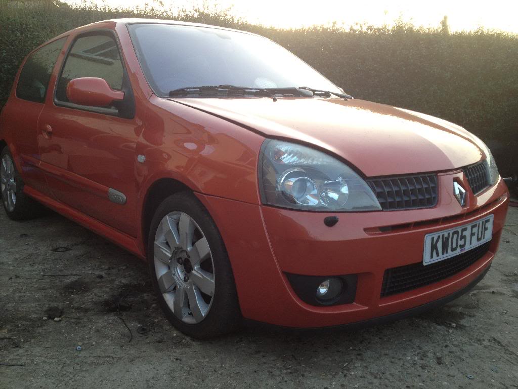

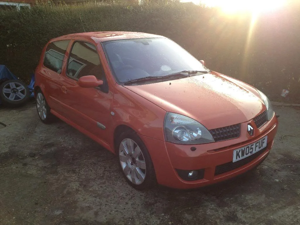

Had a little play with the Inferno this afternoon, Runs sweet, just need to check a few bits. I refitted the headlight, fitted the Skoda front splitter and then refitted the front bumper. I need to put a one way valve in the headlight washer pipework as one leaks. Still a few bits in the engine bay, hence bonnet being open.
So good seeing it back together again, and off axle stands.

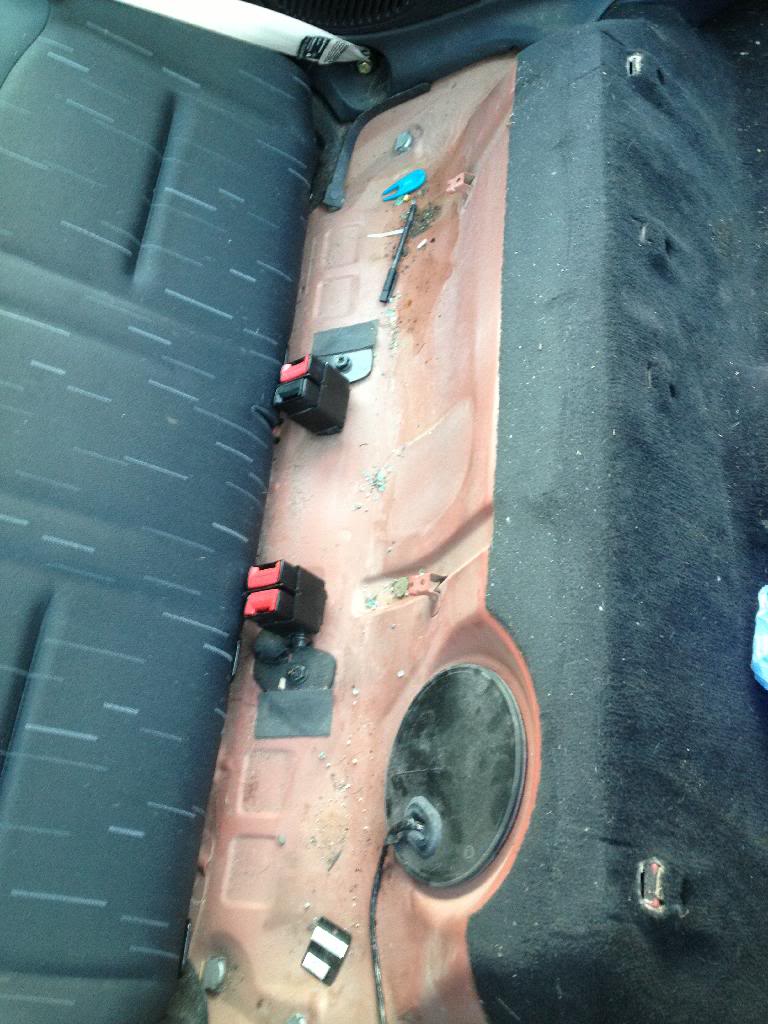

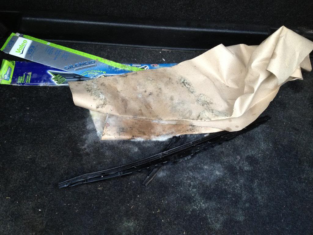

To give you an idea of how bad the inside was when I collected it, I hadn't opened the boot, I found this...

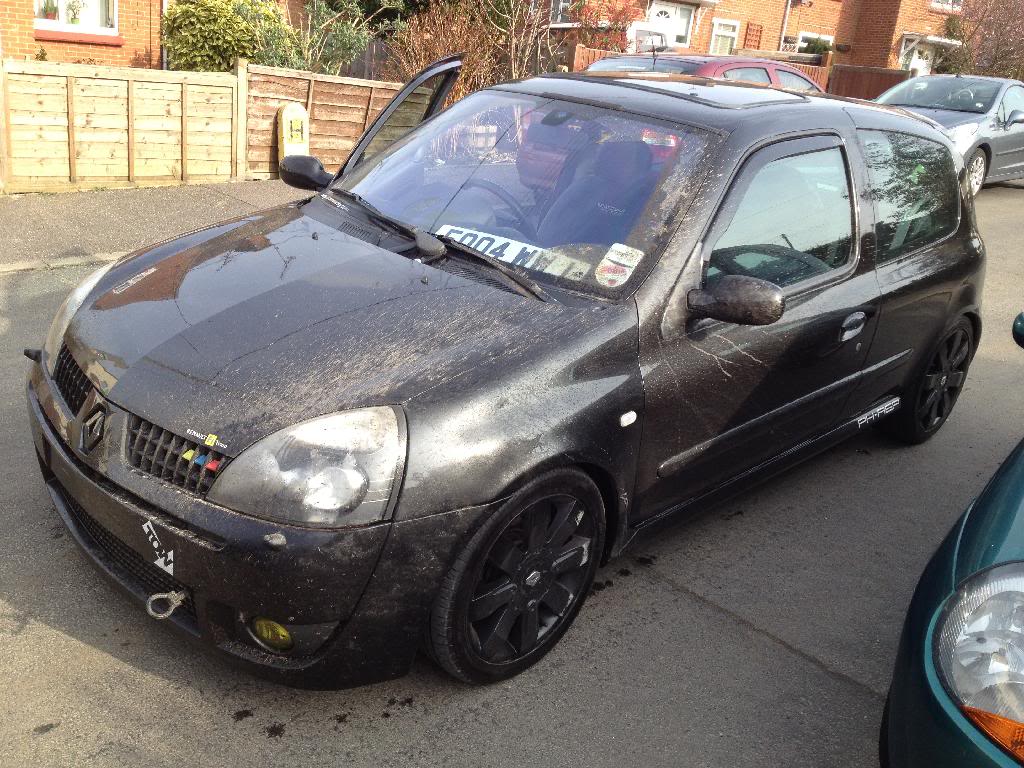

Decided to clean it first, It wasn't as dirty as when we collected it, but its been sat for a while now.
Done, still needs mopping, waxing and wheels doing, as they are dirty as hell, although check the change on the passenger side rear wheel

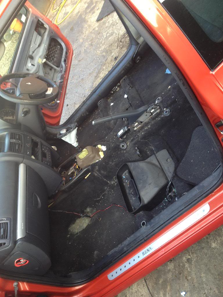

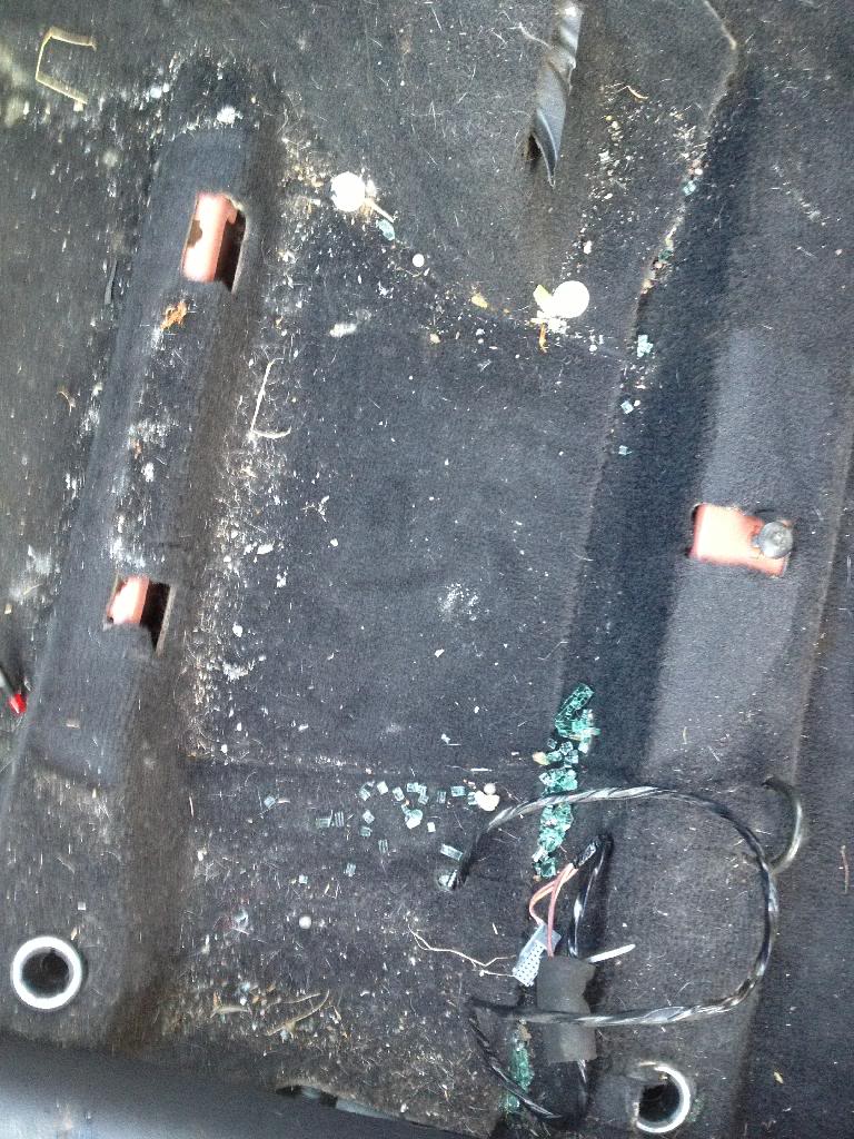

Its minging, inc loads of broken glass, I guess it got broken into at some point.

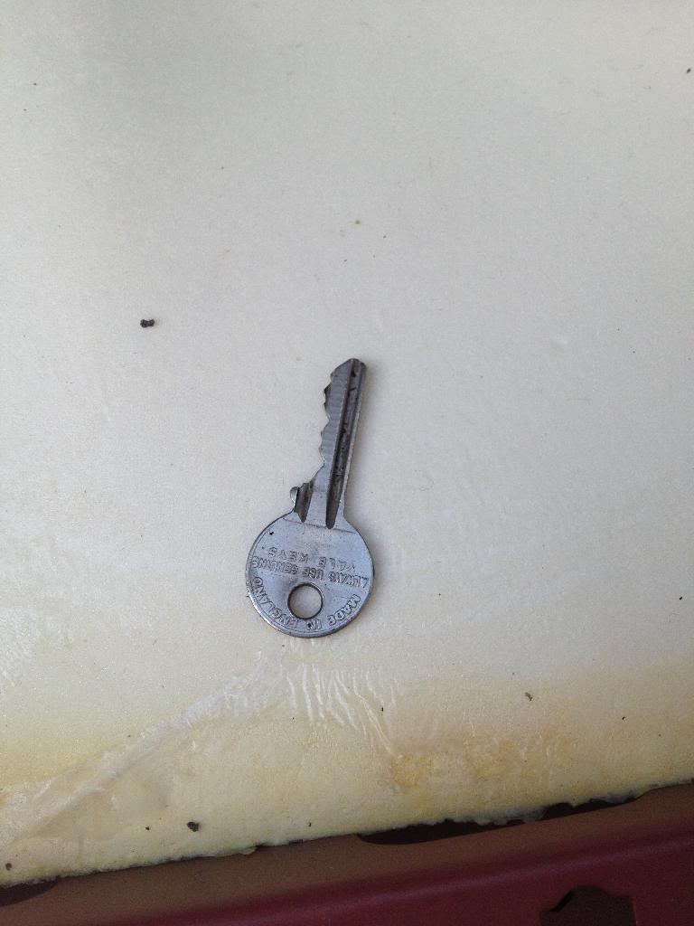

Somebodies missing a house key

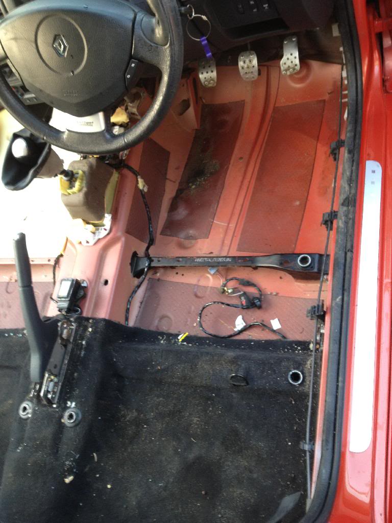

Got the front carpet out, and later, the rear carpet. I'm changing the front carpet as its ripped. All hoovered out now.
