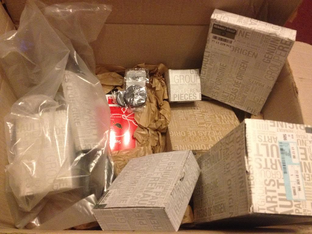

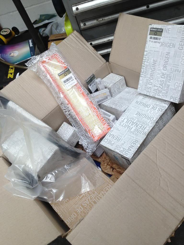

Nice box turned up this morning from Adam @ Renault Wolverhamton. Love these parcels, although they do cost too much and turn up too often.

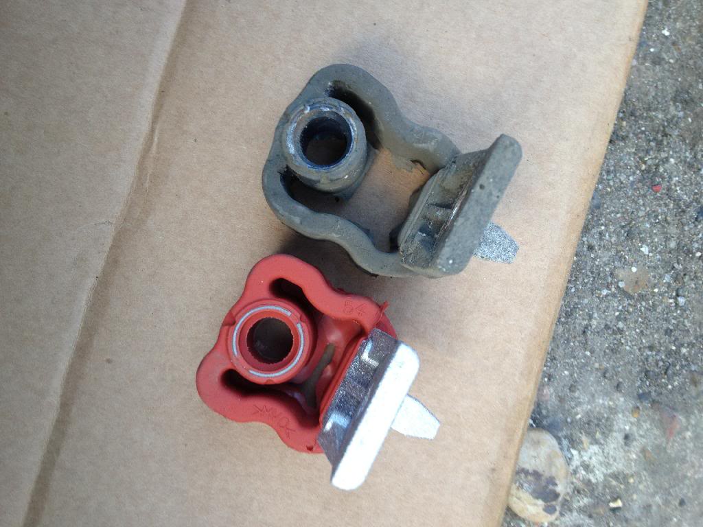

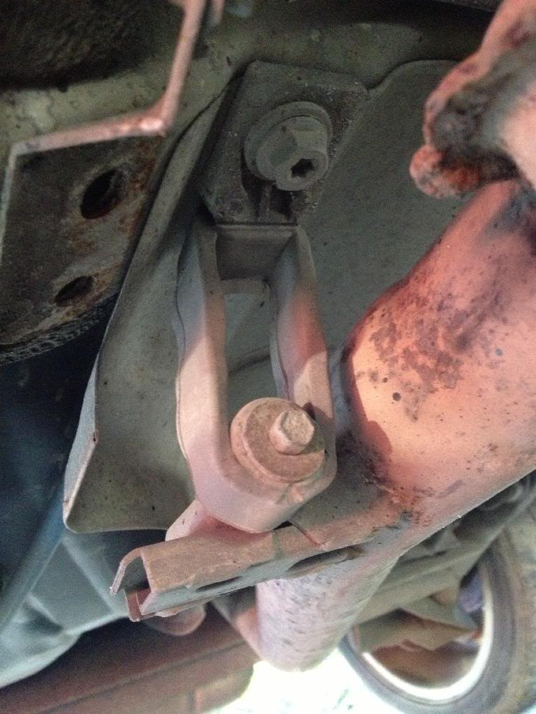

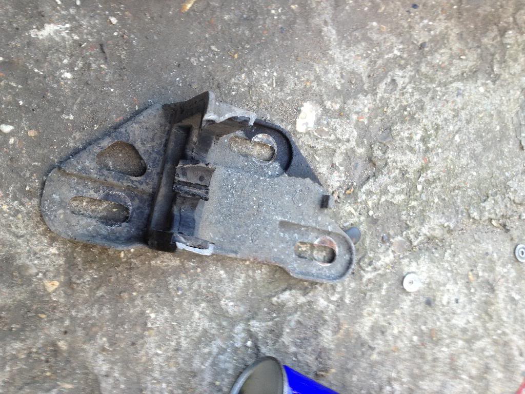

Changed the exhaust mount, reminded me of a couple of girls.
Also changed the rear mounts, one was the worst I've ever seen...
Replaced those with new mounts filled with mastic shiz.

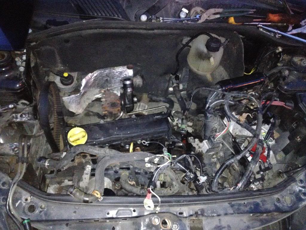

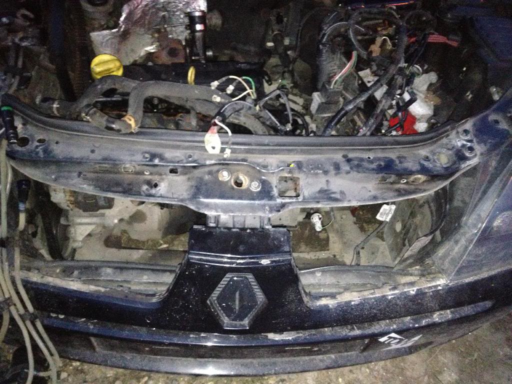

Spent the evening removing some more bits from the DCi...
Such a mess

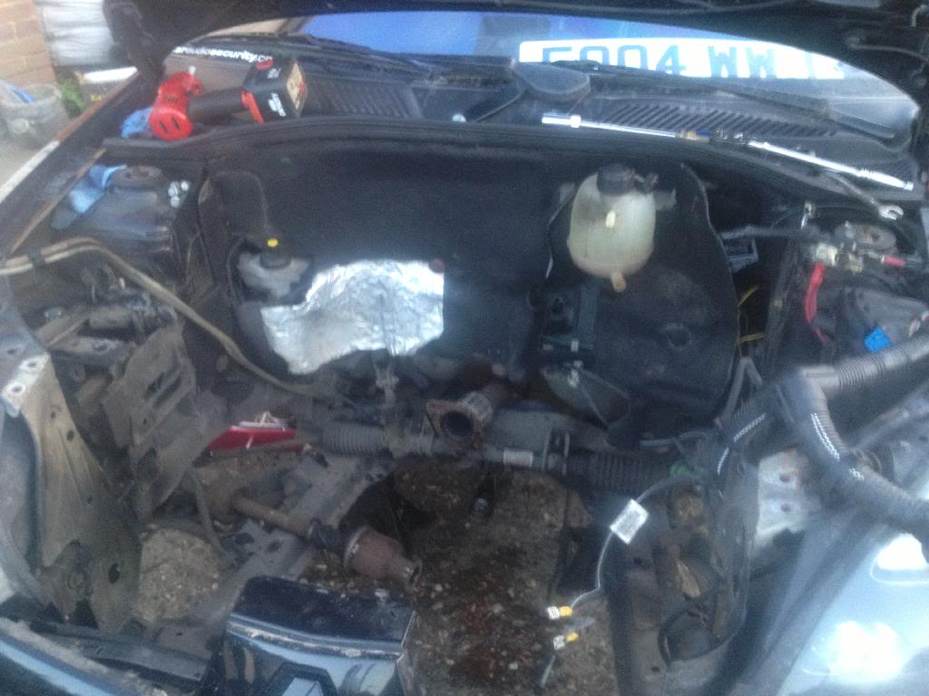

Plan is to remove the engine, check condition of the crank, then go from there.

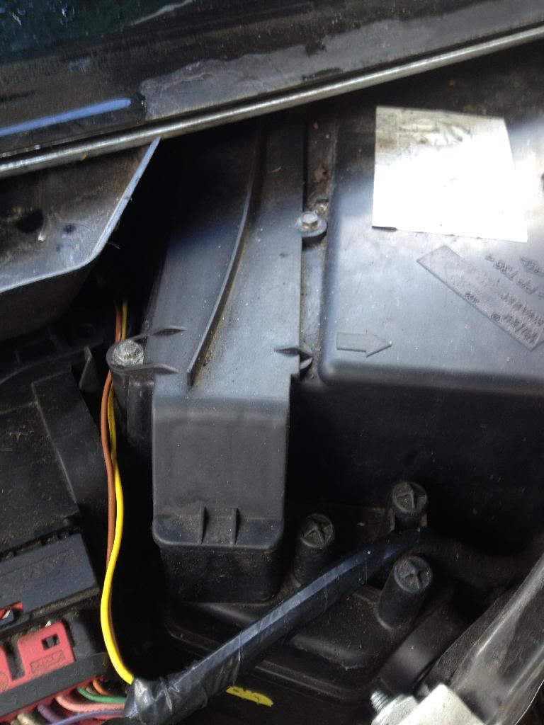

So I need to remove the stupid ECU cover, and the battery box etc, gear linkage, drive shafts and gearbox mounts, then it should come out. I'll be borrowing a engine hoist, as I cba to take the subframe etc off.

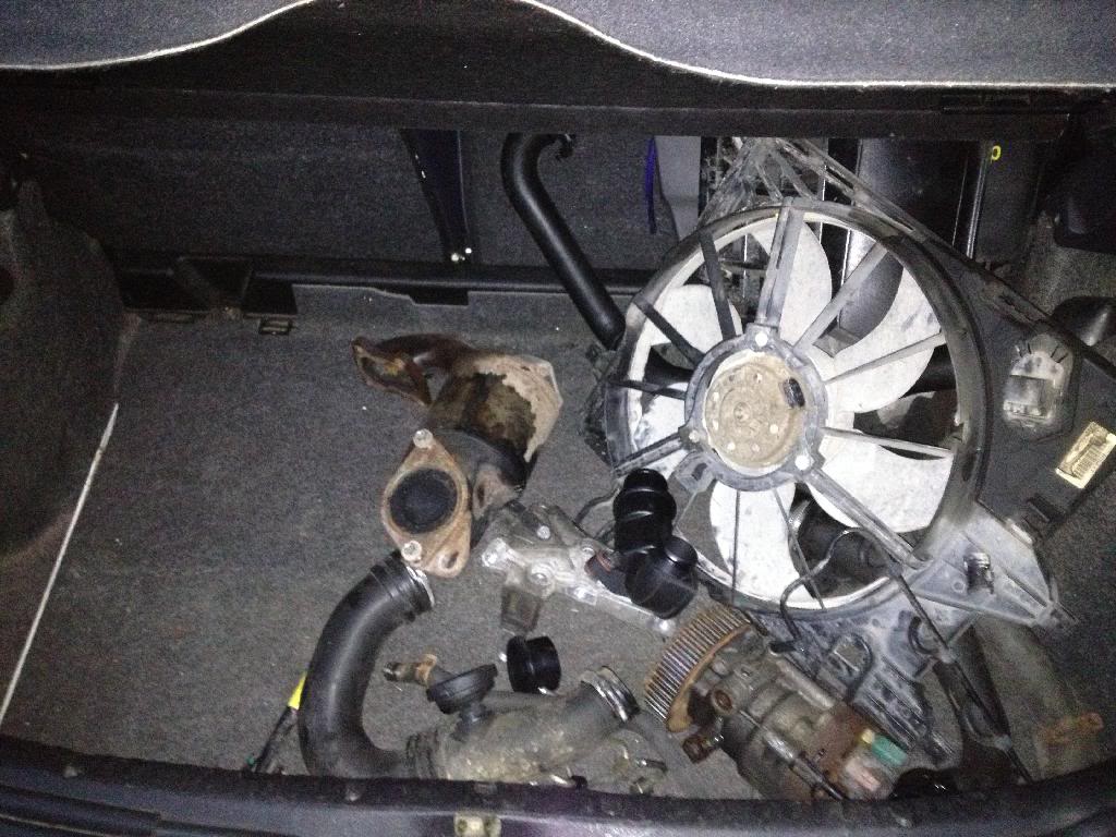

Had a couple of laughs while stripping it, firstly being the rad fan not plugged in, secondly the water in the intercooler, have a video of that which I'll upload later.
Hopefully get it out before the weekend, we'll see.

Great progress ,who the hell deigned that ecu cover that Renault thought was so important ? :mad: causes hours of fun at work then you get another that just falls off lol
  Many.
I know what you mean! Had to cut this one off in the end, couldn't be arsed f**king around with it.

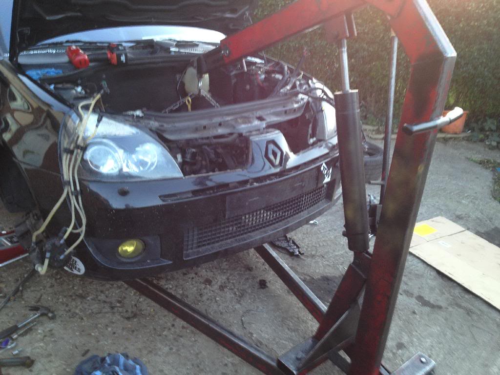

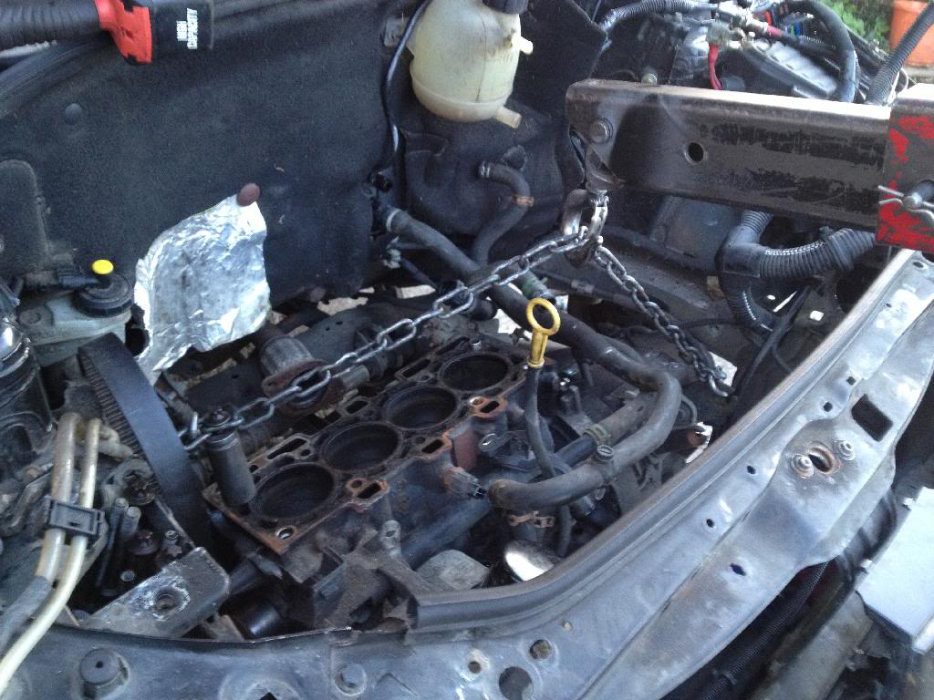

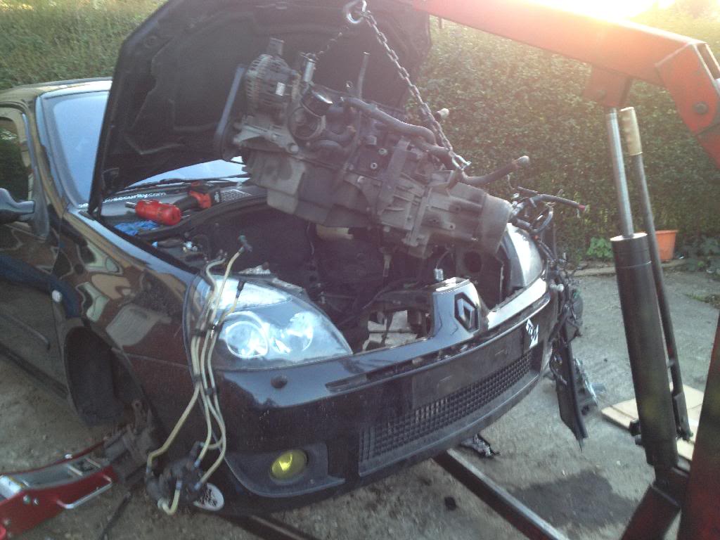

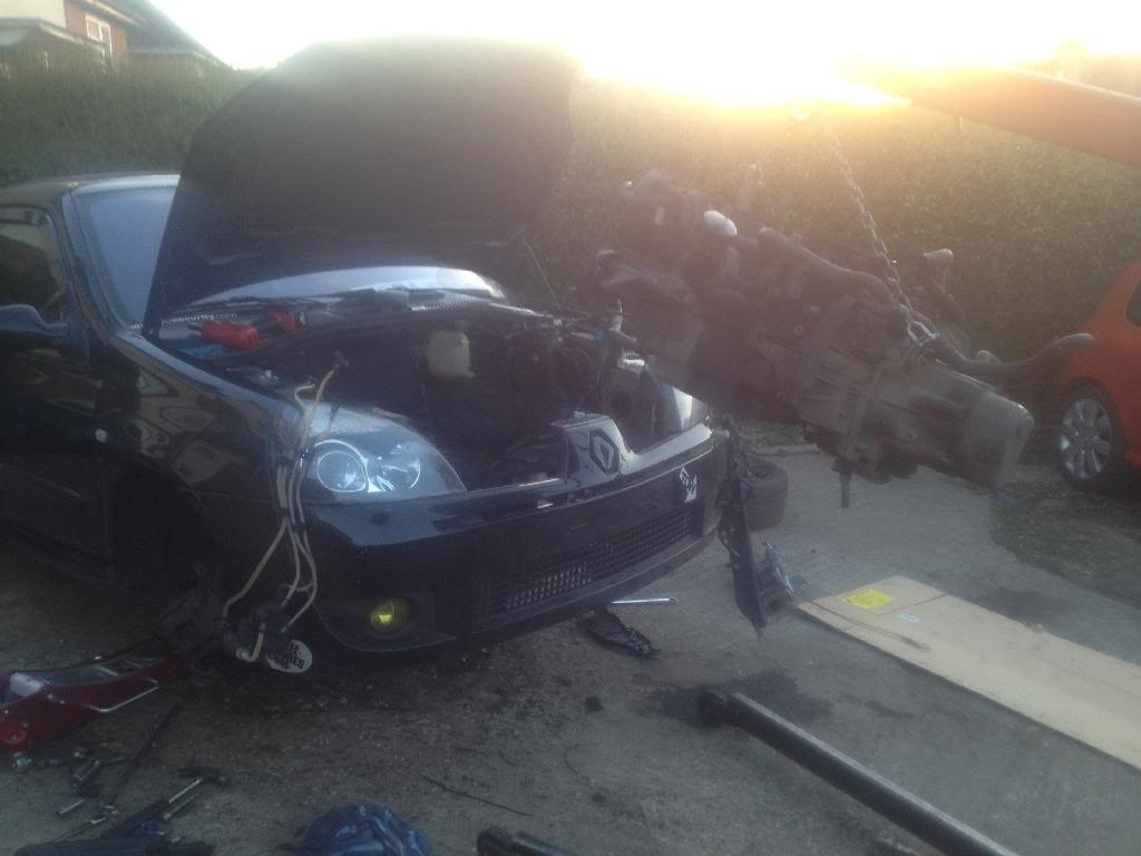

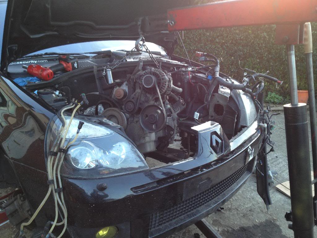

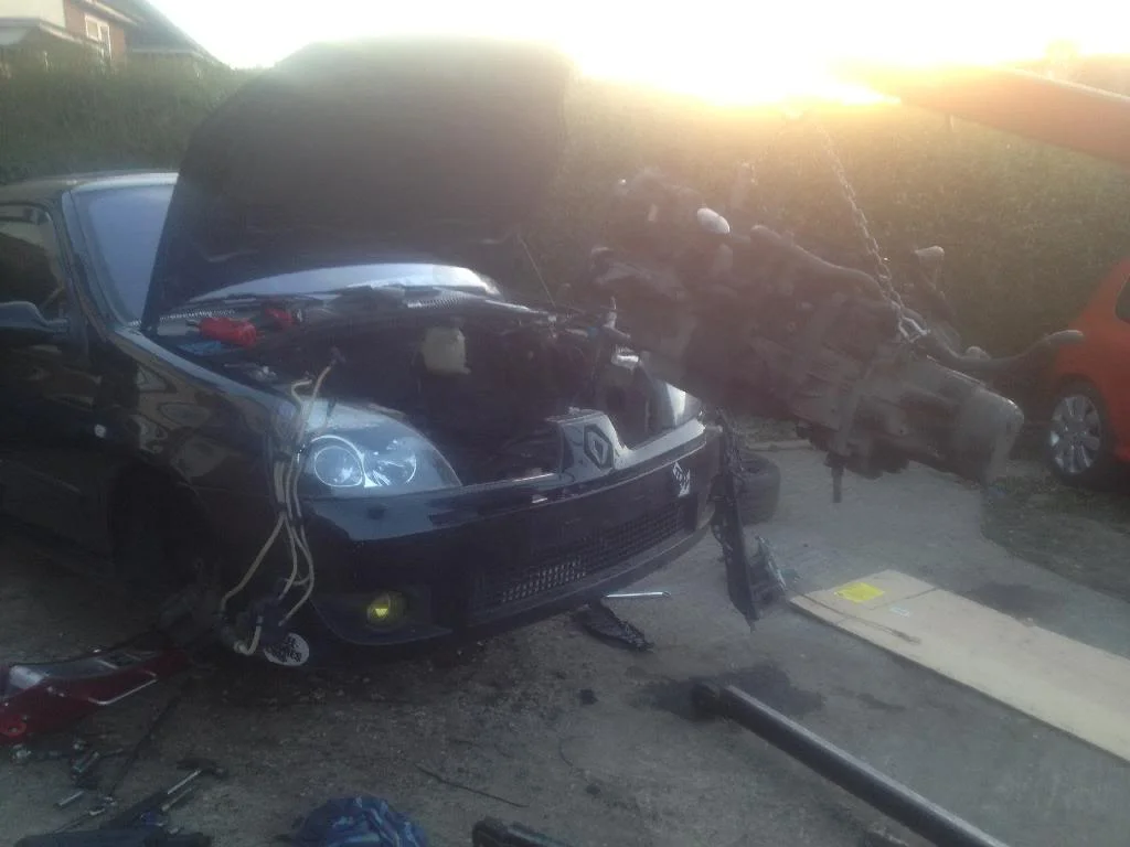

Got the DCi moved yesterday, so have been able to crack on with it, then tonight, borrowed my mates engine hoist...
Hello!
Swinging around
Out!
Empty!
Will get the engine stripped when I can, check condition of the crank etc.

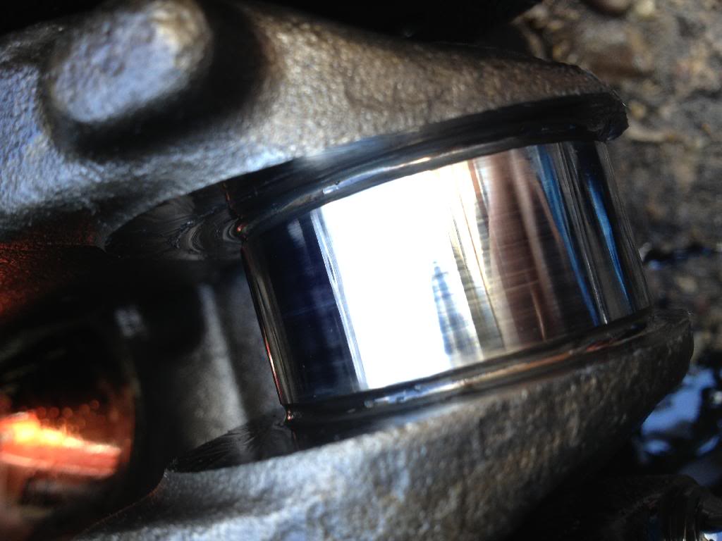

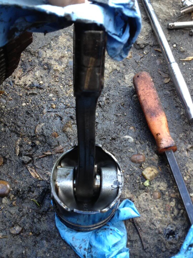

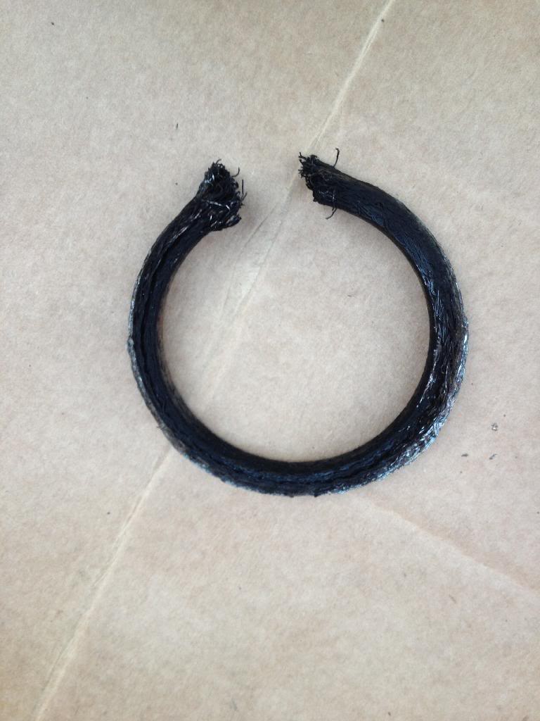

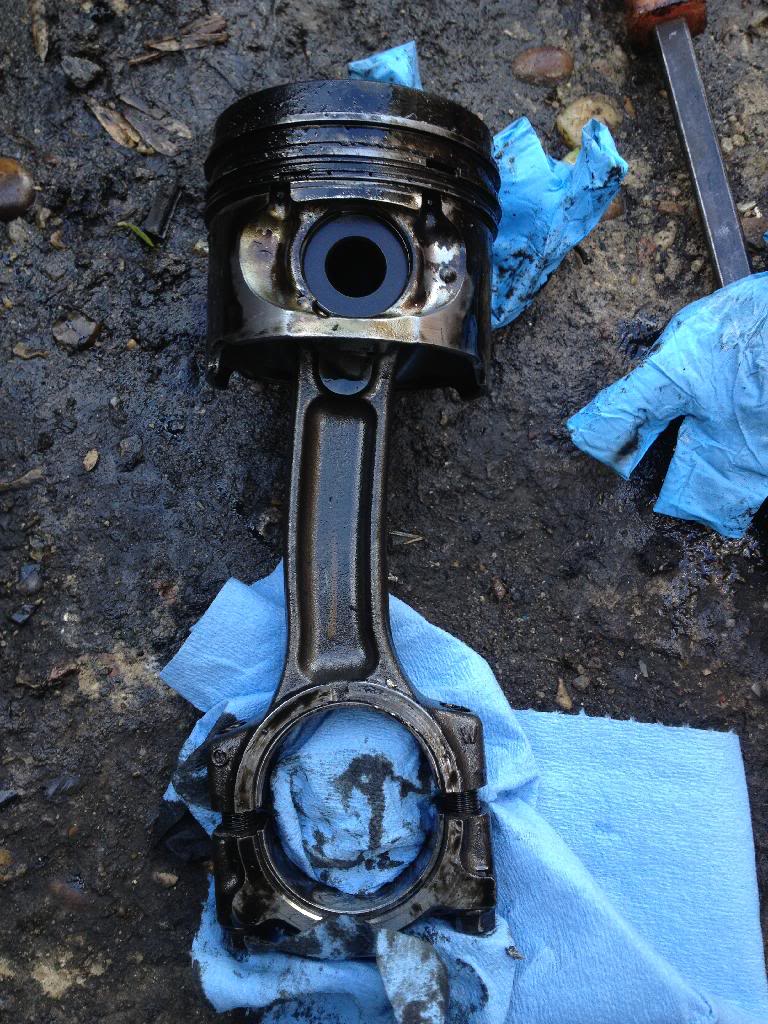

Spent 5mins this morning stripping the engine, gearbox off, clutch out (to check condition, replacing anyway), few other bits removed before the sump...

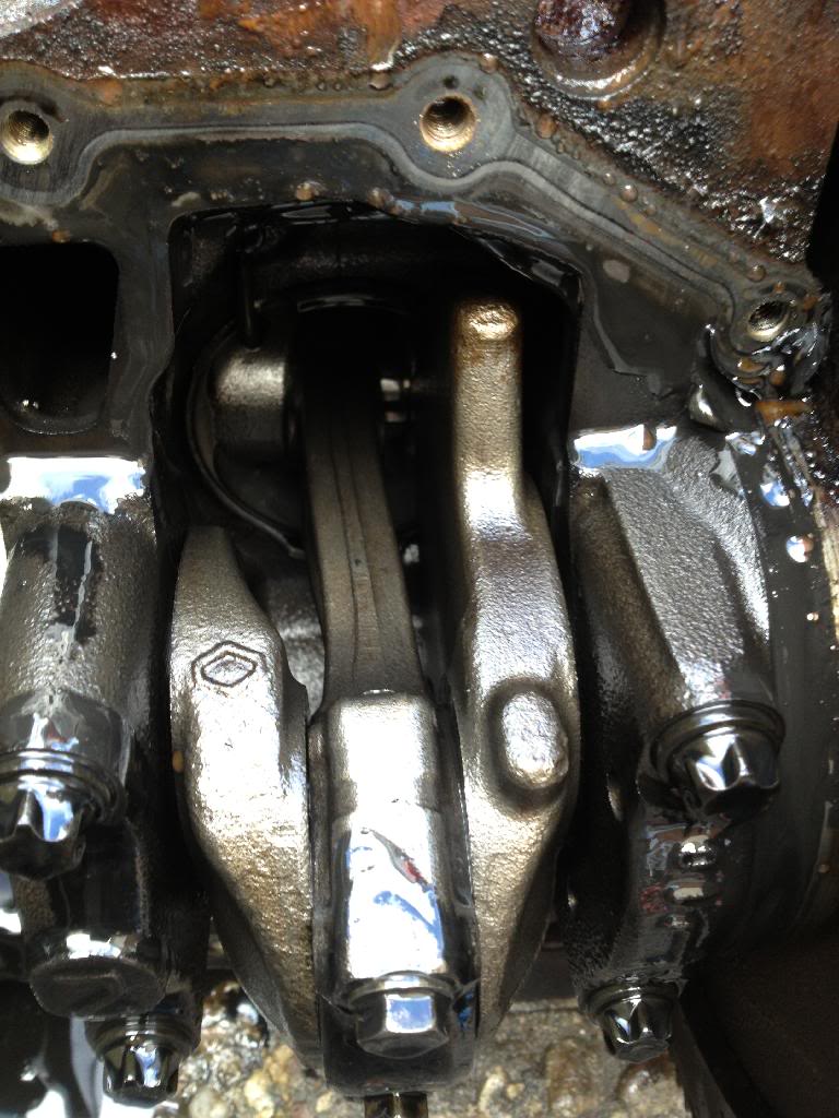

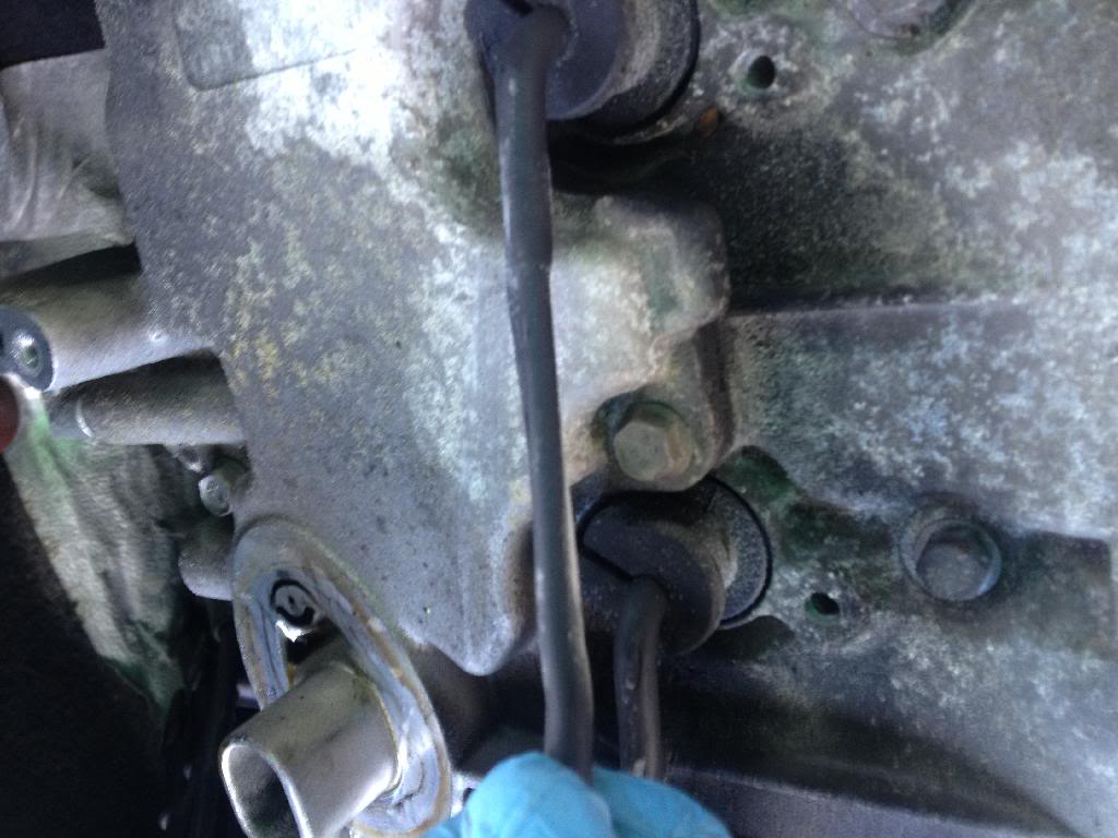

Even an idiot can spot the issue here...
Once removed you can clearly see it, bent both ways.
Luckily, the crank is in good condition, no major scoring or marks.
Will order rebuild bits monday, and get on with rebuilding it ASAP.

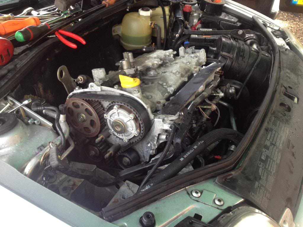

Had barrythecat 's Ph1 to do the Cambelt kit, Aux belt kit, Spark plugs, Service etc.
I was instructed to take LOTS of pictures, so I don't think I did too bad considering it was raining half the day.
Just a few bits to fit...

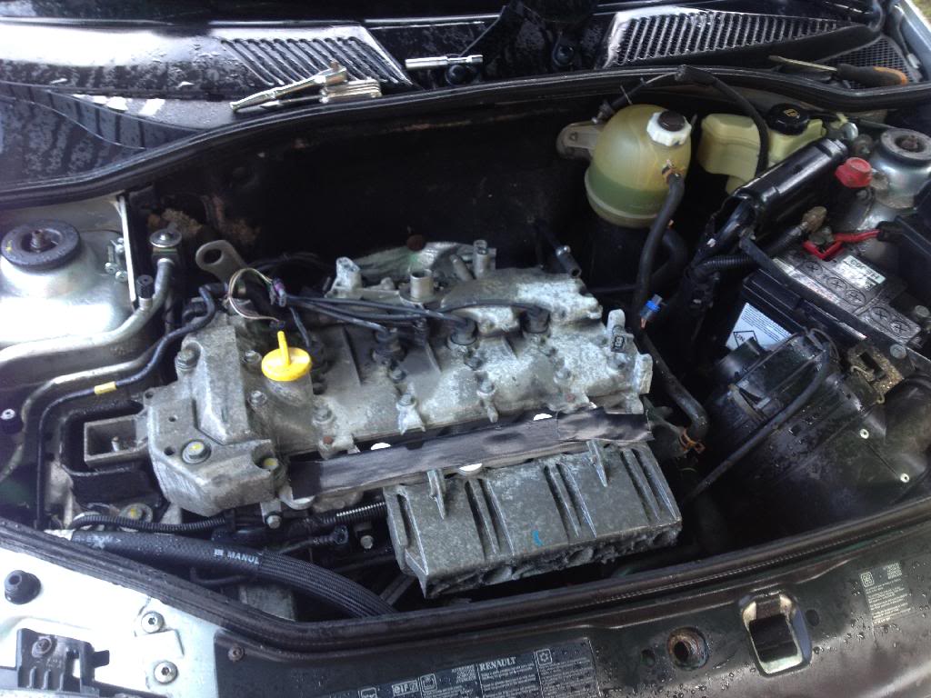

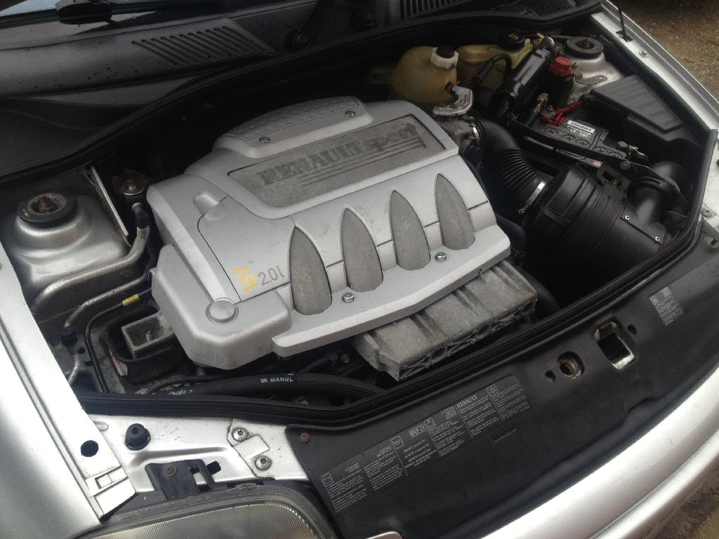

Nice standard Ph1 engine bay, ready to be stripped.
Inlet off, yep, its raining by this point, Gazebo errected.
Nice squished HT lead, Hasn't broken through yet..

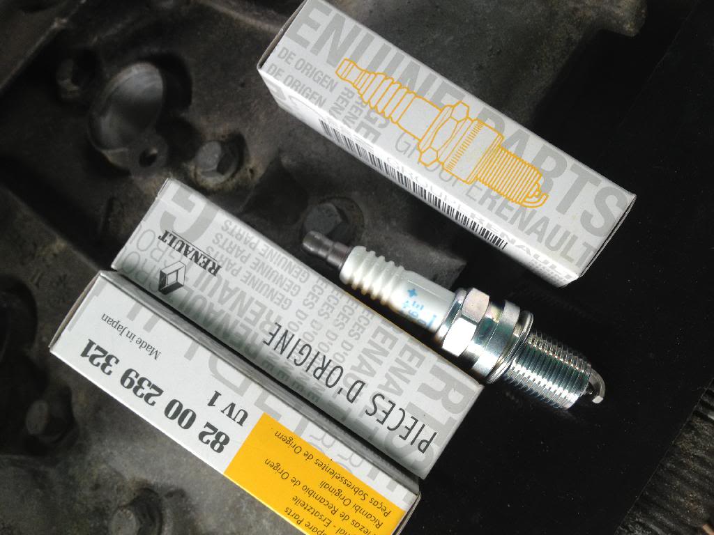

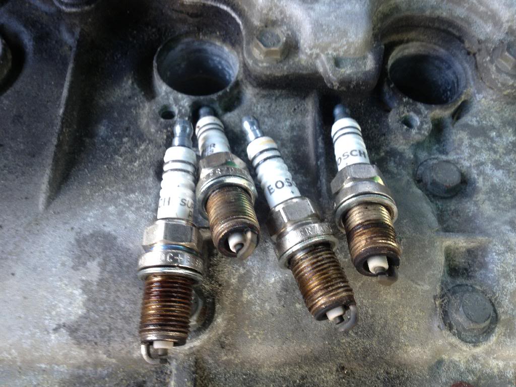

Wrong Bosch spark plugs...
Few more bits removed, engine mount, cambelt cover etc.

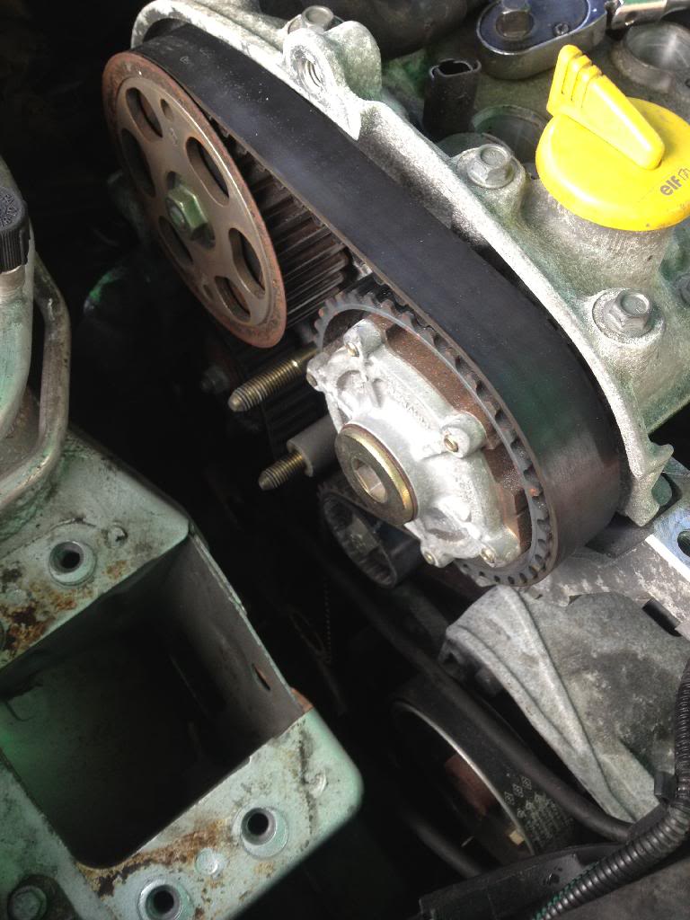

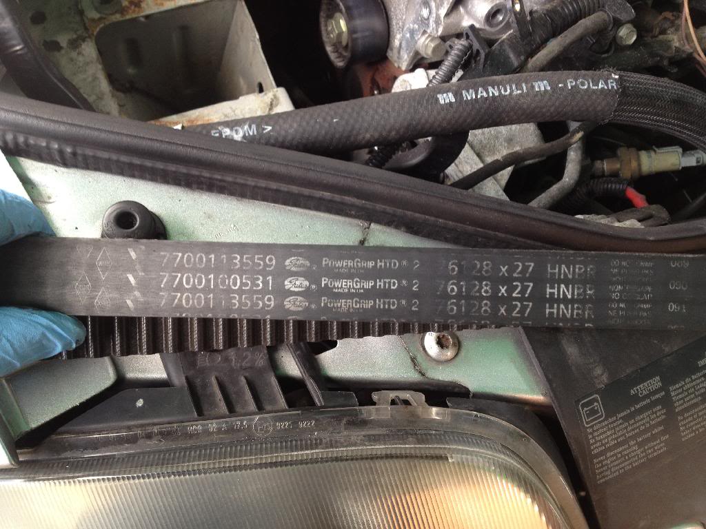

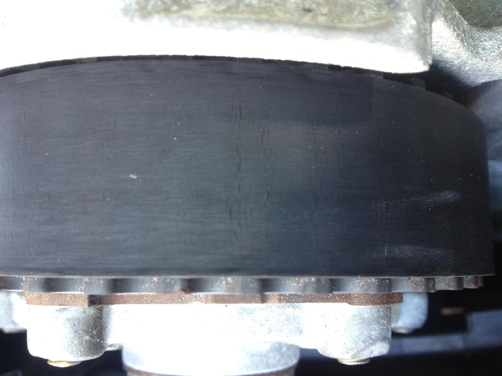

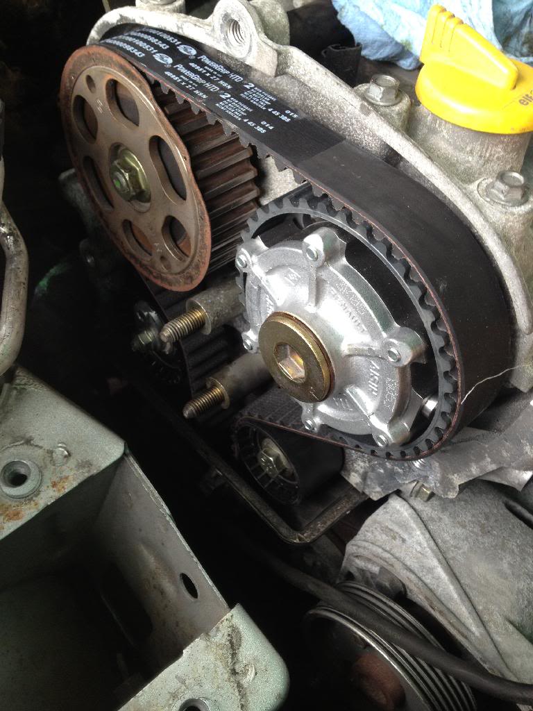

14 year & 68k miles old belt....

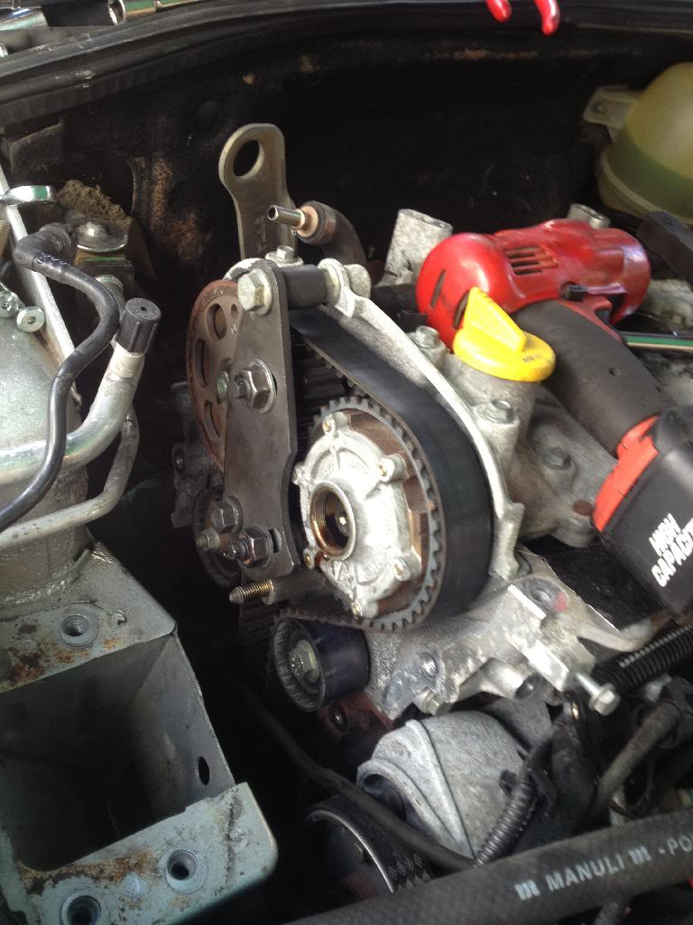

Timing just ever so slightly out

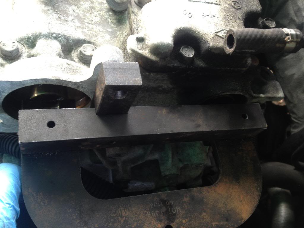

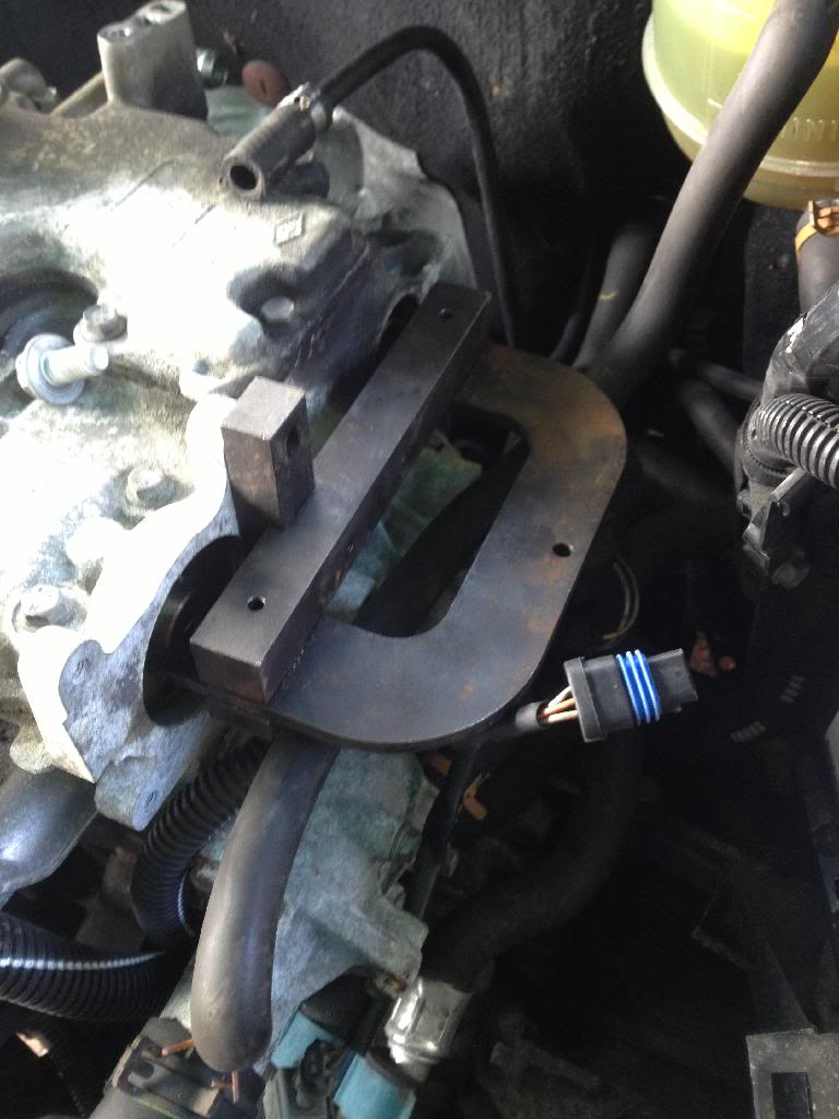

Correct cam pulley locking tool used

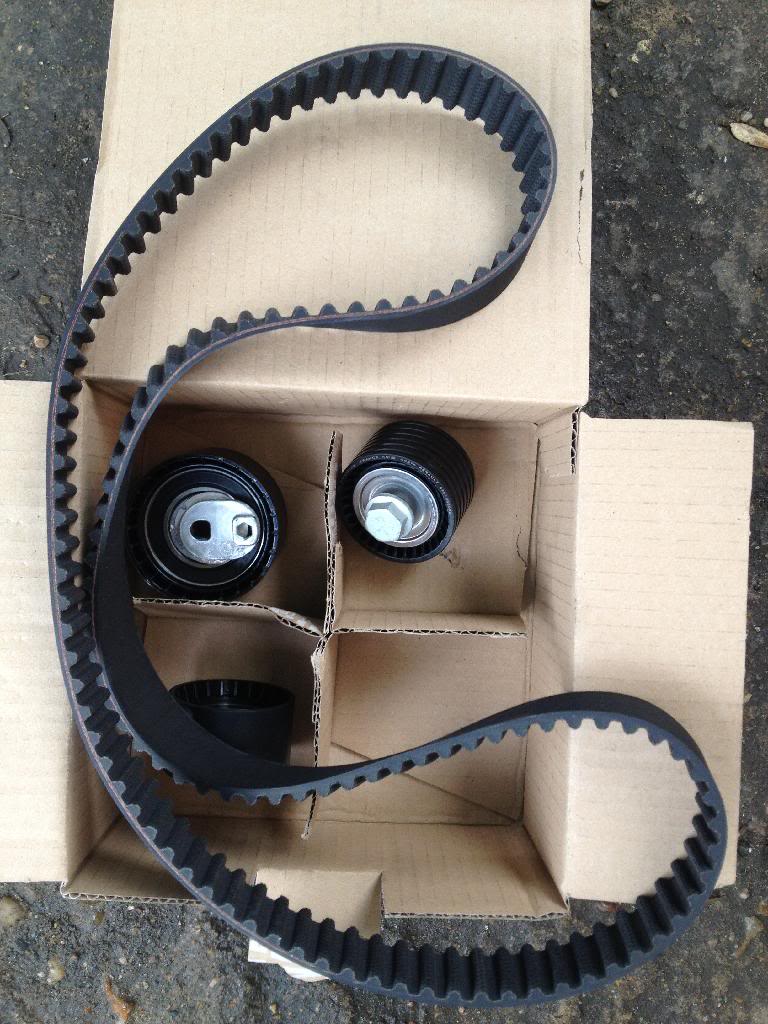

Cambelt

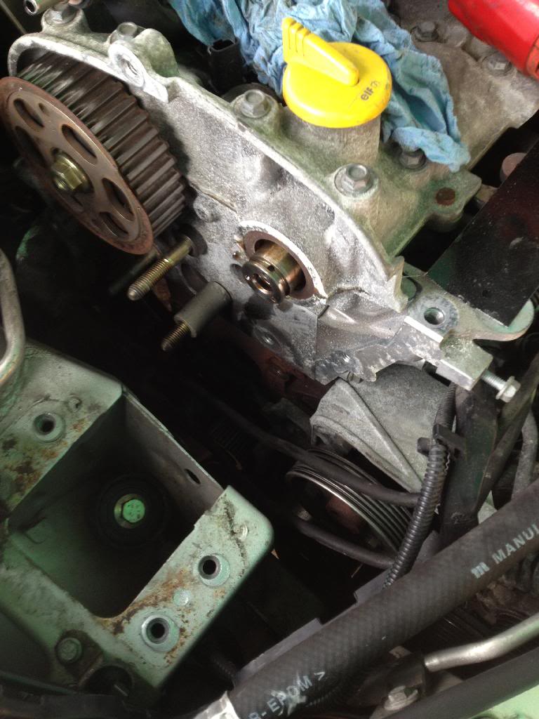

Everything removed
Genuine cambelt kit ready to go on

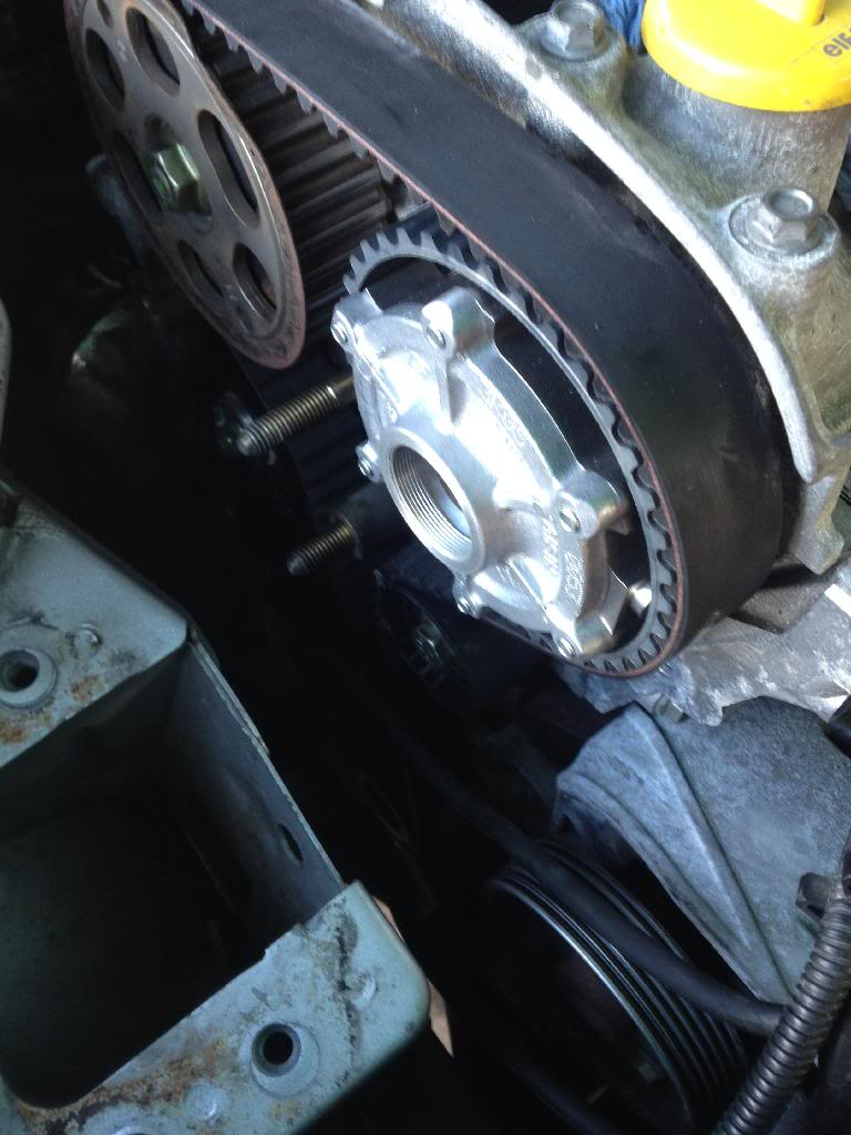

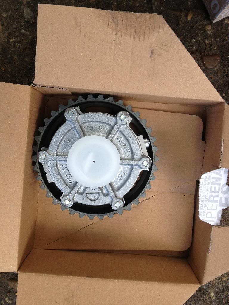

And a nice new dephaser
All fitted
Timed up correctly & checked 3 times to be 100% sure its spot on.
Going back together

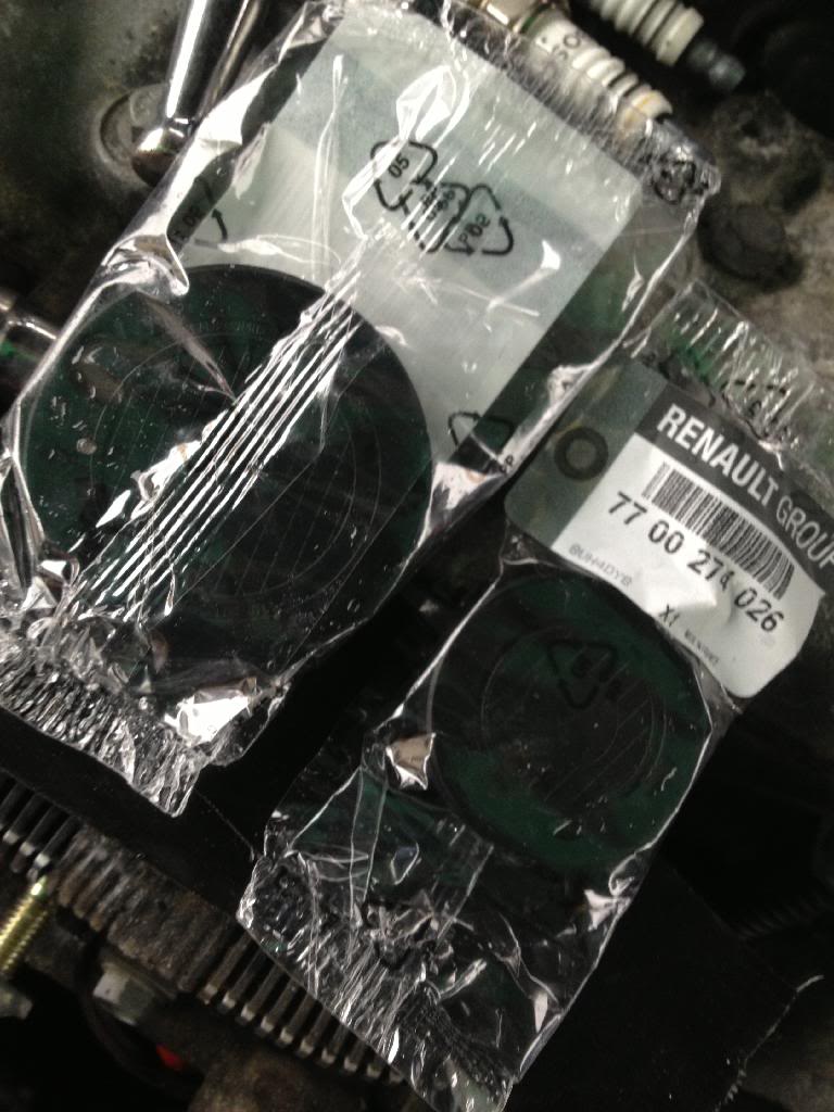

New end plugs

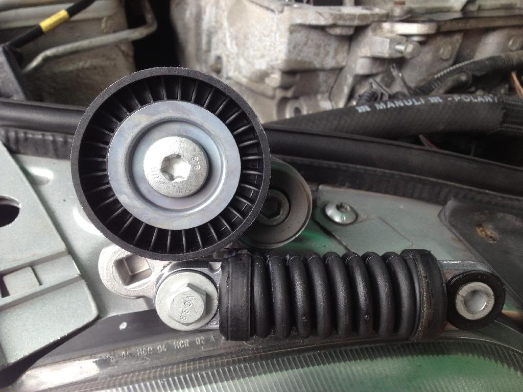

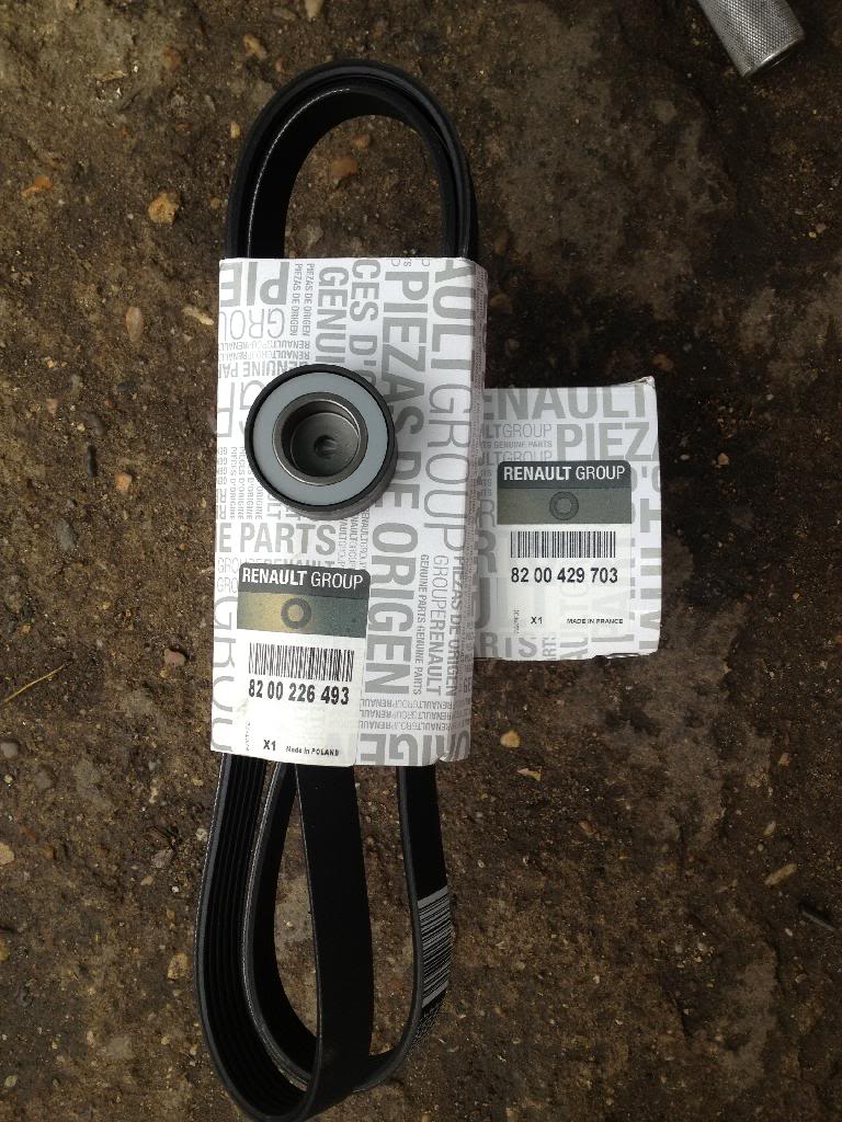

New Aux belt kit
Shiney!

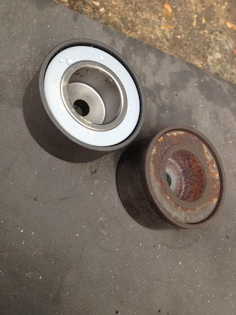

Nasty old, vs shiney new
Correct, new NGK plugs
Hailstones!

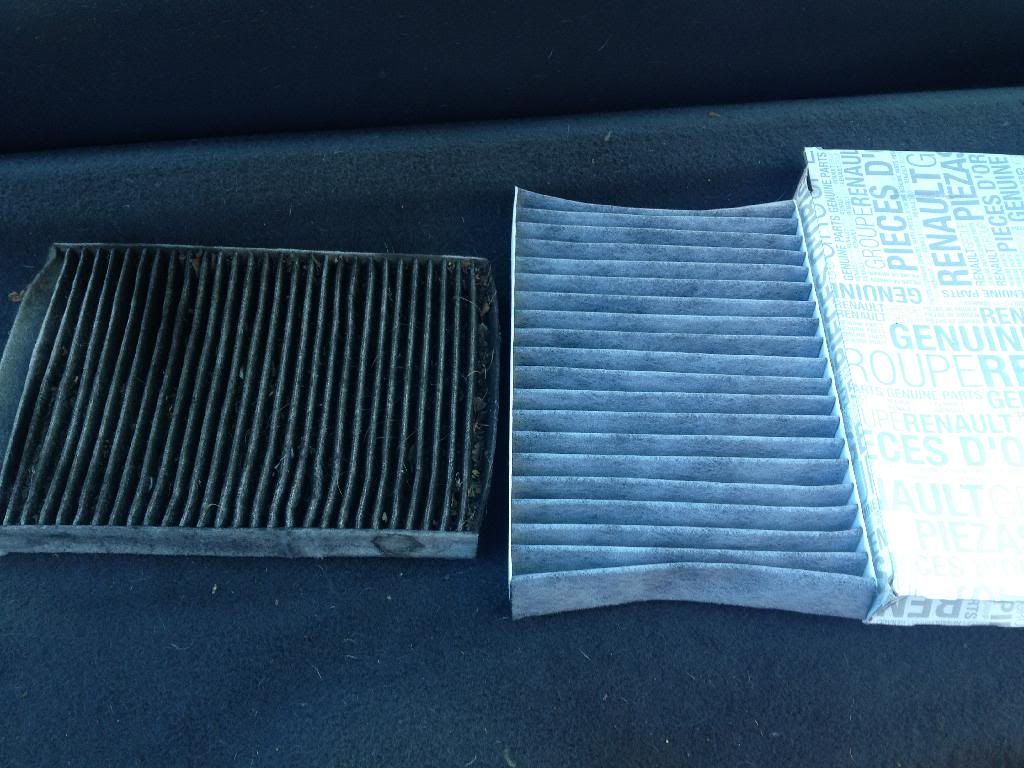

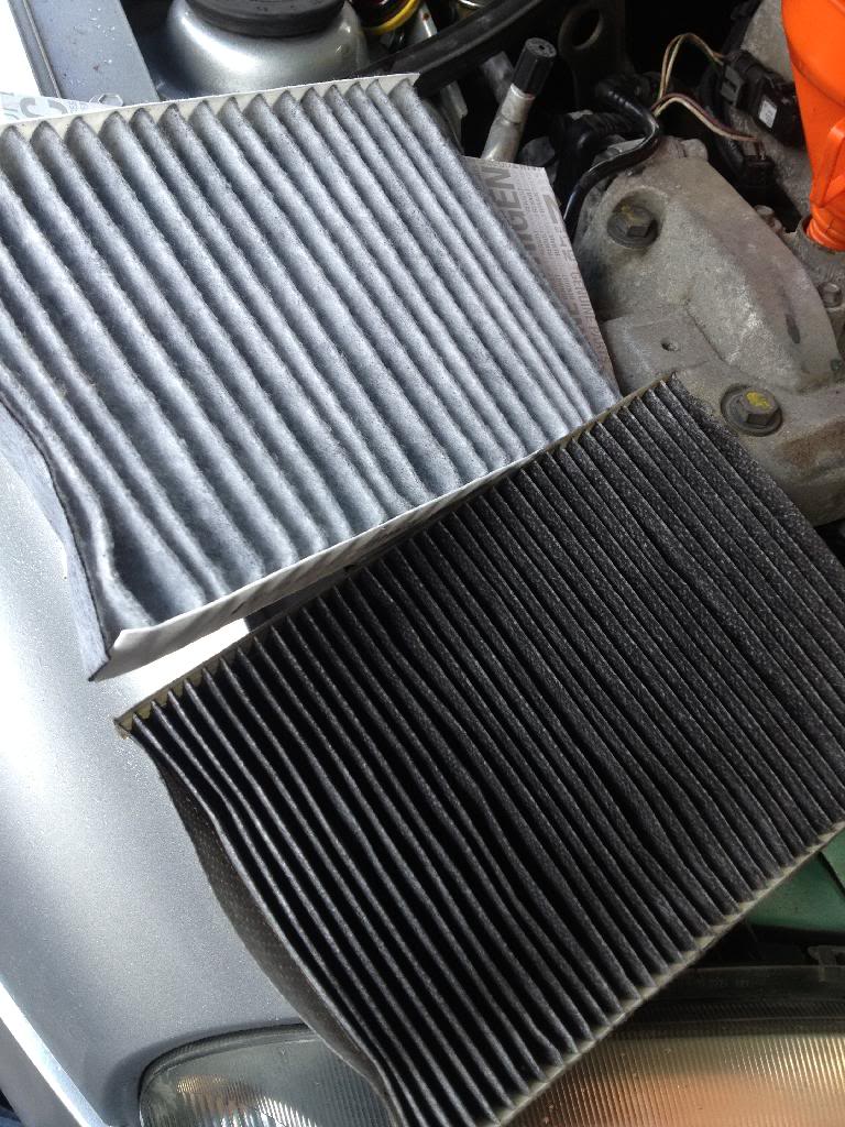

Pollen filter change, a little different on a Ph1
Finished, realised I've missed a few pictures, but air filter, oil & filter were changed too etc.
All in all, its a nice clean Titanium Ph1, few small bits and it'll be awesome. Runs spot on and Barry is very happy, which I love :D
