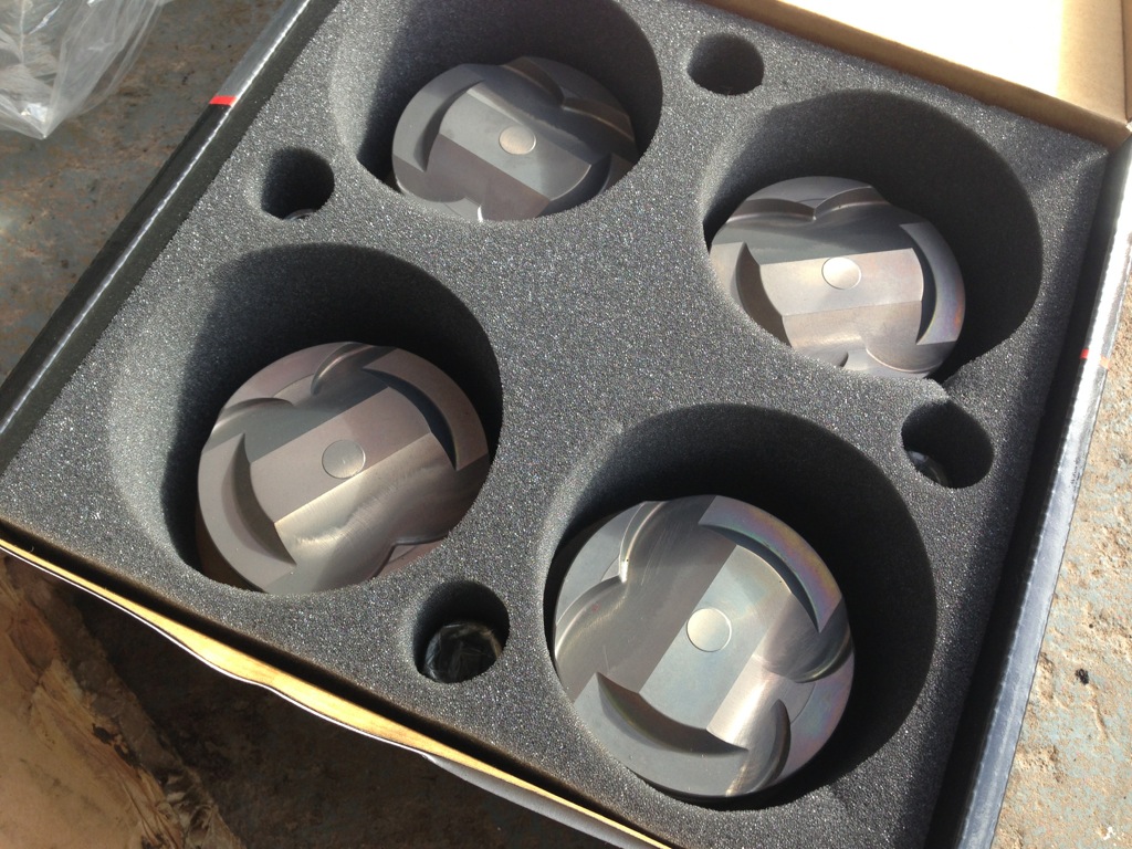

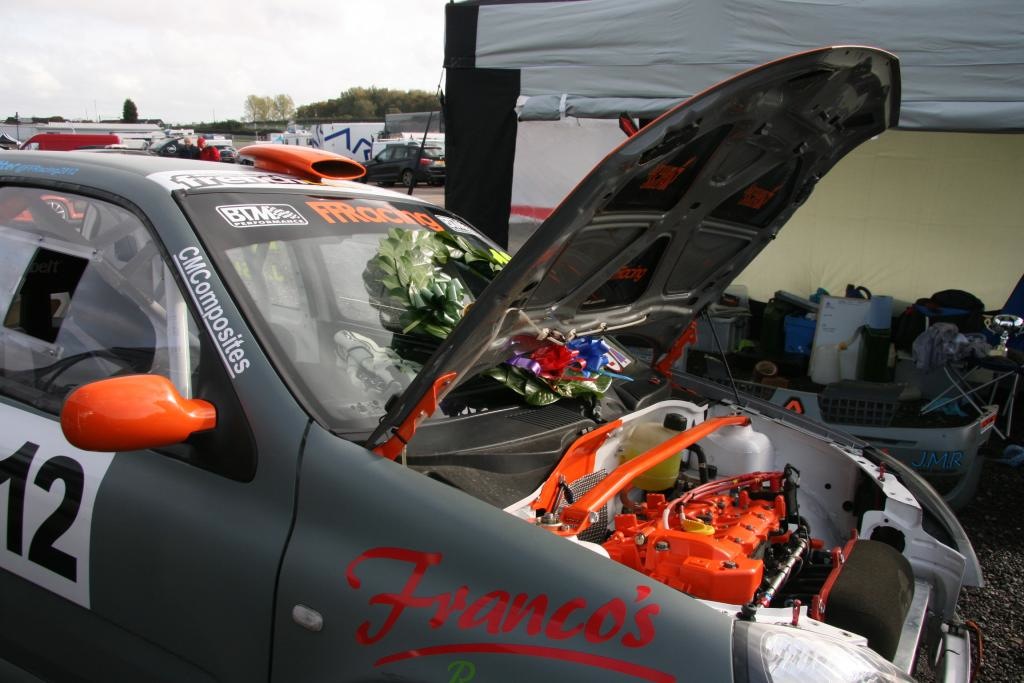

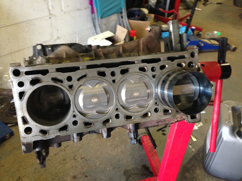

Forged pistons to remove the chance of future ringland failure
Installing

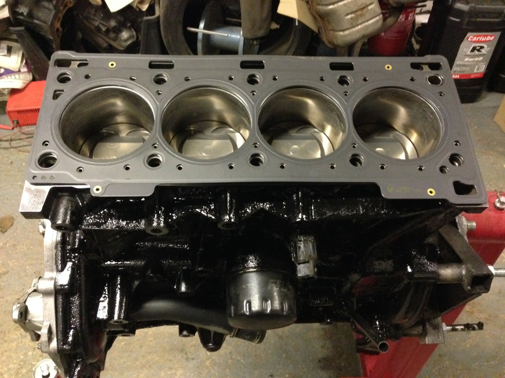

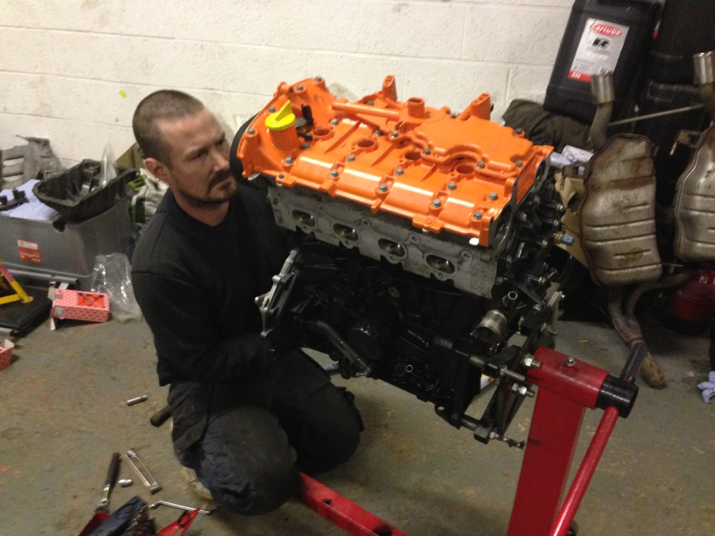

Thick Headgasket much to Fred’s annoyance but I didn’t really want to increase the CR so this was the solution.
The master at work!

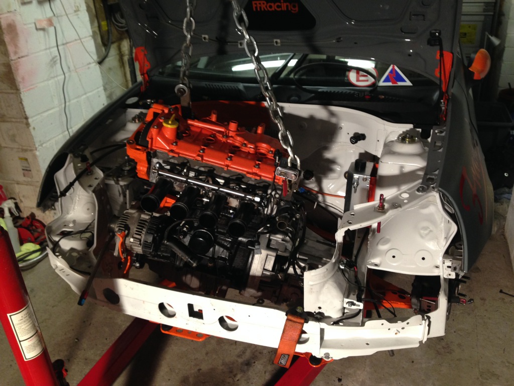

Time to go back together with the new gearbox

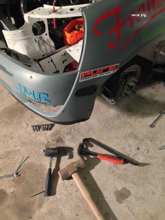

Tools for straightening the front of the car back out

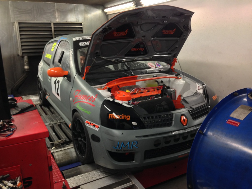

Dropping the mineral oil and swapping to good stuff

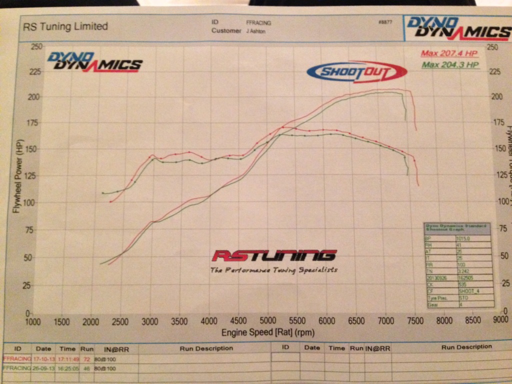

Green line was the old engine just before Oulton and red is the new engine, Just what I wanted!

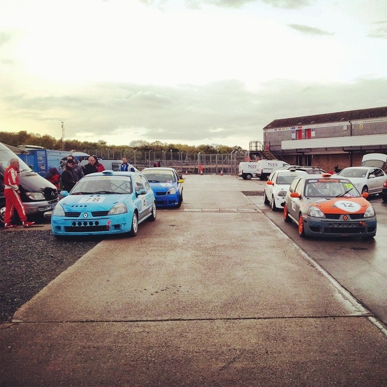

First to arrive at Donington after a hectic few weeks
Mr H arrives and this is home for the weekend

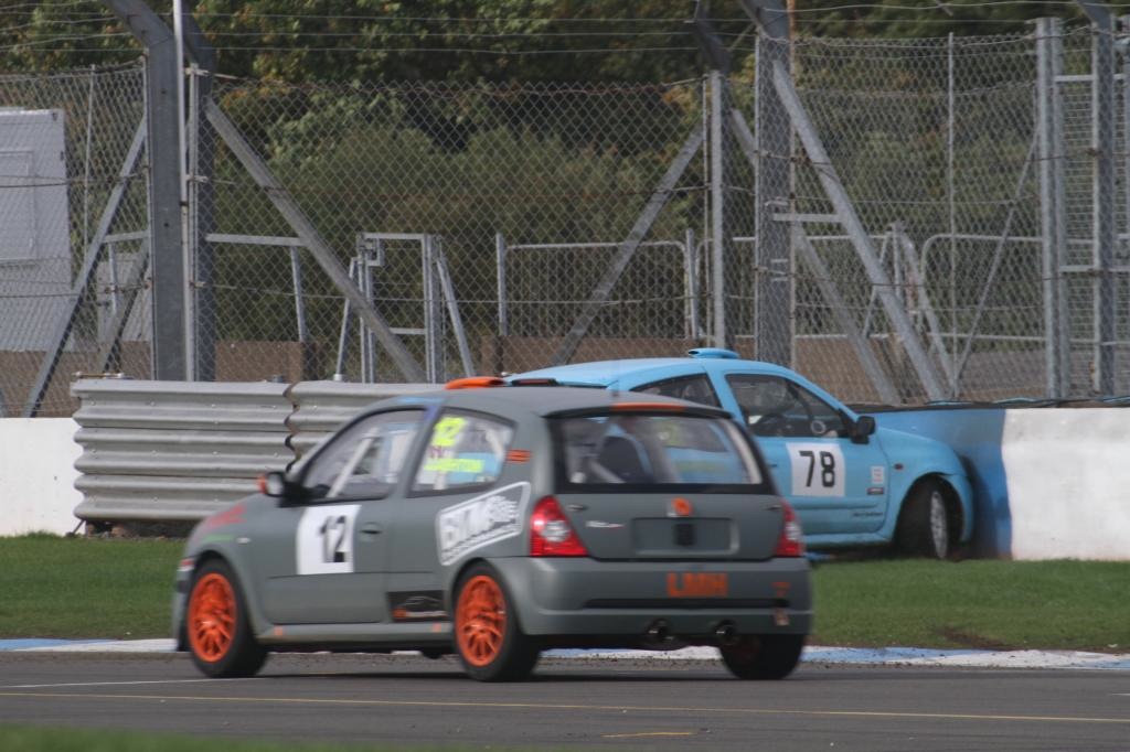

Wet quali was good fun!
Lined up P2 on the grid
A good start
Outside line with a wider entry
Worked!

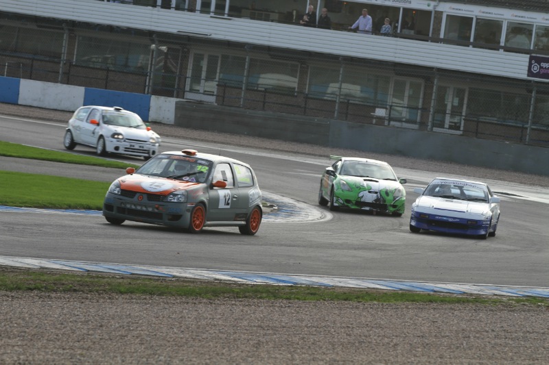

Gap after lap 1 to try and get some comfort ahead of Tony!
Working through the traffic
Trying to overtake the backmarkers who don’t like moving over even after trying to run you off the track lol!

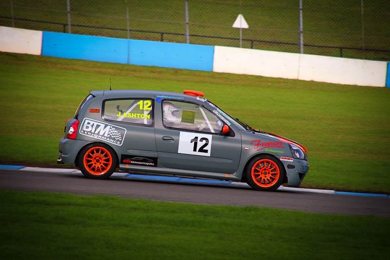

First WIN!! A great parade lap alongside Tony

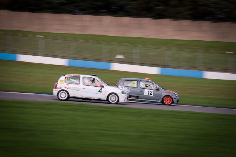

Who brakes first?
Slightly ahead
Sorted!

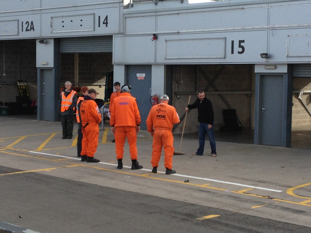

Fred sweeping up my debris :)
Fred teaching the marshals how to sweep!

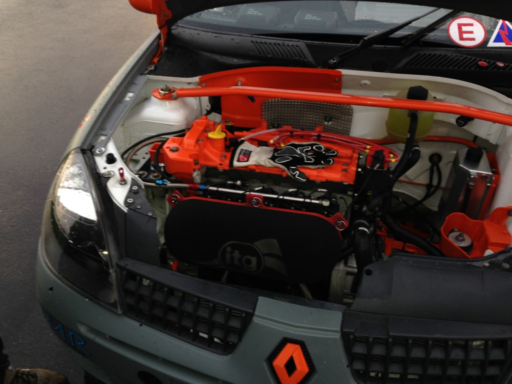

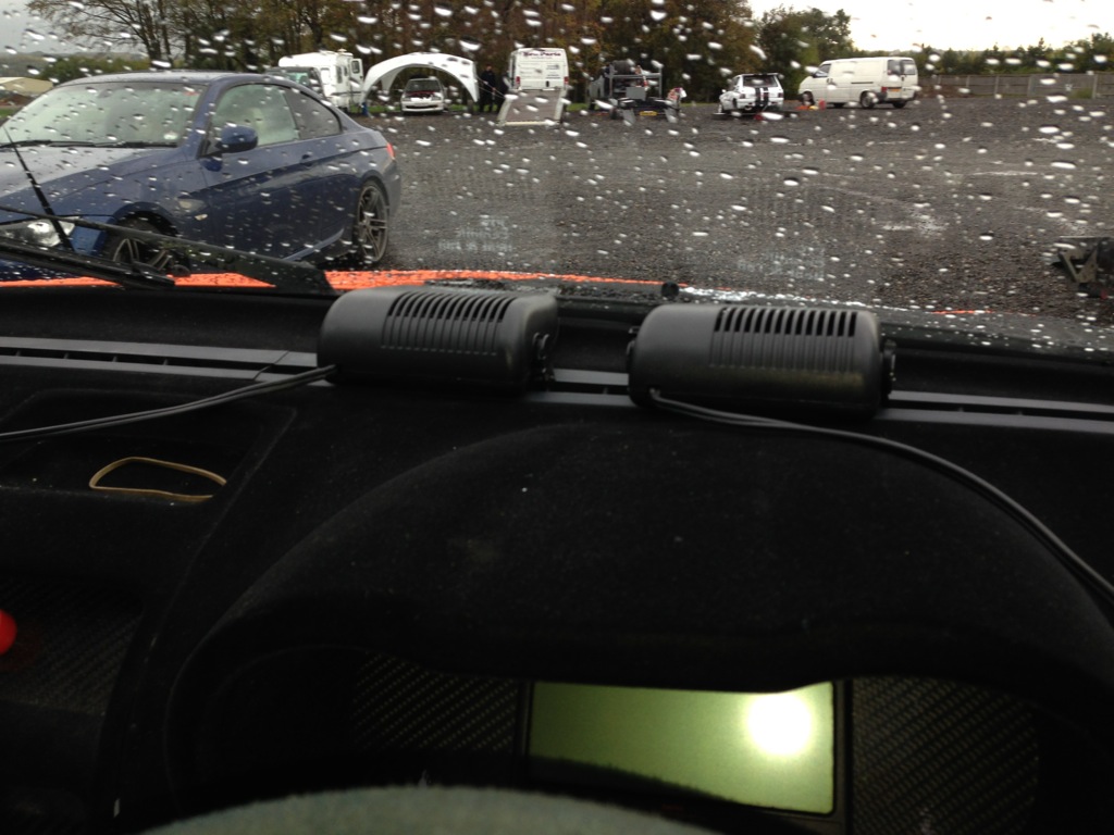

After the misted screen in quali time to wire up some heaters for the wet race 3. Patent pending BTM and FF-Racing
Mr health and safety

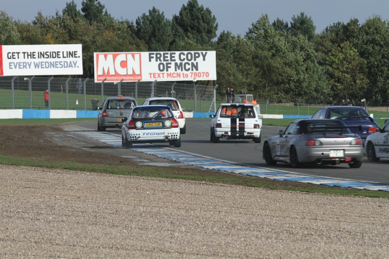

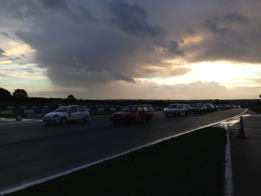

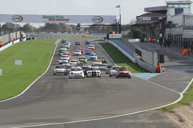

All the clio’s lined up for R3
Left my glove on the wet floor of the car so time for a quick dry before the start of R3

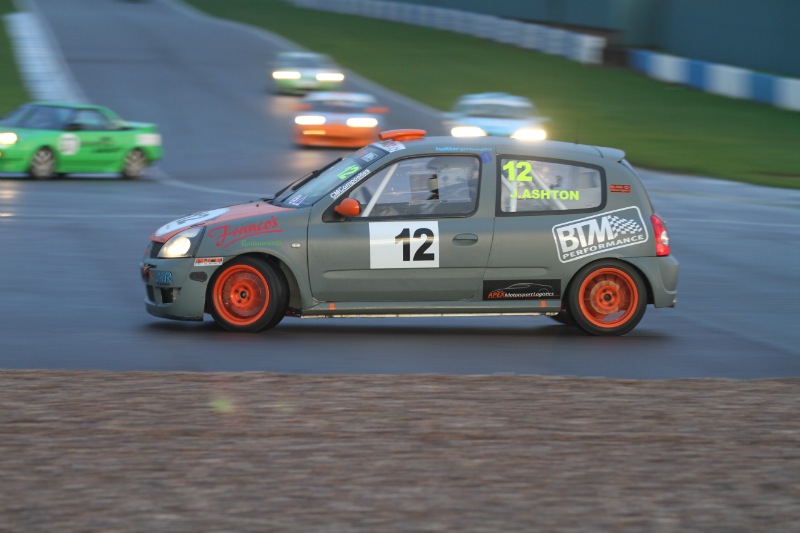

Getting dark right at the back of the grid
First lap whoops..

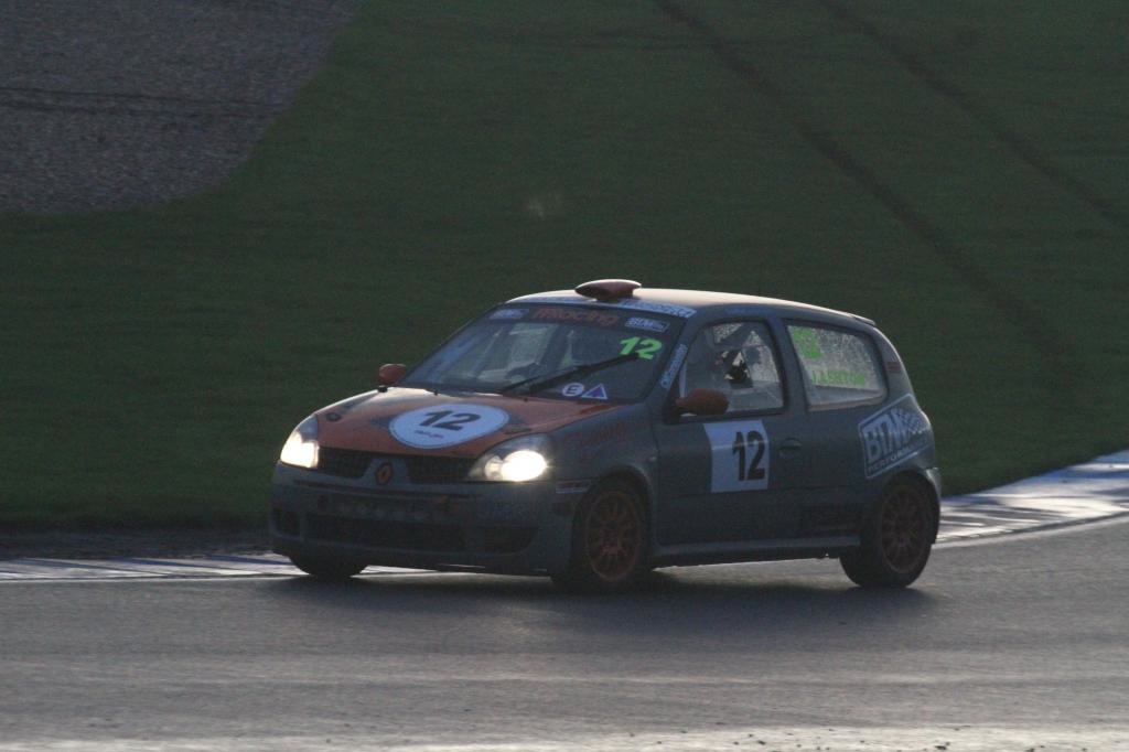

Headlights ablaze
Now getting really dark!

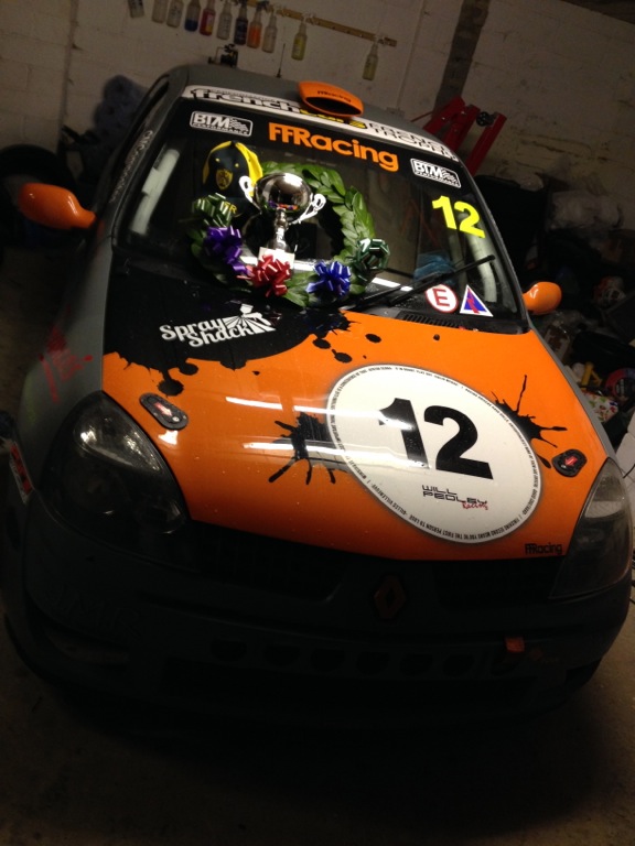

Back home and a great end to a great year!

You didn't want more compression??? :|
If I was fred I'd of chucked a standard gasket on while you weren't looking lol
I had no real interest to get more power mate, it was just a matter of upgrading the weak points and giving me a known working engine to see me through the end of the year and can then be used as a spare engine. It's still a higher cr than std but not the 13.5:1 that it would be with a standard HG.
