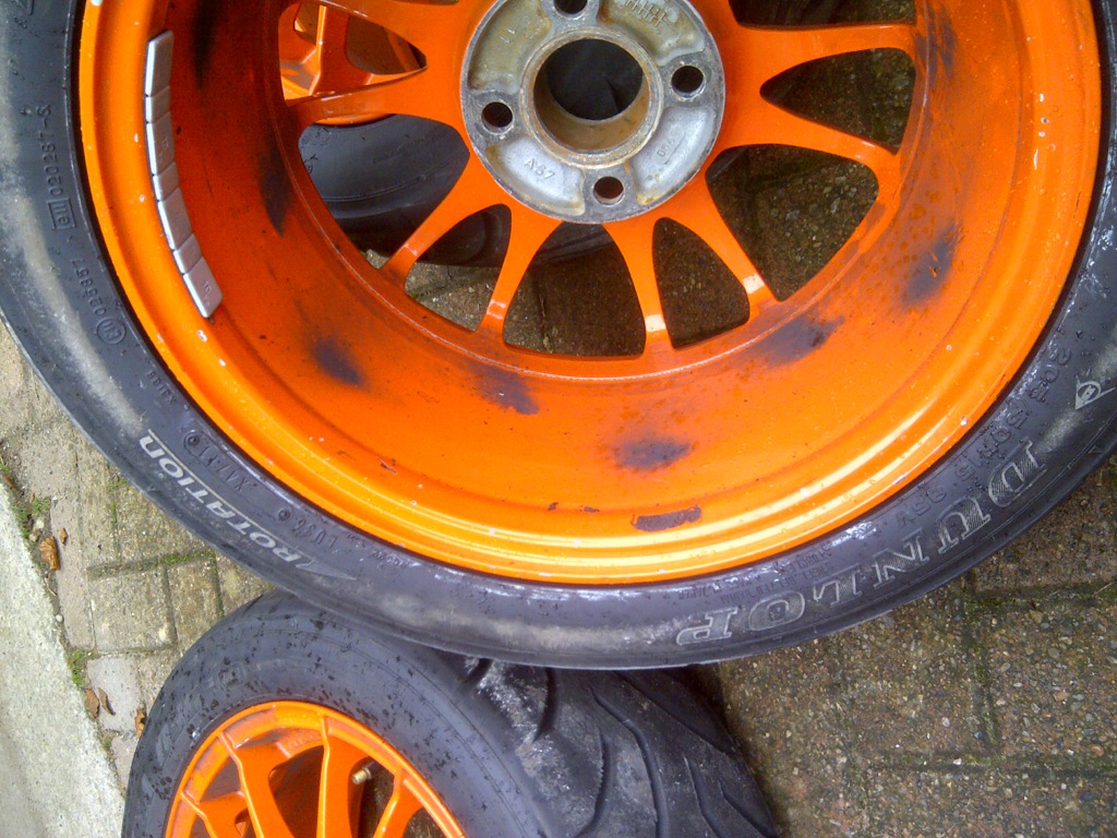

Update:

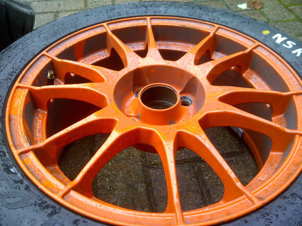

Right so after the suspension issues and also the brakes that weren't working as they should at Donny I was never going to have time to get it all sorted ready to be sure for the Donington race as I am going away in a few hours.
The problem with the brakes seems to be the ABS putting varying pressures to individual corners which was pulling the car massively to left under hard braking to the point I was getting pulled onto the grass which was only going to end badly. The easiest solution is to remove the ABS (It's been intermittent for a long time anyway) and then fit the 172 cup system which should hopefully be reliable.
Below is the picture of how much brake dust had come off one rear brake after just 8 laps
There also seems to be something wrong with the fronts which left this

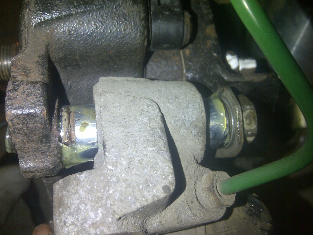

I have decided to get rid of the dust seals on the rear calliper sliders so that I can just keep them well greased

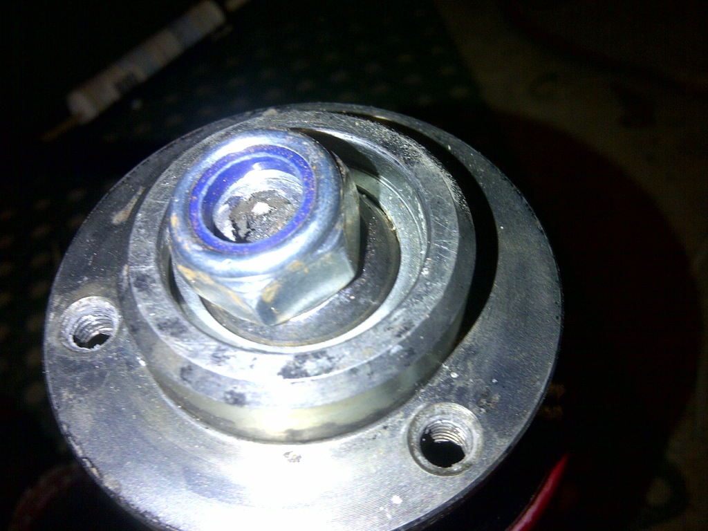

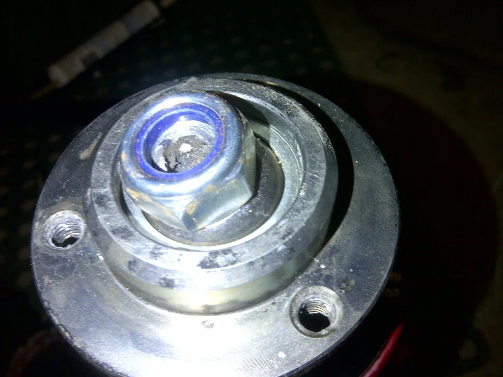

The suspension was sent off to AST the other day who called up to say there was nothing wrong with it which came as a shock as there was play in the shaft even just by moving it with my hand so not sure what was going on there especially because the other side didn't have this play. I explained my dissatisfaction to Josh who as always has been great and he has got AST to fully re-build both to fix them. They will be sent to Fred who will fit them while I'm away. This left me with the issue of how to get the car to BTM with no suspension so I refitted the butchered H+R's and had to do a pikey top mount which I was rather ashamed of but it was only going onto and back off the trailer

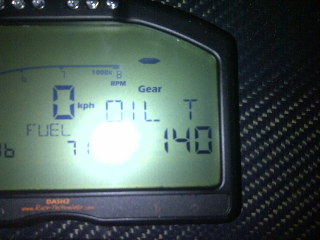

Found a few more issue's when I restarted the car such as the oil temp gauge showing 140 degree's on startup which is odd as it hadn't been started for a week

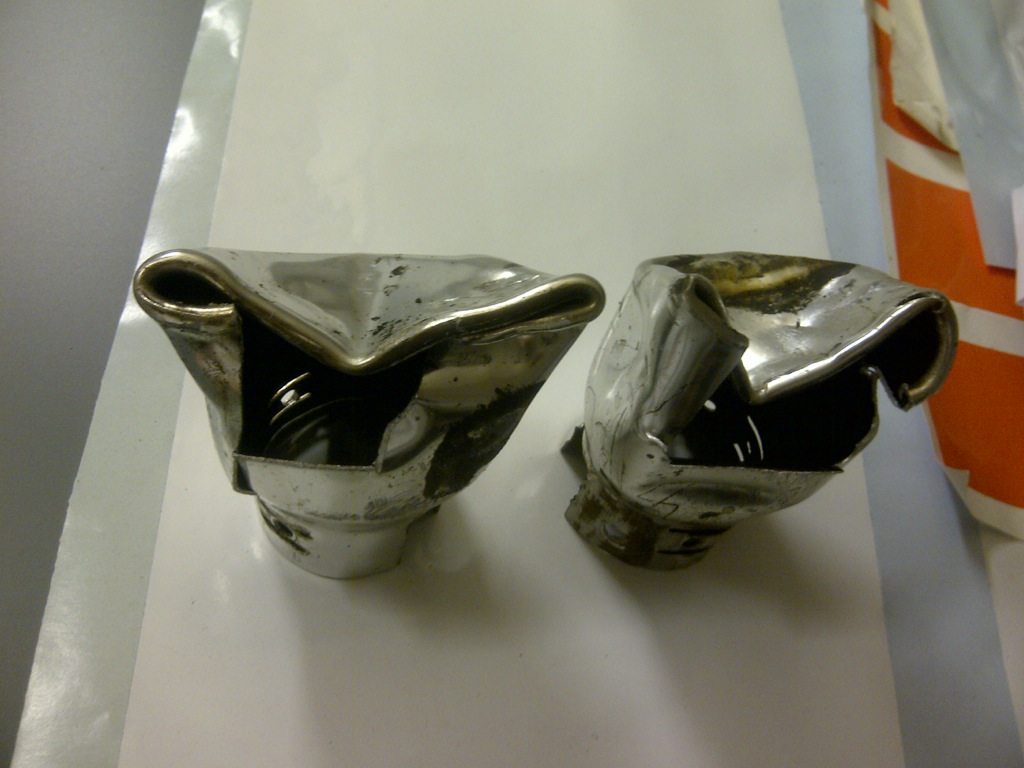

The only outstanding job is to work out what to do with the exhaust after our attempts to silence the car at Donny

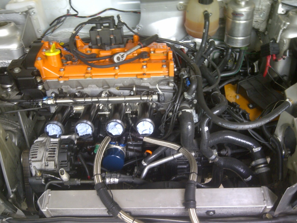

jesus from that engine bay pic it looks as though everything's held together with tie wraps obviously not your doing though and hopefully youl have a good outing at Donington

If ever there's an argument to simplify the engine wiring it's your bay, looks really busy. I thought TDF's EC1 cut wiring dramatically, seems not, looks like there's more than standard.

Scary ammount of dust from the rear brakes. Don't think ours do much at all. It's takes ages to get the surface rust off the disks sometimes :)
Haha lol everyone says that ;)
Love the downward swept DTM tail pipes, did you notice a difference in Db?

Haha tell me about it! That's why its all getting re-wired over winter as it's just too complex for me to understand and too easy to catch a wire when just doing simple tasks.
Didn't get chance to try them out as the TDO wouldn't let us back out :(

Yes wasn't good at all! Normally the rear wheels barely even need cleaning this time that one was f**ked
