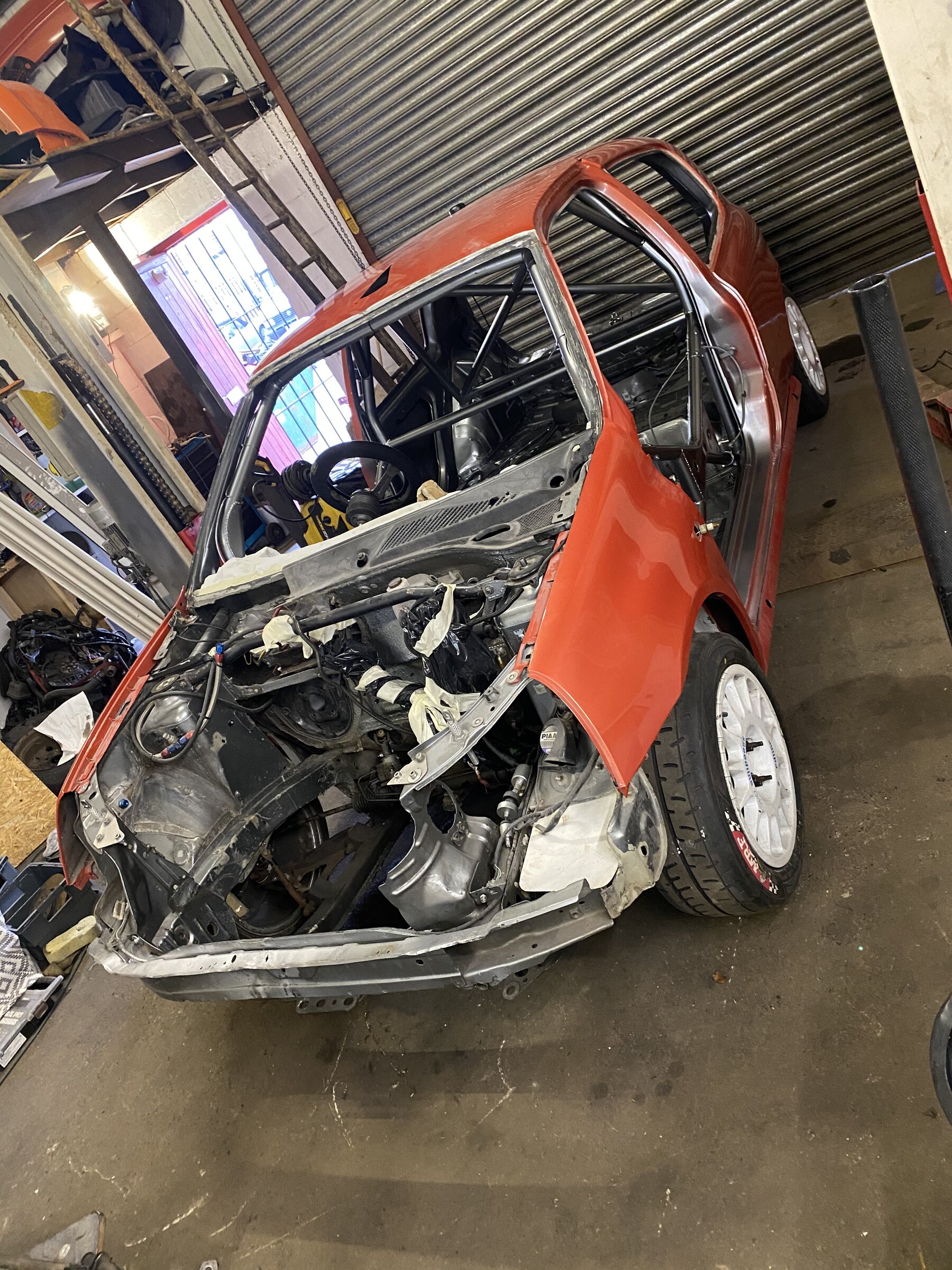

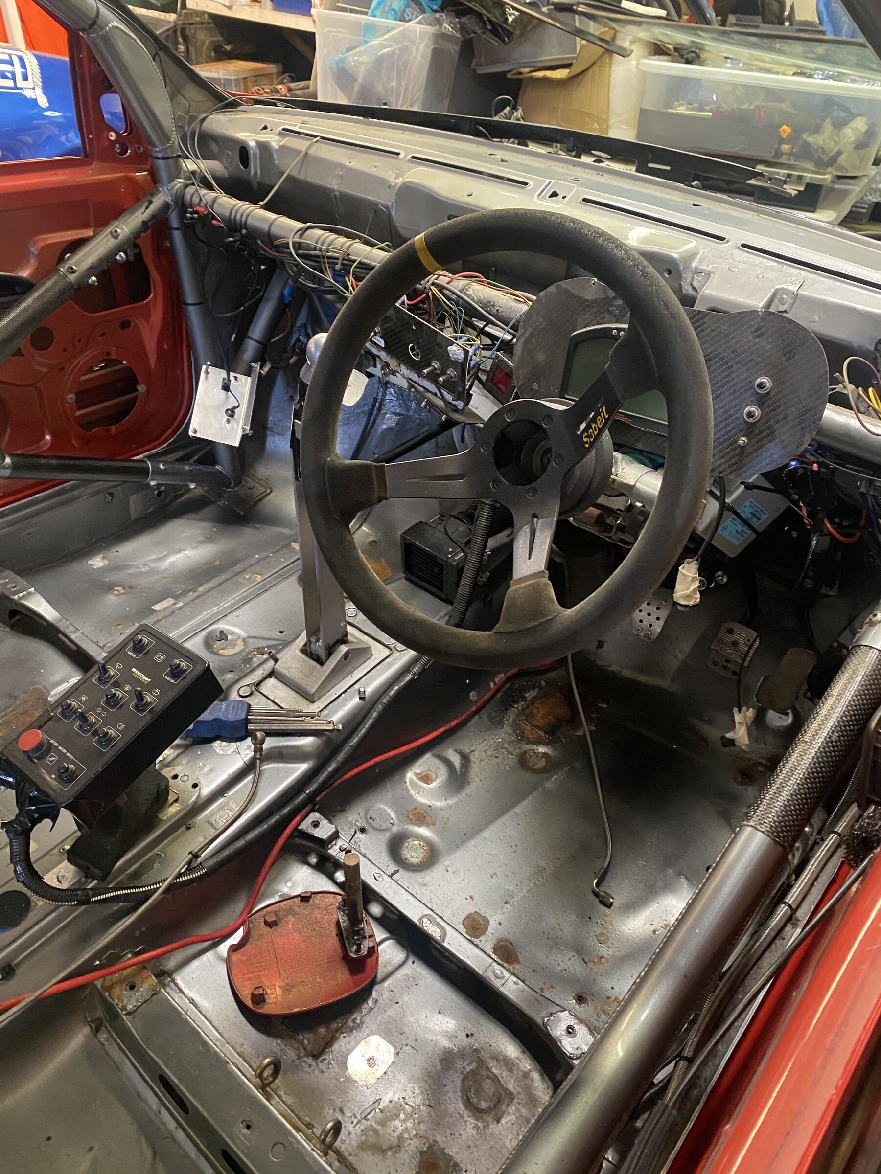

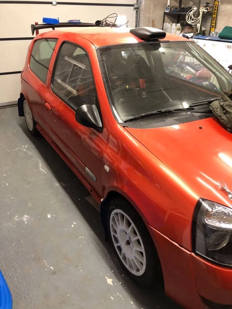

I bought an already rally converted ex Clio Cup race car. It wasn’t in too bad condition but it hadn’t rallied competitively in a few years so I knew it would need work to get it where I want it.
  Audi rs3/Clio 172cup

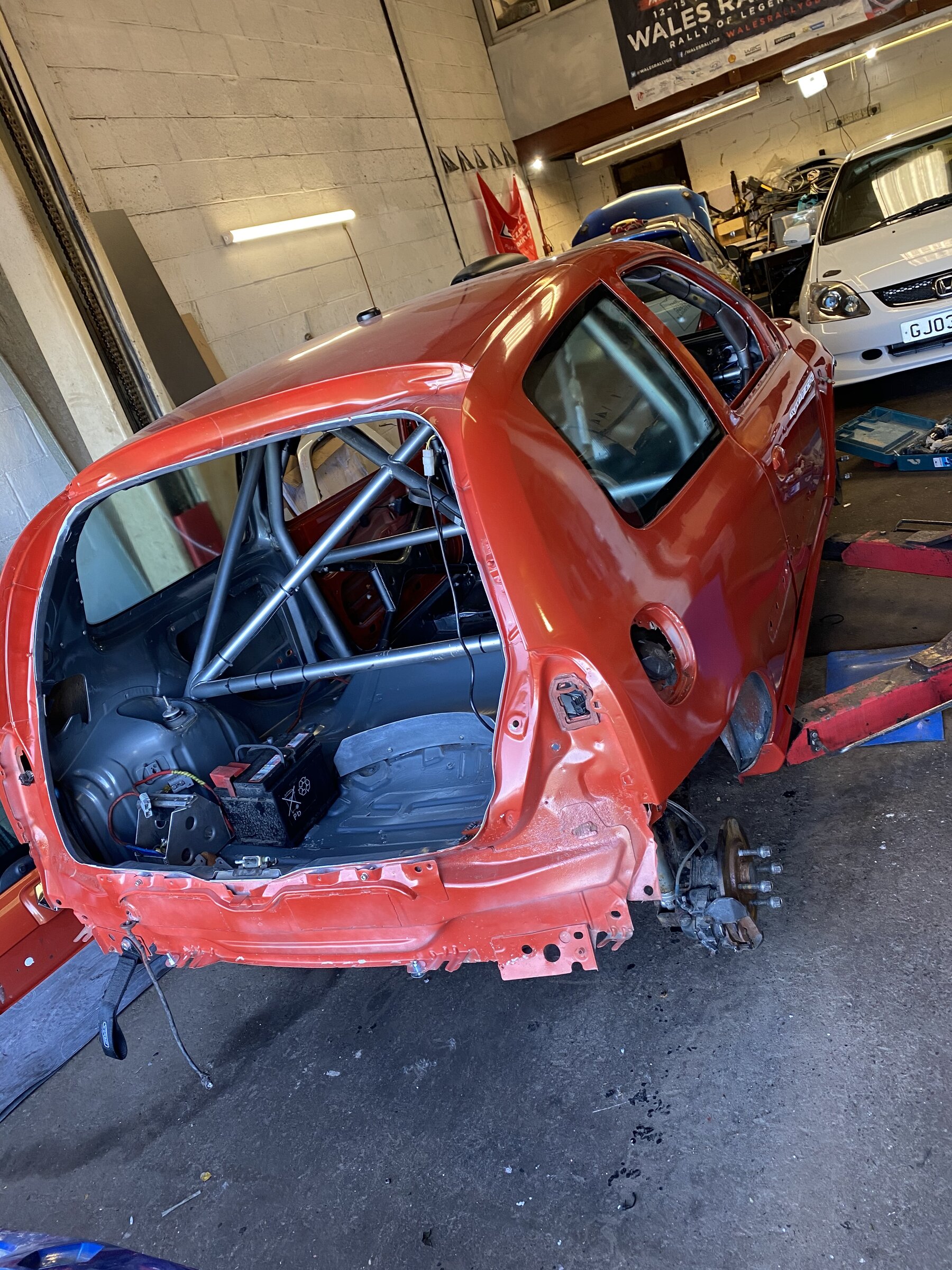

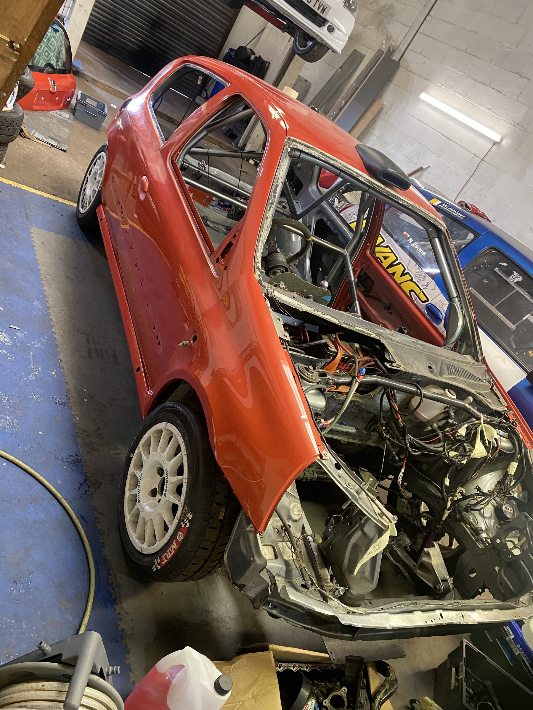

Off to the body shop tomorrow and still undecided on what colour to paint it 😂

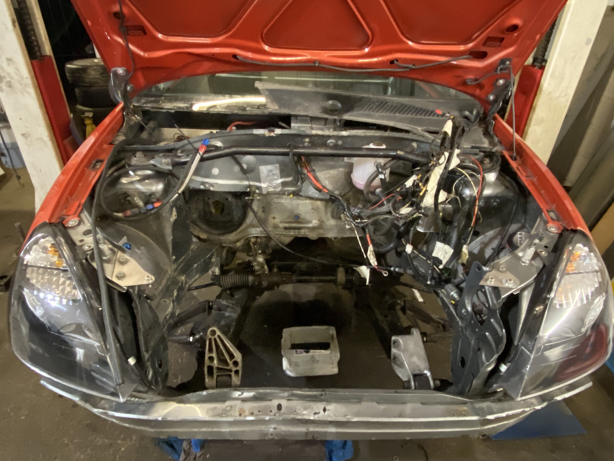

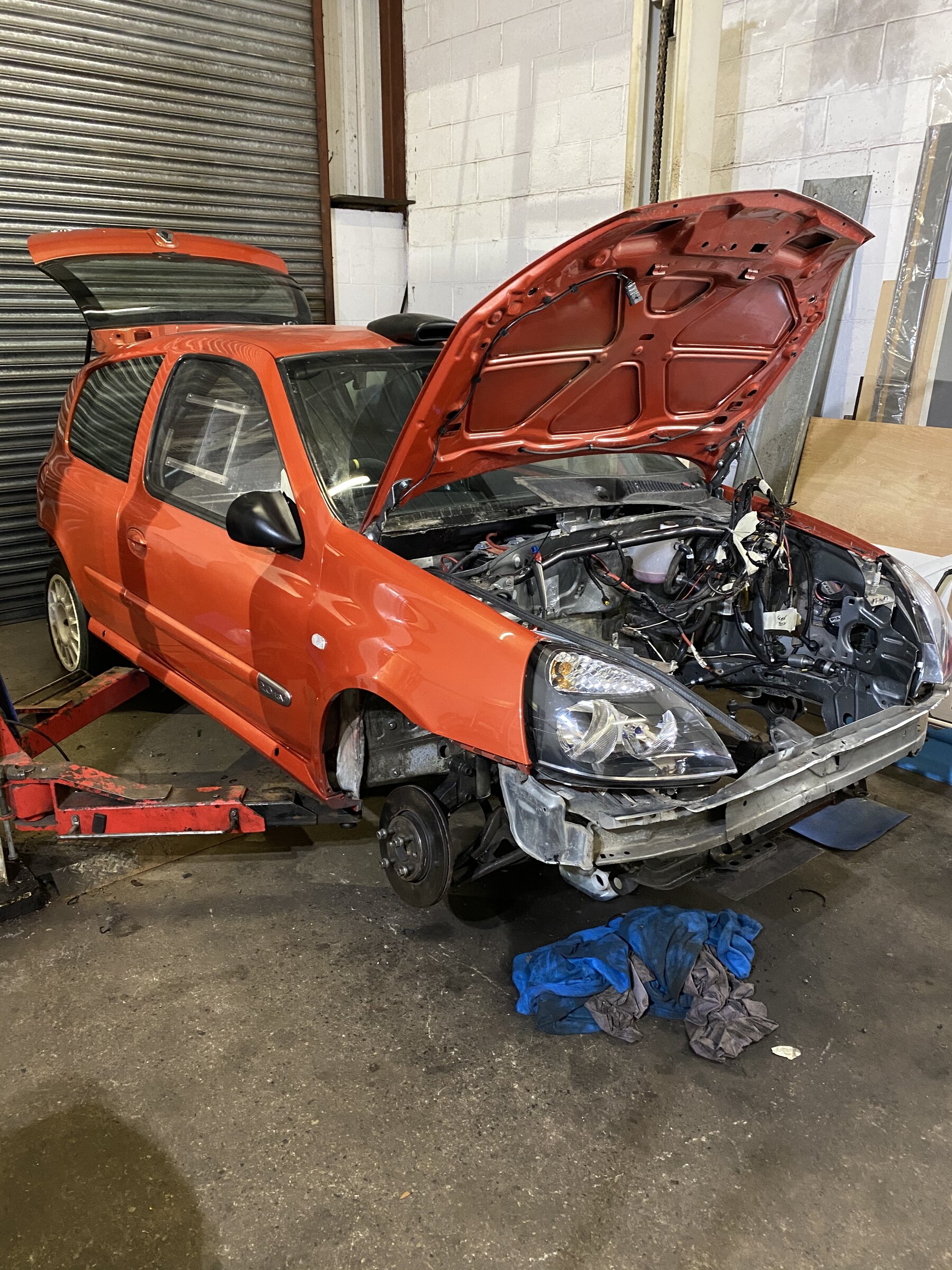

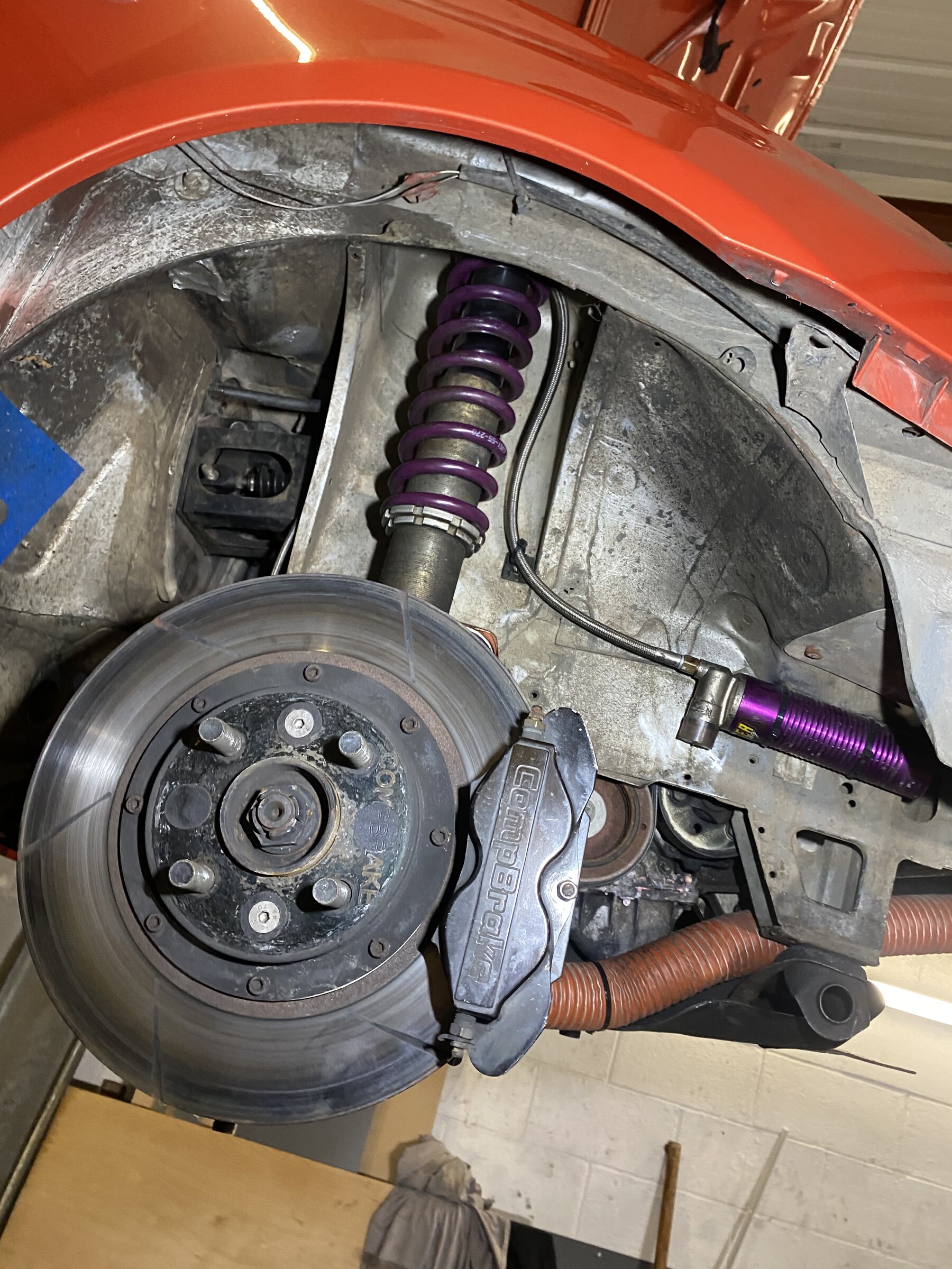

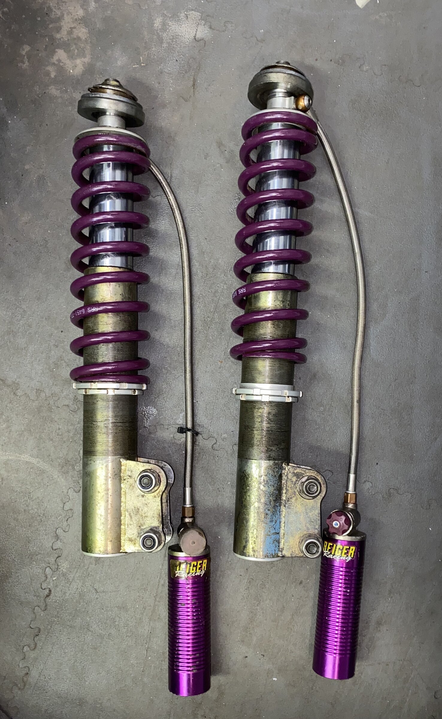

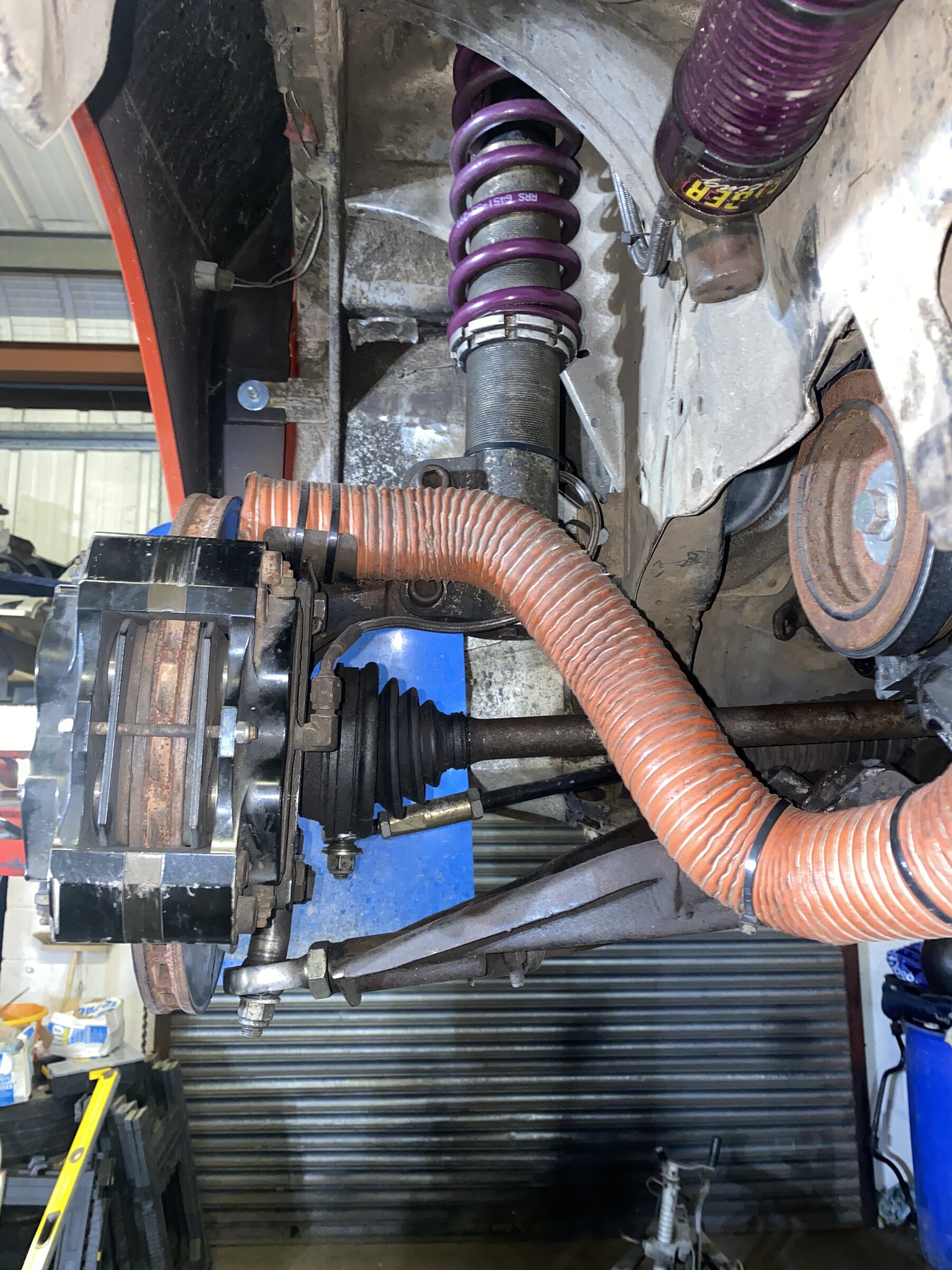

Subframe off and normal 172 on for the time being so I can get the reigers serviced and springs changed to my liking with a helper spring added as well.
Will paint the subframe whilst it’s off and will source some more hubs as ones had a repair where the pin fits.
I know they’re supposed to be 2.2 or 2.0 Laguna hubs but the part number come back with all models from 1.6, 1.8, 1.9dti, 2.0 and 2.2d

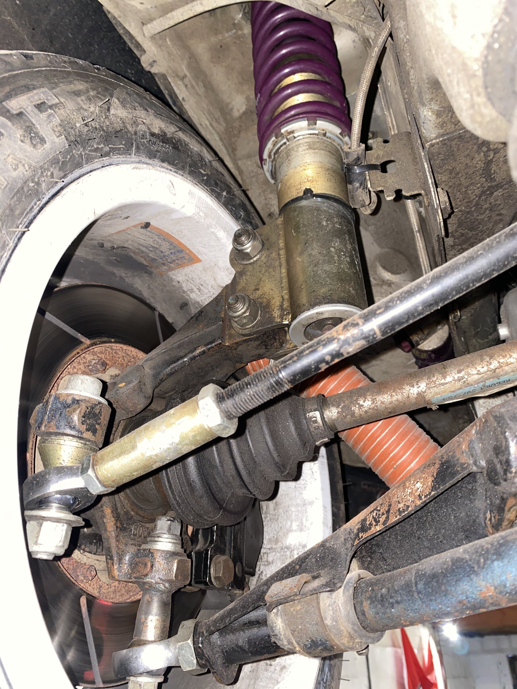

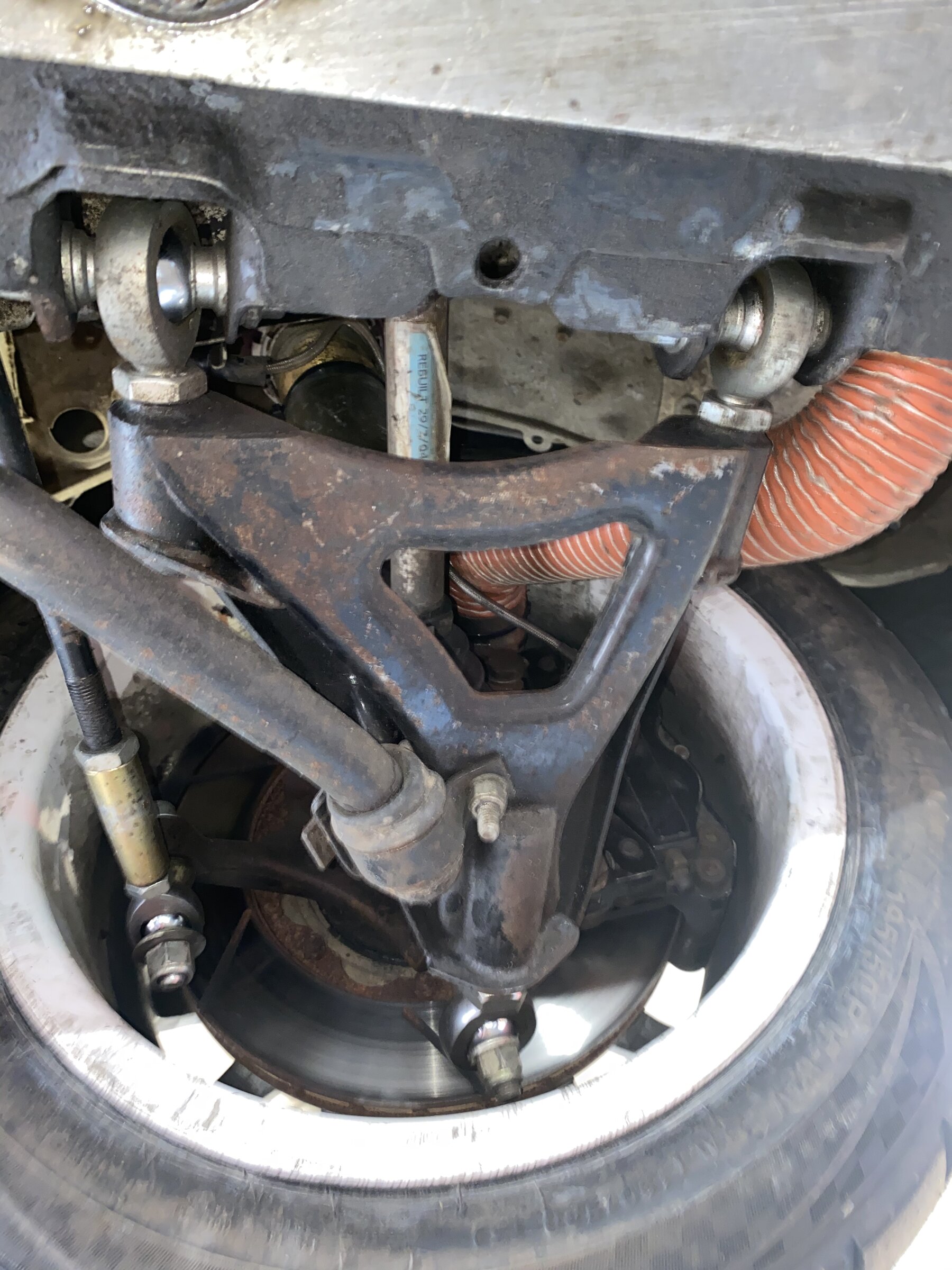

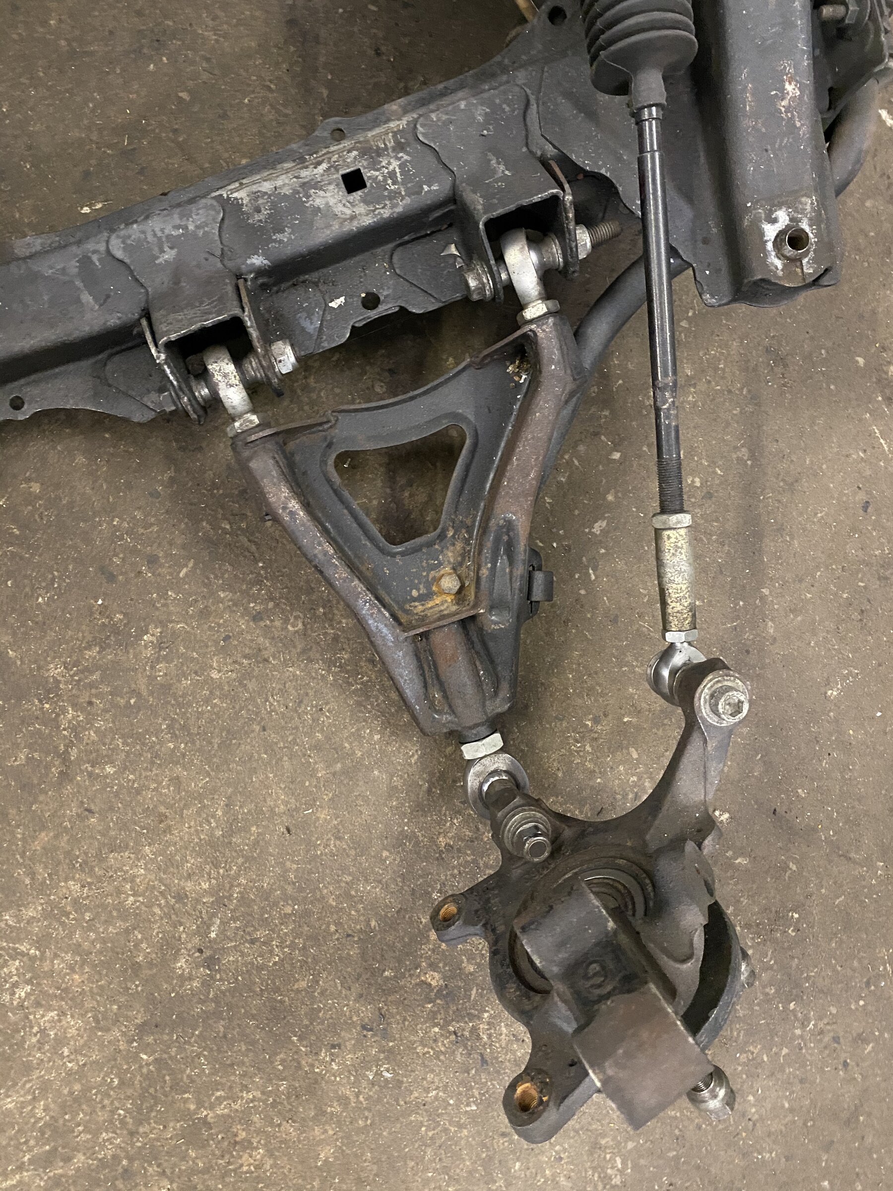

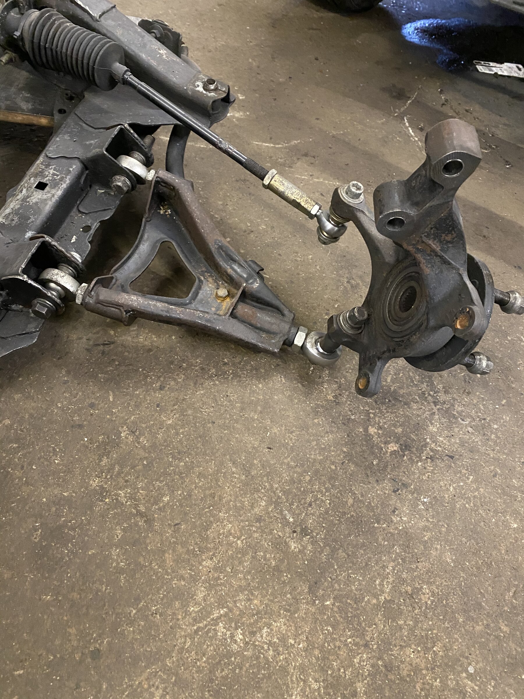

Those rose joints on the outer still worry me a bit.
As for colour, maybe just white so it's clean for some vinyl? Yellow? I like yellow :ROFLMAO:
If you look at anything f2000 or maxi they all use a similar style wishbone that’s fully rose jointed. Time will only tell i suppose. The pin snapping seems to be more common.
I have thought about yellow myself, like the cup racer press car

Yeah I guess you're right. I think the quality of the joints makes a big difference. Just a bit of a concern as I knew a guy in Denmark who broke a couple on an Escort like my old one. Hopefully yours will be alright.
Yellow would look good. I'd probably stick to a flat colour, just so it's easy to match. RB would like quite good, but a factory colour would be a bit boring.

No it doesn’t have reigers in the rear, just some cheap looking track coilover. I’ve been speaking to zoltan this morning about servicing the front and he’s getting me a price for the rear. I do have r3 ohlins 3 way on the blue car, so may end up taking the rears off that.

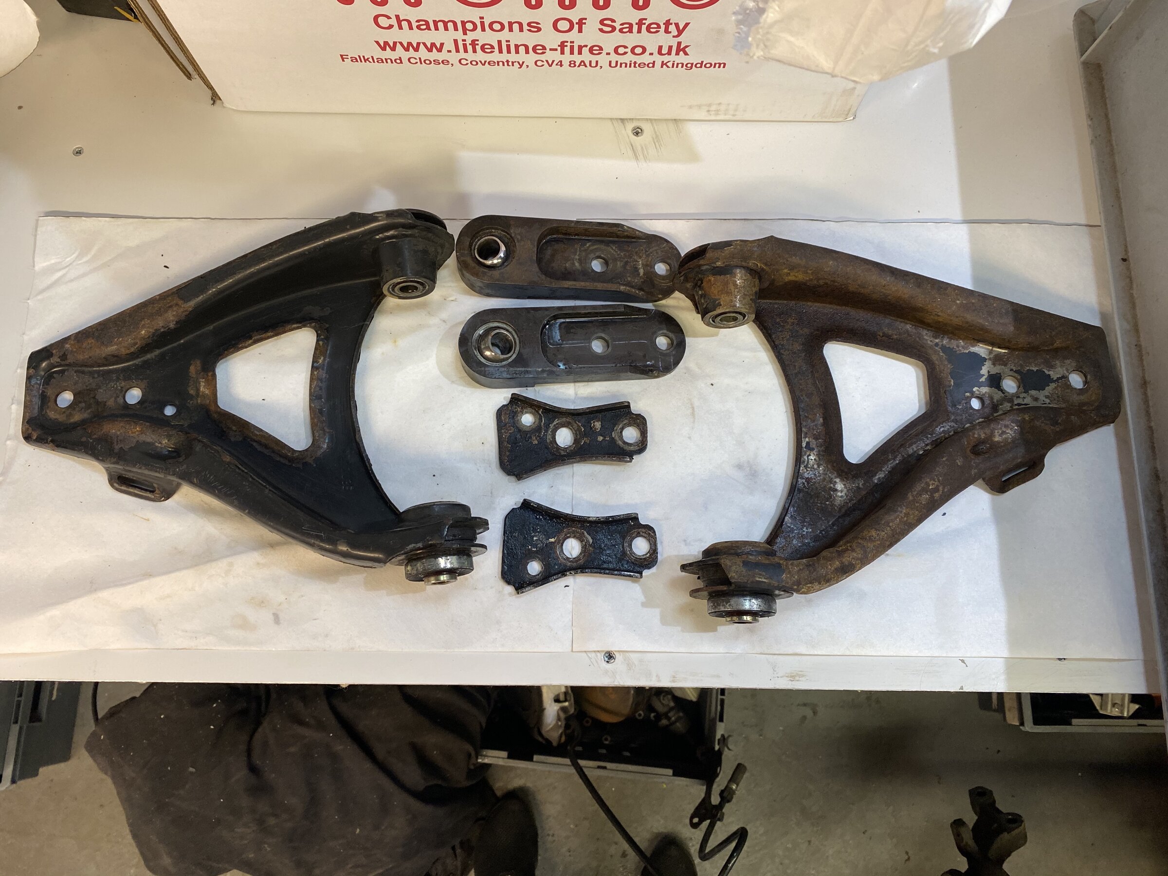

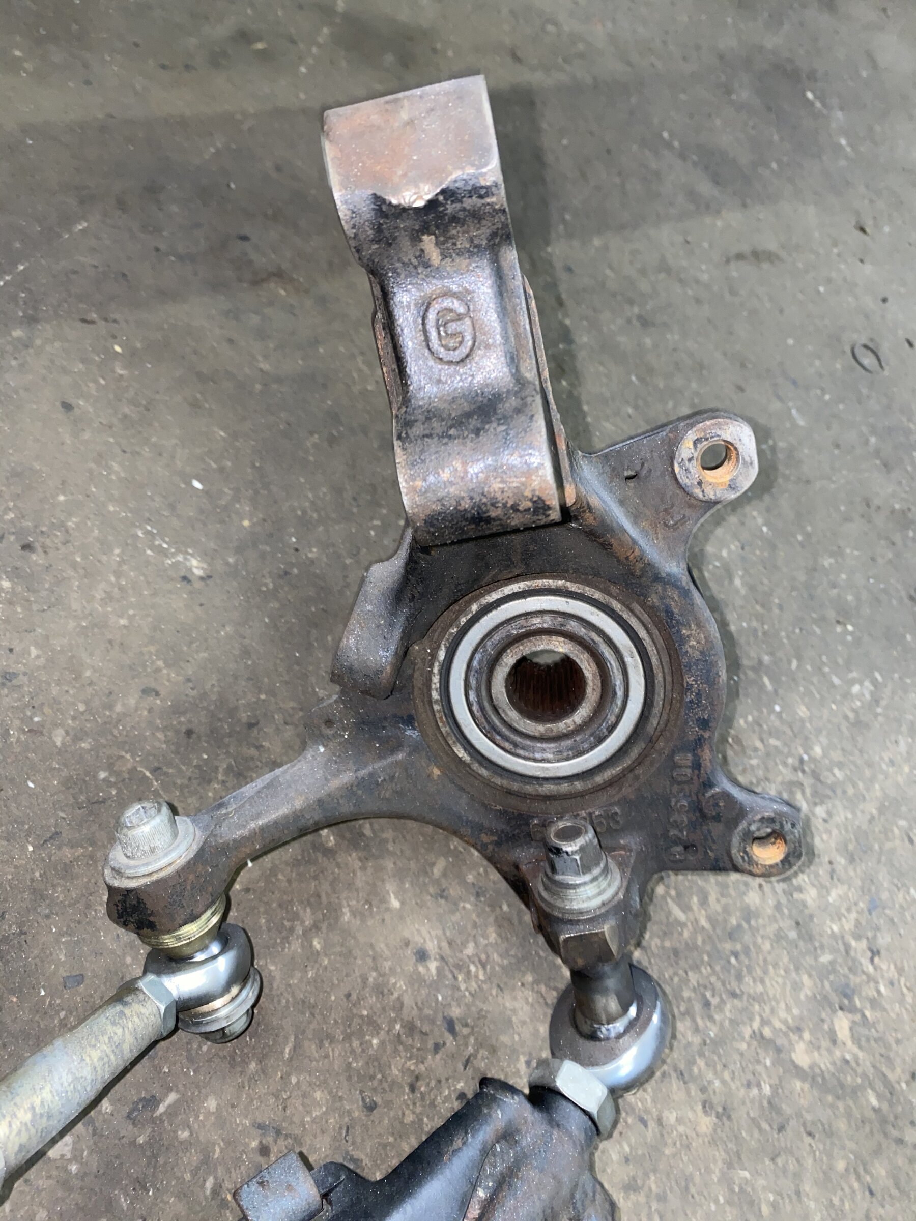

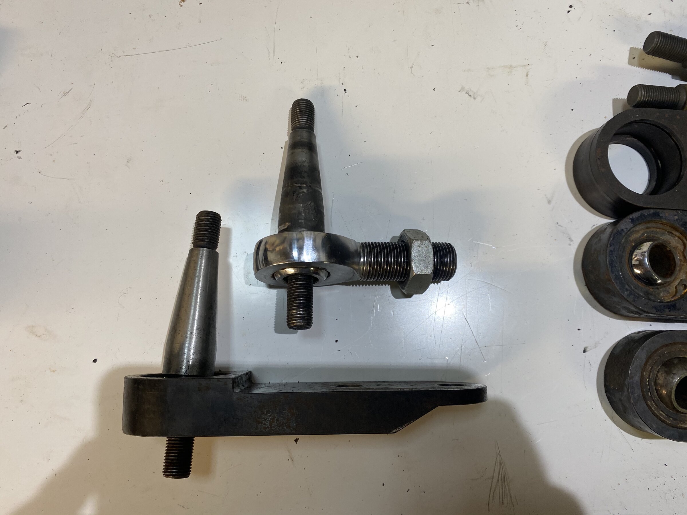

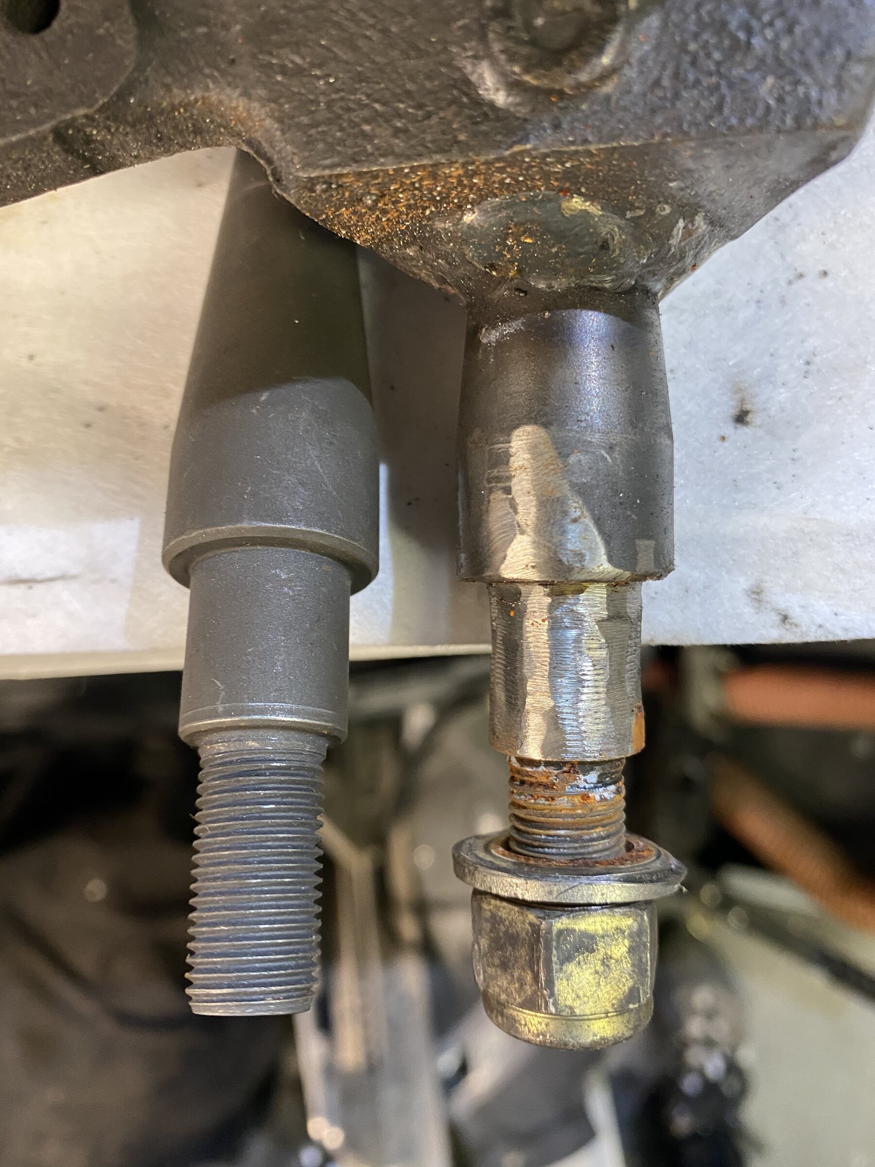

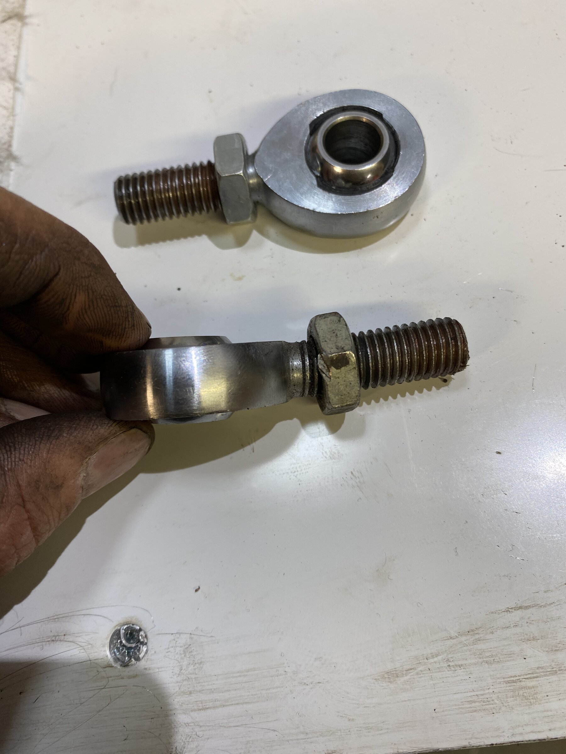

Strip down of the front hubs this week after building up the cup racer wishbones and I found a few issues with what was on the car.
Not sure why they’d pay for the job on the adjustable wishbones to them then not use the correct size rose joint.
They’d just ground the pin smaller so it fitted into the joint!! The pin was also bent like a banana too, to match the pms track rod end which was also bent.
I’ve decided to get rid of the adjustable wishbones and fit the cup racer ones with new pins and bearings.
I’m still undecided whether to buy a new bump steer kit or just buy new inserts and run standard track rod ends

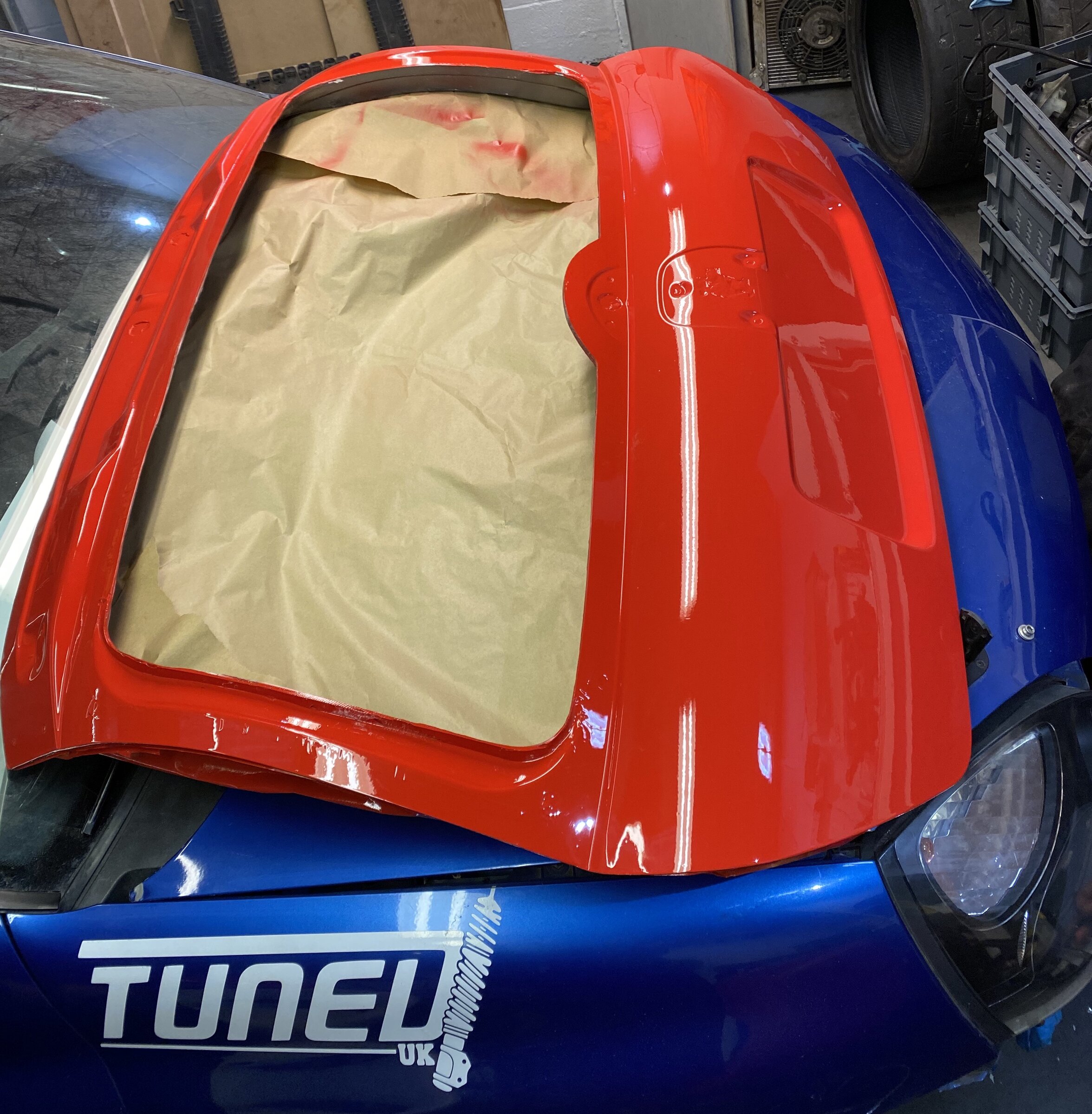

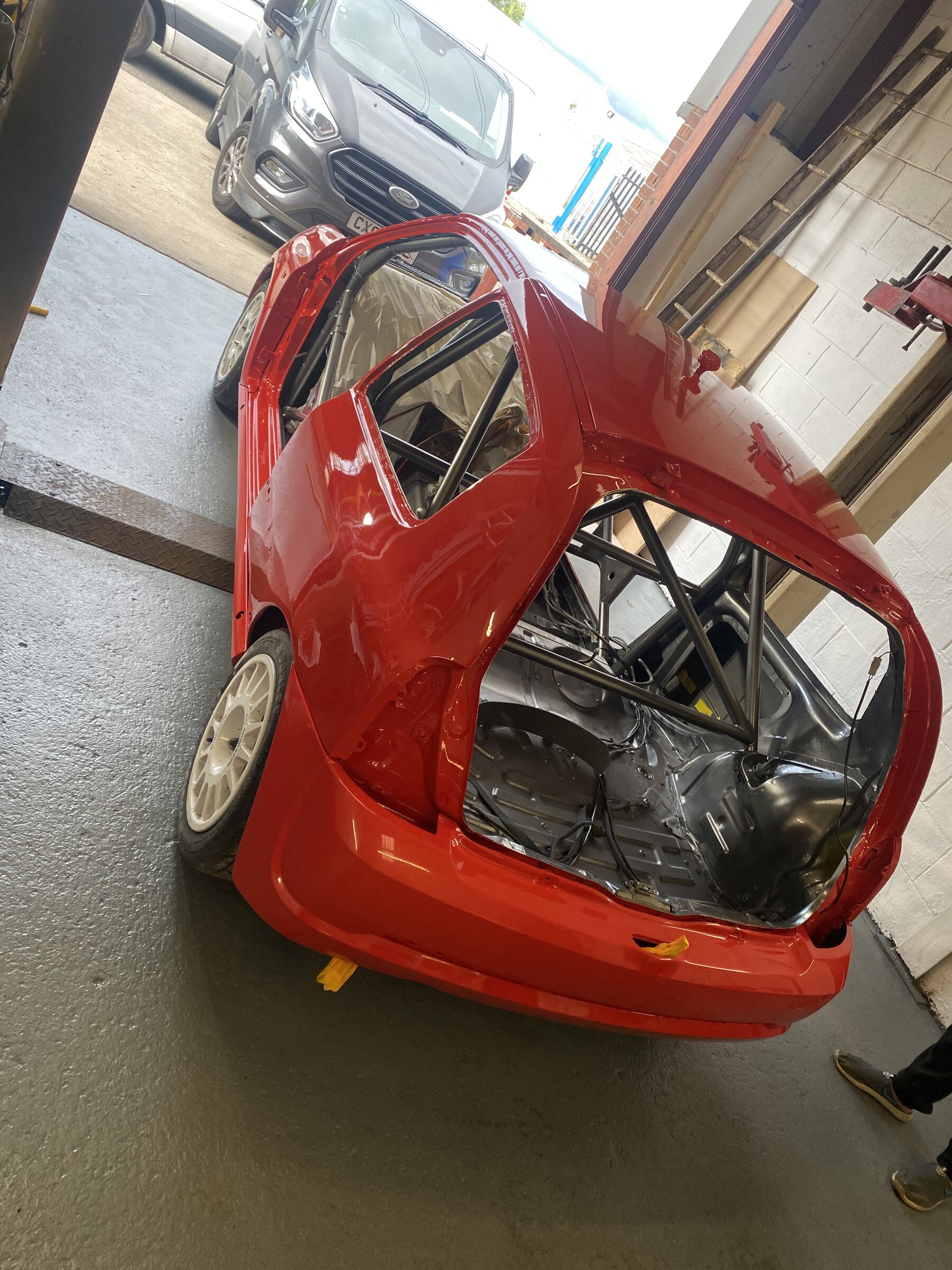

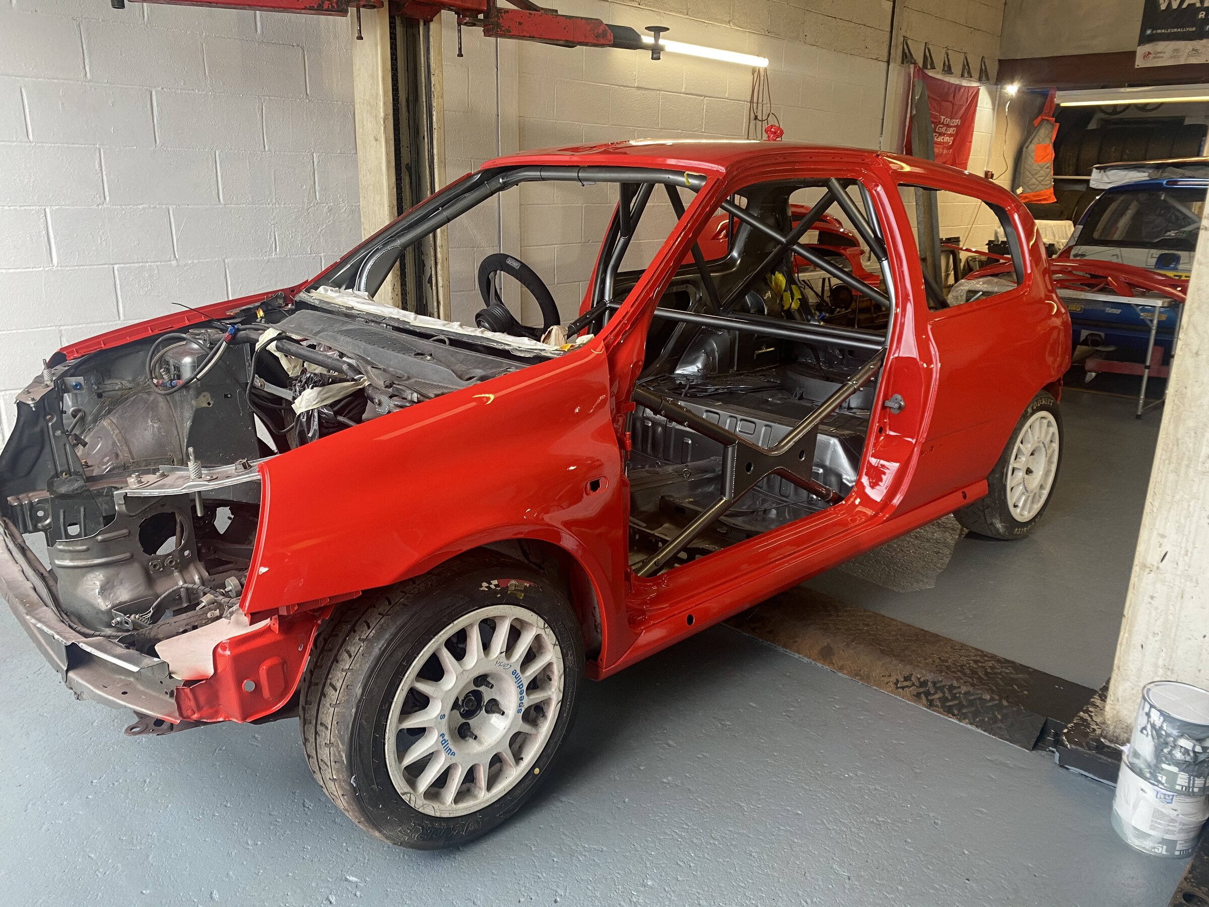

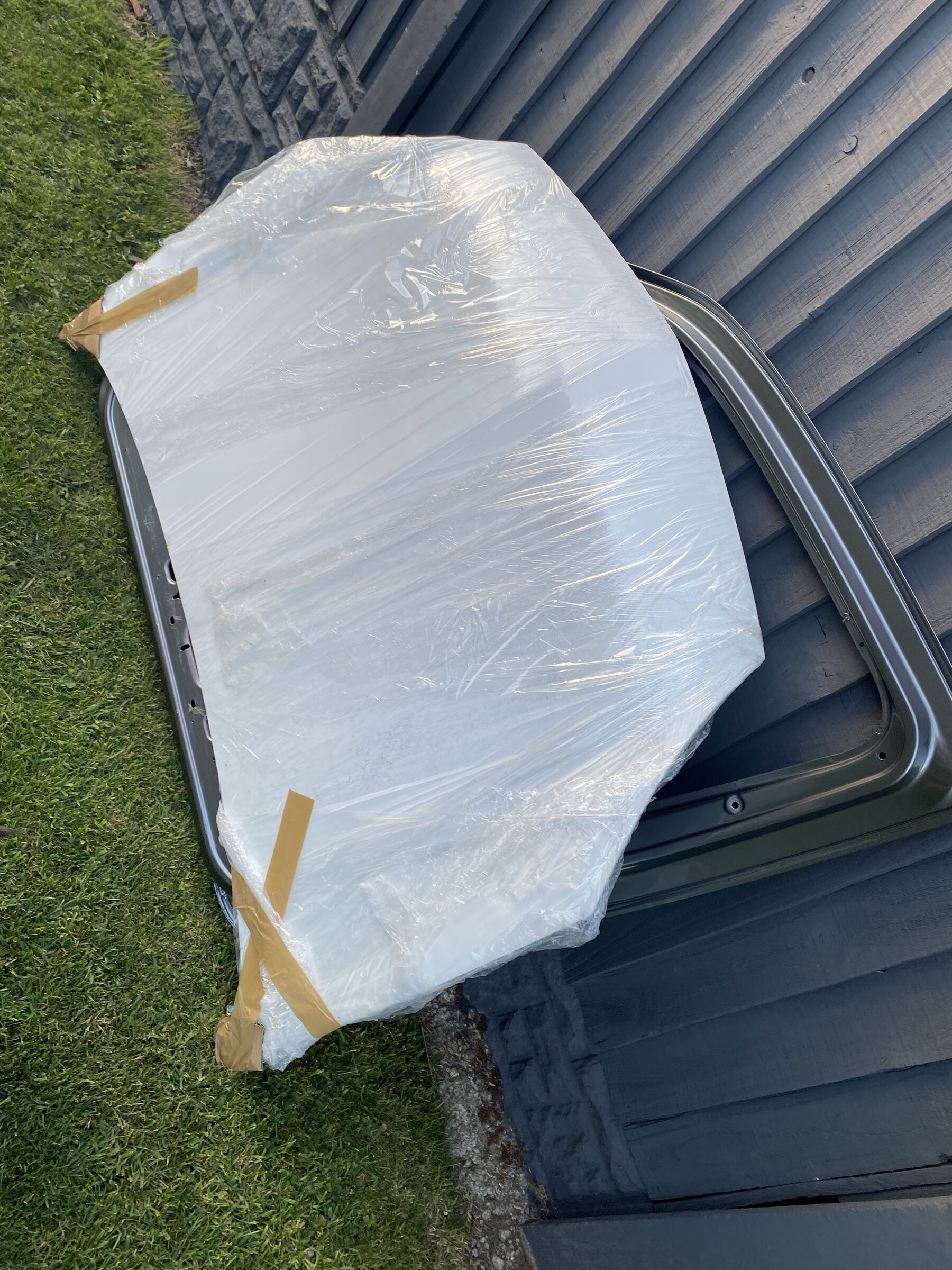

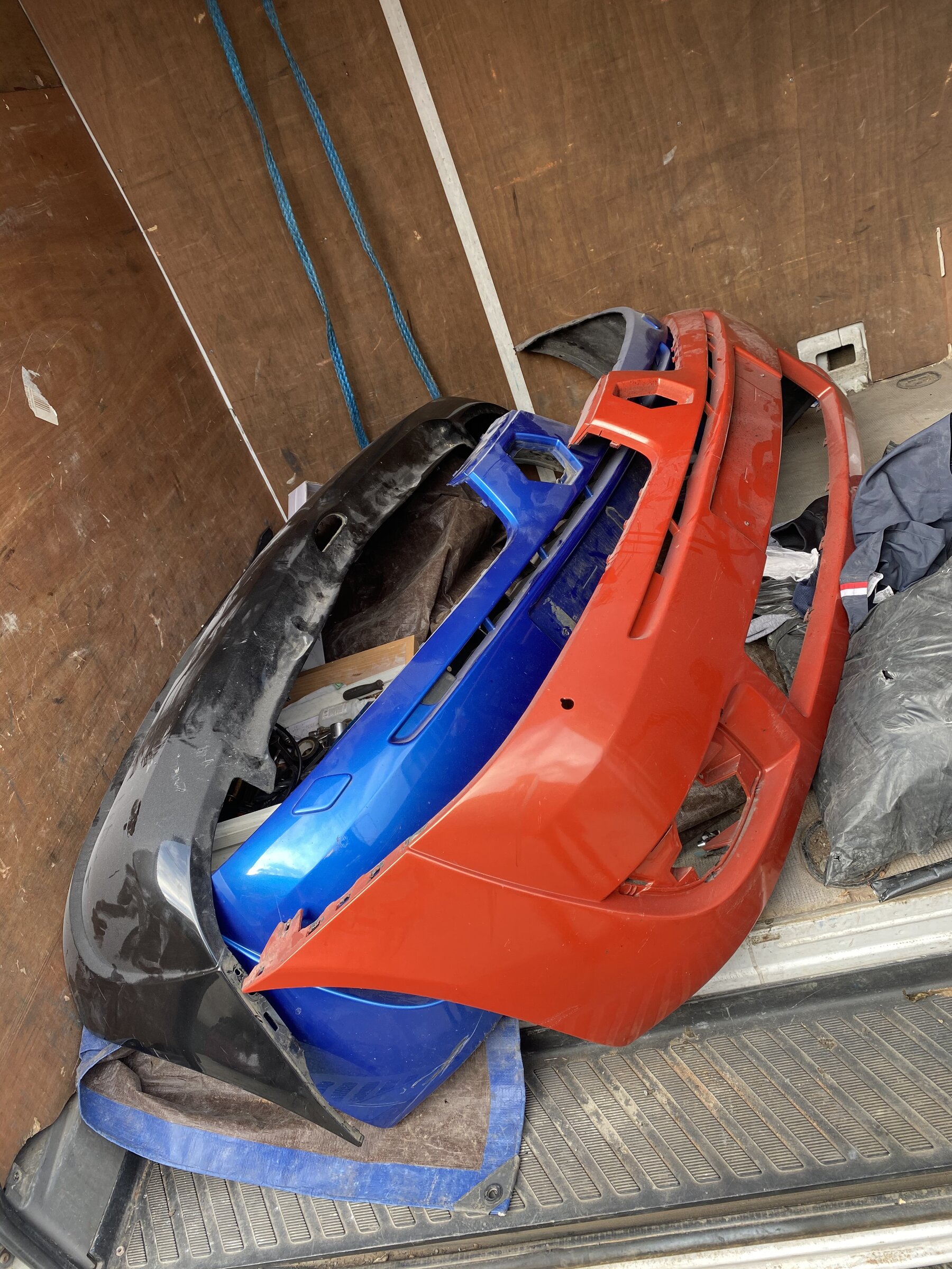

Few more panels collected, just the shell next

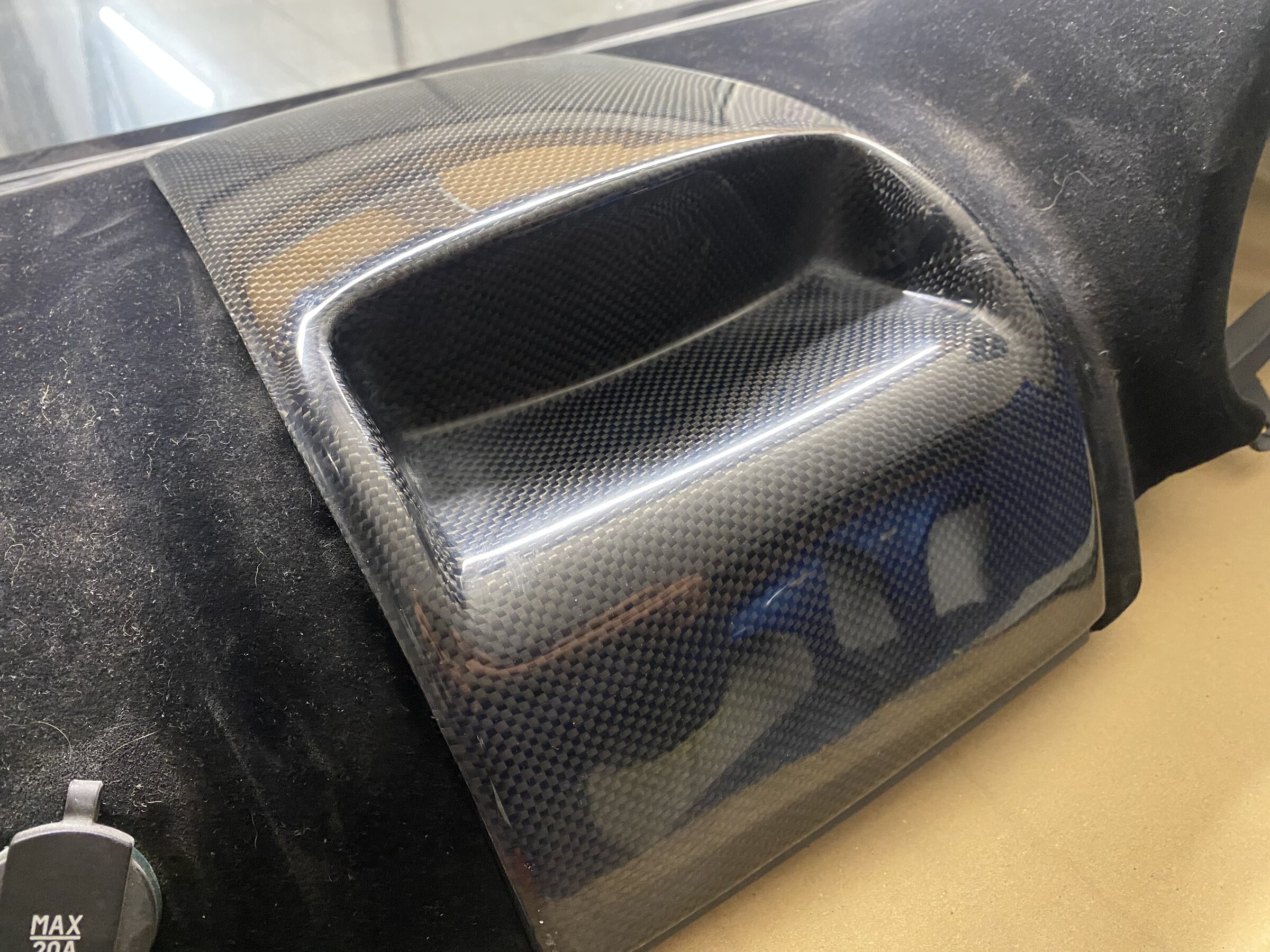

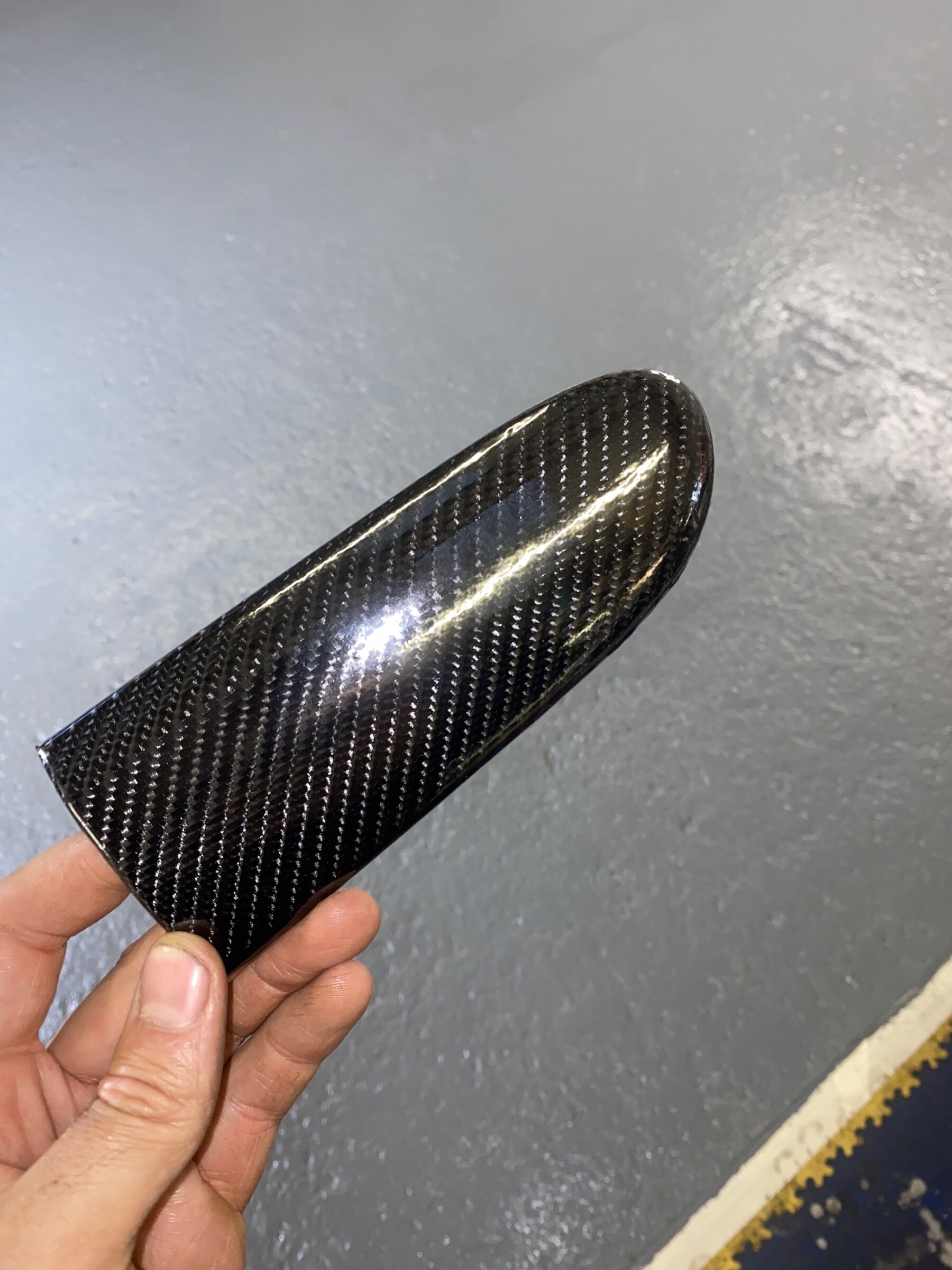

Door bullets sanded and carbon wrapped. I am having a few parts carbon skinned so tried wrap first to see how it would look

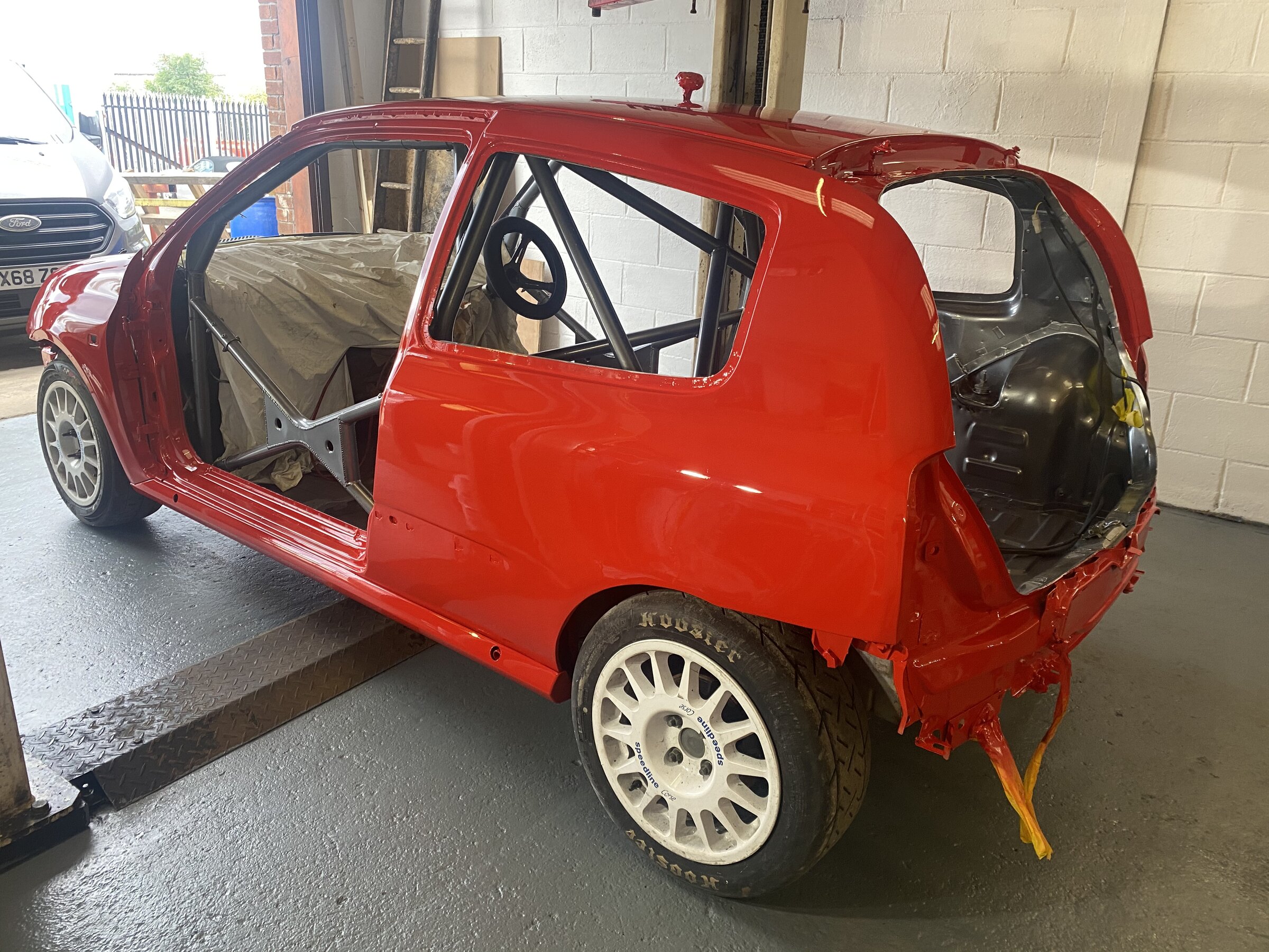

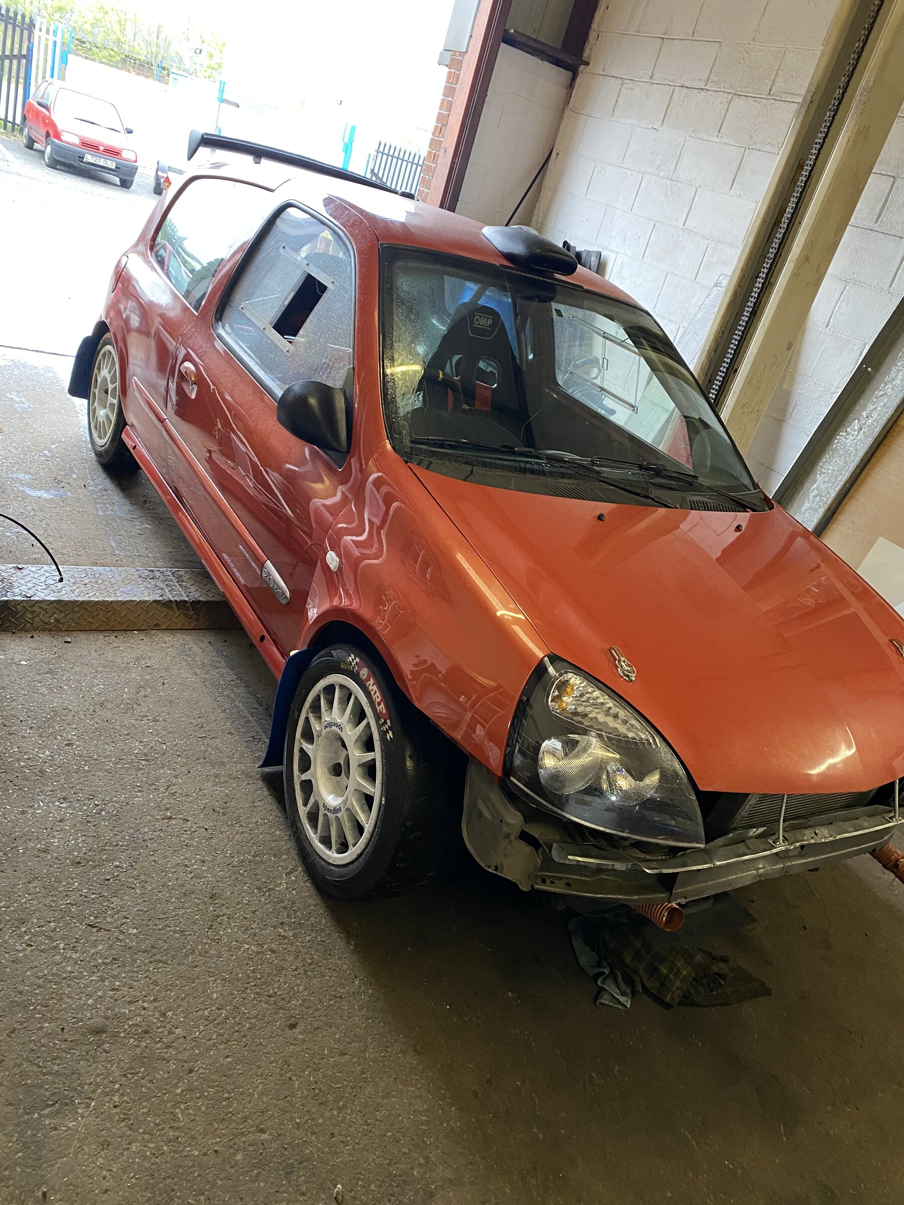

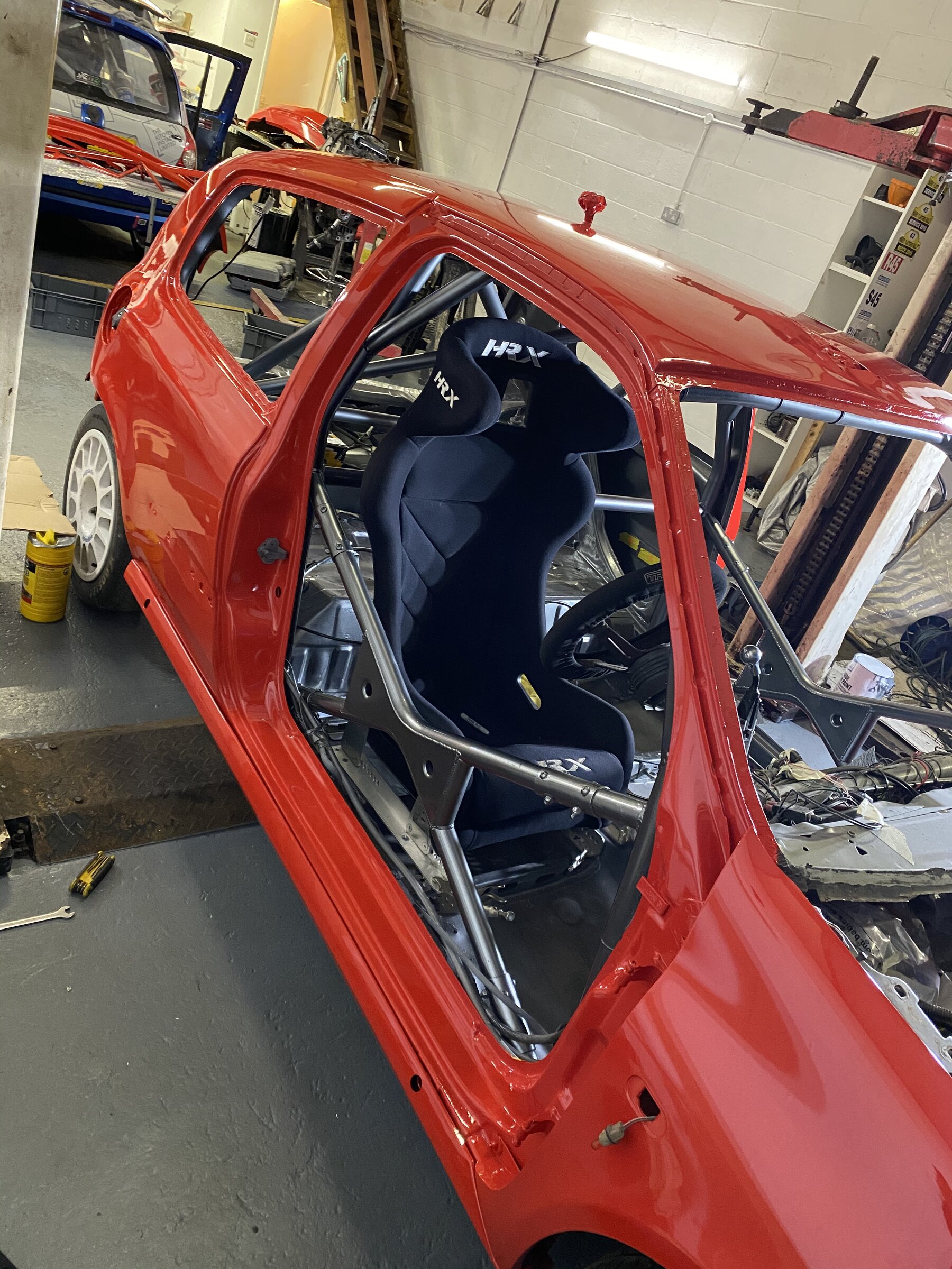

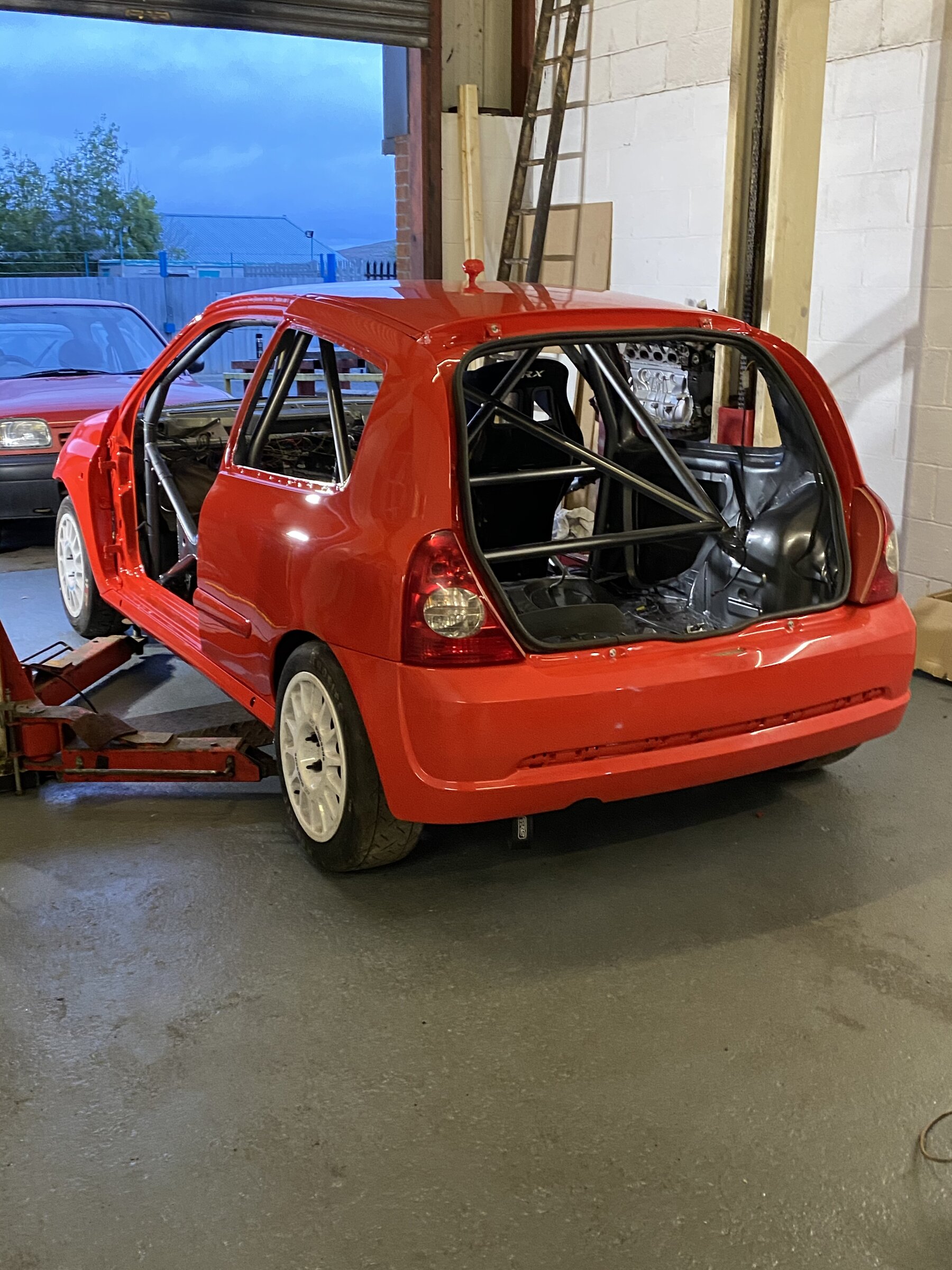

Picked the car up today and the colour looks better than I ever imagined. The pictures don’t really do it justice, it’s so bright.

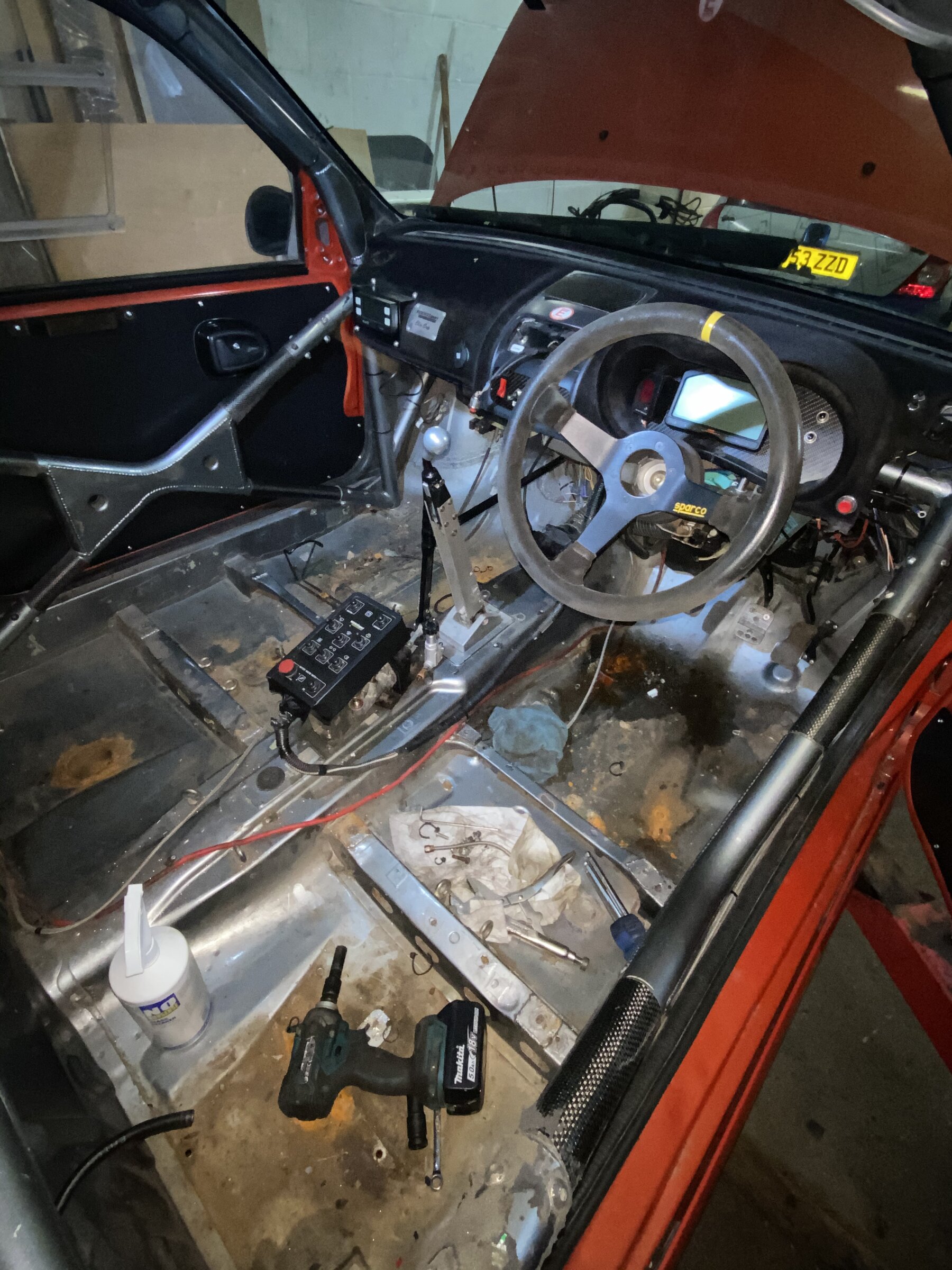

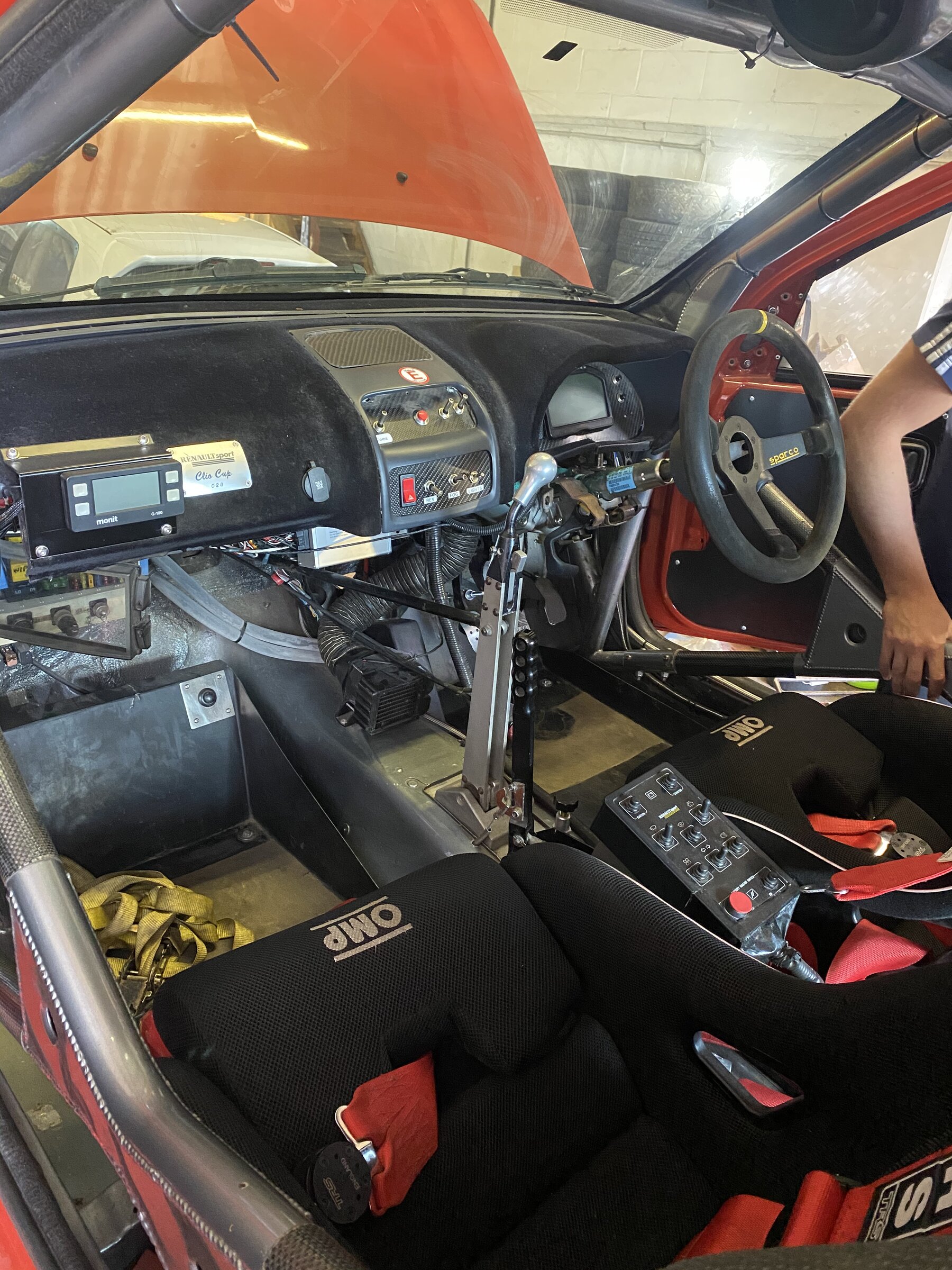

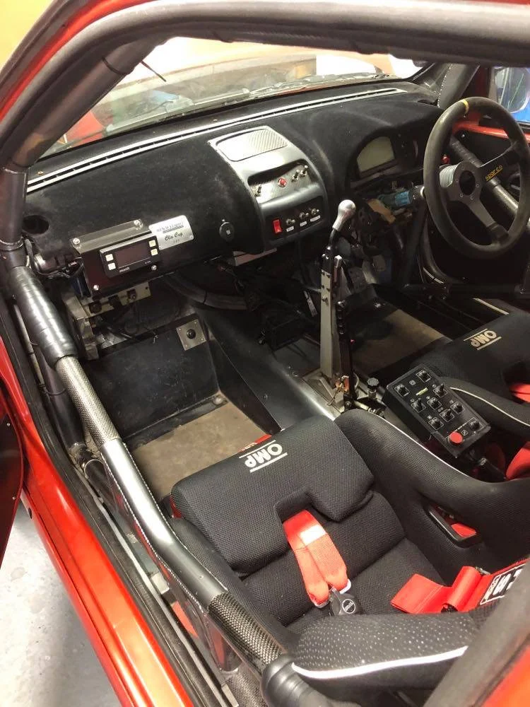

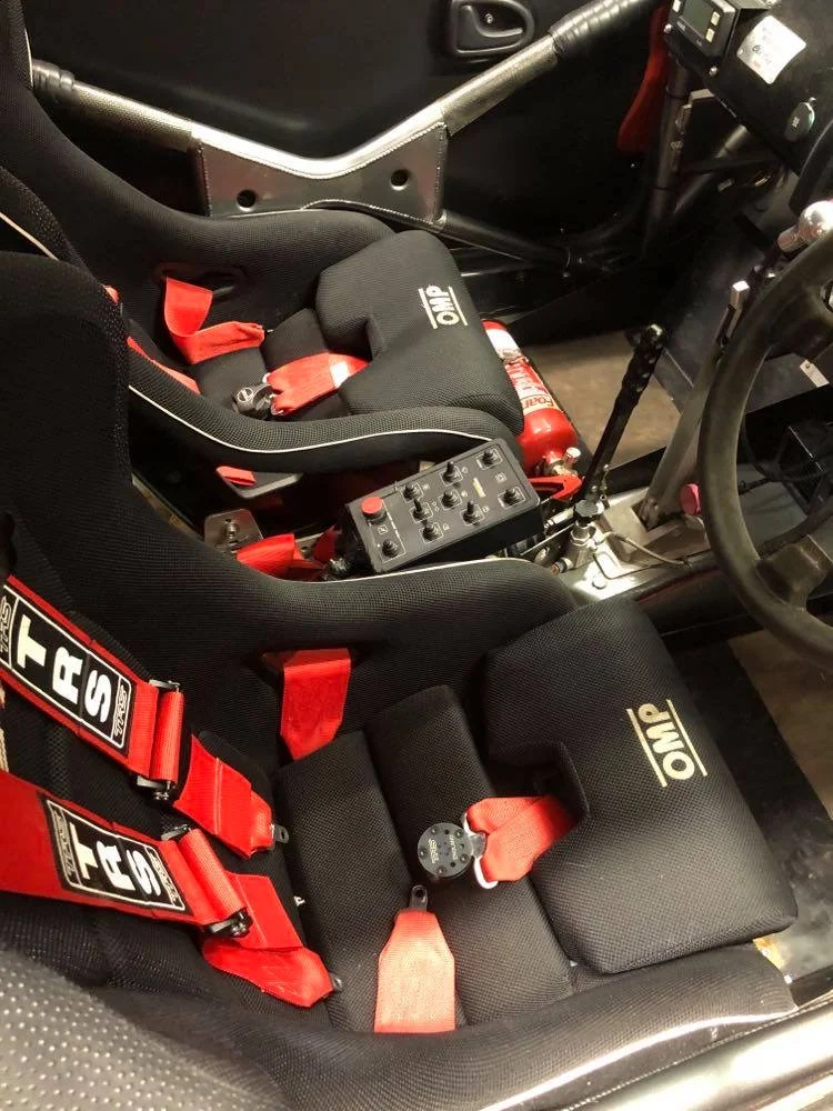

Spent most of the evening getting the seat fitted, now I can work everything around that with the extinguisher going behind it.

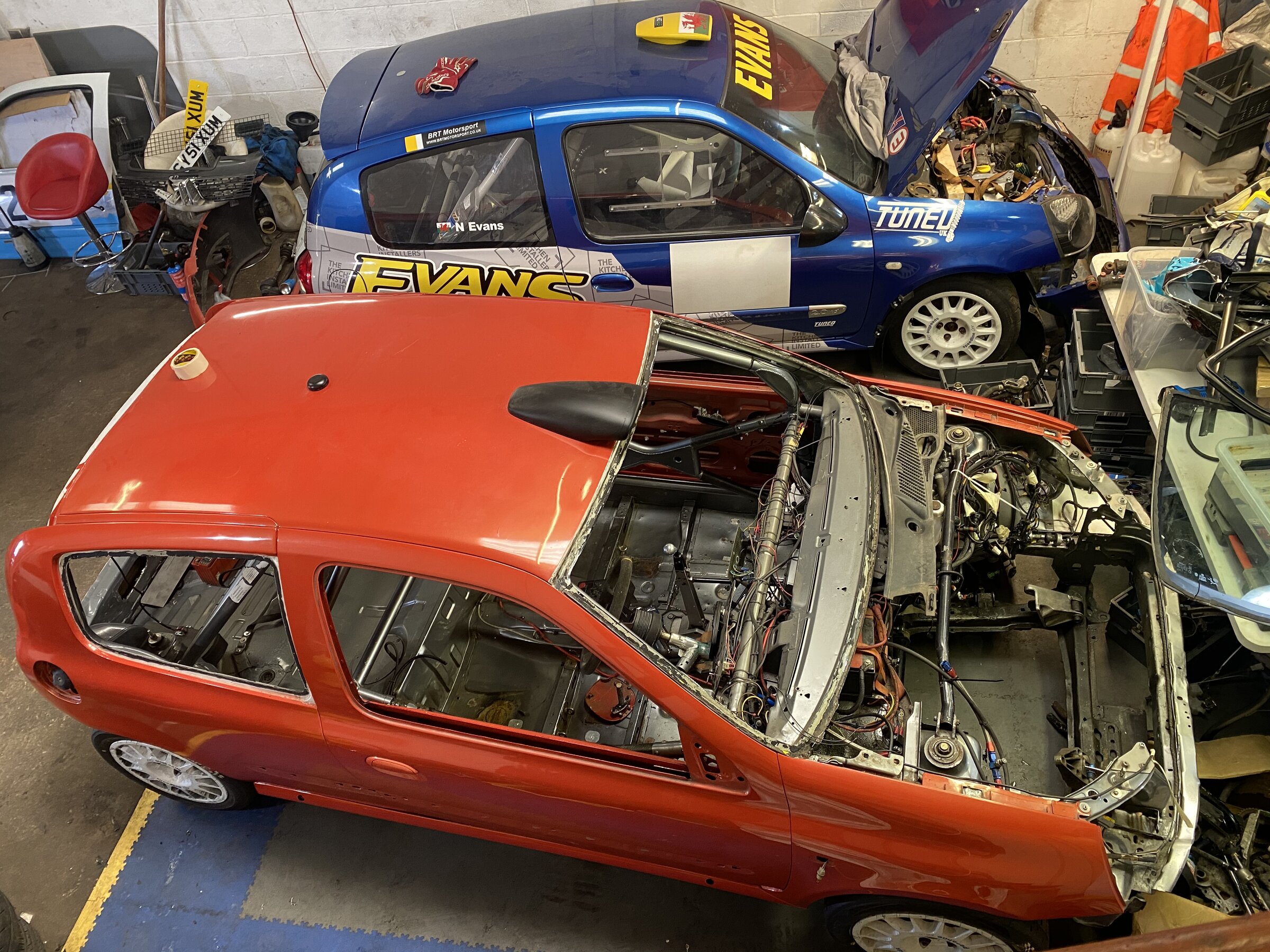

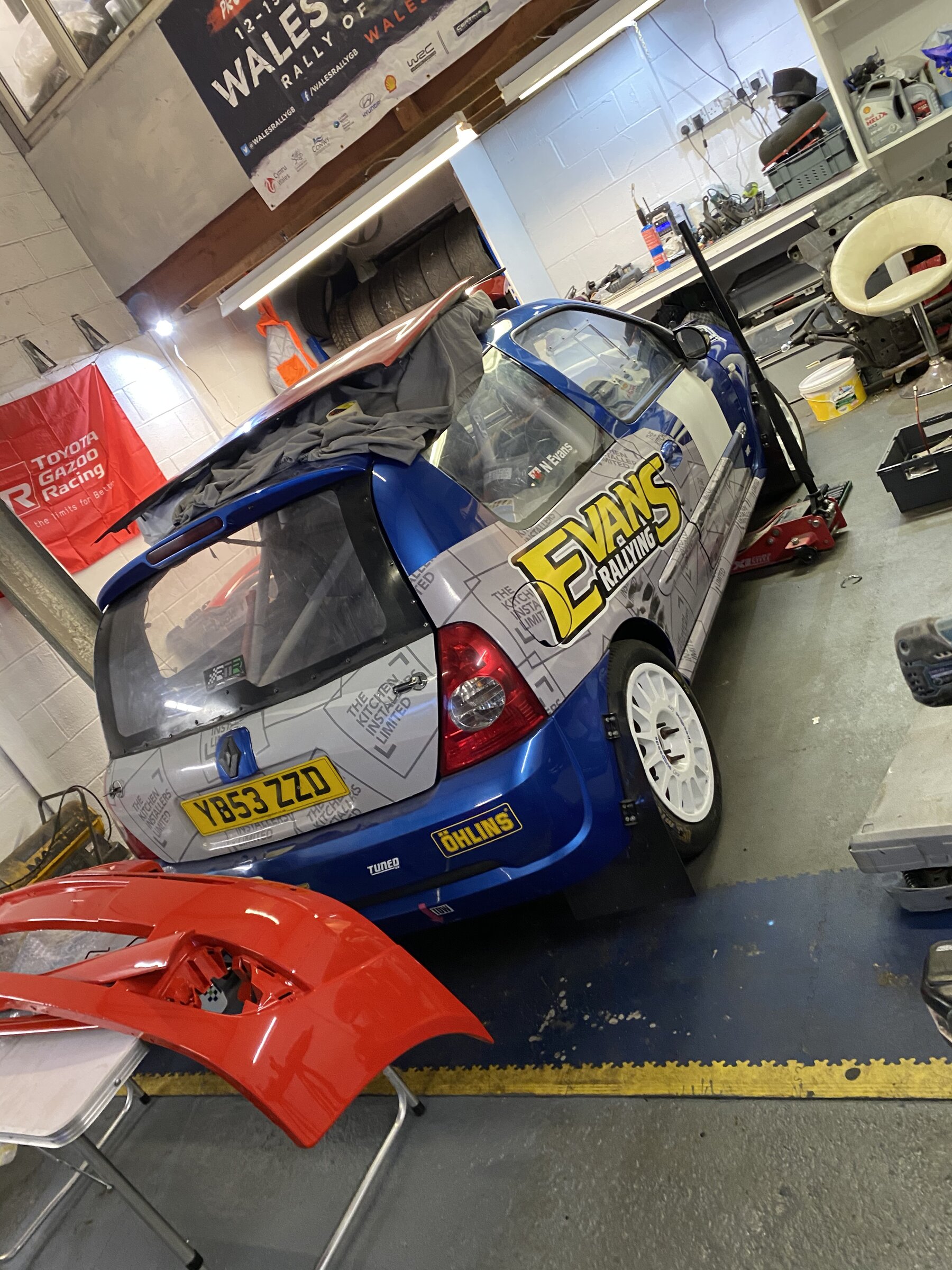

My brother has sold his civic and bought the blue car off me minus a few parts I’m taking over onto this one.
It will be pretty much identical spec to when I had it, just on 45mm bodies not 48mm.

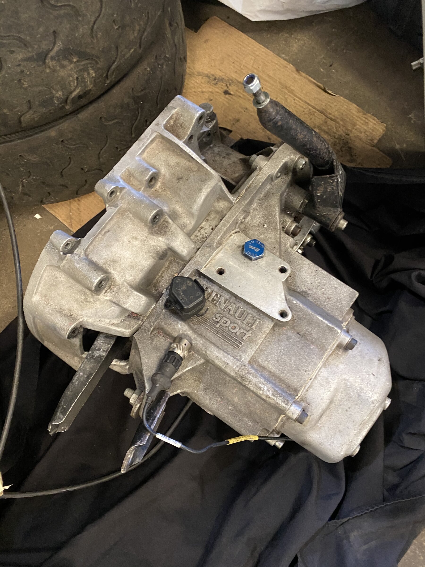

Currently having the gearbox rebuilt and diff serviced, as soon as that’s back we can start building it back up
