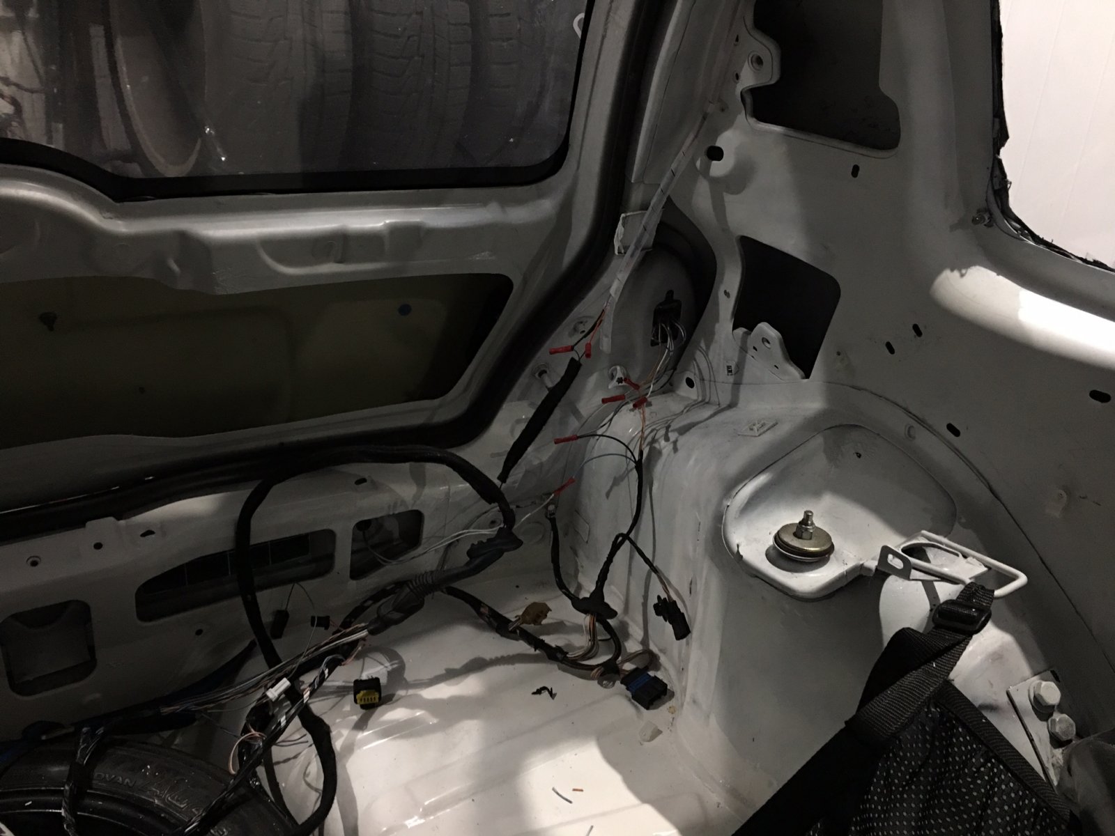

Slow progress at the moment. Spent quite a bit of time sorting the wiring. Front headlights are easy, just plug straight on the megane loom as same connector, rears had to play around with a spare battery to work out which wires corresponded to which on the clio loom I left attached to the lights and then spliced it onto the megane loom. Fuel pump and level 4 wires, 2 larger ones are the pump ground and eath other two go to the petrol gauge. Tidied engine bay wiring and connected wipers up - bit of trial and error required to get it right. Then onto switches - have 2 buttons for start / stop (well one is for the clutch switch the other is start / stop) so press both for engine start, also wired up hazards, washer jets, cabin heater and engine fan override to my switch panel and attached DRE shiftlight back to the top of the column.
  M135i, 197 turbo

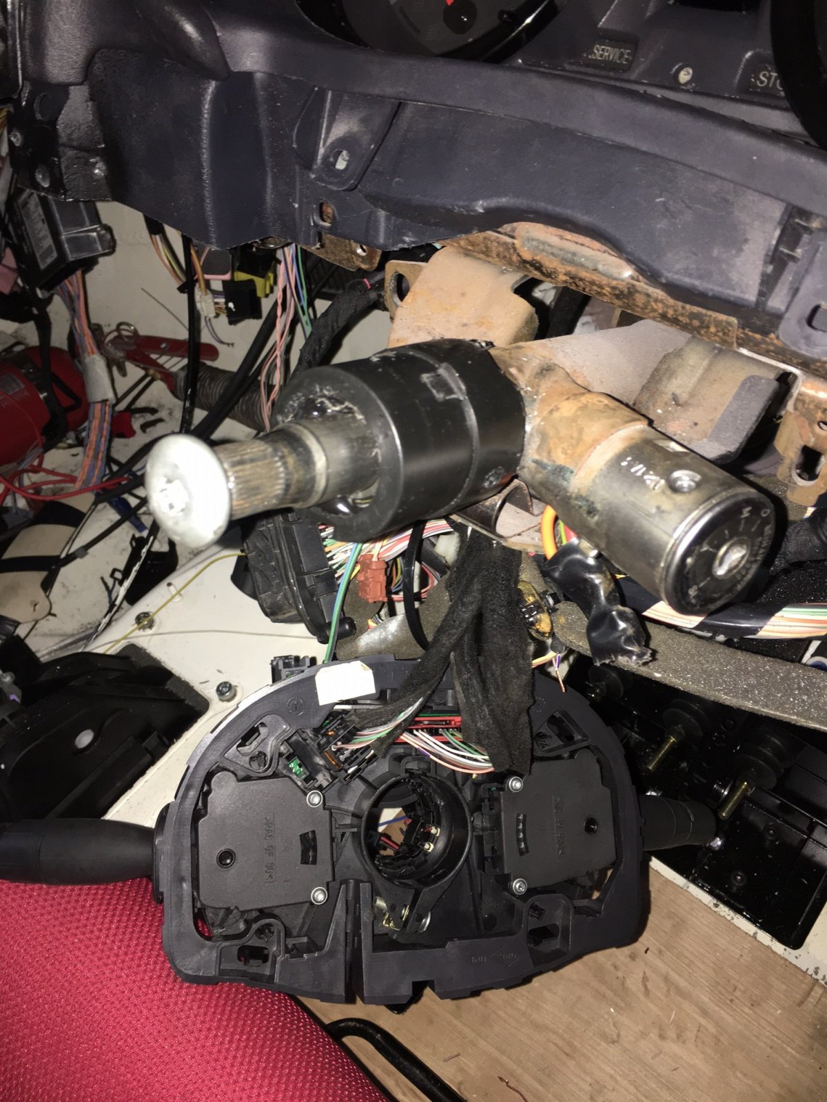

In terms of fitting the megane stalks you can fit this collar off the megane column after dremelling out the inside that the megane stalks mount up to

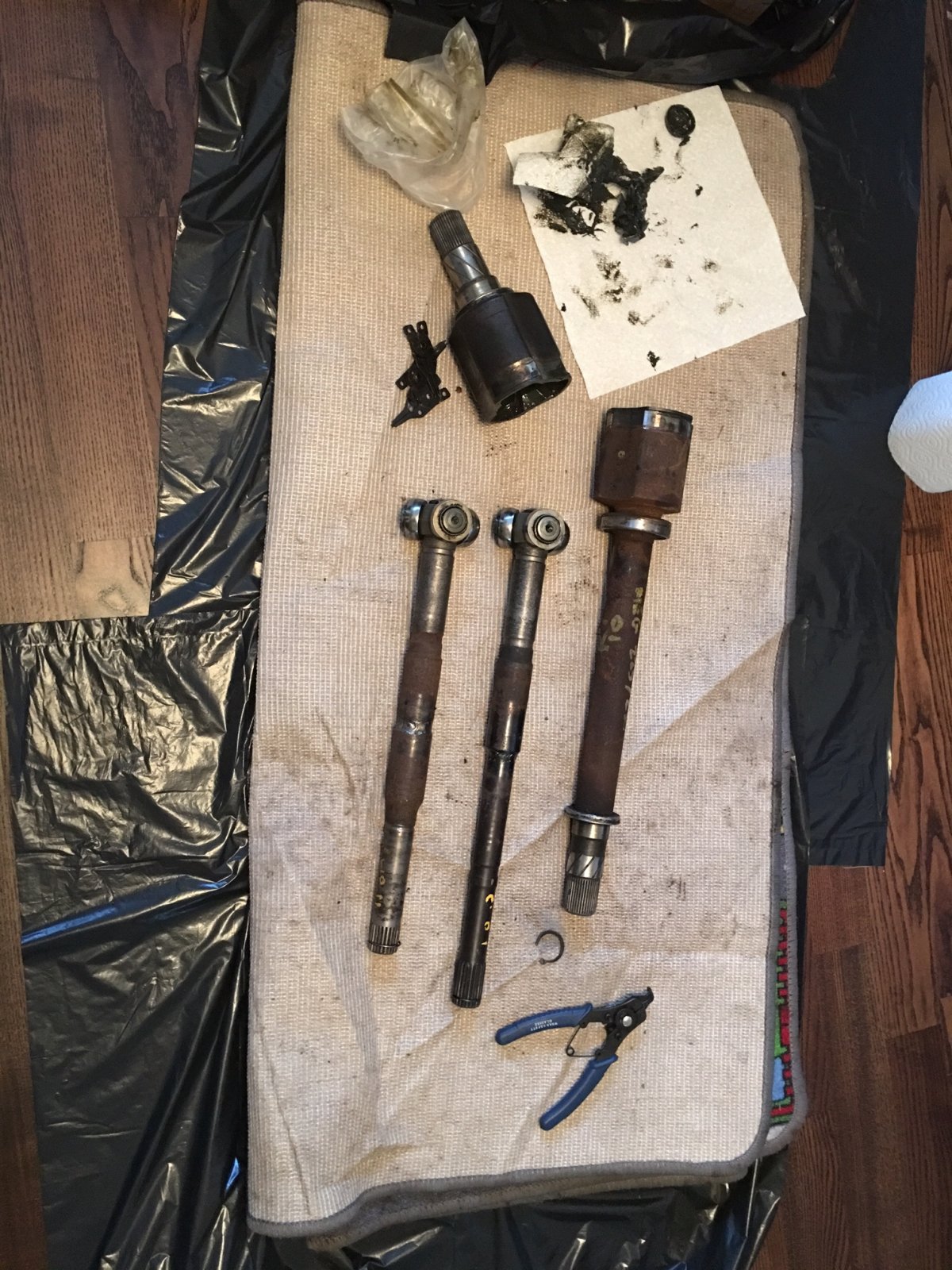

Also finally got around to putting the driveshafts together. Got new inner boots from ECP, then found I didn't have any outer boots so ordered those last night but should have them together in a couple of days

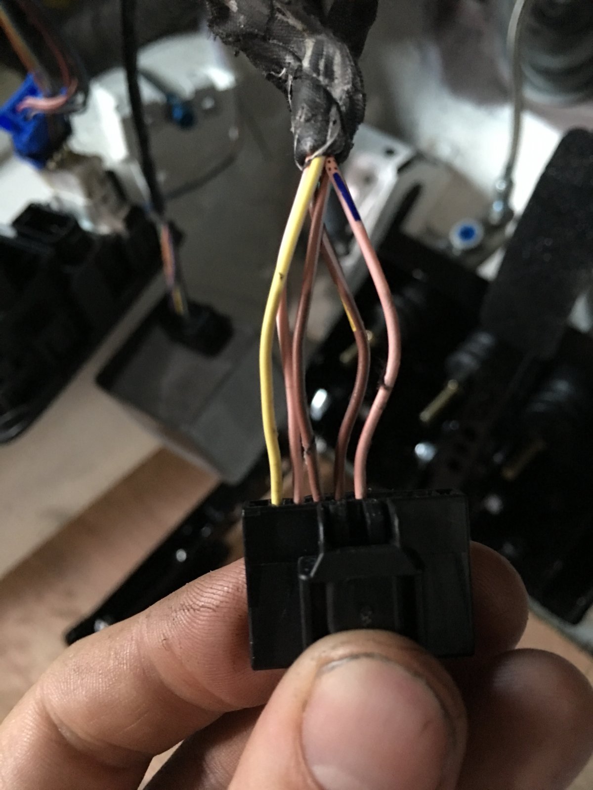

Plugs for the eps ecu, luckily I took this before I chopped it off. Bridge pins 4 &5 and 6&7
Got the driveshafts assembled now, meant to measure, but forgot, in case I need anymore making

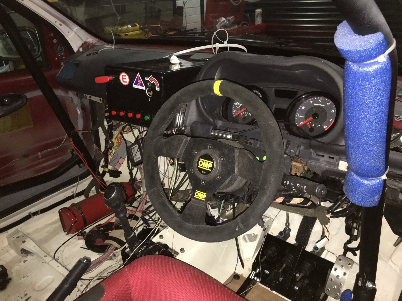

Wiring all connected up, still need to chop loads out but that can come later. Brake and clutch lines in, system bled. Bleeding the clutch was a bit a head scratcher as it turns out you release a clip on the slave cylinder and then slide it back a bit to open the bleed nipple. Got an Eezibleed and made light work of bleeding everything. Need to nip up the connectors on the reservoir tonight as ones weeping a bit.
Picked up replacement suspension to front hub bolt as one was fubared so that can be changed. Then it's wheels back on and on the ground.

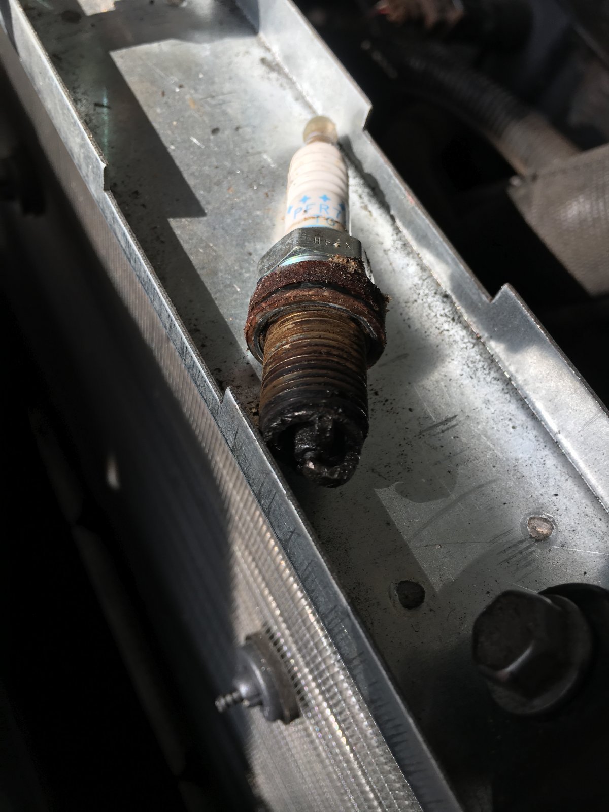

What a shite day 😧
Started well, got to Oulton without any issues, car behaved perfectly, temps all good, boosted well. Went out for sighting laps and everything good apart from engine temps hitting the bottom of the red even with the rad fan running permanently. Removed the front grill sections which sorted the overheating, and swapped onto cut slicks and went back out. First mistake hadn't checked pressures as they were a 2nd had set off Ebay and completely forgot they were cold so went straight off at Cascades. Went back into the pits lowered the pressures and went back out. Did a couple of laps at moderate speed being overtaken by everything, cranked it up a notch to 80% attack, rapidly caught a clio that had passed me half a lap back, full boost down the pit straight, wont rev past 5000, sounds ill, after cascades running very badly. Limped back to the pits, it's running on 3 and rattling. Also got a terrible oil leak that's appeared from god knows where.
Decided to limp it home. It's smoking progressively worse on the way back, sounds like a bag of spanners when reved.
On the plus side the pedal box and RC6 pads are brilliant, massive stopping power and really good modulation and feedback. A048 tyres also huge grip when you've remembered to warm them up.
Now off the garage to start pulling it to bits to see what's occurred. May use this as an opportunity to put an R26 gearbox in with LSD and stick an RS250 turbo on. Just not doing it at the same mad rush as before.
What's annoying is when it had ITB's we gave it death everywhere and it didn't miss a beat, but it's a gamble sticking an engine in when you don't know it runs well, only have anothers word for it.

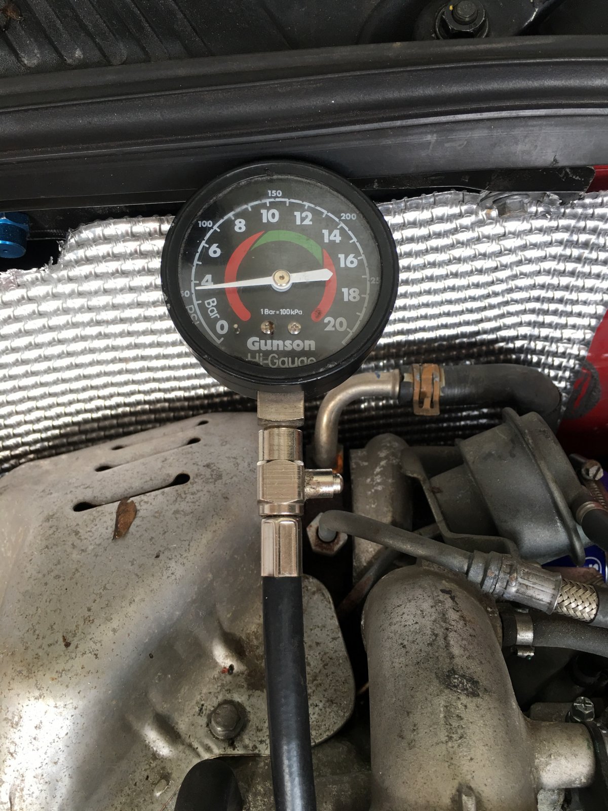

Shite compression across all cylinders, best is 75psi. No gunk in oil or coolant. Engines coming out now regardless
:confounded::confounded::confounded::confounded::confounded::confounded::confounded::confounded::confounded::confounded::confounded::confounded::confounded:
I know it's too late, but a compression check before would of been :up:
  M135i, 197 turbo
I did. It was okay when I checked it before starting it after installing it. Good figures across all 4, but slightly lower on 1

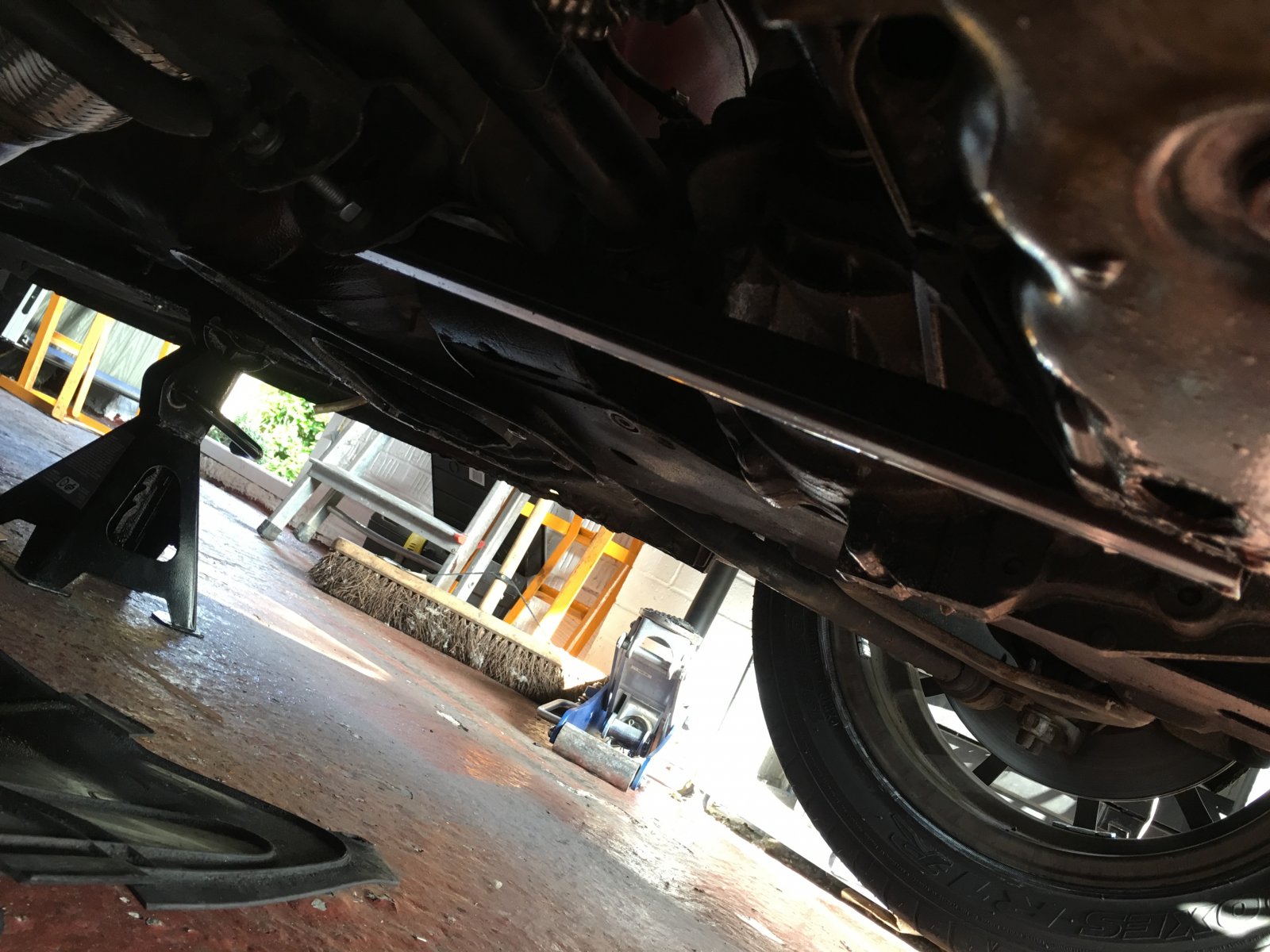

@Mash. heres my fancy lower engine mount whilst I'm pulling it apart. Works a treat and the vibration wasn't much worse than with polybush black series dogbone
