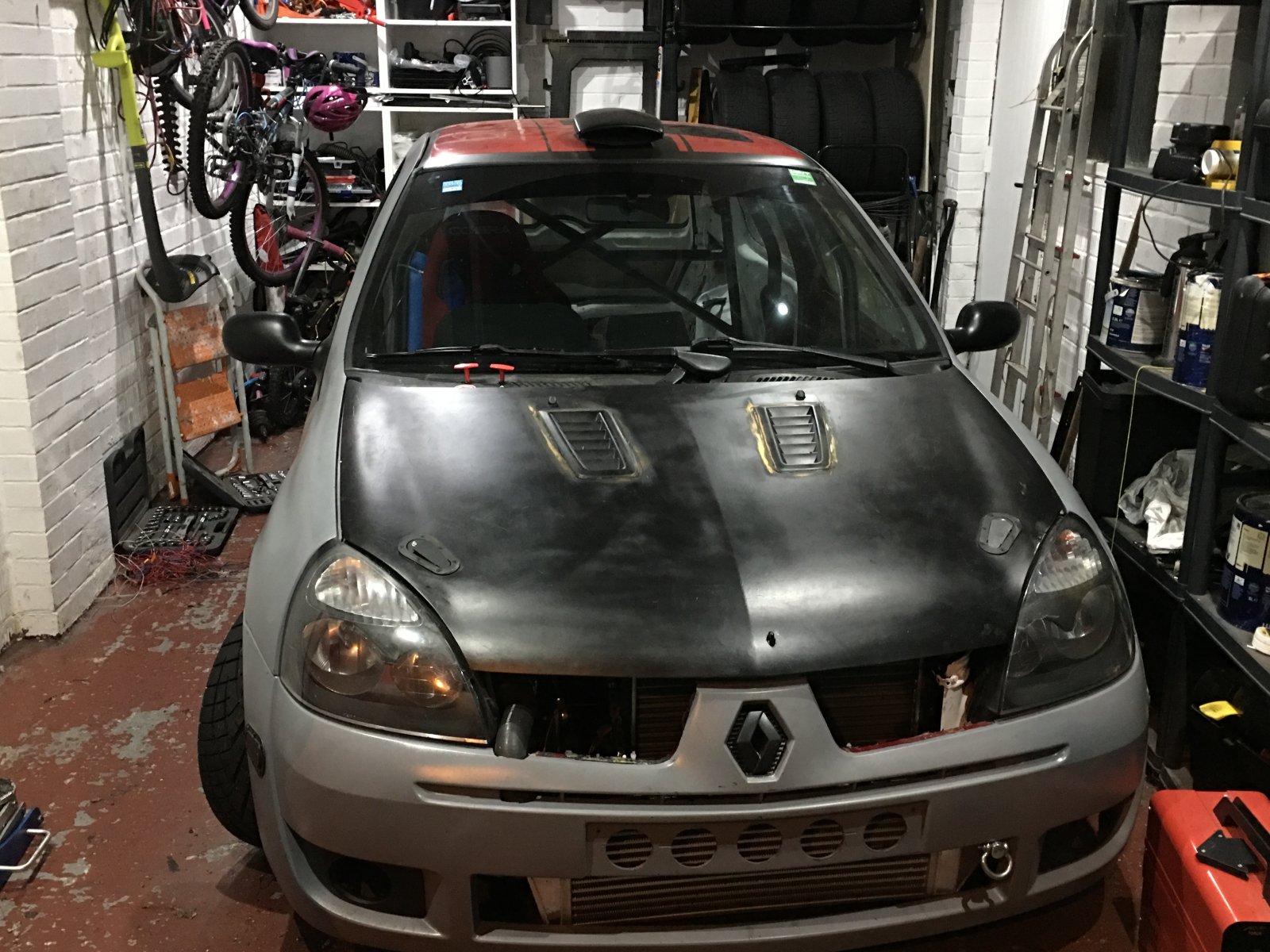

It lives. Again. Only briefly though, won't idle. Checked compression and 165psi across all 4. Two nice looking spark plugs, 2 fouled. Assume coil packs so see if I can get some new ones tomorrow.

I hope this isn't offensive bud, but I love how rough this thing looks lol
Just no messing around, straight in there and get the job done approach!
No offense at all mate! I know it's rough around the edges, and I love how it looks. Bonnet does need respraying, well re-rattle canning, as had to sand it down where I bonded the vents in.

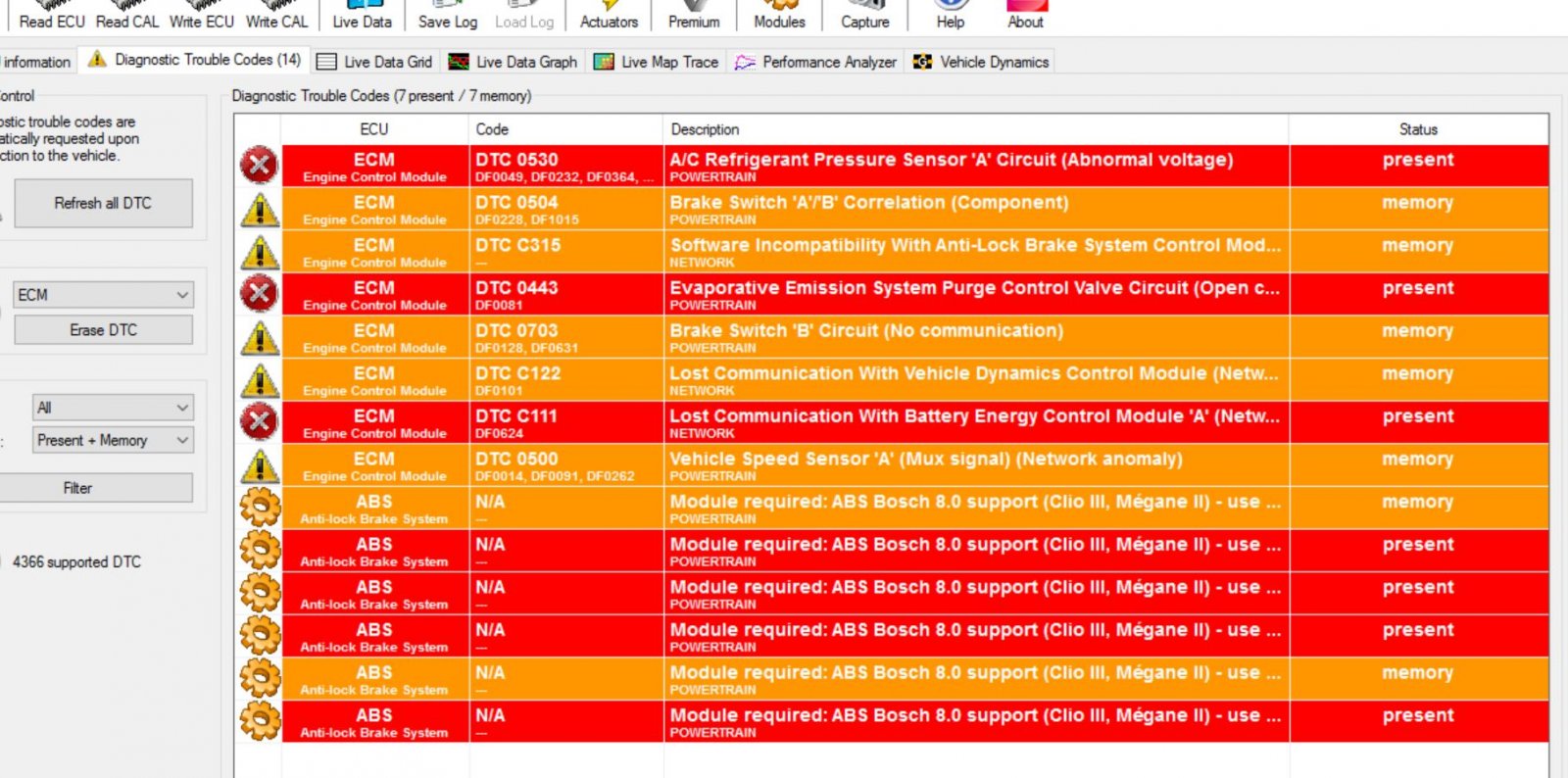

Errors showing are below
All the above is expected apart from vehicle speedo sensor A - anyone know what this is? hoping it's the crank sensor (or wiring) for an easy fix. Can't be arsed changing the engine again if I've been sold a knackered one. Seriously considering breaking this thing and getting a lotus 220 turbo

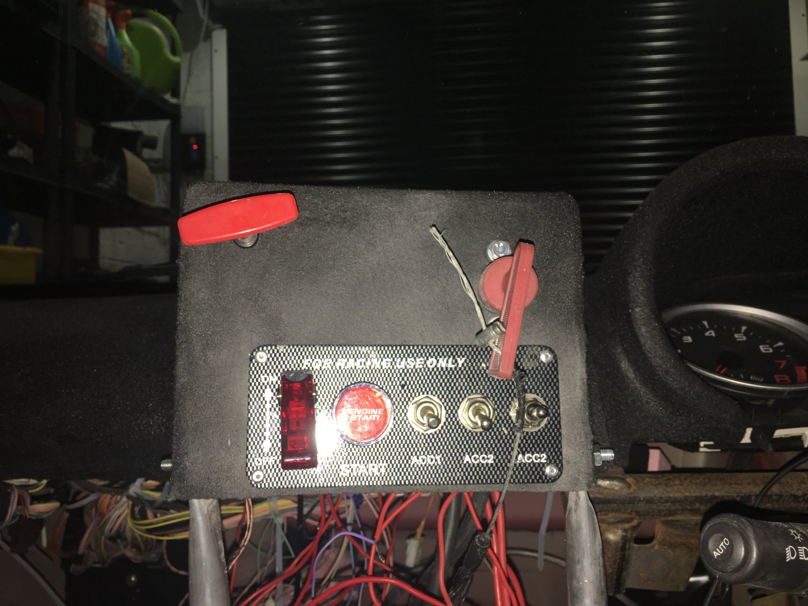

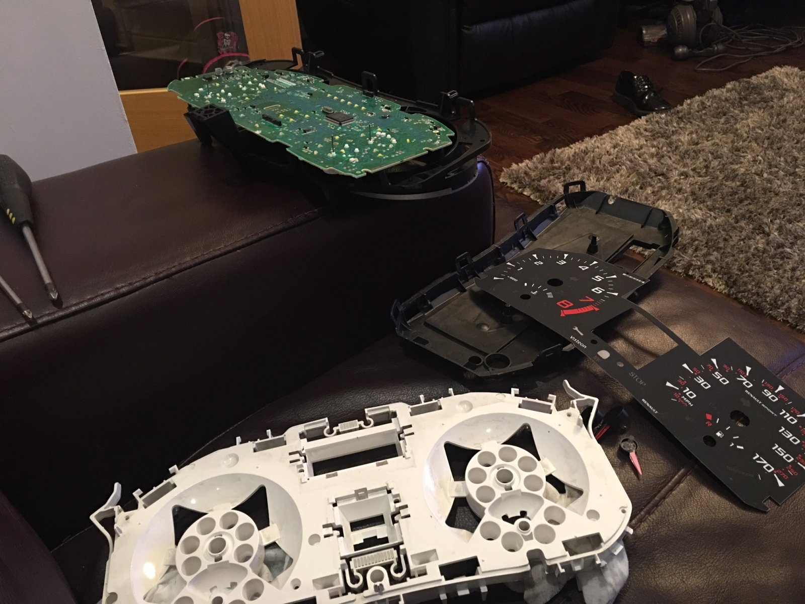

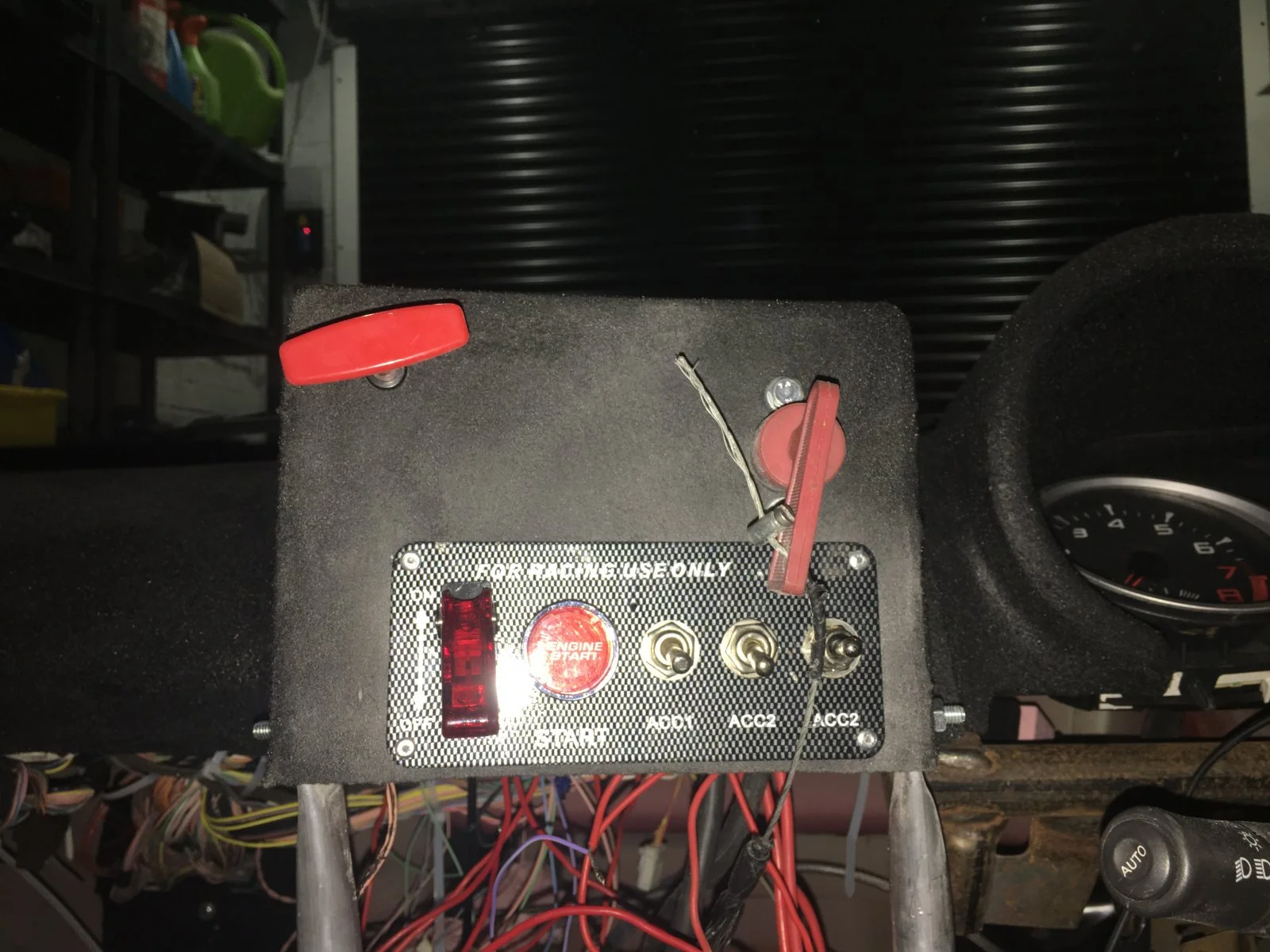

Been getting on with wiring the switch panel today. Didn't like the switches I'd fitted so bought a cheapo switch panel and fitted that
Last things to do are run some wires through the the bulk head for the fan override, washer jets, shift light and kill switch to cut the ignition. Mappings in a couple of weeks time at RS tuning so hopefully get it out on the road next weekend :up:

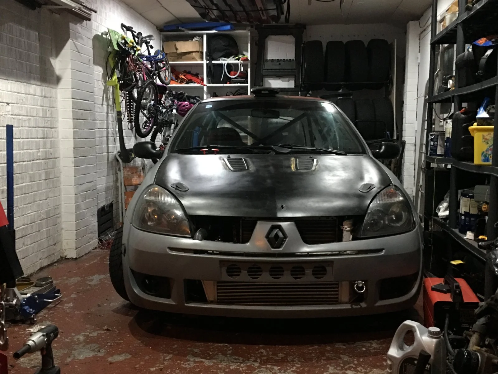

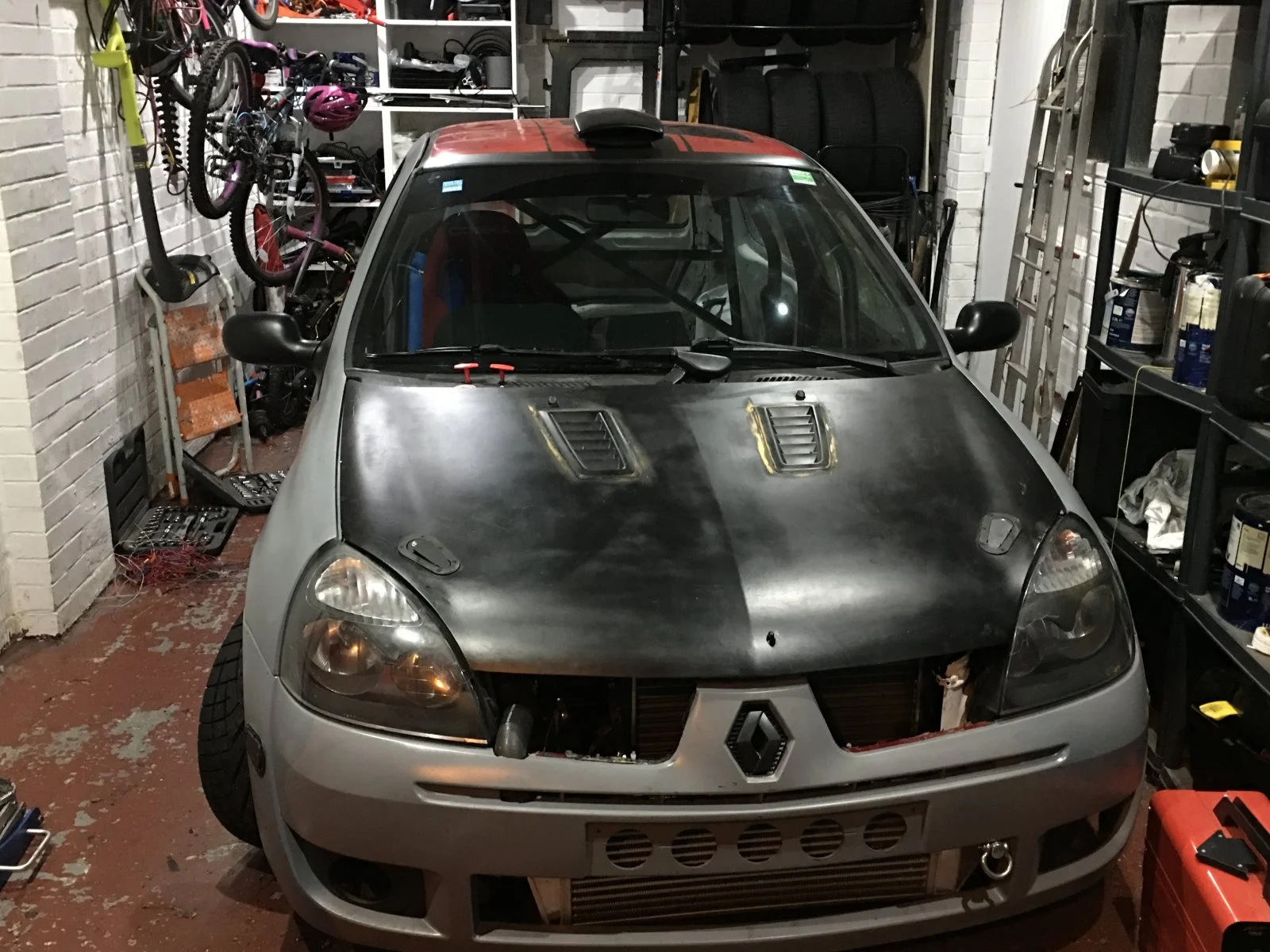

New higher flow fuel pump from engine dynamics. Also found a load of crap in the bottom of the fuel sender so cleaned that out. It's not perfect but it's 100% better and capable of driving. Going to send the ecu off for checking this week before we go for mapping.
Got it out of the garage and cleaned off 2 months worth of dust and grime. Couple of bits left to do but nothing major. Going get some pics and vids hopefully in the next week

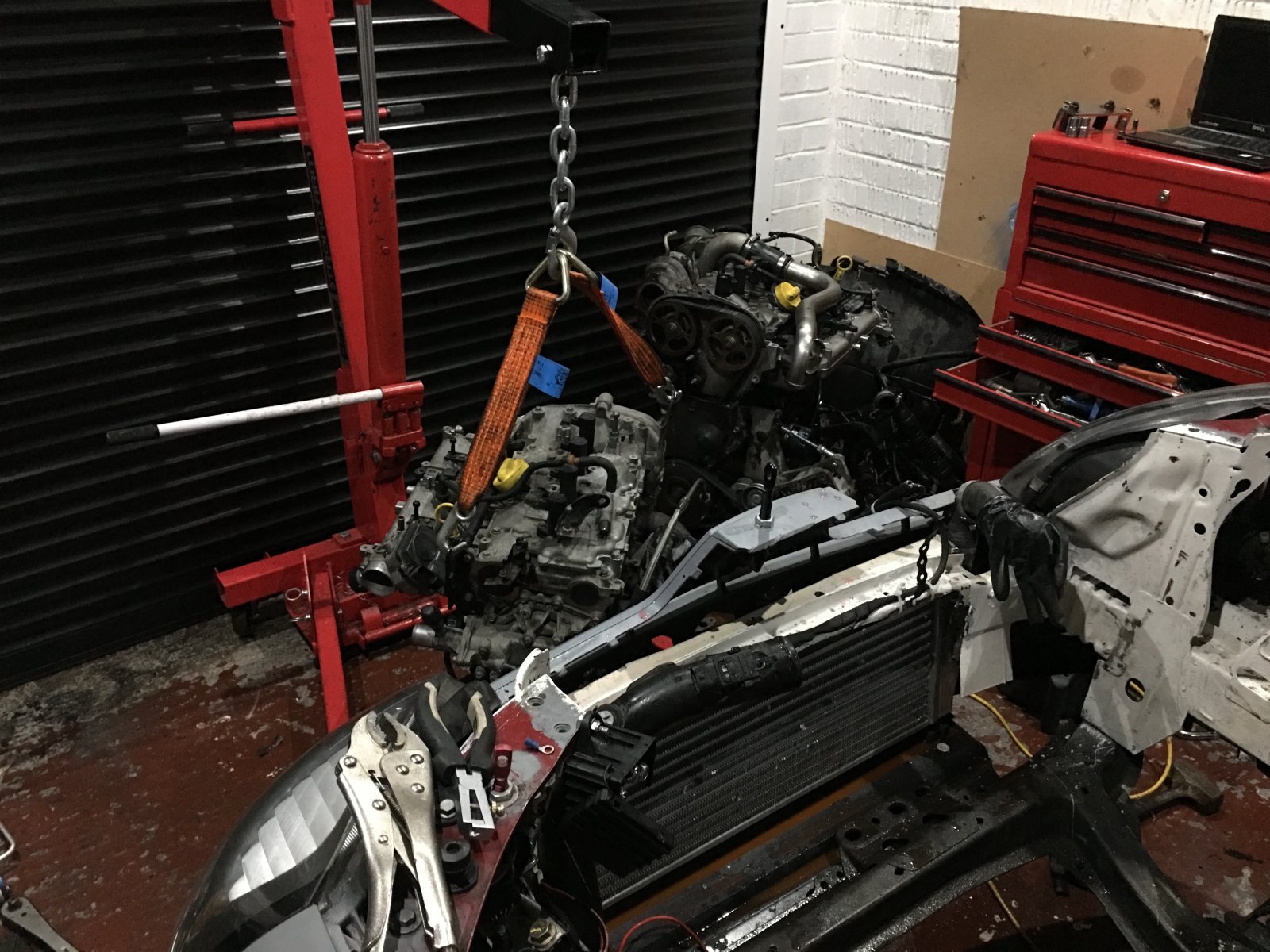

  M135i, 197 turbo
4 hours including stopping for a curry and beers and engine out, gearbox, flywheel etc transferred to replacement, need to swap turbo over then it can go back in
