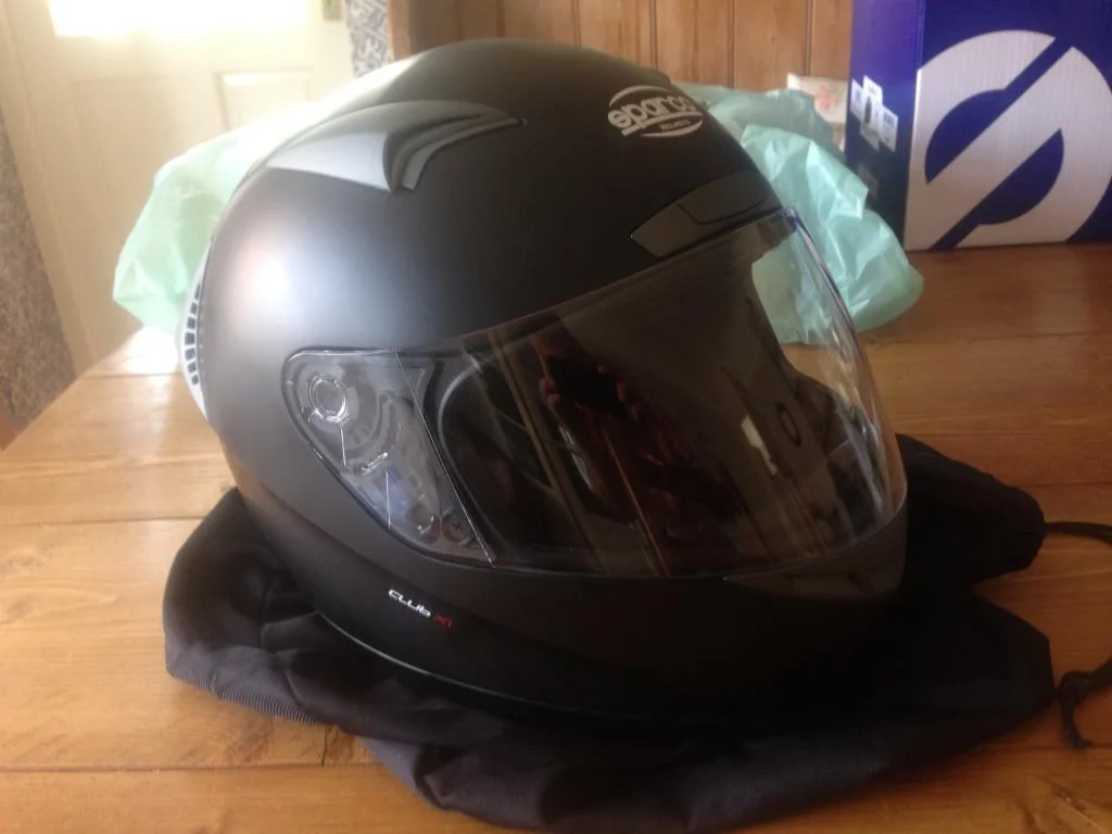

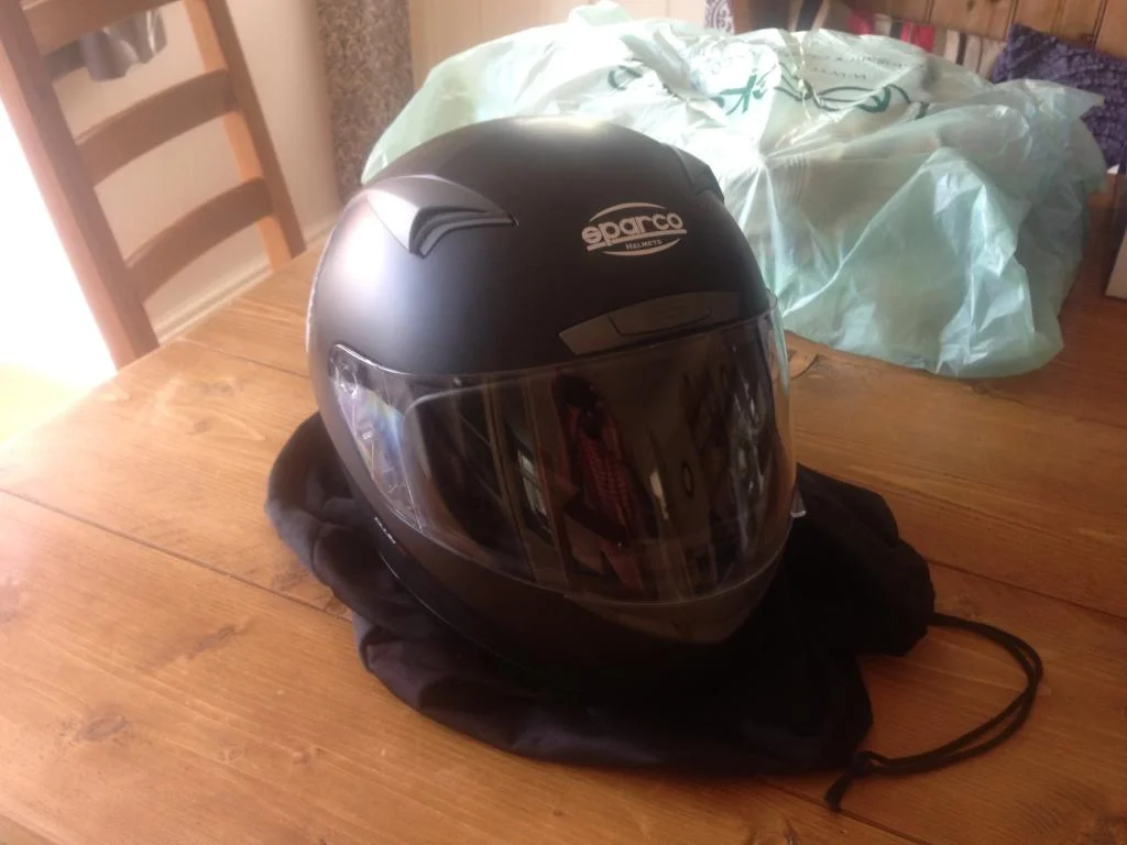

In addition, with the upcoming trackdays at Llandow and Oulton, I have bought a few extra goodies. First up, a helmet (which came with a free helmet bag);
Top service from John at Demon Tweeks using the club discount from here.

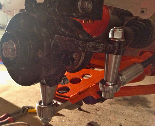

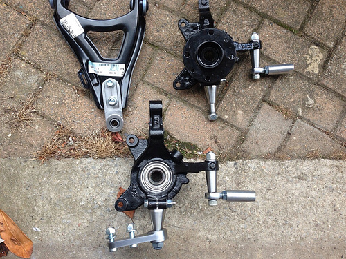

Oh, and I have also committed to a set of these ;)
Apologies to NorthloopCup and BIGASH for shamefully stealing their pictures.

Glad you have committed to the hubs. Really does make a huge difference.

Can someone offer me a brief summary of what they do and how they improve things? I've seen the thread and it has too many posts. A simple one-liner will do, thanks.
No chance in a one-liner and it actually educate you about them in a useful way really, but will be as brief as I can
Standard 172 has really good rollcentres (its a measure of geometry)
When you lower a car it ruins these rollcentres which is bad, at the same time as lowering the COG (which is good) improving the looks (which is good) and generally making the suspension harder (which is good to a point)
This kit puts the roll centre back, without undoing any of the other effects of lowering.
So standard car = good at roll centre but bad at some other stuff
Lowered car = good at other stuff but bad at roll centre
Lowered car plus these = no downsides (other than cost) and all the good stuff of lowering
Effect when driving = car turns in sharper, and leans less

Are the benefits more suited to track application, or are they equally valid for 'fast road' spec?

I would say just as important for fast road spec tbh, a track is more even than the roads, so road benefit is very good indeed.

I agree in principle but in practice you have to be a bit of a tool on the road to ever need more than a standard one of these cars can do. Lol.
But it it does just feel "right" which is good anywhere. Lot of money though.

When you lower the car the suspension points on the wheels move up relative to the body, these things move them back down again.

Yeah that's one line but if you already understand why moving the suspension points is bad you would know what these did and if you don't then that line won't help much I suspect. Lol.

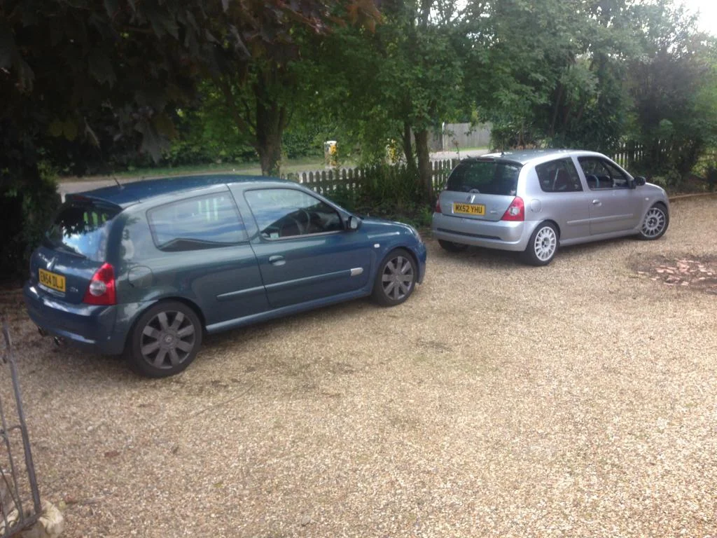

Small update. Hadn't moved the car for a while, so with Llandow on Weds I thought I best give it a clean and a run out, check it still works ;) Lucky I did, as whilst on the shake down drive the PMS shifter moved slightly out of alignment, so I could go into reverse without needing to lift the guard. Not good, and certainly wouldn't be good for track work. I nursed it back got it in the garage, jacked up and on axle stands, and awaited the cavalry to lend me a hand.
Then the cavalry started to arrive, although I think it was the BBQ that they came for and not to fix the car;
And with 5 mins of Budgie under the car, and me in it, the selector was adjusted and all was right in the world :)
With my car fixed, Christopher. fitted an airbox to his PB, and the BBQ got fired up. With the BBQ going, I got a chance to have a good luck around Phase1sr Ph1 and it is bonkers how nice it is. Words can't do justice to it, it literally looks like an improved (cams, coilovers) car that has come straight from the factory yesterday. I'm glad it got a good run out Scott, it is a real credit to you and it sounded great as it headed off. Some photos of it that don't do it justice;
