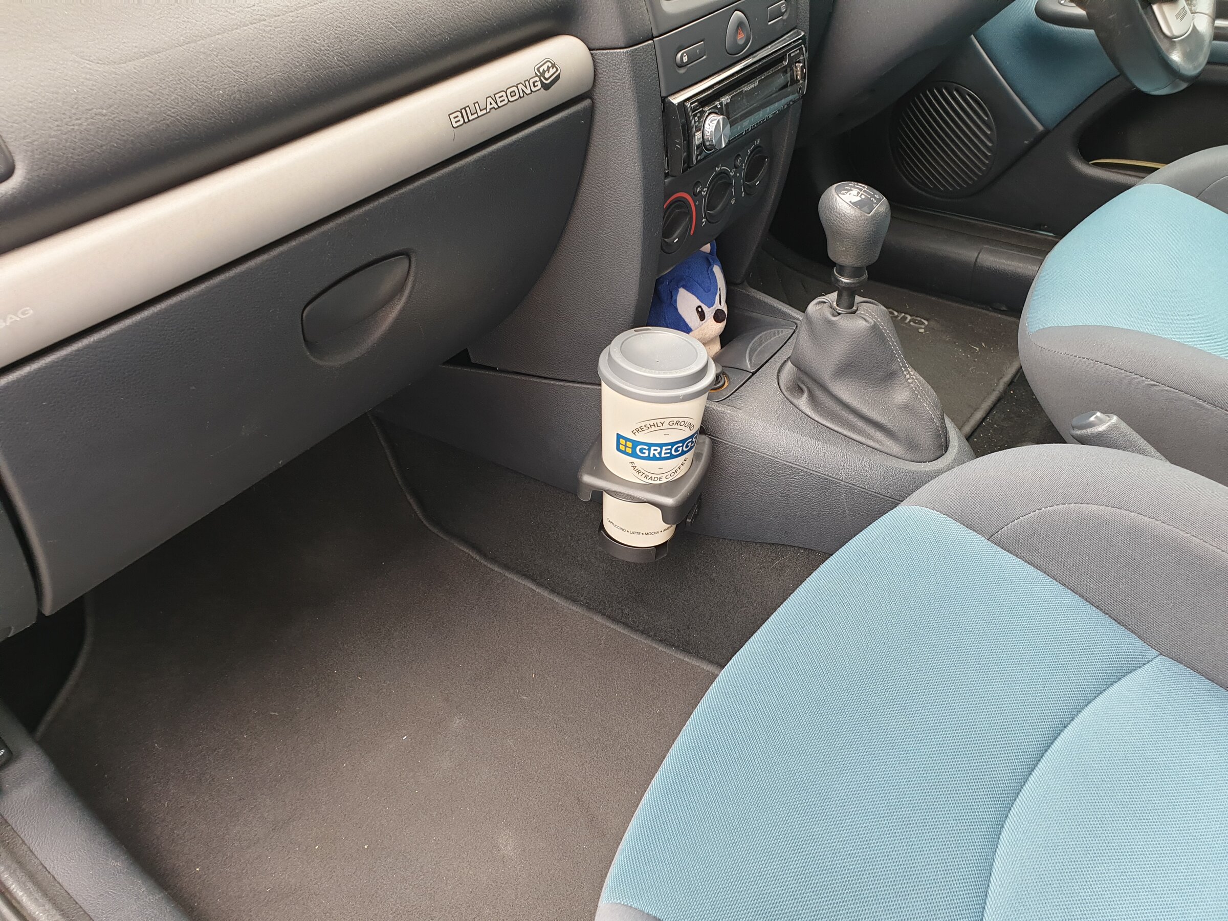

Anyway i fitted a cup holder today. Not the most elegant but should hopefully do the job
Greggs cup test as thats how we roll;)

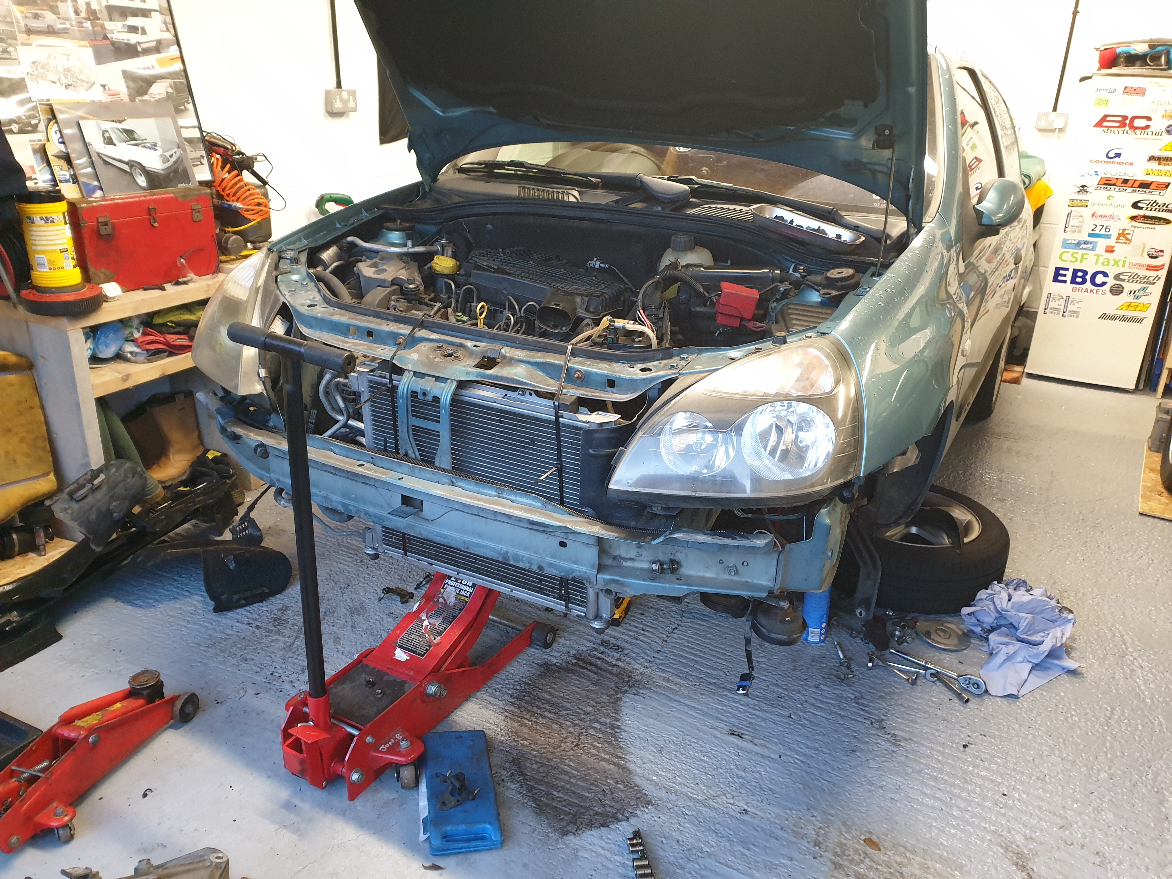

Got a flier from work this afternoon, just had to endure a 2 hour teams meeting with 50 of us in it:sleep:

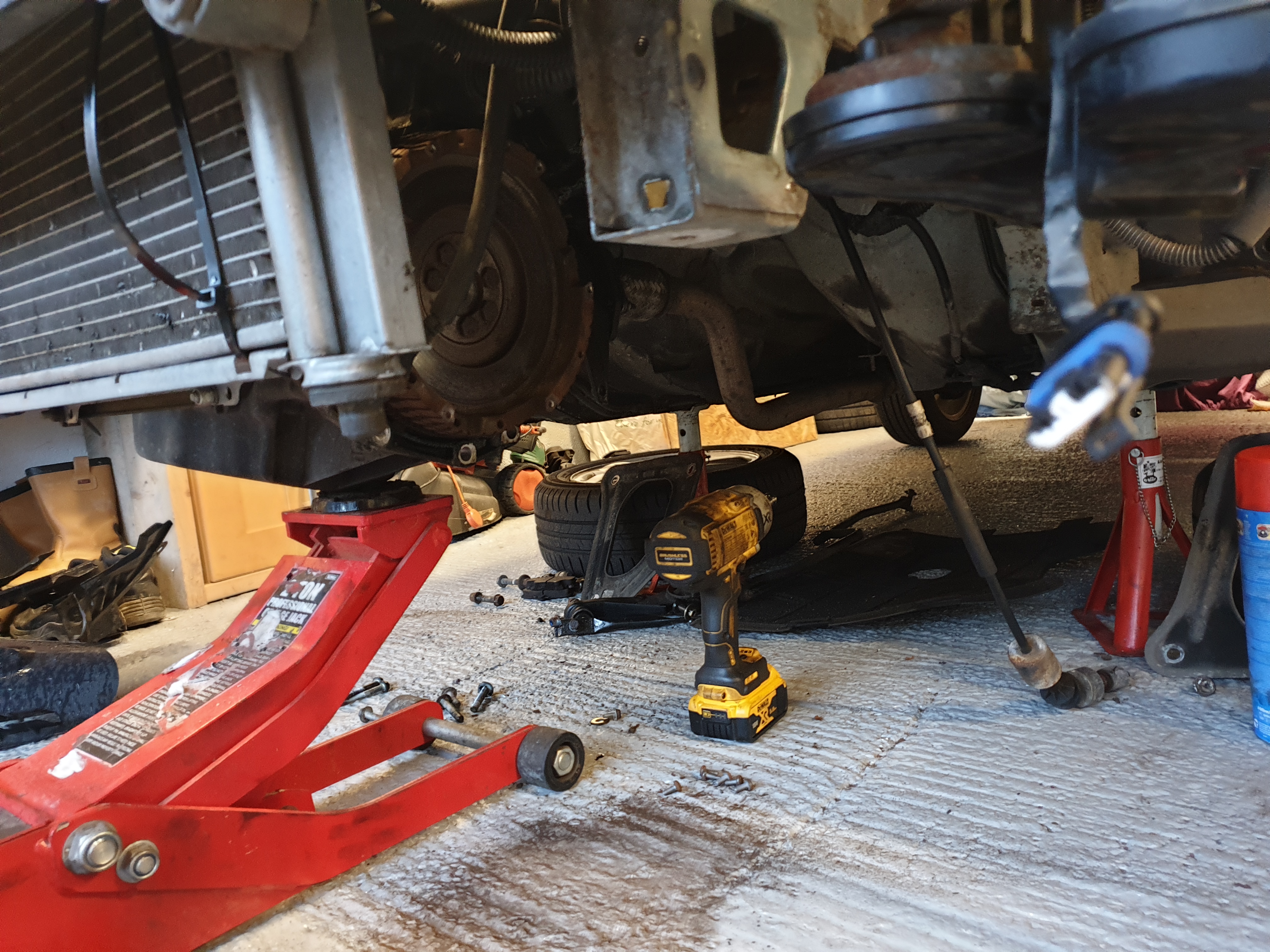

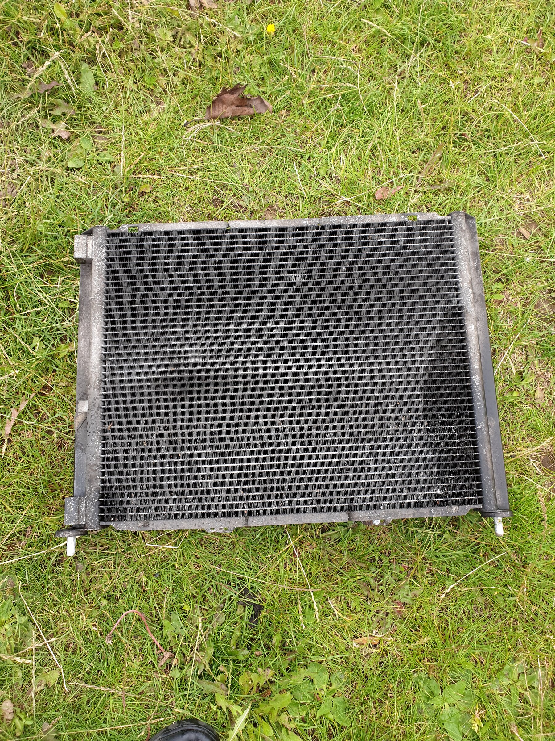

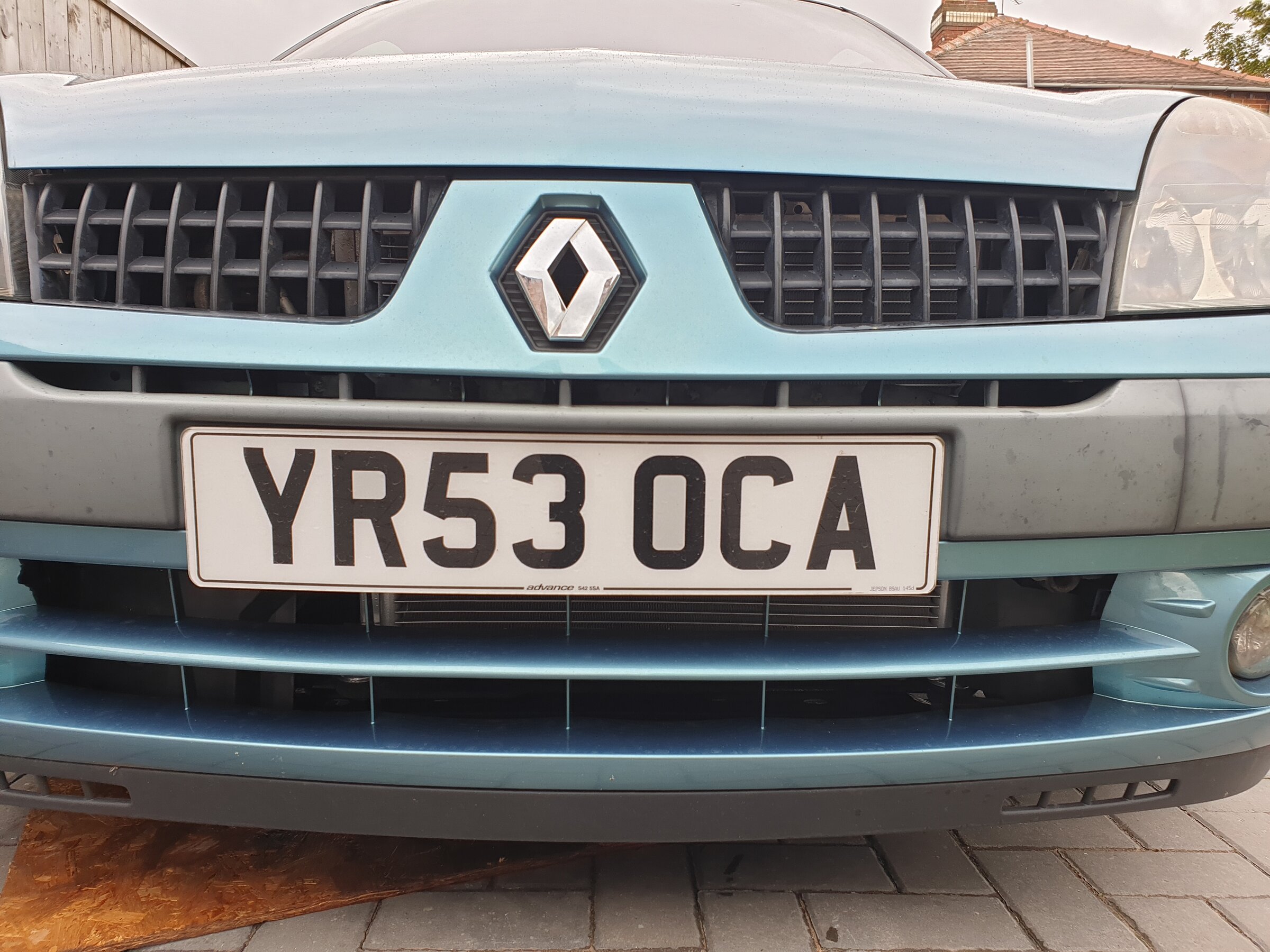

Anyway straight out to fit the new rad and condensor pack. Whipped grill and slam panel off and it was out in ten mins.
Black mark shows the leaks on the old condensor.
Bolts holding rad fan on were rotten so got the grinder out. New rad fitted, had to re use the old aircon seals, the new oem renault ones were different to the originals, new ones were basically normal o rings and the old ones are about 6mm wide o rings. They did not look bad at all, lubed them up with pag and went in tightly/snug, so fingers crossed they wont leak.

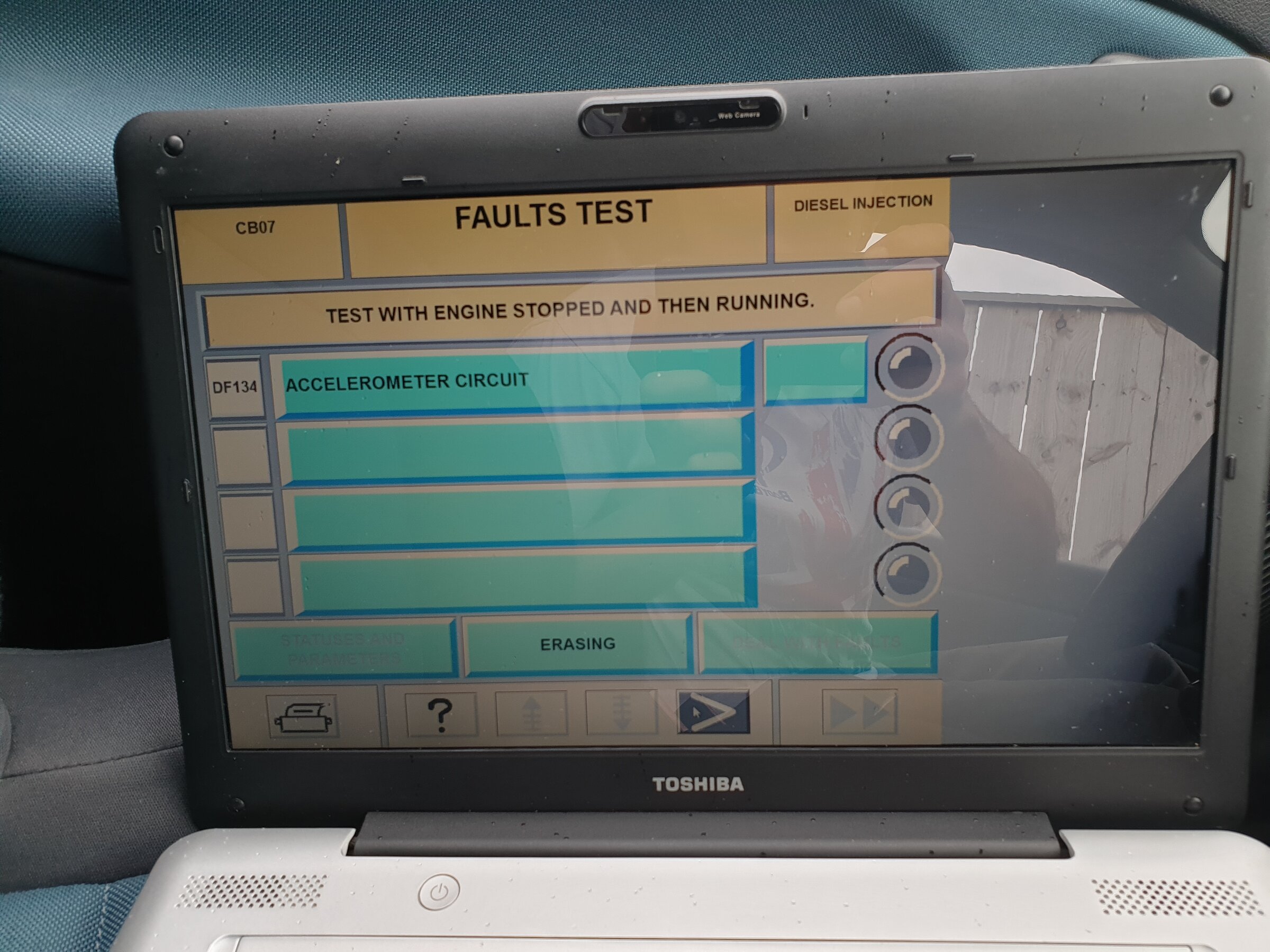

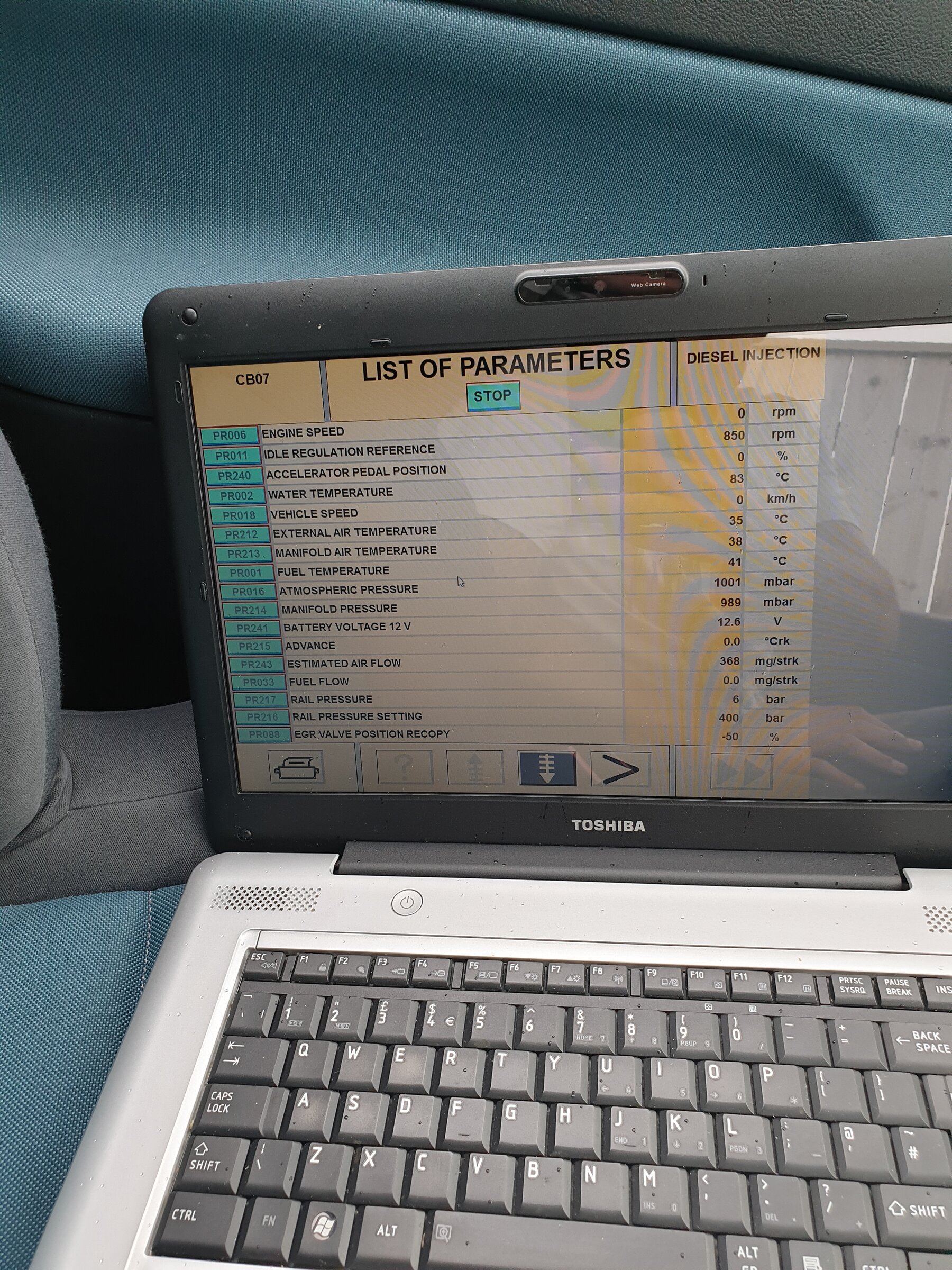

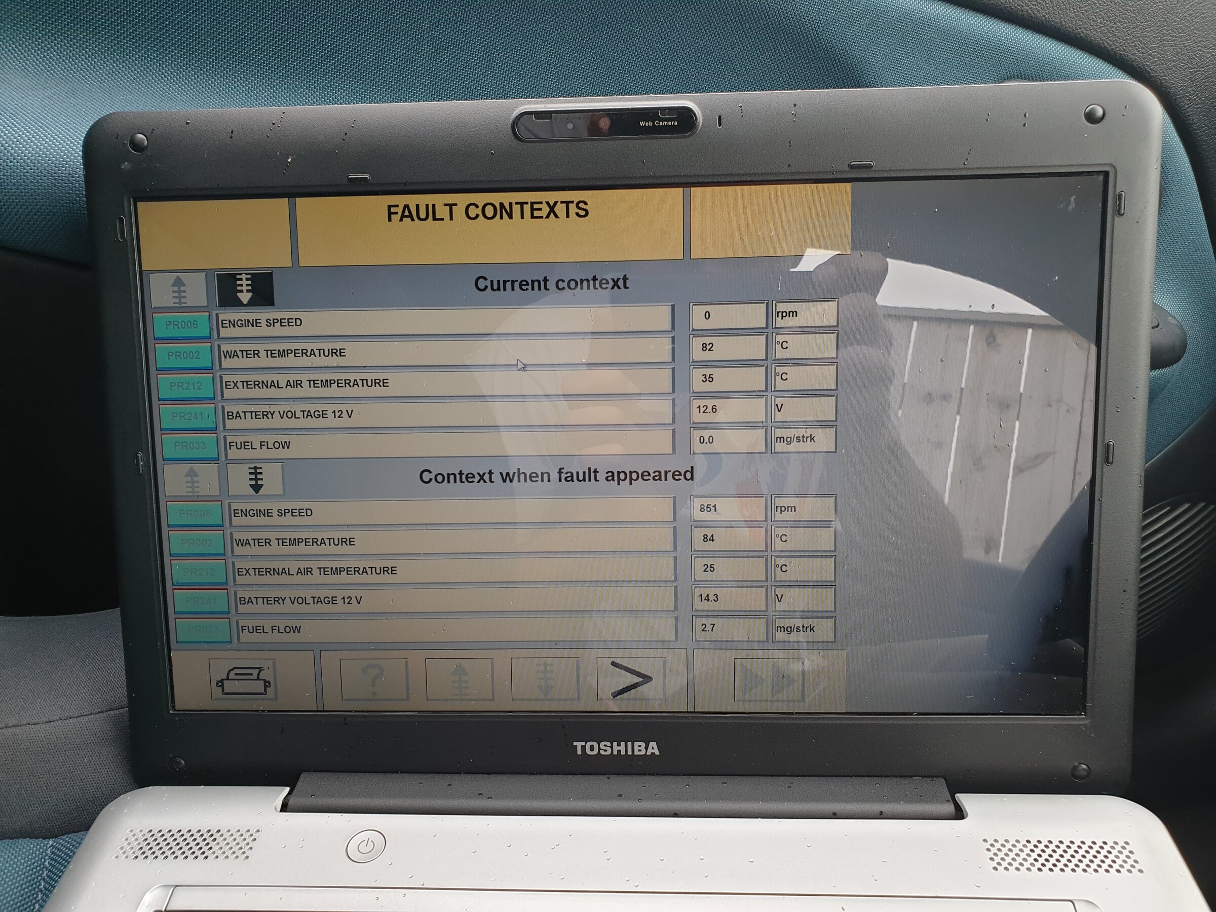

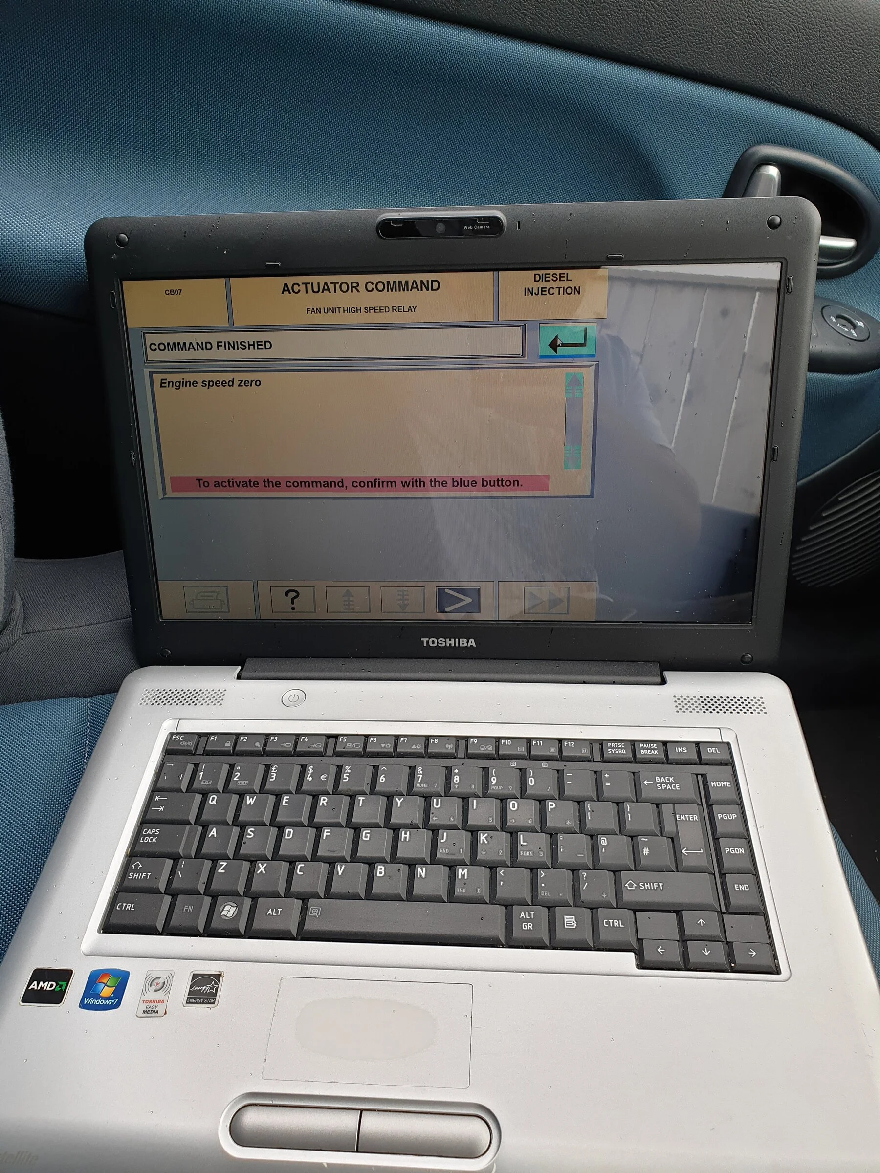

I wanted to make sure rad fan was working so hooked up clip. Clip is great for stuff like this, dead easy to do an actuator test.
Reading parameters
Tested low and high speed, both working ok.
Scanned the diesel injection ecu for faults whilst plugged in. Df134 accelerometer circuit is always intermittently stored and has been since ive got the car. Not sure why and it runs ok with no eml or any other issues. Probably wiring or sensor might replace it one day.

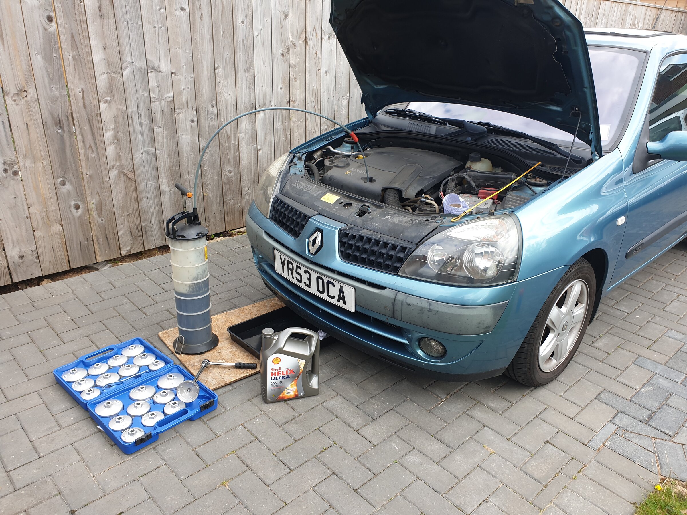

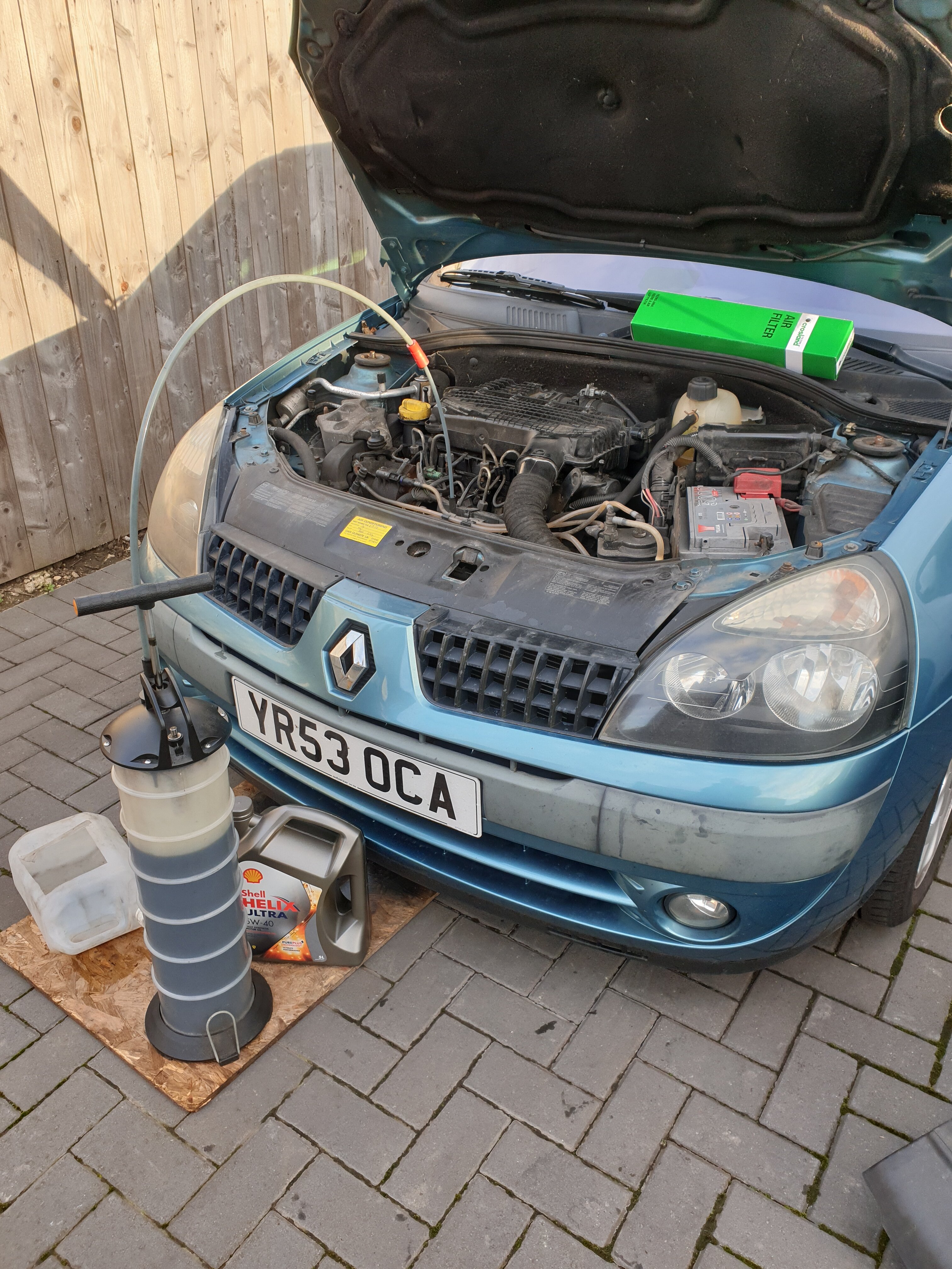

Oil change time as done 8k since last one. Ten min job with vac pump, invested in a cheap oil filter socket kit as the oil filter is always tight as feck and hard to get off. Worked great, oil filter straight off.

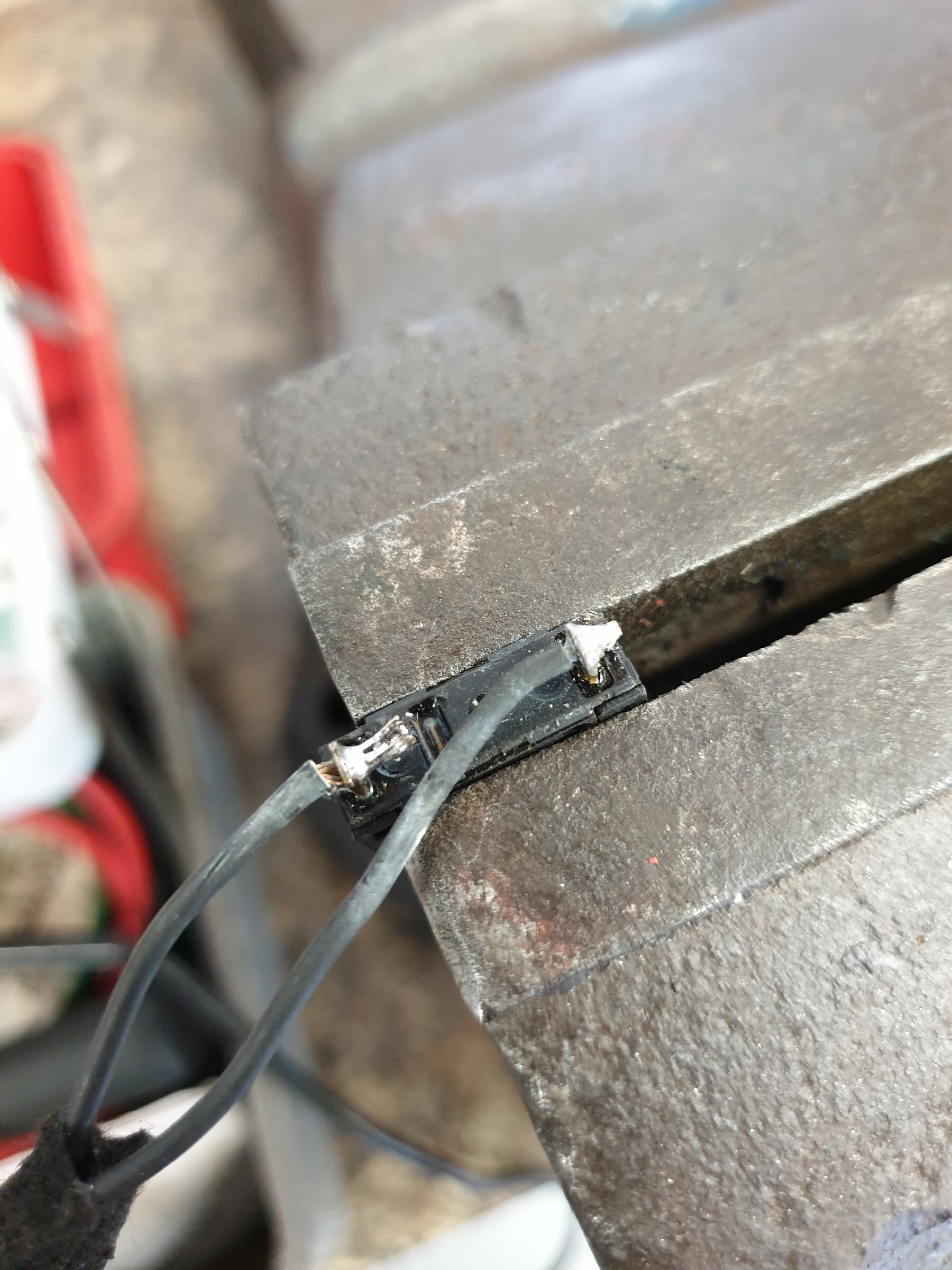

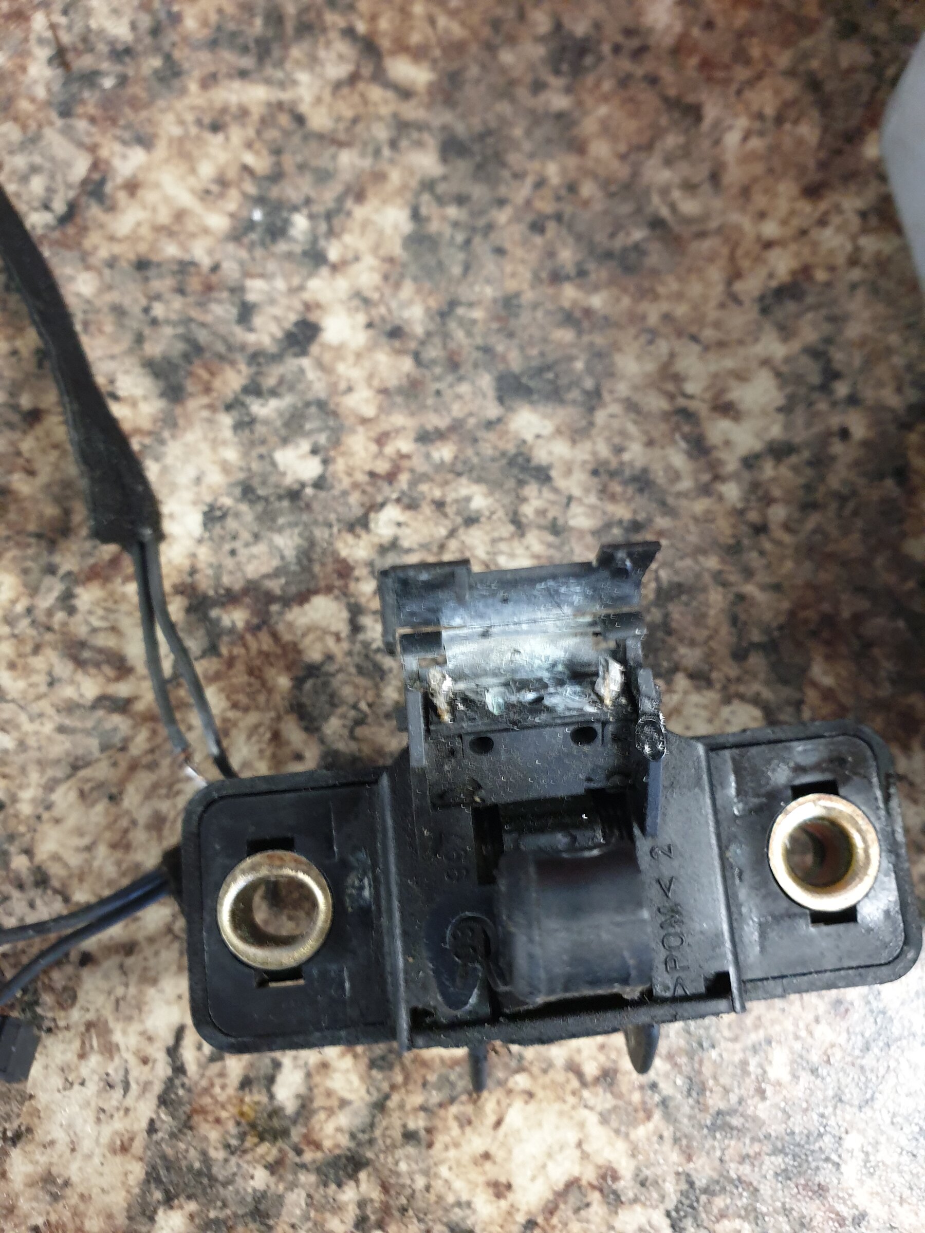

Boot microswitch failed so the boot was relocking when opened. Dug one out of the spare parts aka box of shite in the garage. Wires were chopped for some reason so had to swap them from the knackered switch. 20 mins work nice easy fix.
Corroded switch
New one soldered up.

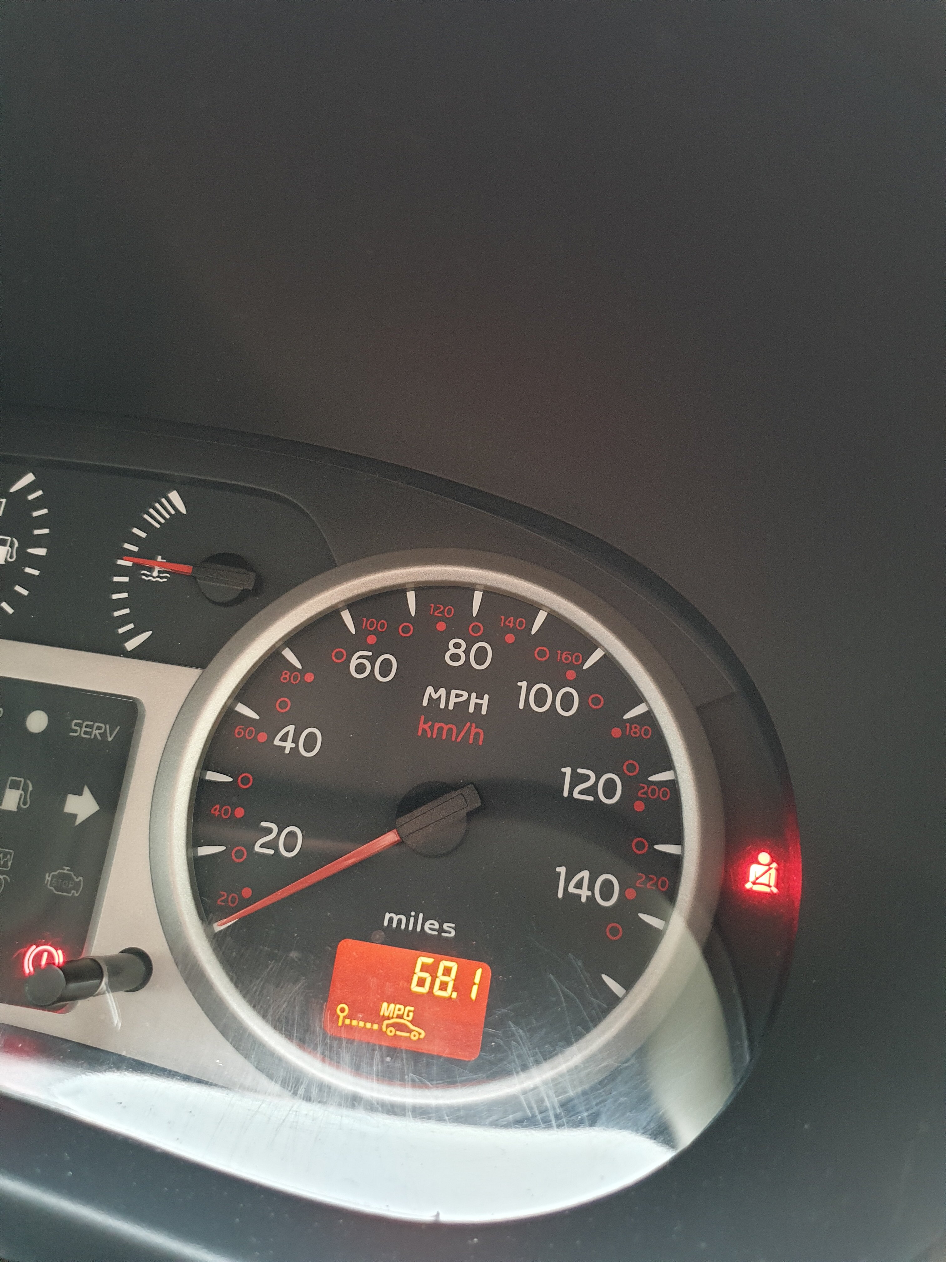

Both clios still soldiering on, blue one still clocking up loads of miles at work.
Changed oil and filters on the blue one a couple of months back and boshed an airfilter in, old airfilter was black.
Clutch started slipping shortly after on hard acceleration, so have limped it for 2 month or so as too busy/couldnt be arsed to do it :LOL:
Mpg has been going up as slower driving, currently up to 68.3, mixed driving

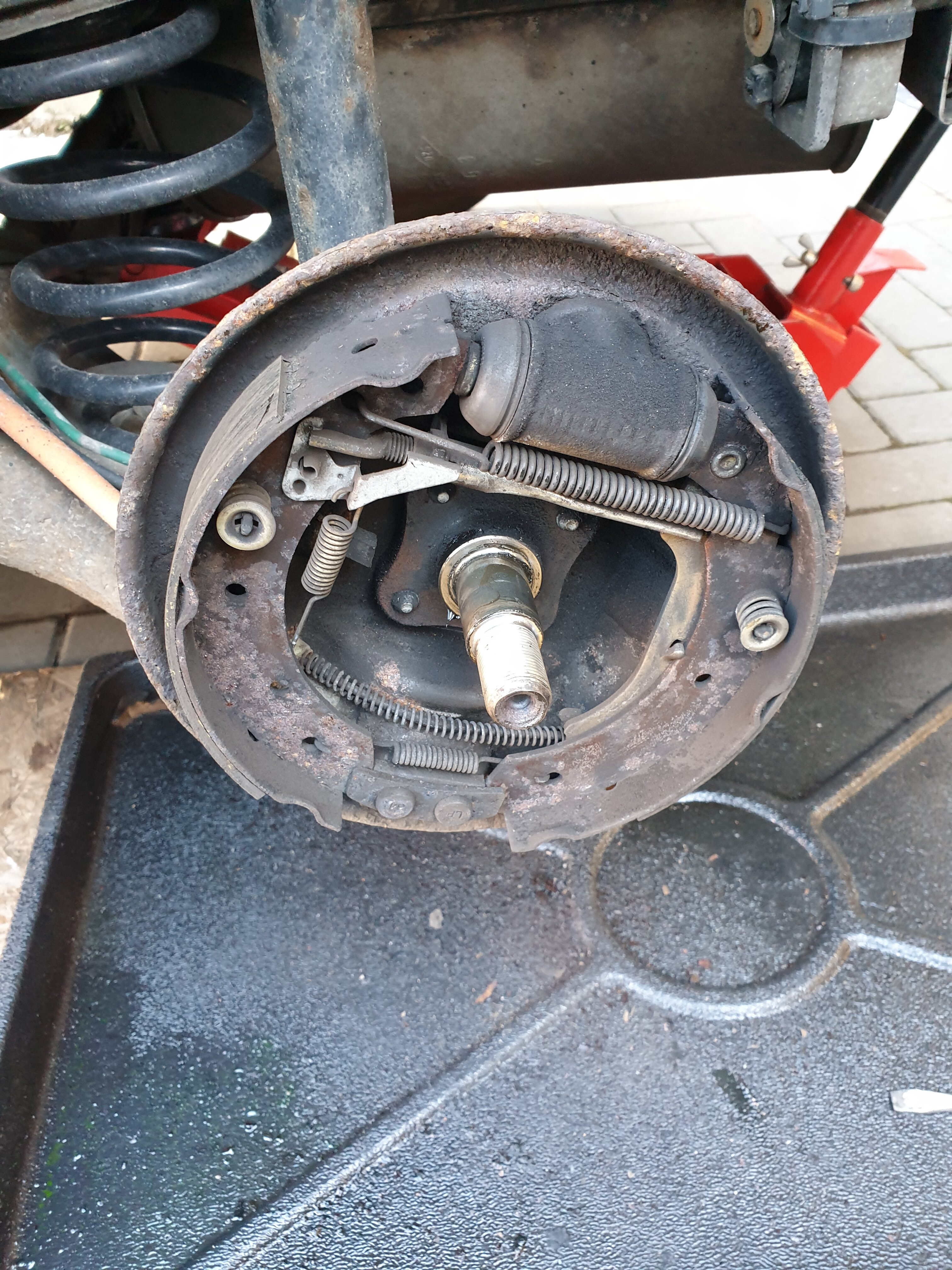

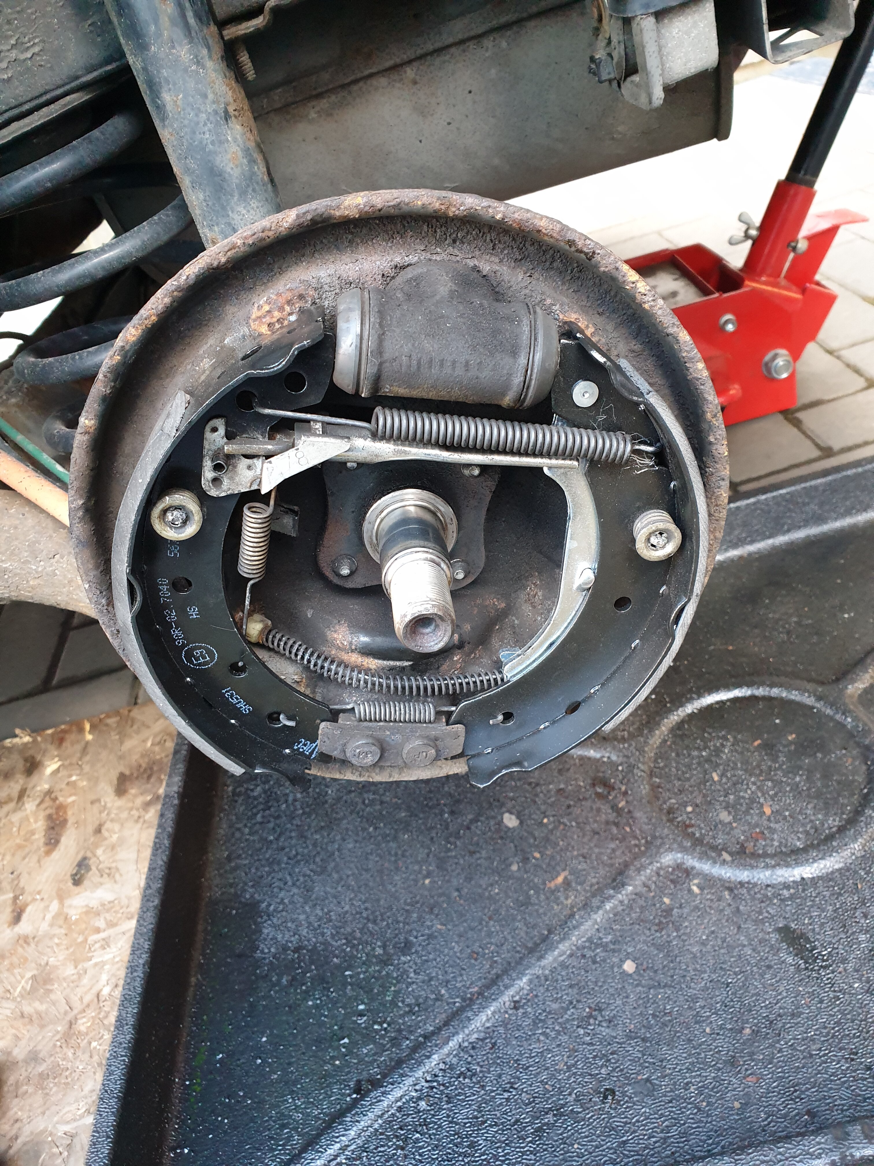

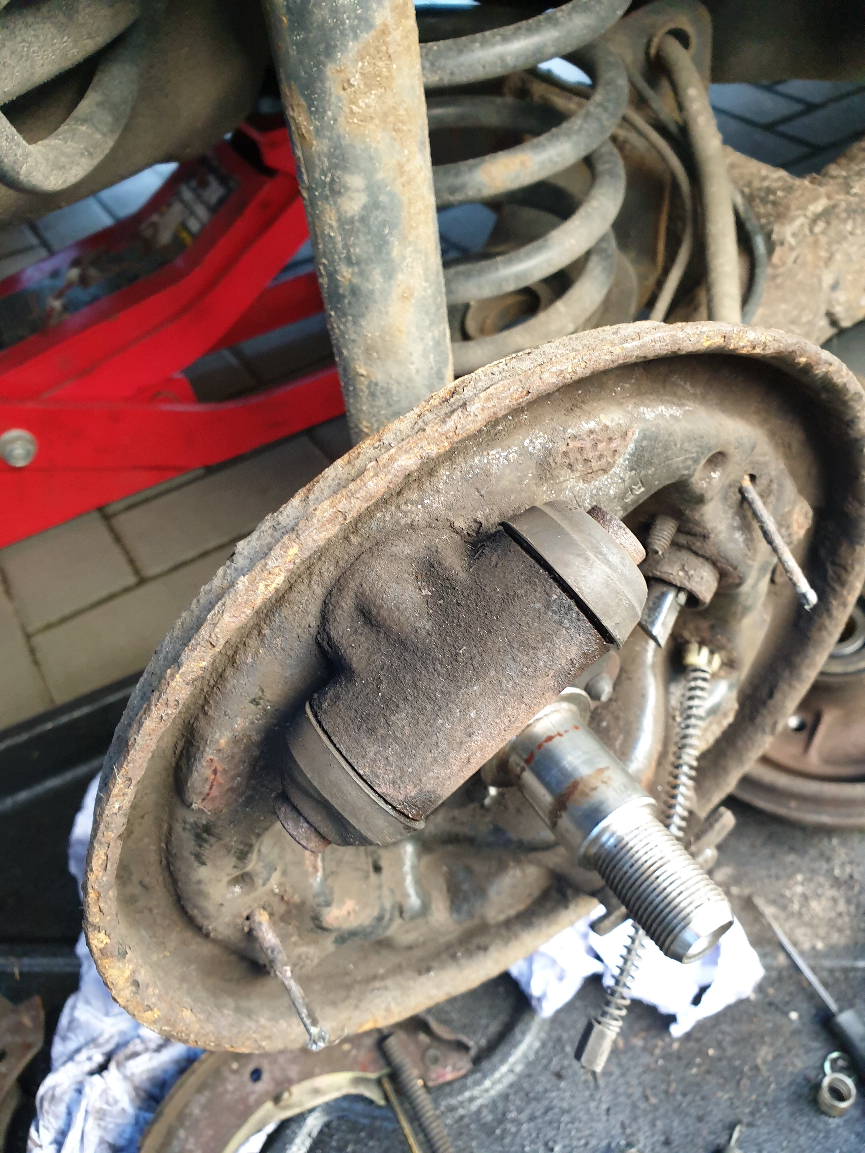

Was hearing an intermittent grinding/squeaking this week on the blue dci when braking first thing on a morning. I thought it was a build up of brake dust or poss weeing brake cylinder so pulled the drum off quickly to check today.
N/s was greeted with shoe lining starting to come off on the leading shoe, can see a small gap in the pic on lower edge. No doubt would have failed and locked the drum at some point.
Checked cylinder was ok so shot down the motorfactors for new shoes. Usual piss on with springs flying off
Got to the o/s and checked the cylinder and the boot was full of fluid. Back down the motorfactors for a cylinder. Old one below
No pics of new one fitted, bled up ok, shoes adjusted properly and brakes are sharp, decent improvement.
Ive had a slight rumbling from the back recently which sounded like a dry bearing or on its way. A little bit of pick up on the stub axle on o/s so investigated.
N/s bearing split when removing drum so regreased and looks fine, popped the bearing apart on o/s rear and race is scored/plastic bearing cage is cracked. Motorfactors were closed at this point so getting an snr from euro tomorrow.
Joys of old cars/higher mileage. Cant moan as i do tons of miles in this and its very reliable.

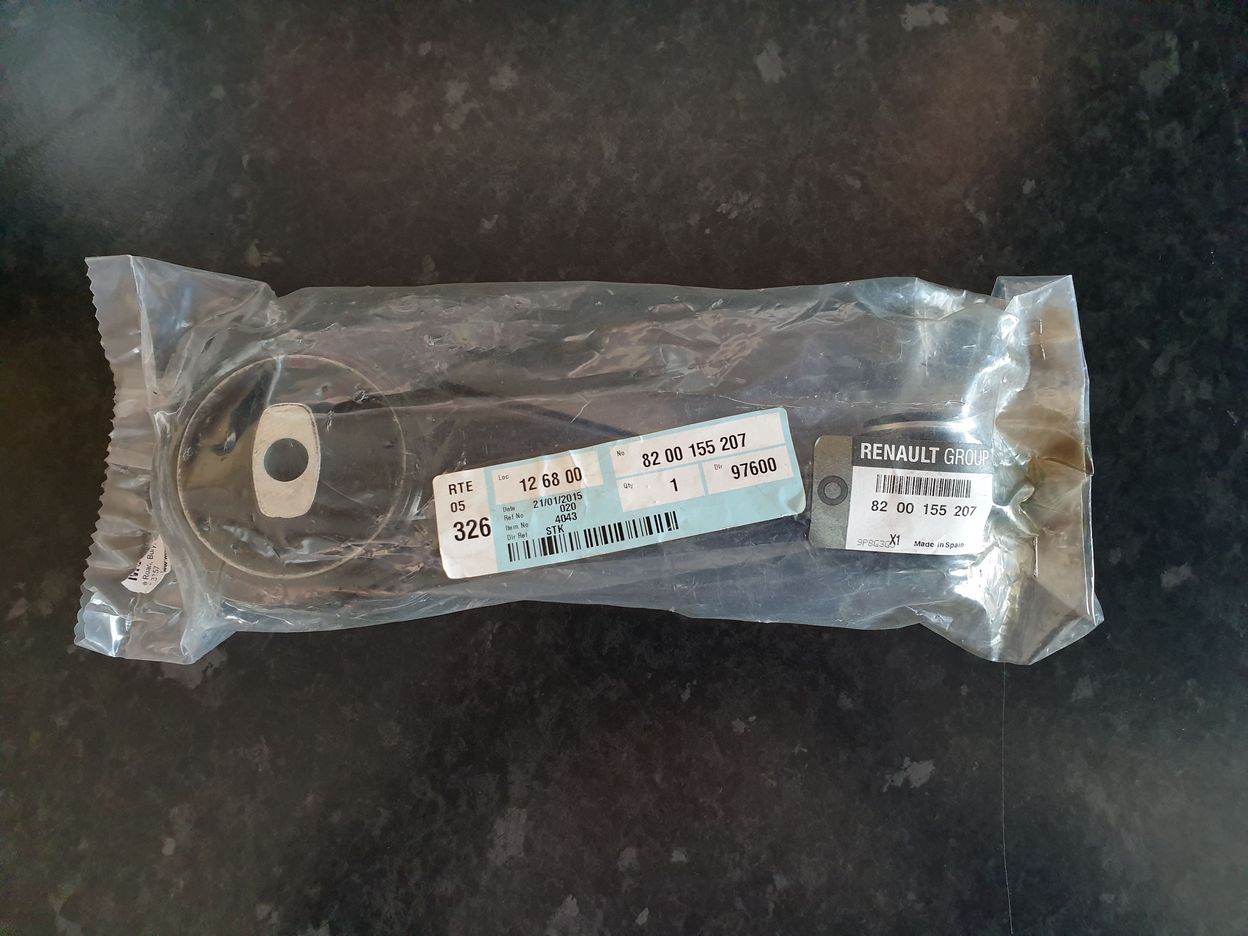

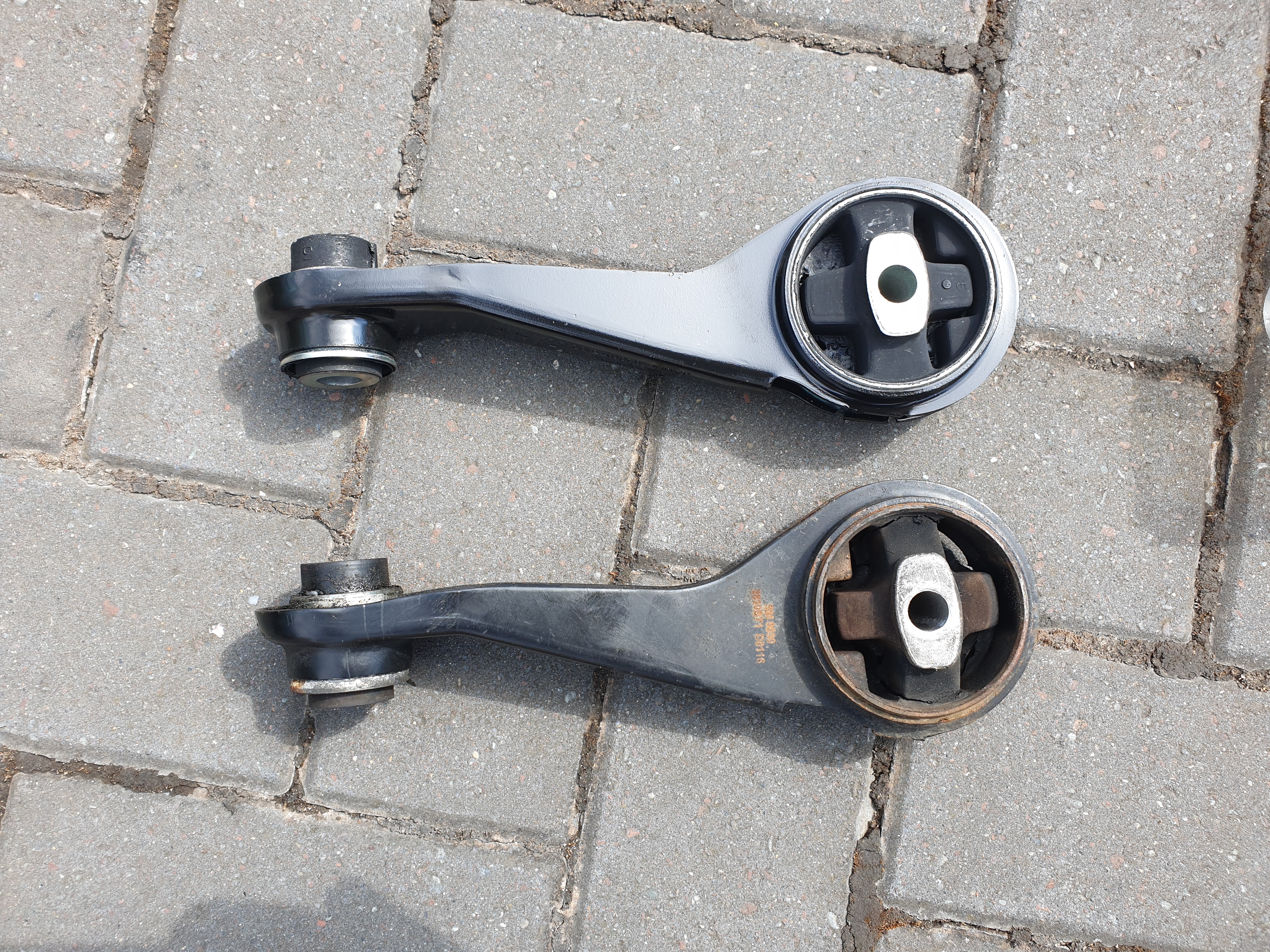

Changed dog bone mount on the blue dci as noticed it was torn when i changed the clutch. Oem this time instead of aftermarket
Fitted, 15 min job.

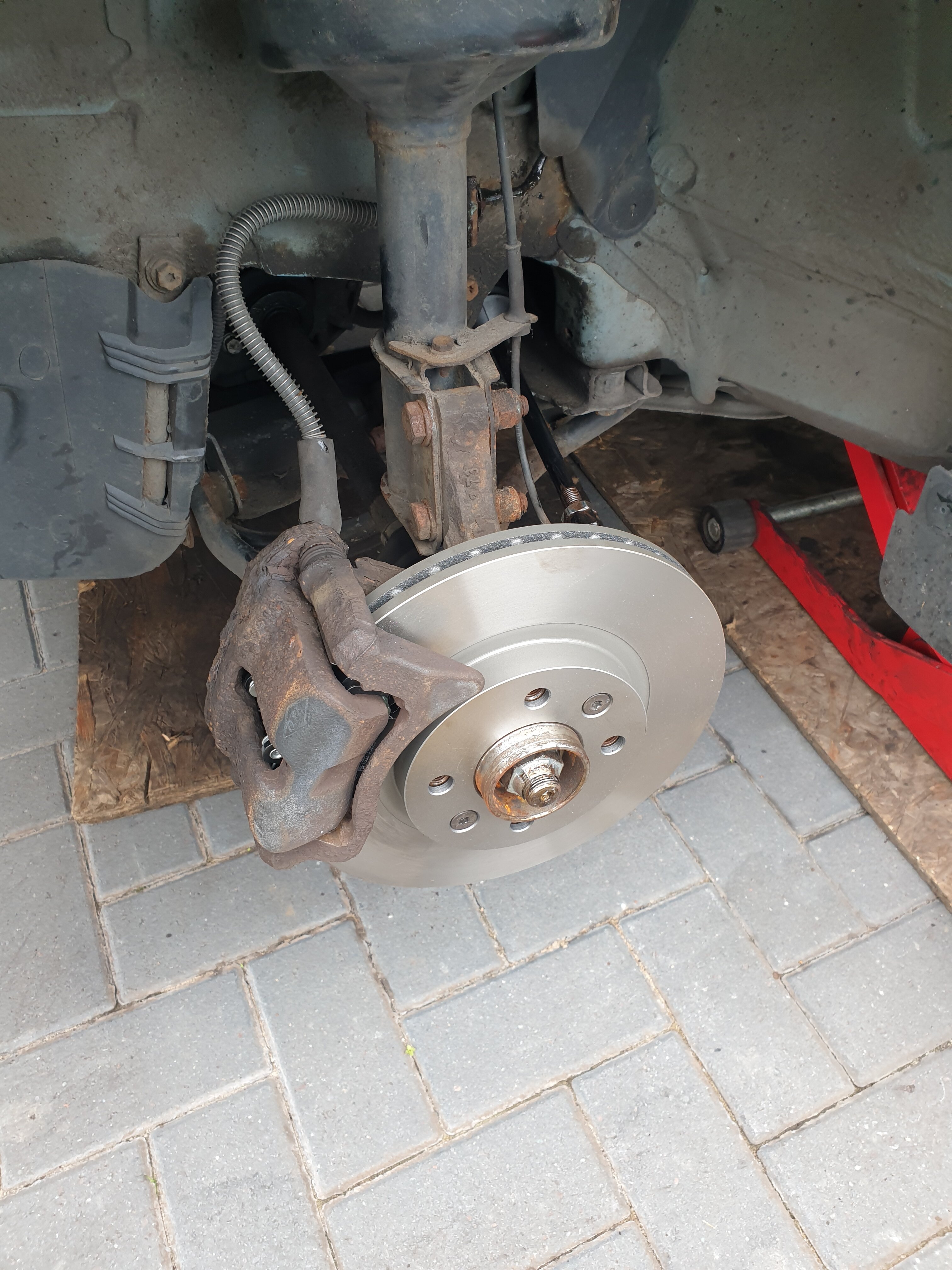

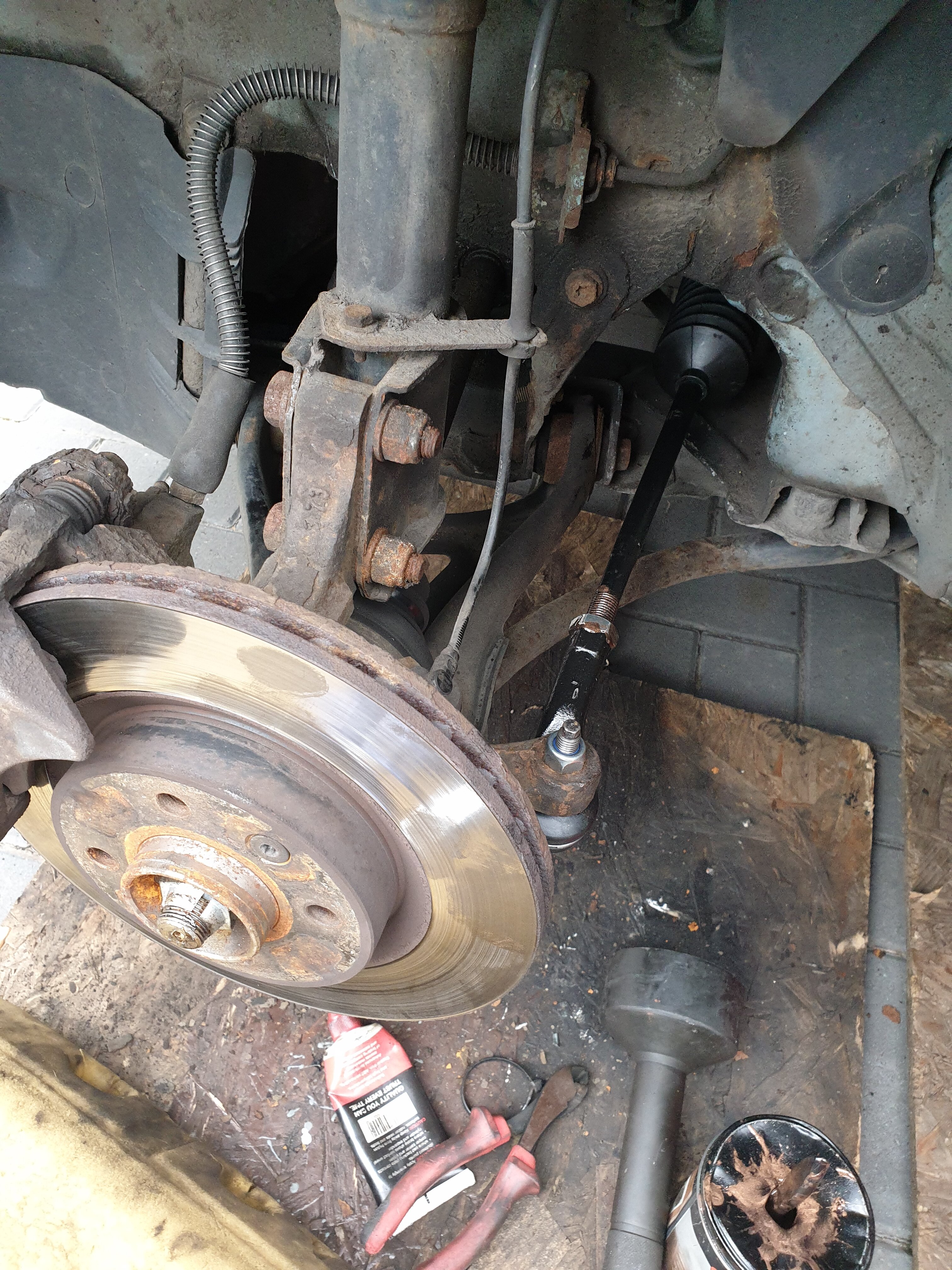

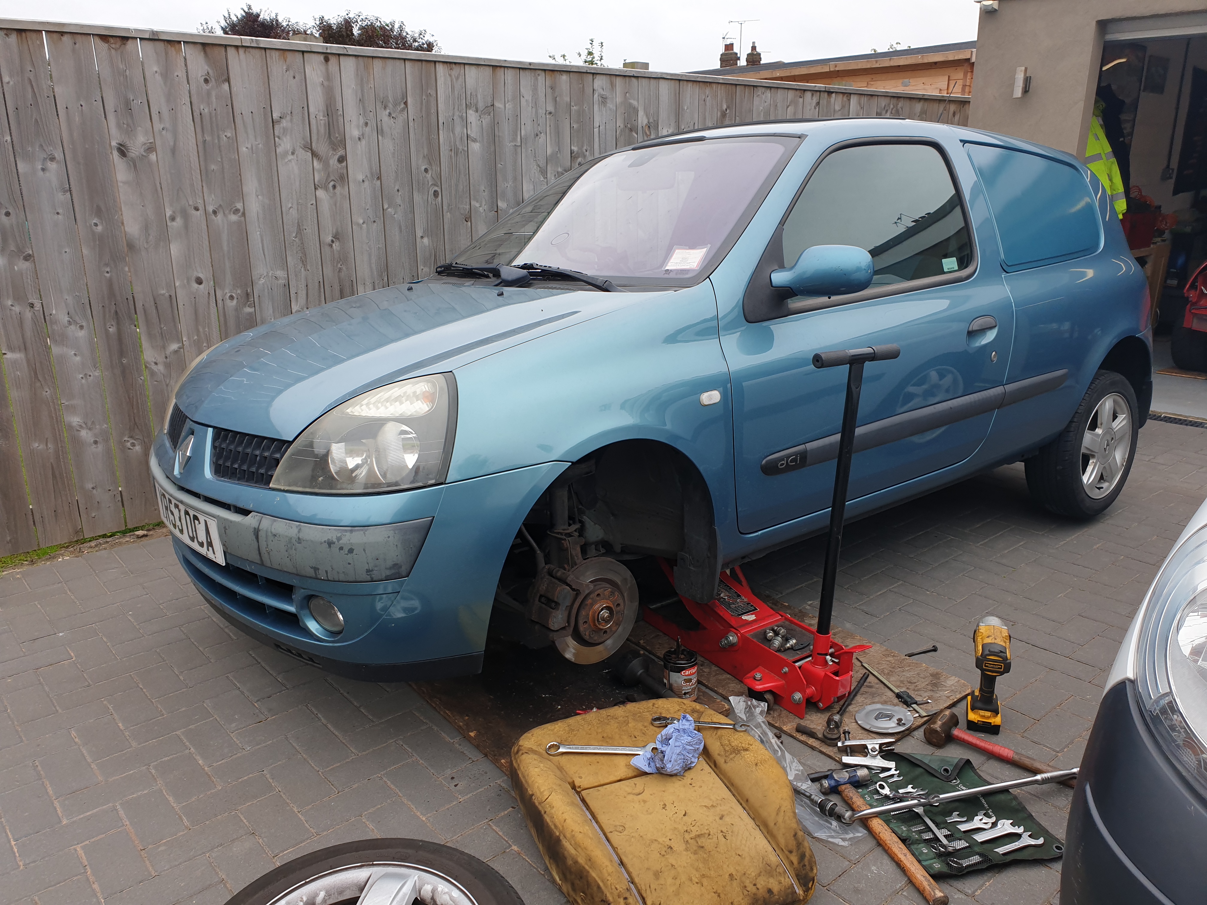

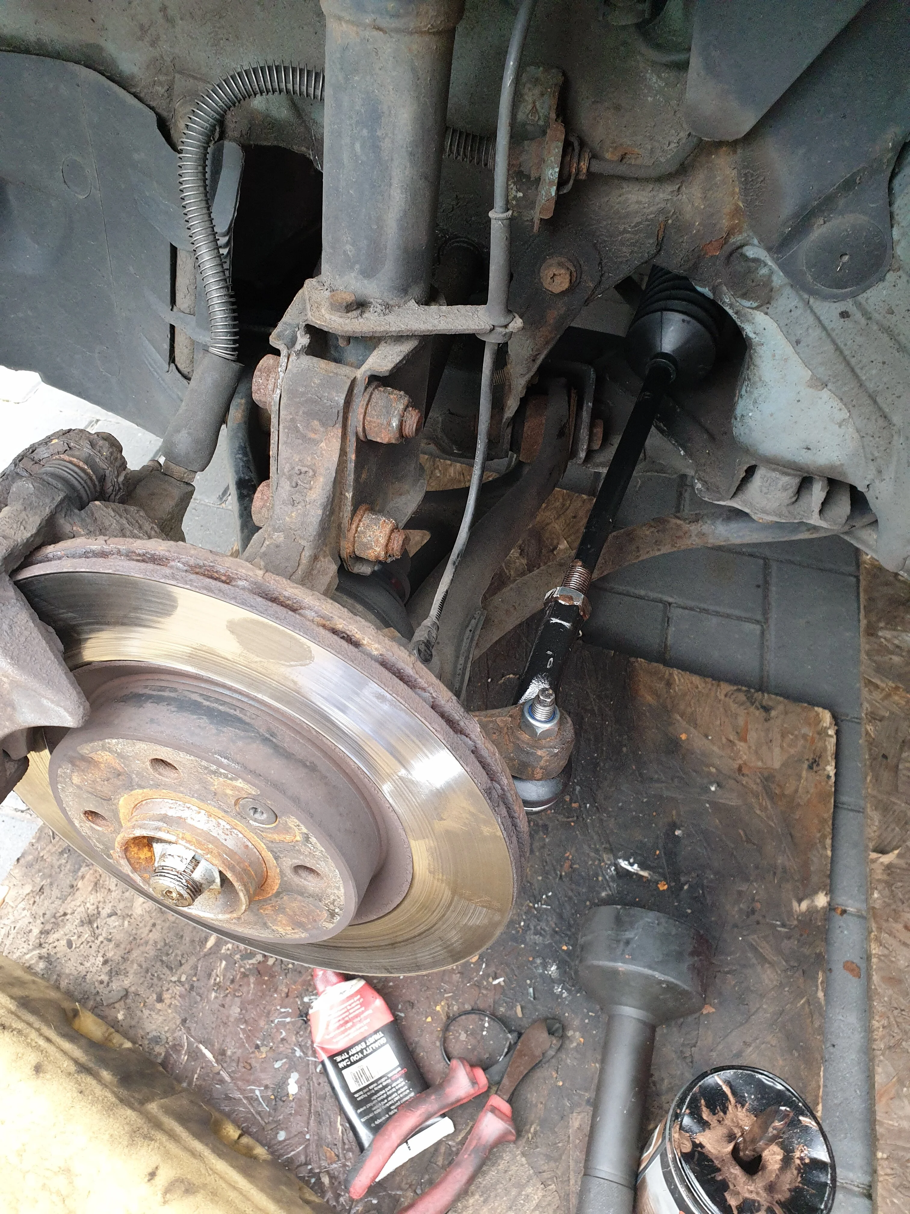

Mot tomorrow. Done a pre check the other day and play in n/s tie rod and front discs looked about worn out on the inside as a large ridge.
Went down the local motor factors and picked up a new tie rod/track rod end, discs and pads for £60. 1 hour to fit it all and should be good for a clean mot tomorrow fingers crossed.

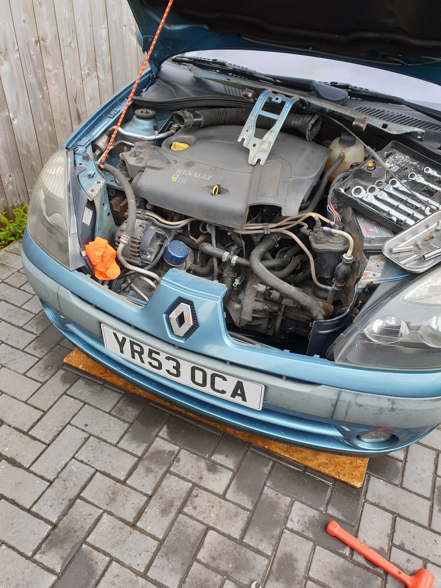

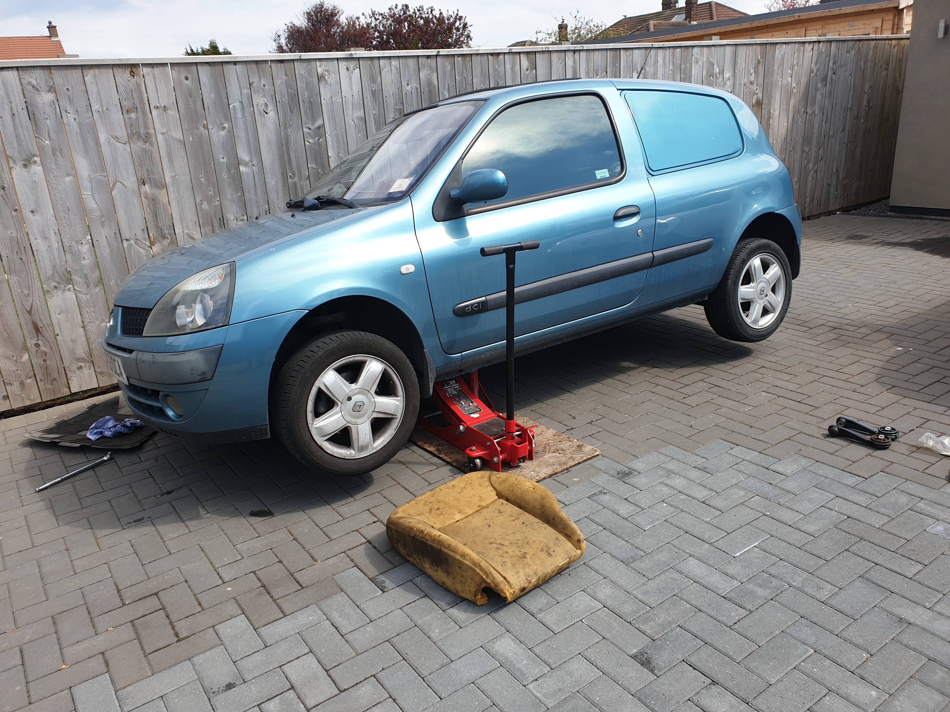

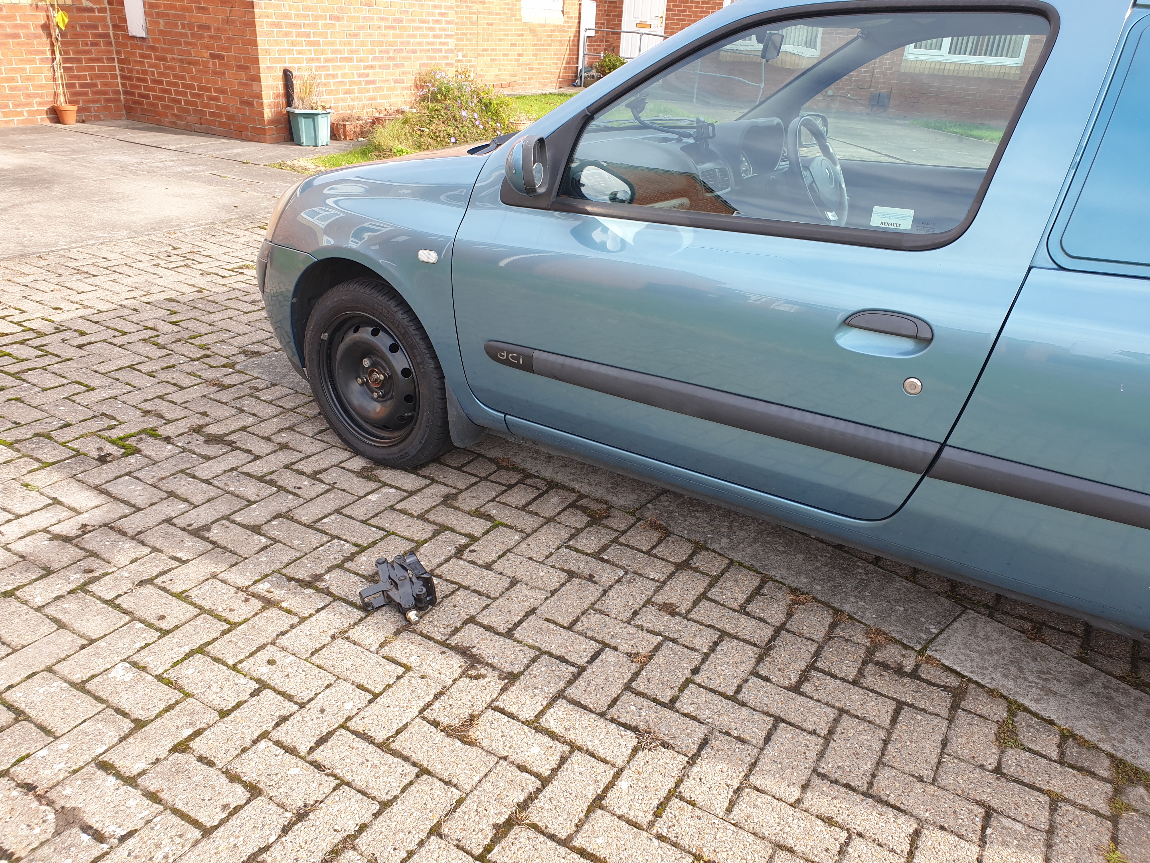

Turbo swap on the blue dci next weekend as my mrs was following me in the megane on saturday and said its smoking a bit for first couple of mins running so its time to get it done.

Removed turbo on blue dci and it checked out as good, no oil on exhaust turbine so the blue smoke from cold must be from worn or gummed up rings, valve stem oil seals or dribbly injector (starts too good for that i reckon).
Assuming its rings at the moment. Monitoring oil consumption which is around 800ml per 1000mile so getting up there, but not a new thing as its been using oil for a while now. Might run it until its using more oil than fuel and then give it a quick & dirty bottom end rebuild? Will see how it goes.
Had a puncture on site the other day so had to fit the steel spare with 18 year old conti tyre on to get home.
Looked alright, id rock the steels on it:unsure:anyway puncture repaired and normal service resumed.
