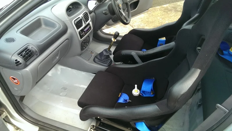

I've de-carpeted this morning!
Ph1 Tom

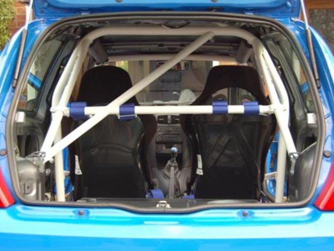

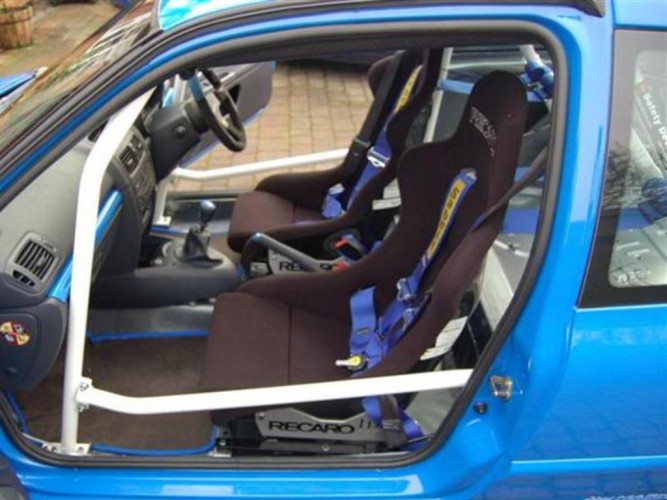

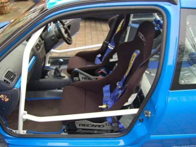

Got my cage from Mark Fish today, I went for the full safety devices cage with single removable door bars and removable diagonal and harness bar.
Like this, but in black...

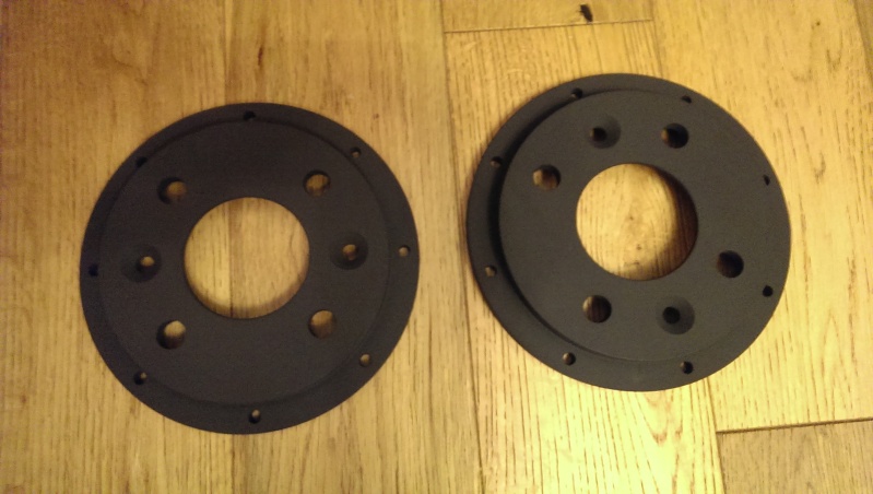

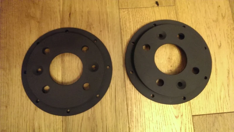

Also I trial fitted my brake bells, tweaked the CSKs for the standard mounting bolts and gave them a lick of black VHT paint. @Cub. @Phase1sr @scooby-93
Now I know they fit I've ordered the rotors from Hi Spec, they should be here around the 2nd/3rd week in January :)

Unfortunately I have no fabrication and machining equipment or skills. I got some material off cuts for a good price and I have a friend with access to equipment who machines the bits for me but I have to pay mates rates for his time.
I was only able to get 3 sets made, 1 of which is for me. I only sell stuff at cost so if I don't sell extras I have made for the benefit of forum members then I'm at a loss. The bells for example have been shot peened and anodised which isn't cheap, hence the low numbers.
I've designed them to be standard size. So with a little modification to standard callipers you could use them with 283*26mm rotors. Or the same rotors but with Brembos.

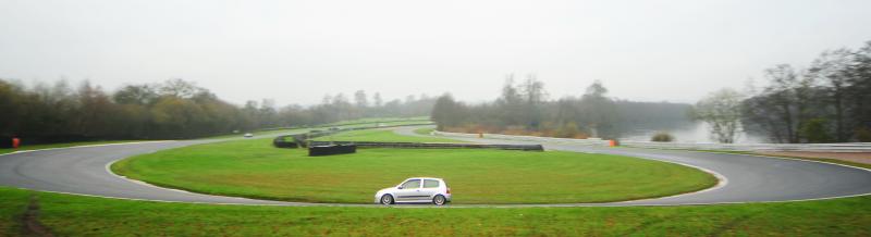

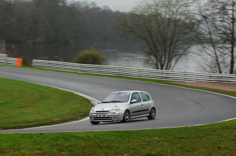

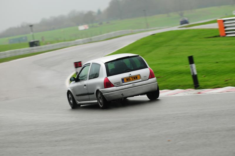

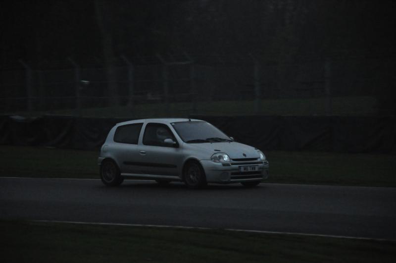

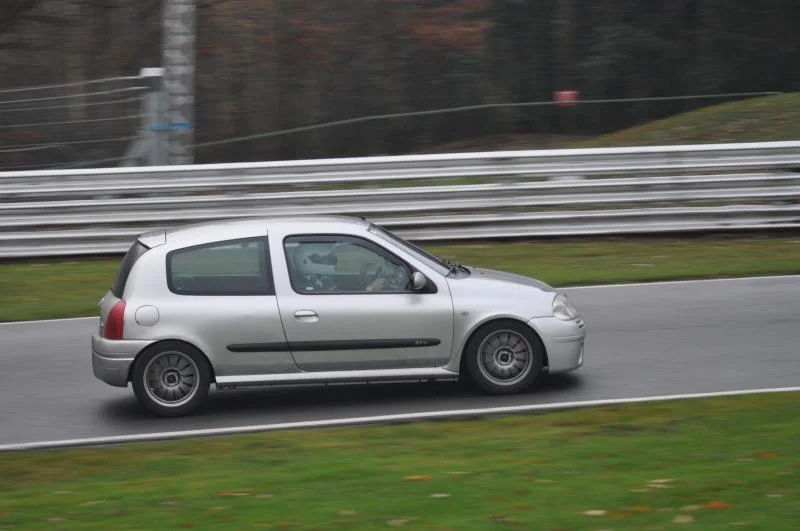

Thought I'd better put the photos and videos of the last track day up seeing as its a month ago.
Then it got a bit dark...
Couple of videos:-

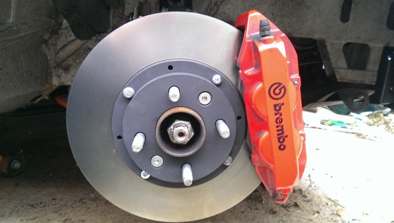

I've got 3 sets including the set I intend to fit on my car. They only suit 8x154mm PCD so max rotor size is 283mm so they are only good for standard callipers or the Clio/Meg Brembos with 280mm brackets.
Perfect even just bells would be fine, as could go for 295mm rotors from Martoon at Reyland
They won't suit that size rotor Neil. I take it your running 300mm discs currently?

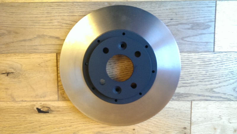

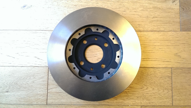

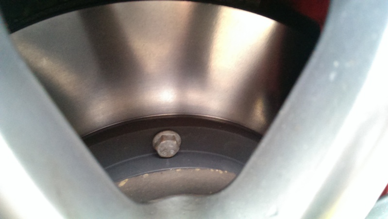

So I had a parcel this morning, I knew what it was which is why I didn't go into work for some overtime! Such excite! Before trying them out I weighed the bell and rotor, 5kg in total. Then after taking the standard disc off I weighed that, 7kg. So a 2kg saving per side :smile:
First off I checked everything lined up. All ok so far :smiley:
Then I found a couple of M6 nuts and bolts to try it out on the car.

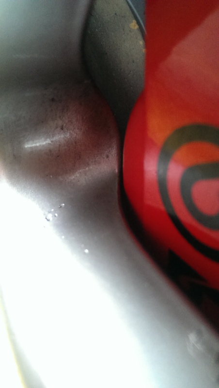

And then I thought I'd see if the wheel cleared without any spacers, and I was surprised to see it does! By a hair :sweatsmile:I think there will be a bit more space when I've got the callipers spaced out another 1.6mm with some M14 form B washers. However without spacers the wheels seem quite close to the coilovers so I'll have to check clearance there too.
Because the bells are fairly small, or at least the whole bell and rotor assembly is and the wheel design doesn't show much off behind it. The bells and rotors are quite stealthy.
Now I know everything fits and what size bolts to get I've ordered all the nuts, bolts and washers in high tensile BZP steel. Stainless was out of the question as I couldn't find the parts in the grade of stainless required.
