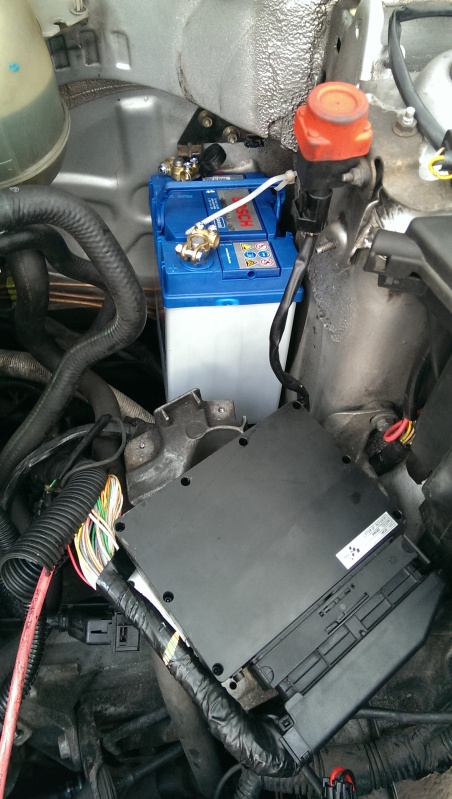

Battery in new position, I've got a battery tray to modify to suit. It's wired straight to the starter wiring on the gearbox so it starts very well now. I need to get some alclad sheet to bolt the ecu to and then I'll bolt the sheet to the gearbox mount.

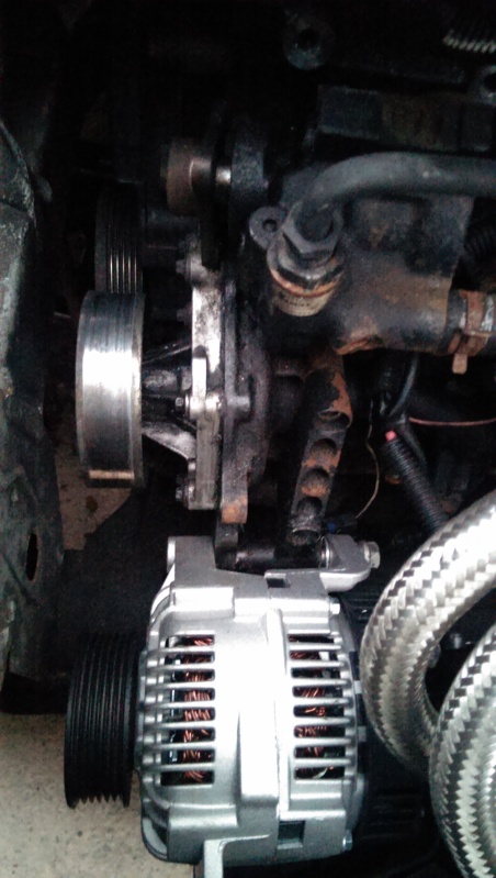

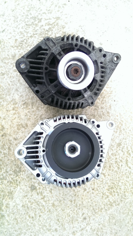

New alternator turned up mid week and the pulley yesterday so here are the old and new.

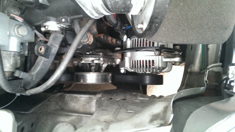

Measured for the new belt, shortest length was 850mm (alternator touching the crossmember) and longest was 890 (alternator touching the mount/block) so I've ordered an 858mm and 870mm belt to see which is best.

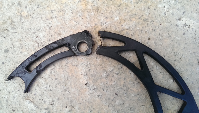

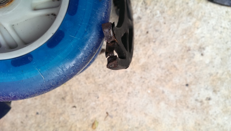

When I removed the old alternator however I was greeted by this :( not impressed tbh, its sheared cleanly. I need to get onto Pure Motorsport as it shouldn't fail like that, only issue is they are out of stock.

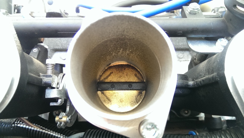

And lastly, it looks as though the Ktec filter of death is starting to go, I've been keeping a close eye on it and it been ok but it seems like its time to replace it for a decent one now.
My PMS bracket broke like that too. PMS replaced it for me as it was less than a year old from memory.
Any reason why you haven't gone for a light weight battery under the passenger seat or in the boot?
Get yourself a new filter man!!

I bought a second hand PMS delete kit that had also broke like that. I had to buy a replacement bit.

I've already got a lightweight battery under the seat. It weighs 6kg +2kg more cable weight. This one is 10kg. So it's still 3kg lighter than standard but only 2kg heavier than the lightweight battery. I gain an extra 22amp/hours and 130 cold crank amps. Which I will need with the astra PAS setup which needs an 80amp feed.
  Many.
What does the alternator put out though? If that can't keep up, it means sod all what battery you have.
Sorry if you have already covered/thought about this, but a lot of people misunderstand battery/alternator/car electrics in general!
Ah ok fair enough mate :)

After buying several belt lengths I finally got one to fit perfectly with the PMS delete setup and a larger 80mm alternator pulley, its 905mm in length.

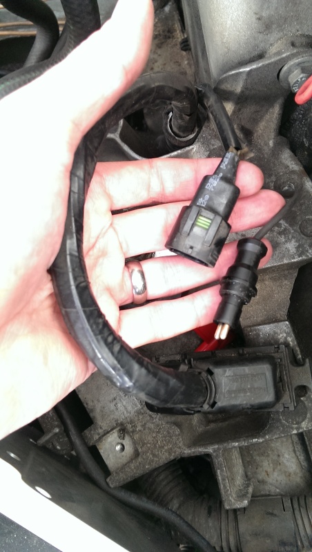

So with that lot done I took it for a drive today without the PAS and without the top plug (see photo) connected, it was part of the ABS loom and I've removed the ABS so I guessed it was no longer needed. Everything works fine so I assume it is now redundant.

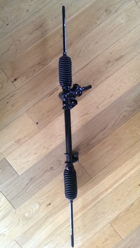

Picked up a refurbed EPAS rack. I thought it was a 3.25 turn rack but it turns out to be a 2.75!

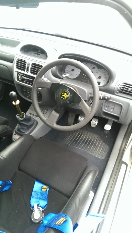

I replaced my 330mm Sabelt wheel with a 350mm Motacorsa wheel to help with steering effort. It's leather rather than suede so doesn't need as much looking after.

Do you have a part number for that alternator pulley? and also where is the returned rack from, I think mines developing some play.

I got the pulley from here : http://pages.ebay.com/link/?nav=item.view&id=281470785919&alt=web
You need to get the alternator pulley spacers from the same shop, I used 8 of the 10 spacers to get it the same as standard : http://pages.ebay.com/link/?nav=item.view&id=281476055349&alt=web
The rack was from this place http://autosteerdirect.co.uk/

How easy is fitting the epas Tom?
It's just the rack I've got fitted Oli, I assume you mean that.
Rather than drop the subframe I decided to cut the PAS pipes at the rack. Then you can pull it out from the driver's side.
As for putting the epas rack back in, it's smaller than the PAS rack so it slides in easily. I found the tie rods were the same length as the ones I had fitted (only cup ones are longer) so I didn't have to swap them over as I have longer adapters for the roll centre kit rod ends.
The rack bolts on differently so you just need to sort a suitable nut and bolt combination and then a new method of attaching the heatshield back in position.

Don't suppose you have the Renault number the rack by any chance?
What else is needed for fitting an epas rack/non pas rack? I'd much rather have manual steering than hydraulic or electric.
