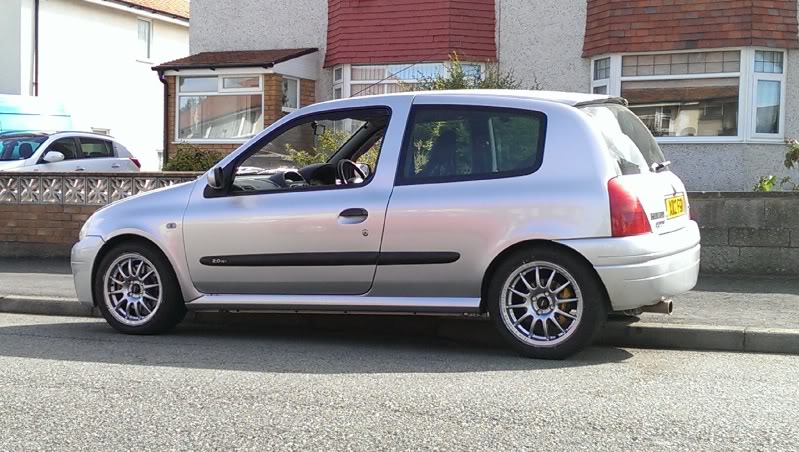

Turns out the Pro Race were ET25 not 35 so that's why they were a bit heavier. Got that sorted and got them on now :) They are 1kg lighter each than the OZ but stronger too and a better offset so the spacers have gone too.

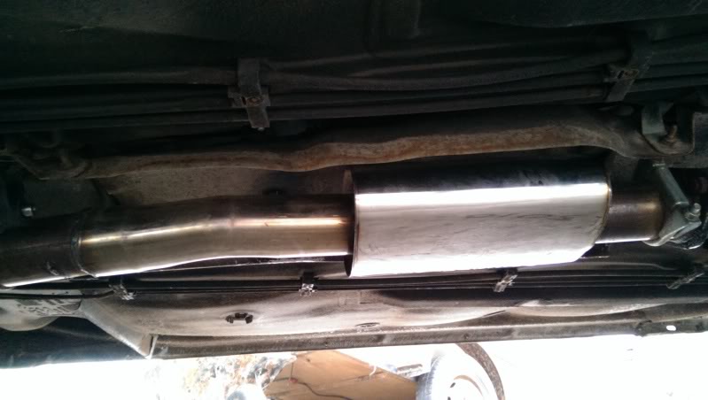

Went to see a friend who is just opening his new Powerflow place in Deeside and I was his first customer (testing the ramps etc.). I got a smaller centre silencer fitted to keep the same tone but up the volume a tad, just right now. Also means I don't have to detach the exhaust to swap the seats over! Cost all of £60 :)

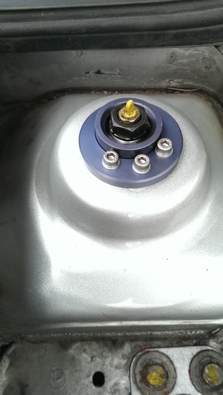

Got my AST strut tops through from Cooksport. I'll get them fitted with the new bearings and strut bump stops. Then turn up the camber :)

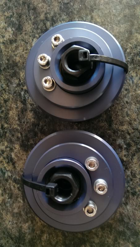

Swapped out the cup shocks and top mounts for some adjustable AST mounts and adjustable Konis

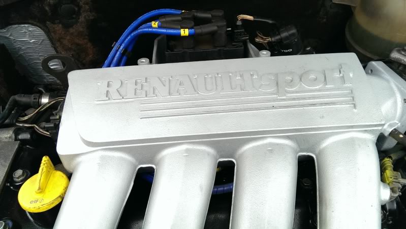

Fitted some 8mm blue Magnecore leads.

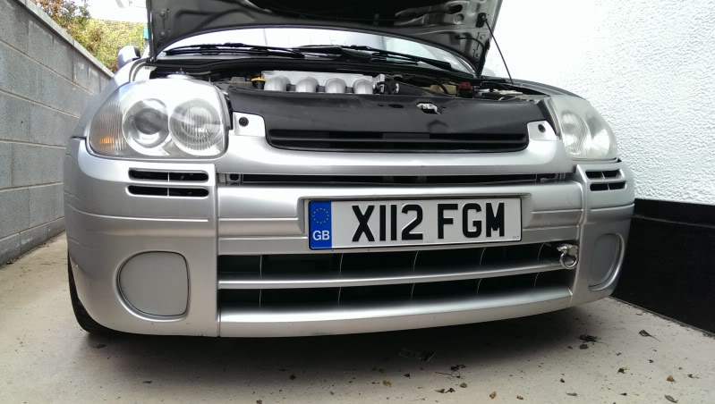

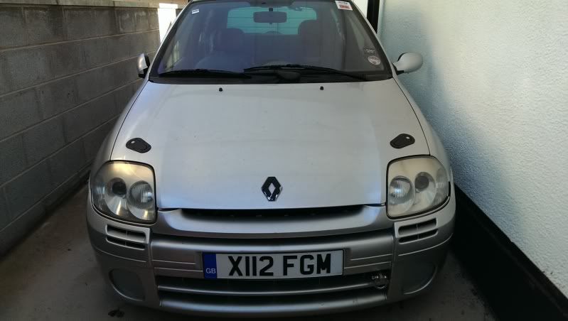

Got a pair of fog blanks for when I'm not needing brake cooling.

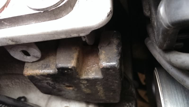

Wondering how this is removed...

Easy, put your hand round the back of it.
Between the cam cover and the strut top.
Theres a bolt that goes through into it.

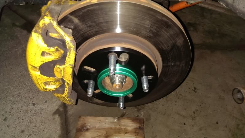

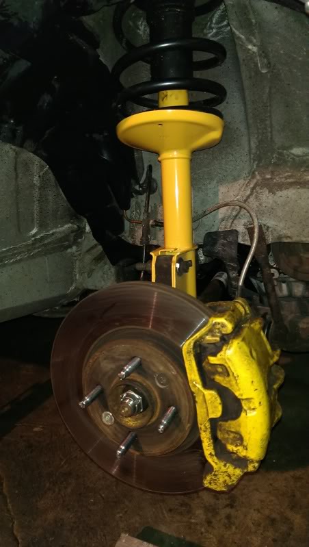

Ordered some studs so I can get rid of the wheel bolts, 10mm hubcentric spacers for the front with a 60.1-73.1 centre bore so I won't need spigot rings, 10mm rear spacers with an extra -1 degree camber.
I'll get all that on then take it to get the front geo set up.

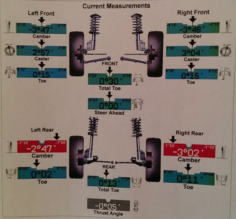

Got my studs and spacers on before Oulton and then had the alignment done.

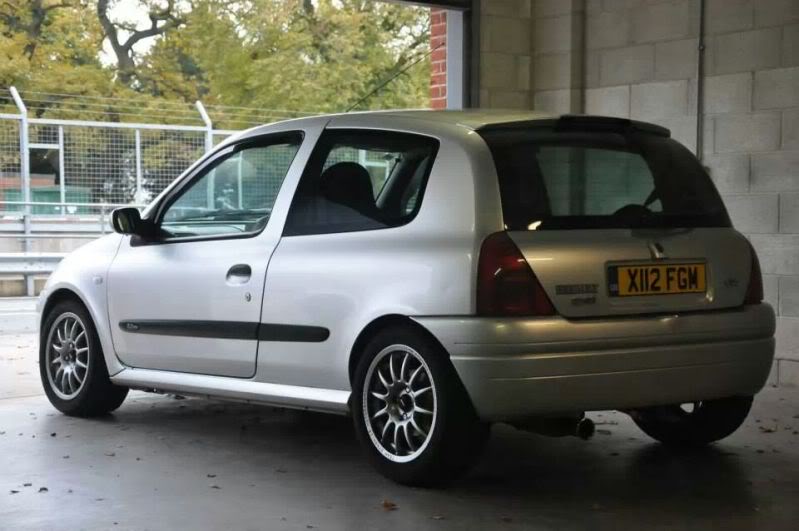

Had a good day at Oulton. Track was dry but there were a good few red flags, I counted 11 but could have been more than that.
Here's a few pics from the day.
So after the day my plan of things to do are:-
Fit front cup subframe for wider front track.
Reduce front camber to 3.3 and try to get more caster.
Reduce rear camber to 2.
Roll rear arches and get 10mm spacers on the rear.
Stud and nut conversion for the rear.
Take some more weight out. Weighed it at Oulton, it's currently 980kg with a full tank of fuel.

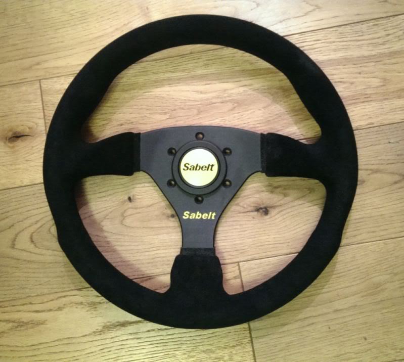

Meanwhile I cleaned up the wheel I got from JohnnyE and got a Sabelt centre button too.

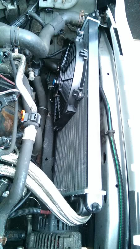

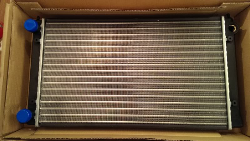

My radiator arrived. Very happy with it for £21.50 posted and it's bigger than the usual Polo radiator used which is too small imo.

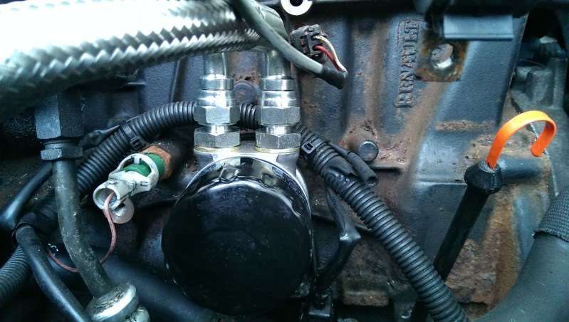

I've done the aerocatches and radiator ready. In the process of doing the oil cooler whilst I've got easy access.

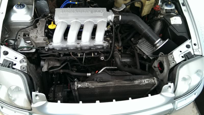

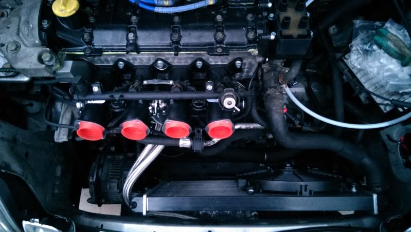

With other things on this weekend I didn't get as far as I had hoped. But this is where I'm up to.
Oil cooler kit fitted, hoses are off a Mk1 so a bit short but managed to find somewhere to route them around the radiator, I'll tie them out of the way so they don't rub.

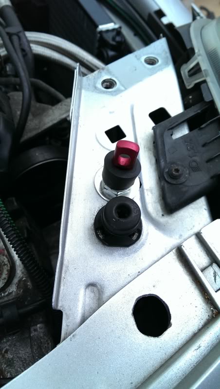

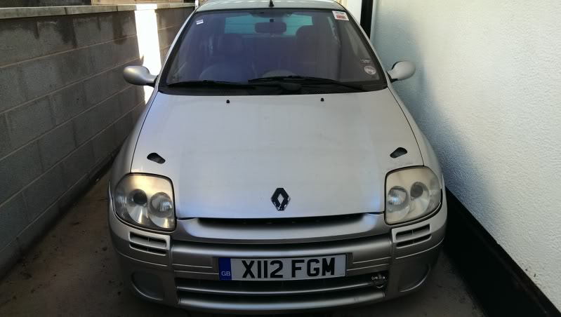

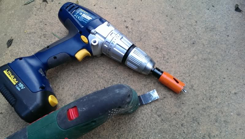

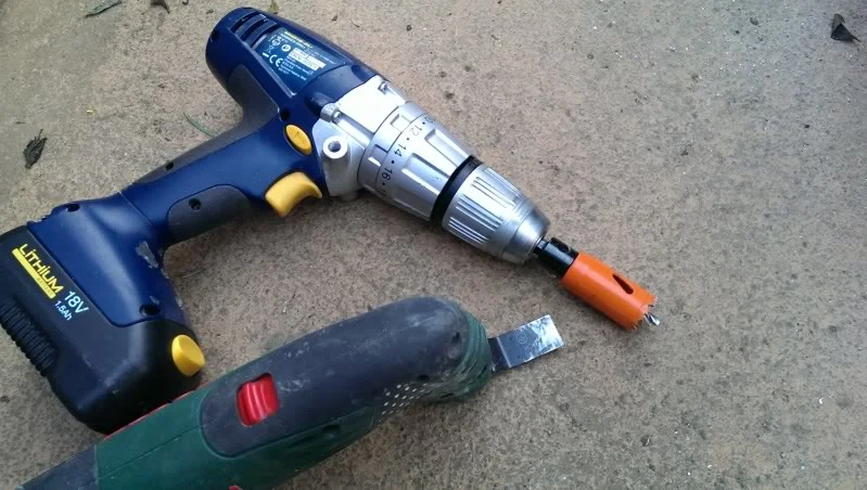

I also fitted some aerocatches, I prefered the look of them at an angle, also it allows you to use the standard bonnet stops to set the height perfectly. No dremel so I used what I had available. Everthing was treated for corrosion protection afterwards.
And the ITBs bolted up with the brake line, fuel rail and linkage set. Need to do the throttle cable next and the ECU wiring. The FPR has no vac feed, I don't know if this is an issue or not, it should give a flat rate of 4 bar with the uprated FPR fitted. Does it need a vac feed to work properly?!
Also I'm looking into how to angle the trumpets to where I want for a better filter location and give me a longer inlet length so I've started drawing up a cad model which involves 2 x DCOE patter flanges and some angled pipes. I need to determine the best angle but it's probably around 30 degrees at a guess.
