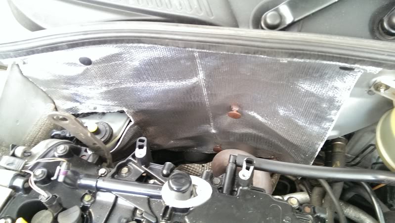

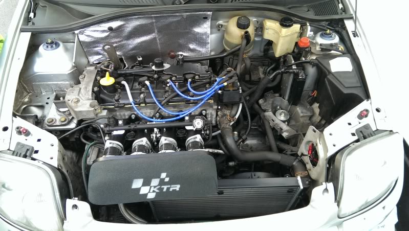

Last bit I needed to do in the bay was the bulkhead heat protection.

Nice and responsive, pulled well from low down.
Now I've got the filter setup all sorted the idle is solid around 900rpm. Just need to tweak the cold start so I don't have to hold it on the throttle for a few seconds to get it idling.

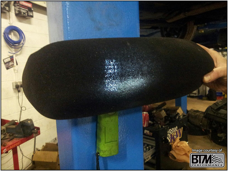

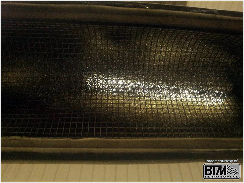

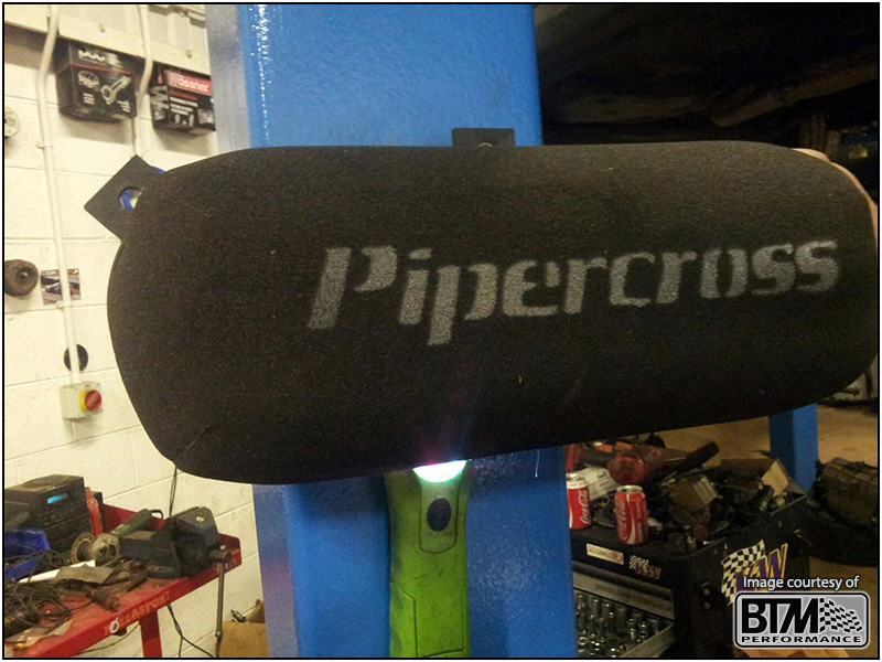

Look at @SharkyUK project thread. Some pics of his running the same filter. It was practically transparent.
Indeed - please be very careful with the filter. It was shocking. It's also worth noting that I maintained my filter (and indeed everything else ) impeccably...
My engine ingested a lot of the filter.
How a decent filter SHOULD look...

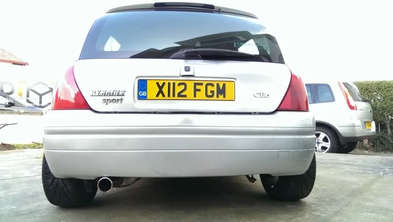

Cup subframe is done as well as changing the rear spacers. Looks much better all round now.

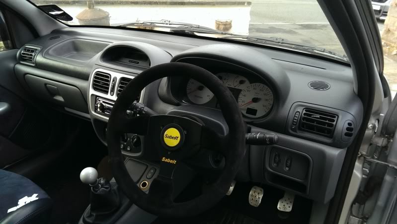

Got my 1.2 dash fitted today after getting the car back.

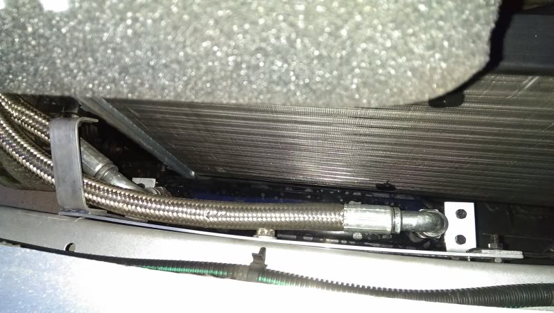

The final bit I needed to do before mapping in 3 weeks was to secure the oil cooler and radiator for driving the car in earnest.

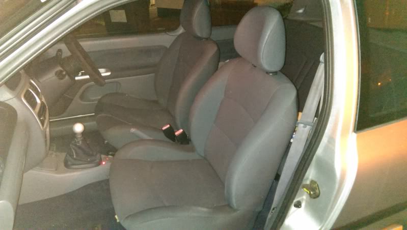

I decided whilst the weather was decent to change my Ph1 seats over to the 172 Cup seats I got from Carbonraider I gave them a clean and swapped the runners and pretensioners over from the Ph1 seats.
Popped them in this evening and they match the 1.2 top dash and cowling much better now, besides I already had the Cup rear bench.

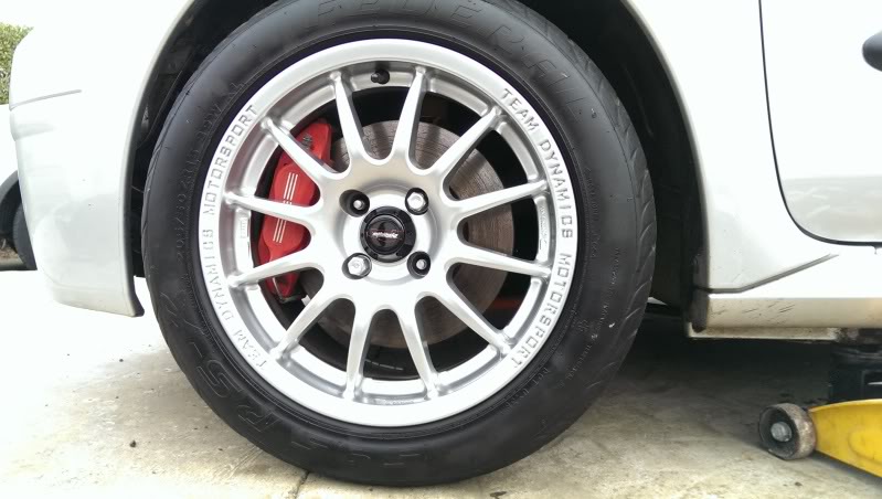

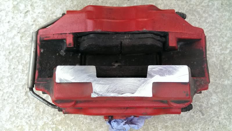

Did some tinkering today. Took an angle grinder to a 4 pot calliper then tried it in place.
So next step is to machine it down properly and convert it to radial mount then decide on discs and makes some brackets.

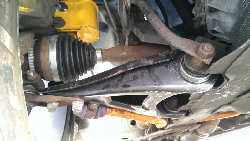

Also got a couple of pics to show how it sits now with the cup subframe, et35 wheels and 10mm spacers on the front and et35 wheels with 7.5mm spacers on the back. I'll get another 5mm each side on the front with the roll centre kit.
Here you can see the wishbone mounts further out than on a ph1 subframe.

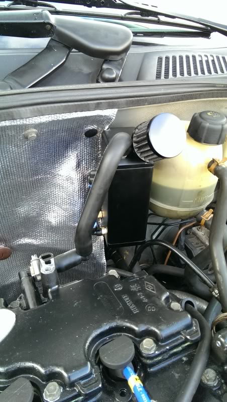

Also fitted a catch tank

Exact same thinking as me with the AP's.
Bought some a while back and looked into making them radials then get some brackets made up. Should do a job and make less of a squeal than the 406 brembos. What discs are you going for?

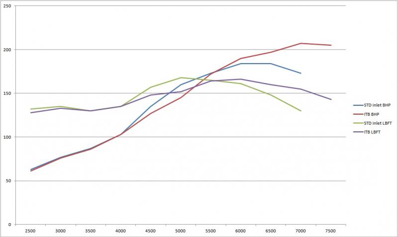

Previous power was 152 at the wheels (dyno dynamics corrected it to 184 at the fly). It is now 171 at the wheels, so using the same factor for losses that's 207 at the fly.
I'm going to overlay graphs later :)

Done the graph overlays so you can see the before and after, the standard inlet give a big peak in the midrange so I'm losing out around 4500 and 5000 but above that I'm gaining quite a bit. I can feel it too, it doesn't have the kick it had at 4.5k but it feels much quicker overall now.
