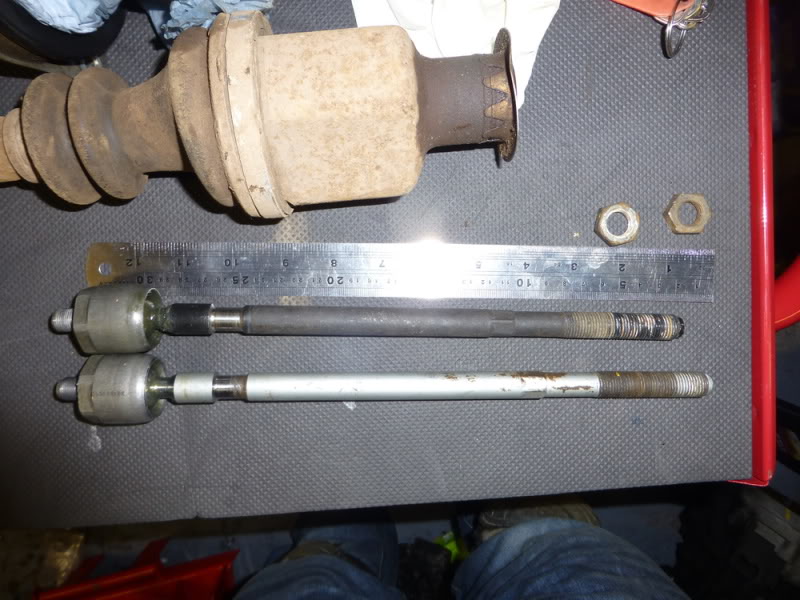

Well the drive shaft and track rod issues are sorted with help from NorthloopCup Chip-mk1 and Carbonraider .

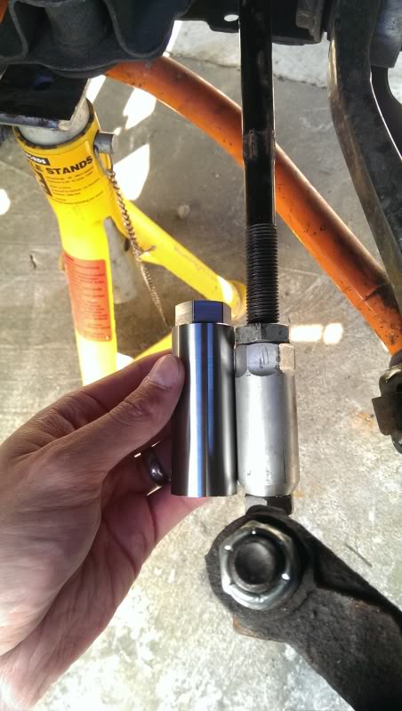

For the track rods I had some longer adapters made.

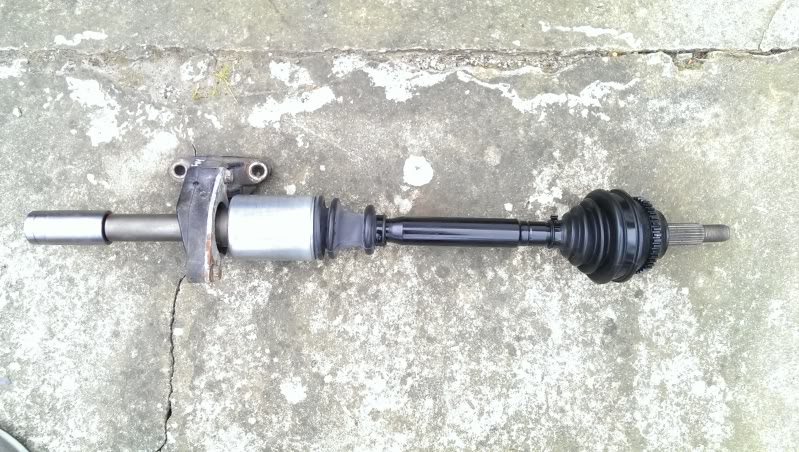

And I've fitted a set of new genuine ph2 172 shafts which are 20mm longer each side than the ph1 shafts. For the o/s I went for the two piece shaft and sourced a used bearing carrier.

Well the drive shaft and track rod issues are sorted with help from @NorthloopCup @Chip-mk1 and @Carbonraider .

Would you do me a favour please? And measure the length of the track rod if you could. The entire thing, and just thread down please. My lemforder items still seem a little short.

I think Morgan dud this photo. Non cup up top and cup below.

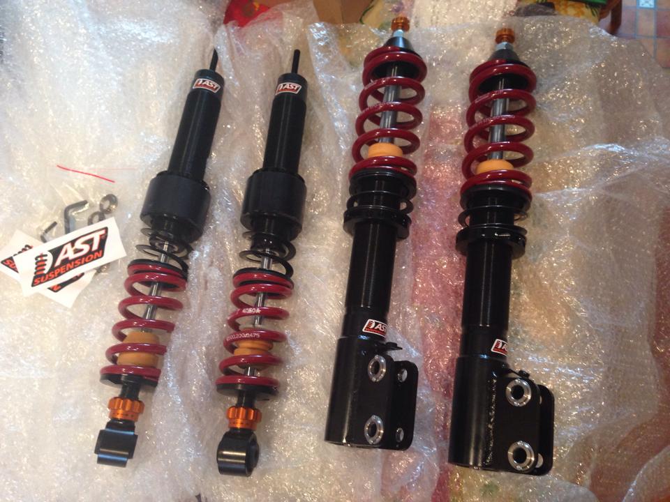

Also had some good news yesterday, apparently my ASTs are ready so I've booked a hotel and I'm traveling down to Cheltenham to pick them up, going to squeeze in a trip to Kenilworth Castle tomorrow to take the kids to watch some jousting too. All being well I'll get the struts fitted on Sunday and take it out for a drive :race:

Tbh on the road I doubt they'll be much different to yours, I'll just have damping adjustment for track use really as they'll be on fully soft for road.
You've got Eibach springs on yours whereas mine are AST springs (same colour paint as the Cooksport springs funny enough :P so I wouldn't be surprised if the planned Cooksport coilovers have something to do with AST one way or another) so my guess would be that Eibach didn't make a suitable free length spring which is why AST have their own now so they don't need the spacer.
As for spring rates I've got 400lb front and 285lb rear. It rides spot on, couldn't be happier tbh. I've got less roll which I wanted but its road manners are the same, if not better than the Cooksport springs (it'll be down to the damper technology rather than spring rate though). Looking forward to trying it out on track now, the combination of the coilovers and the roll centre kit is unbelievable.

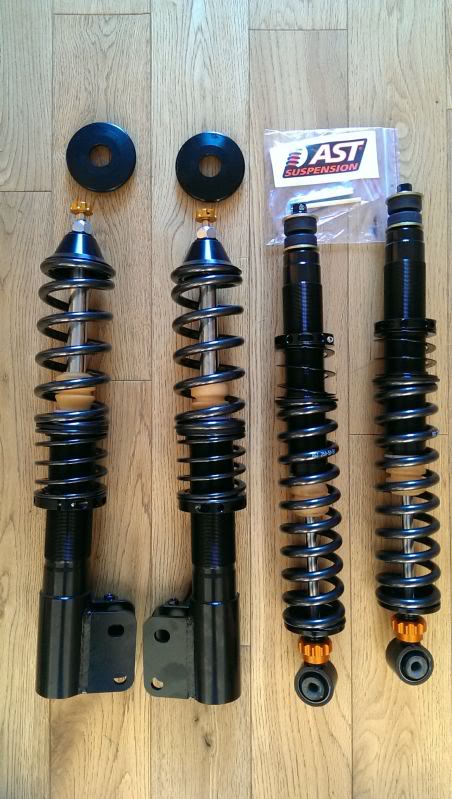

Eibach don't do a spring longer than 5" in the 1.9" diameter so Ast had to use that spacer setup. I've got something very similar on the rear of mine. I just got some nylon spacers custom made. Martin.
Cheers chaps. Mine are 450lbs all round from memory. Or maybe slightly more on the front. Can't remember what josh decided on for me when I ordered them. Need to get them fitted urgently just waiting on some bits back from my mate.
I did did wonder what this bit on mine was! Got any pictures of yours mark? NorthloopCup bet it looks better than the plastic on mine.
Is plastic actually strong enough?? Guess it must be!

Eibach don't do a spring longer than 5" in the 1.9" diameter so Ast had to use that spacer setup. I've got something very similar on the rear of mine. I just got some nylon spacers custom made. @Martin.

They do 10" http://www.hmsraceparts.com/Eibach-1-9-ID-10-Length-Springs/
I could go stiffer all round but it's so composed and comfy on the road whilst having minimal roll I don't know if I'd want to. Joe is running the same rates as me IIRC
You'd be surprised how strong some plastics are! Martin. Have a look at your springs. They should be something like 180-80 on the front which would be 7" free length (180mm) and 456lb (80nm) and the rear maybe 130-90 so 5" and 514lb if they are the 'track' setup.

I've got some pictures mate, but I'm fucked if I can work out how to upload them off my phone via photofuckit! I need a tutorial! Lol! Yeah plastic/nylon is fine and extremely strong. It's beautiful to work with on the lathe as well! I've got nylon rear top suspension bushes and I'll be having some nylon bushes made for the dogbone as well.

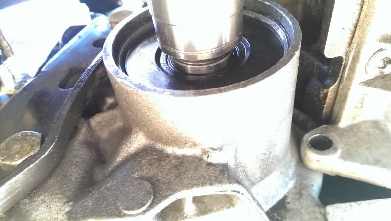

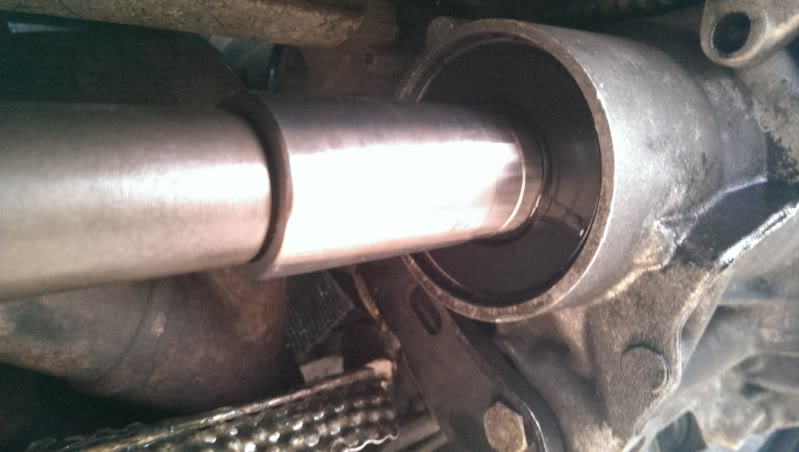

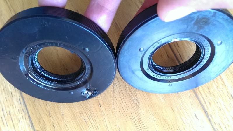

Three days after getting it all back together I had more bad luck...fresh gearbox oil down the road and on the driveway coming from the O/S gearbox seal.
So upon investigation it turns out the driveshaft end section had shifted slightly and moved closer to the seal then worn away the outer lip of the seal.
I couldn't knock the end piece back into place so left it where it was and ground the end down a few mm and leaving a few mm spare before reaching the splines.
New seal fitted and I've got plenty of clearance now :)
Going to give it a good run later and then check again

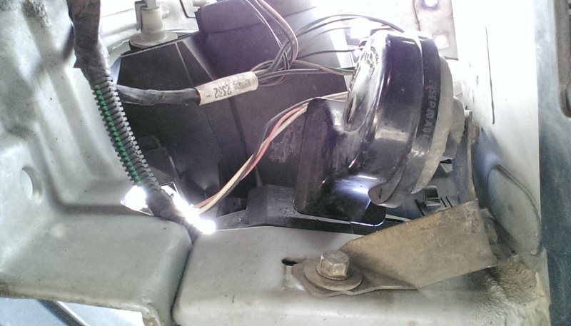

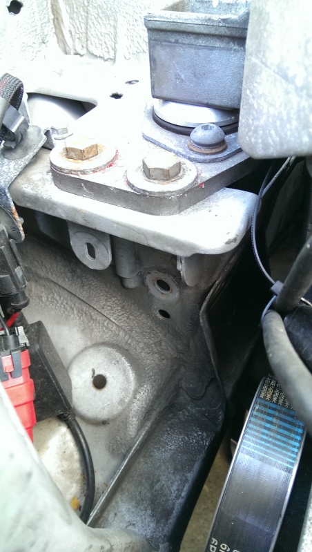

Some minor weight saving, got rid of one horn and bent the bracket to tuck it up out of the way. Also removed the weight by the engine mount.

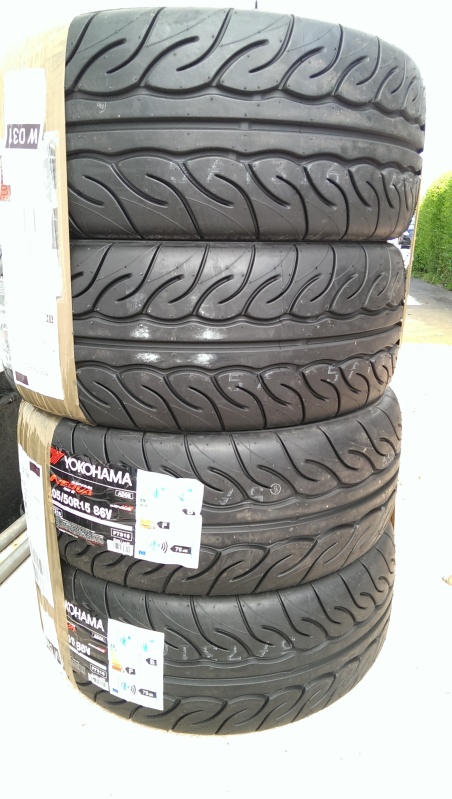

I'd decided I was going to go down to 195/50 from 205/50 R15 tyres but changed my mind again so the R888 went and I got a set of AD08R to try out, the Federal RSR still have a fair bit of life left so I'll sell those on when I take them off.

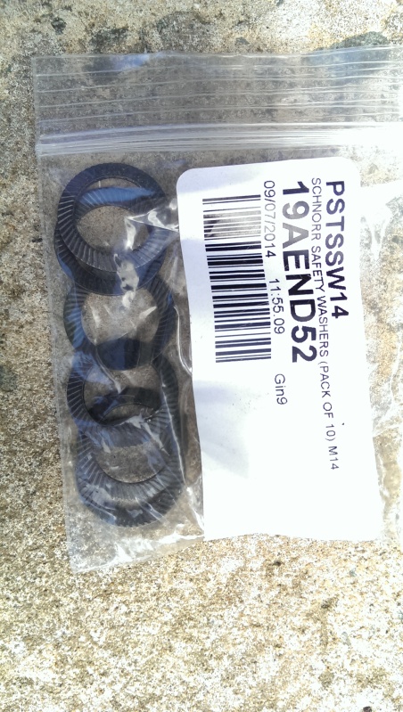

On Mark's recommendation NorthloopCup I fitted some Schnorr washers to the strut bolts.

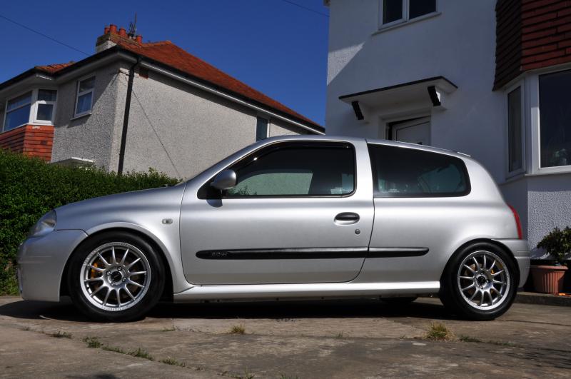

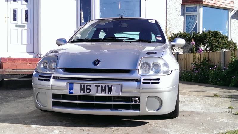

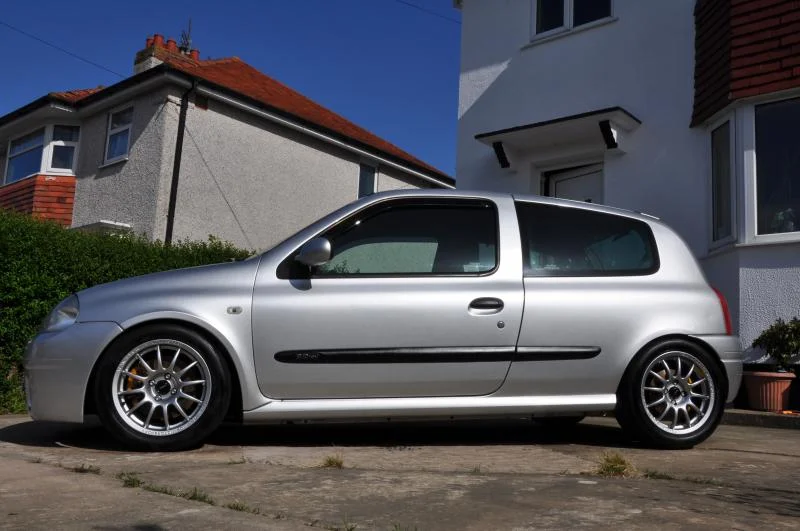

Interior has come back out for Oulton on the 27th, tracking has been set and I've put my spacers back on the front with the studs and nuts. It looks wide :)
With the tracking set it drives better than ever, can't wait to get it out on track and see what it can do. Gave it a wash and a polish too.

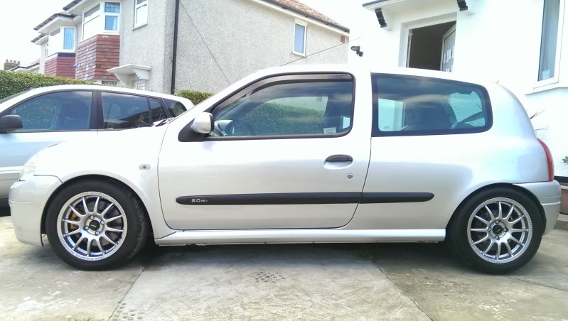

So up front over a standard phase 1 I've got a cup subframe (+10mm each side), roll centre kit (+5mm each side), ET35 wheels (+8mm each side) and 10mm spacers. So a 66mm wider front track.
On the back I've got the ET35 wheels and 7.5mm hub spacers. But after rolling the arches I'm hoping to go 15 or 20mm spacers. So potentially 56mm wider on the back; depends how much I can pull the arches out. I'll be getting the arches repainted afterwards so not bothered it the paint cracks so hopefully I can get them out quite far.
